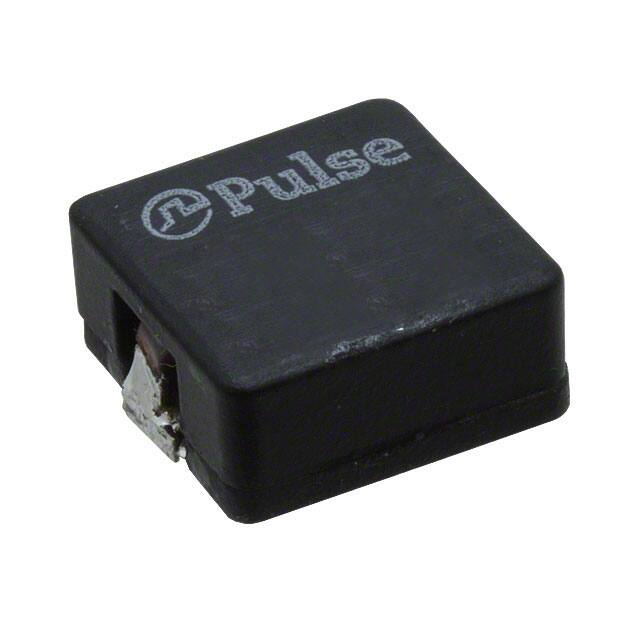

    固定电感器 Nonstandard 2µH ±20% 23A 2.9mΩ
PG0077.202NLT 数据手册
SMT POWER INDUCTORS Flat Coils - PG0077NL and PG0084NL Series Height: 6.5mm Max (PG0077) and 4.40mm Max (PG0084) Footprint: 14.5mm x 13.0mm Max Current Rating: up to 45A Inductance Range: 0.38µH to 2.65µH Electrical Specifications @ 25°C — Operating Temperature -40°C to +95°C 1 Inductance @Irated (μH TYP) Part 8,9 Number 2 MAX Inductance @0A D C (μH ±20%) Saturation 4 Current Isat (A) Heating 5 Current I D C (A) DCR (m Ω) Irated 3 (A) TYP Core Loss 6 Factor K1 K2 PG0077.401NL 0.34 45 0.75 0.80 0.45 48 45 1.68E-9 33.5 PG0077.801NL 0.68 35 1.20 1.30 0.80 38 35 1.68E-9 42.5 PG0077.142NL 1.16 27 2.00 2.10 1.40 28 27 1.68E-9 57.8 PG0077.202NL 1.66 23 2.80 2.90 2.00 24 23 1.68E-9 67.6 PG0077.282NL 2.32 19 4.10 4.20 2.80 20 19 1.68E-9 80.1 PG0084.351NL 0.28 40 1.30 1.80 0.35 40 61 1.27E-9 28.7 PG0084.651NL 0.52 32 2.30 2.80 0.65 32 45 1.27E-9 38.1 PG0084.112NL 0.88 24 3.60 4.20 1.10 24 34 1.27E-9 50.1 Schematic Mechanical X .512 MAX 13,00 Y .441 11,20 1 2 .165 4,20 PG0077.XXX PG0084.XXX Date Code Country of Origin .091 2,30 PG0077 PG0084 Weight .................5.5 grams......3.5 grams Tape & Reel............300/reel ........400/reel .612 ± .005 15,55 ± 0,12 Dimensions: Inches mm Unless otherwise specified, all tolerances are ± .010 0,25 .205 ± .005 5,20 ± 0,12 Part Number Max. Length “X” (in./mm) Max. Height “Y” (in./mm) Max. Height “Z” (in./mm) PG0077.401 PG0077.801 PG0077.142 PG0077.202 PG0077.282 PG0084.351 PG0084.651 PG0084.112 .571/14,50 .571/14,50 .551/14,00 .551/14,00 .551/14,00 .551/14,00 .551/14,00 .543/13,80 .256/6,50 .256/6,50 .256/6,50 .256/6,50 .256/6,50 .173/4,40 .173/4,40 .173/4,40 .276/7,00 .276/7,00 .276/7,00 .276/7,00 .276/7,00 .173/4,40 .173/4,40 .173/4,40 2x .197 ± .005 5,00 ± 0,12 .520 13,20 SUGGESTED PAD LAYOUT .453 11,50 .945 ± .012 24,00 ± 0,30 .598 15,20 Z .945 24,00 TAPE & REEL LAYOUT USA 858 674 8100 • Germany 49 7032 7806 0 • Singapore 65 6287 8998 • Shanghai 86 21 54643211 / 2 • China 86 755 33966678 • Taiwan 886 3 4641811 www.pulseeng.com 62 SPM2007 (11/07) SMT POWER INDUCTORS Flat Coils - PG0077NL and PG0084NL Series Notes from Tables 1. The temperature of the component (ambient plus temperature rise) must be within the standard operating temperature range. 2. Inductance at Irated is a typical inductance value for the component taken at rated current. 3. The rated current listed is the lower of the saturation current @ 25°C or the heating current. 4. The saturation current, ISAT, is the current at which the component inductance drops by 20% (typical) at an ambient temperature of 25°C. This current is determined by placing the component in the specified ambient environment and applying a short duration pulse current (to eliminate self-heating effects) to the component. 5. The heating current, I DC , is the DC current required to raise the component temperature by approximately 40°C. The heating current is determined by mounting the component on a typical PCB and applying current for 30 minutes. The temperature is measured by placing the thermocouple on top of the unit under test. Take note that the component’s performance varies depending on the system condition. It is suggested that the component be tested at the system level, to verify the temperature rise of the component during system operation. 6. Core loss approximation is based on published core data: Core Loss = K1 * (f)1.035 * (K2ΔI)2.263 Where: Core Loss = in Watts f = switching frequency in kHz K1 & K2 = core loss factors ΔI = delta I across the component in Ampere ΔI = one half of the peak to peak flux density K2Δ across the component in Gauss 7. Unless otherwise specified, all testing is made at 100kHz, 0.1VAC. 8. Optional Tape & Reel packaging can be ordered by adding a "T" suffix to the part number (i.e. PG0077.401NL becomes PG0077.401NLT). Pulse complies to industry standard tape and reel specification EIA481. 9. The "NL" suffix indicates an RoHS-compliant part number. Non-NL suffixed parts are not necessarily RoHS compliant, but are electrically and mechanically equivalent to NL versions. If a part number does not have the "NL" suffix, but an RoHS compliant version is required, please contact Pulse for availability. Inductance vs Current Characteristics PG0077 Series 3.0 PG0077.202 2.0 1.5 PG0077.142 1.0 PG0077.801 0.5 48.5 46.5 44.5 42.5 40.5 38.5 36.5 34.5 32.5 30.5 28.5 26.5 24.5 22.5 20.5 18.5 16.5 14.5 12.5 8.5 10.5 6.5 4.5 2.5 0 PG0077.401 0.5 I N D U C TA N C E (µH ) PG0077.282 2.5 BIAS CURRENT (A) PG0084 Series 2.8 2.0 1.6 1.2 PG0084.112 0.8 PG0084.651 0.4 58.5 56.6 54.5 52.5 50.6 46.5 48.5 44.6 42.5 38.6 36.5 34.5 32.6 30.5 28.5 26.6 24.5 22.5 20.6 18.5 16.5 14.6 12.5 8.6 10.5 6.5 4.5 2.6 0.5 0 PG0084.351 40.5 I N D U C TA N C E (µH ) 2.4 BIAS CURRENT (A) USA 858 674 8100 • Germany 49 7032 7806 0 • Singapore 65 6287 8998 • Shanghai 86 21 54643211 / 2 • China 86 755 33966678 • Taiwan 886 3 4641811 www.pulseeng.com 63 SPM2007 (11/07)
