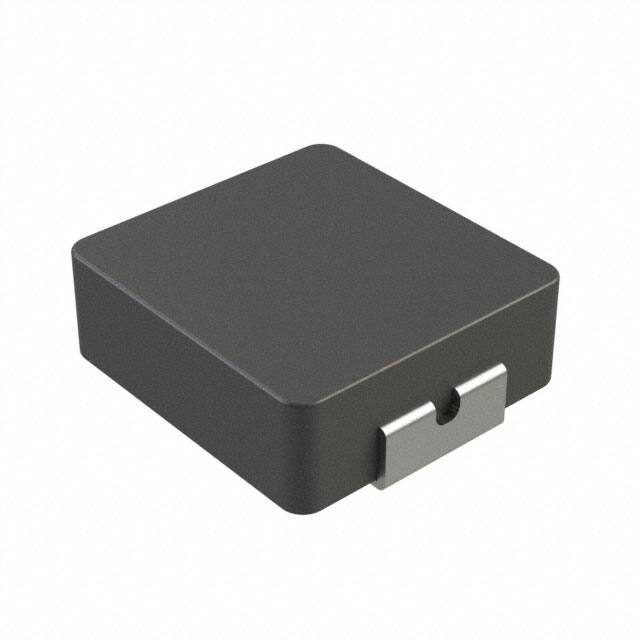

    固定电感器 Nonstandard 6.8µH ±20% 1.5A 348mΩ
PM4547.682NLT 数据手册
SMT Power Inductor High Current Molded Power Inductor - PA4547 & PM4547 Series POWER PRODUCTS IA Height: 1.5mm Max Footprint: 3.8mm x 3.4mm Max Current Rating: up to 7.0A Inductance Range: 0.22uH to 10.0uH High current, low DCR, and high efficiency High reliability Minimized acoustic noise and minimized leakage flux noise 200Vdc Isolation between terminal and core T F 169 4 9 Electrical Specifications @ 25°C - Operating Temperature -55°C to +125°C Commercial Automotive 5,6 5,6 DC Resistance Inductance5 100KHz, 1.0V Rated3 Current TYP. MAX. Saturation2 Current uH±20% A mΩ mΩ A PA4547.221NLT PM4547.221NLT 0.22 7.00 14 17 10.8 PA4547.471NLT PM4547.471NLT 0.47 5.50 23.3 28 8.0 PA4547.561NLT PM4547.561NLT 0.56 5.00 28 33 7.2 PA4547.681NLT PM4547.681NLT 0.68 4.50 34 42 6.5 PA4547.102NLT PM4547.102NLT 1.00 3.60 41 50 5.8 PA4547.152NLT PM4547.152NLT 1.50 3.40 64 77 4.0 PA4547.222NLT PM4547.222NLT 2.20 3.20 82 98 3.8 PA4547.332NLT PM4547.332NLT 3.30 2.50 170 205 3.2 PA4547.472NLT PM4547.472NLT 4.70 1.90 220 264 2.8 PA4547.562NLT PM4547.562NLT 5.60 1.70 265 318 2.3 PA4547.682NLT PM4547.682NLT 6.80 1.50 290 348 2.0 PA4547.822NLT PM4547.822NLT 8.20 1.30 390 468 1.8 PA4547.103NLT PM4547.103NLT 10.00 1.20 435 522 1.6 Notes: 1. Actual temperature of the component during system operation (ambient plus temperature rise) must be within the standard operating range. 2. The saturation current is the current at which the initial inductance drops approximately 30% at the stated ambient temperature. This current is determined by placing the compnent in the specified ambient environment and applying a short duration pulse current (to eliminate self-heating effect) to the component. 3. The rated current is the DC current required to raise the component temperature by approximately 40�C. Take note that the components’ performanc varies depending on the system condition. It is suggested that the component be tested at the system level, to verify the temperature rise of the component during system operation. 4. The part temperature (ambient+temp rise) should not exceed 125�C under worst case operating conditions. Circuit design, PCB trace size and thickness, airflow and other cooling provisions all affect the part temperature. Part temperature should be 1 Power.PulseElectronics.com 5. 6. 7. 8. verified in the end application. Please note that the inductance tolerance of all parts are +/-20% except those indicated with a * which are +/-30%. Parts shown in bold are standard catalog parts and are available through sample stock and distribution. Parts in lighter font are available but are not necessarily held in sample stock or distribution and lead times may be longer. Please contact Pulse for availablity. Both the PA and PM part numbers are AEC-Q200 qualified parts. The PM part numbers have full automotive IATF16949 certification. The PM part number dimensions are 100% tested in production but do not necessarily meet a product capability index (Cpk)> 1.33 and therefore may not strictly conform to PPAP. Special characteristics P824.G (07/20) SMT Power Inductor High Current Molded Power Inductor - PA4547 & PM4547 Series POWER PRODUCTS Mechanical PA4547/PM4547 C L E  XXX B D H A G SUGGESTED PAD LAYOUT FINAL LAYOUT Series A B C D E L G H PA4547/PM4547 3.5±0.3 3.2±0.2 1.3±0.2 0.7±0.2 1.2±0.2 4.1 1.9 1.45 All Dimensions in mm. TAPE & REEL INFO Marking Marking K0 A W P1 G Direction of tape SURFACE MOUNTING TYPE, REEL/TAPE LIST REEL SIZE (mm) PA4547/PM4547 2 TAPE SIZE (mm) QTY A G P1 W K0 PCS/REEL Ø330 12.4 8 12 1.8 3000 Power.PulseElectronics.com P824.G (07/20) SMT Power Inductor High Current Molded Power Inductor - PA4547 & PM4547 Series POWER PRODUCTS Typical Performance Curves PA4547.XXXNLT 48 0.14 32 0.07 16 PA4547.681NLT 0.48 48 0.6 48 0.32 32 0.4 32 0.16 16 0.2 16 0 0 0.8 64 0.6 48 0.4 32 0.2 16 0 1.38 2.76 4.14 DC CURRENT(A) 5.52 PA4547.222NLT TMPC0315H-2R2 TEMP. RISE(oC) INDUCTANCE (uH) 1.4 0 PA4547.562NLT 0.28 16 0.5 10 PA4547.103NLT 10.4 3 4.64 0 0 5.8 PA4547.332NLT TMPC0315H-3R3 0 0.8 1.6 2.4 DC CURRENT(A) 3.2 PA4547.472NLT TMPC0315H-4R7 4 0 5.6 88 3 51 4.2 66 2 34 2.8 44 12 1 17 1.4 22 0 0 3.8 1.6 TMPC0315H-100 3.48 68 40 13 2.32 DC CURRENT(A) 4 3.2 1.84 1.16 7 60 1.38 0 50 85 4.8 0.92 PA4547.152NLT TMPC0315H-1R5 20 80 DC CURRENT(A) 0 10 1 6.4 0.46 8 32 10 0 6 0.56 100 0 4 DC CURRENT(A) 30 0.8 TMPC0315H-5R6 2 1.5 24 8 0 48 1.6 3.04 PA4547.102NLT TMPC0315H-1R0 0 0.84 36 2.28 0 40 2.4 1.52 8 2 48 DC CURRENT(A) 6.4 64 3.2 0.76 4.8 1.12 5 0 3.2 DC CURRENT(A) 2.5 60 0 1.6 80 0 6.9 TEMP. RISE(oC) INDUCTANCE (uH) 4 INDUCTANCE (uH) 64 80 0 CTANCE (uH) 0 14 0 0.64 1.28 1.92 DC CURRENT(A) 2.56 0 0 3.2 PA4547.682NLT TMPC0315H-6R8 0 0.56 1.12 1.68 DC CURRENT(A) 110 2.24 PA4547.822NLT TMPC0315H-8R2 0 2.8 60 12 8 48 9.6 48 6 36 7.2 36 4 24 4.8 24 20 2 12 2.4 12 0 0 TEMP. RISE(oC) INDUCTANCE (uH) INDUCTANCE (uH) 11.2 TMPC0315H-R68 1 INDUCTANCE (uH) 8.4 0.8 2.3 0 0.4 0.8 1.2 DC CURRENT(A) 1.6 2 0 0 0 0.36 0.72 1.08 DC CURRENT(A) TEMP. RISE(oC) 5.6 DC CURRENT(A) 80 60 1.44 TEMP. RISE(oC) 2.8 64 TEMP. RISE(oC) INDUCTANCE (uH) 0 0.64 TEMP. RISE(oC) INDUCTANCE (uH) 0 1 TEMP. RISE(oC) 0.21 PA4547.561NLT TMPC0315H-R56 80 TEMP. RISE(oC) 64 PA4547.471NLT TMPC0315H-R47 TEMP. RISE(oC) INDUCTANCE (uH) 0.28 TEMP. RISE(oC) INDUCTANCE (uH) 0.8 0 1.8 80 Power.PulseElectronics.com 64 7.8 48 5.2 32 MP. RISE(oC) INDUCTANCE (uH) 80 TEMP. RISE(oC) INDUCTANCE (uH) PA4547.221NLT TMPC0315H-R22 0.35 P824.G (07/20) 1.6 24 SMT Power Inductor 3 51 2 34 High Current Molded Power Inductor - PA4547 & PM4547 Series 0 0 0.76 1.52 PA4547.562NLT 1 0 0 3.8 10 6.4 80 4.8 60 3.2 40 1.6 0 0 0.46 0.92 1.38 DC CURRENT(A) 1.84 PA4547.103NLT TMPC0315H-100 13 0 0 3.2 PA4547.682NLT TMPC0315H-6R8 0 0.56 1.12 1.68 DC CURRENT(A) 2.24 PA4547.822NLT TMPC0315H-8R2 0 2.8 6 36 7.2 36 4 24 4.8 24 20 2 12 2.4 12 0 0 2.3 0 0.4 0.8 1.2 DC CURRENT(A) 1.6 2 0 0 0 0.36 0.72 1.08 DC CURRENT(A) 60 1.44 0 1.8 80 32 2.6 16 0.96 22 48 5.2 0.64 2.56 1.4 9.6 48 DC CURRENT(A) 1.92 44 48 7.8 0.32 1.28 DC CURRENT(A) 2.8 8 64 0 0.64 66 12 10.4 0 0 4.2 60 TEMP. RISE(oC) INDUCTANCE (uH) 100 17 88 1.28 TEMP. RISE(oC) INDUCTANCE (uH) 3.04 TMPC0315H-5R6 8 INDUCTANCE (uH) 2.28 DC CURRENT(A) 12 TEMP. RISE(oC) INDUCTANCE (uH) 0.8 5.6 TEMP. RISE(oC) 36 68 TEMP. RISE(oC) 2.4 4 TEMP. RISE(oC) INDUCTANCE (uH) 48 TEMP. RISE(oC) INDUCTANCE (uH) INDUCTANCE (uH) 3.2 0 1.6 For More Information: Americas - prodinfo_power@pulseelectronics.com | Europe - power-apps-europe@pulseelectronics.com | Asia - power-apps-asia@pulseelectronics.com Performance warranty of products offered on this data sheet is limited to the parameters specified. Data is subject to change without notice. Other brand and product names mentioned herein may be trademarks or registered trademarks of their respective owners. © Copyright, 2020. Pulse Electronics, Inc. All rights reserved. 4 Power.PulseElectronics.com P824.G (07/20) POWER PRODUCTS
