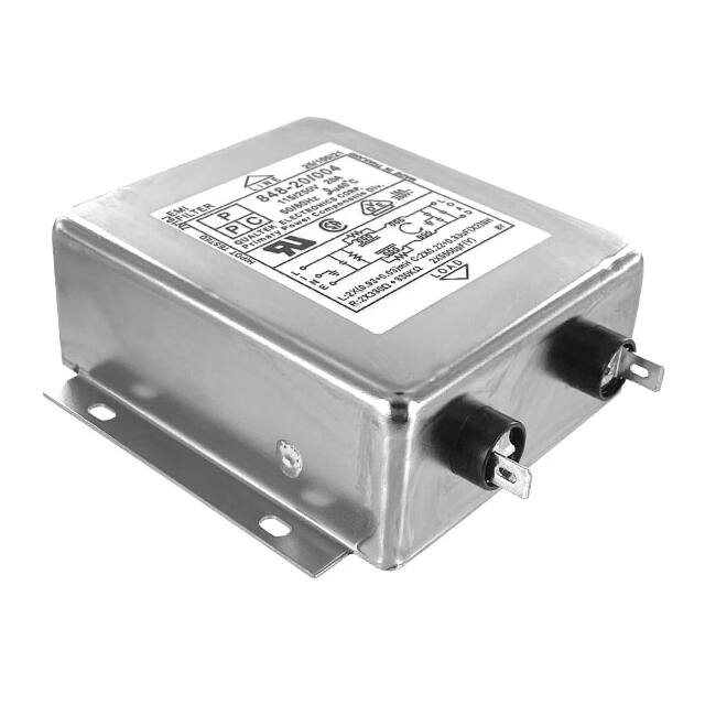

REVISION THESE DRAWINGS ARE THE PROPERTY OF QUALTEK ELECTRONICS AND NOT TO BE REPRODUCED FOR OR COMMUNICATED TO A THIRD PARTY WITHOUT THE EXPRESS WRITTEN PERMISSION OF AN OFFICER OF QUALTEK ELECTRONICS. REV. B DESCRIPTION DATE 06-01-06 RoHS Compliancy APPROVED DP ELECTRICAL CHARACTERISTICS: 1-1. VOLTAGE RATING...................................115/250VAC PHYSICAL DIMENSIONS: 3.75 ± 0.02 3.40 MAX. 4.14 MAX. 0.157 SLOTS: 0.255 6.5 X 4.0 (4) 1-2. CURRENT RATING A. @ 115 VAC..........................................20 A RMS MAX B. @ 250 VAC.........................................16 A RMS MAX 1-3. OPERATING FREQUENCY......................50/60Hz 1-4. LEAKAGE CURRENT: EACH LINE TO GROUND A. @ 115 VAC 60Hz............................0.45 mA MAX B. @ 250 VAC 50Hz.............................0.90 mA MAX 1-5. HIPOT RATING (FOR ONE MINUTE) A. LINE TO GROUND...........................2250 VDC B. LINE TO LINE.....................................1450 VDC 1-6. MINIMUM INSERTION LOSS IN dB: (AT 50 OHM SYSTEM) .01 .05 .10 .15 .50 1.0 5.0 10 30 COM. MODE dB 1 5 10 12 20 30 35 40 40 DIF. MODE dB 0 2 20 25 60 60 50 50 45 FREQ. MHz 2.00 ± 0.02 1.54 MAX. 5.25 MAX. SCHEMATIC: L1: L2: C1: C2: Cy: R1: R2: 30.0uH 0.93mH 0.22+033uF 0.22uF 3300+2200pF 330KΩ 330Ω 1-7. OPERATING TEMPERATURE.................-25° TO +85° C 1-8. SAFETY: 1-9. RoHS COMPLIANT Dim range (mm) Tolerance +/(mm) 0-1 0.15 1-6 0.20 6-18 0.30 18-50 0.50 CONTROLLED Qualtek Electronics Corp. Part Number: Description: PPC DIVISION 848-20/004 EMI FILTER UNIT: in REV. B 50-120 0.70 Drawn / Date Checked / Date Approved / Date 120-250 0.90 250-500 1.20 B.ZHANG 02-07-03 02-07-03 JJH / 02-07-03
