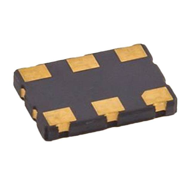

    有源晶振 3.3V 155.52MHz SMD-6
CL3225-155.520-3.3-25-X-T-TR 数据手册
ULTRA LOW JITTER LVDS CLOCK OSCILLATOR Page 1 of 4 CL3225-156.250-3.3-25-X-T-TR ◼ ELECTRICAL SPECIFICATION PARAMETER Nominal Frequency Supply Voltage Supply Current, max Operating Temperature Range Storage Temperature Range Output Logic Type SYMBOL fo VCC IS Ta T(stg) --- Overall Freq. Stability, Max. f/fo Output Voltage VOL VOH Output Load --- CONDITIONS Ta=25°C Vcc ±5% Vcc; Ta=+25C; --Absolute max Inclusive of 25°C Tolerance and Changes due to Operating Temperature, Supply Voltage, Load, Aging, Shock and Vibration Logic “0” Level Logic “1” Level Connected between Out and Complementary Out Pin 1: N.C. (Open) or High (0.7 x Vcc) Enable / Disable Function E/D Pin 1: Low (0.3 x Vcc) Symmetry (Duty Cycle) Rise Time and Fall Time Jitter, RMS, typ/max. ◼ DC tr / tf J @50% Wave form @20% to 80% Vdd 1, 12kHz < Fj < 20MHz MECHANICAL SPECIFICATION ◼ VALUE 156.200 3.3 40 -40 to +85 -55 to +125 LVDS UNIT MHz VDC mA C C ±25 ppm 0.9 Min 1.6 Max VDC VDC 100 Ω Pin 4 & 5 – Oscillation (Enabled) Pin 4 & 5 – High Impedance (Disabled) 45 to 55 % 1.0 ns 0.8/1.0 ps CARRIER TAPE DIMENSIONS NOTE: REFER TO EIA-481 FOR DIMENSIONS NOT LISTED ◼ PACKAGING 178 mm REEL DIAMETER 8 mm TAPE WIDTH, 4 mm PITCH QUANTITY: 3000 PIECES PER REEL Pin Connections 1 – Enable / Disable 2 – NC 3 – Ground 4 – Output 5 – Complimentary Output 6 – Vcc RALTRON ELECTRONICS ▪ 10400 N.W. 33rd Street ▪ Miami, Florida 33172 ▪ U.S.A. Telephone: +1-305-593-6033 ▪ Fax: +1-305-594-3973 ▪ e-mail: sales@raltron.com ▪ web: http://www.raltron.com ULTRA LOW JITTER LVDS CLOCK OSCILLATOR Page 2 of 4 CL3225-156.250-3.3-25-X-T-TR ◼ OUTPUT WAVEFORM ◼ PHASE NOISE RALTRON ELECTRONICS ▪ 10400 N.W. 33rd Street ▪ Miami, Florida 33172 ▪ U.S.A. Telephone: +1-305-593-6033 ▪ Fax: +1-305-594-3973 ▪ e-mail: sales@raltron.com ▪ web: http://www.raltron.com ULTRA LOW JITTER LVDS CLOCK OSCILLATOR Page 3 of 4 CL3225-156.250-3.3-25-X-T-TR ◼ REFLOW PROFILE tP TP Critical Zone TL to TP Ramp-up TL tL TSMAX Temp. [°C] TSMIN Ramp-down tS Preheat Time [sec] t[25°C] to Peak Reflow profile Temperature Min Preheat Temperature Max Preheat Time (TSMIN to TSMAX) Temperature Peak Temperature Ramp-up rate Ramp-down rate Time within 5°C of Peak Temperature Time t[25°C] to Peak Temperature Time ◼ TSMIN TSMAX tS TL TP RUP RDOWN tP t[25°C] to Peak tL 150°C 200°C 60-180 sec. 217°C 260°C 3°C/sec max. 6°C/sec max. 10 sec. 480 sec. 60-150 sec. ENVIRONMENTAL PARAMETER MOISTURE SENSITIVITY LEVEL RoHS REACH-SVHC HALOGEN-FREE TERMINATION FINISH VALUE 1 Compliant Compliant Compliant Au RALTRON ELECTRONICS ▪ 10400 N.W. 33rd Street ▪ Miami, Florida 33172 ▪ U.S.A. Telephone: +1-305-593-6033 ▪ Fax: +1-305-594-3973 ▪ e-mail: sales@raltron.com ▪ web: http://www.raltron.com ULTRA LOW JITTER LVDS CLOCK OSCILLATOR Page 4 of 4 CL3225-156.250-3.3-25-X-T-TR ◼ MARKING Rx156.2 •3AEyw x – Internal Production ID code y – Year code w – Week code YEAR CODE Year Code 2015 2016 2017 2018 2019 2020 2021 2022 2023 2024 2025 Week 5 6 7 8 9 0 1 2 3 4 5 ALPHA WEEK CODE TABLE Code Week Code Week 1 2 3 4 5 6 7 8 9 10 11 12 13 14 15 16 17 18 ◼ a b c d e f g h i j k l m n o p q r 19 20 21 22 23 24 25 26 27 28 29 30 31 32 33 34 35 36 s t u v w x y z A B C D E F G H I J 37 38 39 40 41 42 43 44 45 46 47 48 49 50 51 52 Code K L M N O P Q R S T U V W X Y Z APPROVAL RALTRON DRAWN BY: APPROVED BY: REVISION: AR, January 21, 2019 CP, January 21, 2019 A, Initial Release B, Updated the Current Revision Levels AR, May 21 ,2020 Raltron Electronics / RAMI Technology USA, LLC, including its affiliates, employees, agents and other persons acting on its behalf (collectively Raltron/RAMI Tech), disclaim any and all liability for any errors or inaccuracies contained in this data sheet. While Raltron/RAMI Tech has made every reasonable effort ensure the accuracy of all product information, specifications and data contained herein, Raltron/RAMI Tech does not guarantee that the information is accurate, reliable or current. The product information is provided only for reference purposes only and is subject to change, correction or revision, at any time without notice. Raltron/RAMI Tech does not assume any liability arising out of an application or use of any product described herein and disclaims any warranties expressed or implied. The user of products in such applications shall assume all risks of such use and will agree to hold Raltron/RAMI Tech, harmless against all damages. Copyright © 2016, Raltron Electronics / RAMI Technology USA, LLC. All rights reserved. No part of this document may be reproduced in any form without the prior written permission of Raltron Electronics / RAMI Technology USA, LLC. RALTRON ELECTRONICS ▪ 10400 N.W. 33rd Street ▪ Miami, Florida 33172 ▪ U.S.A. Telephone: +1-305-593-6033 ▪ Fax: +1-305-594-3973 ▪ e-mail: sales@raltron.com ▪ web: http://www.raltron.com
