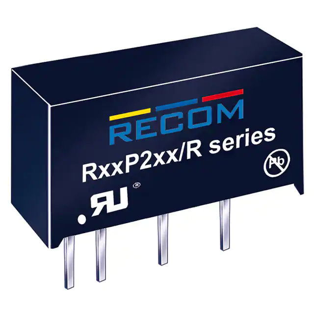

Features Unregulated Converters • Qualified with 65kV/µs @ Vcommon mode =1KV • IEC/EN61010 for test, measurement and lab use • IEC/EN60601 for medical applications • Reinforced isolation 6.4kVDC or 8kVDC • Optional continuous short circuit protection • Very low isolation capacitance • /X2 Option for >9mm input/output clearance DC/DC Converter RxxP2xx/R 2 Watt 3 SIP 7 Single and Dual Output Description YEA R The RxxP2xx/R Series of DC/DC Converters are certified to IEC/EN/UL/CSA-60950. This makes them ideal for safety applications where approved or reinforced isolation is required. These versions are also EN61010-1 certified for lab equipment. The /X2 version has an input/output clearance of more than 9mm. w 600 72 - 78 3300 5, 12, 15, 24 5 400 79 - 84 1200 RxxP209S/R (3,4,5) 5, 12, 15, 24 9 222 80 - 87 1200 5, 12, 15, 24 12 167 80 - 87 680 RxxP215S/R (3,4,5) 5, 12, 15, 24 15 133 80 - 88 680 (3,4,5) 5, 12, 15, 24 ±3.3 ±300 73 - 80 ±1500 RxxP205D/R (3,4,5) 5, 12, 15, 24 ±5 ±200 79 - 85 ±470 RxxP205S/R RxxP212S/R (3,4,5) RxxP23.3D/R 5, 12, 15, 24 ±9 ±111 80 - 87 ±470 RxxP212D/R (3,4,5) 5, 12, 15, 24 ±12 ±85 80 - 87 ±330 5, 12, 15, 24 ±15 ±66 80- 87 ±330 RxxP209D/R (3,4,5) M CONVER T 10 from 10 PL U D IA N T PRO M CONVER T S M O REACH compliant CO CO Notes: Note1: Efficiency is tested at nominal input and full load at +25°C ambient Note2: Max. Capacitive Load is defined as the capacitive load that will allow start up in under 1 second without damage to the converter C R S RoHS 2 + compliant E O R C E RE RxxP215D/R (3,4,5) M TS 3.3 C 5, 12, 15, 24 (3,4,5) TS RxxP23.3S/R (3,4,5) C nom. Input Output Output Efficiency max. Capacitive Voltage Voltage Current typ. (1) Load (2) [VDC] [VDC] [mA] [%] [µF] RE Selection Guide Part Number y arrant PL U D IA N T PRO E314885 Model Numbering UL/CSA60950-1 certified IEC/EN60950-1 certified UL/ES/CSA60601-1 certified IEC/EN60601-1 certified IEC/EN61010-1 certified CB report R__P2 __ _/P/X2/R Input Voltage “Reinforced Isolation (3)” Output Power “Pinout (4)” Output Voltage “Protection (5)” Single or Dual Notes: Note3: add suffix „/R6.4“ for 6.4kVDC/1second isolation or „/R8“ for 8kVDC/1second isolation Note4: add suffix „/X2“ for single output with alternative pinout Note5: add suffix „/P“ for continous short circuit protection Ordering Examples: R05P23.3S/R8/P = 5V Input, 3.3V Output, Single Output, 8kVDC/1s isolation, Continous Short Circuit Protection R24P205S/R6.4/P/X2 = 24V Input, 5V Output, Single Output, 6.4kVDC/1s isolation, Continous SCP, Alternative Pinout R12P205D/R8/X2 = ±12V Input, ±5V Output, Dual Output, 8kVDC/1s isolation, Alternative Pinout REF DESIGN available www.recom-power.com/eval-ref-boards www.recom-power.com REV.: 6/2020 dv/dt ADVISORY REPORT AVAILABLE www.recom-power.com/bier ECO-1 RxxP2xxS_D/R DC/DC Converter Series Specifications (measured at Ta= 25°C, nominal input voltage, full load) BASIC CHARACTERISTICS Parameter Condition Min. Typ. Input Voltage Range Max. ±10% Minimum Load Internal Operating Frequency Output Ripple and Noise 0% 20kHz (6) 50kHz 85kHz 20MHz BW 200mVp-p Notes: Note6: Measurements are made with a 0.1µF MLCC across output (low ESR) Efficiency vs. Load RxxP205S/R6.4 and RxxP205S/R8 100 90 90 80 80 70 70 Efficiency [%] Efficiency [%] 100 60 50 40 30 60 50 40 30 5Vin 12Vin 24Vin 20 10 0 RxxP205D/R6.4 and RxxP205D/R8 0 10 20 30 40 50 60 70 80 20 5Vin 12Vin 24Vin 10 0 90 100 0 10 20 30 Output Load [%] 40 50 60 70 80 90 100 Output Load [%] REGULATIONS Parameter Condition Value Output Accuracy ±5.0% max. Line Regulation low line to high line, full load 10% to 100% load Load Regulation (7) 1.2%/1% of Vin typ. 3.3Vout, 5Vout 9Vout, 12Vout, 15Vout 15.0% typ. 10.0% typ. Notes: Note7: Operation below 10% load won‘t harm the converter, but specifications may not be met Deviation vs. Load RxxP205S/R6.4 and RxxP205S/R8 30 30 25 5Vin 12Vin 24Vin 20 Deviation [%] Deviation [%] 25 15 10 5 0 5Vin 12Vin 24Vin 20 15 10 5 0 -5 -10 RxxP205D/R6.4 and RxxP205D/R8 -5 0 10 20 30 40 50 60 70 80 -10 90 100 Output Load [%] 0 10 20 30 40 50 60 70 80 90 100 Output Load [%] continued on next page www.recom-power.com REV.: 6/2020 ECO-2 RxxP2xx/R DC/DC Converter Series Specifications (measured at Ta= 25°C, nominal input voltage, full load) Output Voltage [%] Tolerance Envelope +10% +5% +5% Typical L o ad Line Vnom -1.5% -5% 10 50 100 Load [%] PROTECTIONS Parameter Type Short Circuit Protection (SCP) Isolation Voltage (8) Value without Suffix “/P” with Suffix “/P” tested for 1 second “/R6.4” “/R8” rated for 1 minute “/R6.4” “/R8” I/P to O/P Isolation Resistance Isolation Capacitance 1 second continuous 6.4kVDC 8kVDC 3.2kVAC/60Hz 4kVAC/60Hz 15GΩ min. 1.5pF min./10.0pF max. Leakage Current 4.8mm External clearance/creepage >4.8mm Means of Protection Notes: Note8: For repeat Hi-Pot testing, reduce the time and/or the test voltage ENVIRONMENTAL Parameter Operating Temperature Range Condition Value without derating @ natural convection 0.1m/s (see graph) Maximum Case Temperature +105°C Operating Altitude Operating Humidity -40°C to +85°C 3000m non-condensing 95% RH max. Pollution Degree MTBF PD2 according to MIL-HDBK-217F, G.B. +25°C +85°C 23429 x 10 hours 9818 x 103 hours 3 continued on next page www.recom-power.com REV.: 6/2020 ECO-3 RxxP2xxS_D/R DC/DC Converter Series Specifications (measured at Ta= 25°C, nominal input voltage, full load) Derating Graph (@ Chamber and natural convection 0.1m/s) 100 90 Output Load [%] 80 70 60 50 40 30 20 10 0 -40 -30 -20 -10 0 10 20 30 40 50 60 70 80 90 100 110 85 Ambient Temperature [°C] SAFETY AND CERTIFICATIONS Certificate Type (Safety) Report / File Number Information Technology Equipment, General Requirements for Safety LVD1605077-14 Information Technology Equipment, General Requirements for Safety 2236395 Information Technology Equipment, General Requirements for Safety 2207629 Medical Electric Equipment, General Requirements for Safety and Essential Performance Medical Electric Equipment, General Requirements for Safety and Essential Performance Medical Electric Equipment, General Requirements for Safety and Essential Performance. (CB Scheme) 2207629 E314885-A5-UL E314885-A5-CB-1 Medical Electric Equipment, General Requirements for Safety and Essential Performance Safety requirements for electrical equipement for measurement, control and laboratory use EAC WD-SE-R-180539-A0 T1301251-313 RU-AT.37.02367 RoHS 2 EMC Compliance Electromagnetic compatibility of multimedia equipment Emission requirements Standard EN60950-1: 2006 + A2:2013 IEC60950-1-2005 , 2nd Edition + A2:2013 ANSI/UL60950-1, 1st Edition CAN/CSA-C22.2 No. 60950-1 ANSI/UL60950-1, 1st Edition CAN/CSA C22.2 No. 60950-1 UL60601-1, 1st Edition CAN/CSA-C22.2 No. 601.1-M90 ANSI/AAMI ES60601-1:2005 +A2:10 CAN/CSA-C22.2 No. 60601-1:2008 IEC60601-1:2005 + C2:2007 EN60601-1:2006 + A12:2014 IEC60601-1:2005 + A1:2012, 3rd Edition EN61010:2010 IEC61010:2010, 3rd Edition TP TC 004/2011 RoHS-2011/65/EU + AM-2015/863 Condition Standard / Criterion with external filter (refer to “EMC Filtering”) EN55032, Class A and B continued on next page www.recom-power.com REV.: 6/2020 ECO-4 RxxP2xxS_D/R DC/DC Converter Series Specifications (measured at Ta= 25°C, nominal input voltage, full load) EMC Filtering Suggestion according to EN55032 Class A and Class B Single Output Dual Output C3 +Vin L1 +Vout +Vin C2 C1 -Vin L1 +Vout +Vout +Vout -Vout -Vout -Vout +Vout +Vinin C1 -Vin C3 L1 +V +Vin C2 -Vout -Vin +Vin C3 C2 +Vin ComC2 C1 -Vout -V -Vin -Vinin +Vout Com -Vin C1 L1 C3 C1 10µF 100V MLCC 3.9µH choke WE 744 045 0039 470pF C2 10µF 100V MLCC 2.2µF 100V MLCC L1 C3 12µH choke WE 744 045 120 470pF DIMENSION AND PHYSICAL CHARACTERISTICS Parameter Type Value Material case potting PCB non-conductive black plastic, (UL94 V-0) silicon rubber compound, (UL94 V-0) FR4, (UL94 V-0) Dimension (LxWxH) 19.5 x 9.8 x 12.5mm Weight 4.3g typ. Dimension Drawing (mm) embossed logo 9.8 12.5 19.5 Marking 0.25±0.05 4.10 0.50+0.10/-0.05 Recommended Footprint Details 5 6 7 1 2 2.54 1 2 2.4 Bottom View 3x2.54= 7.62 1.9 Pin Connection Pin # Single 1 +Vin 2 -Vin 5 -Vout 6 No Pin 7 +Vout Dual +Vin -Vin -Vout Com +Vout /X2 +Vin -Vin No Pin -Vout +Vout Tolerance: xx.x= ±0.5mm xx.xx= ±0.25mm 5 6 7 Top View 2.54 6x2.54= 15.24 PACKAGING INFORMATION Parameter Type Value Packaging Dimension (LxWxH) tube 520.0 x 22.3 x 12.0mm Packaging Quantity tube 25pcs Storage Temperature Range - 55°C to +125°C Storage Humidity 95% RH max. The product information and specifications may be subject to changes even without prior written notice.The product has been designed for various applications; its suitability lies in the responsibility of each customer. The products are not authorized for use in safety-critical applications without RECOM’s explicit written consent. A safety-critical application is an application where a failure may reasonably be expected to endanger or cause loss of life, inflict bodily harm or damage property. The applicant shall indemnify and hold harmless RECOM, its affiliated companies and its representatives against any damage claims in connection with the unauthorized use of RECOM products in such safety-critical applications. www.recom-power.com REV.: 6/2020 +Vout Com -Vout -Vout Component List Class B Component List Class A 0.51 L1 C3 ECO-5
R15P215S/R8
1. 物料型号:RxxP2xx/R系列,包括多种型号,如RxxP23.3S/R, RxxP205S/R等,具有不同的输入电压、输出电压和输出电流规格。
2. 器件简介:这些转换器符合IEC/EN/UL/CSA-60950标准,适用于需要批准或加强隔离的安全应用,也符合EN61010-1标准,适用于实验室设备。
3. 引脚分配:文档提供了详细的引脚分配图和说明,包括单输出和双输出型号的引脚配置。
4. 参数特性:包括输入电压范围、最小负载、内部工作频率、输出纹波和噪声等。
5. 功能详解:文档详细描述了转换器的效率与负载的关系、输出精度、线路调整率、负载调整率等。
6. 应用信息:适用于信息技术设备、医疗电气设备、测量、控制和实验室用途的电气设备。
7. 封装信息:提供了转换器的尺寸、重量、材料和包装信息。
8. 安全和认证:包括EN60950-1、IEC60601-1、EN61010等安全标准认证。
9. 电磁兼容性:提供了符合EN55032 Class A和Class B的EMC过滤建议。
10. 环境规格:包括工作温度范围、最大外壳温度、工作高度、工作湿度、污染等级和MTBF。
