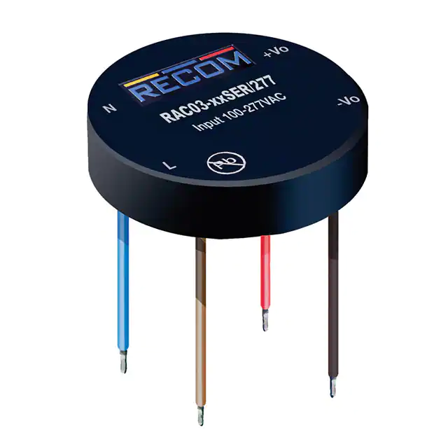

    RAC03-SER/277系列是具有3kVAC隔离和超宽输入电压范围的调节型AC/DC转换器。适用于楼宇自动化、安全系统和通信系统等多种应用。
RAC03-3.3SER/277-TRAY 数据手册
Features • 40mW max. no load power consumption • High efficiency up to 76% • Isolated output 3kVAC / 1 min • SCP, OVP protection • Wide operating temperature range: -40°C to +85°C • Universal input 85-305VAC Regulated Converter Description The modules of the RAC03-SER/277 series are regulated AC/DC converters with 3kVAC isolation and a round, flat shape. This series has been designed to offer low stand-by consumption and an ultra-wide input voltage range. Uses include a variety of applications in building automation, security systems and communication systems. AC/DC Converter RAC RAC03-SER/277 3 Watt Single Output Selection Guide Part Input Output Output Efficiency Max. Capacitive Number Voltage Range Voltage Current typ (1) Load (2) [VAC] [VDC] [mA] [%] [µF] RAC03-3.3SER/277 100-277 3.3 900 68 22000 RAC03-05SER/277 100-277 5 600 70 7500 RAC03-12SER/277 100-277 12 250 74 1000 RAC03-24SER/277 100-277 24 125 76 200 Notes: Note1: Efficiency is tested at nominal input and full load at +25°C ambient Note2: Max Cap Load is tested at nominal input and full resisitive load Model Numbering RAC03-__ SER/277-_ E224736 Packaging (3) nom. Output Power Single Output Voltage Notes: Note3: add suffix “-TRAY” for Tray packaging, without suffix standard cardboard box packaging Ordering Examples: RAC03-05SER/277 RAC03-12SER/277 RAC03-05SER/277-TRAY www.recom-power.com 3 Watt 3 Watt 3 Watt 5Vout 12Vout 5Vout Single Output Single Output Single Output cardboard box cardboard box tray packaging REV.: 8/2018 UL60950-1 certified CAN/CSA-22.2 No. 60950 certified EN60335-1 certified IEC/EN60950-1 certified CB Report EN55032 certified EN55024 certified EN55014 certified PA-1 RAC03-SER/277 AC/DC Converter Series Specifications (measured @ Ta= 25°C, nom. Vin (115/230VAC), full load and after warm-up unless otherwise stated) BASIC CHARACTERISTICS Parameter Input Voltage Range (4) Condition Min. Typ. Max. nom. Vin= 230VAC 85VAC 120VDC 277VAC 305VAC 430VDC 115VAC 230VAC Input Current Inrush Current 70mA 45mA 115VAC 230VAC cold start at +25°C No load Power Consumption 15A 30A 85-305VAC/ 47-440Hz Input Frequency Range 40mW AC Input 47Hz Minimum Load (7) Hold-up Time 115VAC Internal Operating Frequency Output Ripple and Noise 440Hz 10% 18ms 100% load at nominal Vin 3.3Vout all others (5) 55kHz 250mVp-p 200mVp-p Notes: Note4: No line derating required Note5: Ripple and Noise is the maximum peak-to-peak voltage value measured at the output with a 20MHz bandwidth, at rated line voltage at full load. And with a 47µF low-ESR electrolytic capacitor in parallel with a 0.1µF ceramic capacitor across output Efficiency vs. Load RAC03-05SER/277 100 90 Efficiency [%] 80 70 60 50 40 30 115VAC 230VAC 277VAC 20 10 0 0 10 20 30 40 50 60 70 80 90 100 Output Load [%] REGULATIONS Parameter Condition Output Voltage Tolerance (6) Line Regulation Load Regulation (7) Value 3.3Vout 5Vout 12, 24Vout low line to high line, full load 10% to 100% load 3.3Vout 5Vout 12, 24Vout ±4.0% typ. / ±8.0% max. ±3.5% typ. / ±5.0% max. ±3.0% typ. / ±4.0% max. ±0.7% typ. / ±1.0% max. 5.5% typ. / 9.0% max. 5.0% typ. / 7.5% max. 4.0% typ. / 5.5% max. Notes: Note6: Includes initial voltage accuracy, thermal drift, line regulation and load regulation at rated input voltage and load conditions Note7: Operation below 10% load will not harm the converter, but specifications may not be met www.recom-power.com REV.: 8/2018 PA-2 RAC03-SER/277 AC/DC Converter Series Specifications (measured @ Ta= 25°C, nom. Vin (115/230VAC), full load and after warm-up unless otherwise stated) PROTECTIONS Parameter Type Value Short Circuit Protection (SCP) continuous, automatic recovery Over Voltage Protection (OVP) zener diode clamp 105% - 150% Over Current Limit 120% - 190% Over Voltage Category OVCII Isolation Voltage Isolation Resistance I/P to O/P tested for 1 minute 3kVAC 1GΩ min. Leakage Current 85-305VAC, 47-440Hz 10µA max. Notes: Note8: Refer to local wiring regulations if input over-current protection is also required. Recommended fuse: slow blow type L N FUSE +Vout -Vout ENVIRONMENTAL Parameter Condition Operating Temperature Range (9) Value full load -40°C to +75°C refer to derating graph -40°C to +85°C Maximum Case Temperature +105°C Thermal Impedance 9.5K/W typ. Operating Humidity non-condensing MTBF 5% - 95% RH max. according to MIL-HDBK-217F, G.B. 3554 x 103 hours 3219 x 103 hours +25°C Notes: Note9: At low input voltage (85-140VAC) and temperature below -25°C the RAC03-3.3SER/277 and RAC03-05SER/277, will not start Derating Graph @ 140-305VAC 100 100 90 90 80 80 70 70 Output Load [%] Output Load [%] @ 85-140VAC 60 50 40 30 40 all models 20 10 0 -40 50 30 3.3V and 5V all other models 20 60 10 -20 -25 www.recom-power.com 0 20 40 60 80 100 75 85 120 Ambient Temperature [°C] 0 -40 -20 0 20 40 60 80 100 75 85 120 Ambient Temperature [°C] REV.: 8/2018 PA-3 RAC03-SER/277 AC/DC Converter Series Specifications (measured @ Ta= 25°C, nom. Vin (115/230VAC), full load and after warm-up unless otherwise stated) SAFETY AND CERTIFICATIONS Certificate Type (Safety) Report / File Number Standard IEC60950-1:2005 2nd Edition + A2:2013 EN60950-1:2006 + A2:2013 Information Technology Equipment, General Requirements for Safety (CB Scheme) L0339L26-CB-1-B4 Information Technology Equipment, General Requirements for Safety E224736-A24-UL UL No. 60950-1, 2nd Edition, 2014 CAN/CSA-C22.2 No. 60950-1-07, 2nd Edition, 2014 Household and similar electrical appliances, General requirements L0339L26-B2-L EN60335-1:2012+A11:2014 EAC Safety of Low Voltage Equipment RU-AT.37.02367 TP TC 004/2011 RoHS2+ RoHS-2011/65/EU + AM-2015/863 EMC Compliance (Industrial) Condition Information technology equipment - Radio disturbance characteristics - Limits and methods of measurement EN55032:2015, Class B Information technology equipment - Immunity characteristics Limits and methods of measurement ESD Electrostatic discharge immunity test EN55024:2010 ±8kV air, ±4kV contact Radiated, radio-frequency, electromagnetic field immunity test Fast Transient and Burst Immunity 3V/m EN61000-4-4:2012, Criteria A 50Hz, 1A/m EN61000-4-8:2010, Criteria A EN61000-4-11:2004, Criteria A EN61000-4-11:2004, Criteria A EN61000-4-11:2004, Criteria B Voltage Dips: >95% reduction >30% reduction Interruption: >95% Limits of Voltage Fluctuations & Flicker EN61000-3-3:2013 EMC Compliance (Household) Condition Electromagnetic compatibility of multimedia equipment – Emission Requirements Fast Transient and Burst Immunity Surge Immunity Immunity to conducted disturbances, induced by radio-frequency fields Voltage Dips and Interruption Standard / Criterion EN55014-1:2006+A2:2011 Information technology equipment - Immunity characteristics Limits and methods of measurement ESD Electrostatic discharge immunity test Radiated, radio-frequency, electromagnetic field immunity test EN61000-4-2:2009, Criteria B EN61000-4-3:2006 + A2:2010, Criteria A AC Power Port: ±1kV Power Magnetic Field Immunity Voltage Dips and Interruption Standard / Criterion EN55014-2:2015 ±8kV Air, ±4kV Contact 3V/m IEC61000-4-2:2008, Criteria A IEC61000-4-3:2006 + A2:2010, Criteria A AC Power Port +/-1.0kV DC Output +/-0.5kV IEC61000-4-4:2012, Criteria A AC Power Port L-N +/-2kV DC Output L-N +/-1kV IEC61000-4-5:2014, Criteria B AC Power Port 3V, DC Output 3V IEC61000-4-6:2013, Criteria A Voltage Dips: >95% reduction >30% reduction Interruption: >95% IEC61000-4-11:2004, Criteria B IEC61000-4-11:2004, Criteria C IEC61000-4-11:2004, Criteria C Limits of Harmonic Current Emissions EN61000-3-2:2014 Limits of Voltage Fluctuations & Flicker EN61000-3-3:2013 DIMENSION AND PHYSICAL CHARACTERISTICS Parameter Type Value Material case potting black plastic, (UL94V-0) epoxy, (UL94V-0) Dimension (LxWxH) 50.3 x 50.3 x 11.0mm Weight 41g typ. continued on next page www.recom-power.com REV.: 8/2018 PA-4 RAC03-SER/277 AC/DC Converter Series Specifications (measured @ Ta= 25°C, nom. Vin (115/230VAC), full load and after warm-up unless otherwise stated) Top View 6.0 Dimension Drawing (mm) 31.5 Wired information tc N # 1 2 3 4 V+ (Blue) embossed logo (Red) V- L (Black) (Brown) Function VAC in (L) VAC in (N) +Vout -Vout Wire color brown blue red black Type UL-1015 UL-1015 UL-1430 UL-1430 AWG 22 22 22 22 tc= case temperature measuring point Tolerance: xx.x= ±0.5mm xx.xx= ±0.35mm Ø2.40 Ø1.56 10±2 94.0 ±5 11.0 embossed logo max. 0.1 height Ø0.76 Ø0.76 Bottom View 1 0.3 Ø5 2 4 3 PACKAGING INFORMATION Parameter Type Value Packaging Dimension (LxWxH) cardboard box tray 195.0 x 170.0 x 140.0mm 462.0 x 292.0 x 49.0mm Packaging Quantity cardboard box tray 12pcs 72pcs Storage Temperature Range -40°C to +85°C The product information and specifications may be subject to changes even without prior written notice.The product has been designed for various applications; its suitability lies in the responsibility of each customer. The products are not authorized for use in safety-critical applications without RECOM’s explicit written consent. A safety-critical application is an application where a failure may reasonably be expected to endanger or cause loss of life, inflict bodily harm or damage property. The applicant shall indemnify and hold harmless RECOM, its affiliated companies and its representatives against any damage claims in connection with the unauthorized use of RECOM products in such safety-critical applications. www.recom-power.com REV.: 8/2018 PA-5
