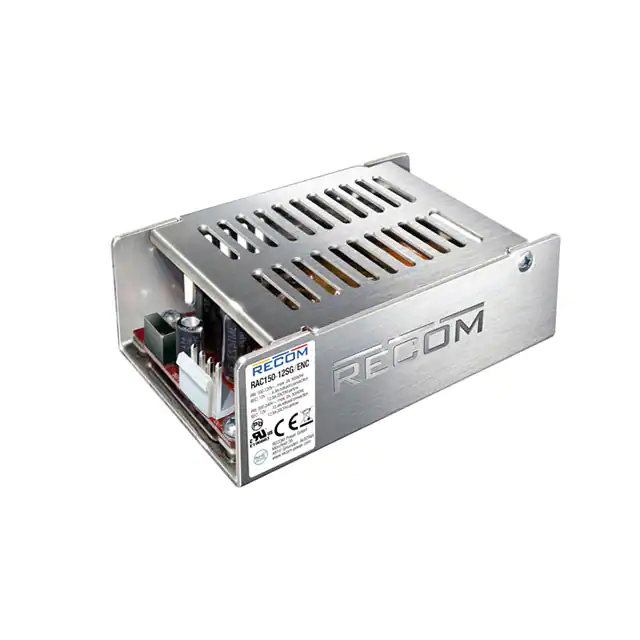

    RAC150-G系列AC/DC转换器具有90-264VAC的通用输入范围,适用于全球使用。它们可以提供高达125W的功率,并且在自然空气对流下适用于空间紧凑、低气流环境。该系列产品通过了UL和CE认证...
RAC150-48SG/OF 数据手册
• Universal input 90-264VAC • Efficiency 91% • Short circuit and over voltage protected • Active PFC function, PF>0.95 • Power indicator LED • UL, CE marked (CB report) • Conformal coated product • RECOM connector set available Features Regulated Converter AC/DC Converter RAC RAC150-G Description 150 Watt 3 4“ x 2“ Open Frame or Enclosed Case YEA R y arrant w The RAC150 series are cost-efficient 150 Watt AC/DC power supplies in a standard 2”x4” footprint with a universal input range of 90-264VAC for worldwide usage. They are built to deliver up to 125 Watt with natural air convection for use in tight, space-critical housings with low available airflow. UL and CE marks with CB-reports include the new 62368 safety standard as well as the usual 60950 safety standard. The RAC150 series offers tightly regulated 12V, 24V and 48VDC outputs with 3kVAC isolation and Class B EMC certifications and come with a three year warranty. Selection Guide Part Input Output max. Output Efficiency Max. Capacitive Number Voltage Range Voltage Current (1) typ (2) Load (3) [VAC] [VDC] [mA] [%] [µF] RAC150-12SG (4) 90-264 12 12500 91 2000 RAC150-24SG (4) 90-264 24 6250 91 1000 RAC150-48SG (4) 90-264 48 3125 91 500 Notes: Note1: With forced air cooling, refer to derating graph Note2: Typ. efficiency is tested @ 230VAC and full load Note3: Max. cap load is tested @ 90-264VAC and full resistive load Model Numbering RAC150-__SG/_ T CONVER T REACH TS compliant M C TS M S C O R 10 from 10 PL U D IA N T PRO C E RE CONVER CO RAC150-24SG/OF RAC150-12SG/ENC PL U D IA N T PRO E196683 24Vout 12Vout Single Single open frame version enclosed version Specifications (measured @ Ta= 25°C, nom. Vin and full load unless otherwise stated) BASIC CHARACTERISTICS Condition Min. Typ. Max. with forced cooling 90-264VAC 150W natural convection 230VAC 115VAC 125W 120W UL62368-1 certified CAN/CSA C22.2 No. 62368-1-14 certified UL60950 certified CAN/CSA C22.2 N.60950-1-07 certified IEC/EN60950-1 certified EN55032/55024 FCC Part 15 CB Report refer to “Derating Graph” 90-115VAC Internal Input Filter Pi type Input Voltage Range 90VAC 230VAC Input Current Inrush Current M S CO M Ordering Examples: Output Power O RoHS 2 + compliant Notes: Note4: add suffix “OF” for open frame version add suffix “ENC” for enclosed version Parameter C R RE “Case Option (4)” E Output Voltage Single 264VAC 2A cold start at 25°C 115VAC 230VAC 40A 60A continued on next page www.recom-power.com REV.: 5/2019 PA-1 RAC150-G AC/DC Converter Series Specifications (measured @ Ta= 25°C, nom. Vin, full load and after warm-up unless otherwise stated) BASIC CHARACTERISTICS Parameter Condition Min. Input Frequency Range Typ. 47Hz Minimum Load 63Hz 0% 115VAC 230VAC Power Factor Rise Time 0.98 0.95 115VAC/230VAC 115VAC 230VAC Hold-up Time 50ms 100% load 50% load 6ms 20ms Internal Operating Frequency 132kHz Output Ripple and Noise -30°C Efficiency vs. Load RAC150-12SG RAC150-24SG 100 90 90 80 80 70 70 Efficiency [%] 100 60 50 90VAC 115VAC 230VAC 264VAC 40 30 60 50 30 20 10 10 0 10 20 30 40 50 60 70 80 90VAC 115VAC 230VAC 264VAC 40 20 0 150mVp-p 240mVp-p 360mVp-p 300mVp-p 480mVp-p 720mVp-p 12Vout 24Vout 48Vout 12Vout 24Vout 48Vout +70°C Efficiency [%] Max. 90 0 100 0 10 20 Output Load [%] 30 40 50 60 70 80 90 100 Output Load [%] Efficiency vs. Input Voltage Recommended Line Derating 95% EN61000-4-11:2004, Criteria B EN61000-4-11:2004, Criteria C EN61000-4-11:2004, Criteria C Limits of Harmonic Current Emissions EN61000-3-2:2014, Criteria A Limits of Voltage Fluctuations & Flicker EN61000-3-3:2013 DIMENSIONS and PHYSICAL CHARACTERISTICS Parameter Material Type PCB case/baseplate Value FR4 (UL94-V0) aluminium Dimension (LxWxH) OF -version ENC-version 101.6 x 50.8 x 30.0mm 105.0 x 62.0 x 35.0mm Weight OF -version ENC-version 200.0g 265.0g continued on next page www.recom-power.com REV.: 5/2019 PA-5 RAC150-G AC/DC Converter Series Specifications (measured @ Ta= 25°C, nom. Vin and full load unless otherwise stated) Dimension Drawing Open Frame (mm) 101.6 CN2 Top View 1 2 3 4 50.8 4- Ø3.2 1 CN1 3 Connections AC Input (CN1) Customer Application Pin # Terminal 1 AC/L 3 AC/N 3 Pins (Pin2 removed) with 3.96mm pitch DC Output Connector (CN2) 30.0 max. Side View Pin # Terminal 1,2 V3,4 V+ 4 Pins with 3.96mm pitch 3.2 PCB thickness=1.6mm 6.5 ±1.0 FC = fixing centers Crimp Terminal AWG Range: 18-22AWG Tolerance: xx.x= ±1.0mm xx.xx= ±0.5mm Compatible Connectors Housing Landwin 3960S Series JST VHR Molex 51144 Series FC 44.5 Crimp Terminal Bottom View 3.5 Landwin 3963T011R JST SVH-21T-P1.1 Molex 50539 FC 95.3 continued on next page www.recom-power.com REV.: 5/2019 PA-6 RAC150-G AC/DC Converter Series Specifications (measured @ Ta= 25°C, nom. Vin and full load unless otherwise stated) Dimension Drawing Enclosed Case (mm) 1 CN2 2 3 4 Top View 1 62.0 105.0 CN1 3 Connections AC Input (CN1) Pin # Terminal 1 AC/L 3 AC/N 3 Pins (Pin2 removed) with 3.96mm pitch DC Output Connector (CN2) 35.0 Side View Terminal 1,2 V3,4 V+ 4 Pins with 3.96mm pitch FC = fixing centers Crimp Terminal AWG Range: 18-22AWG Tolerance: xx.x= ±1.0mm xx.xx= ±0.5mm 8.7 embossed logo Pin # Compatible Connectors Housing 2- Ø3.2 FC 44.45 Landwin 3960S Series JST VHR Molex 51144 Series Bottom View Crimp Terminal Landwin 3963T011R JST SVH-21T-P1.1 Molex 50539 4.8 FC 95.25 continued on next page www.recom-power.com REV.: 5/2019 PA-7 RAC150-G AC/DC Converter Series Specifications (measured @ Ta= 25°C, nom. Vin and full load unless otherwise stated) APPLICATION and INSTALLATION Mounting horizontal (standard) horizontal (standard) airflow airflow DC DC airflow airflow horizontal (standard) horizontal (standard) DC DC If module is mounted vertical or upside-down with natural convection cooling, the power must be derated ≥ 10%. vertical vertical DCDC vertical vertical airflow airflow airflow airflow ACAC ACAC DCDC AC AC AC AC upside-down upside-down upside-down upside-down AC AC DC DC airflow airflow AC AC DC DC airflow airflow Block Diagram L N PE T3.5AL Input Filter Rectifier PFC Controller Active PFC Transformer LLC Power Stage Active Rectification Output Filter +V -V Regulation SCP LLC Controller OVP PACKAGING INFORMATION Parameter Packaging Dimension (LxWxH) Type cardboard box Packaging Quantity 1pcs Storage Temperature Range Storage Humidity Value 112.0 x 80.0 x 50.0mm -40°C to +85°C non-condensing 10% - 95% RH The product information and specifications may be subject to changes even without prior written notice.The product has been designed for various applications; its suitability lies in the responsibility of each customer. The products are not authorized for use in safety-critical applications without RECOM’s explicit written consent. A safety-critical application is an application where a failure may reasonably be expected to endanger or cause loss of life, inflict bodily harm or damage property. The applicant shall indemnify and hold harmless RECOM, its affiliated companies and its representatives against any damage claims in connection with the unauthorized use of RECOM products in such safety-critical applications. www.recom-power.com REV.: 5/2019 PA-8
