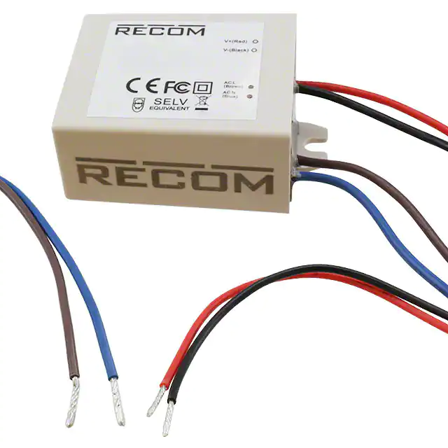

• 7W Class II AC-DC LED power supply • Suitable for high brightness LED • 250mA, 350mA, 500mA and 680mA constant current operation • 3.75kVAC isolation • Fused input and SCP, OCP, OVP, OLP • IP67 rated Features Constant Current LED Driver Description The RACD07 is a constant current 7W AC/DC source for LED lighting with a wide input voltage range. The LED drivers are available with constant current outputs of 250mA, 350mA, 500mA or 680mA. The series is IP67 rated and suitable for use in dry, damp or wet areas. RACD07 drivers have a 3 year warranty. Selection Guide Part Number Input Constant Current (1) Voltage Range Mode [VAC] [VDC] [mA] RACD07-250 90-295 RACD07-350 RACD07-500 RACD07-700 Efficiency min. [%] AC/DC Converter RACD07 7 Watt Constant Current Single Output Rated Power max. [W] 14-28 250 75 7 90-295 10-20 350 70 7.3 90-295 5-14.5 500 70 7.2 90-295 3-10.5 680 70 7.1 All LED Drivers may not be used without a load. They must be switched on the primary side only. Noncompliance may damage the LED or reduce its lifetime. Notes: Note1: Constant current operation region is within 75%-100% rated output voltage. This is the suitable operation region for LED related applications, but please reconfirm special electrical requirements for some specific system design. Model Numbering E340696 RACD07-___ nom. Output Power nom. Output Current Specifications (measured @ ta= 25°C and 115/230VAC) BASIC CHARACTERISTICS Parameter Condition Input Voltage Range Min. Typ. 90VAC 230VAC 120VDC Max. 295VAC 415VDC Input Current full load, 100VAC 200mA Inrush Current 230VAC 10A No Load Power Consumption 230VAC 0.5W Input Frequency Range 47Hz Power Factor 0.50 63Hz Start-up Time 1s Hold-up Time Set-up Time 18ms full load, 230VAC Internal Operating Frequency Output Ripple Current (2) UL8750 certified UL1310 certified CSA-C22.2 No. 223-M91 certified CSA-C22.2 No. 250.13-12 certified IEC/EN61347 certified IEC/EN61347-2-13 certified EN55015 compliant EN61547 compliant EAC 0.5s 45kHz 20MHz BW 30mAp-p Notes: Note2: Measured with a 12“ twisted pair-wire terminated with 0.1µF & 47µF parallel capacitor continued on next page www.recom-power.com REV.: 4/2019 L-1 RACD07 AC/DC Converter Series Specifications (measured @ ta= 25°C and 115/230VAC) Input Voltage vs. Load 100 90 Output Load [%] 80 70 60 50 40 30 20 10 0 80 90 100 120 140 160 180 200 220 240 295 Input Voltage [VAC] REGULATIONS Parameter Condition Output Voltage Accuracy Value includes: line, load and tolerance ±5% Output Current Accuracy ±3% typ. / ±7% max. PROTECTION Parameter Condition Value Internal Input Fuse T1A, slow blow Hiccup Mode, auto recovery after fault condition is removed Short Circuit Protection (SCP) Overload Protection (OLP) 105% - 120% typ. Over Current Protection (OCP) Constant current mode protection Isolation Voltage I/P to O/P 3.75kVAC / 1 minute Isolation Resistance 500VDC 100MW min. Notes: Note3: Refer to local wiring regulations if input over-current protection is also required Maximum loading of automatic circuit breakers* * @ 115VAC, 1Ohm, 90° phase angle and max. load Circuit Breaker Circuit Breaker Current * @ 230VAC, 1Ohm, 90° phase angle and max. load Circuit Breaker Circuit Breaker Current * @ 277VAC, 1Ohm, 90° phase angle and max. load Circuit Breaker Circuit Breaker Current Typ 10A 16A 20A 25A Typ 10A 16A 20A 25A Typ 10A 16A 20A 25A C 101 128 171 228 B 61 100 121 150 B 70 115 139 172 C 121 164 221 291 C 139 188 254 334 ENVIRONMENTAL Parameter Operating Temperature Range Condition -20°C to +50°C non condensing 20% - 90% RH Max. Case Temperature Operating Humidity +85°C IP Rating Vibration Design Lifetime MTBF Value @ natural convection 0.1m/s, full load IP67 10-500Hz, 2G; 10 minute/cycle 1 cycle period for 60 min each along X, Y and Z axes +25°C ambient 70 x 103 hours according to MIL-HDBK-217F, G.B. +25°C 200 x 10³ hours continued on next page www.recom-power.com REV.: 4/2019 L-2 RACD07 AC/DC Converter Series Specifications (measured @ ta= 25°C and 115/230VAC) Derating Graph (@ natural air convection 0.1m/s) 100 90 Output Load [%] 80 70 60 50 40 30 20 10 0 -20 -10 0 10 20 30 40 50 60 Ambient Temperature [°C] SAFETY AND CERTIFICATIONS Certificate Type (Safety) Report Number Standard for LED Equipment for use in Lighting Products UL8750, 1st Edition, 2009 Standard for Class 2 Power Units UL1310, 6th Edition, 2011 E340696-1-7 LED Equipment for Lighting Applications Canadian Standard for Powr Supplies with Extra-Low-Voltage Class 2 Outputs CSA C22.2 No. 223-M91 Safety of control gear for LED modules PSE102-0283 Safety requirements for lamp controlgear RoHS2 RU Д- AT.AB49.B.09571 EAC EMC Compliance Condition Limits and methods of measurement of radio disturbance characteristics of electrical lighting and similar equipment TP TC 004/2011 Standard / Criterion EN61547:2009 Information technology equipment - Radio disturbance characteristics - Limits and methods of measurement CISPR22, 3rd Edition, 1997, Class B Radio Frequency Devices, Subpart B - Unintentional Radiators 47 CFR, FCC Part 15 Subpart B, Class B Methods of Measurement of Radio-Noise Emissions from Low-Voltage Electrical and Electronic Equipment in the Range of 9 kHz to 40 GHz ANSI C63.4:2009 Alternating Current High Voltage Power Systems Radiated, radio-frequency, electromagnetic field immunity test IEC/EN61347-2-13, 2nd Edition 2014 IEC61347-1, 3rd Edition, 2015 EN61347-1:2015 RoHS-2011/65/EU + AM-2015/863 EN55015:2013 + A1:2015, Class B Equipment for general lighting purposes – EMC immunity requirements ESD Electrostatic discharge immunity test CSA-C22.2 No. 250.13-12 Canadian ICES-003 issue 4, 2004 ±8, 4, 2kV Air Discharge, ±4, 2 kV Contact Discharge 3V/m IEC61000-4-2:2008 Criteria A IEC61000-4-3:2006 + A2:2010 Criteria A Fast Transient and Burst Immunity ±0.5, ±1kV AC Input ±0.5kV DC Output IEC61000-4-4:2012, Criteria A Surge Immunity ±0.5, ±1kV AC Input IEC61000-4-5:2014, Criteria A Immunity to conducted disturbances, induced by radio-frequency fields AC and DC Port: 3V IEC61000-4-6:2013, Criteria A 3A/m at 50/60Hz IEC61000-4-8:2009, Criteria A Power Frequency Magnetic Field Immunity Voltage Dips and Interruptions Dips: >95% IEC61000-4-11:2004 Criteria B Dips: 30% IEC61000-4-11:2004 Criteria B Limits for harmonic current emissions IEC61000-3-2, 2014 Limitation of voltage fluctuations/flicker in low-voltage systems IEC61000-3-3, 2013 www.recom-power.com REV.: 4/2019 L-3 RACD07 AC/DC Converter Series Specifications (measured @ ta= 25°C and 115/230VAC) DIMENSION and PHYSICAL CHARACTERISTICS Parameter Type Value Material case potting plastic (UL94V-2) silicone (UL94V-0) Dimension (LxWxH) 57.0 x 40.8 x 24.0mm Weight 75g Dimensions Drawing (mm) 57.0 Wired Connection # Function Wire Color 1 VAC in (L) brown 2 VAC in (N) blue 3 LED+ red 4 LED- black 3 4 4.0 15.3 tc Type UL-1007, AWG18 UL-1007, AWG18 UL-1007, AWG18 UL-1007, AWG18 tc= case temperature measuring point FC = fixing centers Tolerance: x x.x= ±0.5mm 1 2 PRI 39.2 11.0 150±10 SEC 17.0 49.0 FC 4.5 2.0 24.0 22.2 40.8 INSTALLATION and APPLICATION Connection L N LED+ LED- PACKAGING INFORMATION Parameter Packaging Dimension (LxWxH) Type cardboard box 25pcs Packaging Quantity Storage Temperature Range Storage Humidity Value 286.0 x 201.0 x 88.0mm -40°C to +85°C non condensing 10% - 90% RH The product information and specifications may be subject to changes even without prior written notice.The product has been designed for various applications; its suitability lies in the responsibility of each customer. The products are not authorized for use in safety-critical applications without RECOM’s explicit written consent. A safety-critical application is an application where a failure may reasonably be expected to endanger or cause loss of life, inflict bodily harm or damage property. The applicant shall indemnify and hold harmless RECOM, its affiliated companies and its representatives against any damage claims in connection with the unauthorized use of RECOM products in such safety-critical applications. www.recom-power.com REV.: 4/2019 L-4
