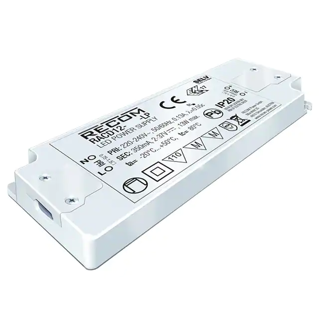

Features • Low profile case (13mm height max.) • 350mA to 700mA constant current outputs • Terminal block input/output with cable clamps LED Driver AC/DC Converter • Fully protected (OLP, SCP, OCP, OTP) • Low standby power, ErP conform RACD12-LP • Low cost Description These low profile constant current LED drivers have been designed for cost-sensitive applications. The SELV outputs are suitable for both independently supplied or built-in power-supply LED luminaires. Their low profile design allows them to be invisibly built into furniture, discreetly mounted under shelves or integrated in space-restricted applications such as coving lighting, strip lighting or troffer lighting systems. The power supplies are short circuit and overload protected and come with a full 3-year warranty. 12 Watt Constant Current Single Output Selection Guide Part Number Input Input Output Output Efficiency Output Voltage Range Current Voltage Range Current typ. Power max. [VAC] [mA] [VDC] [mA] [%] [W] RACD12-350-LP 198-264 130 2-37 350 86 13W RACD12-500-LP 198-264 130 2-24 500 81 12W RACD12-700-LP 198-264 130 2-19 700 85 13W All LED Drivers may not be used without a load. They must be switched on the primary side only. Noncompliance may damage the LED or reduce its lifetime. ERP compliant Specifications (measured @ Ta= 25°C, 240VAC and rated load) BASIC CHARACTERISTICS Parameter Condition Input Voltage Range Min. Typ. Max. 198VAC 230VAC 264VAC Inrush Current 8.0A Start-up Time 500ms Input Frequency Range 47Hz 63Hz No Load Power Consumption Power Factor 0.5W full load, 230VAC Internal Operating Frequency Output Ripple Current full load 0.55 60kHz 140kHz IEC/EN61347-1 certified IEC/EN61347-2-13 certified ENEC certified CB report EN55015 compliant 50mAp-p (1) Notes: Note1: Measured at 20MHz Bandwidth using 0.1µF & 47µF parallel capacitor REGULATIONS Parameter Condition Value Output Accuracy ±5% max. Line Regulation 5% max. Load Regulation 5% max. www.recom-power.com REV.: 2/2019 L-1 RACD12-LP AC/DC Converter Series Specifications (measured @ Ta= 25°C, 240VAC and rated load) PROTECTION Parameter Condition Input Fuse Value external fuse is recommended T1A Open Circuit Protection (OCP) auto recovery after fault condition is removed Over Load Protection (OLP) auto recovery after fault condition is removed Over Voltage Protection (OVP) auto recovery after fault condition is removed Over Temperature Protection (OTP) 110°C Tcase Isolation Voltage auto recovery after fault condition is removed I/P to O/P 3.75kVAC / 1 minute Maximum loading of automatic circuit breakers * @ 230VAC, 1Ohm, 90° phase angle and max. load Circuit Breaker Typ Circuit Breaker Current 10A 16A 20A 25A B 17 28 35 44 C 37 59 74 92 ENVIRONMENTAL Parameter Condition Value Operating Temperature Range -20°C to +50°C Maximum Case Temperature +80°C Operating Altitude 2000m Operating Humidity non-condensing 5% to 85% RH IP Rating IP20 Pollution Degree PD2 Design Lifetime 30 x 10³ hours Derating Graph 100 90 Output Load [%] 80 70 60 50 40 30 20 10 0 -20 -10 0 10 20 30 40 50 60 Ambient Temperature [°C] www.recom-power.com REV.: 2/2019 L-2 RACD12-LP AC/DC Converter Series Specifications (measured @ Ta= 25°C, 240VAC and rated load) SAFETY AND CERTIFICATIONS Certificate Type (Safety) Report Number Lamp controlgear Part 1: General and safety requirements (CB Scheme) Standard IEC61347-1:2015+A1:2017, 3rd Edition 374931 Lamp controlgear Part 2-13: Particular requirements for d.c. or a.c. supplied electronic controlgear for LED modules (CB Scheme) Lamp controlgear Part 1: General and safety requirements (LVD) IEC61347-2-13:2014+A1:2016, 2nd Edition EN61347-1:2015 Lamp controlgear Part 2-13: Particular requirements for d.c. or a.c. supplied electronic controlgear for LED modules (LVD) EN61347-2-13:2014 + A1:2017 Lamp controlgear Part 1: General and safety requirements EN61347-1:2015 374931 Lamp controlgear Part 2-13: Particular requirements for d.c. or a.c. supplied electronic controlgear for LED modules DC or AC supplied electronic control gear for LED modules Performance requirements 374931 DC or AC supplied electronic control gear for LED modules Performance requirements EAC RU-AT.49.09571 RoHS 2 EN61347-2-13:2014+A1:2017 IEC62384:2006 1st Edition + A1:2009 EN62384:2006 + A1:2009 TP TC 004/2011 RoHS 2011/65/EU + AM2015/863 EMC Compliance Condition Limits and methods of measurement of radio disturbance characteristics of electrical lighting and similar equipment EN55015:2013 + A1:2015 374931 Equipment for general lighting purposes – EMC immunity requirements Assessment of lighting equipment related to human exposure to electromagnetic fields Radiated, radio-frequency, electromagnetic field immunity test 3V/m ±0.5kV (DC Output) ±1kV (AC Input) Fast Transient and Burst Immunity Surge Immunity ±0.5kV (AC Input) Immunity to conducted disturbances, induced by radio-frequency fields AC Power Port 3V Voltage Dips and Interruptions Voltage Dips and Interruptions EN61547:2009 EN62493:2015 ±8kV Air Discharge, ±4kV Contact Discharge ESD Electrostatic discharge immunity test Standard / Criterion EN61000-4-2:2009, Criteria A EN61000-4-3:2006 + A2:2010, Criteria A EN61000-4-4:2012, Criteria A EN61000-4-5:2014 + A1:2017, Criteria A EN61000-4-6:2014, Criteria A Voltage Dips >95% EN61000-4-11:2004 + A1:2017, Criteria B Voltage Dips 30% EN61000-4-11:2004 + A1:2017, Criteria B Limits of Harmonic Current Emissions EN61000-3-2:2014, Class C Limits of Voltage Fluctuations & Flicker EN61000-3-3:2013, Clause 5 DIMENSION and PHYSICAL CHARACTERISTICS Parameter Type Value Material case plastic (UL94V-2) Dimension (LxWxH) 128.0 x 50.0 x 13.0mm Weight 70g continued on next page www.recom-power.com REV.: 2/2019 L-3 RACD12-LP AC/DC Converter Series Specifications (measured @ Ta= 25°C, 240VAC and rated load) 52.0 PRI SEC 3 2 4 50.0 tc 1 FC 44.0 18.0 Dimension Drawing (mm) M3 Screws wire preparation 6-7mm FC 115.0 50.0 13.0 2.0 128.0 Connection via Screw Terminal # Function Solid Wire Stranded Wire (2) AWG 1 VAC in (N) 0.75-1.5mm² 0.75-1.5mm² 20-16 2 VAC in (L) 0.75-1.5mm² 0.75-1.5mm² 20-16 3 LED+ 0.5-1.5mm² 0.5-1.5mm² 21-16 4 LED- 0.5-1.5mm² 0.5-1.5mm² 21-16 Notes: Note2: The use of sleeve or ferrule terminations is recommended wire stripping length: 6-7mm recommended tightening torque: 0.25Nm tc= case temperature measuring point FC = fixing centers Tolerance: xx.x= ±0.5mm xx.xx= ±0.35mm 2 mounting screws are included INSTALLATION and APPLICATION Connection L N LED+ LED- PACKAGING INFORMATION Parameter Packaging Dimension (LxWxH) Packaging Quantity Type cardboard box Storage Temperature Range Storage Humidity Value 265.0 x 139.0 x 62.0mm 10pcs -20°C to +70°C non-condensing 5% - 85% RH The product information and specifications may be subject to changes even without prior written notice.The product has been designed for various applications; its suitability lies in the responsibility of each customer. The products are not authorized for use in safety-critical applications without RECOM’s explicit written consent. A safety-critical application is an application where a failure may reasonably be expected to endanger or cause loss of life, inflict bodily harm or damage property. The applicant shall indemnify and hold harmless RECOM, its affiliated companies and its representatives against any damage claims in connection with the unauthorized use of RECOM products in such safety-critical applications. www.recom-power.com REV.: 2/2019 L-4
