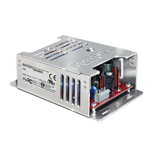

    RACM65系列是一款紧凑型3" x 2"高效率AC/DC电源模块,适用于医疗应用。该电源模块具有通用输入电压范围(85-264VAC),4kVAC隔离,无需最小负载,可在-40℃至+85℃的环境温度...
RACM65-12S-ST 数据手册
!NOT RECOMMENDED FOR NEW DESIGNS! • Long 5 year warranty Features • 2MOPP/250VAC AC/DC Converter • Suitable for built in Class II applications • Wide input voltage range (85-264VAC) • Low leakage current (8.0mm >8.0mm Notes: Note5: For repeat Hi-Pot testing, reduce the time and/or the test voltage www.recom-power.com REV.: 8/2021 MED-3 ! NOT RECOMMENDED FOR NEW DESIGNS ! RACM65 AC/DC Converter Series Specifications (measured at Ta= 25°C, 250VAC, full load and after warm-up) ENVIRONMENTAL Parameter Condition Operating Temperature Range Value refer to derating graph -40°C to +85°C Temperature Coefficient ±0.02%/K Operating Altitude 5000m max. Operating Humidity non-condensing 5% to 95% RH Pollution Degree PD2 Shock according to IEC60068-2-27 Vibration according to IEC60068-2-6 MTBF 1494 x 103 hours according to MIL-HDBK-217F, full load, +25°C Derating Graph (@ natural convection 0.1m/s) RACM65-15,24S(/OF) 100 100 90 90 80 80 70 70 Output Load [%] Output Load [%] RACM65-05,12,48S(/OF) 60 50 40 30 50 40 30 20 10 60 20 115VAC 230VAC 10 0 -40 -30 -20 -10 0 10 20 30 40 50 60 70 80 90 100 110 75 85 Ambient Temperature [°C] 115VAC 230VAC 0 -40 -30 -20 -10 0 10 20 30 40 50 60 70 80 90 100 110 75 85 Ambient Temperature [°C] SAFETY AND CERTIFICATIONS Certificate Type (Safety) Report / File Number Medical Electric Equipment, General Requirements for Safety and Essential Performance E314885 Medical Electric Equipment, General Requirements for Safety and Essential Performance (CB Scheme) 151101302 Information Technology Equipment - General Requirements for Safety (LVD) TW1708008-001 Information Technology Equipment - General Requirements for Safety EAC RU-AT.49.09571 RoHs2+ Standard CAN/CSA-C22.2 No. 60601-1:14 ANSI/AAMI ES60601-1:2005 + A2:2010 IEC60601-1:2005 + C2:2007, 3rd Edition EN60601-1:2006 EN60950-1:2006 + A2:2013 IEC60950-1:2005, 2nd Edition + A2:2013 TP TC 004/2011 TP TC 004/2011 RoHS-2011/65/EU + AM-2015/863 EMC Compliance (Medical) Conditions Standard / Criterion Medical electrical equipment - Part 1-2: General requirements for basic safety and essential performance - Collateral standard: Electromagnetic compatibility - Requirements and tests EN60601-1-2:2015 Industrial, scientific and medical equipment - Radio frequency disturbance characteritics Limits and methods of measurement CISPR11:2009 + A1:2010, Class B continued on next page www.recom-power.com REV.: 8/2021 MED-4 ! NOT RECOMMENDED FOR NEW DESIGNS ! AC/DC Converter RACM65 Series Specifications (measured at Ta= 25°C, 250VAC, full load and after warm-up) EMC Compliance (Medical) Conditions ESD Electrostatic discharge immunity test Air ±15kV; Contact ±8kV Standard / Criterion IEC61000-4-2:2008 Radiated, radio-frequency, electromagnetic field immunity test 20V/m (80-2700MHz) 27V/m (385MHz) 28V/m (450MHz) IEC61000-4-3:2006 + A2:2010 Fast Transient and Burst Immunity AC Power Port: ±2kV IEC61000-4-4:2012 Surge Immunity AC Port: IEC61000-4-5:2014 20Vr.m.s IEC61000-4-6:2013 50Hz, 30A/m IEC61000-4-8:2009 Dips: >95%; 30%; Interruptions >95% IEC61000-4-11:2004 Immunity to conducted disturbances, induced by radio-frequency fields Power Frequency Magnetic Field Voltage Dips and Interruptions L-N= ±1kV L-GND= ±2kV Limits of Voltage Fluctuations and Flicker EN61000-3-3:2013 Limitations on the amount of electromagnetic intererence allowed from digital & electronic devices 47CFR FCC Part 15 Subpart B, Class B Methods of Measurement of Radio-Noise Emissions from Low-Voltage Electrical and Electronic Equipment in the Range of 9 kHz to 40 GHz ANSI C63.4:2014 FCC methods of measurement of radio noise emissions from industrial, scientific, and medical equipment FCC OST/MP-5 EMC Compliance (Industrial) Conditions Electromagnetic compatibility of multimedia equipment – Emission Requirements Information technology equipment - Immunity characteristics - Limits and methods of measurement ESD Electrostatic discharge immunity test Standard / Criterion EN55032:2015+AC:2013, Class B EN55024:2010+A1:2015 Air ±15kV; Contact ±6kV IEC61000-4-2:2008, Criteria A Radiated, radio-frequency, electromagnetic field immunity test 10V/m (80-1000MHz) 20V/m (80-1000MHz) IEC61000-4-3:2006 + A2:2010, Criteria A Fast Transient and Burst Immunity AC Power Port: ±4kV IEC61000-4-4:2012, Criteria A Surge Immunity AC Port: L-N= ±2kV L-PE= ±4kV IEC61000-4-5:2014, Criteria A Immunity to conducted disturbances, induced by radio-frequency fields AC Power Port 10V, 20V IEC61000-4-6:2013, Criteria A 50Hz/60Hz, 100A/m, 1000A/m IEC61000-4-8:2009, Criteria A Voltage Dips and Interruptions Dips: >95%; 60%; 30% Interruptions >95% IEC61000-4-11:2004, Criteria A IEC61000-4-11:2004, Criteria B Damped oscillatory wave immunity test AC Port: L-N= ±1kV L/N-G= ±2.5kV IEC61000-4-18:2006 + A1:2010, Criteria A Power Frequency Magnetic Field Limits of Voltage Fluctuations and Flicker EN61000-3-3:2013 DIMENSION and PHYSICAL CHARACTERISTICS Parameter Type Value Material enclosed case PCB aluminum FR4, (UL94V-0) Dimension (LxWxH) enclosed case open frame 91.4 x 60.5 x 33.3mm 76.2 x 50.8 x 26.5mm Weight enclosed case open frame + “-ST” version 172g 137g continued on next page www.recom-power.com REV.: 8/2021 MED-5 ! NOT RECOMMENDED FOR NEW DESIGNS ! RACM65 AC/DC Converter Series Specifications (measured at Ta= 25°C, 250VAC, full load and after warm-up) Dimension Drawing Enclosed Case (mm) Top View 14.3 51.3 60.5 FC 41.3 CON2 CON1 Trim Adj. logo embossed 76.2 FC 84.2 91.4 AC Input Connector (CON1) Pin# Terminal Mating Housing 1 AC/L 3 AC/N Molex KK156 (SD-2478) Molex KK156 (09508031) DC Output Connector (CON2) Pin# Terminal Mating Housing 1,2 V3,4 V+ Molex KK156 (SD-2478) Molex KK156 (09508041) 1.20 33.3 Side View 10.0 9.6 Bottom View 3.5 M3 screws continued on next page www.recom-power.com REV.: 8/2021 MED-6 ! NOT RECOMMENDED FOR NEW DESIGNS ! RACM65 AC/DC Converter Series Specifications (measured at Ta= 25°C, 250VAC, full load and after warm-up) Dimension Drawing Open Frame (/OF) (mm) Top View 76.2 10.0 44.0 50.8 ScrewACTerminal Version Input Connector (CON1)„-ST“ Ø3.2 FC 69.8 51.3 14.3 51.3 Side View Pin# Terminal Mating Housing 1 AC/L 3 AC/N Molex KK156 (SD-2478) Molex KK156 (09508031) 14.3 Connector Version FC 44.4 CON2 CON1 Trim Adj. DC Output Connector (CON2) 24.0 CON1 1,2 V3,4 V+ Trim Terminal Adj. Mating Housing Molex KK156 (SD-2478) Molex KK156 (09508041) 2.5 1.6 CON2 CON1 Pin# CON2 Trim Adj. Screw Terminal Connection “-ST” Top View logo embossed logo embossed Screw Terminal Version „-ST“ Trim Adj. CON1 Trim Adj. Trim Adj. CON2 CON2 CON2 CON1 CON2 CON1 51.3 Open Frame Version 14.3 Enclosed Version logo embossed CON1 Screw terminal information # Function AWG 1 3 1,2 3,4 Trim Adj. VAC in (L) VAC in (N) -Vout +Vout 26-16 26-16 26-16 26-16 Model ETB30 (EK381V) ETB30 (EK381V) CON2 CON2 recommended tightening torque: 0.2Nm www.recom-power.com REV.: 8/2021 MED-7 ! NOT RECOMMENDED FOR NEW DESIGNS ! AC/DC Converter RACM65 Series Specifications (measured at Ta= 25°C, 250VAC, full load and after warm-up) PACKAGING INFORMATION Parameter Packaging Dimension (LxWxH) Type cardboard box Value enclosed case 120.0 x 80.0 x 85.0mm open frame 111.0 x 94.0 x 51.0mm Packaging Quantity 1pcs Storage Temperature Range Storage Humidity -40°C to +85°C non-condensing 5% to 95% RH The product information and specifications may be subject to changes even without prior written notice.The product has been designed for various applications; its suitability lies in the responsibility of each customer. The products are not authorized for use in safety-critical applications without RECOM’s explicit written consent. A safety-critical application is an application where a failure may reasonably be expected to endanger or cause loss of life, inflict bodily harm or damage property. The applicant shall indemnify and hold harmless RECOM, its affiliated companies and its representatives against any damage claims in connection with the unauthorized use of RECOM products in such safety-critical applications. www.recom-power.com REV.: 8/2021 MED-8
