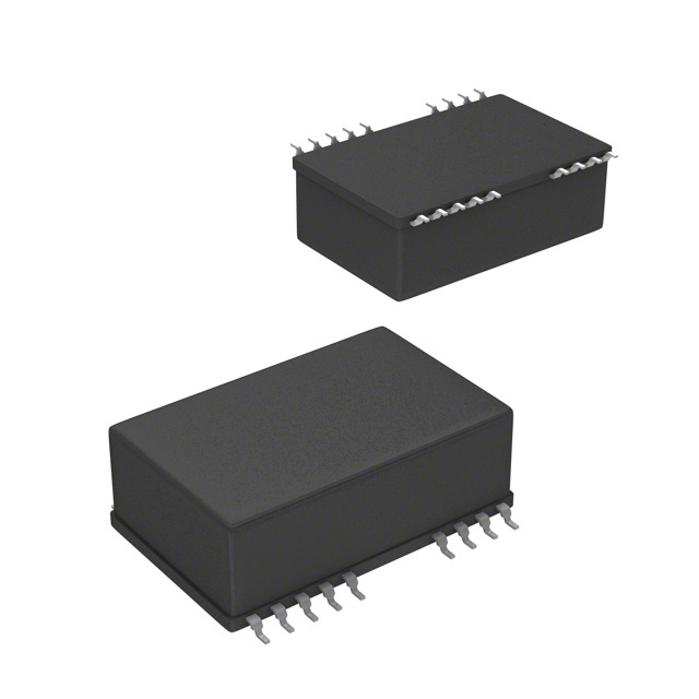

Features Regulated Converters ● ● ● ● ● ● ● ● ● ● 2kV, 4kVDC & 6kVDC Isolation Industry Standard 3W DIP24 Package Feedback Regulated Output Continuous Short Circuit Protection Wide Input 2:1 & 4:1 Medical Approvals (4kV/6kV Versions) EN and UL Certificates 3 Pinout Options, 3 Case Styles Control Pin Option Efficiency to 86% Description Besides the standard isolation of 2kVDC, this series offers options of 4kVDC (= "/H4") or 6kVDC (="/H6") making it suitable for medical applications and other sophisticated industrial applications. Packaging can be either DIP-24 plastic or 5-side-shielded DIP24 metal case (=option "/M") as well as SMD pinning (= option "/SMD"). For all the above variants, 2 industry-standard pinouts (= option "/A" or "/C") are available, and B pinning is available with 1.6kVDC isolation. Remote on/off control is possible with the /CTRL option (A pinning only). The converters can deliver 140% rated power for short periods of time to cope with applications with large capacitive loads or high start up currents. ECONOLINE DC/DC-Converter with 3 year Warranty 3 Watt DIP24 & SMD Single & Dual Output Selection Guide Part Number DIP24 (SMD) Input Voltage (VDC) Output Voltage (VDC) Output Efficiency Max Current Capacitive (mA) (%) Load(1) REC3-xx3.3SRW/H* 4.5 - 9, 9 - 18, 18 - 36, 36 - 72 3.3 900 66-76 4700µF REC3-xx05SRW/H* 4.5 - 9, 9 - 18, 18 - 36, 36 - 72 5 600 71-79 4700µF REC3-xx09SRW/H* 4.5 - 9, 9 - 18, 18 - 36, 36 - 72 9 330 74-83 3300µF REC3-xx12SRW/H* 4.5 - 9, 9 - 18, 18 - 36, 36 - 72 12 250 75-85 2200µF REC3-xx15SRW/H* 4.5 - 9, 9 - 18, 18 - 36, 36 - 72 15 200 75-86 2200µF REC3-xx05DRW/H* 4.5 - 9, 9 - 18, 18 - 36, 36 - 72 ±5 ±300 74-83 ±2200µF REC3-xx12DRW/H* 4.5 - 9, 9 - 18, 18 - 36, 36 - 72 ±12 ±125 75-85 ±1000µF REC3-xx15DRW/H* 4.5 - 9, 9 - 18, 18 - 36, 36 - 72 ±15 ±100 75-86 ±1000µF REC3-xx3.3SRWZ/H* 9 - 36, 18 - 72 3.3 900 77-79 4700µF REC3-xx05SRWZ/H* 9 - 36, 18 - 72 5 600 78-80 4700µF REC3-xx09SRWZ/H* 9 - 36, 18 - 72 9 330 80-83 3300µF REC3-xx12SRWZ/H* 9 - 36, 18 - 72 12 250 83-85 2200µF REC3-xx15SRWZ/H* 9 - 36, 18 - 72 15 200 83-85 2200µF REC3-xx05DRWZ/H* 9 - 36, 18 - 72 ±5 ±300 77-80 ±2200µF REC3-xx12DRWZ/H* 9 - 36, 18 - 72 ±12 ±125 83-85 ±1000µF REC3-xx15DRWZ/H* 9 - 36, 18 - 72 ±15 ±100 83-85 ±1000µF H* = H2, H4 or H6 for A or C pinning options with 2kVDC, 4kVDC or 6kVDC isolation. RoHS 2011/65/EU 6/6 E-358085 EN-60950-1 Certified UL-60950-1 Certified EN-60601-1 Certified REC3-S_DRW Isolation Restrictions ‘B” Pinning is restricted to 1.6kV isolation due to the closeness of the input and output pins. H* = H for B pinning option with 1.6kVDC isolation only. 2:1 Input (REC3-S/DRWH4/H6) xx = 4.5-9Vin = 05 xx = 9-18Vin = 12 xx = 18-36Vin = 24 xx = 36-72Vin = 48 4:1 Input (REC3-S/DRWZ(H4/H6)) xx = 9-36Vin = 24 xx = 18-72Vin = 48 * add suffix "/A", "/A/X2", "/B"or "/C" for pinning options, see next page and Isolation Restrictions. * add suffix "/M" for metal case. * add suffix "/SMD" for SMD package. * add suffix "/CTRL" for control pin option (A Pinning only) * add suffix -R for Tape and Reel packaging Ordering Examples: REC3-0512DRW/H2/A/CTRL= 2:1 input, 5V Vin, ±12V Vout, 2kVDC, pinout “A”, plastic case, control pin REC3-4812SRWZ/H4/A/M = 4:1 input, 48V Vin, 12V Vout, 4kVDC, pinout “A”, metal case, no control pin REC3-2412DRWZ/H/B = 4:1 input, 24V Vin, ±12V Vout, 1.6kVDC, pinout “B”, plastic case, no control pin REC3-0505SRW/H6/C/SMD-R = 2:1 input, 5V Vin, 5V Vout, 6kVDC, SMD pinout “C”, plastic case, no control pin, Tape and Reel packaging. www.recom-power.com REV: 0/2015 If the options "/M" for metal case and "/SMD" for SMD pinout are combined, the maximum allowed isolation voltage is 2kVDC because of the shorter distances between pins and the metal case. DIP-24 through-hole case and SMD-plastic case are not affected and offer the full isolation barriers of 2kV through to 6kVDC. Refer to Application Notes E-141 REC3-S_DRW(Z) /H* Series ECONOLINE DC/DC-Converter Input Voltage Range 2:1 & 4:1 Output Voltage Accuracy ±2% max. Line Regulation (HL-LL) ±0.4% max. Load Regulation (for output load current change from 20% to 100%) ±0.6% max. Minimum Load 10% (2) Output Ripple and Noise (0,1µF capacitor on output, 20MHz BW) 50mVp-p max. Switching Frequency at Full Load 2:1 Input types 90kHz min. / 150kHz max. and nominal Input Voltage 4:1 Input types 120kHz min. / 180kHz max. Input Filter Pi Network Efficiency at Full Load see above No Load Power Consumption 300mW max. Isolation Voltage H2-Suffix (tested for 1 second) 2000VDC (rated for 1 minute**) 1000VAC / 60Hz Isolation Voltage H4-Suffix (tested for 1 second) 4000VDC (rated for 1 minute**) 2000VAC / 60Hz Isolation Voltage H6-Suffix (tested for 1 second) 6000VDC (rated for 1 minute**) 3000VAC / 60Hz Isolation Capacitance 2:1 Input types 20pF min. / 60pF max. 4:1 Input types 40pF min. / 80pF max. Isolation Resistance 1 GΩ min. Short Circuit Protection (Max temp. = 60°C during short circuit conditions) Continuous, Auto Restart Operating Temperature Range 5V input types -40°C to +80°C (see Graph) (free air convection) others -40°C to +85°C (see Graph) Storage Temperature Range -55°C to +125°C Relative Humidity 95% RH Case Material Non-Conductive Plastic or Metal Thermal Impedance Natural convection 20°C/W for plastic case 12°C/W for metal case Package Weight 13g Packing Quantity 15 pcs per Tube 100 pcs per Reel MTBF (+25°C) using MIL-HDBK 217F 1043 x 103 hours } Derating-Graph (Ambient Temperature) Output Power (%) Output Power (%) Vin = 5V 120 100 80 60 50 40 20 0 -40 Safe Operating Area 100 50 75 125 80 105 Operating Temperature (°C) 120 100 80 60 50 40 20 0 -40 0 25 Safe Operating Area 0 25 50 75 Operating Temperature (°C) 100 85 105 125 Detailed Information see Application Notes chapter "MTBF" 186 x 103 hours UL 60950-1 1st Ed. C22.2 No. 60950-1-03 EN General Safety Report: SPCLVD1212007 EN60950-1:2006 + A1:2010+A12:2011 EN Medical Safety Report: MDD1205098-3 + RM1205098-3 IEC/EN 60601-1 3rd Ed. Medical Report + ISO14971 Risk Assessment (+85°C) using MIL-HDBK 217F Certifications UL General Safety Report: E358085 **Any data referred to in this datasheet are of indicative nature and based on our practical experience only. For further details, please refer to our Application Notes. Notes Note 1: Maximum capacitive load is defined as the capacitive load that will allow start up in under 1 second without damage to the converter Note 2: The REC3-RW series requires a minimum of 10% load on the output to maintain specified regulation. Operating under no-load conditions will not damage these devices; however, they may not meet all listed specifications. Typical Characteristics Single 2:1 Input Single 2:1 Input 100 2415 2409 60 Efficiency % 40 20 0% 40% 20% 60% Total Output current (%) E-142 80% 100% 20 0 0512D 1212D 60 60 2405 40 80 80 80 0 Efficiency / Load 100 2418 1205 2424 4805 0% 40% 20% 60% Total Output current (%) 80% REV: 0/2015 100% 0515D 40 Efficiency % 100 Dual 2:1 Input Efficiency / Load Efficiency / Load Efficiency % REC3-RW Specifications (measured at TA = 25°C, nominal input voltage, full load and after warm-up) 20 0 0% 40% 20% 60% Total Output current (%) 80% 100% www.recom-power.com REC3-S_DRW(Z) /H* Series ECONOLINE DC/DC-Converter Typical Characteristics - Continued Single 4:1 Input Single 4:1 Input Efficiency / Load 100 60 40 0% 40% 20% 60% Total Output current (%) 80% 20 0 100% 2415D/ H4 40 483.3/ H4 Efficiency % 20 Efficiency % 243.3/ H4 2412D/ H4 80 60 40 Efficiency % 100 4805/ H4 80 60 0 Efficiency / Load Efficiency / Load 100 2405/ H4 80 Dual 4:1 Input 0% 40% 20% 60% Total Output current (%) 100% 80% 20 0 0% 40% 20% 60% Total Output current (%) 80% 100% Package Style and Pinning (mm) DIP 24 , Wide Input 2:1 & 4:1 “A” Pinning 20.30 32.00 /H2, /H4 & /H6 Pin Connections 10.20 Pin # 3.8+0.5 /-0.25 15.24 0.51 4.60 CTRL Option only 1 2 3 9 Recommended Footprint Details 1.00 ø+0.15/–0 11 23 22 16 Vin+ CTRL Option 3.8+0.5 /-0.25 15.24 Recommended Footprint Details 1.00 ø+0.15/–0 1 2 10 11 12 15 2.54 13 2.54 www.recom-power.com –Vin 9 NC No Pin Com 11 NC NC –Vout 14 +Vout +Vout +Vout 16 –Vout –Vout Com 22 +Vin +Vin +Vin 23 +Vin +Vin +Vin XX.X ± 0.5 mm XX.XX ± 0.25 mm Pin # Single Dual 1 +Vin +Vin 2 +Vin +Vin 10 NC Com 11 NC Com 12 –Vout NC 13 +Vout –Vout 15 NC +Vout 23 –Vin –Vin 24 –Vin –Vin NC = No Connection Bottom View 24 23 –Vin –Vin Pin Connections 10.20 0.51 –Vin –Vin CTRL 1 1kW 1N4148 20.30 2.06 –Vin 3 RECx-xxxx/CTRL 2,3 Off On TTL Input /H2, /H4 & /H6 2 22,23 0V ON = Open or 0V< Vctrl

1. 物料型号:文档中列出了多种型号,例如REC3-xx3.3SRW/H、REC3-xx05SRW/H等,这些型号具有不同的输入电压范围、输出电压、输出电流和效率。
2. 器件简介:ECONOLINE DC/DC转换器,具有2kV、4kV和6kV的隔离电压选项,适用于医疗和高端工业应用。提供DIP24和SMD封装,具有多种引脚选项和控制引脚选项。
3. 引脚分配:文档提供了详细的引脚分配图和说明,包括DIP24和SMD封装的单输出和双输出配置。
4. 参数特性:包括输入电压范围、输出电压精度、负载调整、最小负载、输出纹波和噪声、开关频率、输入滤波器、效率、无负载功耗、隔离电压、隔离电容和电阻、短路保护等。
5. 功能详解:转换器能够提供高达140%的额定功率短时间,以适应具有大电容负载或高启动电流的应用。还提供了远程开关控制功能。
6. 应用信息:适用于医疗设备和其他需要高隔离电压的工业应用。
7. 封装信息:提供DIP24塑料封装、5面屏蔽的DIP24金属封装以及SMD引脚选项。
