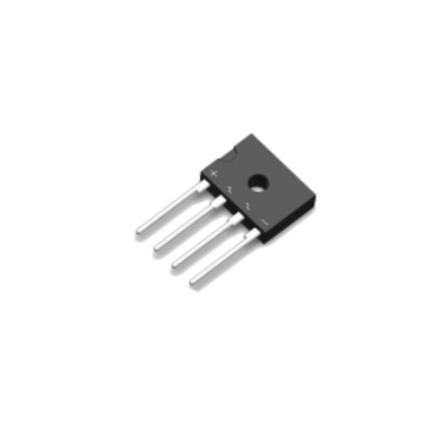

DB101 THRU DB107 SINGLE-PHASE GLASS PASSIVATED SILICON BRIDGE RECTIFIER VOLTAGE RANGE 50 to 1000 Volts CURRENT 1.0 Ampere FEATURES * * * * * * * * Good for automation insertion Surge overload rating - 30 amperes peak Ideal for printed circuit board Reliable low cost construction utilizing molded Glass passivated device Polarity symbols molded on body Mounting position: Any Weight: 1.0 gram DB-1 MECHANICAL DATA .255 (6.5) * Epoxy: Device has UL flammability classification 94V-O * UL listed under the recognized component directory, file #E94233. .245 (6.2) .350 (8.9) .300 (7.6) .335 (8.5) .307 (7.8) .118 (3.0) .093 (2.35) MAXIMUM RATINGS AND ELECTRICAL CHARACTERISTICS .193 (4.9) .020 (0.5) Ratings at 25 o C ambient temperature unless otherwise specified. .155 (3.9) Single phase, half wave, 60 Hz, resistive or inductive load. .205 (5.2) For capacitive load, derate current by 20%. .195 (5.0) .060 (1.5) Dimensions in inches and (millimeters) MAXIMUM RATINGS (At T A = 25 C unless otherwise noted) o SYMBOL DB101 DB102 DB103 DB104 DB105 DB106 DB107 UNITS Maximum Recurrent Peak Reverse Voltage RATINGS VRRM 50 100 200 400 600 800 1000 Volts Maximum RMS Bridge Input Voltage VRMS 35 70 140 280 420 560 700 Volts Maximum DC Blocking Voltage VDC 50 100 200 400 600 800 1000 Maximum Average Forward Output Current at T A = 40 oC Volts IO 1.0 Amps I FSM 30 Amps I 2T 3.74 Peak Forward Surge Current 8.3 ms single half sine-wave superimposed on rated load (JEDEC method) Typical Current Squared Time Typical Thermal Resistance (Note 2) Operating and Storage Temperature Range RQ J A 40 RQ J L 15 T J, T STG -55 to + 150 2 AS 0 C/W 0 C ELECTRICAL CHARACTERISTICS (At TA = 25 C unless otherwise noted) o SYMBOL CHARACTERISTICS Maximum Forward Voltage Drop per Bridge VF Element at 1.0A DC o Maximum Reverse Current at Rated @T A = 25 C DC Blocking Voltage per element @T A = 125 o C Note: 1.”ROHS compliant”. 2. Thermal Resistance: PCB mounted. IR DB101 DB102 DB103 DB104 1.0 DB105 DB106 DB107 UNITS Volts 1.0 uAmps 0.05 mAmps 2021-07 REV:B 60 8.3mS Single Half Sine-Wave JEDEC Method 50 40 30 20 10 0 0 2 4 10 6 20 40 60 100 INSTANTANEOUS FORWARD CURRENT, (A) PEAK FORWARD SURGE CURRENT, (A) RATING AND CHARACTERISTICS CURVES ( DB101 THRU DB107 ) 10 1 0.1 T J = 25 OC Pulse Width = 300MS 1% Duty Cycle 0.01 0 NUMBER OF CYCLES AT 60Hz 100 1.5 2.0 2.5 1.5 AVERAGE FORWARD CURRENT, (A) INSTANTANEOUS REVERSE CURRENT, (MA) 1.0 FIG.2 MAXIMUM INSTANTANEOUS FORWARD CHARACTERISTICS FIG.1 MAXIMUM NON-REPETITIVE FORWARD SURGE CURRENT TA = 25 OC 10 1.0 0.1 0 0.5 INSTANTANEOUS FORWARD VOLTAGE, (V) 20 40 60 80 100 120 140 PERCENT RATED PEAK REVERSE VOLTAGE, (%) FIG.3 MAXIMUM REVERSE CHARACTERISTICS 1.0 0.5 60 Hz RESISTIVE OR INDUCTIVE LOAD 0 20 40 60 80 100 120 140 150 AMBIENT TEMPERATURE, (OC) FIG.4 TYPICAL FORWARD CURRENT DERAT TING CURVE RECTRON Attachment information about DB10X 1. Internal Circuit 2. Marking on the body Part No. + Rectron Logo DB10X Plant - code Voltage-code ~ VXXX ~ Year - code 7 ------- for all Voltage range 50V~1000V Week - code 3. Items marked on the inner box and carton 3.1 On the box (for –C) CUSTOMER TYPE LOT NO. QUANTITY Q.A. DATE 3.2 On the carton CUSTOMER TYPE QUANTITY LOT NO. REMARK PACKAGING OF DIODE AND BRIDGE RECTIFIERS TUBE PACK PACKAGE DB-1 PACKING CODE EA PER BOX INNER BOX SIZE CARTON SIZE (mm) (mm) -C 2,500 440*130*65 460*290*150 EA PER CARTON WEIGHT(Kg) 10,000 6.80 DISCLAIMER NOTICE Rectron Inc reserves the right to make changes without notice to any product specification herein, to make corrections, modifications, enhancements or other changes. Rectron Inc or anyone on its behalf assumes no responsibility or liability for any errors or inaccuracies. Data sheet specifications and its information contained are intended to provide a product description only. "Typical" parameters which may be included on RECTRON data sheets and/ or specifications can and do vary in different applications and actual performance may vary over time. Rectron Inc does not assume any liability arising out of the application or use of any product or circuit. Rectron products are not designed, intended or authorized for use in medical, life-saving implant or other applications intended for life-sustaining or other related applications where a failure or malfunction of component or circuitry may directly or indirectly cause injury or threaten a life without expressed written approval of Rectron Inc. Customers using or selling Rectron components for use in such applications do so at their own risk and shall agree to fully indemnify Rectron Inc and its subsidiaries harmless against all claims, damages and expenditures.
