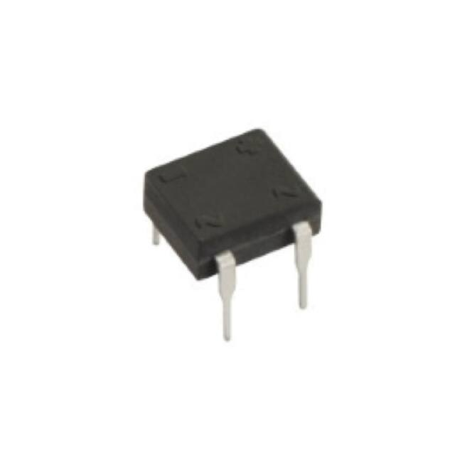

DB101S THRU DB107S SINGLE-PHASE GLASS PASSIVATED SILICON BRIDGE RECTIFIER VOLTAGE RANGE 50 to 1000 Volts CURRENT 1.0 Ampere FEATURES * * * * * * * Good for automation insertion Surge overload rating - 30 amperes peak Ideal for printed circuit board Reliable low cost construction utilizing molded Glass passivated device Polarity symbols molded on body Mounting position: Any DB-S MECHANICAL DATA .255 (6.5) .245 (6.2) * Epoxy: Device has UL flammability classification 94V-O .410 (10.4) .360 (9.4) .045 (1.14) .035 (0.89) .060 (1.524) .037 (0.95 ) .346 (8.8) .144(3.65 ) .307 (7.8) .089 (2.25) MAXIMUM RATINGS AND ELECTRICAL CHARACTERISTICS Ratings at 25 o C ambient temperature unless otherwise specified. .205 (5.2) resistive or inductive load. .195 (5.0) Dimensions in inches and (millimeters) o MAXIMUM RATINGS (At T A = 25 C unless otherwise noted) SYMBOL RATINGS DB101S DB102S DB103S DB104S DB105S DB106S DB107S Maximum Recurrent Peak Reverse Voltage VRRM 50 Maximum RMS Bridge Input Voltage VRMS Maximum DC Blocking Voltage VDC o Maximum Average Forward Output Current at T A = 40 C 100 200 400 600 35 70 140 280 420 50 100 200 400 600 800 UNITS 1000 Volts 560 700 Volts 800 1000 Volts IO 1.0 Amps I FSM 30 Amps I2t 3.73 A2Sec Peak Forward Surge Current 8.3 ms single half sine-wave superimposed on rated load (JEDEC method) Typical Current Squarad Time Typical Thermal Resistance (Note 2) Operating and Storage Temperature Range Rθ J A 40 R θJ L 15 T J, T STG -55 to + 150 SYMBOL DB101S DB102S DB103S DB104S DB105S DB106S DB107S VF 1.0 Volts 1.0 uAmps 0 C/W 0 C o ELECTRICAL CHARACTERISTICS (At TA = 25 C unless otherwise noted) CHARACTERISTICS Maximum Forward Voltage Drop per chip ( diode ) at 1.0A DC Maximum Reverse Current at Rated @T A = 25 o C DC Blocking Voltage per element @T A = 125 o C Note: 1.” ROHS compliant”. 2. Thermal Resistance: Mounted on PCB. IR 0.05 UNITS mAmps 20 20-04/97 REV:E 60 8.3mS Single Half Sine-Wave JEDEC Method 50 40 30 20 10 0 1 2 4 6 10 20 40 60 100 INSTANTANEOUS FORWARD CURRENT, (A) PEAK FORWARD SURGE CURRENT, (A) RATING AND CHARACTERISTICS CURVES ( DB101S THRU DB107S ) 10 1 0.1 T J = 25 OC Pulse Width = 300mS 1% Duty Cycle 0.01 0 NUMBER OF CYCLES AT 60Hz FIG. 1 - MAXIMUM NON-REPETITIVE FORWARD SURGE CURRENT 1.0 1.5 2.0 2.5 FIG.2 MAXIMUM INSTANTANEOUS FORWARD CHARACTERISTICS 100 1.5 AVERAGE FORWARD CURRENT, (A) INSTANTANEOUS REVERSE CURRENT, (uA) 0.5 INSTANTANEOUS FORWARD VOLTAGE, (V) TA = 125 OC 10 1 TA = 25 OC 1.0 0 20 40 60 80 100 120 140 PERCENT RATED PEAK REVERSE VOLTAGE, (%) FIG.3 MAXIMUM REVERSE CHARACTERISTICS 1.0 0.5 60 Hz RESISTIVE OR INDUCTIVE LOAD 0 20 40 60 80 100 120 140 150 AMBIENT TEMPERATURE, (OC) FIG.4 TYPICAL FORWARD CURRENT TING CURVE DERAT Mounting Pad Layout .410 Max. (10.4 Max.) .205 (5.2) .195 (5.0) .042 Min. (1.10 Min.) Dimensions in inches and (millimeters) .060 Min. (1.52 Min.) Marking Description Part No. ~ Year – code (Y: Last digit of year & A:2010, B:2011...) + DB10X Rectron Logo VYWW Voltage-code ~ Week – code: (WW:01~52) 1-------50V 2-------100V 3-------200V 4-------400V 5-------600V 6-------800V 7-----1000V PACKAGING OF DIODE AND BRIDGE RECTIFIERS BULK PACK PACKAGE PACKING CODE -C DB-S EA PER BOX INNER BOX SIZE (mm) 4,000 450*140*84 CARTON SIZE EA PER CARTON (mm) 464*305*283 24,000 WEIGHT(Kg) 18.44 REEL PACK PACKAGE DB-S PACKING EA PER EA PER COMPONENT TAPE SPACE REEL DIA CARTON SIZE EA PER GROSS SPACE INNER REEL CARTON WEIGHT(Kg) CODE (mm) (mm) (mm) (mm) BOX -T/W 1,000 1,000 9.5 52 330 360*355*360 8,000 9.8 DISCLAIMER NOTICE Rectron Inc reserves the right to make changes without notice to any product specification herein, to make corrections, modifications, enhancements or other changes. Rectron Inc or anyone on its behalf assumes no responsibility or liability for any errors or inaccuracies. Data sheet specifications and its information contained are intended to provide a product description only. "Typical" parameters which may be included on RECTRON data sheets and/ or specifications can and do vary in different applications and actual performance may vary over time. Rectron Inc does not assume any liability arising out of the application or use of any product or circuit. Rectron products are not designed, intended or authorized for use in medical, life-saving implant or other applications intended for life-sustaining or other related applications where a failure or malfunction of component or circuitry may directly or indirectly cause injury or threaten a life without expressed written approval of Rectron Inc. Customers using or selling Rectron components for use in such applications do so at their own risk and shall agree to fully indemnify Rectron Inc and its subsidiaries harmless against all claims, damages and expenditures.
DB106S
物料型号:DB101S至DB107S
器件简介: - 适用于自动化插入 - 峰值浪涌电流额定值为30安培 - 适合印刷电路板使用 - 采用模塑封装,成本低廉且可靠 - 器件表面有玻璃钝化处理 - 极性符号模塑在外壳上 - 可任意位置安装
引脚分配:文档中未明确提供引脚分配信息,但通常桥式整流器有四个引脚,分别为阳极、阴极和两个交流输入端。
参数特性: - 工作温度范围:-55°C至+150°C - 具有不同的最大反向峰值电压(VRRM)从50至1000伏特 - 最大有效值桥输入电压(VRMS)从35至700伏特 - 最大直流阻断电压(Vpc)与VRRM相同 - 在40°C环境温度下,最大平均正向输出电流(Io)为1.0安培 - 峰值正向浪涌电流(IFSM)为30安培(8.3毫秒单半正弦波叠加在额定负载上,JEDEC方法)
功能详解: - 正向电压降(VF)在1.0A直流下每芯片最大值为1.0伏特 - 在额定直流阻断电压下的最大反向电流在25°C时为1.0微安 - 在125°C时,每个元件的直流阻断电压下的最大反向电流为0.05微安
应用信息:文档中未明确提供应用信息,但根据参数特性,这些整流器适用于需要高电压和大电流的应用场合。
封装信息: - 环氧树脂:设备具有UL阻燃分类94V-0 - 封装尺寸以英寸和毫米提供 - 标记描述包括极性标记和电压编码
包装信息: - 散装包装和卷装包装的详细信息,包括每箱数量、内盒尺寸、纸箱尺寸、每箱毛重等。
