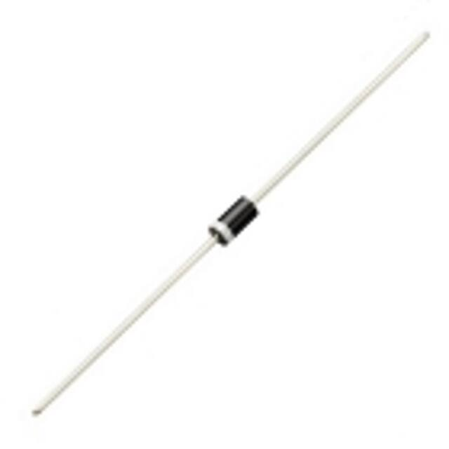

    DIODE GEN PURP 2000V 500MA DO41
R2000FG 数据手册
R2000FG SURFACE MOUNT GLASS PASSIVATED HIGH VOLTAGE FAST RECOVERY RECTIFIER VOLTAGE RANGE 2000 Volts CURRENT 0.5 Ampere FEATURES *Fast switching *Low leakage *High current capability *High surge capability *High reliability *Glass passivated junction MECHANICAL DATA * * * * * Case: Molded plastic Epoxy: Device has UL flammability classification 94V-O Lead: MIL-STD-202E method 208C guaranteed Mounting position: Any Weight: 0.336 g ram 1.0 (25.4) MIN. .205 (5.2) .166 (4.2) .034 (0.9) DIA. .028 (0.7) .107 (2.7) .080 (2.0) MAXIMUM RATINGS AND ELECTRICAL CHARACTERISTICS DIA. 1.0 (25.4) MIN. o Ratings at 25 C ambient temperature unless otherwise specified. Single phase, half wave, 60 Hz, resistive or inductive load. For capacitive load, derate current by 20%. Dimensions in inches and (millimeters) MAXIMUM RATINGS (At T A = 25 C unless otherwise noted) o SYMBOL R2000FG UNITS Maximum Recurrent Peak Reverse Voltage VRRM 2000 Volts Maximum RMS Volts VRMS 1400 Volts VDC 2000 Volts IO 500 mAmps I FSM 20 Amps A 2S RATINGS Maximum DC Blocking Voltage Maximum Average Forward Rectified Current at T A = 55 oC Peak Forward Surge Current, 8.3 ms single half sine-wave superimposed on rated load (JEDEC method) 2 Typical Current Squarad Time Typical Thermal Resistance (Note 1) Operating and Storage Temperature Range I t 1.66 R Q JA 65 RQJL 30 T J , T STG -65 to + 175 SYMBOL R2000FG VF 2.5 Volts 1.0 uAmps 500 uAmps 0 C/W 0 C ELECTRICAL CHARACTERISTICS (At TA = 25 C unless otherwise noted) o CHARACTERISTICS Maximum Instantaneous Forward Voltage at 0.1A DC Maximum DC Reverse Current at Rated DC Blocking Voltage @ TA = 25oC @ TA = 150 oC Maximum Reverse Recovery Time (Note2 ) NOTES : 1. Thermal Resistance : Mounted on PCB. 2.Test Conditions: IF = 0.5A, IR = -1.0A, IRR = -0.25A IR trr 300 UNITS nSec 2021-06 REV:A RATING AND CHARACTERISTIC CURVES ( R2000FG ) FIG. 2 - MAXIMUM NON-REPETITIVE FORWARD SURGE CURRENT PEAK FORWARD SURGE CURRENT, (A) AVERAGE FORWARD CURRENT, (mA) FIG. 1 - TYPICAL FORWARD CURRENT DERATING CURVE 500 Single Phase Half Wave 60Hz Inductive or Resistive Load 400 300 200 100 0 0 50 100 150 AMBIENT TEMPERATURE, ( 175 70 60 8.3ms Single Half Sine-Wave (JEDEC Method) 50 40 30 20 10 0 1 10 ) NUMBER OF CYCLES AT 60Hz FIG. 3 - TEST CIRCUIT DIAGRAM AND REVERSE RECOVERY TIME CHARACTERISTIC 50 NONINDUCTIVE 10 NONINDUCTIVE trr +0.5A (+) 25 Vdc (approx) (-) (-) D.U.T PULSE 0 GENERATOR (NOTE 2) 1 NONINDUCTIVE OSCILLOSCOPE (NOTE 1) NOTES:1 Rise Time = 7ns max. Input Impedance = 1 megohm. 22 pF. 2. Rise Time = 10ns max. Source Impedance = 50 ohms. -0.25A (+) -1.0A 1cm SET TIME BASE FOR 120/1 ns/cm RECTRON 100 Marking Description Rectron Logo Part No. V Y M Cathode Band Year – code: (Y:Last digit of year) R2000 FG Month – code: (M:0~9,O,N,D) Voltage-code 2000-------2000V PACKAGING OF DIODE AND BRIDGE RECTIFIERS BULK PACK PACKAGE PACKING CODE DO-41 -B EA PER BOX INNER BOX SIZE (mm) 1,000 194*75*21 CARTON SIZE EA PER CARTON (mm) 415*220*255 50,000 GROSS WEIGHT(Kg) 16.2 REEL PACK PACKAGE DO-41 PACKING EA PER EA PER COMPONENT TAPE SPACE REEL DIA CARTON SIZE EA PER GROSS SPACE INNER REEL CARTON WEIGHT(Kg) CODE (mm) (mm) (mm) (mm) BOX -T 5,000 5,000 5.0 52 330 355*350*335 20,000 10.49 AMMO PACK PACKAGE PACKING CODE REEL ( EA ) COMPONENT TAPE SPACE SPACE(mm) (mm) DO-41 -F 3,000 5.0 52 DO-41 -E 3,000 5.0 26 BOX SIZE (mm) CARTON SIZE(mm) CARTON ( EA ) GROSS WEIGHT (Kg) 255*73*100 400*268*225 30,000 13.0 256*48*94 42,000 12.41 365*270*217 DISCLAIMER NOTICE Rectron Inc reserves the right to make changes without notice to any product specification herein, to make corrections, modifications, enhancements or other changes. Rectron Inc or anyone on its behalf assumes no responsibility or liability for any errors or inaccuracies. Data sheet specifications and its information contained are intended to provide a product description only. "Typical" parameters which may be included on RECTRON data sheets and/ or specifications can and do vary in different applications and actual performance may vary over time. Rectron Inc does not assume any liability arising out of the application or use of any product or circuit. Rectron products are not designed, intended or authorized for use in medical, life-saving implant or other applications intended for life-sustaining or other related applications where a failure or malfunction of component or circuitry may directly or indirectly cause injury or threaten a life without expressed written approval of Rectron Inc. Customers using or selling Rectron components for use in such applications do so at their own risk and shall agree to fully indemnify Rectron Inc and its subsidiaries harmless against all claims, damages and expenditures.
