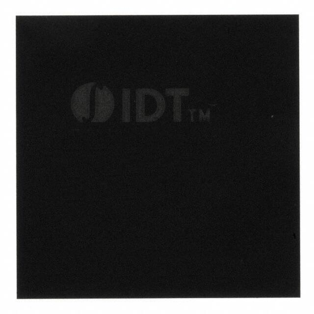

70V3569S6BFG
70V3569S6BFG
    RENESAS(瑞萨)
    CABGA208_15X15MM
    IC SRAM 576KBIT PAR 208FPBGA
70V3569S6BFG 数据手册
HIGH-SPEED 3.3V 16K x 36 SYNCHRONOUS PIPELINED DUAL-PORT STATIC RAM WITH 3.3V OR 2.5V INTERFACE Features: ◆ ◆ ◆ ◆ ◆ ◆ True Dual-Port memory cells which allow simultaneous access of the same memory location High-speed clock to data access – Commercial: 4.2/5/6ns (max.) – Industrial: 5ns (max) Pipelined output mode Counter enable and reset features Dual chip enables allow for depth expansion without additional logic Full synchronous operation on both ports – 7.5ns cycle time, 133MHz operation (9.6 Gbps bandwidth) – Fast 4.2ns clock to data out – 1.8ns setup to clock and 0.7ns hold on all control, data, and address inputs @ 133MHz 70V3569S – Data input, address, byte enable and control registers – Self-timed write allows fast cycle time Separate byte controls for multiplexed bus and bus matching compatibility LVTTL- compatible, single 3.3V (±150mV) power supply for core LVTTL- compatible, selectable 3.3V (±150mV)/2.5V (±125mV) power supply for I/Os and control signals on each port Industrial temperature range (-40°C to +85°C) is available for selected speeds Available in a 208-pin Plastic Quad Flatpack (PQFP), 208-ball fine-pitch Ball Grid Array, and 256-pin Ball Grid Array Green parts available, see ordering instructions ◆ ◆ ◆ ◆ ◆ ◆ Functional Block Diagram BE3L BE3R BE2L BE2R BE1L BE1R BE0L BE0R R/WL R/WR B B WW 0 1 L L CE0L B B WW 2 3 L L B BB B W WW W 3 2 1 0 R RR R CE0R CE1R CE1L OEL OER Dout0-8_L Dout9-17_L Dout18-26_L Dout27-35_L Dout0-8_R Dout9-17_R Dout18-26_R Dout27-35_R 16K x 36 MEMORY ARRAY I/O0L- I/O35L Din_L I/O0R - I/O35R Din_R CLKL CLKR A13L A0L CNTRSTL ADSL CNTENL Counter/ Address Reg. , A 13R ADDR_L ADDR_R Counter/ Address Reg. A 0R CNTRSTR ADSR CNTENR 4831 tbl 01 AUGUST 2019 1 ©2019 Integrated Device Technology, Inc. DSC 4831/15 70V3569S High-Speed 16K x 36 Dual-Port Synchronous Pipelined Static RAM Description: The IDT70V3569 is a high-speed 16K x 36 bit synchronous Dual-Port RAM. The memory array utilizes Dual-Port memory cells to allow simultaneous access of any address from both ports. Registers on control, data, and address inputs provide minimal setup and hold times. The timing latitude provided by this approach allows systems to be designed with very short cycle times. With an input data register, the IDT70V3569 has been optimized for applications having unidirectional or bidirectional data flow Industrial and Commercial Temperature Ranges in bursts. An automatic power down feature, controlled by CE0 and CE1, permits the on-chip circuitry of each port to enter a very low standby power mode. The 70V3569 can support an operating voltage of either 3.3V or 2.5V on one or both ports, controllable by the OPT pins. The power supply for the core of the device (VDD) remains at 3.3V. Pin Configuration(1,2,3,4) A1 A2 IO19L IO18L B1 B2 I/O20R C1 A3 VSS B3 VSS I/O18R C2 C3 A4 NC B4 VSS C4 VDDQL I/O19R VDDQR VDD D1 D2 I/O22L VSS E2 E1 D3 D4 I/O21L I/O20L E3 A5 NC B5 NC C5 NC D5 NC A6 NC B6 A13L C6 NC D6 A11L A7 A12L B7 A9L C7 A10L D7 A7L A8 A8L A9 B9 B8 BE2L C8 ADSL VSS C11 C10 C9 D9 BE0L B11 B10 CE0L VSS D10 R/WL D11 OEL CNTRSTL VDD A12 A13 CLKL CNTENL A4L VDD BE3L CE1L D8 A11 A10 BE1L B12 A5L C12 A6L D12 A3L B13 A1L C13 A2L D13 F2 F3 VDDQL I/O23R I/O24L G1 G2 I/O26L VSS H2 H1 G3 E4 J2 VDDQ VDD J3 VSS I/O28R L1 K2 VSS L2 K3 M2 M3 I/O31L P1 N2 N3 70V3569 BF208(5) BFG208(5) H4 J4 H14 VDD J14 VSS VSS 208-Pin fpBGA Top View(6) K4 K14 L14 I/O6R M4 M14 R1 VSS T1 N4 P3 P4 R2 R3 I/O33L I/O34R T2 T3 R4 NC T4 I/O33R I/O34L VDDQL VSS U1 VSS VSS N14 U2 I/O35L U3 VDD U4 NC C15 C16 C17 D15 D16 VSS D17 E15 F15 E16 E17 VSS F16 I/O13L F17 G15 G16 G17 H15 IO9R J15 VDD K15 H16 H17 VSS J16 L L15 I/O7L M15 P5 NC R5 NC T5 NC U5 NC P6 NC R6 A13R T6 NC U6 A11R P7 A12R R7 A9R T7 A10R U7 A7R P8 A8R R8 P9 P10 BE1R R9 VDD R10 BE2R CE0R T8 T9 VSS T10 BE3R CE1R U8 BE0R U9 VSS U10 VDD P11 P12 CLKR CNTEN R11 ADSR T11 R/WR U11 R R12 A5R T12 A6R U12 OER CNTRSTR A3R P13 A4R R13 A1R T13 A2R U13 A0R P14 J17 K16 K17 L16 VSS T14 VSS U14 VDD VSS L17 VSS M16 I/O8L M17 I/O6L I/O5R VDDQR N15 P15 I/O2L I/O3L R14 I/O10R VSS VDDQR N16 N17 I/O3R VDDQL I/O4R VSS I/O31R I/O30L P2 B17 B16 VDDQR I/O16L I/O15R I/O7R VDDQ I/O8R L4 I/O32R I/O32L VDDQR I/O35R D14 VSS I/O9L VDDQL I/O10L I/O11R VDDQL I/O29L I/O30R VSS N1 B15 VDD I/O16R I/O15L G14 G4 I/O29R I/O28L VDDQR I/O27L M1 A17 A16 OPTL I/O17L VSS I/O12R I/O11L VDDQR VSS I/O27R VSS L3 C14 F14 F4 L K1 VSS A15 I/O12L I/O13R VDD I/O26R VDDQR I/O25R J1 B14 E14 I/O25L I/O24R H3 A0L VDD I/O17R VDDQL I/O14L I/O14R I/O23L I/O22R VDDQR I/O21R F1 A14 R15 P16 I/O5L P17 VSS R16 I/O4L R17 VDDQL I/O1R VDDQR T15 I/O0R U15 T17 T16 VSS U16 I/O2R U17 OPTR I/O0L I/O1L , 4831 drw 02c NOTES: 1. All VDD pins must be connected to 3.3V power supply. 2. All VDDQ pins must be connected to appropriate power supply: 3.3V if OPT pin for that port is set to VIH (3.3V), and 2.5V if OPT pin for that port is set to VIL (0V). 3. All VSS pins must be connected to ground supply. 4. Package body is approximately 15mm x 15mm x 1.4mm, with 0.8mm ball pitch. 5. This package code is used to reference the package diagram. 6. This text does not indicate orientation of the actual part-marking. 6.42 2 70V3569S High-Speed 16K x 36 Dual-Port Synchronous Pipelined Static RAM Industrial and Commercial Temperature Ranges Pin Configuration(1,2,3,4) (con't.) 70V3569 BC256(5) 256-Pin BGA Top View(6) A1 NC B1 I/O18L C1 A2 NC B2 NC C2 I/O18R I/O19L D1 D2 A3 NC B3 NC C3 VSS D3 I/O20R I/O19R I/O20L E1 E2 E3 A4 NC B4 NC C4 NC D4 VDD E4 I/O21R I/O21L I/O22L VDDQL F1 F2 F3 F4 I/O23L I/O22R I/O23R VDDQL G1 G2 G3 G4 I/O24R I/O24L I/O25L VDDQR H1 H2 H3 H4 I/O26L I/O25R I/O26R VDDQR J1 J2 J3 J4 I/O27L I/O28R I/O27R VDDQL K1 K2 K3 K4 I/O29R I/O29L I/O28L VDDQL L1 L2 L3 L4 I/O30L I/O31R I/O30R VDDQR M1 M2 M3 M4 I/O32R I/O32L I/O31L VDDQR N1 N2 N3 I/O33L I/O34R I/O33R P1 P2 I/O35R I/O34L R1 I/O35L T1 NC R2 NC T2 NC P3 NC R3 NC T3 NC N4 VDD P4 NC R4 NC T4 NC A5 NC B5 NC C5 A13L D5 A6 A11L B6 A12L C6 A10L D6 A7 A8L B7 A9L C7 A7L D7 A8 BE2L B8 BE3L C8 BE1L D8 A9 CE1L B9 CE0L C9 BE0L D9 A10 OEL B10 A11 CNTENL B11 R/WL CNTRST C10 CLKL D10 L C11 ADSL D11 A12 A5L B12 A4L C12 A6L D12 VDDQL VDDQL VDDQR VDDQR VDDQL VDDQL VDDQR VDDQR E5 VDD F5 VDD G5 VSS H5 VSS J5 VSS K5 VSS L5 VDD M5 VDD N5 E6 VDD F6 VSS G6 VSS H6 VSS J6 VSS K6 VSS L6 VSS M6 VDD N6 E7 VSS F7 VSS G7 VSS H7 VSS J7 VSS K7 VSS L7 VSS M7 VSS N7 E8 VSS F8 VSS G8 VSS H8 VSS J8 VSS K8 VSS L8 VSS M8 VSS N8 E9 VSS F9 VSS G9 VSS H9 VSS J9 VSS K9 VSS L9 VSS M9 VSS N9 E10 VSS F10 VSS G10 VSS H10 VSS J10 VSS K10 VSS L10 VSS M10 VSS N10 E11 VDD F11 VSS G11 VSS H11 VSS J11 VSS K11 VSS L11 VSS M11 VDD N11 E12 VDD F12 VDD G12 VSS H12 VSS J12 VSS K12 VSS L12 VDD M12 VDD N12 VDDQR VDDQR VDDQL VDDQL VDDQR VDDQR VDDQL VDDQL P5 A13R R5 NC T5 NC P6 A10R R6 A12R T6 A11R P7 A7R R7 A9R T7 A8R P8 BE1R R8 BE3R T8 BE2R P9 P10 P11 BE0R CLKR ADSR R9 R10 R11 CE0R R/WR CNTRSTR T9 CE1R T10 T11 OER CNTENR P12 A6R R12 A4R T12 A5R A13 A2L B13 A1L C13 A3L D13 VDD E13 A14 A0L B14 VDD C14 A15 A16 NC B15 NC B16 I/O17L NC C16 C15 OPTL I/O17R I/O16L D14 D16 D15 I/O15R I/O15L I/O16R E14 E16 E15 VDDQR I/O13L I/O14L I/O14R F13 F14 F16 F15 VDDQR I/O12R I/O13R I/O12L G13 G14 G15 G16 VDDQL I/O10L I/O11L I/O11R H13 H14 VDDQL I/O9R J13 J14 H16 H15 IO9L J15 J16 VDDQR I/O8R I/O7R K13 K14 VDDQR I/O6R L13 L14 VDDQL I/O5L M13 M14 VDDQL I/O3R N13 VDD P13 A3R R13 A1R T13 A2R N14 I/O2L P14 I/O0L R14 OPTR T14 A0R I/O10R K15 I/O8L K16 I/O6L I/O7L L16 L15 I/O4R I/O5R M16 M15 I/O3L I/O4L N16 N15 I/O1R P15 I/O2R P16 I/O0R I/O1L R16 R15 NC T15 NC , T16 NC NC 4831 drw 02d , NOTES: 1. All VDD pins must be connected to 3.3V power supply. 2. All VDDQ pins must be connected to appropriate power supply: 3.3V if OPT pin for that port is set to VIH (3.3V), and 2.5V if OPT pin for that port is set to VIL (0V). 3. All VSS pins must be connected to ground supply. 4. Package body is approximately 17mm x 17mm x 1.4mm, with 1.0mm ball-pitch. 5. This package code is used to reference the package diagram. 6. This text does not indicate orientation of the actual part-marking. 6.42 3 70V3569S High-Speed 16K x 36 Dual-Port Synchronous Pipelined Static RAM Industrial and Commercial Temperature Ranges 70V3569 DRG208(5) 208-Pin PQFP Top View 104 103 102 101 100 99 98 97 96 95 94 93 92 91 90 89 88 87 86 85 84 83 82 81 80 79 78 77 76 75 74 73 72 71 70 69 68 67 66 65 64 63 62 61 60 59 58 57 56 55 54 53 1 2 3 4 5 6 7 8 9 10 11 12 13 14 15 16 17 18 19 20 21 22 23 24 25 26 27 28 29 30 31 32 33 34 35 36 37 38 39 40 41 42 43 44 45 46 47 48 49 50 51 52 157 158 159 160 161 162 163 164 165 166 167 168 169 170 171 172 173 174 175 176 177 178 179 180 181 182 183 184 185 186 187 188 189 190 191 192 193 194 195 196 197 198 199 200 201 202 203 204 205 206 207 208 I/O19L I/O19R I/O20L I/O20R VDDQL VSS I/O21L I/O21R I/O22L I/O22R VDDQR VSS I/O23L I/O23R I/O24L I/O24R VDDQL VSS I/O25L I/O25R I/O26L I/O26R VDDQR VSS VDD VDD VSS VSS VDDQL VSS I/O27R I/O27L I/O28R I/O28L VDDQR VSS I/O29R I/O29L I/O30R I/O30L VDDQL VSS I/O31R I/O31L I/O32R I/O32L VDDQR VSS I/O33R I/O33L I/O34R I/O34L VSS VDDQR I/O17R I/O17L OPTL VSS VDD VDD A0L A1L A2L A3L A4L A5L A6L CNTRSTL CNTENL ADSL R/WL OEL CLKL VSS VSS VDD VDD CE0L CE1L BE0L BE1L BE2L BE3L A7L A8L A9L A10L A11L A12L A13L NC NC NC NC NC NC NC VSS VDD VSS I/O18L I/O18R VDDQR VSS 156 155 154 153 152 151 150 149 148 147 146 145 144 143 142 141 140 139 138 137 136 135 134 133 132 131 130 129 128 127 126 125 124 123 122 121 120 119 118 117 116 115 114 113 112 111 110 109 108 107 106 105 I/O16L I/O16R I/O15L I/O15R VSS VDDQL I/O14L I/O14R I/O13L I/O13R VSS VDDQR I/O12L I/O12R I/O11L I/O11R VSS VDDQL I/O10L I/O10R I/O9L I/O9R VSS VDDQR VDD VDD VSS VSS VSS VDDQL I/O8R I/O8L I/O7R I/O7L VSS VDDQR I/O6R I/O6L I/O5R I/O5L VSS VDDQL I/O4R I/O4L I/O3R I/O3L VSS VDDQR I/O2R I/O2L I/O1R I/O1L Pin Configuration(1,2,3,4) (con't.) VSS VDDQL I/O0R I/O0L OPTR VSS VSS VDD A0R A1R A2R A3R A4R A5R A6R CNTRSTR CNTENR ADSR R/WR OER CLKR VSS VSS VDD VDD CE0R CE1R BE0R BE1R BE2R BE3R A7R A8R A9R A10R A11R A12R A13R NC NC NC NC NC NC NC NC VSS VDD I/O35L I/O35R VDDQL VSS 4831 drw 02e NOTES: 1. All VDD pins must be connected to 3.3V power supply. 2. All VDDQ pins must be connected to appropriate power supply: 3.3V if OPT pin for that port is set to VIH (3.3V), and 2.5V if OPT pin for that port is set to VIL (0V). 3. All VSS pins must be connected to ground supply. 4. Package body is approximately 28mm x 28mm x 3.5mm. 5. This package code is used to reference the package diagram. 6.42 4 70V3569S High-Speed 16K x 36 Dual-Port Synchronous Pipelined Static RAM Industrial and Commercial Temperature Ranges Pin Names Left Port Right Port Names CE0L, CE1L CE0R, CE1R Chip Enables R/WL R/WR Read/Write Enable OEL OER Output Enable A0L - A13L A0R - A13R Address I/O0L - I/O35L I/O0R - I/O35R Data Input/Output CLKL CLKR Clock ADSL ADSR Address Strobe Enable CNTENL CNTENR Counter Enable CNTRSTL CNTRSTR Counter Reset BE0L - BE3L BE0R - BE3R Byte Enables (9-bit bytes) VDDQL VDDQR Power (I/O Bus) (3.3V or 2.5V)(1) OPTL OPTR Option for selection VDDQX(1,2) VDD Power (3.3V)(1) VSS Ground NOTES: 1. VDD, OPTX, and VDDQX must be set to appropriate operating levels prior to applying inputs on the I/Os and controls for that port. 2. OPTX selects the operating voltage levels for the I/Os and controls on that port. If OPTX is set to VIH (3.3V), then that port's I/Os and controls will operate at 3.3V levels and VDDQX must be supplied at 3.3V. If OPTX is set to VIL (0V), then that port's I/Os and controls will operate at 2.5V levels and VDDQX must be supplied at 2.5V. The OPT pins are independent of one another—both ports can operate at 3.3V levels, both can operate at 2.5V levels, or either can operate at 3.3V with the other at 2.5V. (0V) 4831 tbl 01 Truth Table I—Read/Write and Enable Control(1,2,3,4) CLK CE0 CE1 BE3 BE2 BE1 BE0 R/W Byte 3 I/O27-35 Byte 2 I/O18-26 Byte 1 I/O9-17 Byte 0 I/O0-8 X ↑ H X X X X X X High-Z High-Z High-Z High-Z Deselected–Power Down X ↑ X L X X X X X High-Z High-Z High-Z High-Z Deselected–Power Down X ↑ L H H H H H X High-Z High-Z High-Z High-Z All Bytes Deselected X ↑ L H H H H L L High-Z High-Z High-Z DIN Write to Byte 0 Only X ↑ L H H H L H L High-Z High-Z DIN High-Z Write to Byte 1 Only X ↑ L H H L H H L High-Z DIN High-Z High-Z Write to Byte 2 Only X ↑ L H L H H H L DIN High-Z High-Z High-Z Write to Byte 3 Only X ↑ L H H H L L L High-Z High-Z DIN DIN Write to Lower 2 Bytes Only X ↑ L H L L H H L DIN DIN High-Z High-Z Write to Upper 2 bytes Only X ↑ L H L L L L L DIN DIN DIN DIN Write to All Bytes L ↑ L H H H H L H High-Z High-Z High-Z DOUT Read Byte 0 Only L ↑ L H H H L H H High-Z High-Z DOUT High-Z Read Byte 1 Only L ↑ L H H L H H H High-Z DOUT High-Z High-Z Read Byte 2 Only L ↑ L H L H H H H DOUT High-Z High-Z High-Z Read Byte 3 Only L ↑ L H H H L L H High-Z High-Z DOUT DOUT Read Lower 2 Bytes Only L ↑ L H L L H H H DOUT DOUT High-Z High-Z Read Upper 2 Bytes Only L ↑ L H L L L L H DOUT DOUT DOUT DOUT H ↑ L H L L L L X High-Z High-Z High-Z High-Z OE MODE Read All Bytes Outputs Disabled NOTES: 1. "H" = VIH, "L" = VIL, "X" = Don't Care. 2. ADS, CNTEN, CNTRST = X. 3. OE is an asynchronous input signal. 4. It is possible to read or write any combination of bytes during a given access. A few representative samples have been illustrated here. 6.42 5 4831 tbl 02 70V3569S High-Speed 16K x 36 Dual-Port Synchronous Pipelined Static RAM Industrial and Commercial Temperature Ranges Truth Table II—Address Counter Control(1,2) Address X Previous Address Addr Used X 0 CLK(6) ↑ ADS CNTEN X (4) I/O(3) CNTRST MODE X (4) L DI/O(0) Counter Reset to Address 0 An X An ↑ L X H DI/O (n) External Address Used An Ap Ap ↑ H H H DI/O(p) External Address Blocked—Counter disabled (Ap reused) H DI/O(p+1) X Ap Ap + 1 ↑ (5) H L Counter Enabled—Internal Address generation NOTES: 1. "H" = VIH, "L" = VIL, "X" = Don't Care. 2. Read and write operations are controlled by the appropriate setting of R/W, CE0, CE1, BEn and OE. 3. Outputs are in Pipelined mode: the data out will be delayed by one cycle. 4. ADS and CNTRST are independent of all other memory control signals including CE0, CE1 and BEn 5. The address counter advances if CNTEN = VIL on the rising edge of CLK, regardless of all other memory control signals including CE0, CE1, BEn. Recommended DC Operating Conditions with VDDQ at 2.5V Recommended Operating Temperature and Supply Voltage(1) Parameter Min. Typ. Max. Unit 3.15 3.3 3.45 V 2.375 2.5 2.625 V 0 0 0 V Input High Voltage (3) (Address & Control Inputs) 1.7 ____ VDDQ + 125mV(2) V Input High Voltage - I/O(3) 1.7 ____ VDDQ + 125mV(2) V ____ 0.7 V GND VDD VDD Core Supply Voltage 0OC to +70OC 0V 3.3V + 150mV VDDQ I/O Supply Voltage (3) -40OC to +85OC 0V 3.3V + 150mV VSS Ground VIH VIH Commercial Industrial Symbol Ambient Temperature Grade 4831 tbl 03 4831 tbl 04 NOTES: 1. Industrial temperature: for specific speeds, packages and powers contact your sales office. VIL Input Low Voltage (1) -0.3 4831 tb l 05a NOTES: 1. VIL > -1.5V for pulse width less than 10 ns. 2. VTERM must not exceed VDDQ + 125mV. 3. To select operation at 2.5V levels on the I/Os and controls of a given port, the OPT pin for that port must be set to VIL (0V), and VDDQX for that port must be supplied as indicated above. Absolute Maximum Ratings(1) Symbol Rating Commercial & Industrial Unit VTERM(2) Terminal Voltage with Respect to GND -0.5 to +4.6 V TBIAS Temperature Under Bias -55 to +125 o C TSTG Storage Temperature -65 to +150 o C IOUT DC Output Current Recommended DC Operating Conditions with VDDQ at 3.3V Symbol 50 mA 4831 tbl 06 NOTES: 1. Stresses greater than those listed under ABSOLUTE MAXIMUM RATINGS may cause permanent damage to the device. This is a stress rating only and functional operation of the device at these or any other conditions above those indicated in the operational sections of this specification is not implied. Exposure to absolute maximum rating conditions for extended periods may affect reliability. 2. VTERM must not exceed VDD + 150mV for more than 25% of the cycle time or 4ns maximum, and is limited to < 20mA for the period of VTERM > VDD + 150mV. Min. Typ. Max. Unit VDD Core Supply Voltage Parameter 3.15 3.3 3.45 V VDDQ I/O Supply Voltage (3) 3.15 3.3 3.45 V VSS Ground 0 0 0 V (2) V VIH Input High Voltage (Address & Control Inputs)(3) 2.0 ____ VDDQ + 150mV VIH Input High Voltage - I/O(3) 2.0 ____ VDDQ + 150mV(2) V VIL Input Low Voltage -0.3(1) ____ 0.8 V 4831 tbl 05b NOTES: 1. VIL > -1.5V for pulse width less than 10 ns. 2. VTERM must not exceed VDDQ + 150mV. 3. To select operation at 3.3V levels on the I/Os and controls of a given port, the OPT pin for that port must be set to VIH (3.3V), and VDDQX for that port must be supplied as indicated above. 6.42 6 70V3569S High-Speed 16K x 36 Dual-Port Synchronous Pipelined Static RAM Industrial and Commercial Temperature Ranges Capacitance(1) (TA = +25°C, F = 1.0MHZ) PQFP ONLY Symbol Parameter Input Capacitance CIN (3) COUT Output Capacitance Conditions(2) Max. Unit VIN = 3dV 8 pF VOUT = 3dV 10.5 pF 4831 tbl 07 NOTES: 1. These parameters are determined by device characterization, but are not production tested. 2. 3dV references the interpolated capacitance when the input and output switch from 0V to 3V or from 3V to 0V. 3. COUT also references CI/O. DC Electrical Characteristics Over the Operating Temperature and Supply Voltage Range (VDD = 3.3V ± 150mV) 70V3569S Symbol Parameter (1) Test Conditions Min. Max. Unit |ILI| Input Leakage Current VDDQ = Max., VIN = 0V to V DDQ ___ 10 µA |ILO| Output Leakage Current 10 µA CE0 = VIH or CE1 = VIL, VOUT = 0V to V DDQ ___ VOL (3.3V) Output Low Voltage (2) IOL = +4mA, VDDQ = Min. ___ 0.4 V VOH (3.3V) Output High Voltage (2) IOH = -4mA, VDDQ = Min. 2.4 ___ V VOL (2.5V) Output Low Voltage (2) IOL = +2mA, VDDQ = Min. ___ 0.4 V VOH (2.5V) (2) IOH = -2mA, VDDQ = Min. 2.0 ___ V Output High Voltage 4831 tbl 08 NOTE: 1. At VDD < - 2.0V input leakages are undefined. 2. VDDQ is selectable (3.3V/2.5V) via OPT pins. Refer to p.4 for details. 6.42 7 70V3569S High-Speed 16K x 36 Dual-Port Synchronous Pipelined Static RAM Industrial and Commercial Temperature Ranges DC Electrical Characteristics Over the Operating Temperature and Supply Voltage Range(3) (VDD = 3.3V ± 150mV) 70V3569S4 Com'l Only Symbol IDD ISB1 ISB2 ISB3 ISB4 Parameter Test Condition Version 70V3569S5 Com'l & Ind 70V3569S6 Com'l Only Typ. (4) Max. Typ. (4) Max. Typ.(4) Max. Unit mA Dynamic Operating Current (Both Ports Active) CEL and CER= VIL, Outputs Disabled, f = fMAX(1) COM'L S 375 460 285 360 245 310 IND S ____ ____ 285 415 245 360 Standby Current (Both Ports - TTL Level Inputs) CEL = CER = VIH f = fMAX(1) COM'L S 145 190 105 145 95 125 IND S ____ ____ 105 175 95 150 Standby Current (One Port - TTL Level Inputs) CE"A" = VIL and CE"B" = VIH Active Port Outputs Disabled, f=fMAX(1) COM'L S 265 325 190 260 175 225 IND S ____ ____ 190 300 175 260 Full Standby Current (Both Ports - CMOS Level Inputs) Both Ports CEL and CER > VDDQ - 0.2V, VIN > VDDQ - 0.2V or VIN < 0.2V, f = 0(2) COM'L S 6 15 6 15 6 15 IND S ____ ____ 6 30 6 30 Full Standby Current (One Port - CMOS Level Inputs) CE"A" < 0.2V and CE"B" > VDDQ - 0.2V(5) VIN > VDDQ - 0.2V or VIN < 0.2V, Active Port, Outputs Disabled, f = fMAX(1) COM'L S 265 325 180 260 170 225 IND S ____ ____ 180 300 170 260 (5) mA mA mA mA 4831 tbl 09 NOTES: 1. At f = fMAX, address and control lines (except Output Enable) are cycling at the maximum frequency clock cycle of 1/tCYC, using "AC TEST CONDITIONS" at input levels of GND to 3V. 2. f = 0 means no address, clock, or control lines change. Applies only to input at CMOS level standby. 3. Port "A" may be either left or right port. Port "B" is the opposite from port "A". 4. VDD = 3.3V, TA = 25°C for Typ, and are not production tested. IDD DC(f=0) = 120mA (Typ). 5. CEX = VIL means CE0X = VIL and CE1X = VIH CEX = VIH means CE0X = VIH or CE1X = VIL CEX < 0.2V means CE0X < 0.2V and CE1X > VDDQ - 0.2V CEX > VDDQ - 0.2V means CE0X > VDDQ - 0.2V or CE1X - 0.2V "X" represents "L" for left port or "R" for right port. 6.42 8 70V3569S High-Speed 16K x 36 Dual-Port Synchronous Pipelined Static RAM Industrial and Commercial Temperature Ranges AC Test Conditions 2.5V Input Pulse Levels (Address & Controls) GND to 3.0V/GND to 2.35V Input Pulse Levels (I/Os) GND to 3.0V/GND to 2.35V Input Rise/Fall Times 833Ω 3ns Input Timing Reference Levels 1.5V/1.25V Output Reference Levels DATAOUT 1.5V/1.25V Output Load 5pF* 770Ω Figures 1, 2, and 3 4831 tbl 10 , 3.3V 50Ω 590Ω 50Ω DATAOUT 1.5V/1.25 , DATAOUT 10pF (Tester) 4831 drw 03 435Ω 5pF* Figure 1. AC Output Test load. 4831 drw 04 Figure 2. Output Test Load (For tCKLZ, tCKHZ, tOLZ, and tOHZ). *Including scope and jig. 10.5pF is the I/O capacitance of this device, and 10pF is the AC Test Load Capacitance. 7 6 5 4 ΔtCD (Typical, ns) 3 2 1 • 20.5 • 30 • 50 • 80 100 200 -1 Capacitance (pF) 4831 drw 05 · Figure 3. Typical Output Derating (Lumped Capacitive Load). 6.42 9 , , 70V3569S High-Speed 16K x 36 Dual-Port Synchronous Pipelined Static RAM Industrial and Commercial Temperature Ranges AC Electrical Characteristics Over the Operating Temperature Range (Read and Write Cycle Timing)(1,2) (VDD = 3.3V ± 150mV, TA = 0°C to +70°C) 70V3569S4 Com'l Only Symbol Parameter 70V3569S5 Com'l & Ind 70V3569S6 Com'l Only Min. Max. Min. Max. Min. Max. Unit ns tCYC2 Clock Cycle Time (Pipelined) 7.5 ____ 10 ____ 12 ____ tCH2 Clock High Time (Pipelined) 3 ____ 4 ____ 5 ____ ns tCL2 Clock Low Time (Pipelined) 3 ____ 4 ____ 5 ____ ns tR Clock Rise Time ____ 3 ____ 3 ____ 3 ns tF Clock Fall Time ____ 3 ____ 3 ____ 3 ns tSA Address Setup Time 1.8 ____ 2.0 ____ 2.0 ____ ns tHA Address Hold Time 0.7 ____ 0.7 ____ 1.0 ____ ns tSC Chip Enable Setup Time 1.8 ____ 2.0 ____ 2.0 ____ ns tHC Chip Enable Hold Time 0.7 ____ 0.7 ____ 1.0 ____ ns tSB Byte Enable Setup Time 1.8 ____ 2.0 ____ 2.0 ____ ns tHB Byte Enable Hold Time 0.7 ____ 0.7 ____ 1.0 ____ ns tSW R/W Setup Time 1.8 ____ 2.0 ____ 2.0 ____ ns tHW R/W Hold Time 0.7 ____ 0.7 ____ 1.0 ____ ns tSD Input Data Setup Time 1.8 ____ 2.0 ____ 2.0 ____ ns tHD Input Data Hold Time 0.7 ____ 0.7 ____ 1.0 ____ ns ADS Setup Time 1.8 ____ 2.0 ____ 2.0 ____ ns tHAD ADS Hold Time 0.7 ____ 0.7 ____ 1.0 ____ ns tSCN CNTEN Setup Time 1.8 ____ 2.0 ____ 2.0 ____ ns tHCN CNTEN Hold Time 0.7 ____ 0.7 ____ 1.0 ____ ns tSRST CNTRST Setup Time 1.8 ____ 2.0 ____ 2.0 ____ ns CNTRST Hold Time 0.7 ____ 0.7 ____ 1.0 ____ ns Output Enable to Data Valid ____ 4 ____ 5 ____ 6 ns tSAD tHRST tOE (1) tOLZ Output Enable to Output Low-Z 0 ____ 0 ____ 0 ____ ns tOHZ Output Enable to Output High-Z 1 4 1 4.5 1 5 ns tCD2 Clock to Data Valid (Pipelined) ____ 4.2 ____ 5 ____ 6 ns tDC Data Output Hold After Clock High 1 ____ 1 ____ 1 ____ ns tCKHZ Clock High to Output High-Z 1 3 1 4.5 1.5 6 ns tCKLZ Clock High to Output Low-Z 1 ____ 1 ____ 1 ____ ns 6 ____ 8 ____ 10 ____ ns Port-to-Port Delay tCO Clock-to-Clock Offset NOTES: 1. All input signals are synchronous with respect to the clock except for the asynchronous Output Enable (OE). 2. These values are valid for either level of VDDQ (3.3V/2.5V). See page 4 for details on selecting the desired I/O voltage levels for each port. 6.42 10 4831 tbl 11 70V3569S High-Speed 16K x 36 Dual-Port Synchronous Pipelined Static RAM Industrial and Commercial Temperature Ranges Timing Waveform of Read Cycle for Pipelined Operation(2) tCYC2 tCH2 tCL2 CLK CE0 tSC tSC tHC tHC (3) CE1 tSB tSB tHB BE(0-3) R/W ADDRESS (4) tSW tHW tSA tHA An An + 1 (1 Latency) An + 2 An + 3 tDC tCD2 DATAOUT Qn tCKLZ OE tHB (5) Qn + 1 Qn + 2 (5) (1) tOHZ tOLZ (1) tOE NOTES: 4831 drw 06 1. OE is asynchronously controlled; all other inputs are synchronous to the rising clock edge. 2. ADS = VIL, CNTEN and CNTRST = VIH. 3. The output is disabled (High-Impedance state) by CE0 = VIH, CE1 = VIL, BEn = VIH following the next rising edge of the clock. Refer to Truth Table 1. 4. Addresses do not have to be accessed sequentially since ADS = VIL constantly loads the address on the rising edge of the CLK; numbers are for reference use only. 5. If BEn was HIGH, then the appropriate Byte of DATAOUT for Qn + 2 would be disabled (High-Impedance state). Timing Waveform of a Multi-Device Pipelined Read(1,2) tCH2 tCYC2 tCL2 CLK tSA tHA A0 ADDRESS(B1) tSC tHC CE0(B1) tSC tHC tCD2 tCD2 Q0 DATAOUT(B1) tCKHZ A1 tSC tCKHZ A6 A5 A4 A3 A2 tSC CE0(B2) Q3 tCKLZ tDC tHA A0 ADDRESS(B2) tCD2 Q1 tDC tSA A6 A5 A4 A3 A2 A1 tHC tHC tCD2 DATAOUT(B2) tCKHZ tCD2 Q4 Q2 tCKLZ NOTES: 1. B1 Represents Device #1; B2 Represents Device #2. Each Device consists of one IDT70V3569 for this waveform, and are setup for depth expansion in this example. ADDRESS(B1) = ADDRESS(B2) in this situation. 2. BEn, OE, and ADS = VIL; CE1(B1), CE1(B2), R/W, CNTEN, and CNTRST = VIH. 6.42 11 tCKLZ 4831 drw 07 70V3569S High-Speed 16K x 36 Dual-Port Synchronous Pipelined Static RAM Industrial and Commercial Temperature Ranges Timing Waveform of Left Port Write to Pipelined Right Port Read(1,2) CLKL tSW tHW tSA tHA R/WL ADDRESSL NO MATCH MATCH tSD DATAINL tHD VALID tCO(3) CLKR tCD2 R/WR ADDRESSR tSW tHW tSA tHA NO MATCH MATCH DATAOUTR VALID tDC 4831 drw 08 NOTES: 1. CE0, BEn, and ADS = VIL; CE1, CNTEN, and CNTRST = VIH. 2. OE = VIL for the Right Port, which is being read from. OE = VIH for the Left Port, which is being written to. 3. If tCO < minimum specified, then data from right port read is not valid until following right port clock cycle (ie, time from write to valid read on opposite port will be tCO + 2 tCYC2 + tCD2). If tCO > minimum, then data from right port read is available on first right port clock cycle (ie, time from write to valid read on opposite port will be tCO + tCYC + tCD2). Timing Waveform of Pipelined Read-to-Write-to-Read tCYC2 (OE = VIL)(2) tCH2 tCL2 CLK CE0 tSC tHC tSB tHB CE1 BEn tSW tHW R/W (3) ADDRESS tSW tHW An tSA tHA An +1 An + 2 An + 3 An + 2 An + 4 tSD tHD DATAIN Dn + 2 tCD2 (1) tCKHZ tCKLZ tCD2 Qn + 3 Qn DATAOUT READ NOP (4) WRITE READ 4831 drw 09 NOTES: 1. Output state (High, Low, or High-impedance) is determined by the previous cycle control signals. 2. CE0, BEn, and ADS = VIL; CE1, CNTEN, and CNTRST = VIH. "NOP" is "No Operation". 3. Addresses do not have to be accessed sequentially since ADS = VIL constantly loads the address on the rising edge of the CLK; numbers are for reference use only. 4. "NOP" is "No Operation." Data in memory at the selected address may be corrupted and should be rewritten to guarantee data integrity. 6.42 12 70V3569S High-Speed 16K x 36 Dual-Port Synchronous Pipelined Static RAM Industrial and Commercial Temperature Ranges Timing Waveform of Pipelined Read-to-Write-to-Read (OE Controlled)(2) tCH2 tCYC2 tCL2 CLK CE0 tSC tHC tSB tHB CE1 BEn tSW tHW R/W (3) ADDRESS tSW tHW An tSA tHA An +1 An + 2 tSD DATAIN Dn + 2 tCD2 (1) Qn DATAOUT An + 4 An + 3 An + 5 tHD Dn + 3 tCKLZ tCD2 Qn + 4 (4) tOHZ OE READ WRITE READ 4831 drw 10 NOTES: 1. Output state (High, Low, or High-impedance) is determined by the previous cycle control signals. 2. CE0, BEn, and ADS = VIL; CE1, CNTEN, and CNTRST = VIH. 3. Addresses do not have to be accessed sequentially since ADS = VIL constantly loads the address on the rising edge of the CLK; numbers are for reference use only. 4. This timing does not meet requirements for fastest speed grade. This waveform indicates how logically it could be done if timing so allows. Timing Waveform of Pipelined Read with Address Counter Advance(1) tCH2 tCYC2 tCL2 CLK tSA ADDRESS tHA An tSAD tHAD ADS tSAD tHAD CNTEN tSCN tHCN tCD2 DATAOUT Qx - 1(2) Qn + 2(2) Qn + 1 Qn Qx Qn + 3 tDC READ EXTERNAL ADDRESS READ WITH COUNTER COUNTER HOLD READ WITH COUNTER 4831 drw 11 NOTES: 1. CE0, OE, BEn = VIL; CE1, R/W, and CNTRST = VIH. 2. If there is no address change via ADS = VIL (loading a new address) or CNTEN = VIL (advancing the address), i.e. ADS = VIH and CNTEN = VIH, then the data output remains constant for subsequent clocks. 6.42 13 70V3569S High-Speed 16K x 36 Dual-Port Synchronous Pipelined Static RAM Industrial and Commercial Temperature Ranges Timing Waveform of Write with Address Counter Advance(1) tCH2 tCYC2 tCL2 CLK tSA tHA An ADDRESS INTERNAL(3) ADDRESS An(7) An + 2 An + 1 An + 4 An + 3 tSAD tHAD ADS tSCN tHCN CNTEN tSD tHD Dn + 1 Dn DATAIN WRITE EXTERNAL ADDRESS Dn + 1 Dn + 4 Dn + 3 Dn + 2 WRITE WRITE WITH COUNTER COUNTER HOLD WRITE WITH COUNTER 4831 drw 12 Timing Waveform of Counter Reset(2) tCH2 tCYC2 tCL2 CLK tSA tHA (4) An ADDRESS INTERNAL(3) ADDRESS Ax 0 1 An + 2 An + 1 An An + 1 tSW tHW R/W ADS tSAD tHAD CNTEN tSCN tHCN tSRST tHRST CNTRST tSD tHD D0 DATAIN (5) Q1 Q0 DATAOUT (6) COUNTER RESET WRITE ADDRESS 0 READ ADDRESS 0 READ ADDRESS 1 READ ADDRESS n Qn READ ADDRESS n+1 NOTES: 4831 drw 13 1. CE0, BEn, and R/W = VIL; CE1 and CNTRST = VIH. 2. CE0, BEn = VIL; CE1 = VIH. 3. The "Internal Address" is equal to the "External Address" when ADS = VIL and equals the counter output when ADS = VIH. 4. Addresses do not have to be accessed sequentially since ADS = VIL constantly loads the address on the rising edge of the CLK; numbers are for reference use only. 5. Output state (High, Low, or High-impedance) is determined by the previous cycle control signals. 6. No dead cycle exists during counter reset. A READ or WRITE cycle may be coincidental with the counter reset cycle: ADDR 0 will be accessed. Extra cycles are shown here simply for clarification. 7. CNTEN = VIL advances Internal Address from ‘An’ to ‘An +1’. The transition shown indicates the time required for the counter to advance. The ‘An +1’Address is written to during this cycle. 6.42 14 70V3569S High-Speed 16K x 36 Dual-Port Synchronous Pipelined Static RAM Industrial and Commercial Temperature Ranges Functional Description Depth and Width Expansion The IDT70V3569 provides a true synchronous Dual-Port Static RAM interface. Registered inputs provide minimal set-up and hold times on address, data, and all critical control inputs. All internal registers are clocked on the rising edge of the clock signal, however, the self-timed internal write pulse is independent of the LOW to HIGH transition of the clock signal. An asynchronous output enable is provided to ease asynchronous bus interfacing. Counter enable inputs are also provided to stall the operation of the address counters for fast interleaved memory applications. A HIGH on CE0 or a LOW on CE1 for one clock cycle will power down the internal circuitry to reduce static power consumption. Multiple chip enables allow easier banking of multiple IDT70V3569s for depth expansion configurations. Two cycles are required with CE0 LOW and CE1 HIGH to reactivate the outputs. The IDT70V3569 features dual chip enables (refer to Truth Table I) in order to facilitate rapid and simple depth expansion with no requirements for external logic. Figure 4 illustrates how to control the various chip enables in order to expand two devices in depth. The IDT70V3569 can also be used in applications requiring expanded width, as indicated in Figure 4. Through combining the control signals, the devices can be grouped as necessary to accommodate applications needing 72-bits or wider. A15 IDT70V3569 CE0 CE1 CE0 CE1 VDD VDD Control Inputs Control Inputs IDT70V3569 IDT70V3569 IDT70V3569 CE1 CE1 CE0 CE0 Control Inputs Control Inputs 4831 drw 14 Figure 4. Depth and Width Expansion with IDT70V3569 6.42 15 BE, R/W, OE, CLK, ADS, CNTRST, CNTEN 70V3569S High-Speed 16K x 36 Dual-Port Synchronous Pipelined Static RAM Industrial and Commercial Temperature Ranges Ordering Information XXXXX A 999 A Device Type Power Speed Package A A A Process/ Temperature Range Blank 8 Tray Tape and Reel Blank I(1) Commercial (0°C to +70°C) Industrial (-40°C to +85°C) G(2) Green BF DR BC 208-pin fpBGA (BF208, BFG208) 208-pin PQFP (DRG208) 256-pin BGA (BC256) 4 5 6 Commercial Only Commercial & Industrial Commercial Only S Standard Power Speed in nanoseconds 70V3569 576Kbit (16K x 36-Bit) 3.3V Synchronous Dual-Port RAM 4831 drw 15 NOTES: 1. Contact your local sales office for Industrial temp range in other speeds, packages and powers. 2. Green parts available. For specific speeds, packages and powers contact your local sales office. LEAD FINISH (SnPb) parts are Obsolete excluding BGA & fpBGA. Product Discontinuation Notice - PDN# SP-17-02 Note that information regarding recently obsoleted parts are included in this datasheet for customer convenience. Orderable Part Information Speed (ns) 4 5 6 Pkg. Code Pkg. Type Temp. Grade 70V3569S4BC BC256 CABGA C 70V3569S4BC8 BC256 CABGA C Orderable Part ID 70V3569S4BF BF208 CABGA C 70V3569S4BF8 BF208 CABGA C 70V3569S4BFG BFG208 CABGA C 70V3569S4BFG8 BFG208 CABGA C 70V3569S4DRG DRG208 PQFP C 70V3569S5BC BC256 CABGA C 70V3569S5BC8 BC256 CABGA C 70V3569S5BCI BC256 CABGA I 70V3569S5BCI8 BC256 CABGA I 70V3569S5BF BF208 CABGA C 70V3569S5BF8 BF208 CABGA C 70V3569S5BFI BF208 CABGA I 70V3569S5BFI8 BF208 CABGA I 70V3569S6BC BC256 CABGA C 70V3569S6BC8 BC256 CABGA C 70V3569S6BF BF208 CABGA C 70V3569S6BF8 BF208 CABGA C 6.42 16 70V3569S High-Speed 16K x 36 Dual-Port Synchronous Pipelined Static RAM Industrial and Commercial Temperature Ranges Datasheet Document History 01/08/99: 03/12/99: 04/28/99: 06/08/99: 06/15/99: 08/04/99: 10/14/99: 10/19/99: 11/12/99: 04/10/00: 01/12/01: 04/10/01: 12/12/01: 03/23/05: 02/08/06: 07/25/08: 10/23/08: 10/08/14: 02/15/18: 08/21/19: Initial Public Release Added fpBGA package Fixed typo on page 10 Changed drawing format Page 2 Changed package body dimensions Page 3 Fixed typo Page 5 Deleted note 6 for Table II Page 2 Fixed typographical error Page 6 Improved power number Upgraded speed to 133MHz, added 2.5V I/O capability Page 4 Corrected I/O numbers in Truth Table I Replaced IDT logo Added new BGA packages, added full 2.5V interface capability Page 6 Updated Truth Table II Increased storage temperature parameter Clarified TA Parameter Page 8 DC Electrical parameters–changed wording from "open" to "disabled" Removed note 7 on DC Electrical Characteristics table Removed Preliminary status Added Industrial Temperature Ranges and removed related notes Page 2, 3 & 4 Added date revision to pin configurations Page 6 Removed industrial temp footnote from table 04 Page 8 & 10 Removed industrial temp for 6ns from DC & AC Electrical Characteristics Page 16 Removed industrial temp from 6ns in ordering information Added industrial temp footnote Page 1 & 17 Replaced TM logo with ® logo Page 1 Added green availability to features Page 16 Added green indicator to ordering information Page 1 & 17 Replaced old IDT TM with new IDT TM logo Page 5 Changed footnote 2 for Truth Table I from ADS, CNTEN, CNTRST = VIH to ADS, CNTEN, CNTRST = X Page 8 Corrected a typo in the DC Chars table Page 16 Removed "IDT" from orderable part number Page 16 Added Tape and Reel to the Ordering Information Product Discontinuation Notice - PDN# SP-17-02 Last time buy expires June 15, 2018 Page 2, 3& 16 Updated package codes BF-208 to BF208, BFG208 and BC-256 to BC256 Page 4 Rotated DRG208 PQFP pin configuration to accurately reflect pin 1 orientation Page 16 Added Orderable Part Information table CORPORATE HEADQUARTERS 6024 Silver Creek Valley Road San Jose, CA 95138 for SALES: 800-345-7015 or 408-284-8200 fax: 408-284-2775 www.idt.com The IDT logo is a registered trademark of Integrated Device Technology, Inc. 6.42 17 for Tech Support: 408-284-2794 DualPortHelp@idt.com IMPORTANT NOTICE AND DISCLAIMER RENESAS ELECTRONICS CORPORATION AND ITS SUBSIDIARIES (“RENESAS”) PROVIDES TECHNICAL SPECIFICATIONS AND RELIABILITY DATA (INCLUDING DATASHEETS), DESIGN RESOURCES (INCLUDING REFERENCE DESIGNS), APPLICATION OR OTHER DESIGN ADVICE, WEB TOOLS, SAFETY INFORMATION, AND OTHER RESOURCES “AS IS” AND WITH ALL FAULTS, AND DISCLAIMS ALL WARRANTIES, EXPRESS OR IMPLIED, INCLUDING, WITHOUT LIMITATION, ANY IMPLIED WARRANTIES OF MERCHANTABILITY, FITNESS FOR A PARTICULAR PURPOSE, OR NON-INFRINGEMENT OF THIRD PARTY INTELLECTUAL PROPERTY RIGHTS. These resources are intended for developers skilled in the art designing with Renesas products. You are solely responsible for (1) selecting the appropriate products for your application, (2) designing, validating, and testing your application, and (3) ensuring your application meets applicable standards, and any other safety, security, or other requirements. These resources are subject to change without notice. Renesas grants you permission to use these resources only for development of an application that uses Renesas products. Other reproduction or use of these resources is strictly prohibited. No license is granted to any other Renesas intellectual property or to any third party intellectual property. Renesas disclaims responsibility for, and you will fully indemnify Renesas and its representatives against, any claims, damages, costs, losses, or liabilities arising out of your use of these resources. Renesas' products are provided only subject to Renesas' Terms and Conditions of Sale or other applicable terms agreed to in writing. No use of any Renesas resources expands or otherwise alters any applicable warranties or warranty disclaimers for these products. (Rev.1.0 Mar 2020) Corporate Headquarters Contact Information TOYOSU FORESIA, 3-2-24 Toyosu, Koto-ku, Tokyo 135-0061, Japan www.renesas.com For further information on a product, technology, the most up-to-date version of a document, or your nearest sales office, please visit: www.renesas.com/contact/ Trademarks Renesas and the Renesas logo are trademarks of Renesas Electronics Corporation. All trademarks and registered trademarks are the property of their respective owners. © 2020 Renesas Electronics Corporation. All rights reserved.
