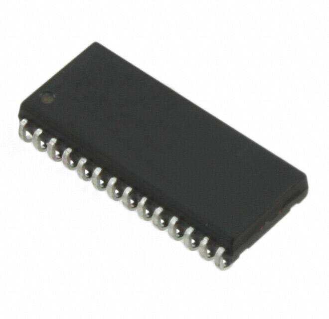

    BSOJ-28
    IC SRAM 256KBIT PARALLEL 28SOJ
71256L25YG8 数据手册
71256S 71256L CMOS Static RAM 256K (32K x 8-Bit) Features ◆ ◆ ◆ ◆ ◆ ◆ ◆ ◆ ◆ Description High-speed address/chip select time – Commercial: 20/25/35ns (max.) – Industrial: 20/25/35ns (max.) – Military: 25/35/45/55/70/85/100ns (max.) Low-power operation Battery Backup operation – 2V data retention Produced with advanced high-performance CMOS technology Input and output directly TTL-compatible Available in standard 28-pin (300 or 600 mil) ceramic DIP, 28-pin (300 mil) SOJ Military product compliant to MIL-STD-883, Class B Industrial temperature range (–40°C to +85°C) is available for selected speeds Green parts available, see ordering information The IDT 71256 is a 262,144-bit high-speed static RAM organized as 32K x 8. It is fabricated using high-performance, high-reliability CMOS technology. Address access times as fast as 20ns are available with power consumption of only 350mW (typ.). The circuit also offers a reduced power standby mode. When CS goes HIGH, the circuit will automatically go to and remain in, a low-power standby mode as long as CS remains HIGH. This capability provides significant system level power and cooling savings. The low-power (L) version also offers a battery backup data retention capability where the circuit typically consumes only 5μW when operating off a 2V battery. The IDT71256 is packaged in a 28-pin (300 or 600 mil) ceramic DIP, a 28-pin 300 mil SOJ providing high board level packing densities. The IDT71256 military RAM is manufactured in compliance with the latest revision of MIL-STD-883, Class B, making it ideally suited to military temperature applications demanding the highest level of performance and reliability. Functional Block Diagram A0 VCC 262,144 BIT MEMORY ARRAY ADDRESS DECODER GND A14 I/O0 I/O CONTROL INPUT DATA CIRCUIT I/O7 CS OE WE , CONTROL CIRCUIT 2946 drw 01 1 Aug.06.20 71256S/L CMOS Static RAM 256K (32K x 8-Bit) Military, Commercial, and Industrial Temperature Ranges Pin Configurations(1) A14 A12 A7 A6 A5 A4 A3 A2 A1 A0 I/O0 I/O1 I/O2 GND Truth Table(1) 1 28 2 27 3 26 4 25 5 6 7 8 71256S/L SD28 CD28 PJG28 9 10 VCC WE A13 A8 A9 A11 OE A10 CS I/O7 I/O6 I/O5 I/O4 I/O3 24 23 22 21 20 11 19 18 12 17 13 16 14 15 WE CS OE I/O Function X H X High-Z Standby (ISB) X VHC X High-Z Standby (ISB1) H L H High-Z Output Disabled H L L DOUT Read Data L L X DIN Write Data Absolute Maximum Ratings(1) 2946 drw 02 DIP/SOJ Top View Symbol NOTE: 1. This text does not indicate orientation of actual part-marking. Pin Descriptions Name Description A0 - A14 Address Inputs I/O0 - I/O7 Data Input/Output CS Chip Select WE Write Enable OE Output Enable GND Ground VCC Power 2946 tbl 02 NOTE: 1. H = VIH, L = VIL, X = Don't care. Rating Com'l. Ind. Mil. VTERM Terminal Voltage with Respect to GND TA Operating Temperature TBIAS Temperature Under Bias TSTG Storage Temperature PT Power Dissipation 1.0 1.0 1.0 IOUT DC Output Current 50 50 50 Unit -0.5 to +7.0 -0.5 to +7.0 -0.5 to +7.0 0 to +70 -40 to +85 V -55 to +125 o C -55 to +125 -55 to +125 -65 to +135 o C -55 to +125 -55 to +125 -65 to +150 o C W mA 2946 tbl 03 NOTE: 1. Stresses greater than those listed under ABSOLUTE MAXIMUM RATINGS may cause permanent damage to the device. This is a stress rating only and functional operation of the device at these or any other conditions above those indicated in the operational sections of this specification is not implied. Exposure to absolute maximum rating conditions for extended periods may affect reliability. 2946 tbl 01 Capacitance (TA = +25°C, f = 1.0MHz) Symbol Parameter(1) CIN Input Capacitance CI/O I/O Capacitance Conditions Max. Unit VIN = 0V 11 pF VOUT = 0V 11 pF 2946 tbl 04 NOTE: 1. This parameter is determined by device characterization, but is not production tested. 2 Aug.06.20 71256S/L CMOS Static RAM 256K (32K x 8-Bit) Military, Commercial, and Industrial Temperature Ranges Recommended DC Operating Conditions Recommended Operating Temperature and Supply Voltage Grade Temperature GND Vcc Symbol Military -55OC to +125OC 0V 5V ± 10% VCC Supply Voltage Industrial -40OC to +85OC 0V 5V ± 10% GND Ground 0 C to +70 C 0V 5V ± 10% VIH VIL Commercial O O 2946 tbl 05 Parameter Min. Typ. Max. Unit 4.5 5.0 5.5 V 0 0 0 V Input High Voltage 2.2 ____ 6.0 V Input Low Voltage -0.5(1) ____ 0.8 V NOTE: 1. VIL (min.) = –3.0V for pulse width less than 20ns, once per cycle. 2946 tbl 06 DC Electrical Characteristics(1,2) (VCC = 5.0V ± 10%, VLC = 0.2V, VHC = VCC - 0.2V) 71256S/L20 Power Symbol Parameter ICC ISB ISB1 71256S/L25 Com'l. & Ind Com'l & Ind Mi l . 71256S/L35 Com'l. & Ind Mi l . 71256S/L45 Mi l . Unit Dynamic Op e rating Curre nt CS < VIL, Outp uts Op e n VCC = Max., fMAX(2) S ____ ____ 150 ____ 140 135 L 135 125 130 115 120 115 Stand b y Po we r Sup p ly Curre nt (TTL Le ve l), CS > VIH, VCC = Max., Outp uts Op e n, f = fMAX(2) S ____ ____ 20 ____ 20 20 L 3 3 3 3 3 3 Full Stand b y Po we r Sup p ly Curre nt (CMOS Le ve l), CS > VHC, VCC = Max., f = 0 S ____ ____ 20 ____ 20 20 L 0.6 0.6 1.5 0.6 1.5 1.5 mA mA mA 2946 tb l 07 71256S/L55 71256S/L70 71256S/L85 71256S/L100 Power Mil. Mil. Mil. Mil. Unit Dynamic Operating Current CS < VIL, Outputs Open VCC = Max., fMAX(2) S 135 135 135 135 mA L 115 115 115 115 Standby Power Supply Current (TTL Level), CS > VIH, VCC = Max., Outputs Open, f = fMAX(2) S 20 20 20 20 L 3 3 3 3 Full Standby Power Supply Current (CMOS Level), CS > VHC, VCC = Max., f = 0 S 20 20 20 20 L 1.5 1.5 1.5 1.5 Symbol ICC ISB ISB1 Parameter NOTES: 1. All values are maximum guaranteed values. 2. fMAX = 1/tRC, all address inputs are cycling at fMAX; f = 0 means no address pins are cycling. 6.42 3 Aug.06.20 mA mA 2946 tbl 08 71256S/L CMOS Static RAM 256K (32K x 8-Bit) Military, Commercial, and Industrial Temperature Ranges AC Test Conditions Input Pulse Levels GND to 3.0V Input Rise/Fall Times 5ns Input Timing Reference Levels 1.5V Output Reference Levels 1.5V AC Test Load See Figures 1 and 2 2946 tbl 09 5V 5V 480Ω 480Ω DATA OUT DATA OUT 30pF* 255Ω 5pF* 255Ω , , 2946 drw 04 2946 drw 05 Figure 1. AC Test Load Figure 2. AC Test Load (for tCLZ, tOLZ, tCHZ, tOHZ, tOW, and tWHZ) *Includes scope and jig capacitances DC Electrical Characteristics (VCC = 5.0V ± 10%) IDT71256S Symbol Parameter Test Conditions IDT71256L Min. Typ. Max. Min. Typ. Max. Unit ____ 10 5 ____ ____ ____ ____ 5 2 µA 10 5 ____ ____ ____ ____ 5 2 µA V |ILI| Input Leakage Current VCC = Max., VIN = GND to VCC MIL. COM"L & IND. ____ ____ ____ |ILO| Output Leakage Current VCC = Max., CS = VIH, VOUT = GND to V CC MIL. COM"L & IND. ____ ____ ____ ____ VOL Output Low Voltage IOL = 8mA, VCC = Min. ____ ____ 0.4 ____ ____ 0.4 IOL = 10mA, VCC = Min. ____ ____ 0.5 ____ ____ 0.5 IOH = -4mA, VCC = Min. 2.4 ____ ____ 2.4 ____ ____ VOH Output High Voltage V 2946 tbl 10 Data Retention Characteristics Over All Temperature Ranges (L Version Only) (VLC = 0.2V, VHC = VCC - 0.2V) Max. VCC @ Typ.(1) VCC @ Symbol Parameter VDR VCC for Data Retention ICCDR Data Retention Current tCDR Chip Deselect to Data Retention Time tR(3) Operation Recovery Time Test Condition Min. 2.0V 3.0V 2.0V 3.0V Unit ____ 2.0 ____ ____ ____ ____ V ____ ____ ____ ____ ____ ____ 500 120 800 200 μA 0 ____ ____ ____ ____ ns tRC(2) ____ ____ ____ ____ ns MIL. COM'L. & IND. CS > VHC NOTES: 1. TA = +25°C. 2. tRC = Read Cycle Time. 3. This parameter is guaranteed by device characterization, but is not production tested. 4 Aug.06.20 2946 tbl 11 71256S/L CMOS Static RAM 256K (32K x 8-Bit) Military, Commercial, and Industrial Temperature Ranges Low VCC Data Retention Waveform DATA RETENTION MODE VCC 4.5V VDR ≥ 2V tCDR CS 4.5V VIH tR VIH VDR 2946 drw 06 AC Electrical Characteristics (VCC = 5.0V ± 10%, All Temperature Ranges) 71256L20(1) Symbol Parameter 71256S25 71256L25 71256S35 71256L35 71256S45(3) 71256L45(3) Min. Max. Min. Max. Min. Max. Min. Max. Unit Read Cycle tRC Read Cycle Time 20 ____ 25 ____ 35 ____ 45 ____ ns tAA Address Access Time ____ 20 ____ 25 ____ 35 ____ 45 ns tACS Chip Select Access Time ____ 20 ____ 25 ____ 35 ____ 45 ns tCLZ(2) Chip Select to Output in Low-Z 5 ____ 5 ____ 5 ____ 5 ____ ns tCHZ(2) Chip Desele ct to Output in High-Z ____ 10 ____ 11 ____ 15 ____ 20 ns tOE Output Enable to Output Valid ____ 10 ____ 11 ____ 15 ____ 20 ns tOLZ(2) Output Enab le to Output in Low-Z 2 ____ 2 ____ 2 ____ 0 ____ ns tOHZ(2) Output Disab le to Output in High-Z 2 8 2 10 2 15 ____ 20 ns tOH Output Hold from Address Change 5 ____ 5 ____ 5 ____ 5 ____ ns Write Cycle tWC Write Cycle Time 20 ____ 25 ____ 35 ____ 45 ____ ns tCW Chip Select to End-of-Write 15 ____ 20 ____ 30 ____ 40 ____ ns tAW Address Valid to End-of-Write 15 ____ 20 ____ 30 ____ 40 ____ ns tAS Address Set-up Time 0 ____ 0 ____ 0 ____ 0 ____ ns tWP Write Pulse Width 15 ____ 20 ____ 30 ____ 35 ____ ns tWR Write Recovery Time 0 ____ 0 ____ 0 ____ 0 ____ ns tDW Data to Write Time Overlap 11 ____ 13 ____ 15 ____ 20 ____ ns ____ 10 ____ 11 ____ 15 ____ 20 ns (2) tWHZ Write Enab le to Output in High-Z tDH Data Hold from Write Time 0 ____ 0 ____ 0 ____ 0 ____ ns tOW(2) Output Active from End-of-Write 5 ____ 5 ____ 5 ____ 5 ____ ns NOTES: 1. 0° to +70°C or -40° to +85°C temperature range only. 2. This parameter is guaranteed by device characterization, but is not production tested. 3. –55°C to +125°C temperature range only. 6.42 5 Aug.06.20 2946 tbl 12 71256S/L CMOS Static RAM 256K (32K x 8-Bit) Military, Commercial, and Industrial Temperature Ranges AC Electrical Characteristics (VCC = 5.0V ± 10%, Military Temperature Ranges) 71256S55(1) 71256L55(1) Symbol Parameter 71256S70(1) 71256L70(1) 71256S85(1) 71256L85(1) 71256S100(1) 71256L100(1) Min. Max. Min. Max. Min. Max. Min. Max. Unit Read Cycle tRC Read Cycle Time 55 ____ 70 ____ 85 ____ 100 ____ ns tAA Address Access Time ____ 55 ____ 70 ____ 85 ____ 100 ns tACS Chip Select Access Time ____ 55 ____ 70 ____ 85 ____ 100 ns tCLZ(2) Chip Select to Output in Low-Z 5 ____ 5 ____ 5 ____ 5 ____ ns tCHZ(2) Chip Desele ct to Output in High-Z ____ 25 ____ 30 ____ 35 ____ 40 ns tOE Output Enable to Output Valid ____ 25 ____ 30 ____ 35 ____ 40 ns tOLZ(2) Output Enab le to Output in Low-Z 0 ____ 0 ____ 0 ____ 0 ____ ns tOHZ(2) Output Disab le to Output in High-Z 0 25 0 30 ____ 35 ____ 40 ns tOH Output Hold from Address Change 5 ____ 5 ____ 5 ____ 5 ____ ns Write Cycle tWC Write Cycle Time 55 ____ 70 ____ 85 ____ 100 ____ ns tCW Chip Select to End-of-Write 50 ____ 60 ____ 70 ____ 80 ____ ns tAW Address Valid to End-of-Write 50 ____ 60 ____ 70 ____ 80 ____ ns tAS Address Set-up Time 0 ____ 0 ____ 0 ____ 0 ____ ns tWP Write Pulse Width 40 ____ 45 ____ 50 ____ 55 ____ ns tWR Write Recovery Time 0 ____ 0 ____ 0 ____ 0 ____ ns tDW Data to Write Time Overlap 25 ____ 30 ____ 35 ____ 40 ____ ns tWHZ(2) Write Enab le to Output in High-Z ____ 25 ____ 30 ____ 35 ____ 40 ns tDH Data Hold from Write Time (WE) 0 ____ 0 ____ 0 ____ 0 ____ ns tOW(2) Output Active from End-of-Write 5 ____ 5 ____ 5 ____ 5 ____ NOTES: 1. -55° to +125°C temperature range only. 2. This parameter is guaranteed by device characterization, but is not production tested. 6 Aug.06.20 ns 2946 tbl 13 71256S/L CMOS Static RAM 256K (32K x 8-Bit) Military, Commercial, and Industrial Temperature Ranges Timing Waveform of Read Cycle No. 1(1) tRC ADDRESS tOH tAA OE tOE tOLZ (5) tOHZ(5) CS tACS tCHZ(5) tCLZ (5) DATAOUT 2946 drw 07 Timing Waveform of Read Cycle No. 2(1,2,4) tRC ADDRESS tAA tOH tOH DATAOUT , 2946 drw 08 Timing Waveform of Read Cycle No. 2(1,3,4) CS tACS tCHZ(5) tCLZ (5) DATAOUT 2946 drw 09 NOTES: 1. WE is HIGH for Read Cycle. 2. Device is continuously selected, CS is LOW. 3. Address valid prior to or coincident with CS transition LOW. 4. OE is LOW. 5. Transition is measured ±200mV from steady state. 6.42 7 Aug.06.20 71256S/L CMOS Static RAM 256K (32K x 8-Bit) Military, Commercial, and Industrial Temperature Ranges Timing Waveform of Write Cycle No. 1 (WE Controlled Timing)(1,2,4,6) t WC ADDRESS tOHZ (5) OE tAW CS (6) t WR t WP t AS WE tWZ (5) t OW (3) DATAOUT (3) tDW tDH DATAIN 2946 drw 10 Timing Waveform of Write Cycle No. 2 (CS Controlled Timing)(1,2,4) tWC ADDRESS tAW CS t AS tCW(6) t WR WE t DW tDH2 DATA IN 2946 drw 11 NOTES: 1. A write occurs during the overlap of a LOW CS and a LOW WE. 2. tWR is measured from the earlier of CS or WE going HIGH to the end of the write cycle. 3. During this period, I/O pins are in the output state so that the input signals must not be applied. 4. If the CS LOW transition occurs simultaneously with or after the WE LOW transition, the outputs remain in a high-impedance state. 5. Transition is measured ±200mV from steady state. 6. If OE is LOW during a WE controlled write cycle, the write pulse width must be the larger of tWP or (tWHZ +tDW) to allow the I/O drivers to turn off and data to be placed on the bus for the required tDW. If OE is HIGH during a WE controlled write cycle, this requirement does not apply and the minimum write pulse width can be as short as the specified tWP. For a CS controlled write cycle, OE may be LOW with no degradation to tCW. 8 Aug.06.20 71256S/L CMOS Static RAM 256K (32K x 8-Bit) Military, Commercial, and Industrial Temperature Ranges Ordering Information — Commercial & Industrial 71256 Device Type X XX XXX X Power Speed Package X X Process/ Temperature Range Blank 8 Tube Tape and Reel Blank I(1) Commercial (0°C to +70°C) Industrial (-40°C to +85°C) (2) G Green Y 300 mil SOJ (PJG28) 20 25 35 Speed in nanoseconds L Low Power 2946 drw 13 NOTES: 1. Contact your local sales office for Industrial temp range for other speeds, packages and powers. 2. Green parts available. For specific speeds, packages and powers contact your local sales office. Ordering Information — Military 71256 X XXX XXX X Device Type Power Speed Package Process/ Temperature Range X Blank Tube B Military (–55°C to +125°C) Compliant to MIL-STD-883, Class B TD D 300 mil CERDIP (SD28) 600 mil CERDIP (CD28) 25 35 45 55 70 85 100 S L 6.42 9 Aug.06.20 Speed in nanoseconds Standard Power Low Power 2946 drw 12 71256S/L CMOS Static RAM 256K (32K x 8-Bit) Military, Commercial, and Industrial Temperature Ranges Orderable Part Information Speed (ns) 20 25 35 Pkg. Code Pkg. Type Temp. Grade Speed (ns) 71256L20YG PJG28 SOJ C 25 71256L20YG8 PJG28 SOJ C 71256L20YGI PJG28 SOJ I Orderable Part ID 71256L20YGI8 PJG28 SOJ I 71256L25DB CD28 CDIP M 71256L25TDB SD28 CDIP M 71256L25YG PJG28 SOJ C 71256L25YG8 PJG28 SOJ C 71256L25YGI PJG28 SOJ I 71256L25YGI8 PJG28 SOJ I 71256L35DB CD28 CDIP M 71256L35TDB SD28 CDIP M 71256L35YG PJG28 SOJ C 71256L35YG8 PJG28 SOJ C 71256L35YGI PJG28 SOJ I 71256L35YGI8 PJG28 SOJ I 71256L45DB CD28 CDIP M 71256L45TDB SD28 CDIP M 71256L55DB CD28 CDIP M 71256L55TDB SD28 CDIP M 70 71256L70DB CD28 CDIP M 71256L70TDB SD28 CDIP M 85 71256L85DB CD28 CDIP M 71256L85TDB SD28 CDIP M 71256L100DB CD28 CDIP M 71256L100TDB SD28 CDIP M 45 55 100 Pkg. Type Temp. Grade 71256S25DB CD28 CDIP M 71256S25TDB SD28 CDIP M 35 71256S35DB CD28 CDIP M 71256S35TDB SD28 CDIP M 45 71256S45DB CD28 CDIP M 71256S45TDB SD28 CDIP M 71256S55DB CD28 CDIP M 71256S55TDB SD28 CDIP M 71256S70DB CD28 CDIP M 71256S70TDB SD28 CDIP M 71256S85DB CD28 CDIP M 71256S85TDB SD28 CDIP M 71256S100DB CD28 CDIP M 71256S100TDB SD28 CDIP M 55 70 85 100 10 Aug.06.20 Pkg. Code Orderable Part ID 71256S/L CMOS Static RAM 256K (32K x 8-Bit) Military, Commercial, and Industrial Temperature Ranges Datasheet Document History 11/4/99: Updated to new format Added Industrial Temperature Range offerings Removed 30, 120, and 150ns military and 45ns commercial speed grade offerings. Removed P28-2 package from DIP/SOJ Top View Removed 30ns and 45ns (Commercial only) speed grade offerings from DC Electrical table Revised notes and footnotes Pg. 5 Removed 30ns speed grade offering from AC Electrical table Revised notes and footnotes Pg. 6 Expressed Military Temperature range on AC Electrical table Revised notes and footnotes Pg. 8 Removed Note 1 and renumbered notes and footnotes Pg. 9 Revised Ordering Information and presented by temperature range offering Pg. 10 Added Datasheet Document History Not recommended for new designs Remove "Not recommended for new designs" Pg. 3 Changed power limits for commercial and industrial. Refer to PCN SR-0602-03. Added Restricted hazardous substance device to ordering information. Pg. 2,9 Corrected typo on pin 21 in 32-Pin LCC diagram. Updated the ordering information by removing the "IDT" notation. Pg. 1, 2, 5, 9 Added 20ns to Industrial offering. Obsoleted 28-pin 600 mil, 32-pin LCC and Added Tape and Reel to Ordering information and updated description of Restricted hazardous substance device to Green. Pg. 1 In the Description: removed IDT’s reference to fabrication and removed the sentence "In the full standby mode, the low-power device consumes less than 15µW, typically". Pg. 1 - 12 Rebranded as Renesas datasheet Pg.1 & 9 Updated Indusrial temp and green availability Pg. 2 & 9 Updated package codes Pg. 10 Added Orderable Part Information tables Pg. 1–5, 9 Pg. 1 Pg. 2 Pg. 3 08/09/00: 02/01/01: 11/15/06: 11/01/08: 04/28/11: 09/26/13: 08/06/20: 6.42 11 Aug.06.20 IMPORTANT NOTICE AND DISCLAIMER RENESAS ELECTRONICS CORPORATION AND ITS SUBSIDIARIES (“RENESAS”) PROVIDES TECHNICAL SPECIFICATIONS AND RELIABILITY DATA (INCLUDING DATASHEETS), DESIGN RESOURCES (INCLUDING REFERENCE DESIGNS), APPLICATION OR OTHER DESIGN ADVICE, WEB TOOLS, SAFETY INFORMATION, AND OTHER RESOURCES “AS IS” AND WITH ALL FAULTS, AND DISCLAIMS ALL WARRANTIES, EXPRESS OR IMPLIED, INCLUDING, WITHOUT LIMITATION, ANY IMPLIED WARRANTIES OF MERCHANTABILITY, FITNESS FOR A PARTICULAR PURPOSE, OR NON-INFRINGEMENT OF THIRD PARTY INTELLECTUAL PROPERTY RIGHTS. These resources are intended for developers skilled in the art designing with Renesas products. You are solely responsible for (1) selecting the appropriate products for your application, (2) designing, validating, and testing your application, and (3) ensuring your application meets applicable standards, and any other safety, security, or other requirements. These resources are subject to change without notice. Renesas grants you permission to use these resources only for development of an application that uses Renesas products. Other reproduction or use of these resources is strictly prohibited. No license is granted to any other Renesas intellectual property or to any third party intellectual property. Renesas disclaims responsibility for, and you will fully indemnify Renesas and its representatives against, any claims, damages, costs, losses, or liabilities arising out of your use of these resources. Renesas' products are provided only subject to Renesas' Terms and Conditions of Sale or other applicable terms agreed to in writing. No use of any Renesas resources expands or otherwise alters any applicable warranties or warranty disclaimers for these products. (Rev.1.0 Mar 2020) Corporate Headquarters Contact Information TOYOSU FORESIA, 3-2-24 Toyosu, Koto-ku, Tokyo 135-0061, Japan www.renesas.com For further information on a product, technology, the most up-to-date version of a document, or your nearest sales office, please visit: www.renesas.com/contact/ Trademarks Renesas and the Renesas logo are trademarks of Renesas Electronics Corporation. All trademarks and registered trademarks are the property of their respective owners. © 2020 Renesas Electronics Corporation. All rights reserved.
