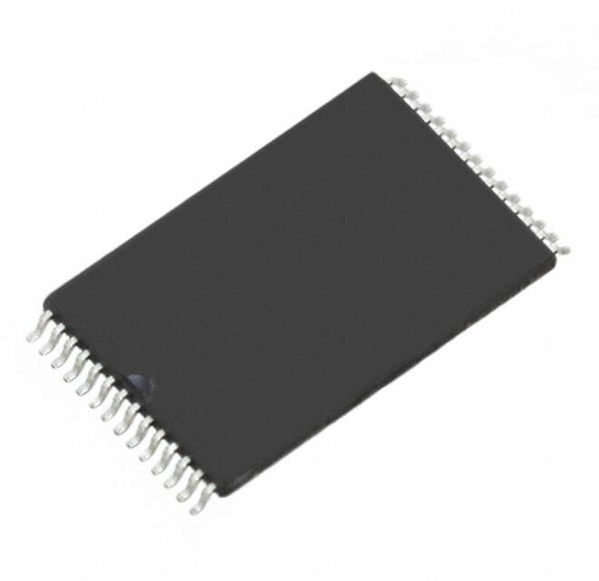

Lower Power 3.3V CMOS Fast SRAM 256K (32K x 8-Bit) Features ◆ ◆ ◆ ◆ ◆ ◆ ◆ ◆ ◆ ◆ 71V256SA Description Ideal for high-performance processor secondary cache Commercial (0°C to +70°C) and Industrial (–40°C to +85°C) temperature range options Fast access times: – Commercial and Industrial: 12/15/20ns Low standby current (maximum): – 2mA full standby Small packages for space-efficient layouts: – 28-pin 300 mil SOJ – 28-pin TSOP Type I Produced with advanced high-performance CMOS technology Inputs and outputs are LVTTL-compatible Single 3.3V(±0.3V) power supply Industrial temperature range (–40°C to +85°C) is available for selected speeds Green parts available, see ordering information The IDT71V256SA is a 262,144-bit high-speed static RAM organized as 32K x 8. It is fabricated using a high-performance, high-reliability CMOS technology. The IDT71V256SA has outstanding low power characteristics while at the same time maintaining very high performance. Address access times of as fast as 12ns are ideal for 3.3V secondary cache in 3.3V desktop designs. When power management logic puts the IDT71V256SA in standby mode, its very low power characteristics contribute to extended battery life. By taking CS HIGH, the SRAM will automatically go to a low power standby mode and will remain in standby as long as CS remains HIGH. Furthermore, under full standby mode (CS at CMOS level, f=0), power consumption is guaranteed to always be less than 6.6mW and typically will be much smaller. The IDT71V256SA is packaged in a 28-pin 300 mil SOJ and a 28-pin 300 mil TSOP Type I. Functional Block Diagram A0 VCC 262,144 BIT MEMORY ARRAY ADDRESS DECODER GND A14 I/O0 I/O CONTROL INPUT DATA CIRCUIT I/O7 CS OE WE , CONTROL CIRCUIT 3101 drw 01 1 Jun.02.20 71V256SA 3.3V CMOS Static RAM 256K (32K x 8-Bit) Commercial and Industrial Temperature Ranges Truth Table(1) Pin Configurations(1) A14 A12 A7 A6 A5 A4 A3 A2 A1 A0 I /O 0 I /O 1 I /O 2 GN D 1 28 2 27 3 26 4 25 5 24 6 7 1 V 2 5 6 SA PJ G2 8 2 3 7 22 8 21 9 20 10 19 11 18 12 17 13 16 14 15 DIP/SOJ Top View OE A11 A9 A8 A13 WE VCC A14 A12 A7 A6 A5 A4 A3 V CC WE A13 A8 A9 A11 OE A10 CS I /O 7 I /O 6 I /O 5 I /O 4 I /O 3 OE I/O X H X High-Z Standby (ISB) X VHC X High-Z Standby (ISB1) H L H High-Z Output Disable H L L DOUT Read L L X DIN Write Function 3101 tbl 02 Absolute Maximum Ratings(1) Symbol Rating Com'l Unit 3101 drw 02 21 23 20 24 19 25 18 26 17 28 CS NOTE: 1. H = VIH, L = VIL, X = Don’t Care 22 27 WE 16 71V256SA PZG28 15 1 14 2 13 3 12 4 11 5 10 6 9 7 8 A10 CS I/O7 I/O6 I/O5 I/O4 I/O3 GND I/O2 I/O1 I/O0 A0 A1 A2 Supply Voltage Relative to GND -0.5 to +4.6 V VTERM(2) Terminal Voltage Relative to GND -0.5 to VCC+0.5 V TBIAS Temperature Under Bias -55 to +125 o C TSTG Storage Temperature -55 to +125 o C PT Power Dissipation 1.0 W IOUT DC Output Current 50 mA 3101 tbl 03 NOTES: 1. Stresses greater than those listed under ABSOLUTE MAXIMUM RATINGS may cause permanent damage to the device. This is a stress rating only and functional operation of the device at these or any other conditions above those indicated in the operational sections of this specification is not implied. Exposure to absolute maximum rating conditions for extended periods may affect reliability. 2. Input, Output, and I/O terminals; 4.6V maximum. 3101 drw 03 TSOP Top View VCC Capacitance NOTE: 1. This text does not indicate orientation of actual part-marking. (TA = +25°C, f = 1.0MHz, SOJ package) Parameter(1) Symbol Pin Descriptions Name Description A0 - A14 Addresses I/O0 - I/O7 Data Input/Output CS Chip Select WE Write Enable OE Output Enable GND Ground VCC Power CIN Input Capacitance COUT Output Capacitance Conditions Max. Unit VIN = 3dV 6 pF VOUT = 3dV 7 pF 3101 tbl 04 NOTE: 1. This parameter is determined by device characterization, but is not production tested. Recommended Operating Temperature and Supply Voltage Grade Commercial Industrial 3101 tbl 01 Temperature GND Vcc 0OC to +70OC 0V 3.3V ± 0.3V -40OC to +85OC 0V 3.3V ± 0.3V 3101 tbl 05 2 Jun.02.20 71V256SA 3.3V CMOS Static RAM 256K (32K x 8-Bit) Commercial and Industrial Temperature Ranges Recommended DC Operating Conditions Symbol Parameter Min. Typ. Max. Unit 3.0 3.3 3.6 V 0 0 0 V VCC Supply Voltage GND Ground VIH Input High Voltage - Inputs 2.0 ____ VCC +0.3 V VIH Input High Voltage - I/O 2.0 ____ VCC +0.3 V ____ 0.8 V VIL Input Low Voltage (1) -0.3 NOTE: 1. VIL (min.) = –2.0V for pulse width less than 5ns, once per cycle. 3101 tbl 06 DC Electrical Characteristics(1) (VCC = 3.3V ± 0.3V, VLC = 0.2V, VHC = VCC - 0.2V, Commercial and Industrial Temperature Ranges) Symbol Parameter 71V256SA12 71V256SA15 71V256SA20 Unit ICC Dynamic Operating Current CS < V IL, Outputs Open, V CC = Max., f = fMAX(2) 90 85 85 mA ISB Standby Power Supply Current (TTL Level) CS = V IH, V CC = Max., Outputs Open, f = fMAX(2) 20 20 20 mA ISB1 Full Standby Power Supply Current (CMOS Level) CS > V HC, V CC = Max., Outputs Open, f = 0(2), V IN < V LC or V IN > V HC 2 2 2 mA 3101 tbl 07 NOTES: 1. All values are maximum guaranteed values. 2. fMAX = 1/tRC, only address inputs cycling at fMAX; f = 0 means that no inputs are cycling. DC Electrical Characteristics (VCC = 3.3V± 0.3V) IDT71V256SA Symbol Parameter Test Conditions Min. Typ. Max. Unit |ILI| Input Leakage Current VCC = Max., VIN = GND to VCC ___ ___ 2 µA |ILO| Output Leakage Current VCC = Max., CS = VIH, VOUT = GND to V CC ___ ___ 2 µA VOL Output Low Voltage IOL = 8mA, VCC = Min. ___ ___ 0.4 V VOH Output High Voltage IOH = -4mA, VCC = Min. 2.4 ___ ___ V 3101 tbl 08 6.42 3 Jun.02.20 71V256SA 3.3V CMOS Static RAM 256K (32K x 8-Bit) Commercial and Industrial Temperature Ranges AC Test Conditions Input Pulse Levels GND to 3.0V Input Rise/Fall Times 3ns Input Timing Reference Levels 1.5V Output Reference Levels 1.5V AC Test Load See Figures 1 and 2 3101 tbl 09 3.3V 3.3V 320Ω 320Ω DATA OUT 350Ω DATA OUT 30pF* 350Ω , 5pF* , 3101 drw 04 3101 drw 05 Figure 1. AC Test Load *Includes scope and jig capacitances Figure 2. AC Test Load (for tCLZ, tOLZ, tCHZ, tOHZ, tOW, tWHZ) AC Electrical Characteristics (VCC = 3.3V ± 0.3V, Commercial and Industrial Temperature Ranges) Symbol Parameter 71V256SA12 71V256SA15 71V256SA20 Min. Max. Min. Max. Min. Max. Unit Read Cycle tRC Read Cycle Time 12 ____ 15 ____ 20 ____ ns tAA Address Access Time ____ 12 ____ 15 ____ 20 ns tACS Chip Select Access Time ____ 12 ____ 15 ____ 20 ns tCLZ(1) Chip Select to Output in Low-Z 5 ____ 5 ____ 5 ____ ns tCHZ(1) Chip Select to Output in High-Z tOE Output Enable to Output Valid 0 8 0 9 0 10 ns ____ 6 ____ 7 ____ 8 ns ____ 0 ____ 0 ____ ns (1) Output Enable to Output in Low-Z 3 (1) tOHZ Output Disable to Output in High-Z 2 6 0 7 0 8 ns tOH Output Hold from Address Change 3 ____ 3 ____ 3 ____ ns tOLZ Write Cycle tWC Write Cycle Time 12 ____ 15 ____ 20 ____ ns tAW Address Valid to End-of-Write 9 ____ 10 ____ 15 ____ ns tCW Chip Select to End-of-Write 9 ____ 10 ____ 15 ____ ns tAS Address Set-up Time 0 ____ 0 ____ 0 ____ ns tWP Write Pulse Width 9 ____ 10 ____ 15 ____ ns tWR Write Recovery Time 0 ____ 0 ____ 0 ____ ns tDW Data to Write Time Overlap 6 ____ 7 ____ 8 ____ ns tDH Data Hold from Write Time 0 ____ 0 ____ 0 ____ ns tOW(1) Output Active from End-of-Write 4 ____ 4 ____ 4 ____ ns tWHZ(1) Write Enable to Output in High-Z 1 8 1 9 1 10 ns 3101 tbl 10 NOTE: 1. This parameter guaranteed with the AC test load (Figure 2) by device characterization, but is not production tested. 4 Jun.02.20 71V256SA 3.3V CMOS Static RAM 256K (32K x 8-Bit) Commercial and Industrial Temperature Ranges Timing Waveform of Read Cycle No. 1(1) t RC ADDRESS t AA t OH OE t OE t OLZ (2) t OHZ (2) t CHZ (2) CS t ACS t CLZ (2) DATAOUT DATA VALID 3101 drw 06 , NOTES: 1. WE is HIGH for Read cycle. 2. Transition is measured ±200mV from steady state. Timing Waveform of Read Cycle No. 2(1,2,4) t RC ADDRESS t AA t OH DATAOUT t OH PREVIOUS DATA VALID DATA VALID 3101 drw 07 , Timing Waveform of Read Cycle No. 3(1,3,4) CS t ACS t CLZ t CHZ (5) (5) DATA VALID DATAOUT 3101 drw 08 NOTES: 1. WE is HIGH for Read cycle. 2. Device is continuously selected, CS is LOW. 3. Address valid prior to or coincident with CS transition LOW. 4. OE is LOW. 5. Transition is measured ±200mV from steady state. 6.42 5 Jun.02.20 , 71V256SA 3.3V CMOS Static RAM 256K (32K x 8-Bit) Commercial and Industrial Temperature Ranges Timing Waveform of Write Cycle No. 1 (WE Controlled Timing)(1,2,4,6) t WC ADDRESS t OHZ (5) OE t AW CS t WP (6) t AS t WR WE t WHZ (5) DATAOUT t OW (5) (3) (3) t DW t DH DATA VALID DATAIN 3101 drw 09 , NOTES: 1. A write occurs during the overlap of a LOW CS and a LOW WE. 2. tWR is measured from the earlier of CS or WE going HIGH to the end of the write cycle. 3. During this period, I/O pins are in the output state so that the input signals must not be applied. 4. If the CS LOW transition occurs simultaneously with or after the WE LOW transition, the outputs remain in a high-impedance state. 5. Transition is measured ±200mV from steady state. 6. If OE is LOW during a WE controlled write cycle, the write pulse width must be the larger of tWP or (tWHZ + tDW) to allow the I/O drivers to turn off and data to be placed on the bus for the required tDW. If OE is HIGH during a WE controlled write cycle, this requirement does not apply and the write pulse can be as short as the specified tWP. Timing Waveform of Write Cycle No. 2 (CS Controlled Timing)(1,2,3,4) t WC ADDRESS t AW CS tAS t CW (5) tWR WE t DW t DH DATA VALID DATAIN 3101 drw 10 NOTES: 1. WE or CS must be HIGH during all address transitions. 2. A write occurs during the overlap of a LOW CS and a LOW WE. 3. tWR is measured from the earlier of CS or WE going HIGH to the end of the write cycle. 4. If the CS LOW transition occurs simultaneously with or after the WE LOW transition, the outputs remain in a high-impedance state. 5. If OE is LOW during a WE controlled write cycle, the write pulse width must be the larger of tWP or (tWHZ + tDW) to allow the I/O drivers to turn off and data to be placed on the bus for the required tDW. If OE is HIGH during a WE controlled write cycle, this requirement does not apply and the write pulse can be as short as the specified tWP. 6 Jun.02.20 , 71V256SA 3.3V CMOS Static RAM 256K (32K x 8-Bit) Commercial and Industrial Temperature Ranges Ordering Information 71V256 SA XX X Device Type Power Speed Package X X X Process/ Temperature Range Blank 8 Tube or Tray Tape & Reel Blank I(1) Commercial (0°C to +70°C) Industrial (–40°C to +85°C) G Green Y PZ 300 mil SOJ (PJG28) TSOP Type I (PZG28) 12 15 20* Speed in nanoseconds * Available in TSOP package only. NOTE: 1. Contact your local sales office for industrial temp. range for other speeds, packages and powers. Orderable Part Information Speed (ns) 12 15 20 Pkg. Code Pkg. Type Temp. Grade 71V256SA12PZG PZG28 TSOP C 71V256SA12PZG8 PZG28 TSOP C 71V256SA12PZGI PZG28 TSOP I 71V256SA12PZGI8 PZG28 TSOP I 71V256SA12YG PJG28 SOJ C 71V256SA12YG8 PJG28 SOJ C 71V256SA12YGI PJG28 SOJ I 71V256SA12YGI8 PJG28 SOJ I 71V256SA15PZG PZG28 TSOP C 71V256SA15PZG8 PZG28 TSOP C 71V256SA15PZGI PZG28 TSOP I 71V256SA15PZGI8 PZG28 TSOP I Orderable Part ID 71V256SA15YG PJG28 SOJ C 71V256SA15YG8 PJG28 SOJ C 71V256SA15YGI PJG28 SOJ I 71V256SA15YGI8 PJG28 SOJ I 71V256SA20PZG PZG28 TSOP C 71V256SA20PZG8 PZG28 TSOP C 71V256SA20PZGI PZG28 TSOP I 71V256SA20PZGI8 PZG28 TSOP I 6.42 7 Jun.02.20 3101 drw 11 71V256SA 3.3V CMOS Static RAM 256K (32K x 8-Bit) Commercial and Industrial Temperature Ranges Datasheet Document History 1/7/00 Pg. 1, 3, 4, 7 Pg. 1, 2, 7 Pg. 6 Pg. 7 Pg. 8 08/09/00 02/01/01 06/21/02 01/30/04 02/20/09 06/11/12 07/24/14 08/18/15 06/02/20 Pg. 7 Pg. 7 Pg. 7 Pg. 3 Pg. 7 Pg. 7 Pg.7 Pg.1 & 7 Pg.2 & 7 Pg. 3 & 4 Pg.7 Pg.1 - 9 Pg.2 & 7 Pg.7 Updated to new format Expanded Industrial Temperature offerings Removed 28-pin 300 mil plastic DIP package offering Removed Note No. 1 from Write Cycle No. 1 diagram; renumbered notes and footnotes Revised Ordering Information Added Datasheet Document History Not recommended for new designs Removed "Not recommended for new designs" Added tape and reel option to the ordering information Added "restricted hazardous substance device" to order information. Removed "IDT" from ordering parts Corrected Recommended DC Operation Conditions Max VIH from 5.0 to Vcc+0.3V Added Green designator to ordering information Corrected footnote in the ordering information from "available in SOJ package only" to "available in TSOP package only" Added tube or tray to the ordering information Removed commercial 10ns speed offering & added green parts available to features Removed "-X"extensions from all pin configurations SOJ28 & TSOP28 Removed commercial 10ns speed offering columns from the DC & AC Elec tables Updated the Industrial and Green footnotes in the Ordering Information Rebranded as Renesas datasheet Updated package codes Added Orderable Part Information 8 Jun.02.20 IMPORTANT NOTICE AND DISCLAIMER RENESAS ELECTRONICS CORPORATION AND ITS SUBSIDIARIES (“RENESAS”) PROVIDES TECHNICAL SPECIFICATIONS AND RELIABILITY DATA (INCLUDING DATASHEETS), DESIGN RESOURCES (INCLUDING REFERENCE DESIGNS), APPLICATION OR OTHER DESIGN ADVICE, WEB TOOLS, SAFETY INFORMATION, AND OTHER RESOURCES “AS IS” AND WITH ALL FAULTS, AND DISCLAIMS ALL WARRANTIES, EXPRESS OR IMPLIED, INCLUDING, WITHOUT LIMITATION, ANY IMPLIED WARRANTIES OF MERCHANTABILITY, FITNESS FOR A PARTICULAR PURPOSE, OR NON-INFRINGEMENT OF THIRD PARTY INTELLECTUAL PROPERTY RIGHTS. These resources are intended for developers skilled in the art designing with Renesas products. You are solely responsible for (1) selecting the appropriate products for your application, (2) designing, validating, and testing your application, and (3) ensuring your application meets applicable standards, and any other safety, security, or other requirements. These resources are subject to change without notice. Renesas grants you permission to use these resources only for development of an application that uses Renesas products. Other reproduction or use of these resources is strictly prohibited. No license is granted to any other Renesas intellectual property or to any third party intellectual property. Renesas disclaims responsibility for, and you will fully indemnify Renesas and its representatives against, any claims, damages, costs, losses, or liabilities arising out of your use of these resources. Renesas' products are provided only subject to Renesas' Terms and Conditions of Sale or other applicable terms agreed to in writing. No use of any Renesas resources expands or otherwise alters any applicable warranties or warranty disclaimers for these products. (Rev.1.0 Mar 2020) Corporate Headquarters Contact Information TOYOSU FORESIA, 3-2-24 Toyosu, Koto-ku, Tokyo 135-0061, Japan www.renesas.com For further information on a product, technology, the most up-to-date version of a document, or your nearest sales office, please visit: www.renesas.com/contact/ Trademarks Renesas and the Renesas logo are trademarks of Renesas Electronics Corporation. All trademarks and registered trademarks are the property of their respective owners. © 2020 Renesas Electronics Corporation. All rights reserved.

物料型号:71V256SA
器件简介:这是一款由RENESAS生产的3.3V CMOS静态随机存取存储器(SRAM),具有256K位(32K x 8位)的容量。它采用高性能、高可靠性的CMOS技术制造,具有出色的低功耗特性和高速性能,适用于高性能处理器的二级缓存。
引脚分配:该SRAM有28个引脚,包括地址引脚A0-A14、数据输入输出引脚I/O0-I/O7、片选CS、写使能WE、输出使能OE、电源VCC和地GND。
参数特性: - 工作电压:3.3V ± 0.3V - 工作温度范围:商业级(0°C至+70°C)和工业级(-40°C至+85°C) - 快速访问时间:商业级和工业级为12/15/20纳秒 - 低待机电流:最大2mA
功能详解: - 当电源管理逻辑将SRAM置于待机模式时,其低功耗特性有助于延长电池寿命。 - 在全待机模式下(CS在CMOS电平,f=0),功耗保证始终低于6.6mW,通常要小得多。
应用信息:适用于需要高性能和低功耗的场合,如3.3V桌面设计的二级缓存。
封装信息:提供28引脚300 mil SOJ和28引脚300 mil TSOP Type I两种封装类型。
