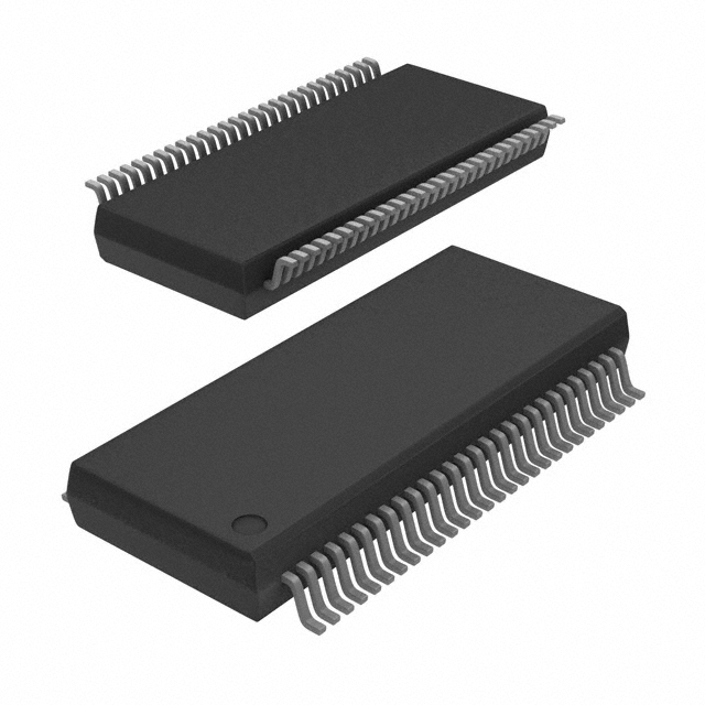

    IC FF D-TYPE DUAL 9BIT 56SSOP
74FCT162823ATPVG 数据手册
IDT74FCT162823AT/CT FAST CMOS 18-BIT REGISTER INDUSTRIAL TEMPERATURE RANGE FAST CMOS 18-BIT REGISTER IDT74FCT162823AT/CT FEATURES: DESCRIPTION: • • • • • • • • The FCT162823T 18-bit bus interface register is built using advanced, dual metal CMOS technology. These high-speed, low-power registers with clock enable (xCLKEN) and clear (xCLR) controls are ideal for parity bus interfacing in high-performance synchronous systems. The control inputs are organized to operate the device as two 9-bit registers or one 18-bit register. Flow-through organization of signal pins simplifies layout. All inputs are designed with hysteresis for improved noise margin. The FCT162823T has balanced output drive with current limiting resistors. This offers low ground bounce, minimal undershoot, and controlled output fall times – reducing the need for external series terminating resistors. The FCT162823T is a plug-in replacement for the FCT16823T and ABT16823 for on-board interface applications. 0.5 MICRON CMOS Technology High-speed, low-power CMOS replacement for ABT functions Typical tSK(o) (Output Skew) < 250ps Low input and output leakage ≤1µA (max.) VCC = 5V ±10% Balanced Output Drivers of ±24mA Reduced system switching noise Typical VOLP (Output Ground Bounce) < 0.6V at VCC = 5V, TA = 25°C • Available in SSOP and TSSOP packages FUNCTIONAL BLOCK DIAGRAM 27 2 1OE 1CLR 2OE 1 2CLR 56 1CLK 2CLK 55 28 29 30 1CLKEN 2CLKEN R C D 3 R C D 1Q1 54 15 2Q1 42 1D1 2D1 TO EIGHT OTHER CHANNELS TO EIGHT OTHER CHANNELS The IDT logo is a registered trademark of Integrated Device Technology, Inc. INDUSTRIAL TEMPERATURE RANGE SEPTEMBER 2009 1 © 2009 Integrated Device Technology, Inc. DSC-5437/7 IDT74FCT162823AT/CT FAST CMOS 18-BIT REGISTER INDUSTRIAL TEMPERATURE RANGE ABSOLUTE MAXIMUM RATINGS(1) PIN CONFIGURATION Symbol Description VTERM(2) Terminal Voltage with Respect to GND Max Unit –0.5 to 7 V –0.5 to VCC+0.5 V 1CLR 1 56 1CLK 1OE 2 55 1CLKEN TSTG Storage Temperature –65 to +150 °C 1Q1 3 54 1D1 IOUT DC Output Current –60 to +120 mA GND 4 53 GND 1Q2 5 52 1D2 1Q3 6 51 1D3 VCC 7 50 VCC 1Q4 8 49 1D4 1Q5 9 48 1D5 1Q6 10 47 1D6 GND 11 46 GND 1Q7 12 45 1D7 CIN Input Capacitance VIN = 0V 3.5 6 pF COUT Output Capacitance VOUT = 0V 3.5 8 pF 1Q8 13 44 1D8 1Q9 14 43 1D9 2Q1 15 42 2D1 2Q2 16 41 2D2 2Q3 17 40 2D3 GND 18 39 GND 2Q4 19 38 2D4 2Q5 20 37 2D5 2Q6 21 36 2D6 VCC 22 35 VCC 2Q7 23 34 2D7 2Q8 24 33 2D8 GND 25 32 GND 2Q9 26 31 2D9 2OE 27 30 2CLKEN 2CLR 28 29 VTERM(3) Terminal Voltage with Respect to GND NOTES: 1. Stresses greater than those listed under ABSOLUTE MAXIMUM RATINGS may cause permanent damage to the device. This is a stress rating only and functional operation of the device at these or any other conditions above those indicated in the operational sections of this specification is not implied. Exposure to absolute maximum rating conditions for extended periods may affect reliability. 2. All device terminals except FCT162XXX Output and I/O terminals. 3. Outputs and I/O terminals for FCT162XXX. CAPACITANCE (TA = +25°C, f = 1.0MHz) Parameter(1) Symbol Conditions Typ. Max. Unit NOTE: 1. This parameter is measured at characterization but not tested. PIN DESCRIPTION Pin Names Description xDx Data Inputs xCLK Clock Inputs xCLKEN Clock Enable Inputs (Active LOW) xCLR Asynchronous clear Inputs (Active LOW) xOE Output Enable Inputs (ActiveLOW) xOx 3-State Outputs FUNCTION TABLE(1) xOE H L L H H L L 2CLK SSOP/ TSSOP TOP VIEW xCLR X L H H H H H Inputs xCLKEN X X H L L L L xCLK X X X ↑ ↑ ↑ ↑ xDx X X X L H L H Outputs xQx Z L Q(2) Z Z L H Function High Z Clear Hold Load NOTES: 1. H = HIGH Voltage Level L = LOW Voltage Level X = Don’t Care Z = High-Impedance 2. Output level before indicated steady-state input conditions were established. 2 IDT74FCT162823AT/CT FAST CMOS 18-BIT REGISTER INDUSTRIAL TEMPERATURE RANGE DC ELECTRICAL CHARACTERISTICS OVER OPERATING RANGE Following Conditions Apply Unless Otherwise Specified: Industrial: TA = –40°C to +85°C, VCC = 5.0V ±10% Symbol Test Conditions(1) Parameter Min. Typ.(2) Max. Unit VIH Input HIGH Level Guaranteed Logic HIGH Level 2 — — V VIL Input LOW Level Guaranteed Logic LOW Level — — 0.8 V IIH Input HIGH Current (Input pins)(4) VCC = Max. — — ±1 µA — — ±1 VI = VCC Input HIGH Current (I/O pins)(4) IIL Input LOW Current (Input pins)(4) VI = GND — — ±1 — — ±1 VO = 2.7V — — ±1 VO = 0.5V — — ±1 — –0.7 –1.2 V –80 –140 –250 mA — 100 — mV — 5 500 µA Input LOW Current (I/O pins)(4) IOZH High Impedance Output Current IOZL (3-State Output pins)(4) VIK Clamp Diode Voltage IOS Short Circuit Current VH Input Hysteresis ICCL Quiescent Power Supply Current VCC = Max. VCC = Min., IIN = –18mA VCC = Max., VO = GND(3) — VCC = Max µA VIN = GND or VCC ICCH ICCZ OUTPUT DRIVE CHARACTERISTICS Symbol IODL Test Conditions(1) Min. Typ.(2) Max. Unit VCC = 5V, VIN = VIH or VIL, VO = 1.5V(3) 60 115 200 mA 1.5V(3) Parameter Output LOW Current IODH Output HIGH Current VCC = 5V, VIN = VIH or VIL, VO = VOH Output HIGH Voltage VCC = Min. –60 –115 –200 mA IOH = –24mA 2.4 3.3 — V IOL = 24mA — 0.3 0.55 V VIN = VIH or VIL VOL Output LOW Voltage VCC = Min. VIN = VIH or VIL NOTES: 1. For conditions shown as Min. or Max., use appropriate value specified under Electrical Characteristics for the applicable device type. 2. Typical values are at VCC = 5.0V, +25°C ambient. 3. Not more than one output should be shorted at one time. Duration of the test should not exceed one second. 4. This test limit for this parameter is ±5µA at TA = –55°C. 3 IDT74FCT162823AT/CT FAST CMOS 18-BIT REGISTER INDUSTRIAL TEMPERATURE RANGE POWER SUPPLY CHARACTERISTICS Test Conditions(1) Symbol ΔICC Parameter Quiescent Power Supply Current TTL Inputs HIGH ICCD Dynamic Power Supply Current(4) VCC = Max. Outputs Open xOE = xCLKEN = GND One Input Toggling 50% Duty Cycle IC Total Power Supply Current(6) VCC = Max. Outputs Open fCP = 10MHz 50% Duty Cycle xOE = xCLKEN = GND at fi = 5MHz 50% Duty Cycle One Bit Toggling VCC = Max. Outputs Open fCP = 10MHz 50% Duty Cycle xOE = xCLKEN = GND at fi = 2.5MHz 50% Duty Cycle Eighteen Bits Toggling Min. — Typ.(2) 0.5 Max. 1.5 Unit mA VIN = VCC VIN = GND — 75 120 µA/ MHz VIN = VCC VIN = GND — 0.8 1.7 mA VIN = 3.4V VIN = GND — 1.3 3.2 VIN = VCC VIN = GND — 4.2 7.1(5) VIN = 3.4V VIN = GND — 9.2 22.1(5) VCC = Max. VIN = 3.4V(3) NOTES: 1. For conditions shown as Min. or Max., use appropriate value specified under Electrical Characteristics for the applicable device type. 2. Typical values are at VCC = 5.0V, +25°C ambient. 3. Per TTL driven input (VIN = 3.4V). All other inputs at VCC or GND. 4. This parameter is not directly testable, but is derived for use in Total Power Supply Calculations. 5. Values for these conditions are examples of the ICC formula. These limits are guaranteed but not tested. 6. IC = IQUIESCENT + IINPUTS + IDYNAMIC IC = ICC + ΔICC DHNT + ICCD (fCPNCP/2 + fiNi) ICC = Quiescent Current (ICCL, ICCH and ICCZ) ΔICC = Power Supply Current for a TTL High Input (VIN = 3.4V) DH = Duty Cycle for TTL Inputs High NT = Number of TTL Inputs at DH ICCD = Dynamic Current Caused by an Input Transition Pair (HLH or LHL) fCP = Clock Frequency for Register Devices (Zero for Non-Register Devices) NCP = Number of Clock Inputs at fCP fi = Input Frequency Ni = Number of Inputs at fi 4 IDT74FCT162823AT/CT FAST CMOS 18-BIT REGISTER INDUSTRIAL TEMPERATURE RANGE SWITCHING CHARACTERISTICS OVER OPERATING RANGE Symbol Parameter tPLH Propagation Delay tPHL xCLKx to xOx tPHL tPZH tPZL tPHZ tPLZ Propagation Delay xCLR to xQx Output Enable Time xOE to xOx Output Disable Time xOE to xOx tSU Set-up Time HIGH or LOW xDx to xCLK tH tSU tH tW tW Hold Time HIGH or LOW, xDx to xCLK Set-up Time HIGH or LOW, xCLKEN to xCLK Hold Time HIGH or LOW, xCLKEN to xCLK xCLK Pulse Width HIGH or LOW xCLR Pulse Width LOW Recovery Time, xCLR to xCLK Output Skew(3) tREM tSK(o) Condition(1) CL = 50pF RL = 500Ω CL = 300pF(4) RL = 500Ω CL = 50pF RL = 500Ω CL = 50pF RL = 500Ω CL = 300pF(4) RL = 500Ω CL = 50pF(4) RL = 500Ω CL = 50pF RL = 500Ω CL = 50pF RL= 500Ω FCT162823AT Min.(2) Max. 1.5 10 Unit ns 1.5 20 1.5 8 1.5 14 1.5 4.7 ns 1.5 12 1.5 4.4 ns 1.5 23 1.5 9 1.5 7 1.5 3.6 1.5 8 1.5 3.6 3 — 1.5 — ns 1.5 3 0 6 6 6 — — — — — — — 0.5 0 2.5 0 3 3 3 — — — — — — — 0.5 ns ns ns ns ns ns ns NOTES: 1. See test circuit and waveforms. 2. Minimum limits are guaranteed but not tested on Propagation Delays. 3. Skew between any two outputs, of the same package, switching in the same direction. This parameter is guaranteed by design. 4. This condition is guaranteed but not tested. 5 FCT162823CT Min.(2) Max. 1.5 4.7 ns IDT74FCT162823AT/CT FAST CMOS 18-BIT REGISTER INDUSTRIAL TEMPERATURE RANGE TEST CIRCUITS AND WAVEFORMS V CC SWITCH POSITION 7.0V Test Switch Open Drain Disable Low Enable Low Closed All Other Tests Open 500Ω V OUT VIN Pulse Generator D.U.T. 50pF RT 500Ω CL DEFINITIONS: CL = Load capacitance: includes jig and probe capacitance. RT = Termination resistance: should be equal to ZOUT of the Pulse Generator. Test Circuits for All Outputs DATA INPUT tH tSU TIMING INPUT ASYNCHRONOUS CONTROL PRESET CLEAR ETC. SYNCHRONOUS CONTROL PRESET CLEAR CLOCK ENABLE ETC. tREM tSU 3V 1.5V 0V 3V 1.5V 0V LOW-HIGH-LOW PULSE 1.5V tW 3V 1.5V 0V HIGH-LOW-HIGH PULSE 1.5V 3V 1.5V 0V tH Pulse Width Set-up, Hold, and Release Times ENABLE SAME PHASE INPUT TRANSITION tPLH tPHL OUTPUT tPLH OPPOSITE PHASE INPUT TRANSITION tPHL 3V 1.5V 0V VOH 1.5V VOL DISABLE 3V CONTROL INPUT tPZL OUTPUT NORMALLY LOW 3V 1.5V 0V SWITCH CLOSED tPLZ 3.5V 1.5V tPZH OUTPUT NORMALLY HIGH Propagation Delay SWITCH OPEN 1.5V 0V 3.5V 0.3V VOL tPHZ 0.3V 1.5V 0V VOH 0V Enable and Disable Times NOTES: 1. Diagram shown for input Control Enable-LOW and input Control Disable-HIGH. 2. Pulse Generator for All Pulses: Rate ≤ 1.0MHz; tF ≤ 2.5ns; tR ≤ 2.5ns. 6 IDT74FCT162823AT/CT FAST CMOS 18-BIT REGISTER INDUSTRIAL TEMPERATURE RANGE ORDERING INFORMATION XX FCT Temp. Range XXX Family XXXX Device Type XX Package PVG PAG Shrink Small Outline Package - Green Thin Shrink Small Outline Package - Green 823AT 823CT 18-Bit Register 162 Double-Density, 5 Volt, Balanced Drive 74 40 C to +85 C Datasheet Document History 09/06/09 Pg. 7 Updated the ordering information by removing the "IDT" notation and non RoHS part. 7 IMPORTANT NOTICE AND DISCLAIMER RENESAS ELECTRONICS CORPORATION AND ITS SUBSIDIARIES (“RENESAS”) PROVIDES TECHNICAL SPECIFICATIONS AND RELIABILITY DATA (INCLUDING DATASHEETS), DESIGN RESOURCES (INCLUDING REFERENCE DESIGNS), APPLICATION OR OTHER DESIGN ADVICE, WEB TOOLS, SAFETY INFORMATION, AND OTHER RESOURCES “AS IS” AND WITH ALL FAULTS, AND DISCLAIMS ALL WARRANTIES, EXPRESS OR IMPLIED, INCLUDING, WITHOUT LIMITATION, ANY IMPLIED WARRANTIES OF MERCHANTABILITY, FITNESS FOR A PARTICULAR PURPOSE, OR NON-INFRINGEMENT OF THIRD PARTY INTELLECTUAL PROPERTY RIGHTS. These resources are intended for developers skilled in the art designing with Renesas products. You are solely responsible for (1) selecting the appropriate products for your application, (2) designing, validating, and testing your application, and (3) ensuring your application meets applicable standards, and any other safety, security, or other requirements. These resources are subject to change without notice. Renesas grants you permission to use these resources only for development of an application that uses Renesas products. Other reproduction or use of these resources is strictly prohibited. No license is granted to any other Renesas intellectual property or to any third party intellectual property. Renesas disclaims responsibility for, and you will fully indemnify Renesas and its representatives against, any claims, damages, costs, losses, or liabilities arising out of your use of these resources. Renesas' products are provided only subject to Renesas' Terms and Conditions of Sale or other applicable terms agreed to in writing. No use of any Renesas resources expands or otherwise alters any applicable warranties or warranty disclaimers for these products. (Rev.1.0 Mar 2020) Corporate Headquarters Contact Information TOYOSU FORESIA, 3-2-24 Toyosu, Koto-ku, Tokyo 135-0061, Japan www.renesas.com For further information on a product, technology, the most up-to-date version of a document, or your nearest sales office, please visit: www.renesas.com/contact/ Trademarks Renesas and the Renesas logo are trademarks of Renesas Electronics Corporation. All trademarks and registered trademarks are the property of their respective owners. © 2020 Renesas Electronics Corporation. All rights reserved.
