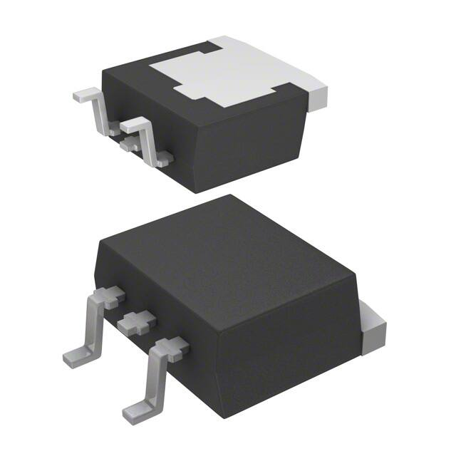

    TRIAC 600V 8A LDPAK
BCR8CS-12LB#B00 数据手册
Preliminary Datasheet BCR8CS-12LB R07DS0223EJ0500 Rev.5.00 Oct 19, 2015 600V-8A-Triac Medium Power Use Features  IT (RMS) : 8 A  VDRM : 600 V  IFGTI, IRGTI, IRGT III : 30 mA (20 mA)Note6  The product guaranteed maximum junction temperature of 150°C  Non-Insulated Type  Planar Passivation Type Outline RENESAS Package code: PRSS0004AE-B (Package name: LDPAK(S)-(1) ) 4 1 2 3 RENESAS Package code: PRSS0004AS-A (Package name: TO-263) RENESAS Package code: PR PRSS0004AB-A 20S) 0S) (Package name: TO-220S) G K P 4 L O E 1 2 2, 4 3 1 1. 2. 3. 4. T1 Terminal T2 Terminal Gate Terminal T2 Terminal 3 RENESAS Package code: PRSS0004AR-A (Package name: TO-262) 4 4 1 2 3 1 23 Applications Solid state relay, hybrid IC Maximum Ratings Parameter Repetitive peak off-state voltageNote1 Non-repetitive peak off-state voltageNote1 R07DS0223EJ0500 Rev.5.00 Oct 19, 2015 Symbol Voltage class 12 Unit VDRM VDSM 600 720 V V Page 1 of 9 BCR8CS-12LB Preliminary Parameter RMS on-state current Symbol IT (RMS) Ratings 8 Unit A Surge on-state current ITSM 80 A I2t 26 A2s PGM PG (AV) VGM IGM Tj Tstg — 5 0.5 10 2 – 40 to +150 – 40 to +150 1.3 W W V A C C g I2t for fusing Peak gate power dissipation Average gate power dissipation Peak gate voltage Peak gate current Junction temperature Storage temperature Mass Conditions Commercial frequency, sine full wave 360° conduction, Tc = 130CNote3 60Hz sinewave 1 full cycle, peak value, non-repetitive Value corresponding to 1 cycle of half wave 60Hz, surge on-state current Typical value Notes: 1. Gate open. Electrical Characteristics Parameter Repetitive peak off-state current On-state voltage Symbol IDRM VTM Min. — — Typ. — — Max. 2.0 1.5 Unit mA V Test conditions Tj = 150C, VDRM applied Tc = 25C, ITM = 12 A, Instantaneous measurement Gate trigger voltageNote2    VFGT VRGT VRGT — — — — — — 1.5 1.5 1.5 V V V Tj = 25C, VD = 6 V, RL = 6 , RG = 330  Gate trigger currentNote2    IFGT IRGT IRGT — — — — — — 30Note6 30Note6 30Note6 mA mA mA Tj = 25C, VD = 6 V, RL = 6 , RG = 330  VGD Rth (j-c) 0.2/0.1 — — — — 2.0 V C/W Tj = 125C/150C, VD = 1/2 VDRM Junction to caseNote3 Note4 (dv/dt)c 10/1 — — V/s Tj = 125C/150C Gate non-trigger voltage Thermal resistance Critical-rate of rise of off-state commutating voltageNote5 Notes: 2. 3. 4. 5. 6. Measurement using the gate trigger characteristics measurement circuit. Case temperature is measured on the T2 tab. The contact thermal resistance Rth (c-f) in case of greasing is 1.0°C/W. Test conditions of the critical-rate of rise of off-state commutating voltage is shown in the table below. High sensitivity (IGT  20mA) is also available. (IGT item: 1) Test conditions 1. Junction temperature Tj = 125C/150C 2. Rate of decay of on-state commutating current (di/dt)c = – 4.0 A/ms 3. Peak off-state voltage VD = 400 V R07DS0223EJ0500 Rev.5.00 Oct 19, 2015 Commutating voltage and current waveforms (inductive load) Supply Voltage Time Main Current (di/dt)c Time Main Voltage (dv/dt)c Time VD Page 2 of 9 BCR8CS-12LB Preliminary Performance Curves Maximum On-State Characteristics 3 2 Tj = 150°C 101 7 5 3 2 100 7 5 0.5 Tj = 25°C 1.0 1.5 2.0 2.5 3.0 3.5 80 70 60 50 40 30 20 10 2 3 4 5 7 101 2 3 4 5 7 102 On-State Voltage (V) Conduction Time (Cycles at 60Hz) Gate Characteristics (I, II and III) Gate Trigger Current vs. Junction Temperature VGM = 10V 101 7 5 3 VGT = 1.5V 2 PG(AV) = 0.5W PGM = 5W IGM = 2A 100 7 5 3 2 10 –1 7 IFGT I IRGT I, IRGT III VGD = 0.1V 5 1 2 10 2 3 5 7 10 2 3 5 7 103 2 3 5 7 104 Gate Trigger Voltage (Tj = t°C) × 100 (%) Gate Trigger Voltage (Tj = 25°C) 90 0 100 4.0 Gate Trigger Current (Tj = t°C) × 100 (%) Gate Trigger Current (Tj = 25°C) 3 2 Gate Voltage (V) Surge On-State Current (A) 100 103 7 5 4 3 2 102 7 5 4 3 2 101 Typical Example IRGT III IFGT I, IRGT I –60 –40 –20 0 20 40 60 80 100 120140160 Gate Current (mA) Junction Temperature (°C) Gate Trigger Voltage vs. Junction Temperature Maximum Transient Thermal Impedance Characteristics (Junction to case) 103 7 5 4 3 Typical Example 2 102 7 5 4 3 2 101 –60 –40 –20 0 20 40 60 80 100120140160 Junction Temperature (°C) R07DS0223EJ0500 Rev.5.00 Oct 19, 2015 Transient Thermal Impedance (°C/W) On-State Current (A) 102 7 5 Rated Surge On-State Current 102 2 3 5 7 103 2.4 2.2 2.0 1.8 1.6 1.4 1.2 1.0 0.8 0.6 0.4 0.2 0 10–1 2 3 5 7 100 2 3 5 7 101 2 3 5 7 102 Conduction Time (Cycles at 60Hz) Page 3 of 9 BCR8CS-12LB Preliminary Allowable Case Temperature vs. RMS On-State Current 16 160 14 140 Case Temperature (°C) On-State Power Dissipation (W) Maximum On-State Power Dissipation 12 360° Conduction Resistive, 10 inductive loads 8 6 4 2 0 0 2 4 10 12 14 16 80 60 40 360° Conduction 20 Resistive, inductive loads 0 0 2 4 6 8 10 12 14 16 Allowable Ambient Temperature vs. RMS On-State Current Allowable Ambient Temperature vs. RMS On-State Current 120 120 × 120 × t2.3 100 × 100 × t2.3 100 60 × 60 × t2.3 80 60 Curves apply regardless of conduction angle Resistive, inductive loads Natural convection 40 20 0 2 4 6 8 10 12 14 160 Ambient Temperature (°C) 140 All fins are black painted aluminum and greased 0 100 RMS On-State Current (A) Natural convection No fins Curves apply regardless of conduction angle Resistive, inductive loads 140 120 100 80 60 40 20 0 16 0 0.5 1.0 1.5 2.0 2.5 RMS On-State Current (A) RMS On-State Current (A) Repetitive Peak Off-State Current vs. Junction Temperature Holding Current vs. Junction Temperature 106 7 Typical Example 5 3 2 105 7 5 3 2 104 7 5 3 2 103 7 5 3 2 102 –60 –40 –20 0 20 40 60 80 100120 140160 Junction Temperature (°C) R07DS0223EJ0500 Rev.5.00 Oct 19, 2015 Holding Current (Tj = t°C) × 100 (%) Holding Current (Tj = 25°C) Ambient Temperature (°C) 8 120 RMS On-State Current (A) 160 Repetitive Peak Off-State Current (Tj = t°C) × 100 (%) Repetitive Peak Off-State Current (Tj = 25°C) 6 Curves apply regardless of conduction angle 10 3 7 5 4 3 2 3.0 Typical Example 10 2 7 5 4 3 2 101 –60 –40 –20 0 20 40 60 80 100120140160 Junction Temperature (°C) Page 4 of 9 BCR8CS-12LB Preliminary Breakover Voltage vs. Junction Temperature 7 5 3 2 Distribution T2+, G– Typical Example 102 7 5 3 2 101 7 5 3 + + 2 T2 , G Typical Example T2–, G– Critical Rate of Rise of Off-State Commutating Voltage (V/μs) 0 40 80 120 160 160 Typical Example 140 120 100 80 60 40 20 0 –60 –40 –20 0 20 40 60 80 100120140160 Junction Temperature (°C) Junction Temperature (°C) Breakover Voltage vs. Rate of Rise of Off-State Voltage (Tj=125°C) Breakover Voltage vs. Rate of Rise of Off-State Voltage (Tj=150°C) 160 Typical Example Tj = 125°C 140 120 III Quadrant 100 80 60 40 I Quadrant 20 0 101 2 3 5 7 102 2 3 5 7 103 2 3 5 7 104 Breakover Voltage (dv/dt = xV/μs) × 100 (%) Breakover Voltage (dv/dt = 1V/μs) Breakover Voltage (dv/dt = xV/μs) × 100 (%) Breakover Voltage (dv/dt = 1V/μs) 100 –40 160 Typical Example Tj = 150°C 140 120 100 III Quadrant 80 60 40 I Quadrant 20 0 101 2 3 5 7 102 2 3 5 7 103 2 3 5 7 104 Rate of Rise of Off-State Voltage (V/μs) Rate of Rise of Off-State Voltage (V/μs) Commutation Characteristics (Tj=125°C) Commutation Characteristics (Tj=150°C) 7 5 3 2 101 7 5 Time Main Voltage (dv/dt)c VD Main Current (di/dt)c IT τ Time Minimum Characteristics Value Typical Example Tj = 125°C IT = 4A τ = 500μs VD = 200V f = 3Hz I Quadrant 3 2 100 7 0 10 III Quadrant 2 3 5 7 101 2 3 5 7 102 Rate of Decay of On-State Commutating Current (A/ms) R07DS0223EJ0500 Rev.5.00 Oct 19, 2015 Critical Rate of Rise of Off-State Commutating Voltage (V/μs) Latching Current (mA) 103 Breakover Voltage (Tj = t°C) × 100 (%) Breakover Voltage (Tj = 25°C) Latching Current vs. Junction Temperature 7 5 3 2 Time Main Voltage (dv/dt)c VD Main Current (di/dt)c IT τ Time 101 7 5 III Quadrant 3 2 I Quadrant 100 7 0 10 Typical Example Tj = 150°C IT = 4A τ = 500μs VD = 200V f = 3Hz 2 3 Minimum Characteristics Value 5 7 101 2 3 5 7 102 Rate of Decay of On-State Commutating Current (A/ms) Page 5 of 9 BCR8CS-12LB Preliminary Gate Trigger Current (tw) × 100 (%) Gate Trigger Current (DC) Gate Trigger Current vs. Gate Current Pulse Width 103 7 5 4 3 Typical Example IFGT I IRGT I 2 IRGT III 102 7 5 4 3 2 101 0 10 2 3 4 5 7 101 2 3 4 5 7 102 Gate Current Pulse Width (μs) Gate Trigger Characteristics Test Circuits 6Ω 6Ω Recommended Circuit Values Around The Triac Load C1 A 6V 330Ω V Test Procedure I R1 A 6V V 330Ω Test Procedure II C0 R0 C1 = 0.1 to 0.47μF C0 = 0.1μF R0 = 100Ω R1 = 47 to 100Ω 6Ω A 6V V 330Ω Test Procedure III R07DS0223EJ0500 Rev.5.00 Oct 19, 2015 Page 6 of 9 BCR8CS-12LB Preliminary Package Dimensions JEITA Package Code SC-83 RENESAS Code PRSS0004AE-B Previous Code LDPAK(S)-(1) / LDPAK(S)-(1)V MASS[Typ.] 1.30g Unit: mm (1.4) 4.44 ± 0.2 7.8 6.6 (1.5) 2.49 ± 0.2 0.2 0.1 –+ 0.1 7.8 7.0 + 0.3 – 0.5 1.3 ± 0.15 10.0 (1.5) 8.6 ± 0.3 10.2 ± 0.3 1.7 Package Name LDPAK(S)-(1) 2.2 1.37 ± 0.2 Package Name TO-220S JEITA Package Code SC-83 2.54 ± 0.5 RENESAS Code PRSS0004AB-A Previous Code TO-220S 1.5Max 1 10.5Max 3.0 –0.5 +0.3 1.5Max L O E MASS[Typ.] 1.2g 1 5 Unit: mm G K P 4.5 1.3 0 +0.3 –0 (1.5) 2.54 ± 0.5 0.4 ± 0.1 8.6 ± 0.3 9.8 ± 0.5 0.2 0.86 +– 0.1 0.3 3.0 –+ 0.5 1.3 ± 0.2 0.5 2.6 ± 0.4 4.5 0.8 R07DS0223EJ0500 Rev.5.00 Oct 19, 2015 Page 7 of 9 BCR8CS-12LB Preliminary Package Name JEITA Package Code RENESAS Code Previous Code MASS (Typ) [g] TO-263 — PRSS0004AS-A TO-263A 1.4 Unit: mm E A A B E1 L2 H D D1 L1 c2 c 2x b2 2x b e 0.25 M A M B Reference Dimensions in millimeters Symbol GAUGE PLANE Nom Max 4.20 4.60 A1 0.00 b 0.65 b2 1.12 c 0.381 c2 1.15 — — — — — — — — — — D 8.50 D1 6.90 E 10.05 E1 8.00 e A1 L3 0° ~ 8° H Min A L L4 H 15.00 L 1.90 — — L3 L4 0.95 1.42 0.737 1.40 9.10 7.50 10.65 8.80 2.54 BSC L1 L2 0.255 — — — — 15.60 2.50 1.70 1.78 0.25 BSC 4.78 — 5.28 Package Name JEITA Package Code RENESAS Code Previous Code MASS (Typ) [g] TO-262 — PRSS0004AR-A TO-262A 1.4 Unit: mm B c1 L2 E A L1 H D A L b1 e A1 b2 0.25 M A B c2 Reference Dimensions in millimeters Symbol Min Max 4.200 4.400 4.600 A1 2.050 2.400 2.750 b1 0.635 1.050 1.400 b2 0.640 0.750 0.880 c1 1.140 1.300 1.400 c2 0.330 0.500 0.600 D 8.500 9.250 9.650 E 9.650 10.000 10.370 e H L L1 L2 R07DS0223EJ0500 Rev.5.00 Oct 19, 2015 Nom A 2.54 BSC — 23.850 — 12.900 13.500 14.100 — — 4.550 4.800 1.100 1.727 Page 8 of 9 BCR8CS-12LB Preliminary Ordering Information Orderable Part Number BCR8CS-12LB#BH0 BCR8CS-12LB-T1#BH0 BCR8CS-12LB-A1#BH0 BCR8CS-12LB#B00 BCR8CS-12LBT11#B00 BCR8CS-12LB#B01 BCR8CS-12LBT11#B01 Package Packing TO-263 Tube TO-263 Embossed Tape TO-262 Tube LDPAK(S)-(1) Tube LDPAK(S)-(1) Embossed Tape TO-220S Tube TO-220S Embossed Tape Quantity 50 pcs. 800 pcs. 50 pcs. 50 pcs. 1000 pcs. 50 pcs. 1000 pcs. Remark Taping direction “T1” Not Recommend for New Design Not Recommend for New Design EOL EOL Note : Please confirm the specification about the shipping in detail. R07DS0223EJ0500 Rev.5.00 Oct 19, 2015 Page 9 of 9 Notice 1. Descriptions of circuits, software and other related information in this document are provided only to illustrate the operation of semiconductor products and application examples. You are fully responsible for the incorporation of these circuits, software, and information in the design of your equipment. Renesas Electronics assumes no responsibility for any losses incurred by you or third parties arising from the use of these circuits, software, or information. 2. Renesas Electronics has used reasonable care in preparing the information included in this document, but Renesas Electronics does not warrant that such information is error free. Renesas Electronics 3. Renesas Electronics does not assume any liability for infringement of patents, copyrights, or other intellectual property rights of third parties by or arising from the use of Renesas Electronics products or assumes no liability whatsoever for any damages incurred by you resulting from errors in or omissions from the information included herein. technical information described in this document. No license, express, implied or otherwise, is granted hereby under any patents, copyrights or other intellectual property rights of Renesas Electronics or others. 4. You should not alter, modify, copy, or otherwise misappropriate any Renesas Electronics product, whether in whole or in part. Renesas Electronics assumes no responsibility for any losses incurred by you or 5. Renesas Electronics products are classified according to the following two quality grades: "Standard" and "High Quality". The recommended applications for each Renesas Electronics product depends on third parties arising from such alteration, modification, copy or otherwise misappropriation of Renesas Electronics product. the product's quality grade, as indicated below. "Standard": Computers; office equipment; communications equipment; test and measurement equipment; audio and visual equipment; home electronic appliances; machine tools; personal electronic equipment; and industrial robots etc. "High Quality": Transportation equipment (automobiles, trains, ships, etc.); traffic control systems; anti-disaster systems; anti-crime systems; and safety equipment etc. Renesas Electronics products are neither intended nor authorized for use in products or systems that may pose a direct threat to human life or bodily injury (artificial life support devices or systems, surgical implantations etc.), or may cause serious property damages (nuclear reactor control systems, military equipment etc.). You must check the quality grade of each Renesas Electronics product before using it in a particular application. You may not use any Renesas Electronics product for any application for which it is not intended. Renesas Electronics shall not be in any way liable for any damages or losses incurred by you or third parties arising from the use of any Renesas Electronics product for which the product is not intended by Renesas Electronics. 6. You should use the Renesas Electronics products described in this document within the range specified by Renesas Electronics, especially with respect to the maximum rating, operating supply voltage range, movement power voltage range, heat radiation characteristics, installation and other product characteristics. Renesas Electronics shall have no liability for malfunctions or damages arising out of the use of Renesas Electronics products beyond such specified ranges. 7. Although Renesas Electronics endeavors to improve the quality and reliability of its products, semiconductor products have specific characteristics such as the occurrence of failure at a certain rate and malfunctions under certain use conditions. Further, Renesas Electronics products are not subject to radiation resistance design. Please be sure to implement safety measures to guard them against the possibility of physical injury, and injury or damage caused by fire in the event of the failure of a Renesas Electronics product, such as safety design for hardware and software including but not limited to redundancy, fire control and malfunction prevention, appropriate treatment for aging degradation or any other appropriate measures. Because the evaluation of microcomputer software alone is very difficult, please evaluate the safety of the final products or systems manufactured by you. 8. Please contact a Renesas Electronics sales office for details as to environmental matters such as the environmental compatibility of each Renesas Electronics product. Please use Renesas Electronics products in compliance with all applicable laws and regulations that regulate the inclusion or use of controlled substances, including without limitation, the EU RoHS Directive. Renesas Electronics assumes no liability for damages or losses occurring as a result of your noncompliance with applicable laws and regulations. 9. Renesas Electronics products and technology may not be used for or incorporated into any products or systems whose manufacture, use, or sale is prohibited under any applicable domestic or foreign laws or regulations. You should not use Renesas Electronics products or technology described in this document for any purpose relating to military applications or use by the military, including but not limited to the development of weapons of mass destruction. When exporting the Renesas Electronics products or technology described in this document, you should comply with the applicable export control laws and regulations and follow the procedures required by such laws and regulations. 10. It is the responsibility of the buyer or distributor of Renesas Electronics products, who distributes, disposes of, or otherwise places the product with a third party, to notify such third party in advance of the contents and conditions set forth in this document, Renesas Electronics assumes no responsibility for any losses incurred by you or third parties as a result of unauthorized use of Renesas Electronics products. 11. This document may not be reproduced or duplicated in any form, in whole or in part, without prior written consent of Renesas Electronics. 12. Please contact a Renesas Electronics sales office if you have any questions regarding the information contained in this document or Renesas Electronics products, or if you have any other inquiries. (Note 1) "Renesas Electronics" as used in this document means Renesas Electronics Corporation and also includes its majority-owned subsidiaries. (Note 2) "Renesas Electronics product(s)" means any product developed or manufactured by or for Renesas Electronics. http://www.renesas.com SALES OFFICES Refer to "http://www.renesas.com/" for the latest and detailed information. Renesas Electronics America Inc. 2801 Scott Boulevard Santa Clara, CA 95050-2549, U.S.A. Tel: +1-408-588-6000, Fax: +1-408-588-6130 Renesas Electronics Canada Limited 9251 Yonge Street, Suite 8309 Richmond Hill, Ontario Canada L4C 9T3 Tel: +1-905-237-2004 Renesas Electronics Europe Limited Dukes Meadow, Millboard Road, Bourne End, Buckinghamshire, SL8 5FH, U.K Tel: +44-1628-585-100, Fax: +44-1628-585-900 Renesas Electronics Europe GmbH Arcadiastrasse 10, 40472 Düsseldorf, Germany Tel: +49-211-6503-0, Fax: +49-211-6503-1327 Renesas Electronics (China) Co., Ltd. Room 1709, Quantum Plaza, No.27 ZhiChunLu Haidian District, Beijing 100191, P.R.China Tel: +86-10-8235-1155, Fax: +86-10-8235-7679 Renesas Electronics (Shanghai) Co., Ltd. Unit 301, Tower A, Central Towers, 555 Langao Road, Putuo District, Shanghai, P. R. China 200333 Tel: +86-21-2226-0888, Fax: +86-21-2226-0999 Renesas Electronics Hong Kong Limited Unit 1601-1611, 16/F., Tower 2, Grand Century Place, 193 Prince Edward Road West, Mongkok, Kowloon, Hong Kong Tel: +852-2265-6688, Fax: +852 2886-9022 Renesas Electronics Taiwan Co., Ltd. 13F, No. 363, Fu Shing North Road, Taipei 10543, Taiwan Tel: +886-2-8175-9600, Fax: +886 2-8175-9670 Renesas Electronics Singapore Pte. Ltd. 80 Bendemeer Road, Unit #06-02 Hyflux Innovation Centre, Singapore 339949 Tel: +65-6213-0200, Fax: +65-6213-0300 Renesas Electronics Malaysia Sdn.Bhd. Unit 1207, Block B, Menara Amcorp, Amcorp Trade Centre, No. 18, Jln Persiaran Barat, 46050 Petaling Jaya, Selangor Darul Ehsan, Malaysia Tel: +60-3-7955-9390, Fax: +60-3-7955-9510 Renesas Electronics India Pvt. Ltd. No.777C, 100 Feet Road, HALII Stage, Indiranagar, Bangalore, India Tel: +91-80-67208700, Fax: +91-80-67208777 Renesas Electronics Korea Co., Ltd. 12F., 234 Teheran-ro, Gangnam-Gu, Seoul, 135-080, Korea Tel: +82-2-558-3737, Fax: +82-2-558-5141 © 2015 Renesas Electronics Corporation. All rights reserved. Colophon 5.0
