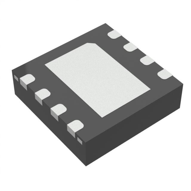

ISL28217FRTZ-T13 数据手册
DATASHEET ISL28117, ISL28217, ISL28417, ISL28417SEH FN6632 Rev.13.00 Sep 13, 2019 40V Precision Low Power Operational Amplifiers The ISL28117, ISL28217, ISL28417, and ISL28417SEH are a family of very high precision amplifiers featuring low noise vs power consumption, low offset voltage, low bias current, and low temperature drift making them the ideal choice for applications requiring both high DC accuracy and AC performance. The combination of precision, low noise, and small footprint provides you with outstanding value and flexibility relative to similar competitive parts. Features Applications for these amplifiers include precision active filters, medical and analytical instrumentation, precision power supply controls, and industrial controls. • Input bias current TC . . . . . . . . . . . . . . . . ±5pA/°C, maximum The ISL28117 single and ISL28217 dual are offered in 8 Ld SOIC, MSOP and TDFN packages. The ISL28417 is offered in 14 Ld SOIC, 14 Ld TSSOP packages. All devices are offered in standard pin configurations and operate across the extended temperature range from -40°C to +125°C. The ISL28417SEH is offered in a 14 Ld Hermetic Ceramic Flatpack package. The device is offered in an industry standard pin configuration and operates across the extended temperature range from -55°C to +125°C. Related Literature • Low input offset voltage . . . . . . . . . . . . . . . ±50µV, maximum ISL28417SEH ±110µV, maximum • Superb offset voltage TC . . . . . . . . . . . . 0.6µV/°C, maximum ISL28417SEH 1µV/°C, maximum • Input bias current. . . . . . . . . . . . . . . . . . . . . . ±1nA, maximum ISL28417SEH ±5nA, maximum • Low current consumption . . . . . . . . . . . . . . . . . . . . . . . . 440µA • Voltage noise . . . . . . . . . . . . . . . . . . . . . . . . . . . . . . . . . 8nV/Hz • Wide supply range . . . . . . . . . . . . . . . . . . . . . . . . . .4.5V to 40V • Operating temperature range. . . . . . . . . . . .-40°C to +125°C ISL28417SEH -55°C to +125°C • Small package offerings in single, dual and quad • Pb-free (RoHS compliant) • No phase reversal Applications • Precision instruments For a full list of related documents, visit our website • Medical instrumentation • ISL28117, ISL28217, ISL28417, and ISL28417SEH device pages • Power supply control • Active filter blocks • Thermocouples and RTD reference buffers • Data acquisition 18 8.2nF V+ - VIN R1 OUTPUT R2 + 1.84k 4.93k 3.3nF C2 V- NUMBER OF AMPLIFIERS C1 VS = ± 15V 16 14 12 10 8 6 4 2 0 -0.45 -0.30 -0.15 0 0.15 0.30 0.45 VOSTC (µV/°C) SALLEN-KEY LOW PASS FILTER (10kHz) FIGURE 1. TYPICAL APPLICATION FN6632 Rev.13.00 Sep 13, 2019 FIGURE 2. VOS TEMPERATURE COEFFICIENT (VOSTC) Page 1 of 42 ISL28117, ISL28217, ISL28417, ISL28417SEH Table of Contents Ordering Information . . . . . . . . . . . . . . . . . . . . . . . . . . . . . . . . . . . . . . . . . . . . . . . . . . . . . . . . . . . . . . . . . . . . . . . . . . . . . . . . . . . . . . . . 3 Pin Configurations. . . . . . . . . . . . . . . . . . . . . . . . . . . . . . . . . . . . . . . . . . . . . . . . . . . . . . . . . . . . . . . . . . . . . . . . . . . . . . . . . . . . . . . . . . . 5 Pin Descriptions. . . . . . . . . . . . . . . . . . . . . . . . . . . . . . . . . . . . . . . . . . . . . . . . . . . . . . . . . . . . . . . . . . . . . . . . . . . . . . . . . . . . . . . . . . . . . 6 Absolute Maximum Ratings . . . . . . . . . . . . . . . . . . . . . . . . . . . . . . . . . . . . . . . . . . . . . . . . . . . . . . . . . . . . . . . . . . . . . . . . . . . . . . . . . . . 7 Thermal Information . . . . . . . . . . . . . . . . . . . . . . . . . . . . . . . . . . . . . . . . . . . . . . . . . . . . . . . . . . . . . . . . . . . . . . . . . . . . . . . . . . . . . . . . . 7 Recommended Operating Conditions . . . . . . . . . . . . . . . . . . . . . . . . . . . . . . . . . . . . . . . . . . . . . . . . . . . . . . . . . . . . . . . . . . . . . . . . . . 7 Electrical Specifications ISL28117, ISL28217, ISL28417 (VS ± 15V). . . . . . . . . . . . . . . . . . . . . . . . . . . . . . . . . . . . . . . . . . . . . . . . . 8 Electrical Specifications ISL28117, ISL28217, ISL28417 (VS ± 5V). . . . . . . . . . . . . . . . . . . . . . . . . . . . . . . . . . . . . . . . . . . . . . . . . 10 Electrical Specifications ISL28417SEH (VS ±15V) . . . . . . . . . . . . . . . . . . . . . . . . . . . . . . . . . . . . . . . . . . . . . . . . . . . . . . . . . . . . . . . 12 Electrical Specifications ISL28417SEH (VS ±5V) . . . . . . . . . . . . . . . . . . . . . . . . . . . . . . . . . . . . . . . . . . . . . . . . . . . . . . . . . . . . . . . . 13 Typical Performance Curves . . . . . . . . . . . . . . . . . . . . . . . . . . . . . . . . . . . . . . . . . . . . . . . . . . . . . . . . . . . . . . . . . . . . . . . . . . . . . . . . . 15 Applications Information . . . . . . . . . . . . . . . . . . . . . . . . . . . . . . . . . . . . . . . . . . . . . . . . . . . . . . . . . . . . . . . . . . . . . . . . . . . . . . . . . . . . Functional Description . . . . . . . . . . . . . . . . . . . . . . . . . . . . . . . . . . . . . . . . . . . . . . . . . . . . . . . . . . . . . . . . . . . . . . . . . . . . . . . . . . . . . . . . . . . Operating Voltage Range . . . . . . . . . . . . . . . . . . . . . . . . . . . . . . . . . . . . . . . . . . . . . . . . . . . . . . . . . . . . . . . . . . . . . . . . . . . . . . . . . . . . . . . . . Input Performance. . . . . . . . . . . . . . . . . . . . . . . . . . . . . . . . . . . . . . . . . . . . . . . . . . . . . . . . . . . . . . . . . . . . . . . . . . . . . . . . . . . . . . . . . . . . . . . Input ESD Diode Protection . . . . . . . . . . . . . . . . . . . . . . . . . . . . . . . . . . . . . . . . . . . . . . . . . . . . . . . . . . . . . . . . . . . . . . . . . . . . . . . . . . . . . . . Output Current Limiting . . . . . . . . . . . . . . . . . . . . . . . . . . . . . . . . . . . . . . . . . . . . . . . . . . . . . . . . . . . . . . . . . . . . . . . . . . . . . . . . . . . . . . . . . . Output Phase Reversal . . . . . . . . . . . . . . . . . . . . . . . . . . . . . . . . . . . . . . . . . . . . . . . . . . . . . . . . . . . . . . . . . . . . . . . . . . . . . . . . . . . . . . . . . . . Unused Channels . . . . . . . . . . . . . . . . . . . . . . . . . . . . . . . . . . . . . . . . . . . . . . . . . . . . . . . . . . . . . . . . . . . . . . . . . . . . . . . . . . . . . . . . . . . . . . . . Power Dissipation . . . . . . . . . . . . . . . . . . . . . . . . . . . . . . . . . . . . . . . . . . . . . . . . . . . . . . . . . . . . . . . . . . . . . . . . . . . . . . . . . . . . . . . . . . . . . . . ISL28117, ISL28217, ISL28417, ISL28417SEH SPICE Model . . . . . . . . . . . . . . . . . . . . . . . . . . . . . . . . . . . . . . . . . . . . . . . . . . . . . . . . . . License Statement. . . . . . . . . . . . . . . . . . . . . . . . . . . . . . . . . . . . . . . . . . . . . . . . . . . . . . . . . . . . . . . . . . . . . . . . . . . . . . . . . . . . . . . . . . . . . . . 24 24 24 24 24 24 24 24 25 25 25 Characterization vs Simulation Results. . . . . . . . . . . . . . . . . . . . . . . . . . . . . . . . . . . . . . . . . . . . . . . . . . . . . . . . . . . . . . . . . . . . . . . . 28 Metallization Mask Layout . . . . . . . . . . . . . . . . . . . . . . . . . . . . . . . . . . . . . . . . . . . . . . . . . . . . . . . . . . . . . . . . . . . . . . . . . . . . . . . . . . . 30 Revision History. . . . . . . . . . . . . . . . . . . . . . . . . . . . . . . . . . . . . . . . . . . . . . . . . . . . . . . . . . . . . . . . . . . . . . . . . . . . . . . . . . . . . . . . . . . . 31 Package Outline Drawings . . . . . . . . . . . . . . . . . . . . . . . . . . . . . . . . . . . . . . . . . . . . . . . . . . . . . . . . . . . . . . . . . . . . . . . . . . . . . . . . . . . 36 FN6632 Rev.13.00 Sep 13, 2019 Page 2 of 42 ISL28117, ISL28217, ISL28417, ISL28417SEH Ordering Information . PART NUMBER (Notes 2, 5) PART MARKING VOS (MAX) (µV) TAPE AND REEL (UNITS) (Note 1) PACKAGE (RoHS Compliant) PKG. DWG. # ISL28117FBBZ 28117 FBZ 50 (B Grade) - 8 Ld SOIC M8.15E ISL28117FBBZ-T13 28117 FBZ 50 (B Grade) 2.5k 8 Ld SOIC M8.15E ISL28117FBBZ-T7 28117 FBZ 50 (B Grade) 1k 8 Ld SOIC M8.15E ISL28117FBBZ-T7A 28117 FBZ 50 (B Grade) 250 8 Ld SOIC M8.15E ISL28117FBZ 28117 FBZ -C 100 (C Grade) - 8 Ld SOIC M8.15E ISL28117FBZ-T13 28117 FBZ -C 100 (C Grade) 2.5k 8 Ld SOIC M8.15E ISL28117FBZ-T7 28117 FBZ -C 100 (C Grade) 1k 8 Ld SOIC M8.15E ISL28117FBZ-T7A 28117 FBZ -C 100 (C Grade) 250 8 Ld SOIC M8.15E ISL28117FUBZ 8117Z 70 (B Grade) - 8 Ld MSOP M8.118B ISL28117FUBZ-T13 8117Z 70 (B Grade) 2.5k 8 Ld MSOP M8.118B ISL28117FUBZ-T7 8117Z 70 (B Grade) 1.5k 8 Ld MSOP M8.118B ISL28117FUBZ-T7A 8117Z 70 (B Grade) 250 8 Ld MSOP M8.118B ISL28117FUZ 8117Z -C 150 (C Grade) - 8 Ld MSOP M8.118B ISL28117FUZ-T13 8117Z -C 150 (C Grade) 2.5k 8 Ld MSOP M8.118B ISL28117FUZ-T7 8117Z -C 150 (C Grade) 1.5k 8 Ld MSOP M8.118B ISL28117FUZ-T7A 8117Z -C 150 (C Grade) 250 8 Ld MSOP M8.118B ISL28117FRTBZ 8117 75 (B Grade) - 8 Ld TDFN L8.3x3K ISL28117FRTBZ-T13 8117 75 (B Grade) 6k 8 Ld TDFN L8.3x3K ISL28117FRTBZ-T7 8117 75 (B Grade) 1k 8 Ld TDFN L8.3x3K ISL28117FRTBZ-T7A 8117 75 (B Grade) 250 8 Ld TDFN L8.3x3K ISL28117FRTZ -C 8117 150 (C Grade) - 8 Ld TDFN L8.3x3K ISL28117FRTZ-T13 -C 8117 150 (C Grade) 2.5k 8 Ld TDFN L8.3x3K ISL28117FRTZ-T7 -C 8117 150 (C Grade) 1k 8 Ld TDFN L8.3x3K ISL28117FRTZ-T7A -C 8117 150 (C Grade) 250 8 Ld TDFN L8.3x3K ISL28217FBBZ 28217 FBZ 50 (B Grade) - 8 Ld SOIC M8.15E ISL28217FBBZ-T13 28217 FBZ 50 (B Grade) 2.5k 8 Ld SOIC M8.15E ISL28217FBBZ-T7 28217 FBZ 50 (B Grade) 1k 8 Ld SOIC M8.15E ISL28217FBBZ-T7A 28217 FBZ 50 (B Grade) 250 8 Ld SOIC M8.15E ISL28217FBZ 28217 FBZ -C 100 (C Grade) - 8 Ld SOIC M8.15E ISL28217FBZ-T13 28217 FBZ -C 100 (C Grade) 2.5k 8 Ld SOIC M8.15E ISL28217FBZ-T7 28217 FBZ -C 100 (C Grade) 1k 8 Ld SOIC M8.15E ISL28217FBZ-T7A 28217 FBZ -C 100 (C Grade) 250 8 Ld SOIC M8.15E ISL28217FUZ 8217Z -C 150 (C Grade) - 8 Ld MSOP M8.118B ISL28217FUZ-T13 8217Z -C 150 (C Grade) 2.5k 8 Ld MSOP M8.118B ISL28217FUZ-T7 8217Z -C 150 (C Grade) 1k 8 Ld MSOP M8.118B ISL28217FUZ -T7A 8217Z -C 150 (C Grade) 250 8 Ld MSOP M8.118B ISL28217FRTBZ 8217 70 (B Grade) - 8 Ld TDFN L8.3x3K ISL28217FRTBZ-T13 8217 70 (B Grade) 2.5k 8 Ld TDFN L8.3x3K ISL28217FRTBZ-T7 8217 70 (B Grade) 1k 8 Ld TDFN L8.3x3K ISL28217FRTZ -C 8217 150 (C Grade) - 8 Ld TDFN L8.3x3K FN6632 Rev.13.00 Sep 13, 2019 Page 3 of 42 ISL28117, ISL28217, ISL28417, ISL28417SEH Ordering Information PART NUMBER (Notes 2, 5) PART MARKING VOS (MAX) (µV) TAPE AND REEL (UNITS) (Note 1) PACKAGE (RoHS Compliant) PKG. DWG. # ISL28217FRTZ-T13 -C 8217 150 (C Grade) 2.5k 8 Ld TDFN L8.3x3K ISL28217FRTZ-T7 -C 8217 150 (C Grade) 1k 8 Ld TDFN L8.3x3K ISL28417FBBZ 28417 FBZ 120 (B Grade) - 14 Ld SOIC MDP0027 ISL28417FBBZ-T13 28417 FBZ 120 (B Grade) 2.5k 14 Ld SOIC MDP0027 ISL28417FBBZ-T7 28417 FBZ 120 (B Grade) 1k 14 Ld SOIC MDP0027 ISL28417FBBZ-T7A 28417 FBZ 120 (B Grade) 250 14 Ld SOIC MDP0027 ISL28417FBZ 28417 FBZ -C 200 (C Grade) - 14 Ld SOIC MDP0027 ISL28417FBZ-T13 28417 FBZ -C 200 (C Grade) 2.5k 14 Ld SOIC MDP0027 ISL28417FBZ-T7 28417 FBZ -C 200 (C Grade) 1k 14 Ld SOIC MDP0027 ISL28417FBZ-T7A 28417 FBZ -C 200 (C Grade) 250 14 Ld SOIC MDP0027 ISL28417FVBZ 28417 FVZ 120 (B Grade) - 14 Ld TSSOP M14.173 ISL28417FVBZ-T13 28417 FVZ 120 (B Grade) 2.5k 14 Ld TSSOP M14.173 ISL28417FVBZ-T7 28417 FVZ 120 (B Grade) 1k 14 Ld TSSOP M14.173 ISL28417FVBZ-T7A 28417 FVZ 120 (B Grade) 250 14 Ld TSSOP M14.173 ISL28417FVZ 28417 FVZ-C 200 (C Grade) - 14 Ld TSSOP M14.173 ISL28417FVZ-T13 28417 FVZ-C 200 (C Grade) 2.5k 14 Ld TSSOP M14.173 ISL28417FVZ-T7 28417 FVZ-C 200 (C Grade) 1k 14 Ld TSSOP M14.173 ISL28417FVZ-T7A 28417 FVZ-C 200 (C Grade) 250 14 Ld TSSOP M14.173 ISL28417SEHMF (Note 3) ISL28417SEHMF 110 (B Grade) - 14 Ld Flatpack K14.A ISL28417SEHF/PROTO (Notes 3, 4) ISL28417SEHF/PROTO K14.A 110 (B Grade) - 14 Ld Flatpack ISL28417SEHMX 110 (B Grade) - DIE ISL28417SEHX/SAMPLE (Note 4) 110 (B Grade) - DIE ISL28117SOICEVAL1Z Evaluation Board ISL28217SOICEVAL2Z Evaluation Board NOTES: 1. See TB347 for details about reel specifications. 2. These Pb-free plastic packaged products employ special Pb-free material sets, molding compounds/die attach materials, and 100% matte tin plate plus anneal (e3 termination finish, which is RoHS compliant and compatible with both SnPb and Pb-free soldering operations). Pb-free products are MSL classified at Pb-free peak reflow temperatures that meet or exceed the Pb-free requirements of IPC/JEDEC J-STD-020. 3. These Pb-free Hermetic packaged products employ 100% Au plate - e4 termination finish, which is RoHS compliant and compatible with both SnPb and Pb-free soldering operations. 4. The /PROTO and /SAMPLE are not rated or certified for Total Ionizing Dose (TID) or Single Event Effect (SEE) immunity. These parts are intended for engineering evaluation purposes only. The /PROTO parts meet the electrical limits and conditions across temperature specified in this datasheet. The /SAMPLE parts are capable of meeting the electrical limits and conditions at +25°C only. The /SAMPLE parts do not receive 100% screening across temperature to the electrical limits. These part types do not come with a Certificate of Conformance. 5. For Moisture Sensitivity Level (MSL), see the ISL28117, ISL28217, and ISL28417 device pages. For more information about MSL, see TB363. TABLE 1. KEY DIFFERENCES BETWEEN FAMILY OF PARTS PART NUMBER NUMBER OF DEVICES PACKAGE OPERATING TEMPERATURE RANGE ISL28117 1 8 Ld SOIC -40°C to +125°C ISL28217 2 8 Ld SOIC -40°C to +125°C ISL28417 4 14 Ld SOIC -40°C to +125°C ISL28417SEH 4 14 Ld Flatpack -55°C to +125°C FN6632 Rev.13.00 Sep 13, 2019 Page 4 of 42 ISL28117, ISL28217, ISL28417, ISL28417SEH Pin Configurations ISL28117 (8 LD TDFN) TOP VIEW ISL28117 (8 LD SOIC, MSOP) TOP VIEW NC 1 8 NC -IN 2 7 V+ +IN 3 6 VOUT V- 4 5 NC - + NC 1 8 NC -IN 2 +IN 3 6 VOUT 5 NC V- 4 ISL28217 (8 LD TDFN) TOP VIEW ISL28217 (8 LD SOIC, MSOP) TOP VIEW VOUT_A 1 -IN_A 2 +IN_A 3 V- 4 8 V+ - + + - VOUT_A 1 7 VOUT_B -IN_A 2 6 -IN_B +IN_A 3 5 +IN_B V- 4 -IN_A 2 14 VOUT_D A - + D + - +IN_A 3 V+ 4 VOUT_B 7 FN6632 Rev.13.00 Sep 13, 2019 1 13 -IN_D -IN_A 2 12 +IN_D +IN_A V- 10 +IN_C +IN_B 5 -IN_B 6 VOUT_A 11 - + B + C 8 V+ 7 VOUT_B - + 6 -IN_B + - 5 +IN_B ISL28417SEH (14 LD FLATPACK) TOP VIEW ISL28417 (14 LD SOIC, TSSOP) TOP VIEW VOUT_A 1 7 V+ - + 9 -IN_C 8 VOUT_C 14 VOUT_D 13 -IN_D 3 12 +IN_D V+ 4 11 V- +IN_B 5 10 +IN_C 9 -IN_C 8 VOUT_C -IN_B 6 VOUT_B 7 A - + - + B D + - + C Page 5 of 42 ISL28117, ISL28217, ISL28417, ISL28417SEH Pin Descriptions ISL28117 (8 Ld SOIC, MSOP, TDFN) ISL28217 (8 Ld SOIC, MSOP, TDFN) ISL28417/SEH (14 Ld SOIC, TSSOP) (14 Ld FLATPACK) PIN NAME EQUIVALENT CIRCUIT 3 - - +IN Circuit 1 Amplifier noninverting input - 3 3 +IN_A - 5 5 +IN_B - - 10 +IN_C - - 12 +IN_D 4 4 11 V- Circuit 3 Negative power supply 2 - - -IN Circuit 1 Amplifier inverting input - 2 2 -IN_A - 6 6 -IN_B - - 9 -IN_C - - 13 -IN_D 7 8 4 V+ Circuit 3 Positive power supply 6 - - VOUT Circuit 2 Amplifier output - 1 1 VOUT_A - 7 7 VOUT_B - - 8 VOUT_C - - 14 VOUT_D 1, 5, 8 - - NC - No internal connection PD PD - PD - Thermal Pad - TDFN package only. Connect thermal pad to ground or most negative potential. V+ 500Ω IN- V+ 500Ω IN+ FN6632 Rev.13.00 Sep 13, 2019 V+ CAPACITIVELY COUPLED ESD CLAMP OUT V- CIRCUIT 1 DESCRIPTION VCIRCUIT 2 V- CIRCUIT 3 Page 6 of 42 ISL28117, ISL28217, ISL28417, ISL28417SEH Absolute Maximum Ratings Thermal Information Maximum Supply Voltage . . . . . . . . . . . . . . . . . . . . . . . . . . . . . . . . . . . . . 42V Maximum Supply Voltage ISL28417SEH (Note 12) . . . . . . . . . . . . . . . . 40V Maximum Differential Input Current . . . . . . . . . . . . . . . . . . . . . . . . . . 20mA Maximum Differential Input Voltage . . . . . . . . . . . . . . . . . . . . . . . . . . . . 42V Maximum Differential Input Voltage (ISL28417SEH) . . . . . . . . . . . . . . 20V Min/Max Input Voltage . . . . . . . . . . . . . . . . . . . . . . . . V- - 0.5V to V+ + 0.5V Max/Min Input Current for Input Voltage >V+ or 130dB over-temperature. The minimum CMRR performance across the -40°C to +125°C temperature range is >120dB for power supply voltages from ±5V (10V) to ±15V (30V). Input Performance The super-beta NPN input pair provides excellent frequency response while maintaining high input precision. High NPN beta (>1000) reduces input bias current while maintaining good frequency response, low input bias current and low noise. Input bias cancellation circuits provide additional bias current reduction to
ISL28217FRTZ-T13
物料型号: - ISL28117, ISL28217, ISL28417, ISL28417SEH
器件简介: - 这些放大器是具有高直流精度和交流性能的超高精度放大器系列。它们以低噪声、低偏置电压、低偏置电流和低温度漂移为特点,适用于需要高直流精度和AC性能的应用场合。
引脚分配: - ISL28117(单)和ISL28217(双)提供8引脚SOIC、MSOP和TDFN封装。 - ISL28417提供14引脚SOIC和14引脚TSSOP封装。 - ISL28417SEH提供14引脚的密封陶瓷Flatpack封装。
参数特性: - 低输入偏置电压:最高±50µV(ISL28417SEH最高±110µV) - 出色的偏置电压温度系数:最高0.6µV/°C(ISL28417SEH最高1µV/°C) - 输入偏置电流:最高±1nA(ISL28417SEH最高±5nA) - 低电流消耗:440µA - 电压噪声:8nV/Hz - 宽电源范围:4.5V至40V - 工作温度范围:-40°C至+125°C(ISL28417SEH为-55°C至+125°C)
功能详解: - 这些放大器适用于精密仪器、医疗仪器、电源控制、主动滤波器模块、热电偶和RTD参考缓冲器、数据采集等领域。
应用信息: - 提供了典型应用电路,如图1所示的Sallen-Key低通滤波器。
封装信息: - 所有设备都提供标准引脚配置,并且在整个扩展温度范围内运行。
