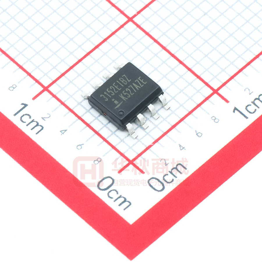

ISL3152EIBZ-T
ISL3152EIBZ-T
    RENESAS(瑞萨)
    SOIC8_150MIL
    类型:收发器 驱动器/接收器:1/1 数据速率:115Kbps 电源电压:4.5V~5.5V
ISL3152EIBZ-T 数据手册
DATASHEET ISL3150E, ISL3152E, ISL3153E, ISL3155E, ISL3156E, ISL3158E Large 3V Output Swing, 16.5kV ESD, Full Fail-Safe, 1/8 Unit Load, RS-485/RS-422 Transceivers The ISL315xE (ISL3150E, ISL3152E, ISL3153E, ISL3155E, ISL3156E, and ISL3158E) family of 5V powered RS-485/RS-422 transceivers features high output drive and high ESD protection. The devices withstand ±16.5kV IEC61000-4-2 ESD strikes without latch-up. The large output voltage of 3.1V typical into a 54Ω load provides high noise immunity, and enables the drive of up to 8000ft long bus segments, or eight 120Ω terminations in a star topology. These devices possess less than 125µA bus input currents, thus constituting a true 1/8 unit load. The high output drive combined with the low bus input currents allows for connecting up to 512 transceivers on the same bus. The receiver inputs feature a full fail-safe design that turns the receiver outputs high when the bus inputs are open or shorted. The ISL315xE family includes half and full-duplex transceivers with active-high driver-enable pins and active-low receiver enable pins. These transceivers support data rates of 115kbps, 1Mbps, and 20Mbps. Their performance is characterized from -40°C to +85°C. FN6363 Rev.5.1 May 11, 2021 Features • High VOD: 3.1V (Typ) into RD = 54Ω • Low bus currents: 125µA constitutes a true 1/8 unit load • Allows for up to 512 transceivers on the bus • ±16.5kV ESD protection on bus I/O pins • High transient overvoltage tolerance of ±100V • Full fail-safe outputs for open or shorted inputs • Hot plug capability - driver and receiver outputs remain high-impedance during power-up and power-down • Supported data rates: 115kbps, 1Mbps, 20Mbps • Low supply current (driver disabled): 550µA • Ultra-low shutdown current: 70nA Applications • Automated utility e-meter reading systems • High node count systems • PROFIBUS and Fieldbus systems in factory automation • Security camera networks • Lighting, elevator, and HVAC control systems in building automation • Industrial process control networks • Networks with star topology 140 130 120 110 100 90 80 70 60 50 40 30 20 10 0 3 6 x 120Ω Terms 8 x 120Ω Terms ISL3158E 2 Driver Output Volta ge (V) Driver Output Curre nt (mA) • Long-haul networks in coal mines and oil rigs 2 x 120Ω Terms 1 x 120Ω Term 1 0 -1 Standard Transceiver -2 20Mbps, 150' UTP, Double 120Ω Termination 0 1 2 3 4 1.5 Diff ere ntial O utput Voltage (V) 5 -3 20ns/Div Figure 1. Typical Driver Output Performance of ISL315xE Transceivers FN6363 Rev.5.1 May 11, 2021 Page 1 of 32 © 2006 Renesas Electronics ISL3150E, ISL3152E, ISL3153E, ISL3155E, ISL3156E, ISL3158E Contents 1. Overview . . . . . . . . . . . . . . . . . . . . . . . . . . . . . . . . . . . . . . . . . . . . . . . . . . . . . . . . . . . . . . . . . . . . . . . . 3 1.1 1.2 2. Typical Operating Circuit . . . . . . . . . . . . . . . . . . . . . . . . . . . . . . . . . . . . . . . . . . . . . . . . . . . . . . . . . 3 Ordering Information . . . . . . . . . . . . . . . . . . . . . . . . . . . . . . . . . . . . . . . . . . . . . . . . . . . . . . . . . . . . 3 Pin Information. . . . . . . . . . . . . . . . . . . . . . . . . . . . . . . . . . . . . . . . . . . . . . . . . . . . . . . . . . . . . . . . . . . 5 2.1 2.2 3. Pin Assignments . . . . . . . . . . . . . . . . . . . . . . . . . . . . . . . . . . . . . . . . . . . . . . . . . . . . . . . . . . . . . . . 5 Pin Descriptions. . . . . . . . . . . . . . . . . . . . . . . . . . . . . . . . . . . . . . . . . . . . . . . . . . . . . . . . . . . . . . . . 5 Specifications. . . . . . . . . . . . . . . . . . . . . . . . . . . . . . . . . . . . . . . . . . . . . . . . . . . . . . . . . . . . . . . . . . . . 6 3.1 3.2 3.3 3.4 Absolute Maximum Ratings . . . . . . . . . . . . . . . . . . . . . . . . . . . . . . . . . . . . . . . . . . . . . . . . . . . . . . . Thermal Information. . . . . . . . . . . . . . . . . . . . . . . . . . . . . . . . . . . . . . . . . . . . . . . . . . . . . . . . . . . . . Recommended Operating Conditions . . . . . . . . . . . . . . . . . . . . . . . . . . . . . . . . . . . . . . . . . . . . . . . Electrical Specifications . . . . . . . . . . . . . . . . . . . . . . . . . . . . . . . . . . . . . . . . . . . . . . . . . . . . . . . . . . 6 6 6 7 4. Test Circuits and Waveforms . . . . . . . . . . . . . . . . . . . . . . . . . . . . . . . . . . . . . . . . . . . . . . . . . . . . . . 11 5. Performance Curves . . . . . . . . . . . . . . . . . . . . . . . . . . . . . . . . . . . . . . . . . . . . . . . . . . . . . . . . . . . . . 14 6. Device Description. . . . . . . . . . . . . . . . . . . . . . . . . . . . . . . . . . . . . . . . . . . . . . . . . . . . . . . . . . . . . . . 17 6.1 6.2 6.3 6.4 7. Overview . . . . . . . . . . . . . . . . . . . . . . . . . . . . . . . . . . . . . . . . . . . . . . . . . . . . . . . . . . . . . . . . . . . . Functional Block Diagram . . . . . . . . . . . . . . . . . . . . . . . . . . . . . . . . . . . . . . . . . . . . . . . . . . . . . . . Operating Modes . . . . . . . . . . . . . . . . . . . . . . . . . . . . . . . . . . . . . . . . . . . . . . . . . . . . . . . . . . . . . . Device Features. . . . . . . . . . . . . . . . . . . . . . . . . . . . . . . . . . . . . . . . . . . . . . . . . . . . . . . . . . . . . . . 17 17 17 18 Application Information. . . . . . . . . . . . . . . . . . . . . . . . . . . . . . . . . . . . . . . . . . . . . . . . . . . . . . . . . . . 21 7.1 7.2 7.3 Network Design . . . . . . . . . . . . . . . . . . . . . . . . . . . . . . . . . . . . . . . . . . . . . . . . . . . . . . . . . . . . . . . 21 Transient Protection. . . . . . . . . . . . . . . . . . . . . . . . . . . . . . . . . . . . . . . . . . . . . . . . . . . . . . . . . . . . 26 Layout Guidelines . . . . . . . . . . . . . . . . . . . . . . . . . . . . . . . . . . . . . . . . . . . . . . . . . . . . . . . . . . . . . 26 8. Revision History. . . . . . . . . . . . . . . . . . . . . . . . . . . . . . . . . . . . . . . . . . . . . . . . . . . . . . . . . . . . . . . . . 28 9. Package Outline Drawings . . . . . . . . . . . . . . . . . . . . . . . . . . . . . . . . . . . . . . . . . . . . . . . . . . . . . . . . 29 FN6363 Rev.5.1 May 11, 2021 Page 2 of 32 ISL3150E, ISL3152E, ISL3153E, ISL3155E, ISL3156E, ISL3158E 1. 1. Overview Overview 1.1 Typical Operating Circuit 5V 5V 100n 100n 8 8 VCC 10k RO R A/Y RO RE RL78 MCU RL78 MCU RT B/Z 10k 10k R A B RB (optional) RT RE DE DI VCC 10k RB (optional) DE Y DI D GND RB (optional) 10k 10k D RB (optional) Z GND 5 5 Figure 2. Typical Operating Circuits of Half-Duplex and Full-Duplex Transceivers 1.2 Ordering Information Part Number (Notes 2, 3) ISL3150EIBZ Part Marking 3150EIBZ Package Description (RoHS Compliant) Pkg. Dwg. # Carrier Type (Note 1) Temp. Range 14 Ld SOIC M14.15 Tube -40 to +85°C ISL3150EIBZ-T Reel, 2.5k ISL3150EIBZ-T7A ISL3150EIUZ Reel, 250 3150Z 10 Ld MSOP M10.118 Tube ISL3150EIUZ-T Reel, 2.5k ISL3150EIUZ-T7A Reel, 250 ISL3152EIBZ 3152EIBZ 8 Ld SOIC M8.15 Tube ISL3152EIBZ-T Reel, 2.5k ISL3152EIBZ-T7 Reel, 1k ISL3152EIBZ-T7A ISL3152EIUZ Reel, 250 3152Z 8 Ld MSOP M8.118 Tube ISL3152EIUZ-T Reel, 2.5k ISL3152EIUZ-T7A Reel, 250 ISL3153EIBZ-T 3153EIBZ 14 Ld SOIC M14.15 ISL3153EIUZ 3153Z 10 Ld MSOP M10.118 Reel, 2.5k Tube ISL3153EIUZ-T Reel, 2.5k ISL3153EIUZ-T7A Reel, 250 ISL3155EIBZ 3155EIBZ 8 Ld SOIC M8.15 Tube ISL3155EIBZ-T Reel, 2.5k ISL3155EIBZ-T7A Reel, 250 ISL3155EIUZ ISL3155EIUZ-T FN6363 Rev.5.1 May 11, 2021 3155Z 8 Ld MSOP M8.118 Tube Reel, 2.5k Page 3 of 32 ISL3150E, ISL3152E, ISL3153E, ISL3155E, ISL3156E, ISL3158E Part Number (Notes 2, 3) ISL3156EIBZ Part Marking 1. Overview Package Description (RoHS Compliant) Pkg. Dwg. # Carrier Type (Note 1) Temp. Range 14 Ld SOIC M14.15 Tube -40 to +85 3156EIBZ ISL3156EIBZ-T Reel, 2.5k ISL3156EIBZ-T7A Reel, 250 ISL3156EIUZ 3156Z 10 Ld MSOP M10.118 Tube ISL3156EIUZ-T Reel, 2.5k ISL3156EIUZ-T7A Reel, 250 ISL3158EIBZ 3158EIBZ 8 Ld SOIC M8.15 Tube ISL3158EIBZ-T Reel, 2.5k ISL3158EIBZ-T7A Reel, 250 ISL3158EIUZ 3158Z 8 Ld MSOP M8.118 Tube ISL3158EIUZ-T Reel, 2.5k ISL3158EIUZ-T7A Reel, 250 Notes: 1. Refer to TB347 for details about reel specifications. 2. These Pb-free plastic packaged products employ special Pb-free material sets, molding compounds/die attach materials, and 100% matte tin plate plus anneal (e3 termination finish, which is RoHS compliant and compatible with both SnPb and Pb-free soldering operations). Pb-free products are MSL classified at Pb-free peak reflow temperatures that meet or exceed the Pb-free requirements of IPC/JEDEC J STD-020. 3. For Moisture Sensitivity Level (MSL), see the product information pages for the ISL3150E, ISL3152E, ISL3153E, ISL3155E, ISL3156E, and ISL3158E. For more information about MSL, see TB363. Table 1. Key Differences of Device Features Part Number Duplex Data Rate (Mbps) Bus ESD (kV) Pin Count ISL3150E Full 0.115 1100 12/4 ±10 10, 14 ISL3152E Half 0.115 1100 12/4 ±16 8 ISL3153E Full 1 150 3/4 ±10 10, 14 ISL3155E Half 1 150 3/4 ±16 8 ISL3156E Full 20 8 0.2/2.5 ±10 10, 14 ISL3158E Half 20 8 0.2/2.5 ±16 8 FN6363 Rev.5.1 May 11, 2021 Rise/Fall Time (ns) Tx/Rx Skew (ns) Page 4 of 32 ISL3150E, ISL3152E, ISL3153E, ISL3155E, ISL3156E, ISL3158E 2. 2. Pin Information Pin Information 2.1 Pin Assignments ISL3152E, ISL3155E, ISL3158E (8 Ld MSOP, 8 Ld SOIC) Top View RO 1 8 VCC RO 1 RE 2 7 B/Z RE 2 DE 3 6 A/Y DE 3 5 GND DI 4 DI R D 4 R D GND 5 2.2 ISL3150E, ISL3153E, ISL3156E (14 Ld SOIC) Top View ISL3150E, ISL3153E, ISL3156E (10 Ld MSOP) Top View 10 VCC NC 1 9 A RO 2 8 B RE 3 7 Z DE 4 6 Y DI 5 14 VCC R 13 NC 12 A 11 B D 10 Z GND 6 9 Y GND 7 8 NC Pin Descriptions 8 Ld SOIC 10 Ld MSOP 14 Ld SOIC Pin Name 1 1 2 RO Receiver output: If A-B ≥ -50mV, RO is high; If A-B ≤ -200mV, RO is low. RO is Fail-safe High if A and B are unconnected (open) or shorted. 2 2 3 RE Receiver output enable. RO is enabled when RE is low; RO is high impedance when RE is high. 3 3 4 DE Driver output enable. The driver outputs, Y and Z, are enabled by bringing DE high. They are high impedance when DE is low. 4 4 5 DI Driver input. A low on DI forces output Y low and output Z high. Similarly, a high on DI forces output Y high and output Z low. 5 5 6, 7 GND 6 – – A/Y Non-inverting receiver input and non-inverting driver output. Pin is an input if DE = 0; pin is an output if DE = 1. 7 – – B/Z Inverting receiver input and inverting driver output. Pin is an input if DE = 0; pin is an output if DE = 1. – 6 9 Y Non-inverting driver output. – 7 10 Z Inverting driver output. – 8 11 B Inverting receiver input. – 9 12 A Non-inverting receiver input. 8 10 – VCC System power supply input (4.5V to 5.5V). – – 1, 8, 13 NC No connection. FN6363 Rev.5.1 May 11, 2021 Function Ground connection. Page 5 of 32 ISL3150E, ISL3152E, ISL3153E, ISL3155E, ISL3156E, ISL3158E 3. 3. Specifications Specifications 3.1 Absolute Maximum Ratings Parameter (Note 4) Minimum Maximum Unit 7 V VCC + 0.3 V VCC to Ground -0.3 Input Voltages at DI, DE, RE Bus I/O Voltages at A/Y, B/Z, A, B, Y, Z -9 13 V ±100 V VCC + 0.3 V Transient Pulse Voltages through 100Ω at A/Y, B/Z, A, B, Y, Z (Note 5) RO -0.3 Short Circuit Duration at Y, Z Continuous ESD Rating See “Electrical Specifications” on page 8. CAUTION: Do not operate at or near the maximum ratings listed for extended periods of time. Exposure to such conditions can adversely impact product reliability and result in failures not covered by warranty. Notes: 4. Absolute Maximum ratings mean the device will not be damaged if operated under these conditions. It does not guarantee performance. 5. Tested according to TIA/EIA-485-A, Section 4.2.6 (±100V for 15µs at a 1% duty cycle). 3.2 Thermal Information Thermal Resistance (Typical, Note 6) θJA (°C/W) 8 Ld SOIC 105 8 Ld MSOP 140 10 Ld MSOP 130 14 Ld SOIC 130 Note: 6. θJA is measured with the component mounted on a high-effective thermal conductivity test board in free air. See TB379 for details. Parameter Minimum Maximum Junction Temperature (Plastic Package) Maximum Storage Temperature Range -65 Pb-Free Reflow Profile 3.3 Maximum Unit +150 °C +150 °C See TB493 Recommended Operating Conditions Minimum Maximum Unit Supply Voltage Parameter 4.5 5.5 V Temperature Range -40 +85 °C Bus Pin Common-Mode Voltage Range -7 +12 V FN6363 Rev.5.1 May 11, 2021 Page 6 of 32 ISL3150E, ISL3152E, ISL3153E, ISL3155E, ISL3156E, ISL3158E 3.4 3. Specifications Electrical Specifications Test Conditions: VCC = 4.5V to 5.5V; unless otherwise specified. Typical values are at VCC = 5V, TA = +25°C (Note 7). Boldface limits apply across the operating temperature range, -40°C to +85°C. Temp (°C) Min (Note 15) Typ Max (Note 15) Unit Full - - VCC V RL = 100Ω (RS-422) (Figure 3) Full 2.8 3.6 - V RL = 54Ω (RS-485) (Figure 3) Full 2.4 3.1 VCC V RL = 15Ω (Eight 120Ω terminations) (Note 16) +25 - 1.65 - V RL = 60Ω, -7V ≤ VCM ≤ 12V (Figure 4) Full 2.4 3 - V ΔVOD RL = 54Ω or 100Ω (Figure 3) Full - 0.01 0.2 V Driver Common-Mode Output Voltage VOC RL = 54Ω or 100Ω (Figure 3) Full - - 3.15 V Change in Magnitude of Driver Common-Mode Output Voltage ΔVOC RL = 54Ω or 100Ω (Figure 3) Full - 0.01 0.2 V Parameter Symbol Test Conditions DC Characteristics Driver Differential Output Voltage (No load) VOD1 Driver Differential Output Voltage (Loaded) VOD2 Change in Magnitude of Driver Differential Output Voltage Logic Input High Voltage VIH DE, DI, RE Full 2 - - V Logic Input Low Voltage VIL DE, DI, RE Full - - 0.8 V +25 - 100 - mV Full -2 - 2 µA DI Input Hysteresis Voltage VHYS Logic Input Current IIN1 DE, DI, RE Input Current (A, B, A/Y, B/Z) IIN2 DE = 0V, VCC = 0V or 5.5V VIN = 12V Full - 70 125 µA VIN = -7V Full -75 55 - µA RE = 0V, DE = 0V, VCC = 0V or 5.5V VIN = 12V Full - 1 40 µA VIN = -7V Full -40 -9 - µA RE = VCC, DE = 0V, VIN = 12V VCC = 0V or 5.5V VIN = -7V Full - 1 20 µA Full -20 -9 - µA DE = VCC, -7V ≤ VY or VZ ≤ 12V (Note 9) Full - - ±250 mA -7V ≤ VCM ≤ 12V Full -200 -90 -50 mV Output Leakage Current (Y, Z) (Full Duplex Versions Only) IIN3 Output Leakage Current (Y, Z) in Shutdown Mode (Full Duplex) IIN4 Driver Short-Circuit Current, VO = High or Low IOSD1 Receiver Differential Threshold Voltage VTH Receiver Input Hysteresis ΔVTH VCM = 0V +25 - 20 - mV Receiver Output High Voltage VOH IO = -8mA, VID = -50mV Full VCC - 1.2 4.3 - V Receiver Output Low Voltage VOL IO = -8mA, VID = -200mV Full - 0.25 0.4 V Receiver Output Low Current IOL VO = 1V, VID = -200mV Full 20 28 - mA Three-State (High Impedance) Receiver Output Current IOZR 0.4V ≤ VO ≤ 2.4V Full -1 0.03 1 µA Receiver Input Resistance RIN -7V ≤ VCM ≤ 12V Full 96 160 - kΩ Receiver Short-Circuit Current IOSR 0V ≤ VO ≤ VCC Full ±7 65 ±85 mA FN6363 Rev.5.1 May 11, 2021 Page 7 of 32 ISL3150E, ISL3152E, ISL3153E, ISL3155E, ISL3156E, ISL3158E 3. Specifications Test Conditions: VCC = 4.5V to 5.5V; unless otherwise specified. Typical values are at VCC = 5V, TA = +25°C (Note 7). Boldface limits apply across the operating temperature range, -40°C to +85°C. (Continued) Parameter Temp (°C) Min (Note 15) Typ Max (Note 15) Unit Half duplex versions, DE = VCC, RE = X, DI = 0V or VCC Full - 650 800 µA All versions, DE = 0V, RE = 0V, or full duplex versions, DE = VCC, RE = X. DI = 0V or VCC Full - 550 700 µA DE = 0V, RE = VCC, DI = 0V or VCC Full - 0.07 3 µA Half duplex +25 - ±16.5 - kV Full duplex +25 - ±10 - kV IEC61000-4-2, Contact Discharge Method +25 - ±9 - kV Human Body Model, from bus pins to GND +25 - ±16.5 - kV Human Body Model, per MIL-STD-883 Method 3015 +25 - ±7 - kV Machine Model +25 - 400 - V Full 500 970 1300 ns Symbol Test Conditions ICC Supply Current No-Load Supply Current (Note 8) Shutdown Supply Current ISHDN ESD Performance RS-485 Pins (A, Y, B, Z, A/Y, B/Z) IEC61000-4-2, Air-Gap Discharge Method All Pins Driver Switching Characteristics (115kbps Versions; ISL3150E, ISL3152E) Driver Differential Output Delay tPLH, tPHL RDIFF = 54Ω, CL = 100pF (Figure 5) Driver Differential Output Skew tSKEW RDIFF = 54Ω, CL = 100pF (Figure 5) Full - 12 50 ns Driver Differential Rise or Fall Time tR, tF RDIFF = 54Ω, CL = 100pF (Figure 5) Full 700 1100 1600 ns Maximum Data Rate fMAX CD = 820pF (Figure 7, Note 17) Full 115.2 2000 - kbps Driver Enable to Output High tZH RL = 500Ω, CL = 100pF, SW = GND (Figure 6, Note 10) Full - 300 600 ns Driver Enable to Output Low tZL RL = 500Ω, CL = 100pF, SW = VCC (Figure 6, Note 10) Full - 130 500 ns Driver Disable from Output Low tLZ RL = 500Ω, CL = 15pF, SW = VCC (Figure 6) Full - 50 65 ns Driver Disable from Output High tHZ RL = 500Ω, CL = 15pF, SW = GND (Figure 6) Full - 35 60 ns (Note 12) Full 60 160 600 ns Time to Shutdown tSHDN Driver Enable from Shutdown to Output High tZH(SHDN) RL = 500Ω, CL = 100pF, SW = GND (Figure 6, Notes 12, 13) Full - - 250 ns Driver Enable from Shutdown to Output Low tZL(SHDN) RL = 500Ω, CL = 100pF, SW = VCC (Figure 6, Notes 12, 13) Full - - 250 ns Full 150 270 400 ns Full - 3 10 ns Driver Switching Characteristics (1Mbps Versions; ISL3153E, ISL3155E) Driver Differential Output Delay Driver Differential Output Skew FN6363 Rev.5.1 May 11, 2021 tPLH, tPHL RDIFF = 54Ω, CL = 100pF (Figure 5) tSKEW RDIFF = 54Ω, CL = 100pF (Figure 5) Page 8 of 32 ISL3150E, ISL3152E, ISL3153E, ISL3155E, ISL3156E, ISL3158E 3. Specifications Test Conditions: VCC = 4.5V to 5.5V; unless otherwise specified. Typical values are at VCC = 5V, TA = +25°C (Note 7). Boldface limits apply across the operating temperature range, -40°C to +85°C. (Continued) Parameter Symbol Test Conditions Temp (°C) Min (Note 15) Typ Max (Note 15) Unit Driver Differential Rise or Fall Time tR, tF RDIFF = 54Ω, CL = 100pF (Figure 5) Full 150 325 450 ns Maximum Data Rate fMAX CD = 820pF (Figure 7, Note 17) Full 1 8 - Mbps Driver Enable to Output High tZH RL = 500Ω, CL = 100pF, SW = GND (Figure 6, Note 10) Full - 110 200 ns Driver Enable to Output Low tZL RL = 500Ω, CL = 100pF, SW = VCC (Figure 6, Note 10) Full - 60 200 ns Driver Disable from Output Low tLZ RL = 500Ω, CL = 15pF, SW = VCC (Figure 6) Full - 50 65 ns Driver Disable from Output High tHZ RL = 500Ω, CL = 15pF, SW = GND (Figure 6) Full - 35 60 ns (Note 12) Full 60 160 600 ns Time to Shutdown tSHDN Driver Enable from Shutdown to Output High tZH(SHDN) RL = 500Ω, CL = 100pF, SW = GND (Figure 6, Notes 12, 13) Full - - 250 ns Driver Enable from Shutdown to Output Low tZL(SHDN) RL = 500Ω, CL = 100pF, SW = VCC (Figure 6, Notes 12, 13) Full - - 250 ns tPLH, tPHL RDIFF = 54Ω, CL = 100pF (Figure 5) Full - 21 30 ns Driver Switching Characteristics (20Mbps Versions; ISL3156E, ISL3158E) Driver Differential Output Delay Driver Differential Output Skew tSKEW RDIFF = 54Ω, CL = 100pF (Figure 5) Full - 0.2 3 ns Driver Differential Rise or Fall Time tR, tF RDIFF = 54Ω, CL = 100pF (Figure 5) Full - 12 16 ns Maximum Data Rate fMAX CD = 470pF (Figure 7, Note 17) Full 20 55 - Mbps Driver Enable to Output High tZH RL = 500Ω, CL = 100pF, SW = GND (Figure 6, Note 10) Full - 30 45 ns Driver Enable to Output Low tZL RL = 500Ω, CL = 100pF, SW = VCC (Figure 6, Note 10) Full - 28 45 ns Driver Disable from Output Low tLZ RL = 500Ω, CL = 15pF, SW = VCC (Figure 6) Full - 50 65 ns Driver Disable from Output High tHZ RL = 500Ω, CL = 15pF, SW = GND (Figure 6) Full - 38 60 ns (Note 12) Full 60 160 600 ns Time to Shutdown tSHDN Driver Enable from Shutdown to Output High tZH(SHDN) RL = 500Ω, CL = 100pF, SW = GND (Figure 6, Notes 12, 13) Full - - 200 ns Driver Enable from Shutdown to Output Low tZL(SHDN) RL = 500Ω, CL = 100pF, SW = VCC (Figure 6, Notes 12, 13) Full - - 200 ns Receiver Switching Characteristics (115kbps and 1Mbps Versions; ISL3150E through ISL3155E) Maximum Data Rate fMAX (Figure 8, Note 17) Full 1 12 - Mbps Receiver Input to Output Delay tPLH, tPHL (Figure 8) Full - 100 150 ns Receiver Skew | tPLH - tPHL | tSKD (Figure 8) Full - 4 10 ns RL = 1kΩ, CL = 15pF, SW = VCC (Figure 9, Note 11) Full - 9 20 ns Receiver Enable to Output Low FN6363 Rev.5.1 May 11, 2021 tZL Page 9 of 32 ISL3150E, ISL3152E, ISL3153E, ISL3155E, ISL3156E, ISL3158E 3. Specifications Test Conditions: VCC = 4.5V to 5.5V; unless otherwise specified. Typical values are at VCC = 5V, TA = +25°C (Note 7). Boldface limits apply across the operating temperature range, -40°C to +85°C. (Continued) Parameter Symbol Test Conditions Temp (°C) Min (Note 15) Typ Max (Note 15) Unit Receiver Enable to Output High tZH RL = 1kΩ, CL = 15pF, SW = GND (Figure 9, Note 11) Full - 7 20 ns Receiver Disable from Output Low tLZ RL = 1kΩ, CL = 15pF, SW = VCC (Figure 9) Full - 8 15 ns Receiver Disable from Output High tHZ RL = 1kΩ, CL = 15pF, SW = GND (Figure 9) Full - 8 15 ns (Note 12) Full 60 160 600 ns Time to Shutdown tSHDN Receiver Enable from Shutdown to Output High tZH(SHDN) RL = 1kΩ, CL = 15pF, SW = GND (Figure 9, Notes 12, 14) Full - - 200 ns Receiver Enable from Shutdown to Output Low tZL(SHDN) RL = 1kΩ, CL = 15pF, SW = VCC (Figure 9, Notes 12, 14) Full - - 200 ns Receiver Switching Characteristics (20Mbps Versions; ISL3156E, ISL3158E) Maximum Data Rate fMAX (Figure 8, Note 17) Full 20 30 - Mbps Receiver Input to Output Delay tPLH, tPHL (Figure 8) Full - 33 45 ns Receiver Skew | tPLH - tPHL | tSKD (Figure 8) Full - 2.5 5 ns Receiver Enable to Output Low tZL RL = 1kΩ, CL = 15pF, SW = VCC (Figure 9, Note 11) Full - 8 15 ns Receiver Enable to Output High tZH RL = 1kΩ, CL = 15pF, SW = GND (Figure 9, Note 11) Full - 7 15 ns Receiver Disable from Output Low tLZ RL = 1kΩ, CL = 15pF, SW = VCC (Figure 9) Full - 8 15 ns Receiver Disable from Output High tHZ RL = 1kΩ, CL = 15pF, SW = GND (Figure 9) Full - 8 15 ns (Note 12) Full 60 160 600 ns Time to Shutdown tSHDN Receiver Enable from Shutdown to Output High tZH(SHDN) RL = 1kΩ, CL = 15pF, SW = GND (Figure 9), (Notes 12, 14) Full - - 200 ns Receiver Enable from Shutdown to Output Low tZL(SHDN) RL = 1kΩ, CL = 15pF, SW = VCC (Figure 9), (Notes 12, 14) Full - - 200 ns Notes: 7. All currents in to device pins are positive; all currents out of device pins are negative. All voltages are referenced to device ground unless otherwise specified. 8. Supply current specification is valid for loaded drivers when DE = 0V. 9. Applies to peak current. See “Performance Curves” beginning on page 14 for more information. 10. Keep RE = 0 to prevent the device from entering SHDN. 11. The RE signal high time must be short enough (typically 600ns to ensure that the device enters SHDN. 14. Set the RE signal high time >600ns to ensure that the device enters SHDN. 15. Parameters with MIN and/or MAX limits are 100% tested at +25°C, unless otherwise specified. Temperature limits established by characterization and are not production tested. 16. See Figure 11 on page 14 for more information and for performance over temperature. 17. Limits established by characterization and are not production tested. FN6363 Rev.5.1 May 11, 2021 Page 10 of 32 ISL3150E, ISL3152E, ISL3153E, ISL3155E, ISL3156E, ISL3158E 4. 4. Test Circuits and Waveforms Test Circuits and Waveforms VCC 0V or 3V DI RL/2 Y DE VOD D Z RL/2 V OC Y VOH Z VOL VOC VOC Figure 3. Measurement of Driver Differential Output Voltage with Differential Load VCC DE DI 0V or 3V 375  Y VOD D RL = 60 Z VCM -7V to +12V 375  Figure 4. Measurement of Driver Differential Output Voltage with Common-Mode Load 3V DI DE DI 50% CL = 100pF VCC tPLH VOD Z 1.5V 0V Y D 50% tPHL Z VOH Y VOL RDIFF CL = 100pF Skew = |tPLH - tPHL| VOD (Y - Z) 90% +VOD 90% 10% 10% tR tF -VOD Figure 5. Measurement of Driver Propagation Delay and Differential Transition Times FN6363 Rev.5.1 May 11, 2021 Page 11 of 32 ISL3150E, ISL3152E, ISL3153E, ISL3155E, ISL3156E, ISL3158E 4. Test Circuits and Waveforms VCC Y DI 500  D SW DE 3V DE CL Z 1.5V 1.5V 0V tZH(SHDN) tHZ tZH VOH Parameter Output RE DI SW CL (pF) tHZ Y/Z X 1/0 GND 15 tLZ Y/Z X 0/1 VCC 15 tZH Y/Z 0 (Note 10) 1/0 GND 100 tZL Y/Z 0 (Note 10) 0/1 VCC 100 tZH(SHDN) Y/Z 1 (Note 13) 1/0 GND 100 tZL(SHDN) Y/Z 1 (Note 13) 0/1 VCC 100 VOH - 0.5V Y, Z 2.3V 0V tZL(SHDN) tZL tLZ VCC Y, Z 2.3V VOL VOL + 0.5V Figure 6. Measurement of Driver Enable and Disable Times VCC 3V Y DE DI DI 0V VOD D 60  CD Z Y, Z +VOD -VOD 0V Figure 7. Measurement of Driver Data Rate +1.5V A B A 0V 0V RO R -1.5V tPHL tPLH 15pF RE VCC RO 1.5V 1.5V 0V Figure 8. Measurement of Receiver Propagation Delay and Data Rate FN6363 Rev.5.1 May 11, 2021 Page 12 of 32 ISL3150E, ISL3152E, ISL3153E, ISL3155E, ISL3156E, ISL3158E 4. Test Circuits and Waveforms VCC A B 1k  RO R SW 15pF 3V RE 1.5V 1.5V RE 0V tZH(SHDN) tZH tHZ VOH VOH - 0.5V RO Parameter DE A SW tHZ 0 +1.5V GND tLZ 0 -1.5V VCC tZH (Note 11) 0 +1.5V GND tZL (Note 11) 0 -1.5V VCC tZH(SHDN) (Note 14) 0 +1.5V GND tZL(SHDN) (Note 14) 0 -1.5V VCC 1.5V 0V tZL(SHDN) tZL tLZ VCC RO 1.5V VOL VOL + 0.5V Figure 9. Measurement of Receiver Enable and Disable Times FN6363 Rev.5.1 May 11, 2021 Page 13 of 32 ISL3150E, ISL3152E, ISL3153E, ISL3155E, ISL3156E, ISL3158E 5. 5. Performance Curves Performance Curves 4.5 VOH 4.0 3.5 3.0 2.5 2.0 VOL 1.5 1.0 0.5 0 0 20 40 60 80 100 120 Driver Output Current – IO (mA) 140 Driver Output Voltage – VA, VB (V) Figure 10. Driver Output High and Low Voltages vs Output Current 5.0 Figure 4 Test Circuit Fig. 4 Test Circuit 4.5 VA 4.0 3.5 VOD 3.0 VOC 2.5 2.0 1.5 VB 1.0 0.5 0 -8 -6 -4 -2 0 2 4 6 8 10 Common-Mode Voltage – VCM (V) 12 Differential Output Voltage – VOD (V) 5.0 D, DE = VCC RD==54Ω 54Ω R D 3.0 2.5 2.0 1.5 1.0 0.5 0 0 1 2 3 4 Supply Voltage – VCC (V) 5 Figure 14. Driver Output Voltage vs Supply Voltage FN6363 Rev.5.1 May 11, 2021 54Ω 4.5 4.0 3.5 3.0 TA = 25oC 2.5 o 2.0 TA = +85 C 15Ω 1.5 1.0 0.5 0 0 20 40 60 80 100 120 Driver Output Current – IO (mA) 140 3.7 3.6 RDIFF = 100Ω 3.5 3.4 3.3 3.2 3.1 RDIFF = 54Ω 3.0 2.9 -40 -20 0 20 40 60 Temperature (oC) 80 100 Figure 13. Driver Differential Output Voltage vs Temperature Driver Output Current – IO (mA) Differential Output Voltage – VOD (V) Figure 12. Driver Output Voltages vs Common-Mode Voltage 3.5 5.0 Figure 11. Driver Differential Output Voltage vs Output Current Differential Output Voltage – VOD (V) Differential Output Voltage – VOD (V) VCC = 5V, TA = +25°C; Unless otherwise specified 70 VOL,+25oC 60 50 VOL,+85oC 40 30 VOH,+25oC 20 VOH,+85oC 10 0 0 1 2 3 4 Supply Voltage – VCC (V) 5 Figure 15. Receiver Output Voltage vs Output Current Page 14 of 32 ISL3150E, ISL3152E, ISL3153E, ISL3155E, ISL3156E, ISL3158E 5. Performance Curves 70 Data I/O (V) RL = 54Ω, CL = 100pF 60 50 DE, RE = VCC 40 30 10 0 10 20 30 40 50 60 70 80 90 100 110 120 Data Rate (kbps) 5V/Div B/Z 1V/Div A/Y Time: 1μs/Div Figure 17. Waveforms (ISL3150E, ISL3152E) 80 Data I/O (V) RL = 54Ω, CL = 100pF 70 60 50 DE, RE = VCC DI RO 5V/Div R D = 54Ω 40 C L = 100 pF 30 Bus I/O (V) Driver Output Current – IO (mA) Figure 16. Supply Current vs Data Rate (ISL3150E, ISL3152E) 20 10 0 0 0.1 0.2 0.3 0.4 0.5 0.6 0.7 0.8 0.9 1.0 Data Rate (Mbps) Figure 18. Supply Current vs Data Rate (ISL3153E, ISL3155E) B/Z 1V/Div A/Y Time: 400ns/Div Figure 19. Waveforms (ISL3153E, ISL3155E) 100 RL = 54Ω, CL = 100pF Data I/O (V) 90 80 70 60 RO 5V/Div RD = 54Ω 40 CL = 100pF 30 20 10 0 DI DE, RE = VCC 50 Bus I/O (V) Driver Output Current – IO (mA) RO CL = 100pF 20 0 DI RD = 54Ω Bus I/O (V) Driver Output Current – IO (mA) VCC = 5V, TA = +25°C; Unless otherwise specified (Continued) 0 2 4 6 8 10 12 14 Data Rate (Mbps) 16 18 Figure 20. Supply Current vs Data Rate (ISL3156E, ISL3158E) FN6363 Rev.5.1 May 11, 2021 20 B/Z 1V/Div A/Y Time: 20ns/Div Figure 21. Waveforms (ISL3156E, ISL3158E) Page 15 of 32 ISL3150E, ISL3152E, ISL3153E, ISL3155E, ISL3156E, ISL3158E 5. Performance Curves 1010 12 1005 11 1000 10 995 Skew (ns) Propagation Delay (ns) VCC = 5V, TA = +25°C; Unless otherwise specified (Continued) 990 985 tPLH 980 975 -20 0 20 40 60 Temperature (oC) 80 4 -40 100 290 3.25 288 3.00 286 282 tPLH 280 278 tPHL 276 20 40 60 Temperature (oC) 80 100 2.50 2.25 2.00 1.75 274 1.50 272 -20 0 20 40 60 Temperature (oC) 80 1.25 -40 100 Figure 24. Differential Rise/Fall Times vs Temperature (ISL3153E, ISL3155E) 0.26 22.5 0.24 22.0 Skew (ns) 21.0 tPHL 20.5 0 20 40 60 Temperature (oC) 80 100 0.22 tPLH 21.5 -20 Figure 25. Differential Propagation Delay vs Temperature (ISL3153E, ISL3155E) 23.0 20.0 19.5 0.20 0.18 0.16 0.14 19.0 0.12 18.5 18.0 -40 0 2.75 284 270 -40 -20 Figure 23. Differential Propagation Delay vs Temperature (ISL3150E, ISL3152E) Skew (ns) Propagation Delay (ns) Figure 22. Differential Rise/Fall Times vs Temperature (ISL3150E, ISL3152E) Propagation Delay (ns) 7 5 965 960 -40 8 6 tPHL 970 9 -20 0 20 40 60 Temperature (oC) 80 100 Figure 26. Differential Rise/Fall Times vs Temperature (ISL3156E, ISL3158E) FN6363 Rev.5.1 May 11, 2021 0.10 -40 -20 0 20 40 60 Temperature (oC) 80 100 Figure 27. Differential Propagation Delay vs Temperature (ISL3156E, ISL3158E) Page 16 of 32 ISL3150E, ISL3152E, ISL3153E, ISL3155E, ISL3156E, ISL3158E 6. 6. Device Description Device Description 6.1 Overview The ISL3150E, ISL3153E, and ISL3156E are full-duplex RS-485 transceivers, and the ISL3152E, ISL3155E, and ISL3158E are half-duplex RS-485 transceivers. All transceivers feature a large output signal swing that is 60% higher than standard compliant transceivers. The devices are available in three speed grades suitable for data transmission up to 115kbps, 1Mbps, and 20Mbps. Each transceiver has an active-high driver enable and an active-low receiver enable function. A shutdown current as low as 70nA can be accomplished by disabling both the driver and receiver for more than 600ns. 6.2 Functional Block Diagram VCC VCC R RO RE DE D DI A RO B Y RE B/Z DE A/Y DI D Z GND GND Figure 28. Block Diagram ISL3150E, ISL3153E, ISL3156E 6.3 R Figure 29. Block Diagram ISL3152E, ISL3155E, ISL3158E Operating Modes 6.3.1 Driver Operation A logic high at the driver enable pin, DE, activates the driver and causes the differential driver outputs, Y and Z, to follow the logic states at the data input, DI. A logic high at DI causes Y to turn high and Z to turn low. In this case, the differential output voltage, defined as VOD = VY – VZ, is positive. A logic low at DI reverses the output states reverse, turning Y low and Z high, thus making VOD negative. A logic low at DE disables the driver, making Y and Z high-impedance. In this condition the logic state at DI is irrelevant. To ensure the driver remains disabled after device power-up, it is recommended to connect DE through a 1kΩ to 10kΩ pull-down resistor to ground. Table 2. Driver Truth Table Inputs Outputs RE DE DI Y Z X H H H L Actively drives bus high X H L L H Actively drives bus low L L X Z Z Driver disabled, outputs high-impedance H L X Z* Z* Shutdown mode: driver and receiver disabled for more than 600ns Function Note:* See Shutdown mode explanation in “Low Current Shutdown Mode” on page 20. FN6363 Rev.5.1 May 11, 2021 Page 17 of 32 ISL3150E, ISL3152E, ISL3153E, ISL3155E, ISL3156E, ISL3158E 6.3.2 6. Device Description Receiver Operation A logic low at the receiver enable pin, RE, activates the receiver and causes its output, RO, to follow the bus voltage at the differential receiver inputs, A and B. Here, the bus voltage is defined as VAB = VA - VB. For VAB ≥ -0.05V, RO turns high, and for VAB ≤ -0.2V, RO turns low. For input voltages between -50mV and -200mV, the state of RO is undetermined, and thus could be high or low. A logic high at RE disables the receiver, making RO high-impedance. In this condition the polarity and magnitude of the input voltage is irrelevant. To ensure the receiver output remains high when the receiver is disabled, it is recommended to connect RO, using a 1kΩ to 10kΩ pull-up resistor to VCC. To enable the receiver to immediately monitor the bus traffic after device power-up, connect RE through a 1kΩ to 10kΩ pull-down resistor to ground. Table 3. Receiver Truth Table Inputs Outputs RE DE A–B RO L X VAB ≥ -0.05V H RO is data-driven high L X -0.05V > VAB > -0.2V Undetermined Actively drives bus low L X VAB ≤ -0.2V L RO is data-driven low L X Inputs Open/Shorted H RO is failsafe-high H H X Z Receiver disabled, RO is high-impedance H L X Z* Shutdown mode: driver and receiver disabled for more than 600ns Function Note:* See Shutdown mode explanation in “Low Current Shutdown Mode” on page 20. 6.4 Device Features 6.4.1 Large Output Signal Swing Driver Output Curre nt – IO (mA) The ISL315xE family has a 60% larger differential output voltage swing than standard RS-485 transceivers. It delivers a minimum VOD of 2.4V across a 54Ω differential load, or 1.65V across a 15Ω differential load. Figure 30 shows that the VOD at 54Ω is more than 50% higher than that of a standard transceiver. 188Ω 140 130 120 110 100 90 80 70 60 50 40 30 20 10 0 TA = +25 oC 15Ω Y DI 375Ω D ISL315xE 3V 60Ω 375Ω Z 54Ω VCM -7V to +12V Std. XCVR 188Ω 0.84 0 1.65 3.1 1 2 3 4 Diff ere ntial O utput Voltage – VOD (V) 5 Figure 30. V-I Characteristic of ISL315xE vs Standard RS-485 Transceiver FN6363 Rev.5.1 May 11, 2021 Device RCM (Ω) 1UL (Ω) # UL 1/8UL (Ω) # Devices on Bus Std. RS-485 375 12k 32 96k 256 ISL315xE 188 12k 64 96k 512 Figure 31. Unit Load and Transceiver Drive of ISL315xE vs Standard RS-485 Transceiver Page 18 of 32 ISL3150E, ISL3152E, ISL3153E, ISL3155E, ISL3156E, ISL3158E 6. Device Description Figure 31 compares the maximum number of unit loads and bus transceivers when choosing an ISL315xE over a standard transceiver. The RS-485 standard specifies a minimum total common-mode load resistance of RCM = 375Ω between each signal conductor and ground. Because one unit load (1UL) is equivalent to 12kΩ, the total common-mode resistance of 375Ω yields 12kΩ/375Ω = 32 ULs. For an ISL315xE transceiver however, RCM can be as small as 188Ω, resulting in a total common-mode load of 12kΩ/188Ω = 64 ULs. This means the driver of an ISL315xE transceiver can drive up to 64 x 1UL transceivers or 512 x 1/8UL transceivers. The advantages of such superior drive capability are: • Up to 900mV higher noise immunity (2.4V vs 1.5V VOD) • Up to twice the maximum cable length of standard transceivers (~8000ft vs 4000ft) • The design of star configurations or other multi-terminated nonstandard network topologies 6.4.2 Driver Overload Protection The RS-485 specification requires drivers to survive worst case bus contentions undamaged. The ISL315xE transceivers meet this requirement through driver output short circuit current limits and on-chip thermal shutdown circuitry. The driver output stages incorporate short-circuit current limiters that ensure that the output current never exceeds the RS-485 specification, even at the common-mode voltage range extremes. In the event of a major short-circuit conditions, the devices also include a thermal shutdown feature that disables the drivers whenever the temperature becomes excessive. This eliminates the power dissipation, allowing the die to cool. The drivers automatically re-enable after the die temperature drops about 15°C. If the contention persists, the thermal shutdown/re-enable cycle repeats until the fault is cleared. The receivers stay operational during thermal shutdown. 6.4.3 Full-Failsafe Receiver The differential receivers of the ISL315xE family are full-failsafe, meaning their outputs turn logic high when: • The receiver inputs are open (floating) due to a faulty bus node connector • The receiver inputs are shorted due to an insulation break of the bus cable • The receiver input voltage is close to 0V due to a terminated bus not being actively driven Full-failsafe switching is accomplished by offsetting the maximum receiver input threshold to -50mV. Figure 32 shows that, in addition to the threshold offset, the receiver also has an input hysteresis, ΔVTH, of 20mV. The combination of offset and hysteresis allows the receiver to maintain its output high, even in the presence of 140mVP-P differential noise, without the need for external failsafe biasing resistors. +VAB RO = High 0V Vn-(P-P) = 140mV -50mV Undetermined VNTH = 20mV -200mV RO = Low -VAB Figure 32. Full-Failsafe Performance with High Noise Immunity FN6363 Rev.5.1 May 11, 2021 Page 19 of 32 ISL3150E, ISL3152E, ISL3153E, ISL3155E, ISL3156E, ISL3158E 6.4.4 6. Device Description Low Current Shutdown Mode The ISL315xE transceivers use a fraction of the power required by their bipolar counterparts, but also include a shutdown feature that reduces the already low quiescent ICC to a 70nA trickle. These devices enter shutdown whenever the receiver and the driver are simultaneously disabled (RE = VCC and DE = GND) for a period of at least 600ns. Disabling both the driver and the receiver for less than 60ns guarantees that the transceiver will not enter shutdown. Note that driver and receiver enable times increase when the transceiver enables from shutdown. Refer to Notes 9 to 13 at the end of “Electrical Specifications” on page 10. 6.4.5 Hot Plug Function When the equipment powers up, there is a period of time where the controller driving the RS-485 enable lines is unable to ensure that the driver and receiver outputs are kept disabled. If the equipment is connected to the bus, a driver activating prematurely during power-up may crash the bus. To avoid this scenario, the ISL315xE devices incorporate a Hot Plug function. During power-up and power-down, the Hot Plug function disables the driver and receiver outputs regardless of the states of DE and RE. When VCC reaches ~3.4V, the enable pins are released. This gives the controller the chance to stabilize and drive the RS-485 enable lines to the proper states. 6.4.6 High ESD Protection The bus pins of the ISL315xE transceivers have on-chip ESD protection against ±16.5kV HBM, and ±9kV contact and ±16.5kV air-discharge according to IEC61000-4-2. The difference between the HBM and IEC ESD ratings lies in the test severity, as both standards aim for different application environments. HBM ESD ratings are component level ratings, used in semiconductor manufacturing in which component handling can cause ESD damage to a single device. Because component handling is performed in a controlled ESD environment, the ESD stress upon a component is drastically reduced. These factors make the HBM test the less severe ESD test. IEC ESD ratings are system level ratings. These are required in the uncontrolled field environment, where for example, a charged end user can subject handheld equipment to ESD levels of more than 40kV by touching connector pins when plugging or unplugging cables. The main differences between the HBM and the IEC 61000-4-2 standards are the number of strikes applied during testing and the generator models (Figure 33), which create differences in the waveforms’ rise times and peak currents (Figure 34). 1.5k 50M 330Ω HV-DC Generator 100pF 150pF 30 VTest = 8kV 25 DUT IPK (A) 1M IEC61000-4-2 20 15 10 HBM 5 Human-Body-Model IEC61000-4-2 Model Figure 33. Generator Models for HBM and IEC ESD Tests 0 0 50 100 150 200 250 300 350 400 450 500 Time (ns) Figure 34. Difference in Rise-time and Charge Currents between HBM and IEC ESD Transients The IEC model has 50% higher charge capacitance (CS) and 78% lower discharge resistance (RD) than the HBM model, thus producing shorter transient rise times and higher discharge currents. The ESD ratings of the ISL315xE transceivers exceed test level 4 of the IEC61000-4-2 standard, which significantly increases equipment robustness. FN6363 Rev.5.1 May 11, 2021 Page 20 of 32 ISL3150E, ISL3152E, ISL3153E, ISL3155E, ISL3156E, ISL3158E 7. 7. Application Information Application Information 7.1 Network Design Designing a reliable RS-485 network requires the consideration of a variety of factors that ultimately determine the network performance. These include network topology, cable type, data rate and/or cable length, stub length, distance between network nodes, and line termination. The main difference between network designs is dictated by their modes of data exchange between bus nodes, which can be half-duplex or full-duplex (Figures 35 and 36). A RO R RE DE DI D A/Y A/Y RT RT B/Z B/Z A/Y B/Z R D RO RO RE RE DE DE DI DI RT R D RT D Z Master Slave Y D A Transmit RT Z R DI DE RE RO B A R Y Receive B B R Y Z Slave D RO RE DE DI RO RE DE DI Figure 35. Half-Duplex Bus Figure 36. Full-Duplex Bus Half-duplex networks use only a single signal-pair of cables between one master node and multiple slave nodes, which allows the nodes to either transmit or receive data, but never both at the same time. Its reduced cabling effort makes these networks well suited for covering long distances of up to several thousands of feet. To maintain high signal integrity, the applied data rates range from as low as 9.6kbps up to 115kbps. This requires transceivers with long driver output transition times, typically in the range of microseconds, to ensure low EMI in the presence of large cable inductances. To prevent signal reflections of the bus lines, each cable end must be terminated with a resistor, RT, whose value should match the characteristic cable impedance, Z0. Full-duplex networks, on the other hand, aim for high data throughput. These networks use two signal-pairs to support the simultaneous transmitting and receiving of data. The signal pair denoted as the transmit path connects the driver output of the master node to the receiver inputs of multiple slave nodes. The other pair connects the driver outputs of the slave nodes with the receiver input of the master node. Because the data flow in the transmit path is unidirectional, the transmit path requires only one termination at the remote cable end, opposite the master node. Data flow in the receive path, however, is bidirectional, thus requiring line termination at both cable ends. Commonly, high data throughput also calls for higher data rates in the 1Mbps to 10Mbps range. As cable losses increase with frequency, most full-duplex networks are limited to shorter bus cable lengths of a few hundred feet to maintain signal integrity. The following sections discuss the aforementioned parameters that impact network performance. This discussion applies to both half-and full-duplex network designs. 7.1.1 Cable Type RS-485 networks use differential signaling over Unshielded Twisted Pair (UTP) cable. The conductors of a twisted pair are equally exposed to external noise. They pick up noise and other electromagnetically induced voltages as common-mode signals, which are effectively rejected by the differential receivers. For best performance use industrial RS-485 cables, which are of the sheathed, shielded, twisted pair type, (STP), with a characteristic impedance of 120Ω and conductor sizes of 22 to 24 AWG (equivalent to diameters of 0.65mm and 0.51mm, respectively). They are available in single, two, and four signal-pair versions to FN6363 Rev.5.1 May 11, 2021 Page 21 of 32 ISL3150E, ISL3152E, ISL3153E, ISL3155E, ISL3156E, ISL3158E 7. Application Information accommodate the design of half- and full-duplex systems. Figure 37 shows the cross section and cable parameters of a typical UTP cable. PVC Jacket Aluminum Foil Polyester Tape Foam High Density Polyethylene Cable: Belden 3105A 22 AWG Tinned Copper Type: 1-pair, 22AWG PLCT/CM Impedance: 120Ω DC Resistance: 14.7mΩ/ft Tinned Copper Braid Capacitance: 11pF/ft Velocity: 78% (1.3ns/ft) 22 AWG Tinned Copper Drain Wire Figure 37. Single Pair STP Cable for RS-485 Applications 7.1.2 Cable Length vs Data Rate RS-485 and RS-422 are intended for network lengths up to 4000ft, but the maximum system data rate decreases as the transmission length increases. Devices operating at 20Mbps are limited to lengths less than 100ft, while the 115kbps versions can operate at full data rates with lengths of several 1000ft. Note that ISL315xE transceivers can cover almost twice the distance of standard compliant RS-485 transceivers. 10000 ISL315xE Transceivers 1000 Standard RS-485 Transceivers 100 10 10k 100k 1M 10M 100M Data Rate (bps) Cable Length (m) Cable Length (ft) 10000 ISL315xE Transceivers 1000 100 10 Standard RS-485 Transceivers 10k 100k 1M 10M 100M Data Rate (bps) Figure 38. Data Rate vs Cable Length Guidelines in Feet and Meters 7.1.3 Topologies and Stub Lengths RS-485 recommends its nodes to be networked in daisy-chain or backbone topology. In these topologies the participating drivers, receivers, and transceivers connect to a main cable trunk through “short” stubs. A stub being the actual electrical link between transceiver and cable trunk. FN6363 Rev.5.1 May 11, 2021 Page 22 of 32 ISL3150E, ISL3152E, ISL3153E, ISL3155E, ISL3156E, ISL3158E 7. Application Information D D D R R D R A B R A B Stub A1 B1 B2 A2 Stub A1 B1 B2 A2 Figure 39. Stub Lengths in Daisy Chain (left) and Backbone (right) Topologies Because daisy chaining brings the cable trunk much closer to the transceiver bus terminals than a backbone design, the stub lengths between the two topologies can differ significantly. To prevent the bus from being overloaded by line terminations, stubs are never terminated. A stub therefore, represents a piece of unterminated transmission line. To eliminate signal reflections on the stub line, a rule of thumb is to keep its propagation delay below 1/5 of the driver output rise time, which leads to the maximum stub length of: tr L Stub = v  c  --5 (EQ. 1) where • c is the speed of light (m/s) • v is the signal velocity in the cable, expressed as a factor of c • tr is the rise time of the driver output (ns) Applying Equation 1 to the ISL315xE transceivers assuming a velocity of 78%, results in the maximum stub lengths associated with the corresponding transceivers, as shown in Table 4. Table 4. Stub Length as Function of Driver Rise Time Device Data Rate (Mbps) Rise Time (ns) Maximum Stub Length ISL3150E, ISL3152E 0.115 1100 168ft (51m) ISL3153E, ISL3155E 1 150 23ft (7m) ISL3156E, ISL3158E 20 8 1.2ft (0.36m) Table 4 proves that transceivers with long driver rise times are well suited for applications requiring long stub lengths and low radiated emission in the presence of increased stub inductance. 7.1.4 Minimum Distance between Nodes The electrical characteristics of the RS-485 bus are primarily defined by the distributed inductance and capacitance along the bus cable and printed circuit board traces. Adding capacitance to the bus in the form of transceivers and connectors lowers the line impedance and causes impedance mismatches at the loaded bus section. Input signals arriving at these mismatches are partially reflected back to the signal source, distorting the driver output signal. Ensuring a valid receiver input voltage during the first signal transition from a driver output anywhere on the bus, requires the bus impedance at the mismatches to be Z load  0.4Z nom or 0.4 x 120Ω = 48Ω. This can be achieved by maintaining a minimum distance between bus nodes of: FN6363 Rev.5.1 May 11, 2021 Page 23 of 32 ISL3150E, ISL3152E, ISL3153E, ISL3155E, ISL3156E, ISL3158E 7. Application Information CL D min  -----------------------5.25  C C (EQ. 2) where • CL is the lumped load capacitance • CC is the distributed cable or PCB trace capacitance per unit length. Figure 40 shows the relationship for the minimum node spacing as a function of CC and CL graphically. Load capacitance includes contributions from the line circuit bus pins, connector contacts, printed circuit board traces, protection devices, and any other physical connections to the trunk line as long as the distance from the bus to the transceiver, known as the stub, is electrically short. Putting some values to the individual capacitance contributions: 5V transceivers typically possess a capacitance of 7pF, while 3V transceivers have about twice that capacitance at 16pF. Board traces add about 1.3 to 2pF/in depending upon their construction. Connector and suppression device capacitance can vary widely. Media distributed capacitance ranges from 11pF/ft for low capacitance, unshielded, twisted-pair cable up to 22pF/ft for backplanes. 20 CL (pF) 100 60 40 20 10 Distance (in) 16 12 8 4 0 40 50 60 70 Distributed Cable Capacitance – CC (pF) 80 Figure 40. Minimum Distance between Bus Nodes as Function of Cable and Load Capacitance 7.1.5 Failsafe Biasing Termination As mentioned in “Full-Failsafe Receiver” on page 19, the ISL315xE transceivers are full-failsafe and capable of tolerating up to 140mVP-P of differential noise on a passive bus without needing external failsafe biasing. However, in harsh industrial environments, such as the factor floors in industrial automation, the differential noise can reach levels of more than 1VP-P. In this case external failsafe biasing at the network’s line terminations is strongly recommended. Here the termination resistors RT connect through the biasing resistors RB to the supply rails VCC and GND. Short data links (100m) require two identical failsafe basing networks, one at each cable end, to minimize the differential voltage drop along the bus (Figure 41, right circuit). Their resistor values are calculated using Equations 6 and 7: (EQ. 6) 2V S  V AB + 1 R B = -----------------------------------0.036 (EQ. 7) R B  120 R T = -------------------------R B – 60 Note that Equations 3 to 7 apply to the multi-driver applications of half- and full-duplex networks. For single driver applications, the values of RB and RT are calculated using Equations 8 and 9. VS VS DE DI RB Z0 D VAB RT RB RO R R RO Figure 42. Failsafe Biasing of a Single-Driver Network (EQ. 8) VS R B = 60  ----------V AB (EQ. 9) R B  120 R T = -------------------------R B – 60 For more details on failsafe biasing refer to TB509. FN6363 Rev.5.1 May 11, 2021 Page 25 of 32 ISL3150E, ISL3152E, ISL3153E, ISL3155E, ISL3156E, ISL3158E 7.2 7. Application Information Transient Protection Although the ISL315xE transceivers have on-chip transient protection circuitry against Electrostatic Discharge (ESD), they are vulnerable to bursts of Electrical Fast Transients (EFT) and surge transients. Surge transients can be caused by lightning strikes or the switching of power systems including load changes and short circuits. Their energy content is up to 8 million times higher than that of ESD transients and thus, requires the addition of external transient protection. Because standard RS-485 transceivers have asymmetric stand-off voltages of -9V and +14V, external protection requires a bidirectional Transient Voltage Suppressor (TVS) with asymmetric breakdown voltages. The only device satisfying this requirement is the 400W TVS, SM712. The SM712 operates across the asymmetrical common-mode voltage range from -7V to +12V. The device protects transceivers against ESD, EFT, and surge transients up to the following levels: • IEC61000-4-2 (ESD) +15kV (air), +8kV (contact) • IEC61000-4-4 (EFT) 40A (5/50ns) • IEC61000-4-5 (Lightning) 12A (8/20μs) Because the transceiver’s ESD cells and the SM712 have a similar switching characteristics, series resistors (RS) are used to prevent the two protection schemes from interacting with one another. These resistors can be carbon composite or pulse-proof thick-film resistors which should be inserted between the TVS and the transceiver bus terminals to limit the bus currents into the transceiver during a surge event. Their value should be less than 20Ω to minimize the attenuation of the bus voltage during normal operation. Figure 43 shows the schematic of a 1kV surge protection example for the ISL3152E and its bill of materials. VS 100n 8 VCC 1 RO B/Z 7 RS A/Y 6 RS B 2 RE 3 DE 4 DI A 1 2 GND 5 XCVR Name Function Order No. Vendor XCVR 5V, 115kbps transceiver ISL3152EIBZ Renesas TVS 400W (8,20μs), bidirectional TVS SM712.TCT Semtech RS 10Ω, 0.2W, pulse-proof thick-film resistor CRCW0603-HP e3 series Vishay TVS 3 Figure 43. IEC61000-4-5 Level 2 (1kV) Surge Protection and Associated Bill of Materials For more information on transient protection, refer to AN1976, AN1977, AN1978, and AN1979. 7.3 Layout Guidelines Because ESD and EFT transients have a wide frequency bandwidth from approximately 3MHz to 3GHz, high-frequency layout techniques must be applied during PCB design. • For your PCB design to be successful, start with the design of the protection circuit in mind. • Place the protection circuitry close to the bus connector to prevent noise transients from penetrating your board. • Use VCC and ground planes to provide low-inductance. Note that high-frequency currents follow the path of least inductance and not the path of least impedance. • Design the protection components into the direction of the signal path. Do not force the transient currents to divert from the signal path to reach the protection device. FN6363 Rev.5.1 May 11, 2021 Page 26 of 32 ISL3150E, ISL3152E, ISL3153E, ISL3155E, ISL3156E, ISL3158E 7. Application Information • Apply 100nF to 220nF bypass capacitors as close as possible to the VCC pins of the transceiver, UART, and controller ICs on the board. • Use at least two vias for VCC and ground connections of bypass capacitors and protection devices to minimize the effective via-inductance. • Use 1kΩ to 10kΩ pull-up/down resistors for the transceiver enable lines to limit noise currents into these lines during transient events. • Insert pulse-proof resistors into the A and B bus lines if the TVS clamping voltage is higher than the specified maximum voltage of the transceiver bus terminals. These resistors limit the residual clamping current into the transceiver and prevent it from latching up. 7.3.1 Layout Example = VCC Vias RPU = Ground Vias RPU CB ISL3152E 1 R 2 VCC 8 RE B 7 3 DE A 6 4 D GND 5 RS to Bus Connector MCU RPD RS TVS Figure 44. ISL3152E Layout Example FN6363 Rev.5.1 May 11, 2021 Page 27 of 32 ISL3150E, ISL3152E, ISL3153E, ISL3155E, ISL3156E, ISL3158E 8. 8. Revision History Revision History Date Rev. May 11, 2021 5.1 Updated Links throughout. Removed obsolete PDIP part and applicable information throughout. Updated Ordering Information table formatting. Updated Figure 18. Updated POD M8.15 to the latest revision, changes are as follows: -Added the coplanarity spec into the drawing Updated PODs M8.118 and M10.118 to the latest revisions, changes are as follows: -Corrected typo in the side view 1 updating package thickness tolerance from ±010 to ±0.10. Updated POD M14.15 to the latest revision, changes are as follows: -In Side View B and Detail A added lead length dimension (1.27 – 0.40) Changed angle of the lead to 0-8 degrees. Jun 3, 2020 5.0 Changed minimum value for maximum data rate from 115kbps to 115.2kbps on page 8. Apr 19, 2018 4.0 Updated to the latest Renesas formatting. Updated title. Updated Application and Features bullets. Updated Table 1. Updated Ordering Information table by adding all available parts, updating Note 1, and removing Notes 2 through 5. Updated Pin Descriptions. Updated Figures 1 through 9. Updated Recommended Operating Conditions - Supply Voltage. Added Device Description sections Rewrote the Application Information sections. Added the following Typical Performance curves: -Driver Output High and Low Voltages vs Output Current -Driver Output Voltages vs Common-Mode Voltage -Driver Output Voltage vs Supply Voltage -Supply Current vs Data Rate for all three data rate versions Aug 23, 2017 3.0 Updated the Receiving Truth Table. Updated header/footer. Updated the POD M8.118 from revision 2 to revision 4. Changes since revision 2: -Updated to new format by adding land pattern and moving dimensions from the table to the drawing. -Corrected lead width dimension in side view 1 from “0.25 - 0.036” to “0.25 - 0.36”. Updated the POD M10.118 from revision 0 to revision 1. Changes since revision 0: -Updated to new format by adding land pattern and moving dimensions from the table to the drawing. Updated the POD M14.15 from revision 0 to revision 1. Changes since revision 0: -Updated to new format by adding land pattern and moving dimensions from the table to the drawing. Updated the POD M8.15 from revision 1 to revision 4. Changes since revision 1: -Changed Note 1 “1982” to “1994” -In the Typical Recommended Land pattern, changed the following: 2.41 (0.095) to 2.20 (0.087) 0.76 (0.030) to 0.60 (0.023) 0.20 to 5.20 (0.205) Updated to new format by adding land pattern and moving dimensions from the table to the drawing. Jun 30 2009 2.0 Converted to new Intersil template. Rev. 2 changes are as follows: Page 1 – Introduction was reworded to fit graphs. Features section by listing only key features. Added performance graphs. Page – 2 Updated Ordering Information by numbering all notes and referencing them on each part. Added MSL Note as new standard with linked parts to device info page. Updated Pinout name to Pin Configurations with Pin Descriptions following on page 3. Page 5 – Added Boldface limit verbiage in Electrical specifications table and added bold formatting for Min and Max over-temperature limits. Page 17 – Added Revision History and Products information with all links included. Jan 17 2008 1.0 Added 8 Ld PDIP to ordering information, POD, and Thermal resistance. Applied Intersil Standards as follows: Updated ordering information with Notes for tape and reel reference, Pb-free PDIP and lead finish. Added Pb-free reflow link and Pb-free note to Thermal Information. Added E8.3 POD. Dec 14, 2006 0.0 Initial release FN6363 Rev.5.1 May 11, 2021 Description Page 28 of 32 ISL3150E, ISL3152E, ISL3153E, ISL3155E, ISL3156E, ISL3158E 9. Package Outline Drawings 9. Package Outline Drawings For the most recent package outline drawing, see M8.15. M8.15 8 Lead Narrow Body Small Outline Plastic Package Rev 5, 4/2021 FN6363 Rev.5.1 May 11, 2021 Page 29 of 32 ISL3150E, ISL3152E, ISL3153E, ISL3155E, ISL3156E, ISL3158E M8.118 8 Lead Mini Small Outline Plastic Package Rev 5, 5/2021 3.0 ±0.05 9. Package Outline Drawings For the most recent package outline drawing, see M8.118. 5 A DETAIL "X" D 8 1.10 MAX SIDE VIEW 2 0.09 - 0.20 4.9 ±0.15 3.0 ±0.05 5 0.95 REF PIN# 1 ID 1 2 B 0.65 BSC GAUGE PLANE TOP VIEW 0.55 ±0.15 0.25 3°±3° 0.85 ±0.10 H DETAIL “X” C SEATING PLANE 0.25 - 0.36 0.08 M C A-B D 0.10 ±0.05 0.10 C SIDE VIEW 1 (5.80) NOTES: (4.40) (3.00) 1. Dimensions are in millimeters. (0.65) (0.40) (1.40) TYPICAL RECOMMENDED LAND PATTERN FN6363 Rev.5.1 May 11, 2021 2. Dimensioning and tolerancing conform to JEDEC MO-187-AA and AMSEY14.5m-1994. 3. Plastic or metal protrusions of 0.15mm max per side are not included. 4. Plastic interlead protrusions of 0.15mm max per side are not included. 5. Dimensions are measured at Datum Plane “H”. 6. Dimensions in ( ) are for reference only. Page 30 of 32 ISL3150E, ISL3152E, ISL3153E, ISL3155E, ISL3156E, ISL3158E M10.118 10 Lead Mini Small Outline Plastic Package Rev 2, 5/2021 9. Package Outline Drawings For the most recent package outline drawing, see M10.118. 5 3.0 ±0.05 A DETAIL "X" D 10 1.10 MAX SIDE VIEW 2 0.09 - 0.20 4.9 ±0.15 3.0 ±0.05 5 0.95 REF PIN# 1 ID 1 2 0.50 BSC B GAUGE PLANE TOP VIEW 0.55 ±0.15 0.25 3°±3° 0.85 ±0.10 H DETAIL “X” C SEATING PLANE 0.18 - 0.27 0.08 M C A-B D 0.10 ±0.05 0.10 C SIDE VIEW 1 (5.80) NOTES: (4.40) (3.00) 1. Dimensions are in millimeters. 2. Dimensioning and tolerancing conform to JEDEC MO-187-BA and AMSEY14.5m-1994. 3. Plastic or metal protrusions of 0.15mm max per side are not included. 4. Plastic interlead protrusions of 0.15mm max per side are not included. (0.50) (0.29) (1.40) 5. Dimensions are measured at Datum Plane “H”. 6. Dimensions in ( ) are for reference only. TYPICAL RECOMMENDED LAND PATTERN FN6363 Rev.5.1 May 11, 2021 Page 31 of 32 ISL3150E, ISL3152E, ISL3153E, ISL3155E, ISL3156E, ISL3158E M14.15 14 Lead Narrow Body Small Outline Plastic Package Rev 2, 6/20 FN6363 Rev.5.1 May 11, 2021 9. Package Outline Drawings For the most recent package outline drawing, see M14.15. Page 32 of 32 IMPORTANT NOTICE AND DISCLAIMER RENESAS ELECTRONICS CORPORATION AND ITS SUBSIDIARIES (“RENESAS”) PROVIDES TECHNICAL SPECIFICATIONS AND RELIABILITY DATA (INCLUDING DATASHEETS), DESIGN RESOURCES (INCLUDING REFERENCE DESIGNS), APPLICATION OR OTHER DESIGN ADVICE, WEB TOOLS, SAFETY INFORMATION, AND OTHER RESOURCES “AS IS” AND WITH ALL FAULTS, AND DISCLAIMS ALL WARRANTIES, EXPRESS OR IMPLIED, INCLUDING, WITHOUT LIMITATION, ANY IMPLIED WARRANTIES OF MERCHANTABILITY, FITNESS FOR A PARTICULAR PURPOSE, OR NON-INFRINGEMENT OF THIRD PARTY INTELLECTUAL PROPERTY RIGHTS. These resources are intended for developers skilled in the art designing with Renesas products. You are solely responsible for (1) selecting the appropriate products for your application, (2) designing, validating, and testing your application, and (3) ensuring your application meets applicable standards, and any other safety, security, or other requirements. These resources are subject to change without notice. Renesas grants you permission to use these resources only for development of an application that uses Renesas products. Other reproduction or use of these resources is strictly prohibited. No license is granted to any other Renesas intellectual property or to any third party intellectual property. Renesas disclaims responsibility for, and you will fully indemnify Renesas and its representatives against, any claims, damages, costs, losses, or liabilities arising out of your use of these resources. Renesas' products are provided only subject to Renesas' Terms and Conditions of Sale or other applicable terms agreed to in writing. No use of any Renesas resources expands or otherwise alters any applicable warranties or warranty disclaimers for these products. (Rev.1.0 Mar 2020) Corporate Headquarters Contact Information TOYOSU FORESIA, 3-2-24 Toyosu, Koto-ku, Tokyo 135-0061, Japan www.renesas.com For further information on a product, technology, the most up-to-date version of a document, or your nearest sales office, please visit: www.renesas.com/contact/ Trademarks Renesas and the Renesas logo are trademarks of Renesas Electronics Corporation. All trademarks and registered trademarks are the property of their respective owners.
ISL3152EIBZ-T
物料型号: - ISL3150E, ISL3152E, ISL3153E, ISL3155E, ISL3156E, ISL3158E
器件简介: - 这些是瑞萨电子生产的5V供电的RS-485/RS-422收发器系列,具有高输出驱动能力和高ESD保护。这些设备能够承受±16.5kV的IEC61000-4-2 ESD冲击而不发生锁死。大的输出电压为3.1V典型值,能够驱动长达8000英尺的总线段,或星型拓扑中的八个120Ω终端。
引脚分配: - 8引脚SOIC和8引脚MSOP的引脚分配包括VCC、RO、RE、DE、DI、GND等。 - 10引脚MSOP和14引脚SOIC的引脚分配还包括A/Y、B/Z、Y、Z、B、A等。
参数特性: - 高输出电压:3.1V(典型值)到54Ω负载 - 低总线电流:真正的1/8单元负载,仅为125µA - 支持数据速率:115kbps、1Mbps、20Mbps - ESD保护:总线I/O引脚±16.5kV - 热插拔能力:在电源上电和下电期间,驱动器和接收器输出保持高阻抗状态
功能详解: - 这些收发器具有全故障安全输出,适用于开路或短路输入。 - 支持热插拔功能,在电源上电和下电期间,驱动器和接收器输出保持高阻抗状态。
应用信息: - 自动化公用事业电表读取系统 - 高节点计数系统 - 工厂自动化中的PROFIBUS和Fieldbus系统 - 安全摄像头网络 - 建筑自动化中的照明、电梯和HVAC控制系统 - 工业过程控制网络 - 具有星型拓扑的网络 - 煤矿和石油钻井的长途网络
封装信息: - 提供8引脚SOIC、8引脚MSOP、10引脚MSOP、14引脚SOIC等封装类型。
