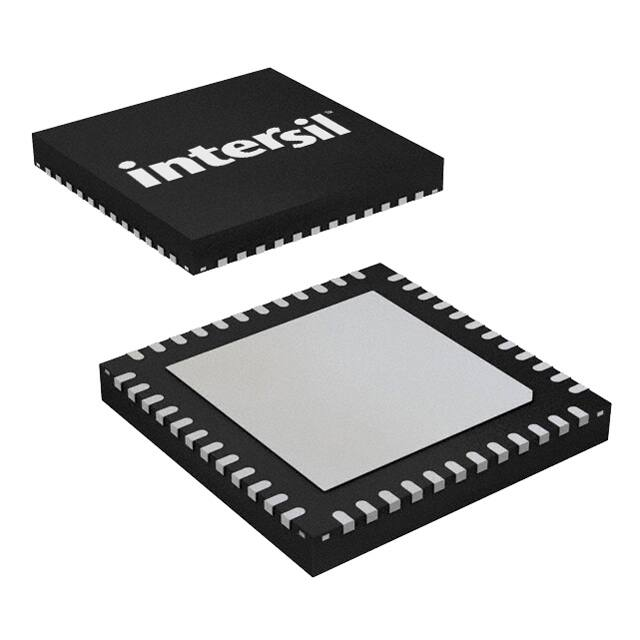

    ISL68137是一款数字双输出、灵活的多相(X + Y ≤ 7)PWM控制器,具备自适应电压调节总线(AVSBus)接口。ISL68137可配置为支持任意所需的相数分配,两个输出(X + Y)的相数...
ISL68137IRAZ 数据手册
DATASHEET ISL68137 Digital Dual Output, 7-Phase Configurable PWM Controller with Adaptive Voltage Scaling Bus (AVSBus) The ISL68137 is a digital dual output, flexible multiphase (X+Y ≤ 7) PWM controller with Adaptive Voltage Scaling Bus (AVSBus) interface. The ISL68137 can be configured to support any desired phase assignments up to a maximum of seven phases across the two outputs (X+Y). For example, 6+1, 5+2, 4+2, 3+3, 3+2, or even a single output as a 7+0 configuration are supported. The flexible phase arrangement, combined with PMBus and AVSBus interfaces, allows the device to support any demanding power supply requirement. The ISL68137 with AVSBus complements PMBus by providing a common interface that accelerates point-to-point communication between the controller and the load to statically and dynamically control the processor voltage, thus delivering a balanced and power-efficient solution. AVSBus can be used exclusively after the device is configured using PMBus. The ISL68137 uses Intersil’s proprietary linear synthetic digital current modulation scheme to achieve the industry’s best combination of transient response and ease of tuning, while addressing the challenges of modern multiphase designs. Device configuration and telemetry monitoring is accomplished using Intersil's intuitive PowerNavigator™ GUI. The ISL68137 device supports on-chip nonvolatile memory to store various configuration settings that are user selectable through pin-strap, giving system designers increased power density to configure and deploy multiple configurations. The device supports an automatic phase add/drop feature to allow maximum efficiency across all load ranges. Thresholds for automatic phase add/drop are user programmable using the powerful PowerNavigator GUI. The ISL68137 supports a comprehensive fault management system to enable the design of highly reliable systems. From a multitiered overcurrent protection scheme, to the configurable power-good and output overvoltage/undervoltage fault thresholds and temperature monitoring, almost any need is accommodated. With minimal external components, easy configuration, robust fault management, and highly accurate regulation capability, implementing a high-performance multiphase regulator has never been easier. Applications • Networking equipment • Telecom and datacom equipment • Server and storage equipment • Point-of-load power supply (Memory, DSP, ASIC, FPGA) FN8757 Rev.1.00 Jun 26, 2017 FN8757 Rev.1.00 Jun 26, 2017 Features • PMBus 1.3 and AVSBus compliant - Telemetry - VIN, VOUT, IOUT, power IN/OUT, temperature, and various fault status registers - Individual AVSBus interface enables high speed voltage changes • Advanced linear digital modulation scheme - Zero latency synthetic current control for excellent HF current balance - Dual-edge modulation for fastest transient response • Auto phase add/drop for excellent load vs efficiency profile • Flexible phase configuration - 7+0, 6+1, 5+2, 4+3 phase operation - Operation using less than seven phases between two outputs is also supported • Diode braking for overshoot reduction • Differential remote voltage sensing supports ±0.5% closed loop system accuracy over load, line, and temperature • Highly accurate current sensing for excellent load-line regulation and accurate OCP - Supports ISL99227 60A smart power stages - Supports DCR sense with integrated temperature compensation • Supports phase doubler (ISL6617A) for up to 14-phase operation • Comprehensive fault management enables high reliability systems - Pulse-by-pulse phase current limiting - Total output current protection - Output and input OV/UV - Open voltage sense detect - Black box recording capability for faults • Intuitive configuration using the PowerNavigator GUI - NVM to store up to eight configurations • Pb-free (RoHS compliant) Related Literature • For a full list of related documents, visit our website - ISL68137 product page Page 1 of 54 ISL68137 Table of Contents Ordering Information . . . . . . . . . . . . . . . . . . . . . . . . . . . . . . . . . . . . . . . . . . . . . . . . . . . . . . . . . . . . . . . . . . . . . . . . . . . . . . . . . . . . . . . . 3 Pin Configuration. . . . . . . . . . . . . . . . . . . . . . . . . . . . . . . . . . . . . . . . . . . . . . . . . . . . . . . . . . . . . . . . . . . . . . . . . . . . . . . . . . . . . . . . . . . . 3 Functional Pin Descriptions. . . . . . . . . . . . . . . . . . . . . . . . . . . . . . . . . . . . . . . . . . . . . . . . . . . . . . . . . . . . . . . . . . . . . . . . . . . . . . . . . . . 4 Driver, DrMOS, and Smart Power Stage Recommendation . . . . . . . . . . . . . . . . . . . . . . . . . . . . . . . . . . . . . . . . . . . . . . . . . . . . . . . . . 5 Internal Block Diagram . . . . . . . . . . . . . . . . . . . . . . . . . . . . . . . . . . . . . . . . . . . . . . . . . . . . . . . . . . . . . . . . . . . . . . . . . . . . . . . . . . . . . . . 5 Typical Application: 6+1 Configuration with ISL99227 SPS . . . . . . . . . . . . . . . . . . . . . . . . . . . . . . . . . . . . . . . . . . . . . . . . . . . . . . . . 6 Typical Application: 4+3 Configuration with ISL99227 SPS . . . . . . . . . . . . . . . . . . . . . . . . . . . . . . . . . . . . . . . . . . . . . . . . . . . . . . . . 7 Typical Application: 5+2 Configuration with DCR Sensing . . . . . . . . . . . . . . . . . . . . . . . . . . . . . . . . . . . . . . . . . . . . . . . . . . . . . . . . . 8 Typical Application: Phase Doubler . . . . . . . . . . . . . . . . . . . . . . . . . . . . . . . . . . . . . . . . . . . . . . . . . . . . . . . . . . . . . . . . . . . . . . . . . . . . 9 Absolute Maximum Ratings . . . . . . . . . . . . . . . . . . . . . . . . . . . . . . . . . . . . . . . . . . . . . . . . . . . . . . . . . . . . . . . . . . . . . . . . . . . . . . . . . . 10 Thermal Information . . . . . . . . . . . . . . . . . . . . . . . . . . . . . . . . . . . . . . . . . . . . . . . . . . . . . . . . . . . . . . . . . . . . . . . . . . . . . . . . . . . . . . . . 10 Recommended Operating Conditions . . . . . . . . . . . . . . . . . . . . . . . . . . . . . . . . . . . . . . . . . . . . . . . . . . . . . . . . . . . . . . . . . . . . . . . . . 10 Electrical Specifications . . . . . . . . . . . . . . . . . . . . . . . . . . . . . . . . . . . . . . . . . . . . . . . . . . . . . . . . . . . . . . . . . . . . . . . . . . . . . . . . . . . . 10 Typical Performance Curves . . . . . . . . . . . . . . . . . . . . . . . . . . . . . . . . . . . . . . . . . . . . . . . . . . . . . . . . . . . . . . . . . . . . . . . . . . . . . . . . . 12 Functional Description . . . . . . . . . . . . . . . . . . . . . . . . . . . . . . . . . . . . . . . . . . . . . . . . . . . . . . . . . . . . . . . . . . . . . . . . . . . . . . . . . . . . . . Overview . . . . . . . . . . . . . . . . . . . . . . . . . . . . . . . . . . . . . . . . . . . . . . . . . . . . . . . . . . . . . . . . . . . . . . . . . . . . . . . . . . . . . . . . . . . . . . . . . . . . . . . PWM Modulation Scheme . . . . . . . . . . . . . . . . . . . . . . . . . . . . . . . . . . . . . . . . . . . . . . . . . . . . . . . . . . . . . . . . . . . . . . . . . . . . . . . . . . . . . . . . PMBus Address Selection. . . . . . . . . . . . . . . . . . . . . . . . . . . . . . . . . . . . . . . . . . . . . . . . . . . . . . . . . . . . . . . . . . . . . . . . . . . . . . . . . . . . . . . . . Phase Configuration . . . . . . . . . . . . . . . . . . . . . . . . . . . . . . . . . . . . . . . . . . . . . . . . . . . . . . . . . . . . . . . . . . . . . . . . . . . . . . . . . . . . . . . . . . . . . Automatic Phase Add and Drop . . . . . . . . . . . . . . . . . . . . . . . . . . . . . . . . . . . . . . . . . . . . . . . . . . . . . . . . . . . . . . . . . . . . . . . . . . . . . . . . . . . Output Voltage Configuration. . . . . . . . . . . . . . . . . . . . . . . . . . . . . . . . . . . . . . . . . . . . . . . . . . . . . . . . . . . . . . . . . . . . . . . . . . . . . . . . . . . . . . Switching Frequency . . . . . . . . . . . . . . . . . . . . . . . . . . . . . . . . . . . . . . . . . . . . . . . . . . . . . . . . . . . . . . . . . . . . . . . . . . . . . . . . . . . . . . . . . . . . . Current Sensing . . . . . . . . . . . . . . . . . . . . . . . . . . . . . . . . . . . . . . . . . . . . . . . . . . . . . . . . . . . . . . . . . . . . . . . . . . . . . . . . . . . . . . . . . . . . . . . . . Temperature Sensing . . . . . . . . . . . . . . . . . . . . . . . . . . . . . . . . . . . . . . . . . . . . . . . . . . . . . . . . . . . . . . . . . . . . . . . . . . . . . . . . . . . . . . . . . . . . Temperature Compensation . . . . . . . . . . . . . . . . . . . . . . . . . . . . . . . . . . . . . . . . . . . . . . . . . . . . . . . . . . . . . . . . . . . . . . . . . . . . . . . . . . . . . . Lossless Input Current and Power Sensing . . . . . . . . . . . . . . . . . . . . . . . . . . . . . . . . . . . . . . . . . . . . . . . . . . . . . . . . . . . . . . . . . . . . . . . . . . Voltage Regulation . . . . . . . . . . . . . . . . . . . . . . . . . . . . . . . . . . . . . . . . . . . . . . . . . . . . . . . . . . . . . . . . . . . . . . . . . . . . . . . . . . . . . . . . . . . . . . Current Feedback . . . . . . . . . . . . . . . . . . . . . . . . . . . . . . . . . . . . . . . . . . . . . . . . . . . . . . . . . . . . . . . . . . . . . . . . . . . . . . . . . . . . . . . . . . . . . . . Power-On Reset (POR) . . . . . . . . . . . . . . . . . . . . . . . . . . . . . . . . . . . . . . . . . . . . . . . . . . . . . . . . . . . . . . . . . . . . . . . . . . . . . . . . . . . . . . . . . . . Soft-Start Delay and Ramp Times . . . . . . . . . . . . . . . . . . . . . . . . . . . . . . . . . . . . . . . . . . . . . . . . . . . . . . . . . . . . . . . . . . . . . . . . . . . . . . . . . . Stored Configuration Selection . . . . . . . . . . . . . . . . . . . . . . . . . . . . . . . . . . . . . . . . . . . . . . . . . . . . . . . . . . . . . . . . . . . . . . . . . . . . . . . . . . . . 13 13 13 13 13 13 14 14 14 15 16 16 17 17 17 17 17 Fault Monitoring and Protection . . . . . . . . . . . . . . . . . . . . . . . . . . . . . . . . . . . . . . . . . . . . . . . . . . . . . . . . . . . . . . . . . . . . . . . . . . . . . . Power-Good Signals. . . . . . . . . . . . . . . . . . . . . . . . . . . . . . . . . . . . . . . . . . . . . . . . . . . . . . . . . . . . . . . . . . . . . . . . . . . . . . . . . . . . . . . . . . . . . . Output Voltage Protection . . . . . . . . . . . . . . . . . . . . . . . . . . . . . . . . . . . . . . . . . . . . . . . . . . . . . . . . . . . . . . . . . . . . . . . . . . . . . . . . . . . . . . . . Output Current Protection. . . . . . . . . . . . . . . . . . . . . . . . . . . . . . . . . . . . . . . . . . . . . . . . . . . . . . . . . . . . . . . . . . . . . . . . . . . . . . . . . . . . . . . . . Smart Power Stage OC Fault Detect . . . . . . . . . . . . . . . . . . . . . . . . . . . . . . . . . . . . . . . . . . . . . . . . . . . . . . . . . . . . . . . . . . . . . . . . . . . . . . . . Thermal Monitoring and Protection. . . . . . . . . . . . . . . . . . . . . . . . . . . . . . . . . . . . . . . . . . . . . . . . . . . . . . . . . . . . . . . . . . . . . . . . . . . . . . . . . 17 18 18 18 20 20 Layout and Design Considerations. . . . . . . . . . . . . . . . . . . . . . . . . . . . . . . . . . . . . . . . . . . . . . . . . . . . . . . . . . . . . . . . . . . . . . . . . . . . . . . . . . . . 21 PMBus Operation . . . . . . . . . . . . . . . . . . . . . . . . . . . . . . . . . . . . . . . . . . . . . . . . . . . . . . . . . . . . . . . . . . . . . . . . . . . . . . . . . . . . . . . . . . . 22 PMBus Protocol . . . . . . . . . . . . . . . . . . . . . . . . . . . . . . . . . . . . . . . . . . . . . . . . . . . . . . . . . . . . . . . . . . . . . . . . . . . . . . . . . . . . . . . . . . . . 23 PMBus Command Summary . . . . . . . . . . . . . . . . . . . . . . . . . . . . . . . . . . . . . . . . . . . . . . . . . . . . . . . . . . . . . . . . . . . . . . . . . . . . . . . . . . 24 PMBus Use Guidelines . . . . . . . . . . . . . . . . . . . . . . . . . . . . . . . . . . . . . . . . . . . . . . . . . . . . . . . . . . . . . . . . . . . . . . . . . . . . . . . . . . . . . . . . . . . 25 PMBus Data Formats . . . . . . . . . . . . . . . . . . . . . . . . . . . . . . . . . . . . . . . . . . . . . . . . . . . . . . . . . . . . . . . . . . . . . . . . . . . . . . . . . . . . . . . . . . . . 25 PMBus Command Detail . . . . . . . . . . . . . . . . . . . . . . . . . . . . . . . . . . . . . . . . . . . . . . . . . . . . . . . . . . . . . . . . . . . . . . . . . . . . . . . . . . . . . 26 OT_FAULT_LIMIT (4Fh) . . . . . . . . . . . . . . . . . . . . . . . . . . . . . . . . . . . . . . . . . . . . . . . . . . . . . . . . . . . . . . . . . . . . . . . . . . . . . . . . . . . . . . . . . . . 34 Adaptive Voltage Scaling (AVSBus) Functionality and Operation . . . . . . . . . . . . . . . . . . . . . . . . . . . . . . . . . . . . . . . . . . . . . . . . . . 49 AVSBus Master Send Subframe. . . . . . . . . . . . . . . . . . . . . . . . . . . . . . . . . . . . . . . . . . . . . . . . . . . . . . . . . . . . . . . . . . . . . . . . . . . . . . . . . . . . 49 AVSBus Slave Response Subframe. . . . . . . . . . . . . . . . . . . . . . . . . . . . . . . . . . . . . . . . . . . . . . . . . . . . . . . . . . . . . . . . . . . . . . . . . . . . . . . . . 49 AVSBus Command Detail . . . . . . . . . . . . . . . . . . . . . . . . . . . . . . . . . . . . . . . . . . . . . . . . . . . . . . . . . . . . . . . . . . . . . . . . . . . . . . . . . . . . 50 Revision History. . . . . . . . . . . . . . . . . . . . . . . . . . . . . . . . . . . . . . . . . . . . . . . . . . . . . . . . . . . . . . . . . . . . . . . . . . . . . . . . . . . . . . . . . . . . 53 About Intersil . . . . . . . . . . . . . . . . . . . . . . . . . . . . . . . . . . . . . . . . . . . . . . . . . . . . . . . . . . . . . . . . . . . . . . . . . . . . . . . . . . . . . . . . . . . . . . 53 Package Outline Drawing . . . . . . . . . . . . . . . . . . . . . . . . . . . . . . . . . . . . . . . . . . . . . . . . . . . . . . . . . . . . . . . . . . . . . . . . . . . . . . . . . . . . 54 FN8757 Rev.1.00 Jun 26, 2017 Page 2 of 54 ISL68137 Ordering Information PART NUMBER (Notes 1, 2, 3) ISL68137IRAZ PART MARKING TEMP. RANGE (°C) ISL68137 IRZ PACKAGE (RoHS COMPLIANT) -40 to +85 PKG. DWG. # 48 Ld 6x6 QFN L48.6x6B NOTES: 1. Add “-T” suffix for 4k unit or “-T7A” suffix for 250 unit tape and reel options. Refer to TB347 for details on reel specifications. 2. These Intersil Pb-free plastic packaged products employ special Pb-free material sets, molding compounds/die attach materials and 100% matte tin plate plus anneal (e3 termination finish, which is RoHS compliant and compatible with both SnPb and Pb-free soldering operations). Intersil Pb-free products are MSL classified at Pb-free peak reflow temperatures that meet or exceed the Pb-free requirements of IPC/JEDEC J STD-020. 3. For Moisture Sensitivity Level (MSL), see the product information page for ISL68137. For more information on MSL, see TB363. TABLE 1. KEY DIFFERENCES BETWEEN FAMILY OF PARTS PART NUMBER PHASE CONFIGURATION OUTPUT X/OUTPUT Y SPECIFICATION SUPPORTED PACKAGE ISL68137 X+Y ≤ 7 PMBus/AVSBus QFN 48 Ld, 6x6mm ISL68134 X+Y ≤ 4 PMBus/AVSBus TQFN 40 Ld, 5x5mm ISL68127 X+Y ≤ 7 PMBus QFN 48 Ld, 6x6mm ISL68124 X+Y ≤ 4 PMBus TQFN 40 Ld, 5x5mm Pin Configuration DNC DNC DNC TMON1 TMON0 VCCS VCC SA VSEN0 RGND0 CS0 CSRTN0 ISL68137 (48 LD QFN) TOP VIEW 48 47 46 45 44 43 42 41 40 39 38 37 PWM0 1 36 CS1 PWM1 2 35 CSRTN1 PWM2 3 34 CS2 PWM3 4 33 CSRTN2 PWM4 5 32 CS3 PWM5 6 31 CSRTN3 GND (EPAD) PWM6 7 AVS_CLK 8 29 CSRTN4 AVS_SDA 9 28 CS5 30 CS4 AVS_MDA 10 27 CSRTN5 26 CS6 AVS_VDDIO 11 25 CSRTN6 FN8757 Rev.1.00 Jun 26, 2017 13 14 15 16 17 18 19 20 21 22 23 24 EN0 EN1 TWARN PG0 PG1 SCL SDA SALRT CONFIG VINSEN VSEN1 RGND1 DNC 12 Page 3 of 54 ISL68137 Functional Pin Descriptions Refer to Table 4 on page 21 for design layout considerations. PIN NUMBER PIN NAME 7, 6, 5, 4, 3, 2, 1 PWM[6:0] Pulse width modulation outputs. Connect these pins to the PWM input pins of 3.3V logic compatible Intersil smart power stages, driver IC(s), or power stages. 8 AVS_CLK AVSBus clock input pin. Connect to ground if not used. 9 AVS_SDA AVSBus data output pin. Leave open if not used. 10 AVS_MDA AVSBus data input pin. Connect to ground if not used. 11 AVS_VDDIO 12, 46, 47, 48 DNC Do not connect any signals to these pins. 13 EN0 Input pin used for enable control of Output 0. Active high. Connect to ground if not used. 14 EN1 Input pin used for enable control of Output 1. Active high. Connect to ground if not used. 15 TWARN 16 PG0 Open-drain, power-good indicators for Output 0. Maximum pull-up voltage is VCC. 17 PG1 Open-drain, power-good indicators for Output 1. Maximum pull-up voltage is VCC. 18 SCL Serial clock signal pin for SMBus interface. Maximum pull-up voltage is VCC. 19 SDA Serial data signal pin for SMBus interface. Maximum pull-up voltage is VCC. 20 SALRT Serial alert signal pin for SMBus interface. Maximum pull-up voltage is VCC. 21 CONFIG Configuration ID selection pin. See Table 3 for more details. 22 VINSEN Input voltage sense pin. Connect to VIN through a resistor divider (typically 40.2k/10k) with a 10nF decoupling capacitor. 23 VSEN1 Positive differential voltage sense input for Output 1. Connect to positive remote sensing point. Connect to ground if not used. 24 RGND1 Negative differential voltage sense input for Output 1. Connect to negative remote sensing point. Connect to ground if not used. 25, 27, 29, 31, 33, 35, 37 CSRTN[6:0] 26, 28, 30, 32, 34, 36, 38 CS[6:0] The CS and CSRTN pins are current sense inputs to individual phase differential amplifiers. Unused phases should have their respective current sense inputs grounded. The ISL68137 supports smart power stage, DCR, and resistor sensing. Connection details depend on current sense method chosen. 39 RGND0 Negative differential voltage sense input for Output 0. Connect to negative remote sensing point. Connect to ground if not used. 40 VSEN0 Positive differential voltage sense input for Output 0. Connect to positive remote sensing point. Connect to ground if not used. 41 SA PMBus Address selection pin. See Table 2 on page 13 for more details. 42 VCC Chip primary bias input. Connect this pin directly to a +3.3V supply with a high quality MLCC bypass capacitor. 43 VCCS Internally generated 1.2V LDO logic supply from VCC. Decouple with 4.7µF or greater MLCC (X5R or better). 44 TMON0 Input pin for external temperature measurement at Output 0. Supports diode based temperature sensing as well as smart power stage sensing. Refer to section “Temperature Compensation” on page 16 for more information. 45 TMON1 Input pin for external temperature measurement at Output 1. Supports diode based temperature sensing as well as smart power stage sensing. Refer to section “Temperature Compensation” on page 16 for more information. EPAD GND FN8757 Rev.1.00 Jun 26, 2017 DESCRIPTION AVSBus reference voltage input pin. Leave open if not used. Thermal warning flag. This open-drain output will be pulled low in the event of a sensed over-temperature at TMON pins without disabling the regulators. Maximum pull-up voltage is VCC. Package pad serves as GND return for all chip functions. Connect directly to system GND plane with multiple thermal vias. Page 4 of 54 ISL68137 Driver, DrMOS, and Smart Power Stage Recommendation INTERSIL PART NUMBER QUIESCENT CURRENT (mA) GATE DRIVE VOLTAGE (V) NUMBER OF DRIVERS ISL99227 4.85 5 Single 60A, 5x5 smart power stage ISL99140 0.19 5 Single 40A, 6x6 DrMOS ISL6596 0.19 5 Single Connect ISL6596 VCTRL to 3.3V ISL6617A 5 N/A N/A COMMENTS Phase doubler with 5V PWM output to be compatible with a 60A DrMOS or with 60A smart power stage. Supports up to a 14-phase design. Internal Block Diagram CS0 CYCLECYCLE OCP ADC CSRTN0 CS1 CSRTN1 CS2 CSRTN2 CS3 CSRTN3 CS4 CSRTN4 CS5 CSRTN6 CS6 CSRTN6 ADC CYCLECYCLE OCP ADC CYCLECYCLE OCP ADC CYCLECYCLE OCP ADC CYCLECYCLE OCP ADC CYCLECYCLE OCP ADC CYCLECYCLE OCP ISUM-0 SUMMED OCP PG0 STATUS MANAGER PG1 TWARN EN0 LOOP MANAGER EN1 CONFIG CPU SA NVM BLACKBO X RGND0 ADC VSA SUMMED OCP OV CURRENT AC FB VDROOP VSE N1 RGND1 VSA ADC UV + + PID OV VINSEN UV + + TMO N0 TMO N1 ADC VCC PWM0 DIG ITAL DUAL EDGE MODULATOR PID DIG ITAL DUAL EDGE MODULATOR PMBus INTERFACE PWM3 PWM4 PWM5 SCL SDA SALRT AVS_CLK AVSBus INTERFACE VCCS PWM2 PWM6 FAULT AND TELEMETRY MANAGER LDO PWM1 PHASE MANAGER VSE N0 ISUM-1 CURRENT AC FB VDROOP AVS_MDA AVS_SDA AVS_VDDIO FIGURE 1. INTERNAL BLOCK DIAGRAM FN8757 Rev.1.00 Jun 26, 2017 Page 5 of 54 ISL68137 Typical Application: 6+1 Configuration with ISL99227 SPS RGND0 VSEN0 1k EN0 VCCS PG0 4.7µF 100 TMON0 3.3V ISL99227 VCC 4.7µF TMON PWM 470pF PWM0 CS0 CSRTN0 100 0.1µF 470pF IMON REFIN 5V VIN BOOT 0.1µF 2x22µF 12V PHASE FAULT# 12V GND SW ISL99227 40.2k TMON VINSEN PWM1 10k PVCC VCC 0.01µF 100 CS1 CSRTN1 PWM 0.1µF 470pF IMON REFIN PVCC VCC COUT VIN BOOT VOUT0 5V 12V 0.1µF 2x22µF PHASE FAULT# ISL68137 GND SW ISL99227 TMON PWM2 CS2 CSRTN2 PWM 100 0.1µF 470pF REFIN 5V VIN BOOT 0.1µF 2x22µF 12V PHASE AVS_CLK FAULT# AVS_SDA GND SW ISL99227 AVS_MDA AVS_VDDIO IMON PVCC VCC TMON PWM3 CS3 CSRTN3 PWM 100 0.1µF 470pF IMON REFIN PVCC VCC 5V VIN BOOT 0.1µF 2x22µF 12V PHASE FAULT# GND SW ISL99227 TMON PWM4 CS4 TWARN CSRTN4 PWM 100 0.1µF 470pF VIN BOOT 12V 0.1µF 2x22µF VOUT1 FAULT# COUT GND SW ISL99227 SDA SA REFIN 5V PHASE SCL SALRT IMON PVCC VCC PWM5 CS5 CSRTN5 TMON PWM 100 0.1µF 470pF IMON REFIN TMON1 PWM6 CS6 CSRTN6 5V 12V VIN BOOT 0.1µF 2x22µF PHASE FAULT# CONFIG PVCC VCC GND SW ISL99227 TMON PWM 470pF 100 470pF IMON 0.1µF REFIN PVCC VCC 5V VIN BOOT 0.1µF 2x22µF 12V PHASE FAULT# GND SW PG1 1k EN1 RGND1 VSEN1 FIGURE 2. TYPICAL APPLICATION: 6+1 CONFIGURATION WITH ISL99227 SPS FN8757 Rev.1.00 Jun 26, 2017 Page 6 of 54 ISL68137 Typical Application: 4+3 Configuration with ISL99227 SPS RGND0 VSEN0 1k EN0 VCCS PG0 4.7µF 100 TMON0 ISL99227 VCC 3.3V 4.7µF PWM0 CS0 CSRTN0 TMON PWM 470pF 100 0.1µF 470pF IMON REFIN 5V PVCC VCC VIN BOOT 0.1µF 2x22µF 12V PHASE FAULT# 12V GND SW ISL99227 40.2k TMON VINSEN PWM1 10k 0.01µF CS1 CSRTN1 PWM 100 0.1µF 470pF IMON REFIN 5V PVCC VCC 12V VIN BOOT 0.1µF 2x22µF PHASE FAULT# ISL68137 GND SW ISL99227 TMON PWM2 CS2 PWM 100 0.1µF CSRTN2 IMON REFIN 470pF 12V VIN BOOT VOUT0 COUT 0.1µF 2x22µF PHASE AVS_CLK FAULT# AVS_SDA GND SW ISL99227 AVS_MDA AVS_VDDIO 5V PVCC VCC TMON PWM3 100 CS3 CSRTN3 PWM 0.1µF 470pF IMON REFIN 5V PVCC VCC VIN BOOT 0.1µF 2x22µF 12V PHASE FAULT# GND SW ISL99227 TMON PWM4 CS4 TWARN CSRTN4 PWM 100 0.1µF 470pF 0.1µF 2x22µF 12V GND SW ISL99227 SDA SA VIN BOOT PHASE FAULT# SCL SALRT IMON REFIN 5V PVCC VCC PWM5 CS5 CSRTN5 TMON PWM 100 0.1µF 470pF IMON REFIN TMON1 CSRTN6 0.1µF 2x22µF GND SW ISL99227 CONFIG CS6 12V VIN BOOT VOUT1 COUT PHASE FAULT# PWM6 5V PVCC VCC TMON PWM 470pF 100 470pF IMON 0.1µF REFIN 5V PVCC VCC 12V VIN BOOT 0.1µF 2x22µF PHASE FAULT# GND SW PG1 1k EN1 RGND1 VSEN1 FIGURE 3. TYPICAL APPLICATION: 4+3 CONFIGURATION WITH ISL99227 SPS FN8757 Rev.1.00 Jun 26, 2017 Page 7 of 54 ISL68137 Typical Application: 5+2 Configuration with DCR Sensing RGND0 VSEN0 1k EN0 VCCS PG0 0.1µF PWM0 EN THDN BOOT PHASE PWM VCC 3.3V PVCC VCC ISL99140 GND 5V VIN 2x22µF 12V SW CS0 4.7µF CSRTN0 TMON0 12V 40.2k 0.1µF VINSEN 10k PWM1 0.01µF EN THDN BOOT PHASE PWM PVCC VCC ISL99140 GND 5V VIN 2x22µF 12V VOUT0 COUT SW CS1 CSRTN1 ISL68137 0.1µF PWM2 EN THDN BOOT PHASE PWM PVCC VCC ISL99140 GND 5V VIN 2x22µF 12V SW CS2 CSRTN2 AVS_SDA AVS_MDA AVS_VDDIO 0.1µF PWM3 EN THDN BOOT PHASE PWM 5V PVCC VCC AVS_CLK ISL99140 GND VIN 12V 2x22µF SW CS3 CSRTN3 0.1µF TWARN PWM4 EN THDN BOOT PHASE PWM 5V PVCC VCC ISL99140 GND VIN 12V 2x22µF SW CS4 SCL COUT CSRTN4 SDA SALRT 0.1µF SA PWM5 EN THDN BOOT PHASE PWM 5V PVCC VCC ISL99140 GND VOUT1 VIN 12V 2x22µF SW CS5 CSRTN5 CONFIG 0.1µF PWM6 EN THDN BOOT PHASE PWM 5V PVCC VCC ISL99140 GND VIN 12V 2x22µF SW CS6 CSRTN6 PG1 1k EN1 TMON1 RGND1 VSEN1 FIGURE 4. TYPICAL APPLICATION: 5+2 CONFIGURATION WITH DCR SENSING FN8757 Rev.1.00 Jun 26, 2017 Page 8 of 54 ISL68137 Typical Application: Phase Doubler VCCS 4.7µF RGND0 EN0 PG0 100 VSEN 0 ISL99227B TMON0 PWM IMON VCC 3.3V PVCC VCC LGCTRL 4.7µF CSRTN0 470pF TMON ISL6617A 5V 0.1µF PWMIN IOUT BOOT 12V 0.1µF 2x22µF PHASE SW GND 0.1µF CSRTNA EN_SYNC PWM0 40.2k FAULT# PWMA CSENA VCC 12V VIN REFIN CS0 5V GND ISL99227B PWMB CSENB PWM CSRTNB PVCC VCC LGCTRL IMON VINSEN VIN REFIN 10k TMON FAULT# 0.01µF 5V BOOT 12V 0.1µF 2x22µF PHASE SW GND 0.1µF ISL99227B PWM PVCC VCC LGCTRL VIN IMON REFIN CS1 CSRTN1 470pF TMON ISL6617A 5V 0.1µF EN_SYNC PWMIN IOUT BOOT 12V 0.1µF 2x22µF PHASE GND SW 0.1µF CSRTNA VCC PWM1 FAULT# PWMA CSENA 5V GND ISL99227B PWMB CSENB PWM CSRTNB PVCC VCC LGCTRL IMON REFIN TMON FAULT# 5V VIN BOOT 12V 0.1µF 2x22µF PHASE GND SW 0.1µF CS2 CSRTN2 PWM2 CS3 CSRTN3 PWM3 ISL68137 CS4 CSRTN4 PWM4 ISL99227B PWM TWARN REFIN CSRTN5 470pF AVS_SDA AVS_MDA AVS_VDDIO TMON ISL6617A 5V 0.1µF EN_SYNC PWMIN IOUT BOOT 12V 0.1µF 2x22µF PHASE GND SW 0.1µF CSRTNA VCC PWM5 FAULT# PWMA CSENA 5V VIN IMON CS5 AVS_CLK PVCC VCC LGCTRL GND ISL99227B PWMB CSENB PWM CSRTNB PVCC VCC LGCTRL VIN IMON REFIN TMON FAULT# 5V BOOT 12V 0.1µF 2x22µF VOUT 1 COUT PHASE GND SW 0.1µF SCL ISL99227B SDA PWM SALRT SA REFIN 470pF FAULT# PWMA CSENA 0.1µF EN_SYNC PWMIN IOUT 12V 0.1µF 2x22µF PHASE GND SW 0.1µF GND ISL99227B PWMB CSENB PWM CSRTNB PVCC VCC LGCTRL IMON REFIN TMON TMON1 470pF PG1 BOOT CSRTNA VCC PWM6 TMON ISL6617A 5V 5V VIN IMON CS6 CSRTN6 CONFIG PVCC VCC LGCTRL FAULT# 5V VIN BOOT 12V 0.1µF 2x22µF PHASE GND SW 0.1µF 1k EN1 RGND1 VSEN 1 FIGURE 5. TYPICAL APPLICATION: PHASE DOUBLER FN8757 Rev.1.00 Jun 26, 2017 Page 9 of 54 ISL68137 Absolute Maximum Ratings Thermal Information VCC . . . . . . . . . . . . . . . . . . . . . . . . . . . . . . . . . . . . . . . . . . . . . . . . . . . . . . +4.3V VCCS. . . . . . . . . . . . . . . . . . . . . . . . . . . . . . . . . . . . . . . . . . . . . . . . . . . . . +1.6V All Other Pins . . . . . . . . . . . . . . . . . . . . . . . . . . . . (GND - 0.3V) to VCC + 0.3V ESD Rating: Human Body Model (Tested per JS-001-2014) . . . . . . . . . . . . . . . . . . 2kV Charged Device Model (Tested per JS-002-2014) . . . . . . . . . . . . . . . 1kV Latch-Up (Tested per JESD-78E; Class 2, Level A). . . . . . . . . . . . . . . 100mA Thermal Resistance (Notes 4, 5) JA (°C/W) JC (°C/W) 48 Ld 6x6 QFN Package . . . . . . . . . . . . . . . 27 1 Maximum Junction Temperature . . . . . . . . . . . . . . . . . . . . . . . . . . . .+150°C Maximum Storage Temperature Range . . . . . . . . . . . . . .-65°C to +150°C Pb-Free Reflow Profile . . . . . . . . . . . . . . . . . . . . . . . . . . . . . . . . . . see TB493 Recommended Operating Conditions Supply Voltage, VCC . . . . . . . . . . . . . . . . . . . . . . . . . . . . . . . . . . . . +3.3V ±5% Ambient Temperature . . . . . . . . . . . . . . . . . . . . . . . . . . . . . . -40°C to +85°C Output Voltage . . . . . . . . . . . . . . . . . . . . . . . . . . . . . . . . . . . . . . . 0V to 3.05V CAUTION: Do not operate at or near the maximum ratings listed for extended periods of time. Exposure to such conditions may adversely impact product reliability and result in failures not covered by warranty. NOTES: 4. JA is measured in free air with the component mounted on a high-effective thermal conductivity test board with “direct attach” features. See TB379. 5. For JC, the “case temp” location is the center of the exposed metal pad on the package underside. Electrical Specifications Recommended operating conditions, VCC = 3.3V, unless otherwise specified. Boldface limits apply across the operating temperature range -40°C to +85°C. PARAMETER TEST CONDITIONS MIN (Note 7) TYP MAX (Note 7) UNIT VCC SUPPLY CURRENT Nominal Supply Current VCC = 3.3VDC; EN1/2 = VIH, fSW = 400kHz 90.5 mA Shutdown Supply Current VCC = 3.3VDC; EN1/2 = 0V, no switching 11.4 mA VCCS LDO SUPPLY Output Voltage Maximum Current Capability 1.20 Excluding internal load 1.25 1.30 50 V mA POWER-ON RESET AND INPUT VOLTAGE LOCKOUT VCC Rising POR Threshold 2.7 2.9 V VCC Falling POR Threshold 1.0 V Enable (EN0 and EN1) Input High Level 2.55 V Enable (EN0 and EN1) Input Low Level 0.8 Enable (EN0 and EN1) LOW to HIGH Ramp Delay (TON_DELAY) 200 POR to Initialization Complete Time V µs 30 40 ms 0.25 3.05 V Set-point 0.8V to 3.05V -0.5 0.5 % Set-point 0.25V to
