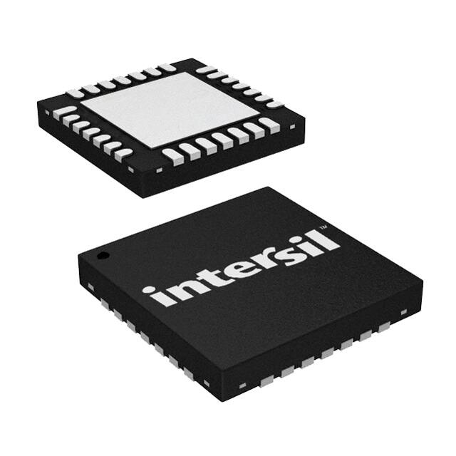

    ISL85033是一款双路标准降压调节器,能够提供每通道3A的连续输出电流。输入电压范围为4.5V至28V,输出电压可调,最高可达3A。该芯片采用峰值电流模式控制,具有独立的电源良好检测、可选的同相或...
ISL85033IRTZ 数据手册
DATASHEET ISL85033 Wide VIN Dual Standard Buck Regulator With 3A/3A Continuous Output Current FN6676 Rev 8.00 February 17, 2015 Features The ISL85033 is a dual standard buck regulator capable of 3A per channel continuous output current. With an input range of 4.5V to 28V, it provides a high frequency power solution for a variety of point of load applications. • Wide input voltage range from 4.5V to 28V • Adjustable output voltage with continuous output current up to 3A The PWM controller in the ISL85033 drives an internal switching N-Channel power MOSFET and requires an external Schottky diode to generate the output voltage. The integrated power switch is optimized for excellent thermal performance up to 3A of output current. The PWM regulator switches at a default frequency of 500kHz and it can be user programmed or synchronized from 300kHz to 2MHz. The ISL85033 utilizes peak current mode control to provide flexibility in component selection and minimize solution size. The protection features include overcurrent, UVLO and thermal overload protection. • Current mode control • Adjustable switching frequency from 300kHz to 2MHz • Independent power-good detection • Selectable in-phase or out-of-phase PWM operation • Independent, sequential, ratiometric or absolute tracking between outputs • Internal 2ms soft-start time • Overcurrent/short circuit protection, thermal overload protection, UVLO The ISL85033 is available in a small 4mmx4mm Thin Quad Flat No-Lead (TQFN) Pb-free package. • Boot undervoltage detection Related Literature • Pb-free (RoHS compliant) • AN1574 “ISL85033DUALEVAL1Z Wide VIN Dual Standard Buck Regulator With 3A/3A Output Current” Applications • AN1585 “ISL85033EVAL2Z (Small Form) Wide VIN Dual Standard Buck Regulator With 3A/3A Output Current - Short Form” • Set-top boxes • General purpose point-of-load DC/DC power conversion • FPGA power and STB power • AN1584 “ISL85033EVAL2Z (Small Form) Wide VIN Dual Standard Buck Regulator With 3A/3A Output Current - Long Form” • DVD and HDD drives • AN1605 “ISL85033CRSHEVAL1Z Wide VIN Current sharing Standard Buck Regulator With 6A Output Current” • Cable modems • LCD panels, TV power 100 EFFICIENCY (%) 90 12VOUT 1MHz 80 70 60 50 40 0.0 0.5 1.0 1.5 2.0 2.5 3.0 OUTPUT LOAD (A) FIGURE 1. EFFICIENCY vs LOAD, VIN = 28V, TA = +25°C FN6676 Rev 8.00 February 17, 2015 Page 1 of 26 ISL85033 Table of Contents Pin Configuration. . . . . . . . . . . . . . . . . . . . . . . . . . . . . . . . . . . . . . . . . . . . . . . . . . . . . . . . . . . . . . . . . . . . . . . . . . . . . . . . . . . . . . . . . . . . 3 Pin Descriptions. . . . . . . . . . . . . . . . . . . . . . . . . . . . . . . . . . . . . . . . . . . . . . . . . . . . . . . . . . . . . . . . . . . . . . . . . . . . . . . . . . . . . . . . . . . . . 3 Typical Application Schematics. . . . . . . . . . . . . . . . . . . . . . . . . . . . . . . . . . . . . . . . . . . . . . . . . . . . . . . . . . . . . . . . . . . . . . . . . . . . . . . . 5 Ordering Information . . . . . . . . . . . . . . . . . . . . . . . . . . . . . . . . . . . . . . . . . . . . . . . . . . . . . . . . . . . . . . . . . . . . . . . . . . . . . . . . . . . . . . . . 7 Absolute Maximum Ratings . . . . . . . . . . . . . . . . . . . . . . . . . . . . . . . . . . . . . . . . . . . . . . . . . . . . . . . . . . . . . . . . . . . . . . . . . . . . . . . . . . . 8 Thermal Information . . . . . . . . . . . . . . . . . . . . . . . . . . . . . . . . . . . . . . . . . . . . . . . . . . . . . . . . . . . . . . . . . . . . . . . . . . . . . . . . . . . . . . . . . 8 Recommended Operating Conditions . . . . . . . . . . . . . . . . . . . . . . . . . . . . . . . . . . . . . . . . . . . . . . . . . . . . . . . . . . . . . . . . . . . . . . . . . . 8 Electrical Specifications . . . . . . . . . . . . . . . . . . . . . . . . . . . . . . . . . . . . . . . . . . . . . . . . . . . . . . . . . . . . . . . . . . . . . . . . . . . . . . . . . . . . . 8 Typical Performance Curves . . . . . . . . . . . . . . . . . . . . . . . . . . . . . . . . . . . . . . . . . . . . . . . . . . . . . . . . . . . . . . . . . . . . . . . . . . . . . . . . . 10 Detailed Description . . . . . . . . . . . . . . . . . . . . . . . . . . . . . . . . . . . . . . . . . . . . . . . . . . . . . . . . . . . . . . . . . . . . . . . . . . . . . . . . . . . . . . . . 16 Operation Initialization. . . . . . . . . . . . . . . . . . . . . . . . . . . . . . . . . . . . . . . . . . . . . . . . . . . . . . . . . . . . . . . . . . . . . . . . . . . . . . . . . . . . . . Power-on Reset and Undervoltage Lockout . . . . . . . . . . . . . . . . . . . . . . . . . . . . . . . . . . . . . . . . . . . . . . . . . . . . . . . . . . . . . . . . . . . . . . . . . . Enable and Disable . . . . . . . . . . . . . . . . . . . . . . . . . . . . . . . . . . . . . . . . . . . . . . . . . . . . . . . . . . . . . . . . . . . . . . . . . . . . . . . . . . . . . . . . . . . . . . Power-good. . . . . . . . . . . . . . . . . . . . . . . . . . . . . . . . . . . . . . . . . . . . . . . . . . . . . . . . . . . . . . . . . . . . . . . . . . . . . . . . . . . . . . . . . . . . . . . . . . . . . Output Voltage Selection . . . . . . . . . . . . . . . . . . . . . . . . . . . . . . . . . . . . . . . . . . . . . . . . . . . . . . . . . . . . . . . . . . . . . . . . . . . . . . . . . . . . . . . . . 16 16 16 16 16 Output Tracking and Sequencing . . . . . . . . . . . . . . . . . . . . . . . . . . . . . . . . . . . . . . . . . . . . . . . . . . . . . . . . . . . . . . . . . . . . . . . . . . . . . 16 Protection Features. . . . . . . . . . . . . . . . . . . . . . . . . . . . . . . . . . . . . . . . . . . . . . . . . . . . . . . . . . . . . . . . . . . . . . . . . . . . . . . . . . . . . . . . . Buck Regulator Overcurrent Protection . . . . . . . . . . . . . . . . . . . . . . . . . . . . . . . . . . . . . . . . . . . . . . . . . . . . . . . . . . . . . . . . . . . . . . . . . . . . . Thermal Overload Protection . . . . . . . . . . . . . . . . . . . . . . . . . . . . . . . . . . . . . . . . . . . . . . . . . . . . . . . . . . . . . . . . . . . . . . . . . . . . . . . . . . . . . . BOOT Undervoltage Protection. . . . . . . . . . . . . . . . . . . . . . . . . . . . . . . . . . . . . . . . . . . . . . . . . . . . . . . . . . . . . . . . . . . . . . . . . . . . . . . . . . . . . 17 17 18 18 Application Guidelines . . . . . . . . . . . . . . . . . . . . . . . . . . . . . . . . . . . . . . . . . . . . . . . . . . . . . . . . . . . . . . . . . . . . . . . . . . . . . . . . . . . . . . Operating Frequency . . . . . . . . . . . . . . . . . . . . . . . . . . . . . . . . . . . . . . . . . . . . . . . . . . . . . . . . . . . . . . . . . . . . . . . . . . . . . . . . . . . . . . . . . . . . . Synchronization Control . . . . . . . . . . . . . . . . . . . . . . . . . . . . . . . . . . . . . . . . . . . . . . . . . . . . . . . . . . . . . . . . . . . . . . . . . . . . . . . . . . . . . . . . . . Output Inductor Selection. . . . . . . . . . . . . . . . . . . . . . . . . . . . . . . . . . . . . . . . . . . . . . . . . . . . . . . . . . . . . . . . . . . . . . . . . . . . . . . . . . . . . . . . . Buck Regulator Output Capacitor Selection. . . . . . . . . . . . . . . . . . . . . . . . . . . . . . . . . . . . . . . . . . . . . . . . . . . . . . . . . . . . . . . . . . . . . . . . . . Current Sharing Configuration . . . . . . . . . . . . . . . . . . . . . . . . . . . . . . . . . . . . . . . . . . . . . . . . . . . . . . . . . . . . . . . . . . . . . . . . . . . . . . . . . . . . . Input Capacitor Selection . . . . . . . . . . . . . . . . . . . . . . . . . . . . . . . . . . . . . . . . . . . . . . . . . . . . . . . . . . . . . . . . . . . . . . . . . . . . . . . . . . . . . . . . . Loop Compensation Design . . . . . . . . . . . . . . . . . . . . . . . . . . . . . . . . . . . . . . . . . . . . . . . . . . . . . . . . . . . . . . . . . . . . . . . . . . . . . . . . . . . . . . . Theory of Compensation. . . . . . . . . . . . . . . . . . . . . . . . . . . . . . . . . . . . . . . . . . . . . . . . . . . . . . . . . . . . . . . . . . . . . . . . . . . . . . . . . . . . . . . . . . PWM Comparator Gain Fm . . . . . . . . . . . . . . . . . . . . . . . . . . . . . . . . . . . . . . . . . . . . . . . . . . . . . . . . . . . . . . . . . . . . . . . . . . . . . . . . . . . . . . . Power Stage Transfer Functions . . . . . . . . . . . . . . . . . . . . . . . . . . . . . . . . . . . . . . . . . . . . . . . . . . . . . . . . . . . . . . . . . . . . . . . . . . . . . . . . . . . Rectifier Selection . . . . . . . . . . . . . . . . . . . . . . . . . . . . . . . . . . . . . . . . . . . . . . . . . . . . . . . . . . . . . . . . . . . . . . . . . . . . . . . . . . . . . . . . . . . . . . . Power Derating Characteristics . . . . . . . . . . . . . . . . . . . . . . . . . . . . . . . . . . . . . . . . . . . . . . . . . . . . . . . . . . . . . . . . . . . . . . . . . . . . . . . . . . . . Layout Considerations. . . . . . . . . . . . . . . . . . . . . . . . . . . . . . . . . . . . . . . . . . . . . . . . . . . . . . . . . . . . . . . . . . . . . . . . . . . . . . . . . . . . . . . . . . . . 18 18 18 18 18 19 19 19 20 20 20 21 22 22 Revision History. . . . . . . . . . . . . . . . . . . . . . . . . . . . . . . . . . . . . . . . . . . . . . . . . . . . . . . . . . . . . . . . . . . . . . . . . . . . . . . . . . . . . . . . . . . . 24 About Intersil . . . . . . . . . . . . . . . . . . . . . . . . . . . . . . . . . . . . . . . . . . . . . . . . . . . . . . . . . . . . . . . . . . . . . . . . . . . . . . . . . . . . . . . . . . . . . . 25 Package Outline Drawing . . . . . . . . . . . . . . . . . . . . . . . . . . . . . . . . . . . . . . . . . . . . . . . . . . . . . . . . . . . . . . . . . . . . . . . . . . . . . . . . . . . . 26 FN6676 Rev 8.00 February 17, 2015 Page 2 of 26 ISL85033 Pin Configuration PGOOD1 FS NC SGND SYNCIN SYNCOUT PGOOD2 ISL85033 (28 LD TQFN) TOP VIEW 28 27 26 25 24 23 22 COMP1 1 21 COMP2 FB1 2 20 FB2 SS1 3 19 SS2 PGND1 4 BOOT1 5 17 BOOT2 PHASE1 6 16 PHASE2 PHASE1 7 15 PHASE2 18 PGND2 9 10 11 12 13 VIN1 EN1 VCC EN2 VIN2 14 VIN2 8 VIN1 PD Pin Descriptions PIN NUMBER SYMBOL 1, 21 COMP1, COMP2 2, 20 FB1, FB2 Feedback pin for the regulator. FB is the negative input to the voltage loop error amplifier. COMP is the output of the error amplifier. The output voltage is set by an external resistor divider connected to FB. In addition, the PWM regulator’s power-good and undervoltage protection circuits use FB1, FB2 to monitor the regulator output voltage. 3, 19 SS1, SS2 Soft-start pins for each controller. The SS1, SS2 pins control the soft-start and sequence of their respective outputs. A single capacitor from the SS pin to ground determines the output ramp rate. See the “Output Tracking and Sequencing” on page 16 for soft-start and output tracking/sequencing details. If SS pins are tied to VCC, an internal soft-start of 2ms will be used. Maximum CSS value is 100nF. 4, 18 PGND1, PGND2 Power ground connections. Connect directly to the system GND plane. 5, 17 BOOT1, BOOT2 Floating bootstrap supply pin for the power MOSFET gate driver. The bootstrap capacitor provides the necessary charge to turn on the internal N-Channel MOSFET. Connect an external capacitor from this pin to PHASE. 6, 7, 15, 16 PHASE1, PHASE2 Switch node output. It connects the source of the internal power MOSFET with the external output inductor and with the cathode of the external diode. 8, 9, 13, 14 VIN1, VIN2 The input supply for the power stage of the PWM regulator and the source for the internal linear regulator that provides bias for the IC. Place a minimum of 10µF ceramic capacitance from each VIN to GND and close to the IC for decoupling. 10, 12 EN1, EN2 PWM controller’s enable inputs. The PWM controllers are held off when the pin is pulled to ground. When the voltage on this pin rises above 2V, the PWM controller is enabled. If EN1, EN2 pins are driven by an external signal, the minimum off-time for EN1, EN2 should be: EN_T_off  s  = 10s  C SS  2.2nF where CSS is the soft-start pin capacitor (nF). The ISL85033 does not have debouncing to EN1, EN2 external signals. 11 VCC Output of the internal 5V linear regulator. Decouple to PGND with a minimum of 4.7µF ceramic capacitor. This pin is provided only for internal bias of ISL85033 (not to be loaded with current over 10mA). FN6676 Rev 8.00 February 17, 2015 PIN DESCRIPTION COMP1, COMP2 are the output of the error amplifier. Page 3 of 26 ISL85033 Pin Descriptions (Continued) PIN NUMBER SYMBOL 23 SYNCOUT 24 SYNCIN 25 SGND 26 NC This is a no connection pin. 27 FS Frequency selection pin. Tie to VCC for 500kHz switching frequency. Connect a resistor to GND for adjustable frequency from 300kHz to 2MHz. 22, 28 PGOOD2, PGOOD1 PD FN6676 Rev 8.00 February 17, 2015 PIN DESCRIPTION Synchronization output. Provides a signal that is the inverse of the SYNCIN signal. Connect to an external signal for synchronization from 300kHz to 2MHz (negative edge trigger). SYNCIN is not allowed to be floating. When SYNCIN = logic 0, PHASE1 and PHASE2 are running at 180° out-of-phase. When SYNCIN = logic 1, PHASE1 and PHASE2 are running at 0° in-phase. When SYNCIN = an external clock, PHASE1 and PHASE2 are running at 180° out-of-phase. External SYNC frequency applied to the SYNCIN pin should be at least 2.4 x the internal switching frequency setting. Signal ground connections. The exposed pad must be connected to SGND and soldered to the PCB. All voltage levels are measured with respect to this pin. Open-drain power-good output that is pulled to ground when the output voltage is below regulation limits or during the soft-start interval. There is an internal 5MΩ internal pull-up resistor. The exposed pad must be connected to the system GND plane with as many vias as possible for proper electrical and thermal performance. Page 4 of 26 ISL85033 Typical Application Schematics R6 8.06k FB2 COMP2 C4 68pF VCC VCC SS1 3 VCC PGOOD2 PGOOD1 L2 7µH VOUT2 3A C5 470pF C2 470pF R8 69.8k R4 69.8k 21 20 FS 27 SS2 19 C1 68pF 1 2 8/9 VIN1 10µF 22 C72 ISL85033 28 PHASE2 L1 7µH PHASE1 6/7 C12 10nF D2 B340B C71 20µF VIN2 13/14 15/16 5 BOOT1 C8 10nF EN1 11 VCC 10 25 SGND 26 NC 12 EN2 23 4/18 SYNCOUT SYNCIN 24 VOUT1 3A C9 47µF D1 B340B BOOT2 17 PGND1/2 C13 47µF VOUT1 R1 42.2k R2 8.06k FB1 R5 25.5k COMP1 VOUT2 4.7µF FIGURE 2. DUAL 3A OUTPUT (VIN RANGE FROM 4.5V TO 28V) FB2 VOUT1 R5 42.2k COMP2 C5 1nF 20 SS2 SS1 PHASE2 13/14 3 6/7 15/16 C12 10nF 17 23 4/18 12 26 10 25 C71 20µF VIN2 C72 VOUT1 6A PHASE1 BOOT1 C8 10nF L1 7µH D1 B340B C9 47µF 11 VCC 24 SGND BOOT2 5 SYNCIN B340B VIN1 10µF ISL85033 EN2 D2 FB1 COMP1 19 PGND1/2 L2 7µH 2 8/9 PGOOD2 22 PGOOD1 28 VOUT1 C13 47µF 1 EN1 Css1 47nF FB2 27 SYNCOUT Css2 47nF 21 NC VCC FS R8 34k COMP2 R7 0 FB2 C4 68pF R6 8.06k 4.7µF FIGURE 3. SINGLE 6A OUTPUT (VIN RANGE FROM 4.5V TO 28V) CURRENT SHARING FN6676 Rev 8.00 February 17, 2015 Page 5 of 26 ISL85033 BOOT2 COMP2 FB2 PGOOD2 Functional Block Diagram VCC 5MΩ BOOT UV DETECTION + - VCC -10% SOFT-START CONTROL VOLTAGE MONITOR VIN2 CSA2 + - SS2 EA + - COMP2 0.8V REFERENCE FAULT MONITOR EN2 GATE DRIVE CSA2 VIN1 LDO VCC = 5V BOOT REFRESH CONTROL SLOPE COMP POWER-ON RESET MONITOR PHASE2 PGND2 + CSA2 VIN1 THERMAL MONITOR +150°C SYNCOUT CSA1 FS OSCILLATOR SYNCIN CSA1 SLOPE COMP + VIN1 CSA1 EN1 FAULT MONITOR 0.8V REFERENCE DRIVE GATE COMP1 EA + MONITOR VOLTAGE + CONTROL SOFT-START VCC 5MΩ -10% PGND1 BOOT UV DETECTION FN6676 Rev 8.00 February 17, 2015 BOOT1 SGND EPAD GND COMP1 FB1 PGOOD1 VCC VCC BOOT REFRESH CONTROL + SS1 PHASE1 Page 6 of 26 ISL85033 Ordering Information PART NUMBER (Notes 1, 2, 3) PART MARKING ISL85033IRTZ 850 33IRTZ ISL85033-12VEVAL3Z Evaluation Board ISL85033DUALEVAL1Z Evaluation Board ISL85033EVAL2Z Evaluation Board ISL85033CRSHEVAL1Z Evaluation Board TEMP. RANGE (°C) -40 to +85 PACKAGE (RoHS Compliant) 28 Ld TQFN PKG. DWG. # L28.4x4 NOTES: 1. Add “-T*” suffix for Tape and Reel. Please refer to TB347 for details on reel specifications. 2. These Intersil Pb-free plastic packaged products employ special Pb-free material sets, molding compounds/die attach materials, and 100% matte tin plate plus anneal (e3 termination finish, which is RoHS compliant and compatible with both SnPb and Pb-free soldering operations). Intersil Pb-free products are MSL classified at Pb-free peak reflow temperatures that meet or exceed the Pb-free requirements of IPC/JEDEC J STD-020. 3. For Moisture Sensitivity Level (MSL), please see device information page for ISL85033. For more information on MSL please see techbrief TB363. FN6676 Rev 8.00 February 17, 2015 Page 7 of 26 ISL85033 Absolute Maximum Ratings Thermal Information VIN1/2 to GND . . . . . . . . . . . . . . . . . . . . . . . . . . . . . . . . . . . . . -0.3V to +30V PHASE1/2 to GND . . . . . . . . . . . . . . . . . . . -7V ( 90% Floating High After VOUT2 > 90% First High High Same time as VOUT2 Same time as VOUT1 Floating Floating R2 8.06k NOTE R1 25.5k FIGURE 41. ABSOLUTE START-UP Not Allowed C3 C1 22nF C1 22nF VOUT1 5.0V C3 SS2 EN1 ISL85033 VOUT2 EN2 ISL85033 C2 47nF SS2 C2 22nF VOUT2 5.0V VOUT1 SS1 SS1 3.3V C4 TABLE 1. OUTPUT SEQUENCING EN2 5.0V C3 C1 47nF Figure 42 illustrates output sequencing. When EN1 is high and EN2 is floating, OUT1 comes up first and OUT2 will not start until OUT1 > 90% of its regulation point. If EN1 is floating and EN2 is high, OUT2 comes up first and OUT1 will not start until OUT2 > 90% of its regulation point. If EN1 = EN2 = high, OUT1 and OUT2 come up at the same time. Please refer to Table 1 for conditions related to Figure 42 (Output Sequencing). EN1 VOUT1 SS1 3.3V C4 3.3V C4 FIGURE 42. OUTPUT SEQUENCING Protection Features FIGURE 39. INDEPENDENT START-UP VOUT1 SS1 5.0V C3 C1 22nF SS2 ISL85033 VOUT2 3.3V C4 C2 22nF FIGURE 40. RATIOMETRIC START-UP The ISL85033 limits the current in all on-chip power devices. Overcurrent protection limits the current on the two buck regulators and internal LDO for VCC. Buck Regulator Overcurrent Protection During PWM on-time, current through the internal switching MOSFET is sampled and scaled through an internal pilot device. The sampled current is compared to a nominal 5A overcurrent limit. If the sampled current exceeds the overcurrent limit reference level, an internal overcurrent fault counter is set to 1 and an internal flag is set. The internal power MOSFET is immediately turned off and will not be turned on again until the next switching cycle. The protection circuitry continues to monitor the current and turns off the internal MOSFET as described. If the overcurrent condition persists for 17 sequential clock cycles, the overcurrent fault counter overflows indicating an overcurrent fault condition exists. The regulator is shutdown and power-good goes low. The buck controller attempts to recover from the overcurrent condition after waiting 8 soft-start cycles. The internal overcurrent flag and counter are reset. A normal soft-start cycle FN6676 Rev 8.00 February 17, 2015 Page 17 of 26 ISL85033 is attempted and normal operation continues if the fault condition has cleared. If the overcurrent fault counter overflows during soft-start, the converter shuts down and this hiccup mode operation repeats. Thermal Overload Protection Thermal overload protection limits maximum junction temperature in the ISL85033. When the junction temperature (TJ) exceeds +150°C, a thermal sensor sends a signal to the fault monitor. The fault monitor commands the buck regulator to shutdown. When the junction temperature has decreased by 20°C, the regulator will attempt a normal soft-start sequence and return to normal operation. For continuous operation, the +125°C junction temperature rating should not be exceeded. BOOT Undervoltage Protection If the BOOT capacitor voltage falls below 2.5V, the BOOT undervoltage protection circuit will pull the phase pin low through a 1Ω switch for 400ns to recharge the capacitor. This operation may arise during long periods of no switching as in no load situations. Application Guidelines Operating Frequency The ISL85033 operates at a default switching frequency of 500kHz if FS is tied to VCC. Tie a resistor from FS to GND to program the switching frequency from 300kHz to 2MHz, as shown in Equation 4. [Minimum on-time of 150ns (typical) in conjunction with the input and output voltage should be considered when selecting the maximum operating frequency]. (EQ. 4) R FS  k  = 122k  t – 0.17s  Where t is the switching period in µs. RFS (kΩ) 300 200 Synchronization Control The frequency of operation can be synchronized up to 2MHz by an external signal applied to the SYNCIN pin. The falling edge on the SYNCIN triggers the rising edge of PHASE1/2. The switching frequency for each output is half of the SYNCIN frequency. Output Inductor Selection The inductor value determines the converter’s ripple current. Choosing an inductor current requires a somewhat arbitrary choice of ripple current, I. A reasonable starting point is 30% of total load current. The inductor value can then be calculated using Equation 5: V IN – V OUT V OUT L = --------------------------------  ---------------f SW  I V IN (EQ. 5) Increasing the value of inductance reduces the ripple current and thus ripple voltage. However, the larger inductance value may reduce the converter’s response time to a load transient. The inductor current rating should be such that it will not saturate in overcurrent conditions. Buck Regulator Output Capacitor Selection An output capacitor is required to filter the inductor current. The Output ripple voltage and transient response are 2 critical factors when considering output capacitance choice. The current mode control loop allows the usage of low ESR ceramic capacitors and thus smaller board layout. Electrolytic and polymer capacitors may also be used. Additional consideration applies to ceramic capacitors. While they offer excellent overall performance and reliability, the actual in-circuit capacitance must be considered. Ceramic capacitors are rated using large peak-to-peak voltage swings and with no DC bias. In the DC/DC converter application, these conditions do not reflect reality. As a result, the actual capacitance may be considerably lower than the advertised value. Consult the manufacturers data sheet to determine the actual in-application capacitance. Most manufacturers publish capacitance vs DC bias so that this effect can be easily accommodated. The effects of AC voltage are not frequently published, but an assumption of ~20% further reduction will generally suffice. The result of these considerations can easily result in an effective capacitance 50% lower than the rated value. Nonetheless, they are a very good choice in many applications due to their reliability and extremely low ESR. The following equations allow calculation of the required capacitance to meet a desired ripple voltage level. Additional capacitance may be used. 100 For the ceramic capacitors (low ESR): 0 500 750 1000 1250 1500 fSW (kHz) FIGURE 43. RFS SELECTION vs fSW 1750 2000 I V OUTripple = ------------------------------------8 f SW C OUT (EQ. 6) Where I is the inductor’s peak-to-peak ripple current, fSW is the switching frequency and COUT is the output capacitor. If using electrolytic capacitors then: V OUTripple = I*ESR FN6676 Rev 8.00 February 17, 2015 (EQ. 7) Page 18 of 26 ISL85033 Regarding transient response needs, a good starting point is to determine the allowable overshoot in VOUT if the load is suddenly removed. In this case, energy stored in the inductor will be transferred to COUT causing its voltage to rise. After calculating capacitance required for both ripple and transient needs, choose the larger of the calculated values. Equation 8 determines the required output capacitor value in order to achieve a desired overshoot relative to the regulated voltage. I OUT 2 * L C OUT = -------------------------------------------------------------------------------------------V OUT 2 *  V OUTMAX  V OUT  2 – 1  I RMS ------------ = Io D – D2 (EQ. 10) Where D = VO/VIN The input ripple current is graphically represented in Figure 45. 0.6 0.5 (EQ. 8) Where VOUTMAX/VOUT is the relative maximum overshoot allowed during the removal of the load. For an overshoot of 5%, the equation becomes Equation 9: I OUT 2 * L C OUT = ----------------------------------------------------V OUT 2 *  1.05 2 – 1  IRMS/IO 0.4 0.3 0.2 (EQ. 9) 0.1 Figure 44 shows the relationship of COUT and % overshoot at three different output voltages. L is assumed to be 7µH and IOUT is 3A. 0 0 0.2 0.4 0.6 DUTY CYCLE (D) 0.8 FIGURE 45. IRMS/IO vs DUTY CYCLE A minimum of 10µF ceramic capacitance is required on each VIN pin. The capacitors must be as close to the IC as physically possible. Additional capacitance may be used. COUT (µF) 80 60 Loop Compensation Design 3.3VOUT 40 20 The ISL85033 uses a constant frequency current mode control architecture to achieve simplified loop compensation and fast loop transient response. 5VOUT 12VOUT 0 1.02 1.04 1.06 1.08 1.10 VOUTMAX/VOUT FIGURE 44. COUT vs OVERSHOOT VOUTMAX/VOUT Current Sharing Configuration In current sharing configuration, FB1 is connected to FB2, EN1 to EN2, COMP1 to COMP2 and VOUT1 to VOUT2 as shown in Figure 3 on page 5. As a result, the equivalent gm doubles its single channel value. Since the two channels are out-of-phase, the frequency will be 2x the channel switching frequency. Ripple current cancellation will reduce the ripple current seen by the output capacitors and thus lower the ripple voltage. This results in the ability to use less capacitance than would be required by a single phase design of similar rating. Ripple current cancellation also reduces the ripple current seen at the input capacitors. Input Capacitor Selection To reduce the resulting input voltage ripple and to minimize EMI by forcing the very high frequency switching current into a tight local loop, an input capacitor is required. The input capacitor must have adequate ripple current rating, which can be approximated by Equation 10. If capacitors other than MLCC are used, attention must be paid to ripple and surge current ratings. The compensator schematic is shown in Figure 47. As mentioned in the COUT selection, ISL85033 allows the usage of low ESR output capacitor. Choice of the loop bandwidth fc is somewhat arbitrary but should not exceed 1/4 of the switching frequency. As a starting point, the lower of 100kHz or 1/6 of the switching frequency is reasonable. The following equations determine initial component values for the compensation, allowing the designer to make the selection with minimal effort. Further detail is provided in “Theory of Compensation” on page 20 to allow fine tuning of the compensator. Compensation resistor R1 is given by Equation 11: 2f c V o C o R T R 1 = ----------------------------------g m V FB (EQ. 11) Which, when applied to the ISL85033 becomes: R 1  k  = 0.008247 f c V o C o (EQ. 12) Where Co is the output capacitor value [µF], fc = loop bandwidth [kHz] and Vo is the output voltage [V]. Compensation capacitors C1 [nF], C2 [pF] are given by Equation 13: 3 6 C o  V o   10  C o  R c   10  C 1 = ----------------------------------------- ,C 2 = ----------------------------------------Io  R1 R1 (EQ. 13) Where Io [A] is the output load current, R1 (Ω) and RC (Ω) is the ESR of the output capacitor Co. FN6676 Rev 8.00 February 17, 2015 Page 19 of 26 ISL85033 Power Stage Transfer Functions Example: Vo = 5V, Io = 3A, fSW = 500kHz, fc = 50kHz, Co = 47µF/Rc = 5mΩ, then the compensation resistance R1 = 96kΩ. Transfer function F1(S) from control to output voltage is calculated in Equation 17: The compensation capacitors are: C1 = 815pF, C2 = 2.5pF (There is approximately 3pF parasitic capacitance from VCOMP to GND; therefore, C2 is optional). Theory of Compensation The sensed current signal is injected into the voltage loop to achieve current mode control to simplify the loop compensation design. The inductor is not considered as a state variable for current mode control and the system becomes a single order system. It is much easier to design a compensator to stabilize the voltage loop than voltage mode control. Figure 46 shows the small signal model of the synchronous buck regulator. + ^i IN ILd^ ^ VIN 1:D ^ iL ^ VO L C 1 1 o Where  esr = --------------- ,Q p  R o -------  o = --------------Rc Co L LC o Transfer function F2(S) from control to inductor current is given by Equation 18: S 1 + -----ˆI V IN z o F 2  S  = ---= --------------------- --------------------------------------Ro + RL 2 dˆ S S ------- + --------------- + 1 2  Q o p o (EQ. 18) 1 + RT Rc Ro Current loop gain Ti(S) is expressed as Equation 19: Co T i  S  = R T F m F 2  S H e  S  Ti(S) K Fm + (EQ. 17) Where  z = -------------Ro Co VINd^ d^ S 1 + ----------- esr vˆ o F 1  S  = -----= V IN --------------------------------------2 dˆ S S ------- + --------------- + 1 2  Q o p o (EQ. 19) The voltage loop gain with open current loop is calculated in Equation 20: (EQ. 20) T v  S  = KFm F 1  S A v  S  The voltage loop gain with current loop closed is given by Equation 21: Tv(S) He(S) ^ VCOMP -Av(S) FIGURE 46. SMALL SIGNAL MODEL OF SYNCHRONOUS BUCK REGULATOR PWM Comparator Gain Fm The PWM comparator gain Fm for peak current mode control is given by Equation 14: 1 dˆ - = -------------------------------F m = ------------------ˆv  + S e S n T s COMP (EQ. 14) Where Se is the slew rate of the slope compensation and Sn is given by Equation 15. V IN – V o S n = R T ----------------------L (EQ. 15) Tv  S  L v  S  = -----------------------1 + Ti  S  (EQ. 21) V FB K = ----------- , V FB is the feedback voltage of the voltage Vo Where error amplifier. If Ti(S)>>1, then Equation 21 can be simplified as shown in Equation 22: S 1 + -----------V FB R o + R L  esr A v  S  1 L v  S  = ----------- --------------------- ---------------------- ---------------- ,  p  --------------Vo S He  S  RT Ro Co 1 + ------p (EQ. 22) Equation 22 shows that the system is a single order system, which has a single pole located at  P before the half switching frequency. Therefore, a simple type II compensator can be easily used to stabilize the system. Where RT is transresistance and is the product of the current sensing resistance and gain of the current amplifier in current loop. CURRENT SAMPLING TRANSFER FUNCTION He(S) In current loop, the current signal is sampled every switching cycle. Equation 16 shows the transfer function: 2 S S H e  S  = ------- + --------------- + 1 2  Q n n n (EQ. 16) 2  Where Qn and n are given by Q n = – --- =  n = f S . FN6676 Rev 8.00 February 17, 2015 Page 20 of 26 ISL85033 Put the compensator zero at 6.6kHz (~1.5x CoRo), and put the compensator pole at ESR zero, which is 1.45MHz. The compensator capacitors are: Vo R2 C3 V FB V REF R3 GM C1 = 470pF, C2 = 3pF (There is approximately 3pF parasitic capacitance from VCOMP to GND; therefore, C2 is optional). V COMP Figure 48A shows the simulated voltage loop gain. It is shown that it has 80kHz loop bandwidth with 69° phase margin and 15dB gain margin. Optional addition phase boost can be added to the overall loop response by using C3. + R1 C2 C1 60 45 FIGURE 47. TYPE II COMPENSATOR 30 Figure 47 shows the type II compensator and its transfer function is expressed as Equation 23: 15 S  S  1 + ------------ 1 + -------------  gm  cz1   cz2 vˆ COMP - = --------------------- --------------------------------------------------------A v  S  = ------------------C1 + C2 S vˆ FB S  1 + ----------    GAIN (dB) 0 (EQ. 23) cp -15 -30 Where: 100 1•103 1•104 1•105 1•106 1•105 1•106 FIGURE 48A. C1 + C2 1 1  cz1 = --------------- ,  cz2 = ---------------  cp = ----------------------R1 C1 C2 R1 C1 R2 C3 (EQ. 24) 100 The compensator design goal is: 80 High DC gain  1 1- f Loop bandwidth fc:  --4- to ----10 SW 60 Gain margin: >10dB 40 Phase margin: 40° 20 The compensator design procedure is shown in Equation 25: 1 Put compensator zero  cz1 =  1to3  --------------R C Put one compensator pole at zero frequency to achieve high DC gain, and put another compensator pole at either ESR zero frequency or half switching frequency, whichever is lower. The loop gain Tv(S) at crossover frequency of fc has unity gain. Therefore, the compensator resistance R1 is determined by Equation 26: (EQ. 26) Where gm is the transconductance of the voltage error amplifier, typically 200µA/V. Compensator capacitor C1 is then given by Equation 27: 1 1 C 1 = ----------------- ,C 2 = ------------------------R 1  cz 2R 1 f esr (EQ. 27) Example: VIN = 12V, Vo = 5V, Io = 3A, fSW = 500kHz, Co = 22µF (derated value over voltage, temperature)/5mΩ, L = 5.6µH, gm = 200µs, RT = 0.21, VFB = 0.8V, Se = 1.1105V/s, Sn = 3.4105V/s, fc = 80kHz, then compensator resistance R1 = 72kΩ. FN6676 Rev 8.00 February 17, 2015 0 (EQ. 25) o 0 2f c V o C o R T R 1 = ----------------------------------g m V FB PHASE (°) -20 100 1•103 1•104 FIGURE 48B. Rectifier Selection Current circulates from ground to the junction of the external Schottky diode and the inductor when the high-side switch is off. As a consequence, the polarity of the switching node is negative with respect to ground. This voltage is approximately -0.5V (a Schottky diode drop) during the off-time. The rectifier's rated reverse breakdown voltage must be at least equal to the maximum input voltage, preferably with a 20% derating factor. The power dissipation when the Schottky diode conducts is expressed in Equation 28: V OUT  P D  W  = I OUT  V D   1 – ---------------- V IN   (EQ. 28) Where: The VD is the voltage drop of the Schottky diode. Selection of the Schottky diode is critical in terms of the high temperature reverse bias leakage current, which is very dependent on VIN and exponentially increasing with temperature. Due to the nature of Page 21 of 26 ISL85033 reverse bias leakage vs temperature, the diode should be carefully selected to operate in the worst case circuit conditions. Catastrophic failure is possible if the diode chosen experiences thermal runaway at elevated temperatures. Refer to Application Notes for AN1574, AN1605, AN1584 diode selection listed on page 1. Power Derating Characteristics To prevent the ISL85033 from exceeding the maximum junction temperature, some thermal analysis is required. The temperature rise is given by Equation 29: (EQ. 29) T RISE =  PD    JA  Where PD is the power dissipated by the regulator and θJA is the thermal resistance from the junction of the die to the ambient temperature. The junction temperature, TJ, is given by Equation 30: (EQ. 30) T J =  T A + T RISE  Where TA is the ambient temperature. For the QFN package, the θJA is +38°C/W. The actual junction temperature should not exceed the absolute maximum junction temperature of +125°C When considering the thermal design, (consider the thermal needs of the rectifier diode). MAXIMUM AMBIENT TEMPERATURE (°C) The ISL85033 delivers full current at ambient temperatures up to +85°C if the thermal impedance from the thermal pad maintains the junction temperature below the thermal shutdown level, depending on the Input Voltage/Output Voltage combination and the switching frequency. The device power dissipation must be reduced to maintain the junction temperature at or below the thermal shutdown level. Figure 49 illustrates the power derating versus ambient temperature for the ISL85033 evaluation kit. Note that the evaluation kit derating curve is based on total circuit dissipation, not IC dissipation alone. 120 110 100 90 80 70 60 50 40 30 20 10 0 0 2 3 4 5 6 7 8 9 10 11 ISL85033EVAL1ZB EVALUATION BOARD TOTAL POWER DISSIPATION (W) FIGURE 49. POWER DERATING CURVE FN6676 Rev 8.00 February 17, 2015 Layout is very important in high frequency switching converter designs. With power devices switching efficiently between 100kHz and 600kHz, the resulting current transitions from one device to another cause voltage spikes across the interconnecting impedances and parasitic circuit elements. These voltage spikes can degrade efficiency, radiate noise into the circuit, and lead to device overvoltage stress. Careful component layout and printed circuit board design minimizes these voltage spikes. As an example, consider the turn-off transition of the upper MOSFET. Prior to turn-off, the MOSFET is carrying the full load current. During turn-off, current stops flowing in the MOSFET and is picked up by the Schottky diode. Any parasitic inductance in the switched current path generates a large voltage spike during the switching interval. Careful component selection, tight layout of the critical components and short, wide traces minimizes the magnitude of voltage spikes. There are two sets of critical components in the ISL85033 switching converter. The switching components are the most critical because they switch large amounts of energy and therefore tend to generate large amounts of noise. Next are the small signal components which connect to sensitive nodes or supply critical bypass current and signal coupling. A multilayer printed circuit board is recommended. Figure 50 shows the connections of the critical components in the converter. Note that capacitors CIN and COUT could each represent numerous physical capacitors. Dedicate one solid layer, (usually a middle layer of the PC board) for a ground plane and make all critical component ground connections with vias to this layer. Dedicate another solid layer as a power plane and break this plane into smaller islands of common voltage levels. Keep the metal runs from the PHASE terminals to the output inductor short. The power plane should support the input power and output power nodes. Use copper filled polygons on the top and bottom circuit layers for the phase nodes. Use the remaining printed circuit layers for small signal wiring. In order to dissipate heat generated by the internal LDO and MOSFET, the ground pad should be connected to the internal ground plane through at least four vias. This allows the heat to move away from the IC and also ties the pad to the ground plane through a low impedance path. JA = +38°C/W 1 Layout Considerations 12 The switching components should be placed close to the ISL85033 first. Minimize the length of the connections between the input capacitors, CIN, and the power switches by placing them nearby. Position both the ceramic and bulk input capacitors as close to the upper MOSFET drain as possible. Position the output inductor and output capacitors between the upper and Schottky diode and the load. The critical small signal components include any bypass capacitors, feedback components, and compensation components. Place the PWM converter compensation components close to the FB and COMP pins. The feedback resistors should be located as close as possible to the FB pin with vias tied straight to the ground plane as required. Page 22 of 26 D1 Cout1 ISL85033 SL85033 .. .. .. vias Cin1 Cin2 LX2 trace L2 D2 Cout2 VOUT2 VOUT2 VIN1 VIN2 VOUT1 Cboot LX1 trace Fb2 Cboot Comp1 Fb1 L1 Comp2 ISL85033 FIGURE 50. PRINTED CIRCUIT BOARD POWER PLANES AND ISLANDS FN6676 Rev 8.00 February 17, 2015 Page 23 of 26 ISL85033 Revision History The revision history provided is for informational purposes only and is believed to be accurate, but not warranted. Please go to web to make sure you have the latest Rev. DATE February 17, 2015 April 17, 2014 REVISION CHANGE FN6676.8 Page 21, paragraph below Equation 27, changed “Co = 220µF/5mΩ...” to "Co = 22µF (derated value over voltage, temperature)/5mΩ... FN6676.7 On page 16 in the "Output Tracking and Sequencing" changed the sentence "Maximum CSS value is 50nF" to "The maximum CSS value is recommended not to exceed 100nF". Figure 39 on page 17, changed C1 from 0.1µF to 22nF and C2 from 0.2µF to 47nF. Figure 40 on page 17, changed the value of both C1 and C2 to 22nF each. Figure 41 on page 17, changed C1 value to 47nF. Figure 42 on page 17, changed C1 and C2 value to 22nF each. On page 18 in the Operating Frequency chapter, after the sentence "Tie a resistor from FS to GND to program the switching frequency from 300kHz to 2MHz, as shown in Equation 4." Added : "Minimum on-time of 150ns (typical) in conjunction with input and output voltage should be considered when selecting the maximum operating frequency". November 2, 2011 FN6676.6 In the “Pin Descriptions” on page 3, added the following to end of EN1, EN2 description: "If EN1, EN2 pins are driven by an external signal, the minimum off-time for EN1, EN2 should be: EN_T_off  s  = 10s  C SS  2.2nF where CSS is the soft-start pin capacitor (nF). ISL85033 does not have debouncing to EN1, EN2 external signals." In “Enable and Disable” on page 16, adding the following: "If EN1, EN2 pins are driven by an external signal, the minimum off-time for EN1, EN2 should be: EN_T_off  s  = 10s  C SS  2.2nF where CSS is the soft-start pin capacitor (nF). ISL85033 does not have debouncing to EN1, EN2 external signals." Adding the following after Equation 3 on page 16: "Maximum Css value is 50nF". In the “Pin Descriptions” on page 3, added the following to the end of SS1, SS2 description: "Maximum Css value is 50nF". October 7, 2011 FN6676.5 In “Absolute Maximum Ratings” on page 8, changed: PHASE1/2 to GND . . . . .-0.3V to +33V to: PHASE1/2 to GND . . . . .-7V (
