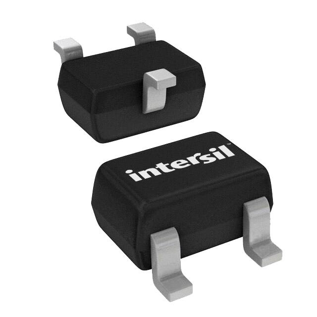

DATASHEET ISL88001, ISL88002, ISL88003 FN6174 Rev 3.00 Feb 10, 2021 Ultra Low Power 3 Ld Voltage Supervisors in SC-70 and SOT-23 Packages The ISL88001, ISL88002, ISL88003 supervisors are extremely low power 160nA voltage supervisors that help to monitor the power supply voltages in a wide variety of applications. By providing Power-On Reset and supply voltage supervision in small 3 Ld SC-70 and SOT-23 packages, the ISL88001, ISL88002, ISL88003 devices can help to lower system cost, reduce board space requirements and increase the reliability of systems. Features The most popular voltage trip points are available for standard power supplies from 1.8V to 5.0V (see “Ordering Information” on page 3). These reset threshold voltages are accurate to within ±1.2% and the reset signal is valid down to 1V. Active high and active low reset outputs are available in push-pull and open drain configurations (see “Functional Block Diagrams” on page 2). • 190ms Power-On Reset Timeout • Single Voltage Monitoring Supervisors • Fixed-Voltage Options Allow Precise Monitoring of +1.8V, +2.5V, +3.0V, +3.3V, and +5.0V Power Supplies • Ultra Low 160nA Supply Current • ±1.2% Voltage Threshold Accuracy • Reset Signal Valid Down to VDD = 1V • No External Components Necessary • Immune to Power-Supply Transients • Available in Small 3 Ld SC-70 and 3 Ld SOT-23 Pb-free Packages The ISL88001, ISL88002, ISL88003 devices are specifically designed for low power consumption and high threshold accuracy, making them especially suitable for electronic devices and portable equipment. • Pin Compatible with MAX803, MAX809, MAX810 Pinouts • Microprocessor/Microcontroller Systems ISL88001, ISL88002 (3 LD SC-70, 3 LD SOT-23) TOP VIEW • Pb-Free (RoHS Compliant) Applications • Intelligent Instruments • Controllers • Computer Systems GND 1 • Portable/Battery-Powered Equipment • PDA and Hand-Held PC Devices ISL88001 ISL88002 RST 3 VDD 2 ISL88001 has a push-pull RST output ISL88002 has an open-drain RST output ISL88003 (3 LD SC-70, 3 LD SOT-23) TOP VIEW GND 1 ISL88003 RST 3 VDD 2 ISL88003 has a push-pull RST output FN6174 Rev 3.00 Feb 10, 2021 Page 1 of 15 ISL88001, ISL88002, ISL88003 Pin Descriptions PIN ISL88001 ISL88002 ISL88003 PIN NAME 1 1 GND Ground IC reference. RST The RST pin is an active-low reset output that is pulled to GND (LOW) when reset is asserted. The ISL88001 is push-pull while the ISL88002 is open drain. 2 RST The RST pin is a push-pull active-high reset output that is pulled to VDD (HIGH) when reset is asserted. 3 VDD Supply Voltage and Monitored Input. The VDD pin is the IC power supply terminal and also the monitored input. 2 3 PIN FUNCTION Functional Block Diagrams VDD VDD POR ± VREF RST RST POR VDD ± VREF VDD GND GND ISL88002 ISL88001 VDD POR ± VREF RST VDD GND ISL88003 FN6174 Rev 3.00 Feb 10, 2021 Page 2 of 15 ISL88001, ISL88002, ISL88003 Ordering Information PART MARKING (Note 6) PACKAGE Tape and Reel PKG. (Pb-free) DWG. # RESET NOMINAL VTHVDD (V) 146 Push-Pull RST 4.62 -40 to +85 3k 3 Ld SC-70 P3.049 ISL88001IE46Z-T7A (Note 3) 146 Push-Pull RST 4.62 -40 to +85 250 3 Ld SC-70 P3.049 ISL88001IE46Z-TK (Note 3) 146 Push-Pull RST 4.62 -40 to +85 1k 3 Ld SC-70 P3.049 ISL88001IE44Z-T (Note 3) 144 Push-Pull RST 4.38 -40 to +85 3k 3 Ld SC-70 P3.049 ISL88001IE44Z-T7A (Note 3) 144 Push-Pull RST 4.38 -40 to +85 250 3 Ld SC-70 P3.049 ISL88001IE44Z-TK (Note 3) 144 Push-Pull RST 4.38 -40 to +85 1k 3 Ld SC-70 P3.049 ISL88001IE31Z-T (Note 3) 131 Push-Pull RST 3.07 -40 to +85 3k 3 Ld SC-70 P3.049 ISL88001IE31Z-T7A (Note 3) 131 Push-Pull RST 3.07 -40 to +85 250 3 Ld SC-70 P3.049 ISL88001IE31Z-TK (Note 3) 131 Push-Pull RST 3.07 -40 to +85 1k 3 Ld SC-70 P3.049 ISL88001IE29Z-T (Note 3) 129 Push-Pull RST 2.92 -40 to +85 3k 3 Ld SC-70 P3.049 ISL88001IE29Z-T7A (Note 3) 129 Push-Pull RST 2.92 -40 to +85 250 3 Ld SC-70 P3.049 ISL88001IE29Z-TK (Note 3) 129 Push-Pull RST 2.92 -40 to +85 1k 3 Ld SC-70 P3.049 ISL88001IE26Z-T (Note 3) 126 Push-Pull RST 2.63 -40 to +85 3k 3 Ld SC-70 P3.049 ISL88001IE26Z-T7A (Note 3) 126 Push-Pull RST 2.63 -40 to +85 250 3 Ld SC-70 P3.049 ISL88001IE26Z-TK (Note 3) 126 Push-Pull RST 2.63 -40 to +85 1k 3 Ld SC-70 P3.049 ISL88001IE23Z-T (Note 3) 123 Push-Pull RST 2.32 -40 to +85 3k 3 Ld SC-70 P3.049 ISL88001IE23Z-T7A (Note 3) 123 Push-Pull RST 2.32 -40 to +85 250 3 Ld SC-70 P3.049 ISL88001IE23Z-TK (Note 3) 123 Push-Pull RST 2.32 -40 to +85 1k 3 Ld SC-70 P3.049 ISL88001IE22Z-T (Note 3) 122 Push-Pull RST 2.19 -40 to +85 3k 3 Ld SC-70 P3.049 ISL88001IE22Z-T7A (Note 3) 122 Push-Pull RST 2.19 -40 to +85 250 3 Ld SC-70 P3.049 ISL88001IE22Z-TK (Note 3) 122 Push-Pull RST 2.19 -40 to +85 1k 3 Ld SC-70 P3.049 ISL88001IE17Z-T (Note 3) 117 Push-Pull RST 1.67 -40 to +85 3k 3 Ld SC-70 P3.049 ISL88001IE17Z-T7A (Note 3) 117 Push-Pull RST 1.67 -40 to +85 250 3 Ld SC-70 P3.049 ISL88001IE17Z-TK (Note 3) 117 Push-Pull RST 1.67 -40 to +85 1k 3 Ld SC-70 P3.049 ISL88001IE16Z-T (Note 3) 116 Push-Pull RST 1.58 -40 to +85 3k 3 Ld SC-70 P3.049 ISL88001IE16Z-T7A (Note 3) 116 Push-Pull RST 1.58 -40 to +85 250 3 Ld SC-70 P3.049 ISL88001IE16Z-TK (Note 3) 116 Push-Pull RST 1.58 -40 to +85 1k 3 Ld SC-70 P3.049 ISL88001IH46Z-T (Note 4) 1H46 Push-Pull RST 4.62 -40 to +85 3k 3 Ld SOT-23 P3.064 ISL88001IH46Z-T7A (Note 4) 1H46 Push-Pull RST 4.62 -40 to +85 250 3 Ld SOT-23 P3.064 ISL88001IH46Z-TK (Note 4) 1H46 Push-Pull RST 4.62 -40 to +85 1k 3 Ld SOT-23 P3.064 ISL88001IH44Z-T (Note 4) 1H44 Push-Pull RST 4.38 -40 to +85 3k 3 Ld SOT-23 P3.064 ISL88001IH44Z-T7A (Note 4) 1H44 Push-Pull RST 4.38 -40 to +85 250 3 Ld SOT-23 P3.064 ISL88001IH44Z-TK (Note 4) 1H44 Push-Pull RST 4.38 -40 to +85 1k 3 Ld SOT-23 P3.064 ISL88001IH31Z-T (Note 4) 1H31 Push-Pull RST 3.07 -40 to +85 3k 3 Ld SOT-23 P3.064 ISL88001IH31Z-T7A (Note 4) 1H31 Push-Pull RST 3.07 -40 to +85 250 3 Ld SOT-23 P3.064 ISL88001IH31Z-TK (Note 4) 1H31 Push-Pull RST 3.07 -40 to +85 1k 3 Ld SOT-23 P3.064 ISL88001IH29Z-T (Note 4) 1H29 Push-Pull RST 2.92 -40 to +85 3k 3 Ld SOT-23 P3.064 ISL88001IH29Z-T7A (Note 4) 1H29 Push-Pull RST 2.92 -40 to +85 250 3 Ld SOT-23 P3.064 PART NUMBER (Notes 1, 5) ISL88001IE46Z-T (Note 3) FN6174 Rev 3.00 Feb 10, 2021 TEMPERATURE TAPE AND REEL RANGE (°C) (Units) (Note 2) Page 3 of 15 ISL88001, ISL88002, ISL88003 Ordering Information (Continued) PART NUMBER (Notes 1, 5) PART MARKING (Note 6) RESET NOMINAL VTHVDD (V) TEMPERATURE TAPE AND REEL RANGE (°C) (Units) (Note 2) PACKAGE Tape and Reel PKG. (Pb-free) DWG. # ISL88001IH29Z-TK (Note 4) 1H29 Push-Pull RST 2.92 -40 to +85 1k 3 Ld SOT-23 P3.064 ISL88001IH26Z-T (Note 4) 1H26 Push-Pull RST 2.63 -40 to +85 3k 3 Ld SOT-23 P3.064 ISL88001IH26Z-T7A (Note 4) 1H26 Push-Pull RST 2.63 -40 to +85 250 3 Ld SOT-23 P3.064 ISL88001IH26Z-TK (Note 4) 1H26 Push-Pull RST 2.63 -40 to +85 1k 3 Ld SOT-23 P3.064 ISL88001IH23Z-T (Note 4) 1H23 Push-Pull RST 2.32 -40 to +85 3k 3 Ld SOT-23 P3.064 ISL88001IH23Z-T7A (Note 4) 1H23 Push-Pull RST 2.32 -40 to +85 250 3 Ld SOT-23 P3.064 ISL88001IH23Z-TK (Note 4) 1H23 Push-Pull RST 2.32 -40 to +85 1k 3 Ld SOT-23 P3.064 ISL88001IH22Z-T (Note 4) 1H22 Push-Pull RST 2.19 -40 to +85 3k 3 Ld SOT-23 P3.064 ISL88001IH22Z-T7A (Note 4) 1H22 Push-Pull RST 2.19 -40 to +85 250 3 Ld SOT-23 P3.064 ISL88001IH22Z-TK (Note 4) 1H22 Push-Pull RST 2.19 -40 to +85 1k 3 Ld SOT-23 P3.064 ISL88001IH17Z-T (Note 4) 1H17 Push-Pull RST 1.67 -40 to +85 3k 3 Ld SOT-23 P3.064 ISL88001IH17Z-T7A (Note 4) 1H17 Push-Pull RST 1.67 -40 to +85 250 3 Ld SOT-23 P3.064 ISL88001IH17Z-TK (Note 4) 1H17 Push-Pull RST 1.67 -40 to +85 1k 3 Ld SOT-23 P3.064 ISL88001IH16Z-T (Note 4) 1H16 Push-Pull RST1 1.58 -40 to +85 3k 3 Ld SOT-23 P3.064 ISL88001IH16Z-T7A (Note 4) 1H16 Push-Pull RST1 1.58 -40 to +85 250 3 Ld SOT-23 P3.064 ISL88001IH16Z-TK (Note 4) 1H16 Push-Pull RST1 1.58 -40 to +85 1k 3 Ld SOT-23 P3.064 ISL88002IE46Z-T (Note 3) 246 Open Drain RST 4.62 -40 to +85 3k 3 Ld SC-70 P3.049 ISL88002IE46Z-T7A (Note 3) 246 Open Drain RST 4.62 -40 to +85 250 3 Ld SC-70 P3.049 ISL88002IE46Z-TK (Note 3) 246 Open Drain RST 4.62 -40 to +85 1k 3 Ld SC-70 P3.049 ISL88002IE44Z-T (Note 3) 244 Open Drain RST 4.38 -40 to +85 3k 3 Ld SC-70 P3.049 ISL88002IE44Z-T7A (Note 3) 244 Open Drain RST 4.38 -40 to +85 250 3 Ld SC-70 P3.049 ISL88002IE44Z-TK (Note 3) 244 Open Drain RST 4.38 -40 to +85 1k 3 Ld SC-70 P3.049 ISL88002IE31Z-T (Note 3) 231 Open Drain RST 3.07 -40 to +85 3k 3 Ld SC-70 P3.049 ISL88002IE31Z-T7A (Note 3) 231 Open Drain RST 3.07 -40 to +85 250 3 Ld SC-70 P3.049 ISL88002IE31Z-TK (Note 3) 231 Open Drain RST 3.07 -40 to +85 1k 3 Ld SC-70 P3.049 ISL88002IE29Z-T (Note 3) 229 Open Drain RST 2.92 -40 to +85 3k 3 Ld SC-70 P3.049 ISL88002IE29Z-T7A (Note 3) 229 Open Drain RST 2.92 -40 to +85 250 3 Ld SC-70 P3.049 ISL88002IE29Z-TK (Note 3) 229 Open Drain RST 2.92 -40 to +85 1k 3 Ld SC-70 P3.049 ISL88002IE26Z-T (Note 3) 226 Open Drain RST 2.63 -40 to +85 3k 3 Ld SC-70 P3.049 ISL88002IE26Z-T7A (Note 3) 226 Open Drain RST 2.63 -40 to +85 250 3 Ld SC-70 P3.049 ISL88002IE26Z-TK (Note 3) 226 Open Drain RST 2.63 -40 to +85 1k 3 Ld SC-70 P3.049 ISL88002IE23Z-T (Note 3) 223 Open Drain RST 2.32 -40 to +85 3k 3 Ld SC-70 P3.049 ISL88002IE23Z-T7A (Note 3) 223 Open Drain RST 2.32 -40 to +85 250 3 Ld SC-70 P3.049 ISL88002IE23Z-TK (Note 3) 223 Open Drain RST 2.32 -40 to +85 1k 3 Ld SC-70 P3.049 ISL88002IE22Z-T (Note 3) 222 Open Drain RST 2.19 -40 to +85 3k 3 Ld SC-70 P3.049 ISL88002IE22Z-T7A (Note 3) 222 Open Drain RST 2.19 -40 to +85 250 3 Ld SC-70 P3.049 ISL88002IE22Z-TK (Note 3) 222 Open Drain RST 2.19 -40 to +85 1k 3 Ld SC-70 P3.049 ISL88002IE17Z-T (Note 3) 217 Open Drain RST 1.67 -40 to +85 3k 3 Ld SC-70 P3.049 FN6174 Rev 3.00 Feb 10, 2021 Page 4 of 15 ISL88001, ISL88002, ISL88003 Ordering Information (Continued) PART MARKING (Note 6) PACKAGE Tape and Reel PKG. (Pb-free) DWG. # RESET NOMINAL VTHVDD (V) ISL88002IE17Z-T7A (Note 3) 217 Open Drain RST 1.67 -40 to +85 250 3 Ld SC-70 P3.049 ISL88002IE17Z-TK (Note 3) 217 Open Drain RST 1.67 -40 to +85 1k 3 Ld SC-70 P3.049 ISL88002IE16Z-T (Note 3) 216 Open Drain RST 1.58 -40 to +85 3k 3 Ld SC-70 P3.049 ISL88002IE16Z-T7A (Note 3) 216 Open Drain RST 1.58 -40 to +85 250 3 Ld SC-70 P3.049 ISL88002IE16Z-TK (Note 3) 216 Open Drain RST 1.58 -40 to +85 1k 3 Ld SC-70 P3.049 ISL88002IH46Z-T (Note 4) 2H46 Open Drain RST 4.62 -40 to +85 3k 3 Ld SOT-23 P3.064 ISL88002IH46Z-T7A (Note 4) 2H46 Open Drain RST 4.62 -40 to +85 250 3 Ld SOT-23 P3.064 ISL88002IH46Z-TK (Note 4) 2H46 Open Drain RST 4.62 -40 to +85 1k 3 Ld SOT-23 P3.064 ISL88002IH44Z-T (Note 4) 2H44 Open Drain RST 4.38 -40 to +85 3k 3 Ld SOT-23 P3.064 ISL88002IH44Z-T7A (Note 4) 2H44 Open Drain RST 4.38 -40 to +85 250 3 Ld SOT-23 P3.064 ISL88002IH44Z-TK (Note 4) 2H44 Open Drain RST 4.38 -40 to +85 1k 3 Ld SOT-23 P3.064 ISL88002IH31Z-T (Note 4) 2H31 Open Drain RST 3.07 -40 to +85 3k 3 Ld SOT-23 P3.064 ISL88002IH31Z-T7A (Note 4) 2H31 Open Drain RST 3.07 -40 to +85 250 3 Ld SOT-23 P3.064 ISL88002IH31Z-TK (Note 4) 2H31 Open Drain RST 3.07 -40 to +85 1k 3 Ld SOT-23 P3.064 ISL88002IH29Z-T (Note 4) 2H29 Open Drain RST 2.92 -40 to +85 3k 3 Ld SOT-23 P3.064 ISL88002IH29Z-T7A (Note 4) 2H29 Open Drain RST 2.92 -40 to +85 250 3 Ld SOT-23 P3.064 ISL88002IH29Z-TK (Note 4) 2H29 Open Drain RST 2.92 -40 to +85 1k 3 Ld SOT-23 P3.064 ISL88002IH26Z-T (Note 4) 2H26 Open Drain RST 2.63 -40 to +85 3k 3 Ld SOT-23 P3.064 ISL88002IH26Z-T7A (Note 4) 2H26 Open Drain RST 2.63 -40 to +85 250 3 Ld SOT-23 P3.064 ISL88002IH26Z-TK (Note 4) 2H26 Open Drain RST 2.63 -40 to +85 1k 3 Ld SOT-23 P3.064 ISL88002IH23Z-T (Note 4) 2H23 Open Drain RST 2.32 -40 to +85 3k 3 Ld SOT-23 P3.064 ISL88002IH23Z-T7A (Note 4) 2H23 Open Drain RST 2.32 -40 to +85 250 3 Ld SOT-23 P3.064 ISL88002IH23Z-TK (Note 4) 2H23 Open Drain RST 2.32 -40 to +85 1k 3 Ld SOT-23 P3.064 ISL88002IH22Z-T (Note 4) 2H22 Open Drain RST 2.19 -40 to +85 3k 3 Ld SOT-23 P3.064 ISL88002IH22Z-T7A (Note 4) 2H22 Open Drain RST 2.19 -40 to +85 250 3 Ld SOT-23 P3.064 ISL88002IH22Z-TK (Note 4) 2H22 Open Drain RST 2.19 -40 to +85 1k 3 Ld SOT-23 P3.064 ISL88002IH17Z-T (Note 4) 2H17 Open Drain RST 1.67 -40 to +85 3k 3 Ld SOT-23 P3.064 ISL88002IH17Z-T7A (Note 4) 2H17 Open Drain RST 1.67 -40 to +85 250 3 Ld SOT-23 P3.064 ISL88002IH17Z-TK (Note 4) 2H17 Open Drain RST 1.67 -40 to +85 1k 3 Ld SOT-23 P3.064 ISL88002IH16Z-T (Note 4) 2H16 Open Drain RST 1.58 -40 to +85 3k 3 Ld SOT-23 P3.064 ISL88002IH16Z-T7A (Note 4) 2H16 Open Drain RST 1.58 -40 to +85 250 3 Ld SOT-23 P3.064 ISL88002IH16Z-TK (Note 4) 2H16 Open Drain RST 1.58 -40 to +85 1k 3 Ld SOT-23 P3.064 ISL88003IE46Z-T (Note 3) 346 Push-Pull RST 4.62 -40 to +85 3k 3 Ld SC-70 P3.049 ISL88003IE46Z-T7A (Note 3) 346 Push-Pull RST 4.62 -40 to +85 250 3 Ld SC-70 P3.049 ISL88003IE46Z-TK (Note 3) 346 Push-Pull RST 4.62 -40 to +85 1k 3 Ld SC-70 P3.049 ISL88003IE44Z-T (Note 3) 344 Push-Pull RST 4.38 -40 to +85 3k 3 Ld SC-70 P3.049 ISL88003IE44Z-T7A (Note 3) 344 Push-Pull RST 4.38 -40 to +85 250 3 Ld SC-70 P3.049 ISL88003IE44Z-TK (Note 3) Push-Pull RST 4.38 -40 to +85 1k 3 Ld SC-70 P3.049 PART NUMBER (Notes 1, 5) FN6174 Rev 3.00 Feb 10, 2021 344 TEMPERATURE TAPE AND REEL RANGE (°C) (Units) (Note 2) Page 5 of 15 ISL88001, ISL88002, ISL88003 Ordering Information (Continued) PART MARKING (Note 6) PACKAGE Tape and Reel PKG. (Pb-free) DWG. # RESET NOMINAL VTHVDD (V) 331 Push-Pull RST 3.07 -40 to +85 3k 3 Ld SC-70 P3.049 ISL88003IE31Z-T7A (Note 3) 331 Push-Pull RST 3.07 -40 to +85 250 3 Ld SC-70 P3.049 ISL88003IE31Z-TK (Note 3) 331 Push-Pull RST 3.07 -40 to +85 1k 3 Ld SC-70 P3.049 ISL88003IE29Z-T (Note 3) 329 Push-Pull RST 2.92 -40 to +85 3k 3 Ld SC-70 P3.049 ISL88003IE29Z-T7A (Note 3) 329 Push-Pull RST 2.92 -40 to +85 250 3 Ld SC-70 P3.049 ISL88003IE29Z-TK (Note 3) 329 Push-Pull RST 2.92 -40 to +85 1k 3 Ld SC-70 P3.049 ISL88003IE26Z-T (Note 3) 326 Push-Pull RST 2.63 -40 to +85 3k 3 Ld SC-70 P3.049 ISL88003IE26Z-T7A (Note 3) 326 Push-Pull RST 2.63 -40 to +85 250 3 Ld SC-70 P3.049 ISL88003IE26Z-TK (Note 3) 326 Push-Pull RST 2.63 -40 to +85 1k 3 Ld SC-70 P3.049 ISL88003IE23Z-T (Note 3) 323 Push-Pull RST 2.32 -40 to +85 3k 3 Ld SC-70 P3.049 ISL88003IE23Z-T7A (Note 3) 323 Push-Pull RST 2.32 -40 to +85 250 3 Ld SC-70 P3.049 ISL88003IE23Z-TK (Note 3) 323 Push-Pull RST 2.32 -40 to +85 1k 3 Ld SC-70 P3.049 ISL88003IE22Z-T (Note 3) 322 Push-Pull RST 2.19 -40 to +85 3k 3 Ld SC-70 P3.049 ISL88003IE22Z-T7A (Note 3) 322 Push-Pull RST 2.19 -40 to +85 250 3 Ld SC-70 P3.049 ISL88003IE22Z-TK (Note 3) 322 Push-Pull RST 2.19 -40 to +85 1k 3 Ld SC-70 P3.049 ISL88003IE17Z-T (Note 3) 317 Push-Pull RST 1.67 -40 to +85 3k 3 Ld SC-70 P3.049 ISL88003IE17Z-T7A (Note 3) 317 Push-Pull RST 1.67 -40 to +85 250 3 Ld SC-70 P3.049 ISL88003IE17Z-TK (Note 3) 317 Push-Pull RST 1.67 -40 to +85 1k 3 Ld SC-70 P3.049 ISL88003IE16Z-T (Note 3) 316 Push-Pull RST 1.58 -40 to +85 3k 3 Ld SC-70 P3.049 ISL88003IE16Z-T7A (Note 3) 316 Push-Pull RST 1.58 -40 to +85 250 3 Ld SC-70 P3.049 ISL88003IE16Z-TK (Note 3) 316 Push-Pull RST 1.58 -40 to +85 1k 3 Ld SC-70 P3.049 ISL88003IH46Z-T (Note 4) 3H46 Push-Pull RST 4.62 -40 to +85 3k 3 Ld SOT-23 P3.064 ISL88003IH46Z-T7A (Note 4) 3H46 Push-Pull RST 4.62 -40 to +85 250 3 Ld SOT-23 P3.064 ISL88003IH46Z-TK (Note 4) 3H46 Push-Pull RST 4.62 -40 to +85 1k 3 Ld SOT-23 P3.064 ISL88003IH44Z-T (Note 4) 3H44 Push-Pull RST 4.38 -40 to +85 3k 3 Ld SOT-23 P3.064 ISL88003IH44Z-T7A (Note 4) 3H44 Push-Pull RST 4.38 -40 to +85 250 3 Ld SOT-23 P3.064 ISL88003IH44Z-TK (Note 4) 3H44 Push-Pull RST 4.38 -40 to +85 1k 3 Ld SOT-23 P3.064 ISL88003IH31Z-T (Note 4) 3H31 Push-Pull RST 3.07 -40 to +85 3k 3 Ld SOT-23 P3.064 ISL88003IH31Z-T7A (Note 4) 3H31 Push-Pull RST 3.07 -40 to +85 250 3 Ld SOT-23 P3.064 ISL88003IH31Z-TK (Note 4) 3H31 Push-Pull RST 3.07 -40 to +85 1k 3 Ld SOT-23 P3.064 ISL88003IH29Z-T (Note 4) 3H29 Push-Pull RST 2.92 -40 to +85 3k 3 Ld SOT-23 P3.064 ISL88003IH29Z-T7A (Note 4) 3H29 Push-Pull RST 2.92 -40 to +85 250 3 Ld SOT-23 P3.064 ISL88003IH29Z-TK (Note 4) 3H29 Push-Pull RST 2.92 -40 to +85 1k 3 Ld SOT-23 P3.064 ISL88003IH26Z-T (Note 4) 3H26 Push-Pull RST 2.63 -40 to +85 3k 3 Ld SOT-23 P3.064 ISL88003IH26Z-T7A (Note 4) 3H26 Push-Pull RST 2.63 -40 to +85 250 3 Ld SOT-23 P3.064 ISL88003IH26Z-TK (Note 4) 3H26 Push-Pull RST 2.63 -40 to +85 1k 3 Ld SOT-23 P3.064 ISL88003IH23Z-T (Note 4) 3H23 Push-Pull RST 2.32 -40 to +85 3k 3 Ld SOT-23 P3.064 ISL88003IH23Z-T7A (Note 4) 3H23 Push-Pull RST 2.32 -40 to +85 250 3 Ld SOT-23 P3.064 PART NUMBER (Notes 1, 5) ISL88003IE31Z-T (Note 3) FN6174 Rev 3.00 Feb 10, 2021 TEMPERATURE TAPE AND REEL RANGE (°C) (Units) (Note 2) Page 6 of 15 ISL88001, ISL88002, ISL88003 Ordering Information (Continued) PART NUMBER (Notes 1, 5) PART MARKING (Note 6) RESET NOMINAL VTHVDD (V) TEMPERATURE TAPE AND REEL RANGE (°C) (Units) (Note 2) PACKAGE Tape and Reel PKG. (Pb-free) DWG. # ISL88003IH23Z-TK (Note 4) 3H23 Push-Pull RST 2.32 -40 to +85 1k 3 Ld SOT-23 P3.064 ISL88003IH22Z-T (Note 4) 3H22 Push-Pull RST 2.19 -40 to +85 3k 3 Ld SOT-23 P3.064 ISL88003IH22Z-T7A (Note 4) 3H22 Push-Pull RST 2.19 -40 to +85 250 3 Ld SOT-23 P3.064 ISL88003IH22Z-TK (Note 4) 3H22 Push-Pull RST 2.19 -40 to +85 1k 3 Ld SOT-23 P3.064 ISL88003IH17Z-T (Note 4) 3H17 Push-Pull RST 1.67 -40 to +85 3k 3 Ld SOT-23 P3.064 ISL88003IH17Z-T7A (Note 4) 3H17 Push-Pull RST 1.67 -40 to +85 250 3 Ld SOT-23 P3.064 ISL88003IH17Z-TK (Note 4) 3H17 Push-Pull RST 1.67 -40 to +85 1k 3 Ld SOT-23 P3.064 ISL88003IH16Z-T (Note 4) 3H16 Push-Pull RST 1.58 -40 to +85 3k 3 Ld SOT-23 P3.064 ISL88003IH16Z-T7A (Note 4) 3H16 Push-Pull RST 1.58 -40 to +85 250 3 Ld SOT-23 P3.064 ISL88003IH16Z-TK (Note 4) 3H16 Push-Pull RST 1.58 -40 to +85 1k 3 Ld SOT-23 P3.064 ISL88001/2/3EVAL1Z Evaluation Platform for ISL88001, ISL88002, and ISL88003 NOTES: 1. For non-standard voltage trip point versions between 1.5V and 5V in 100mV increments, please contact factory for availability. 2. See TB347 for details about reel specifications. 3. These Pb-free plastic packaged products employ special Pb-free material sets; molding compounds/die attach materials and NiPdAu plate-e4 termination finish, which is RoHS compliant and compatible with both SnPb and Pb free soldering operations. Pb-free products are MSL classified at Pb-free peak reflow temperatures that meet or exceed the Pb-free requirements of IPC/JEDEC J-STD-020 4. These Pb-free plastic packaged products employ special Pb-free material sets, molding compounds/die attach materials, and 100% matte tin plate plus anneal (e3 termination finish, which is RoHS compliant and compatible with both SnPb and Pb-free soldering operations). Pb-free products are MSL classified at Pb-free peak reflow temperatures that meet or exceed the Pb-free requirements of IPC/JEDEC J-STD-020. 5. For Moisture Sensitivity Level (MSL), please see device information page for ISL88001, ISL88002, ISL88003. For more information about MSL, see TB363. 6. The part marking is located on the bottom of the part. FN6174 Rev 3.00 Feb 10, 2021 Page 7 of 15 ISL88001, ISL88002, ISL88003 Absolute Maximum Ratings Thermal Information Voltage on Any Pin with respect to GND . . . . . . . . . . -0.3V to +6.5V DC Output Current . . . . . . . . . . . . . . . . . . . . . . . . . . . . . . . . . . 10mA Thermal Resistance (Typical, Note 7) Recommended Operating Conditions Temperature Range (Industrial) . . . . . . . . . . . . . . . . .-40°C to +85°C JA (°C/W) 3 Lead SC-70 . . . . . . . . . . . . . . . . . . . . . . . . . . . . . . 640 3 Lead SOT-23. . . . . . . . . . . . . . . . . . . . . . . . . . . . . 590 Temperature Under Bias . . . . . . . . . . . . . . . . . . . . .-40°C to +125°C Storage Temperature . . . . . . . . . . . . . . . . . . . . . . . .-65°C to +150°C Pb-Free Reflow Profile. . . . . . . . . . . . . . . . . . . . . . . . . . . see TB493 CAUTION: Do not operate at or near the maximum ratings listed for extended periods of time. Exposure to such conditions can adversely impact product reliability and result in failures not covered by warranty. NOTE: 7. JA is measured with the component mounted on a high effective thermal conductivity test board in free air. See TB379 for details. Electrical Specifications SYMBOL Over the recommended operating conditions unless otherwise specified. Boldface limits apply over the operating temperature range, -40°C to +85°C. PARAMETER TEST CONDITIONS MIN (Note 8) VTHVDD = 4.64V, 4.38V, 3.09V, 2.92V, 2.63V 1.8 5.5 V VTHVDD = 2.32V, 2.19V, 1.67V, 1.58V 1.8 2.75 V 215 400 nA VDD = 3.3V, VTHVDD = 3.09V, 2.92V, 2.63V 200 350 nA VDD = 2.5V, VTHVDD = 2.32V, 2.19V 175 325 nA VDD = 1.8V, VTHVDD = 1.67V, 1.58V 160 300 nA 4.625 4.681 V 4.750 V 4.433 V 4.498 V 3.112 V 3.150 V 2.960 V 3.000 V 2.662 V 2.701 V 2.348 V 2.383 V 2.216 V 2.249 V 1.690 V 1.715 V 1.599 V 1.623 V TYP MAX (Note 8) UNITS BIAS VDD IDD Supply Voltage Range Supply Current (RESET, RESET open) VDD = 5.0V, VTHVDD = 4.64V, 4.38V VOLTAGE THRESHOLD VTHVDD Falling Fixed VDD Voltage Trip Point VTHVDDHYST Hysteresis at VDD Input TVTHVDD VTHVDD Temperature Coefficient FN6174 Rev 3.00 Feb 10, 2021 ISL88001, 88002, 88003Ix46, TA = +25°C 4.570 ISL88001, 88002, 88003Ix46 4.500 ISL88001, 88002, 88003Ix44, TA = +25°C 4.327 ISL88001, 88002, 88003Ix44 4.262 ISL88001, 88002, 88003Ix31, TA = +25°C 3.038 ISL88001, 88002, 88003Ix31 3.000 ISL88001, 88002, 88003Ix29, TA = +25°C 2.890 ISL88001, 88002, 88003Ix29 2.850 ISL88001, 88002, 88003Ix26, TA = +25°C 2.598 ISL88001, 88002, 88003Ix26 2.559 ISL88001, 88002, 88003Ix23, TA = +25°C 2.292 ISL88001, 88002, 88003Ix23 2.257 ISL88001, 88002, 88003Ix22, TA = +25°C 2.164 ISL88001, 88002, 88003Ix22 2.131 ISL88001, 88002, 88003Ix17, TA = +25°C 1.650 ISL88001, 88002, 88003Ix17 1.625 ISL88001, 88002, 88003Ix16, TA = +25°C 1.561 ISL88001, 88002, 88003Ix16 1.537 4.380 3.075 2.925 2.630 2.320 2.190 1.670 1.580 1 % 0.48 mV/°C Page 8 of 15 ISL88001, ISL88002, ISL88003 Electrical Specifications SYMBOL Over the recommended operating conditions unless otherwise specified. (Continued)Boldface limits apply over the operating temperature range, -40°C to +85°C. PARAMETER MIN (Note 8) TEST CONDITIONS MAX (Note 8) UNITS TYP RESET / RESET VOL VOH Reset Output Voltage Low Reset Output Voltage High VDD < VTHVDD, for ISL88001 0.2 0.40 V VDD < VTHVDD, Sinking 0.5mA for ISL88002 0.2 0.40 V VDD VTHVDD, for ISL88003 0.2 0.40 V VDD > VTHVDD, for ISL88001 VDD - 0.4 VDD - 0.2 V VDD - 0.2 V VDD - 0.4 VDD - 0.2 V VDD > VTHVDD, Sourcing 0.5mA, ISL88002 VDD < VTHVDD, for ISL88003 tRPD VTH to Reset Asserted Delay tPOR POR Timeout Delay CLOAD Load Capacitance on Reset Pin 15 140 µs 200 260 5 ms pF NOTE: 8. Parameters with MIN and/or MAX limits are 100% tested at +25°C, unless otherwise specified. Temperature limits established by characterization and are not production tested. Pin Descriptions RST The ISL88003 push-pull RST output is set to VDD (HIGH) whenever the device is first powered up or VDD falls below its respective minimum voltage sense level. RST The RST output functions identically to the complementary RST output. On the ISL88001, this is a push-pull output. On the ISL88002, it is an open drain output that is pulled to GND (LOW) when reset is asserted. Suggested pull-up RST resistor values are in the range of 5kΩ to 100kΩ. VDD The VDD pin is the power supply terminal. The voltage at this pin is compared against an internal factory-programmed voltage trip point, VTHVDD. A reset is first asserted when the device is initially powered up to ensure that the power supply has stabilized. Thereafter, reset is again asserted whenever VDD falls below VTHVDD. The device is designed with hysteresis to help prevent chattering due to noise. reset signal (RST = LOW or RST = HIGH) to a µP/µC if this voltage is less than the preset voltage trip point. The reset signal prevents system operation during a power failure or brownout condition. This reset signal remains asserted until VDD exceeds the voltage threshold setting for the reset time delay period tPOR. See Figure 2. VDD VDD VDD RPU* ISL88001 ISL88002* ISL88003 RESET OUTPUT RESET INPUT µP/µC GND GND *Necessary for ISL88002 FIGURE 1. TYPICAL APPLICATION DIAGRAM Principles of Operation The ISL88001, ISL88002, ISL88003 devices provide a low power, high accuracy solution for those voltage monitoring applications needing supply voltage supervision with power reset control. By integrating these features into small 3 Ld SC70 and 3 Ld SOT-23 packages and consuming as little as 160nA of supply current, these devices can lower system cost and reduce board space requirements. Low Voltage Monitoring During normal operation, the ISL88001, ISL88002, ISL88003 devices monitor the voltage level of VDD. The device asserts a FN6174 Rev 3.00 Feb 10, 2021 Page 9 of 15 ISL88001, ISL88002, ISL88003 VTH/VPOR VDD 1V tPOR tRPD tPOR RST FIGURE 2. VOLTAGE MONITORING TIMING DIAGRAM Power-On Reset (POR) Applying power to the ISL88001, ISL88002, ISL88003 activates a POR circuit, which asserts reset once VDD = 1 V. (i.e. RST goes LOW). This provides several benefits: • It prevents the system microprocessor from starting to operate with insufficient voltage. • It prevents the processor from operating prior to stabilization of the oscillator. • It ensures that the monitored device is held out of operation until internal registers are properly loaded. The reset signal remains asserted until VDD rises above the minimum voltage sense level for time period tPOR. This ensures that the VDD voltage has stabilized. Optional VDD de-coupling capacitance can be added to filter transients if needed. See Figures 13 and 14 illustrating the available evaluation platform, ISL88001/2/3EVAL1Z. This evaluation board is shipped with the many released variants loosely packed and the 4.6V threshold variants mounted for immediate evaluation. • It allows time for an FPGA to download its configuration prior to initialization of the circuit. Parametric Performance VDD VDD VDD RST RST FIGURE 3. ISL88001 RST tPOR ~144ms FN6174 Rev 3.00 Feb 10, 2021 RST FIGURE 4. ISL88002 RST tPOR ~155ms, RPU = 5k Page 10 of 15 ISL88001, ISL88002, ISL88003 Parametric Performance (Continued) VDD RST FIGURE 6. ISL88003 tPRD ~26µs 4.75 2.96 4.70 2.94 2.9V VTHVDD (V) 4.6V VTHVDD (V) FIGURE 5. ISL88003 RST tPOR ~145ms 4.65 4.60 2.90 2.88 4.55 4.50 2.92 -40 -20 0 25 50 85 2.86 125 -40 -20 2.23 1.58 2.21 1.58 1.58V VTHVDD (V) 2.2V VTHDD (V) 25 50 85 125 FIGURE 8. ISL8800x 2.9V VTHVDD vs TEMPERATURE FIGURE 7. ISL8800x 4.6V VTHVDD vs TEMPERATURE 2.19 2.17 2.15 2.13 0 TEMPERATURE (°C) TEMPERATURE (°C) 1.57 1.57 1.56 1.56 -40 -20 0 25 50 85 125 TEMPERATURE (°C) FIGURE 9. ISL8800x 2.2V VTHVDD vs TEMPERATURE FN6174 Rev 3.00 Feb 10, 2021 1.55 -40 -20 0 25 50 85 125 TEMPERATURE (°C) FIGURE 10. ISL8800x 1.58V VTHVDD vs TEMPERATURE Page 11 of 15 ISL88001, ISL88002, ISL88003 Parametric Performance (Continued) 3.0 1.015 2.5 NORMALIZED IDD NORMALIZED tPOR 1.010 1.005 1.000 0.995 1.5 1.0 0.990 0.985 2.0 -40 -20 0 25 50 TEMPERATURE (°C) 85 125 0.5 -40 -20 0 25 50 85 125 TEMPERATURE (°C) FIGURE 11. ISL8800x NORMALIZED +25°C tPOR vs TEMPERATURE FIGURE 12. ISL8800x NORMALIZED +25°C IDD vs TEMPERATURE ISL88001/2/3EVAL1Z Evaluation Platform VDD 1k ISL88001 ISL88002 ISL88003 GND RST1 RST2 FIGURE 13. ISL88001/2/3EVAL1Z SCHEMATIC RST3 FIGURE 14. ISL88001/2/3EVAL1Z PHOTOGRAPH Revision History Rev. Date 3.0 Feb 10, 2021 FN6174 Rev 3.00 Feb 10, 2021 Description Added Note 3 to show the change in termination finish from Matte Sn to NiPdAu. Updated Note 2 and added the tape and reel options and information to the ordering information table. Updated links throughout. Added Revision History Page 12 of 15 ISL88001, ISL88002, ISL88003 Package Outline Drawings P3.064 3 Lead Small Outline Transistor Plastic Package (SOT23-3) Rev 3, 3/12 2.92±0.12 4 DETAIL "A" C L 0.085 - 0.19 2.37±0.27 1.30±0.10 4 C L 0.950 0.435±0.065 0 - 8 deg. 0.20 M C TOP VIEW 10° TYP (2 plcs) 0.25 0.95±0.07 GAUGE PLANE 1.00±0.12 SEATING PLANE C SEATING PLANE 0.10 C 0.38±0.10 5 0.013(MIN) 0.100(MAX) SIDE VIEW DETAIL "A" (0.60) NOTES: (2.15) 1. Dimensions are in millimeters. Dimensions in ( ) for Reference Only. 2. Dimensioning and tolerancing conform to AMSEY14.5m-1994. 3. Reference JEDEC TO-236. 4. Dimension does not include interlead flash or protrusions. Interlead flash or protrusions shall not exceed 0.25mm per side. 5. Footlength is measured at reference to gauge plane. (1.25) (0.4 RAD TYP.) (0.95 typ.) TYPICAL RECOMMENDED LAND PATTERN FN6174 Rev 3.00 Feb 10, 2021 Page 13 of 15 ISL88001, ISL88002, ISL88003 0.20 (0.008) M P3.049 3 Lead Small Outline Transistor Plastic Package (SC70-3) VIEW C C CL b 6 INCHES 5 4 CL CL E1 E 1 2 3 e e1 D C CL A A2 SYMBOL MIN MAX A 0.031 0.043 0.80 1.10 - A1 0.000 0.004 0.00 0.10 - A2 0.031 0.039 0.80 1.00 - MAX - b 0.009 0.016 0.25 0.40 0.009 0.014 0.25 0.35 c 0.004 0.007 0.10 0.18 6 0.004 0.007 0.10 0.16 6 D 0.071 0.087 1.80 2.20 3 E 0.071 0.094 1.80 2.40 - E1 0.045 0.053 1.15 1.35 3 L 0.0256 Ref 0.65 Ref 0.0512 Ref 0.010 0.018 - 1.30 Ref 0.26 - 0.46 L1 0.017 Ref. 0.420 Ref. 0.10 (0.004) C L2 0.006 BSC 0.15 BSC WITH b N PLATING b1  c c1 NOTES c1 e1 -C- MIN b1 e SEATING PLANE A1 MILLIMETERS 0° 8° 0° 3 4 - 8° - 3 5 R 0.004 - 0.10 - R1 0.004 0.010 0.15 0.25 Rev. 0 11/06 NOTES: BASE METAL 1. Dimensioning and tolerances per ASME Y14.5M-1994. 2. Package conforms to EIAJ SC70 and JEDEC MO-203AA. 4X 1 3. Dimensions D and E1 are exclusive of mold flash, protrusions, or gate burrs. 4. Footlength L measured at reference to gauge plane. R1 5. “N” is the number of terminal positions. R GAUGE PLANE SEATING PLANE 7. Controlling dimension: MILLIMETER. Converted inch dimensions are for reference only. L C L1  6. These Dimensions apply to the flat section of the lead between 0.08mm and 0.15mm from the lead tip. L2 4X 1 VIEW C FN6174 Rev 3.00 Feb 10, 2021 Page 14 of 15 ISL88001, ISL88002, ISL88003 0.20 (0.008) M P3.049 VIEW C C 3 Lead Small Outline Transistor Plastic Package (SC70-3) CL b INCHES SYMBOL 6 5 4 CL CL E1 E 1 2 3 e e1 D C CL A A2 SEATING PLANE A1 -C- WITH b PLATING b1 MAX NOTES 0.031 0.043 0.80 1.10 - 0.000 0.004 0.00 0.10 - A2 0.031 0.039 0.80 1.00 - b 0.009 0.016 0.25 0.40 - b1 0.009 0.014 0.25 0.35 c 0.004 0.007 0.10 0.18 6 c1 0.004 0.007 0.10 0.16 6 D 0.071 0.087 1.80 2.20 3 E 0.071 0.094 1.80 2.40 - E1 0.045 0.053 1.15 1.35 3 e 0.0256 Ref 0.65 Ref - e1 0.0512 Ref 1.30 Ref - L L2 0.010 0.018 0.017 Ref. 0.26 0.46 4 0.420 Ref. 0.006 BSC 0° N c1 MIN A  c MILLIMETERS MAX A1 L1 0.10 (0.004) C MIN 8° - 0.15 BSC 0° 3 8° - 3 5 R 0.004 - 0.10 - R1 0.004 0.010 0.15 0.25 Rev. 0 11/06 NOTES: BASE METAL 1. Dimensioning and tolerances per ASME Y14.5M-1994. 2. Package conforms to EIAJ SC70 and JEDEC MO-203AA. 4X 1 3. Dimensions D and E1 are exclusive of mold flash, protrusions, or gate burrs. R1 4. Footlength L measured at reference to gauge plane. 5. “N” is the number of terminal positions. R GAUGE PLANE SEATING PLANE L C L1  L2 6. These Dimensions apply to the flat section of the lead between 0.08mm and 0.15mm from the lead tip. 7. Controlling dimension: MILLIMETER. Converted inch dimensions are for reference only. 4X 1 VIEW C FN6174 Rev 3.00 Feb 10, 2021 Page 15 of 15 IMPORTANT NOTICE AND DISCLAIMER RENESAS ELECTRONICS CORPORATION AND ITS SUBSIDIARIES (“RENESAS”) PROVIDES TECHNICAL SPECIFICATIONS AND RELIABILITY DATA (INCLUDING DATASHEETS), DESIGN RESOURCES (INCLUDING REFERENCE DESIGNS), APPLICATION OR OTHER DESIGN ADVICE, WEB TOOLS, SAFETY INFORMATION, AND OTHER RESOURCES “AS IS” AND WITH ALL FAULTS, AND DISCLAIMS ALL WARRANTIES, EXPRESS OR IMPLIED, INCLUDING, WITHOUT LIMITATION, ANY IMPLIED WARRANTIES OF MERCHANTABILITY, FITNESS FOR A PARTICULAR PURPOSE, OR NON-INFRINGEMENT OF THIRD PARTY INTELLECTUAL PROPERTY RIGHTS. These resources are intended for developers skilled in the art designing with Renesas products. You are solely responsible for (1) selecting the appropriate products for your application, (2) designing, validating, and testing your application, and (3) ensuring your application meets applicable standards, and any other safety, security, or other requirements. These resources are subject to change without notice. Renesas grants you permission to use these resources only for development of an application that uses Renesas products. Other reproduction or use of these resources is strictly prohibited. No license is granted to any other Renesas intellectual property or to any third party intellectual property. Renesas disclaims responsibility for, and you will fully indemnify Renesas and its representatives against, any claims, damages, costs, losses, or liabilities arising out of your use of these resources. Renesas' products are provided only subject to Renesas' Terms and Conditions of Sale or other applicable terms agreed to in writing. No use of any Renesas resources expands or otherwise alters any applicable warranties or warranty disclaimers for these products. (Rev.1.0 Mar 2020) Corporate Headquarters Contact Information TOYOSU FORESIA, 3-2-24 Toyosu, Koto-ku, Tokyo 135-0061, Japan www.renesas.com For further information on a product, technology, the most up-to-date version of a document, or your nearest sales office, please visit: www.renesas.com/contact/ Trademarks Renesas and the Renesas logo are trademarks of Renesas Electronics Corporation. All trademarks and registered trademarks are the property of their respective owners.
ISL88003IE31Z-T
物料型号: - ISL88001 - ISL88002 - ISL88003
器件简介: 这些电压监视器用于监控各种应用中的电源电压,提供上电复位和电源电压监控功能。它们具有超低功耗(160nA)、高精度电压阈值(±1.2%)和多种固定电压选项,适用于1.8V至5.0V的标准电源。
引脚分配: - ISL88001和ISL88002有3个引脚:GND(接地)、RST(复位输出)、VDD(供电电压和监控输入)。 - ISL88003也有3个引脚,但RST是推挽输出。
参数特性: - 提供了固定电压选项,用于精确监控+1.8V、+2.5V、+3.0V、+3.3V和+5.0V电源。 - 具有190ms的上电复位延时。 - 复位信号在VDD = 1V时有效。 - 不需要外部组件。 - 对电源瞬态免疫。 - 采用小型3引脚SC-70和3引脚SOT-23无铅封装。
功能详解: - 设计用于低功耗和高阈值精度,特别适用于电子设备和便携设备。 - 与MAX803、MAX809、MAX810引脚兼容。 - 无铅(符合RoHS标准)。
应用信息: - 微处理器/微控制器系统 - 智能仪器 - 控制器 - 计算机系统 - 便携式/电池供电设备 - PDA和手持PC设备
封装信息: - 3引脚SC-70和3引脚SOT-23封装,均为无铅封装。
订购信息: 提供了不同型号的电压阈值、封装类型、温度范围、胶带和卷轴规格等详细信息。
注意事项: - 不要在最大额定值附近长时间运行,以免影响产品可靠性。 - 确保在+25°C时对具有最小和/或最大限制的参数进行100%测试,除非另有说明。
