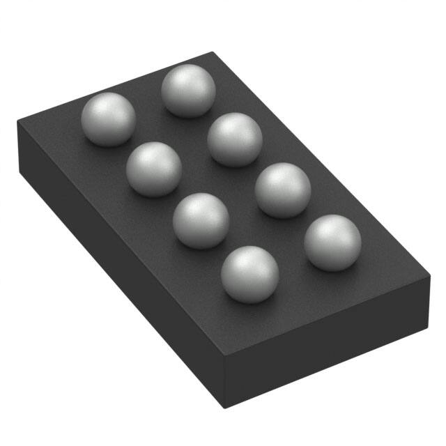

ISL9123IINZ-T
ISL9123IINZ-T
    RENESAS(瑞萨)
    WLCSP8
    降压型 600MA 1.8V~5.5V
ISL9123IINZ-T 数据手册
Datasheet ISL9123 Ultra-Low IQ Buck Regulator with Bypass The ISL9123 is a highly integrated buck switching regulator that is capable of supplying output voltage down to 0.4V. It features an extremely low quiescent current consumption of 950nA in Regulation mode, 140nA in Forced Bypass mode, and 7nA in Shutdown mode. It provides 80% efficiency at 10µA load and has a peak efficiency of 97%. It supports input voltages from 1.8V to 5.5V. Features The ISL9123 has automatic bypass functionality for situations in which the input voltage is close to the output voltage. In addition to the automatic bypass functionality, the Forced Bypass power saving mode can be chosen if voltage regulation is not required. Forced Bypass power saving mode is accessible using the I2C interface bus. • Output current: up to 600mA (VIN = 3.6V, VOUT = 1.8V) The ISL9123 is capable of delivering up to 600mA of output current (VIN = 3.6V, VOUT = 1.8V) and provides excellent efficiency due to its adaptive frequency hysteretic control architecture. The ISL9123 is designed for stand-alone applications and supports a default output voltage at Power-On Reset (POR). After POR, the output voltage can be adjusted in the range of 0.4V to 5.375V by using the I2C interface bus. Specific default output voltages are available upon request. The ISL9123 requires only a single EIA 0603 size inductor and two external capacitors. Power supply solution size is minimized by a 1.8mmx1.0mm WLCSP and is also available in 8 Ld plastic DFN. • 950nA quiescent current • 80% efficiency at 10µA load • 97% peak efficiency • Input voltage range: 1.8V to 5.5V • Output voltage range: 0.4V to 5.375V • Selectable Forced and Auto Bypass power saving modes • PFM and PWM modes with seamless transition • Ultrasonic mode for acoustic noise suppression • I2C control and voltage adjustability • Hysteretic controller • Small 1.8mmx1.0mm WLCSP and 8 Ld DFN packages Applications • Smart watches and wristband devices • Wireless earphones • Internet of Things (IoT) devices • Water, gas, and oil meters • Portable medical devices • Hearing aid devices Related Literature For a full list of related documents, visit our website: • ISL9123 device page 100 95 L1 VIN = 1.8V to 5.5V VIN LX ISL9123 C1 10µF/0603 VOUT = 0.4V to VIN 1µH/0603 VOUT 2 I C Host SDA EN SCL Enable Disable GND C2 10µF/0603 Efficiency (%) VSW 90 85 80 2.5Vin 3.6Vin 5.0Vin 75 70 0.01 0.1 1 10 100 1000 Load Current (mA) Figure 1. Typical Application FN8959 Rev.2.00 Jan.20.21 Figure 2. Efficiency vs Load Current: VOUT = 1.8V, TA = +25°C Page 1 of 23 ISL9123 Contents 1. Overview . . . . . . . . . . . . . . . . . . . . . . . . . . . . . . . . . . . . . . . . . . . . . . . . . . . . . . . . . . . . . . . . . . . . . . . . . . . 3 1.1 1.2 1.3 1.4 2. Block Diagram . . . . . . . . . . . . . . . . . . . . . . . . . . . . . . . . . . . . . . . . . . . . . . . . . . . . . . . . . . . . . . . . . . . . Ordering Information . . . . . . . . . . . . . . . . . . . . . . . . . . . . . . . . . . . . . . . . . . . . . . . . . . . . . . . . . . . . . . . Pin Configuration . . . . . . . . . . . . . . . . . . . . . . . . . . . . . . . . . . . . . . . . . . . . . . . . . . . . . . . . . . . . . . . . . . Pin Descriptions . . . . . . . . . . . . . . . . . . . . . . . . . . . . . . . . . . . . . . . . . . . . . . . . . . . . . . . . . . . . . . . . . . . 3 4 5 5 Specifications. . . . . . . . . . . . . . . . . . . . . . . . . . . . . . . . . . . . . . . . . . . . . . . . . . . . . . . . . . . . . . . . . . . . . . . 6 2.1 2.2 2.3 2.4 2.5 Absolute Maximum Ratings . . . . . . . . . . . . . . . . . . . . . . . . . . . . . . . . . . . . . . . . . . . . . . . . . . . . . . . . . . Thermal Information. . . . . . . . . . . . . . . . . . . . . . . . . . . . . . . . . . . . . . . . . . . . . . . . . . . . . . . . . . . . . . . . Recommended Operating Conditions . . . . . . . . . . . . . . . . . . . . . . . . . . . . . . . . . . . . . . . . . . . . . . . . . . Analog Specifications . . . . . . . . . . . . . . . . . . . . . . . . . . . . . . . . . . . . . . . . . . . . . . . . . . . . . . . . . . . . . . I2C Interface Timing Specifications . . . . . . . . . . . . . . . . . . . . . . . . . . . . . . . . . . . . . . . . . . . . . . . . . . . . 6 6 6 7 9 3. Typical Performance Curves. . . . . . . . . . . . . . . . . . . . . . . . . . . . . . . . . . . . . . . . . . . . . . . . . . . . . . . . . . 10 4. Functional Description . . . . . . . . . . . . . . . . . . . . . . . . . . . . . . . . . . . . . . . . . . . . . . . . . . . . . . . . . . . . . . 14 4.1 4.2 4.3 4.4 4.5 4.6 4.7 4.8 4.9 4.10 4.11 5. Enable Input. . . . . . . . . . . . . . . . . . . . . . . . . . . . . . . . . . . . . . . . . . . . . . . . . . . . . . . . . . . . . . . . . . . . . Soft Discharge . . . . . . . . . . . . . . . . . . . . . . . . . . . . . . . . . . . . . . . . . . . . . . . . . . . . . . . . . . . . . . . . . . . Startup . . . . . . . . . . . . . . . . . . . . . . . . . . . . . . . . . . . . . . . . . . . . . . . . . . . . . . . . . . . . . . . . . . . . . . . . . Overcurrent/Short-Circuit Protection . . . . . . . . . . . . . . . . . . . . . . . . . . . . . . . . . . . . . . . . . . . . . . . . . . Thermal Shutdown. . . . . . . . . . . . . . . . . . . . . . . . . . . . . . . . . . . . . . . . . . . . . . . . . . . . . . . . . . . . . . . . Buck Conversion Topology . . . . . . . . . . . . . . . . . . . . . . . . . . . . . . . . . . . . . . . . . . . . . . . . . . . . . . . . . PWM Operation . . . . . . . . . . . . . . . . . . . . . . . . . . . . . . . . . . . . . . . . . . . . . . . . . . . . . . . . . . . . . . . . . . PFM Operation . . . . . . . . . . . . . . . . . . . . . . . . . . . . . . . . . . . . . . . . . . . . . . . . . . . . . . . . . . . . . . . . . . Operation with VIN Close to VOUT . . . . . . . . . . . . . . . . . . . . . . . . . . . . . . . . . . . . . . . . . . . . . . . . . . . . Forced Operating Modes . . . . . . . . . . . . . . . . . . . . . . . . . . . . . . . . . . . . . . . . . . . . . . . . . . . . . . . . . . . I2C Serial Interface . . . . . . . . . . . . . . . . . . . . . . . . . . . . . . . . . . . . . . . . . . . . . . . . . . . . . . . . . . . . . . . 14 14 14 14 14 14 15 15 15 15 15 Register Descriptions . . . . . . . . . . . . . . . . . . . . . . . . . . . . . . . . . . . . . . . . . . . . . . . . . . . . . . . . . . . . . . . 19 5.1 5.2 5.3 5.4 5.5 RO_REG1 . . . . . . . . . . . . . . . . . . . . . . . . . . . . . . . . . . . . . . . . . . . . . . . . . . . . . . . . . . . . . . . . . . . . . . INTFLG_REG . . . . . . . . . . . . . . . . . . . . . . . . . . . . . . . . . . . . . . . . . . . . . . . . . . . . . . . . . . . . . . . . . . . VSET . . . . . . . . . . . . . . . . . . . . . . . . . . . . . . . . . . . . . . . . . . . . . . . . . . . . . . . . . . . . . . . . . . . . . . . . . . CONV_CFG . . . . . . . . . . . . . . . . . . . . . . . . . . . . . . . . . . . . . . . . . . . . . . . . . . . . . . . . . . . . . . . . . . . . . INTFLG_MASK . . . . . . . . . . . . . . . . . . . . . . . . . . . . . . . . . . . . . . . . . . . . . . . . . . . . . . . . . . . . . . . . . . 19 19 19 20 20 6. Revision History. . . . . . . . . . . . . . . . . . . . . . . . . . . . . . . . . . . . . . . . . . . . . . . . . . . . . . . . . . . . . . . . . . . . 21 7. Package Outline Drawing . . . . . . . . . . . . . . . . . . . . . . . . . . . . . . . . . . . . . . . . . . . . . . . . . . . . . . . . . . . . 22 FN8959 Rev.2.00 Jan.20.21 Page 2 of 23 ISL9123 1. 1.1 1. Overview Overview Block Diagram LX VOUT VIN Auxiliary Switch VSW GND GND Hysteretic PWM Controller Overcurrent Under and Overvoltage SDA SCL EN Digital Core VREF OverTemperature Figure 3. Block Diagram FN8959 Rev.2.00 Jan.20.21 Page 3 of 23 ISL9123 1.2 1. Overview Ordering Information Part Marking Default VOUT (V) I2 C Address Temp Range (°C) Tape and Reel (Units) (Note 1) ISL9123IINZ-T (Note 2) 9123 3.0V 0x1C -40 to +85 3k 8 Bump WLCSP W2x4.8 ISL9123IICZ-T (Note 2) C123 1.8V 0x1C -40 to +85 3k 8 Bump WLCSP W2x4.8 ISL9123II4Z-T (Note 2) 1234 1.0V 0x1C -40 to +85 3k 8 Bump WLCSP W2x4.8 ISL9123II7Z-T (Note 2) 1237 0.7V 0x1C -40 to +85 3k 8 Bump WLCSP W2x4.8 ISL9123IRNZ-T (Note 3) A23 3.0V 0x1C -40 to +85 6k 8 Ld DFN L8.2x3 ISL9123IRNZ-T7A (Note 3) A23 3.0V 0x1C -40 to +85 250 8 Ld DFN L8.2x3 ISL9123IRCZ-T (Note 3) C23 1.8V 0x1C -40 to +85 6k 8 Ld DFN L8.2x3 ISL9123IRCZ-T7A (Note 3) C23 1.8V 0x1C -40 to +85 250 8 Ld DFN L8.2x3 ISL9123IRQZ-T (Note 3) D23 3.3V 0x1C -40 to +85 6k 8 Ld DFN L8.2x3 ISL9123IRQZ-T7A (Note 3) D23 3.3V 0x1C -40 to +85 250 8 Ld DFN L8.2x3 Part Number (Note 4) ISL9123IIC-EVZ Evaluation Board for the ISL9123IICZ ISL9123IRC-EVZ Evaluation Board for the ISL9123IRCZ ISL9123IIN-EVZ Evaluation Board for the ISL9123IINZ ISL9123IRN-EVZ Evaluation Board for the ISL9123IRNZ Package (RoHS Compliant) Pkg. Dwg. # Notes: 1. See TB347 for details about reel specifications. 2. These Pb-free WLCSP packaged products employ special Pb-free material sets; molding compounds/die attach materials and SnAgCu - e1 solder ball terminals, which are RoHS compliant and compatible with both SnPb and Pb-free soldering operations. Pb-free WLCSP packaged products are MSL classified at Pb-free peak reflow temperatures that meet or exceed the Pb-free requirements of IPC/JEDEC J-STD-020. 3. These Pb-free plastic packaged products employ special Pb-free material sets, molding compounds/die attach materials, and 100% matte tin plate plus anneal (e3 termination finish, which is RoHS compliant and compatible with both SnPb and Pb-free soldering operations). Pb-free products are MSL classified at Pb-free peak reflow temperatures that meet or exceed the Pb-free requirements of IPC/JEDEC J-STD-020. 4. For Moisture Sensitivity Level (MSL), see the ISL9123 device page. For more information about MSL, see TB363. FN8959 Rev.2.00 Jan.20.21 Page 4 of 23 ISL9123 1.3 1. Overview Pin Configuration 8 Bump WLCSP Top View 1 A GND 8 Ld DFN Top View 2 VSW LX 1 GND 2 8 VIN 7 SCL EPAD LX B 1.4 VSW 3 6 SDA VOUT 4 5 EN VOUT C VIN EN D SCL SDA Pin Descriptions WLCSP Ball Number DFN Pin Number Pin Names A1 2 GND Ground connection A2 3 VSW Auxiliary output B1 1 LX B2 4 VOUT C1 8 VIN Power supply input C2 5 EN Logic input, drive HIGH to enable device. Do not leave floating D1 7 SCL I2C clock input D2 6 SDA I2C data input N/A EPAD Exposed pad. Must be soldered to PCB GND FN8959 Rev.2.00 Jan.20.21 Description Inductor connection Buck output Page 5 of 23 ISL9123 2. 2.1 2. Specifications Specifications Absolute Maximum Ratings Parameter Minimum Maximum Unit VIN, VOUT -0.3 6.5 V LX -0.3 6.5 V All Other Pins -0.3 6.5 V ESD Rating Value Unit Human Body Model (Tested per JS-001-2017) 2 kV Charged Device Model (Tested per JS-002-2014) 1 kV Latch-Up (Tested per JESD78E; Class 2, Level A) 100 mA CAUTION: Do not operate at or near the maximum ratings listed for extended periods of time. Exposure to such conditions can adversely impact product reliability and result in failures not covered by warranty. 2.2 Thermal Information θJA (°C/W) JC (°C/W) θJB (°C/W) 8 Bump WLCSP Package (Notes 5, 6) 110 - 28 8 Ld 2x3 DFN Package (Notes 5, 7) 55 5.5 - Thermal Resistance (Typical) Notes: 5. θJA is measured in free air with the component mounted on a high-effective thermal conductivity test board with direct attach features. See TB379. 6. For θJB, the board temperature is taken on the board near the edge of the package, on a copper trace at the center of one side. See TB379. 7. For θJC, the case temperature location is the center of the exposed metal pad on the package underside. Parameter Minimum Maximum Junction Temperature Storage Temperature Range -65 Pb-Free Reflow Profile 2.3 Maximum Unit +125 °C +150 °C See TB493 Recommended Operating Conditions Parameter Minimum Maximum Unit Ambient Temperature (TA) Range -40 +85 °C Supply Voltage (VIN) Range 1.8 5.5 V 0 600 mA Load Current (IOUT) Range (DC) FN8959 Rev.2.00 Jan.20.21 Page 6 of 23 ISL9123 2.4 2. Specifications Analog Specifications VIN = VEN = 3.6V, VOUT = 1.8V, I2C pull-up voltage = VIN, L1 = 1µH, C1 = 10µF, C2 = 10µF, TA = +25°C. Boldface limits apply across the operating temperature range (-40°C to +85°C) and input voltage range (1.8V to 5.5V) unless specified otherwise. Parameter Symbol Test Conditions Min (Note 8) Typ Max (Note 8) Unit 5.5 V 1.791 V Power Supply Input Voltage Range VIN Undervoltage Lockout Threshold VIN VUVLO 1.8 VIN rising Hysteresis 100 VIN Quiescent Current IQ VIN = 3.6V, IOUT = 0A (Note 9) VIN Supply Current, Shutdown ISD VIN Supply Current, Soft Shutdown VIN Supply Current, Forced Bypass Mode mV 950 1800 nA VIN = 3.6V, EN = GND 7 450 nA ISSD VIN = 3.6V, shutdown using I2C register. EN_AND = CONV_CFG[7] = 0 30 450 nA IBYP VIN = 3.6V, IOUT = 0A, averaged > 1ms 140 850 nA VOUT VIN > VSET , IOUT = 1mA 0.4 5.375 V VIN = 3.6V, VOUT = 1.8V, IOUT = 0A, forced PWM -2.5 +2.5 % VIN = 3.6V, VOUT = 1.8V, IOUT = 1mA, PFM -3.6 +3.6 % VIN = 3.6V, VOUT = 3.0V, IOUT = 0A, forced PWM -2.0 +2.0 % VIN = 3.6V, VOUT = 3.0V, IOUT = 1mA, PFM -3.6 +3.6 % VIN = 3.6V, VOUT = 1.0V, IOUT = 0A, forced PWM -65 +65 mV VIN = 3.6V, VOUT = 1.0V, IOUT = 1mA, PFM -80 +80 mV VIN = 3.6V, VOUT = 3.3V, IOUT = 0A, forced PWM -2.0 +2.0 % VIN = 3.6V, VOUT = 3.3V, IOUT = 1mA, PFM -3.6 +3.6 % Output Voltage Regulation Output Voltage Range, Buck Mode (Note 10) Output Voltage Accuracy ISL9123IICZ, ISL9123IRCZ VOUT_ACC ISL9123IINZ, ISL9123IRNZ ISL9123II4Z ISL9123IRQZ Soft-Start and Soft Discharge Time to Read OTP VOUT Ramp Rate for Soft-Start and During Dynamic Voltage Scaling (applicable only for VOUT ramp-up, not ramp-down) VOUT Soft Discharge ON-Resistance tOTP DVSRATE Time from when VIN > VUVLO and EN signal asserts until switching starts Default at POR Programmable using I2C after POR 125 µs 3.125 mV/µs 6.25 0.78125 1.5625 mV/µs 125 Ω rDISCHG EN < ENIL P-Channel MOSFET ON-Resistance rDSON_P VIN = 3.6V, VOUT = 3.6V 50 95 140 mΩ N-Channel MOSFET ON-Resistance rDSON_N VIN = 3.6V, VOUT = 3.6V 50 100 140 mΩ 55 70 mΩ Power MOSFET (WLCSP Package) Auxiliary Switched Output MOSFET ON-Resistance rDSON_VAUX VIN = 3.6V, VOUT = 3.6V Power MOSFET (DFN Package) P-Channel MOSFET ON-Resistance rDSON_P VIN = 3.6V, VOUT = 3.6V 150 mΩ N-Channel MOSFET ON-Resistance rDSON_N VIN = 3.6V, VOUT = 3.6V 150 mΩ rDSON_VAUX VIN = 3.6V, VOUT = 3.6V 100 mΩ Auxiliary Switched Output MOSFET ON-Resistance FN8959 Rev.2.00 Jan.20.21 Page 7 of 23 ISL9123 2. Specifications VIN = VEN = 3.6V, VOUT = 1.8V, I2C pull-up voltage = VIN, L1 = 1µH, C1 = 10µF, C2 = 10µF, TA = +25°C. Boldface limits apply across the operating temperature range (-40°C to +85°C) and input voltage range (1.8V to 5.5V) unless specified otherwise. (Continued) Parameter Symbol Test Conditions Min (Note 8) Typ Max (Note 8) Unit Bypass Mode Auto Bypass Thresholds VIN_BYP Auto bypass exit threshold - VIN offset above regulated output voltage VOUT. IOUT = 10mA 30 mV Auto bypass entry threshold - VIN offset above regulated output voltage VOUT. IOUT = 10mA 20 mV 2.5V < VIN < 5.5V 1.4 A 1.8V < VIN < 2.5V 1.2 A 2.5V < VIN < 5.5V 600 mA IOUT_DERATE 1.8V < VIN < 2.5V 300 mA IOUT = 50mA, VIN = 3.7V, VOUT = 3.3V 96 % IOUT = 10µA, VIN = 3.7V, VOUT = 3.3V 86 % IOUT = 50mA, VIN = 3.6V, VOUT = 1.8V 91 % IOUT = 10µA, VIN = 3.6V, VOUT = 1.8V 78 % CCM (with frequency control) 2.5 MHz DCM, Ultrasonic 30 kHz Time from shutdown to restart 100 ms Rising temperature 140 °C 25 °C Inductor Peak Current Limit Peak Current Limit ILIM Output Current Maximum Load Current Maximum Load Current at Low VIN IOUT_MAX Efficiency Efficiency Switching Frequency Switching Frequency fSW Hiccup Mode Hiccup Time tFLT_WAIT Thermal Protection Thermal Shutdown Threshold TSD Thermal Shutdown Hysteresis TSD_HYS Logic Levels Input Leakage ILEAK EN Input HIGH Voltage ENIH EN Input LOW Voltage ENIL SCL/SDA Input HIGH Voltage SCL/SDAIH SCL/SDA Input LOW Voltage SCL/SDAIL EN pin 9 300 nA SCL pin 8 300 nA SDA pin 8 300 nA VIN = 3.6V 1.6 V 0.36 1.45 V V 0.36 V Notes: 8. Parameters with MIN and/or MAX limits are 100% tested at +25°C, unless otherwise specified. Temperature limits are established by characterization and are not production tested. 9. Quiescent current measurements are taken when the device is not switching. 10. Minimum load of 300nA is needed to maintain VOUT , for VSET less than 1.1V. FN8959 Rev.2.00 Jan.20.21 Page 8 of 23 ISL9123 2.5 2. Specifications I2C Interface Timing Specifications Applicable to SCL and SDA in the Fast mode I2C operation, unless otherwise specified. Parameter Symbol Test Conditions Min Max (Note 11) Typ (Note 11) Unit I2C Frequency Capability fI2C Pulse Width Suppression Time at SDA and SCL Inputs tSP Any pulse narrower than the maximum specification is suppressed 50 ns Data Valid Time tVD;DAT Time from SCL falling edge crossing SCLIL to SDA exiting the SDAIL to SDAIH window 900 ns Data Valid Acknowledge Time tVD;ACK Time from SCL falling edge crossing SCLIL to SDA exiting the SDAIL to SDAIH window, during acknowledgment 900 ns 3.4 MHz Bus Free Time Between a STOP and START Condition tBUF Time from SDA crossing SDAIH at STOP to SDA crossing SDAIH at the following START 1300 ns SCL Low Time tLOW Measured at the SCLIL crossing 1300 ns SCL High Time tHIGH Measured at the SCLIH crossing 600 ns START Condition Setup Time tSU;STA Time from SCL rising edge crossing SCLIH to SDA falling edge crossing SDAIH 600 ns START Condition Hold Time tHD;STA Time from SDA falling edge crossing SDAIL to SCL falling edge crossing SCLIH 600 ns Data Set-Up Time tSU;DAT Time from SDA exiting the SDAIL to SDAIH window to SCL rising edge crossing SCLIL 100 ns Data Hold Time tHD;DAT Time from SCL falling edge crossing SCLIL to SDA entering the SDAIL to SDAIH window 50 ns STOP Condition Set-Up Time tSU;STO Time from SCL rising edge crossing SCLIH to SDA rising edge crossing SDAIL 600 ns SCL/SDA Capacitive Loading Cb Capacitive load for each bus line 400 pF Note: 11. Limits established by design and are not production tested. FN8959 Rev.2.00 Jan.20.21 Page 9 of 23 ISL9123 3. 3. Typical Performance Curves Typical Performance Curves Unless otherwise noted, operating conditions are: VIN = VEN = 3.6V, VOUT = 1.8V, I2C pull-up voltage = VIN, L1 = 1µH, C1 = 10µF, C2 = 10µF, TA = +25°C 90 100 85 95 Efficiency (%) Efficiency (%) 80 75 70 65 60 85 VIN = 2.5V VIN = 3.6V VIN = 5.0V 55 50 0.01 0.1 1 10 100 90 3.6Vin 5.0Vin 80 0.01 1000 0.1 1 10 100 Figure 4. Efficiency vs Load Current: VOUT = 0.8V Figure 5. Efficiency vs Load Current: VOUT = 3.3V 100 90 10mA 100mA 600mA 95 85 90 80 Load = 10mA Load = 100mA Load = 600mA 75 85 70 2.0 2.5 3.0 3.5 4.0 4.5 5.0 2.0 VIN (V) 2.5 3.0 3.5 4.0 4.5 5.0 VIN (V) Figure 6. Efficiency vs Input Voltage: VOUT = 1.8V Figure 7. Efficiency vs Input Voltage: VOUT = 0.8V 2 100 2.5Vin 10mA 98 100mA Load Regulation (%) Efficiency (%) 1000 Load Current (mA) Efficiency (%) Efficiency (%) Load Current (mA) 600mA 96 94 92 90 3.6Vin 1 5.0Vin 0 -1 -2 3.5 4.0 4.5 VIN (V) Figure 8. Efficiency vs Input Voltage: VOUT = 3.3V FN8959 Rev.2.00 Jan.20.21 5.0 10 100 Load Current (mA) Figure 9. Output Voltage Accuracy vs Load Current: VOUT = 1.8V Page 10 of 23 ISL9123 3. Typical Performance Curves Unless otherwise noted, operating conditions are: VIN = VEN = 3.6V, VOUT = 1.8V, I2C pull-up voltage = VIN, L1 = 1µH, C1 = 10µF, C2 = 10µF, TA = +25°C (Continued) 1.1 3.0 Quiescent Current (µA) Switching Frequency (MHz) 3.5 2.5 2.0 1.5 1.0 FLL Enabled 0.5 FLL Disabled 2.5 3.0 3.5 4.0 4.5 5.0 Vout = 1.8V 1.0 0.9 0.8 0.0 2.0 Vout = 0.8V Vout = 3.3V 5.5 1.6 2.6 3.6 VIN (V) Figure 10. Switching Frequency vs Input Voltage: Load = 600mA, VOUT = 1.8V VIN (2V/Div) 4.6 5.6 VIN (V) Figure 11. Quiescent Current vs Input Voltage VIN (2V/Div) LX (2V/Div) LX (2V/Div) VOUT (1.8VOFFSET, 10mV/Div) VOUT (1.8VOFFSET, 10mV/Div) IL (500mA/Div) IL (200mA/Div) 400ns/Div 200ns/Div Figure 12. Steady-State Operation in PFM: VIN = 3.6V, VOUT = 1.8V, No Load Figure 13. Steady-State Operation in PWM: VIN = 3.6V, VOUT = 1.8V, Load = 600mA EN (2V/Div) VIN (1V/Div) LX (2V/Div) LX (2V/Div) VOUT (1V/Div) VOUT (500mV/Div) IIN (20mA/Div) IIN (20mA/Div) 100µs/Div Figure 14. Soft-Start: VIN = 3.6V, VSET = 1.8V, No Load FN8959 Rev.2.00 Jan.20.21 100µs/Div Figure 15. Soft-Start: VIN = 1.8V, VSET = 0.8V, No Load Page 11 of 23 ISL9123 3. Typical Performance Curves Unless otherwise noted, operating conditions are: VIN = VEN = 3.6V, VOUT = 1.8V, I2C pull-up voltage = VIN, L1 = 1µH, C1 = 10µF, C2 = 10µF, TA = +25°C (Continued) VIN (2V/Div) VIN (2V/Div) LX (2V/Div) LX (2V/Div) VOUT (1V/Div) VOUT (1V/Div) IL (500mA/Div) IL (500mA/Div) 40ms/Div 40ms/Div Figure 16. Output Short-Circuit Behavior (Hiccup Mode) VIN (2V/Div) Figure 17. Output Short-Circuit Behavior (Shutdown Mode) VIN (2V/Div) IOUT (500mA/Div) LX (2V/Div) VOUT (1.8VOFFSET, 50mV/Div) VOUT (1.8VOFFSET, 10mV/Div) IL (200mA/Div) IL (500mA/Div) 100µs/Div 40ms/Div Figure 18. Steady-State Operation in Ultrasonic Mode: VIN = 3.6V, VOUT = 1.8V, No Load Figure 19. Load Transient: VIN = 3.6V, VOUT = 1.8V, Load = 0.01A to 0.60A, Slew Rate = 1A/μs, Type II Error Amplifier VIN (2V/Div) VIN (2V/Div) IOUT (500mA/Div) IOUT (500mA/Div) VOUT (1.8VOFFSET, 50mV/Div) VOUT (1.8VOFFSET, 50mV/Div) IL (500mA/Div) IL (500mA/Div) 100µs/Div Figure 20. Load Transient: VIN = 3.6V, VOUT = 1.8V, Load = 0.01A to 0.60A, Slew Rate = 1A/μs, Type I Error Amplifier FN8959 Rev.2.00 Jan.20.21 100µs/Div Figure 21. Load Transient: VIN = 3.6V, VOUT = 1.8V, Load = 0.01A to 0.30A, Slew Rate = 1A/μs, Type II Error Amplifier Page 12 of 23 ISL9123 3. Typical Performance Curves Unless otherwise noted, operating conditions are: VIN = VEN = 3.6V, VOUT = 1.8V, I2C pull-up voltage = VIN, L1 = 1µH, C1 = 10µF, C2 = 10µF, TA = +25°C (Continued) VIN (2V/Div) VIN (2V/Div) IOUT (500mA/Div) IVSW (500mA/Div) VOUT (1.8VOFFSET, 50mV/Div) VOUT (1.8VOFFSET, 50mV/Div) VVSW (50mV/Div) IL (500mA/Div) 100µs/Div 100µs/Div Figure 23. Load Transient: VIN = 3.6V, VOUT = 1.8V, Load at VSW = 0.01A to 0.60A, Slew Rate = 1A/μs, Type II Error Amplifier Figure 22. Load Transient: VIN = 3.6V, VOUT = 1.8V, Load = 0.15A to 0.45A, Slew Rate = 1A/μs, Type II Error Amplifier VIN (2V/Div) VOUT (1.8VOFFSET, 50mV/Div) IOUT (500mA/Div) IL (500mA/Div) 100µs/Div Figure 24. Line Transient: VIN = 3.6V to 5.0V, Slew Rate = 0.5V/μs, VOUT = 1.8V, Load = 600mA, Type II Error Amplifier FN8959 Rev.2.00 Jan.20.21 Page 13 of 23 ISL9123 4. 4. Functional Description Functional Description The ISL9123 implements a complete buck switching regulator, with a PWM controller, internal switches, references, protection circuitry, and control inputs. For more information see the “Block Diagram” on page 3. 4.1 Enable Input The device is enabled by asserting the EN pin HIGH. Driving the EN LOW invokes Power-Down mode, in which most internal device functions are disabled. 4.2 Soft Discharge Whenever the converter is disabled over I2C, an internal discharge resistor between VOUT and GND can be activated to slowly discharge the output capacitor. This internal discharge resistor has a typical resistance of 125Ω. The soft discharge function is accessed using I2C while keeping the EN pin HIGH. Using the CONV_CFG register, set the DISCH bit to 1, and disable the IC by setting the EN_AND bit to 0 (see Table 5 on page 20 for details). When the device is disabled by setting EN pin low, while the input voltage is still present, the internal discharge resistor is present between VOUT and GND. 4.3 Startup The power-on sequence starts when the input voltage rises above the undervoltage lockout threshold and EN is asserted HIGH. First, the IC is initialized and its One-Time Programmable (OTP) memory is read. After the OTP has been read and the controller knows the target output voltage and ramp rate, soft-start begins and the output voltage rises at the programmed ramp rate until it reaches the target output voltage. 4.4 Overcurrent/Short-Circuit Protection The ISL9123 provides overcurrent protection by monitoring the inductor current. When the peak inductor current hits its current limit, the IC enters Hiccup mode, Shutdown mode, or Current Limit mode according to the setting of the OC_FAULT_MODE bits in the INT_FLAG_MASK register. During Hiccup mode, the IC shuts down for 100ms and then tries to restart. 4.5 Thermal Shutdown The ISL9123 thermal shutdown feature protects the device from damage due to overheating. An integrated temperature sensor circuit monitors the internal IC temperature. When the temperature exceeds TSD, the device stops switching and waits for the temperature to fall. When the temperature falls by TSDHYS, the controller first goes through the soft-start phase and then starts regulating at the target output voltage as defined by the I2C register value. 4.6 Buck Conversion Topology The ISL9123 operates in either Bypass or Buck mode. When operating in conditions in which VIN is close to VOUT, the ISL9123 automatically switches from Buck mode to Bypass mode. For other conditions, the device performs Buck regulation. Figure 25 shows a simplified diagram of the internal switches and external inductor. Switch D is used for the auxiliary switched output connection. L1 LX VIN VOUT Switch A Switch D VSW Switch B Figure 25. Buck Topology FN8959 Rev.2.00 Jan.20.21 Page 14 of 23 ISL9123 4.7 4. Functional Description PWM Operation In Buck PWM mode, Switches A and B operate as a synchronous buck converter. Switch D can be controlled by using the AUX_SW bit in the INTFLG_MASK register. 4.8 PFM Operation During PFM operation in Buck mode, Switches A and B operate in Discontinuous mode. The ISL9123 closes Switch A to ramp up the current in the inductor and the output voltage. When the inductor current reaches a certain threshold, the device turns off Switch A, then turns on Switch B. With Switch B closed, output voltage decreases as the inductor current ramps down. In some operating conditions, there are multiple PFM pulses to charge up the output capacitor. These pulses continue until VOUT has achieved the upper threshold of the PFM hysteretic controller. Switching then stops and remains stopped until VOUT decays to the lower threshold of the hysteretic PFM controller. 4.9 Operation with VIN Close to VOUT When the output voltage is close to the input voltage, the ISL9123 rapidly and smoothly switches between Buck mode and Bypass mode as needed to maintain the regulated output voltage. This behavior provides excellent efficiency and very low output voltage ripple. 4.10 Forced Operating Modes Forced operating modes include Ultrasonic mode, Forced PWM mode, and Forced Bypass mode. Forced operating modes are selected using the FMODE bits in the CONV_CFG register (see Table 5 on page 20 for details). The power-up default mode is Normal operation with automatic mode transitions to optimize efficiency. Ultrasonic mode can be selected to keep the DCM switching frequency above the audio range. If VIN approaches VOUT, switching instances reduce and smoothly transition from Switching to Bypass mode. Forced PWM mode can be selected to minimize frequency variation. Forced Bypass mode can be selected to minimize power losses when output voltage regulation is not required. When the device enters Bypass mode, the high-side FET is turned ON, providing a direct path from the input to output through the high-side FET and the inductor. In Bypass mode, all other blocks, except POR and I2C, are turned off to minimize quiescent current consumption. There should be at least 1ms of time delay between entry into or exit out of Bypass mode, when transitioning between Bypass mode and Buck mode. Note: There is no overcurrent protection in Bypass mode. 4.11 I2C Serial Interface The ISL9123 supports a bidirectional bus oriented protocol. The protocol defines any device that sends data onto the bus as a transmitter and the receiving device as the receiver. The device controlling the transfer is the master and the device being controlled is the slave. The master always initiates data transfers and provides the clock for both transmit and receive operations. Therefore, the ISL9123 operates as a slave device in all applications. The IC supports the following data transfer rates and modes as defined in the I2C specification: • Up to 100kbit/s in Standard mode • Up to 400kbit/s in Fast mode • Up to 1Mbit/s in Fast-Mode Plus • Up to 3.4Mbit/s in the High-Speed mode All communication over the I2C interface is conducted by sending the MSB of each byte of data first. FN8959 Rev.2.00 Jan.20.21 Page 15 of 23 ISL9123 4.11.1 4. Functional Description Protocol Conventions Data states on the SDA line can change only during SCL LOW periods. The SDA state changes during SCL HIGH are reserved for indicating START and STOP conditions (see Figure 26). At power-up of the ISL9123, the SDA pin is in input mode. SCL SDA Start Data Stable Data Change Data Stable Stop Figure 26. Valid Data Changes, Start, and Stop Conditions All I2C interface operations must begin with a START condition, which is a HIGH to LOW transition of SDA while SCL is HIGH. The ISL9123 continuously monitors the SDA and SCL lines for the START condition and does not respond to any command until this condition is met (see Figure 26). A START condition is ignored during the power-up sequence and when the EN input is low. All I2C interface operations must be terminated by a STOP condition, which is a LOW to HIGH transition of SDA while SCL is HIGH (see Figure 26). A STOP condition at the end of a write operation initiates the reconfiguration for the voltage feedback loop of the ISL9123 as necessary to provide the programmed output voltage. An acknowledge (ACK) is a software convention used to indicate a successful data transfer. The transmitting device, either master or slave, releases the SDA bus after transmitting eight bits. During the ninth clock cycle, the receiver pulls the SDA line LOW to acknowledge the reception of the eight bits of data (see Figure 27). SCL from Master 1 8 9 SDA Output from Transmitter High Impedance High Impedance SDA Output from Receiver Start ACK Figure 27. Acknowledge Response from Receiver The ISL9123 responds with an ACK after recognition of a START condition followed by a valid 7-bit slave address, and once again after successful receipt of a register address byte. The ISL9123 also responds with an ACK after receiving a data byte of a write operation. The master must respond with an ACK after receiving a data byte of a read operation. As a default option, the 7-bit slave address is set in trim to 0x1C. The 7-bit address is followed by a Read/Write bit whose value is “1” for a Read operation, and “0” for a Write operation (see Table 1). Table 1. 7-Bit Address Format 0 (MSB) FN8959 Rev.2.00 Jan.20.21 0 1 1 1 0 0 R/W (LSB) Page 16 of 23 ISL9123 4.11.2 4. Functional Description Write Operation Write operations are shown in Figure 28. A write operation requires a START condition, followed by a valid 7-bit slave address with the R/W bit set to 0, a valid register address byte, one or more data bytes, and a STOP condition. After each of the bytes, the ISL9123 responds with an ACK. After each data byte is acknowledged, the ISL9123 increments its register address to support block writes. The master sends a STOP to complete the command. STOP conditions that terminate write operations must be sent by the master after sending at least one full data byte and its associated ACK signal. If a STOP condition is issued in the middle of a data byte, or before one full data byte + ACK is sent, the ISL9123 ignores the command, and does not change the output voltage or other settings. 2 I C Write Protocol S 0 A A A P System Host Slave I2C Slave 7-Bit Address R/W Register Address S = Start Sr = Repeated Start A = Acknowledge N = Not Acknowledge P = Stop Data Byte 2 I C Block Write Protocol S 0 A A A System Host Slave 2 I C Slave 7-Bit Address R/W Register Address M A Write Data to Reg M+1 Write Data to Reg M A P S = Start Sr = Repeated Start A = Acknowledge N = Not Acknowledge P = Stop Write Data to Reg M+L-1 Figure 28. I2C Register Write Protocols 4.11.3 Read Operation Read operations are shown in Figure 29 on page 18. They consist of four or more bytes. The host generates a START condition, then transmits the 7-bit slave address with the R/W bit set to 0. The ISL9123 responds with an ACK. The host then transmits the register address byte, and the ISL9123 responds with another ACK. The host then generates a repeat START condition and transmits the 7-bit slave address with the R/W bit set to 1. The ISL9123 responds with an ACK, indicating it is ready to begin providing the requested data. The ISL9123 then transmits the data byte by asserting control of the SDA pin while the host generates clock pulses on the SCL pin. After each data byte is complete, the host generates an ACK condition, and the ISL9123 increments its register address to support block reads. After the last data byte is complete and acknowledged, the host sends a STOP condition. This completes the I2C Read operation. FN8959 Rev.2.00 Jan.20.21 Page 17 of 23 ISL9123 4. Functional Description 2 I C Read Protocol S 0 A A Sr Data Byte 1 A A System Host P Slave I2C Slave 7-Bit Address R/W I2C Slave 7-Bit Address Register Address R/W S = Start Sr = Repeated Start A = Acknowledge N = Not Acknowledge P = Stop 2 I C Block Read Protocol S 0 A A Sr System Host 1 A Slave 2 I C Slave 7-Bit Address Data Byte R/W I2C Slave 7-Bit Address Register Address M A Read Data from Reg M Data Byte Read Data from Reg M+1 A R/W Data Byte A P S = Start Sr = Repeated Start A = Acknowledge N = Not Acknowledge P = Stop Read Data from Reg M+L-1 Figure 29. I2C Register Read Protocols 4.11.4 High-Speed Mode Entering High-Speed mode (HS-mode) requires an additional 8-bit master code (0b00001xxx), NACK, and repeated START be inserted after the initial START condition. See the I2C specification for details. FN8959 Rev.2.00 Jan.20.21 Page 18 of 23 ISL9123 5. 5. Register Descriptions Register Descriptions The ISL9123 has five I2C accessible control registers whose functions are described in Tables 2 through 6. These registers can be accessed any time the ISL9123 is enabled. Attempts to communicate with the ISL9123 through its I2C interface when disabled (EN = Low), are not supported. 5.1 RO_REG1 The RO_REG1 register contains the hardware identification bits as described in Table 2. Table 2. Register Address 0x02: RO_REG1 Bit Name 7:6 FAMILY_ID[1:0] R 0x0 Chip family identifier 0x0 = ISL9122 stand-alone converter family 5:3 HW_REV[2:0] R 0x3 Chip revision level 0x3 = Hardware revision D 2:0 RAIL_VAR[2:0] R 0x4 Converter variant identifier 0x4 = Buck (ISL9123) 5.2 Type Reset Description INTFLG_REG The INTFLG_REG register contains fault flags. Each bit represents a different type of fault as described in Table 3. A 0 indicates no fault, and a 1 indicates a fault. Each bit is set by a fault event and is cleared when read. Table 3. Register Address 0x03: INTFLG_REG Bit Name 3 INT3 R 0x0 Voltage setting under range 2 INT2 R 0x0 Voltage setting over range 1 INT1 R 0x0 Over-temperature 0 INT0 R 0x0 Overcurrent 5.3 Type Reset Description VSET The VSET register contains the output voltage setting in 25mV steps as shown in Equation 1. The VSET can be changed after the IC is enabled and operating. When the output voltage is changed, it ramps at the rate set in the DVSRATE bits of CONV_CFG register. (EQ. 1) V OUT = VSET  0.025V The output voltage range is digitally limited to be between the minimum and maximum values shown in Table 4. Setting values above or below the limits results in the output voltage ramping to the limit and the appropriate overvoltage or undervoltage interrupt flag in INTFLG_REG being set. Table 4. Register Address 0x11: VSET Bit Name 7:0 VSET[7:0] FN8959 Rev.2.00 Jan.20.21 Type Reset R/W Description Output voltage setting Minimum limit = 0.4V Maximum limit = 5.375V Page 19 of 23 ISL9123 5.4 5. Register Descriptions CONV_CFG The CONV_CFG register settings are described in Table 5. Table 5. Register Address 0x12: CONV_CFG Bit Name 7 EN_AND R/W 0x1 Enable bit. ANDed with the enable input 0x0 = EN pin going high wakes up the I2C, but does not start the converter. The converter is started by writing 1 to this bit using I2C while the EN pin is high 0x1 = EN pin going high wakes up the I2C and starts the converter Note: EN pin low always disables the converter and I2C 6 DISCH R/W 0x0 0x0 = No discharge resistor present when converter is disabled over I2C 0x1 = Discharge resistor present when converter is disabled over I2C 5:4 DVSRATE[1:0] R/W 0x0 Dynamic Voltage Scaling slew rate applied when the output voltage setting is changed. 0x0 = 3.125mV/µs 0x1 = 6.25mV/µs 0x2 = 0.78125mV/µs 0x3 = 1.5625mV/µs 3:2 FMODE R/W 0x0 Forced operating modes 0x0 = Normal operation with automatic mode transitions 0x1 = Ultrasonic mode with enforced minimum PFM frequency 0x2 = Forced PWM mode with no PFM operation 0x3 = Forced bypass. Disables switching. If the Forced Bypass mode is selected and the part is disabled over I2C (CONV_CFG[7] = EN_AND = 0x0), the converter remains in Forced Bypass 1 CONV_RSVD R/W 0x0 Reserved 0 TYPE1 R/W 0x1 0x0 = Type I error amplifier for best transient response with voltage positioning 0x1 = Type II error amplifier for best steady state voltage accuracy. DO NOT USE Type II error amplifier if overcurrent fault handling is disabled (INTFLG_MASK[7] = OC_FAULT_MODE = 0x2 or 0x3) 5.5 Type Reset Description INTFLG_MASK The INTFLG_MASK register settings are described in Table 6. Table 6. Register Address 0x13: INTFLG_MASK Bit Name 7:6 OC_FAULT_MODE R/W 0x0 Overcurrent fault handling modes 0x0 = Hiccup mode with 100ms wait 0x1 = Shutdown mode. Requires restart over I2C or EN pin 0x2 = Current limit with no fault action taken. USE ONLY with Type I error amplifier (CONV_CFG[0] = TYPE1 = 0x0) 0x3 = Reserved. USE ONLY with Type I error amplifier (CONV_CFG[0] = TYPE1 = 0x0) 5 AUX_SW R/W 0x0 Auxiliary switched output control 0x0 = VSW pin disconnected 0x1 = VSW pin connected to the VOUT pin by power switch 4 EN_OR R/W 0x0 Enable override bit for I2C control of converter. Implements push-button ON operation; the button pulls EN high and the part starts. If EN_OR is set from OTP or over I2C, the part remains enabled when the button is released. 0x0 = Controlled by the EN pin 0x1 = Held in enable state - EN pin is ignored FN8959 Rev.2.00 Jan.20.21 Type Reset Description Page 20 of 23 ISL9123 6. 6. Revision History Revision History Rev. Date 2.00 Jan.20.21 Added DFN package option information throughout. Added ISL9123II7Z-T to the ordering information table. 1.00 Sep.11.19 Changed the minimum values to typical values for the Maximum Load Current and Maximum Load Current at Low Vin specifications. Removed the bolding on the Output Voltage Accuracy specifications minimum and maximum values. 0.00 Aug.26.19 Initial release FN8959 Rev.2.00 Jan.20.21 Description Page 21 of 23 ISL9123 7. Package Outline Drawing 7. Package Outline Drawing For the most recent package outline drawing, see W2x4.8. W2x4.8 8 Ball Wafer Level Chip Scale Package (WLCSP) 0.4mm Pitch Rev 0, 6/17 FN8959 Rev.2.00 Jan.20.21 Page 22 of 23 ISL9123 7. Package Outline Drawing L8.2x3 8 Lead Dual Flat No-Lead Plastic Package Rev 2, 3/15 2.00 For the most recent package outline drawing, see L8.2x3. A 2X 1.50 PIN 1 INDEX AREA 6 PIN #1 INDEX AREA 6X 0.50 1 1.80 +0.10/-0.15 3.00 B (4X) 0.15 8 8X 0.40 ±0.10 TOP VIEW 1.65 +0.10/-0.15 8X 0.25 +0.07/-0.05 4 0.10 M C A B BOTTOM VIEW SEE DETAIL "X" 0.90 ±0.10 0.10 C (1.65) (1.50) (8X 0.60) C BASE PLANE SEATING PLANE 0.08 C 0.05 MAX SIDE VIEW (2.80)(1.80) 0.20 REF C (6X 0.50) 0.05 MAX (8X 0.25) DETAIL "X" TYPICAL RECOMMENDED LAND PATTERN NOTES: FN8959 Rev.2.00 Jan.20.21 1. Dimensions are in millimeters. Dimensions in ( ) for Reference Only. 2. Dimensioning and tolerancing conform to ASME Y14.5m-1994. 3. Unless otherwise specified, tolerance : Decimal ± 0.05 4. Dimension applies to the metallized terminal and is measured between 0.25mm and 0.30mm from the terminal tip. 5. Tiebar shown (if present) is a non-functional feature and may be located on any of the 4 sides (or ends). 6. The configuration of the pin #1 identifier is optional, but must be located within the zone indicated. The pin #1 identifier may be either a mold or mark feature. 7. Compies to JEDEC MO-229 VCED-2. Page 23 of 23 IMPORTANT NOTICE AND DISCLAIMER RENESAS ELECTRONICS CORPORATION AND ITS SUBSIDIARIES (“RENESAS”) PROVIDES TECHNICAL SPECIFICATIONS AND RELIABILITY DATA (INCLUDING DATASHEETS), DESIGN RESOURCES (INCLUDING REFERENCE DESIGNS), APPLICATION OR OTHER DESIGN ADVICE, WEB TOOLS, SAFETY INFORMATION, AND OTHER RESOURCES “AS IS” AND WITH ALL FAULTS, AND DISCLAIMS ALL WARRANTIES, EXPRESS OR IMPLIED, INCLUDING, WITHOUT LIMITATION, ANY IMPLIED WARRANTIES OF MERCHANTABILITY, FITNESS FOR A PARTICULAR PURPOSE, OR NON-INFRINGEMENT OF THIRD PARTY INTELLECTUAL PROPERTY RIGHTS. These resources are intended for developers skilled in the art designing with Renesas products. You are solely responsible for (1) selecting the appropriate products for your application, (2) designing, validating, and testing your application, and (3) ensuring your application meets applicable standards, and any other safety, security, or other requirements. These resources are subject to change without notice. Renesas grants you permission to use these resources only for development of an application that uses Renesas products. Other reproduction or use of these resources is strictly prohibited. No license is granted to any other Renesas intellectual property or to any third party intellectual property. Renesas disclaims responsibility for, and you will fully indemnify Renesas and its representatives against, any claims, damages, costs, losses, or liabilities arising out of your use of these resources. Renesas' products are provided only subject to Renesas' Terms and Conditions of Sale or other applicable terms agreed to in writing. No use of any Renesas resources expands or otherwise alters any applicable warranties or warranty disclaimers for these products. (Rev.1.0 Mar 2020) Corporate Headquarters Contact Information TOYOSU FORESIA, 3-2-24 Toyosu, Koto-ku, Tokyo 135-0061, Japan www.renesas.com For further information on a product, technology, the most up-to-date version of a document, or your nearest sales office, please visit: www.renesas.com/contact/ Trademarks Renesas and the Renesas logo are trademarks of Renesas Electronics Corporation. All trademarks and registered trademarks are the property of their respective owners. © 2021 Renesas Electronics Corporation. All rights reserved.
