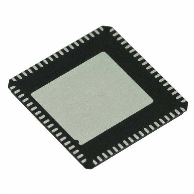

ISLA224P13IRZ
ISLA224P13IRZ
    RENESAS(瑞萨)
    VFQFN72
    IC ADC 14BIT SAR 72QFN
ISLA224P13IRZ 数据手册
DATASHEET ISLA224P FN7570 Rev.2.0 Jul 6, 2021 Dual 14-Bit, 250MSPS/200MSPS/130MSPS ADC The ISLA224P is a family of dual-channel 14-Bit analog-to-digital converters. Designed with Renesas’ proprietary FemtoCharge™ technology on a standard CMOS process, the family supports sampling rates of up to 250MSPS. The ISLA224P is part of a pin-compatible portfolio of 12-bit and 14-bit dual-channel A/Ds with maximum sample rates ranging from 130MSPS to 250MSPS. Features A serial peripheral interface (SPI) port allows for extensive configurability, as well as fine control of various parameters such as gain and offset. • Programmable built-in test patterns Digital output data is presented in selectable LVDS or CMOS formats. The ISLA224P is available in a 72-contact QFN package with an exposed paddle. Operating from a 1.8V supply, performance is specified over the full industrial temperature range (-40°C to +85°C). • Single supply 1.8V operation • Clock duty cycle stabilizer • 75fs clock jitter • 700MHz bandwidth • Multi-ADC support - SPI programmable fine gain and offset control - Support for multiple ADC synchronization - Optimized output timing • Nap and sleep modes - 200µs sleep wake-up time • Data output clock Key Specifications • DDR LVDS-compatible or LVCMOS outputs • SNR @ 250/200/130MSPS 72.7/73.9/74.7dBFS fIN = 30MHz 70.2/70.7/70.2dBFS fIN = 363MHz • SFDR @ 250/200/130MSPS 84/86/86dBc fIN = 30MHz 73/75/79dBc fIN = 363MHz • Total Power Consumption = 837mW @ 250MSPS • Selectable clock divider Applications • Radar array processing • Software defined radios • Broadband communications • High-performance data acquisition • Communications test equipment CLKP OVDD CLKDIVRSTN CLKDIVRSTP AVDD CLKDIV TABLE 1. Pin-Compatible Family CLKOUTP CLOCK MANAGEMENT CLKN 14-BIT 250 MSPS ADC VREF VCM VINAN 14-BIT 250 MSPS ADC VREF + 1.25V – RESETN AVSS NAPSLP SHA VINAP FN7570 Rev.2.0 Jul 6, 2021 D[13:0]P D[13:0]N DIGITAL ERROR CORRECTION ORP ORN RESOLUTION SPEED (MSPS) ISLA224P25 14 250 ISLA224P20 14 200 ISLA224P13 14 130 ISLA222P25 12 250 ISLA222P20 12 200 ISLA222P13 12 130 OUTFMT OUTMODE SPI CONTROL OVSS SHA CSB SCLK SDIO SDO VINBP VINBN CLKOUTN MODEL Page 1 of 34 © 2011 Renesas Electronics ISLA224P Table of Contents Pin Configuration- LVDS Mode . . . . . . . . . . . . . . . . . . . . . . . . . . . . . . . . . . . . . . . . . . . . . . . . . . . . . . . . . . . . . . . . . . . . . . . . . . . . . . . . 3 Pin Descriptions - 72 Ld QFN, LVDS Mode . . . . . . . . . . . . . . . . . . . . . . . . . . . . . . . . . . . . . . . . . . . . . . . . . . . . . . . . . . . . . . . . . . . . . . . 3 Pin Configuration- CMOS Mode . . . . . . . . . . . . . . . . . . . . . . . . . . . . . . . . . . . . . . . . . . . . . . . . . . . . . . . . . . . . . . . . . . . . . . . . . . . . . . . . 5 Pin Descriptions - 72 Ld QFN, CMOS Mode . . . . . . . . . . . . . . . . . . . . . . . . . . . . . . . . . . . . . . . . . . . . . . . . . . . . . . . . . . . . . . . . . . . . . . 5 Ordering Information . . . . . . . . . . . . . . . . . . . . . . . . . . . . . . . . . . . . . . . . . . . . . . . . . . . . . . . . . . . . . . . . . . . . . . . . . . . . . . . . . . . . . . . . 7 Absolute Maximum Ratings . . . . . . . . . . . . . . . . . . . . . . . . . . . . . . . . . . . . . . . . . . . . . . . . . . . . . . . . . . . . . . . . . . . . . . . . . . . . . . . . . . . 8 Thermal Information . . . . . . . . . . . . . . . . . . . . . . . . . . . . . . . . . . . . . . . . . . . . . . . . . . . . . . . . . . . . . . . . . . . . . . . . . . . . . . . . . . . . . . . . . 8 Electrical Specifications . . . . . . . . . . . . . . . . . . . . . . . . . . . . . . . . . . . . . . . . . . . . . . . . . . . . . . . . . . . . . . . . . . . . . . . . . . . . . . . . . . . . . 8 Digital Specifications . . . . . . . . . . . . . . . . . . . . . . . . . . . . . . . . . . . . . . . . . . . . . . . . . . . . . . . . . . . . . . . . . . . . . . . . . . . . . . . . . . . . . . . 10 Timing Diagrams . . . . . . . . . . . . . . . . . . . . . . . . . . . . . . . . . . . . . . . . . . . . . . . . . . . . . . . . . . . . . . . . . . . . . . . . . . . . . . . . . . . . . . . . . . . 11 Switching Specifications . . . . . . . . . . . . . . . . . . . . . . . . . . . . . . . . . . . . . . . . . . . . . . . . . . . . . . . . . . . . . . . . . . . . . . . . . . . . . . . . . . . . 12 Typical Performance Curves . . . . . . . . . . . . . . . . . . . . . . . . . . . . . . . . . . . . . . . . . . . . . . . . . . . . . . . . . . . . . . . . . . . . . . . . . . . . . . . . . 13 Theory of Operation. . . . . . . . . . . . . . . . . . . . . . . . . . . . . . . . . . . . . . . . . . . . . . . . . . . . . . . . . . . . . . . . . . . . . . . . . . . . . . . . . . . . . . . . . 16 Functional Description . . . . . . . . . . . . . . . . . . . . . . . . . . . . . . . . . . . . . . . . . . . . . . . . . . . . . . . . . . . . . . . . . . . . . . . . . . . . . . . . . . . . . . . . . . . 16 Power-On Calibration. . . . . . . . . . . . . . . . . . . . . . . . . . . . . . . . . . . . . . . . . . . . . . . . . . . . . . . . . . . . . . . . . . . . . . . . . . . . . . . . . . . . . . . . . . . . . 16 User Initiated Reset . . . . . . . . . . . . . . . . . . . . . . . . . . . . . . . . . . . . . . . . . . . . . . . . . . . . . . . . . . . . . . . . . . . . . . . . . . . . . . . . . . . . . . . . . . . . . . 17 Temperature Calibration. . . . . . . . . . . . . . . . . . . . . . . . . . . . . . . . . . . . . . . . . . . . . . . . . . . . . . . . . . . . . . . . . . . . . . . . . . . . . . . . . . . . . 18 Analog Input . . . . . . . . . . . . . . . . . . . . . . . . . . . . . . . . . . . . . . . . . . . . . . . . . . . . . . . . . . . . . . . . . . . . . . . . . . . . . . . . . . . . . . . . . . . . . . . . . . . . Clock Input . . . . . . . . . . . . . . . . . . . . . . . . . . . . . . . . . . . . . . . . . . . . . . . . . . . . . . . . . . . . . . . . . . . . . . . . . . . . . . . . . . . . . . . . . . . . . . . . . . . . . Jitter. . . . . . . . . . . . . . . . . . . . . . . . . . . . . . . . . . . . . . . . . . . . . . . . . . . . . . . . . . . . . . . . . . . . . . . . . . . . . . . . . . . . . . . . . . . . . . . . . . . . . . . . . . . Voltage Reference . . . . . . . . . . . . . . . . . . . . . . . . . . . . . . . . . . . . . . . . . . . . . . . . . . . . . . . . . . . . . . . . . . . . . . . . . . . . . . . . . . . . . . . . . . . . . . . Digital Outputs . . . . . . . . . . . . . . . . . . . . . . . . . . . . . . . . . . . . . . . . . . . . . . . . . . . . . . . . . . . . . . . . . . . . . . . . . . . . . . . . . . . . . . . . . . . . . . . . . . Power Dissipation . . . . . . . . . . . . . . . . . . . . . . . . . . . . . . . . . . . . . . . . . . . . . . . . . . . . . . . . . . . . . . . . . . . . . . . . . . . . . . . . . . . . . . . . . . . . . . . Nap/Sleep. . . . . . . . . . . . . . . . . . . . . . . . . . . . . . . . . . . . . . . . . . . . . . . . . . . . . . . . . . . . . . . . . . . . . . . . . . . . . . . . . . . . . . . . . . . . . . . . . . . . . . Data Format . . . . . . . . . . . . . . . . . . . . . . . . . . . . . . . . . . . . . . . . . . . . . . . . . . . . . . . . . . . . . . . . . . . . . . . . . . . . . . . . . . . . . . . . . . . . . . . . . . . . 19 19 20 20 20 20 20 21 Clock Divider Synchronous Reset . . . . . . . . . . . . . . . . . . . . . . . . . . . . . . . . . . . . . . . . . . . . . . . . . . . . . . . . . . . . . . . . . . . . . . . . . . . . . 21 Serial Peripheral Interface . . . . . . . . . . . . . . . . . . . . . . . . . . . . . . . . . . . . . . . . . . . . . . . . . . . . . . . . . . . . . . . . . . . . . . . . . . . . . . . . . . 24 SPI Physical Interface . . . . . . . . . . . . . . . . . . . . . . . . . . . . . . . . . . . . . . . . . . . . . . . . . . . . . . . . . . . . . . . . . . . . . . . . . . . . . . . . . . . . . . . . . . . . SPI Configuration. . . . . . . . . . . . . . . . . . . . . . . . . . . . . . . . . . . . . . . . . . . . . . . . . . . . . . . . . . . . . . . . . . . . . . . . . . . . . . . . . . . . . . . . . . . . . . . . Device Information . . . . . . . . . . . . . . . . . . . . . . . . . . . . . . . . . . . . . . . . . . . . . . . . . . . . . . . . . . . . . . . . . . . . . . . . . . . . . . . . . . . . . . . . . . . . . . Device Configuration/Control. . . . . . . . . . . . . . . . . . . . . . . . . . . . . . . . . . . . . . . . . . . . . . . . . . . . . . . . . . . . . . . . . . . . . . . . . . . . . . . . . . . . . . Global Device Configuration/Control . . . . . . . . . . . . . . . . . . . . . . . . . . . . . . . . . . . . . . . . . . . . . . . . . . . . . . . . . . . . . . . . . . . . . . . . . . . . . . . Digital Temperature Sensor . . . . . . . . . . . . . . . . . . . . . . . . . . . . . . . . . . . . . . . . . . . . . . . . . . . . . . . . . . . . . . . . . . . . . . . . . . . . . . . . . . . . . . . 24 25 25 25 26 28 SPI Memory Map . . . . . . . . . . . . . . . . . . . . . . . . . . . . . . . . . . . . . . . . . . . . . . . . . . . . . . . . . . . . . . . . . . . . . . . . . . . . . . . . . . . . . . . . . . . 29 Equivalent Circuits . . . . . . . . . . . . . . . . . . . . . . . . . . . . . . . . . . . . . . . . . . . . . . . . . . . . . . . . . . . . . . . . . . . . . . . . . . . . . . . . . . . . . . . . . 31 A/D Evaluation Platform. . . . . . . . . . . . . . . . . . . . . . . . . . . . . . . . . . . . . . . . . . . . . . . . . . . . . . . . . . . . . . . . . . . . . . . . . . . . . . . . . . . . . 32 Layout Considerations . . . . . . . . . . . . . . . . . . . . . . . . . . . . . . . . . . . . . . . . . . . . . . . . . . . . . . . . . . . . . . . . . . . . . . . . . . . . . . . . . . . . . . 32 Split Ground and Power Planes . . . . . . . . . . . . . . . . . . . . . . . . . . . . . . . . . . . . . . . . . . . . . . . . . . . . . . . . . . . . . . . . . . . . . . . . . . . . . . . . . . . . Clock Input Considerations. . . . . . . . . . . . . . . . . . . . . . . . . . . . . . . . . . . . . . . . . . . . . . . . . . . . . . . . . . . . . . . . . . . . . . . . . . . . . . . . . . . . . . . . Exposed Paddle . . . . . . . . . . . . . . . . . . . . . . . . . . . . . . . . . . . . . . . . . . . . . . . . . . . . . . . . . . . . . . . . . . . . . . . . . . . . . . . . . . . . . . . . . . . . . . . . . Bypass and Filtering . . . . . . . . . . . . . . . . . . . . . . . . . . . . . . . . . . . . . . . . . . . . . . . . . . . . . . . . . . . . . . . . . . . . . . . . . . . . . . . . . . . . . . . . . . . . . LVDS Outputs . . . . . . . . . . . . . . . . . . . . . . . . . . . . . . . . . . . . . . . . . . . . . . . . . . . . . . . . . . . . . . . . . . . . . . . . . . . . . . . . . . . . . . . . . . . . . . . . . . . LVCMOS Outputs . . . . . . . . . . . . . . . . . . . . . . . . . . . . . . . . . . . . . . . . . . . . . . . . . . . . . . . . . . . . . . . . . . . . . . . . . . . . . . . . . . . . . . . . . . . . . . . . Unused Inputs . . . . . . . . . . . . . . . . . . . . . . . . . . . . . . . . . . . . . . . . . . . . . . . . . . . . . . . . . . . . . . . . . . . . . . . . . . . . . . . . . . . . . . . . . . . . . . . . . . 32 32 32 32 32 32 32 Definitions . . . . . . . . . . . . . . . . . . . . . . . . . . . . . . . . . . . . . . . . . . . . . . . . . . . . . . . . . . . . . . . . . . . . . . . . . . . . . . . . . . . . . . . . . . . . . . . . 32 Revision History. . . . . . . . . . . . . . . . . . . . . . . . . . . . . . . . . . . . . . . . . . . . . . . . . . . . . . . . . . . . . . . . . . . . . . . . . . . . . . . . . . . . . . . . . . . . 33 Package Outline Drawing . . . . . . . . . . . . . . . . . . . . . . . . . . . . . . . . . . . . . . . . . . . . . . . . . . . . . . . . . . . . . . . . . . . . . . . . . . . . . . . . . . . . 34 FN7570 Rev.2.0 Jul 6, 2021 Page 2 of 34 ISLA224P Pin Configuration- LVDS Mode AVDD AVDD AVDD SDIO SCLK CSB SDO OVSS ORP ORN OVDD OVSS D0P D0N D1P D1N D2P D2N (72 LD QFN) TOP VIEW 72 71 70 69 68 67 66 65 64 63 62 61 60 59 58 57 56 55 DNC 1 54 D3P DNC 2 53 D3N NAPSLP 3 52 D4P VCM 4 51 D4N AVSS 5 50 D5P VINBP 6 49 D5N VINBN 7 48 CLKOUTP AVSS 8 47 CLKOUTN AVDD 9 46 RLVDS AVDD 10 45 OVSS AVSS 11 44 D6P VINAN 12 43 D6N VINAP 13 42 D7P AVSS 14 41 D7N CLKDIV 15 40 D8P IPTAT 16 38 D9P Connect Thermal Pad to AVSS 18 27 28 29 30 31 32 33 D13N D13P D12N D12P OVDD D11N 34 35 36 D10P 26 D10N 25 D11P 24 OVDD CLKP 23 OVSS 22 CLKDIVRSTN 21 CLKDIVRSTP 20 CLKN 19 AVDD 37 D9N AVDD RESETN 17 AVDD DNC 39 D8N Thermal Pad Not Drawn to Scale. Consult Mechanical Drawing for Physical Dimensions. Pin Descriptions - 72 Ld QFN, LVDS Mode PIN NUMBER LVDS PIN NAME 1, 2, 17 DNC Do Not Connect 9, 10, 19, 20, 21, 70, 71, 72 AVDD 1.8V Analog Supply 5, 8, 11, 14 AVSS Analog Ground 27, 32, 62 OVDD 1.8V Output Supply 26, 45, 61, 65 OVSS Output Ground 3 NAPSLP 4 VCM 6, 7 VINBP, VINBN Channel B Analog Input Positive, Negative 12, 13 VINAN, VINAP Channel A Analog Input Negative, Positive FN7570 Rev.2.0 Jul 6, 2021 LVDS PIN FUNCTION Tri-Level Power Control (Nap, Sleep modes) Common Mode Output Page 3 of 34 ISLA224P Pin Descriptions - 72 Ld QFN, LVDS Mode PIN NUMBER LVDS PIN NAME 15 CLKDIV 16 IPTAT 18 RESETN 22, 23 CLKP, CLKN (Continued) LVDS PIN FUNCTION Tri-Level Clock Divider Control Temperature Monitor (Output current proportional to absolute temperature) Power On Reset (Active Low) Clock Input True, Complement 24, 25 CLKDIVRSTP, CLKDIVRSTN 28, 29 D13N, D13P LVDS Bit 13 (MSB) Output Complement, True 30, 31 D12N, D12P LVDS Bit 12 Output Complement, True 33, 34 D11N, D11P LVDS Bit 11 Output Complement, True 35, 36 D10N, D10P LVDS Bit 10 Output Complement, True 37, 38 D9N, D9P LVDS Bit 9 Output Complement, True 39, 40 D8N, D8P LVDS Bit 8 Output Complement, True 41, 42 D7N, D7P LVDS Bit 7 Output Complement, True 43, 44 D6N, D6P LVDS Bit 6 Output Complement, True 46 RLVDS 47, 48 CLKOUTN, CLKOUTP LVDS Clock Output Complement, True 49, 50 D5N, D5P LVDS Bit 5 Output Complement, True 51, 52 D4N, D4P LVDS Bit 4 Output Complement, True 53, 54 D3N, D3P LVDS Bit 3 Output Complement, True 55, 56 D2N, D2P LVDS Bit 2 Output Complement, True 57, 58 D1N, D1P LVDS Bit 1 Output Complement, True 59, 60 D0N, D0P LVDS Bit 0 (LSB) Output Complement, True 63, 64 ORN, ORP LVDS Over Range Complement, True 66 SDO SPI Serial Data Output 67 CSB SPI Chip Select (active low) 68 SCLK SPI Clock 69 SDIO SPI Serial Data Input/Output Exposed Paddle AVSS Analog Ground FN7570 Rev.2.0 Jul 6, 2021 Synchronous Clock Divider Reset True, Complement LVDS Bias Resistor (connect to OVSS with 1%10k) Page 4 of 34 ISLA224P Pin Configuration- CMOS Mode AVDD AVDD AVDD SDIO SCLK CSB SDO OVSS OR DNC OVDD OVSS D0 DNC D1 DNC D2 DNC (72 LD QFN) TOP VIEW 72 71 70 69 68 67 66 65 64 63 62 61 60 59 58 57 56 55 DNC 1 54 D3 DNC 2 53 DNC NAPSLP 3 52 D4 VCM 4 51 DNC AVSS 5 50 D5 VINBP 6 49 DNC VINBN 7 48 CLKOUT AVSS 8 47 DNC AVDD 9 46 RLVDS AVDD 10 45 OVSS AVSS 11 44 D6 VINAN 12 43 DNC VINAP 13 42 D7 AVSS 14 41 DNC CLKDIV 15 40 D8 IPTAT 16 38 D9 Connect Thermal Pad to AVSS 18 19 20 21 22 23 24 25 26 27 28 29 30 31 32 33 34 35 36 AVDD CLKP CLKN CLKDIVRSTP CLKDIVRSTN OVSS OVDD DNC D13 DNC D12 OVDD DNC D11 DNC D10 37 DNC AVDD RESETN 17 AVDD DNC 39 DNC Thermal Pad Not Drawn to Scale. Consult Mechanical Drawing for Physical Dimensions. Pin Descriptions - 72 Ld QFN, CMOS Mode PIN NUMBER CMOS PIN NAME 1, 2, 17, 28, 30, 33, 35, 37, 39, 41, 43, 47, 49, 51, 53, 55, 57, 59, 63 DNC Do Not Connect 9, 10, 19, 20, 21, 70, 71, 72 AVDD 1.8V Analog Supply 5, 8, 11, 14 AVSS Analog Ground 27, 32, 62 OVDD 1.8V Output Supply 26, 45, 61, 65 OVSS Output Ground 3 NAPSLP 4 VCM FN7570 Rev.2.0 Jul 6, 2021 CMOS PIN FUNCTION Tri-Level Power Control (Nap, Sleep modes) Common Mode Output Page 5 of 34 ISLA224P Pin Descriptions - 72 Ld QFN, CMOS Mode (Continued) PIN NUMBER CMOS PIN NAME CMOS PIN FUNCTION 6, 7 VINBP, VINBN Channel B Analog Input Positive, Negative 12, 13 VINAN, VINAP Channel A Analog Input Negative, Positive 15 CLKDIV 16 IPTAT Tri-Level Clock Divider Control Temperature Monitor (Output current proportional to absolute temperature) 18 RESETN 22, 23 CLKP, CLKN 24, 25 CLKDIVRSTP, CLKDIVRSTN 29 D13 CMOS Bit 13 (MSB) Output 31 D12 CMOS Bit 12 Output 34 D11 CMOS Bit 11 Output 36 D10 CMOS Bit 10 Output 38 D9 CMOS Bit 9 Output 40 D8 CMOS Bit 8 Output 42 D7 CMOS Bit 7 Output 44 D6 CMOS Bit 6 Output 46 RLVDS LVDS Bias Resistor (connect to OVSS with 1%10k) 48 CLKOUT CMOS Clock Output 50 D5 CMOS Bit 5 Output 52 D4 CMOS Bit 4 Output 54 D3 CMOS Bit 3 Output 56 D2 CMOS Bit 2 Output 58 D1 CMOS Bit 1 Output 60 D0 CMOS Bit 0 (LSB) Output 64 OR CMOS Over Range 66 SDO SPI Serial Data Output 67 CSB SPI Chip Select (active low) 68 SCLK SPI Clock 69 SDIO SPI Serial Data Input/Output Exposed Paddle AVSS Analog Ground FN7570 Rev.2.0 Jul 6, 2021 Power On Reset (Active Low) Clock Input True, Complement Synchronous Clock Divider Reset True, Complement Page 6 of 34 ISLA224P Ordering Information PART NUMBER (Notes 1, 2) PART MARKING ISLA224P13IRZ ISLA224P13 IRZ ISLA224P20IRZ ISLA224P20 IRZ ISLA224P25IRZ ISLA224P25 IRZ ISLA224IR72EV1Z Evaluation Board PACKAGE DESCRIPTION (RoHS Compliant) PKG. DWG. # CARRIER TYPE TEMP. RANGE 72 Ld QFN L72.10x10G Tray -40°C to +85°C NOTES: 1. These Pb-free plastic packaged products employ special Pb-free material sets; molding compounds/die attach materials and NiPdAu-Ag plate-e4 termination finish, which is RoHS compliant and compatible with both SnPb and Pb-free soldering operations. Pb-free products are MSL classified at Pb-free peak reflow temperatures that meet or exceed the Pb-free requirements of IPC/JEDEC J STD-020. 2. For Moisture Sensitivity Level (MSL), see respective device information page for ISLA224P13, ISLA224P20, ISLA224P25. For more information on MSL, see TB363. FN7570 Rev.2.0 Jul 6, 2021 Page 7 of 34 ISLA224P Absolute Maximum Ratings Thermal Information AVDD to AVSS . . . . . . . . . . . . . . . . . . . . . . . . . . . . . . . . . . . . . . . -0.4V to 2.1V OVDD to OVSS . . . . . . . . . . . . . . . . . . . . . . . . . . . . . . . . . . . . . . . -0.4V to 2.1V AVSS to OVSS . . . . . . . . . . . . . . . . . . . . . . . . . . . . . . . . . . . . . . . -0.3V to 0.3V Analog Inputs to AVSS . . . . . . . . . . . . . . . . . . . . . . . . . -0.4V to AVDD + 0.3V Clock Inputs to AVSS . . . . . . . . . . . . . . . . . . . . . . . . . . -0.4V to AVDD + 0.3V Logic Input to AVSS . . . . . . . . . . . . . . . . . . . . . . . . . . . -0.4V to OVDD + 0.3V Logic Inputs to OVSS . . . . . . . . . . . . . . . . . . . . . . . . . . -0.4V to OVDD + 0.3V Latchup (Tested per JESD-78C;Class 2,Level A) . . . . . . . . . . . . . . . 100mA Thermal Resistance (Typical) JA (°C/W) JC (°C/W) 72 Ld QFN (Notes 3, 4) . . . . . . . . . . . . . . . . 23 0.9 Operating Temperature . . . . . . . . . . . . . . . . . . . . . . . . . . . . . -40°C to +85°C Storage Temperature. . . . . . . . . . . . . . . . . . . . . . . . . . . . . .-65°C to +150°C Junction Temperature . . . . . . . . . . . . . . . . . . . . . . . . . . . . . . . . . . . . .+150°C Pb-Free Reflow Profile . . . . . . . . . . . . . . . . . . . . . . . . . . . . . . . . . . see TB493 CAUTION: Do not operate at or near the maximum ratings listed for extended periods of time. Exposure to such conditions may adversely impact product reliability and result in failures not covered by warranty. NOTES: 3. JA is measured in free air with the component mounted on a high-effective thermal conductivity test board with direct attach features. See TB379. 4. For JC, the “case temp” location is the center of the exposed metal pad on the package underside. Electrical Specifications All specifications apply under the following conditions unless otherwise noted: AVDD = 1.8V, OVDD = 1.8V, TA = -40°C to +85°C (typical specifications at +25°C), AIN = -1dBFS, fSAMPLE = Maximum Conversion Rate (per speed grade). Boldface limits apply over the operating temperature range, -40°C to +85°C. ISLA224P25 PARAMETER SYMBOL CONDITIONS MIN (Note 5) TYP 1.95 2.0 ISLA224P20 MAX MIN (Note 5) (Note 5) TYP ISLA224P13 MAX MIN (Note 5) (Note 5) TYP MAX (Note 5) UNITS 2.0 2.2 VP-P DC SPECIFICATIONS (Note 6) Analog Input Full-Scale Analog Input Range VFS Differential 2.2 1.95 2.0 2.2 1.95 Input Resistance RIN Differential 600 600 600  Input Capacitance CIN Differential 4.5 4.5 4.5 pF Full Temp 108 82 75 ppm/°C Full Scale Range Temp. Drift AVTC Input Offset Voltage VOS Common-Mode Output Voltage VCM 0.94 0.94 0.94 V Common-Mode Input Current (per pin) ICM 2.6 2.6 2.6 µA/MSPS Inputs Common Mode Voltage 0.9 0.9 0.9 V CLKP,CLKN Input Swing 1.8 1.8 1.8 V -7.0 -1.7 7.0 -5.0 -1.7 5.0 -5.0 -1.7 5.0 mV Clock Inputs Power Requirements 1.8V Analog Supply Voltage AVDD 1.7 1.8 1.9 1.7 1.8 1.9 1.7 1.8 1.9 V 1.8V Digital Supply Voltage OVDD 1.7 1.8 1.9 1.7 1.8 1.9 1.7 1.8 1.9 V 1.8V Analog Supply Current IAVDD 375 389 344 376 293 312 mA 1.8V Digital Supply Current (Note 6) I OVDD 3mA LVDS 90 100 85 93 75 83 mA Power Supply Rejection Ratio PSRR 30MHz, 50mVP-P signal on AVDD -65 -65 -65 dB Total Power Dissipation FN7570 Rev.2.0 Jul 6, 2021 Page 8 of 34 ISLA224P Electrical Specifications All specifications apply under the following conditions unless otherwise noted: AVDD = 1.8V, OVDD = 1.8V, TA = -40°C to +85°C (typical specifications at +25°C), AIN = -1dBFS, fSAMPLE = Maximum Conversion Rate (per speed grade). Boldface limits apply over the operating temperature range, -40°C to +85°C. (Continued) ISLA224P25 PARAMETER Normal Mode SYMBOL PD Nap Mode PD Sleep Mode PD Nap/Sleep Mode Wakeup Time CONDITIONS MIN (Note 5) TYP 2mA LVDS 810 3mA LVDS 837 CMOS 780 CSB at logic high Sample Clock Running ISLA224P20 MAX MIN (Note 5) (Note 5) TYP ISLA224P13 MAX MIN (Note 5) (Note 5) 750 880 772 TYP MAX (Note 5) 640 844 662 705 UNITS mW 711 590 mW mW 87 96 83 93 77 85 mW 6 11 6 11 6 10 mW 200 400 630 µs AC SPECIFICATIONS Differential Nonlinearity DNL fIN = 105MHz No Missing Codes Integral Nonlinearity INL fIN = 105MHz Minimum Conversion Rate (Note 7) fS MIN Maximum Conversion Rate fS MAX Signal-to-Noise Ratio (Note 8) SNR Signal-to-Noise and Distortion (Note 8) Effective Number of Bits (Note 8) FN7570 Rev.2.0 Jul 6, 2021 2.0 -0.99 ±4.0 250 fIN = 30MHz ±0.4 ±0.4 130 73.6 72.7 LSB LSB 40 73.9 72.0 0.99 ±3.0 40 200 72.5 -0.99 ±3.0 72.7 70.6 0.99 MSPS MSPS 74.7 dBFS 74.3 dBFS fIN = 190MHz 71.8 72.8 72.9 dBFS fIN = 363MHz 70.2 70.7 70.2 dBFS fIN = 461MHz 69.3 69.3 68.8 dBFS fIN = 605MHz 67.9 68.0 68.0 dBFS fIN = 30MHz 72.1 73.5 74.2 dBFS 72.8 dBFS fIN = 105MHz ENOB ±0.5 40 fIN = 105MHz SINAD -0.99 68.8 71.0 69.8 72.7 70.0 fIN = 190MHz 70.0 71.5 71.4 dBFS fIN = 363MHz 68.0 69.1 69.5 dBFS fIN = 461MHz 66.0 66.3 65.7 dBFS fIN = 605MHz 63.8 62.1 60.3 dBFS fIN = 30MHz 11.68 11.92 12.03 Bits fIN = 105MHz 11.14 11.50 11.30 11.78 11.34 11.80 Bits fIN = 190MHz 11.34 11.58 11.57 Bits fIN = 363MHz 11.00 11.19 11.25 Bits fIN = 461MHz 10.67 10.72 10.62 Bits fIN = 605MHz 10.31 10.02 9.72 Bits Page 9 of 34 ISLA224P Electrical Specifications All specifications apply under the following conditions unless otherwise noted: AVDD = 1.8V, OVDD = 1.8V, TA = -40°C to +85°C (typical specifications at +25°C), AIN = -1dBFS, fSAMPLE = Maximum Conversion Rate (per speed grade). Boldface limits apply over the operating temperature range, -40°C to +85°C. (Continued) ISLA224P25 PARAMETER SYMBOL Spurious-Free Dynamic Range (Note 8) SFDR CONDITIONS MIN (Note 5) fIN = 30MHz fIN = 105MHz TYP ISLA224P20 MAX MIN (Note 5) (Note 5) 84 71 79 TYP ISLA224P13 MAX MIN (Note 5) (Note 5) 86 72 82 71 TYP MAX (Note 5) UNITS 86 dBc 79 dBc fIN = 190MHz 75 77 76 dBc fIN = 363MHz 73 75 79 dBc fIN = 461MHz 69 71 70 dBc fIN = 605MHz 67 64 62 dBc Spurious-Free Dynamic SFDRX23 fIN = 30MHz Range Excluding H2, H3 fIN = 105MHz (Note 8) 88 95 99 dBc 91 93 96 dBc fIN = 190MHz 88 91 92 dBc fIN = 363MHz 86 85 89 dBc fIN = 461MHz 88 82 87 dBc fIN = 605MHz 87 81 83 dBc fIN = 70MHz 87 87 86 dBFS fIN = 170MHz 96 102 100 dBFS fIN = 10MHz 90 100 105 dBFS fIN = 121MHz 90 93 100 dBFS 10-12 10-12 700 700 Intermodulation Distortion IMD Channel to Channel Isolation Word Error Rate WER 10-12 Full Power Bandwidth FPBW 700 MHz NOTES: 5. Compliance to datasheet limits is assured by one or more methods: production test, characterization and/or design. 6. Digital Supply Current is dependent upon the capacitive loading of the digital outputs. IOVDD specifications apply for 10pF load on each digital output. 7. The DLL Range setting must be changed for low-speed operation. 8. Minimum specification guaranteed when calibrated at +85°C. Digital Specifications Boldface limits apply over the operating temperature range, -40°C to +85°C. PARAMETER SYMBOL CONDITIONS MIN (Note 5) TYP MAX (Note 5) UNITS 0 1 10 µA -25 -12 -7 µA 4 12 µA -415 -300 µA INPUTS Input Current High (RESETN) IIH VIN = 1.8V Input Current Low (RESETN) IIL VIN = 0V Input Current High (SDIO) IIH VIN = 1.8V Input Current Low (SDIO) IIL VIN = 0V Input Voltage High (SDIO, RESETN) VIH Input Voltage Low (SDIO, RESETN) VIL Input Current High (CLKDIV) (Note 9) IIH 16 Input Current Low (CLKDIV) IIL -34 Input Capacitance CDI FN7570 Rev.2.0 Jul 6, 2021 -600 1.17 V 0.63 V 25 34 µA -25 -16 µA 3 pF Page 10 of 34 ISLA224P Digital Specifications Boldface limits apply over the operating temperature range, -40°C to +85°C. (Continued) PARAMETER SYMBOL CONDITIONS MIN (Note 5) TYP MAX (Note 5) UNITS LVDS INPUTS (CLKDIVRSTP,CLKDIVRSTN) Input Common Mode Range VICM 825 1575 mV Input Differential Swing (peak to peak, single-ended) VID 250 450 mV CLKDIVRSTP Input Pull-down Resistance RIpd 100 k CLKDIVRSTN Input Pull-up Resistance RIpu 100 k 612 mVP-P LVDS OUTPUTS Differential Output Voltage (Note 10) Output Offset Voltage VT 3mA Mode VOS 3mA Mode 1120 1150 1200 mV Output Rise Time tR 240 ps Output Fall Time tF 240 ps OVDD - 0.1 V CMOS OUTPUTS Voltage Output High VOH IOH = -500µA Voltage Output Low VOL IOL = 1mA OVDD - 0.3 0.1 0.3 V Output Rise Time tR 1.8 ns Output Fall Time tF 1.4 ns NOTES: 9. The Tri-Level Inputs internal switching thresholds are approximately. 0.43V and 1.34V. It is advised to float the inputs, tie to ground or AVDD depending on desired function. 10. The voltage is expressed in peak-to-peak differential swing. The peak-to-peak singled-ended swing is 1/2 of the differential swing. Timing Diagrams INP INN tA CLKN CLKP LATENCY = L CYCLES tCPD CLKOUTN CLKOUTP tDC D[13:0]N D[13:0]P tPD A DATA N-L B DATA N-L A DATA N-L+1 B DATA N-L+1 B DATA N-1 A DATA N B DATA N FIGURE 3. LVDS FN7570 Rev.2.0 Jul 6, 2021 Page 11 of 34 ISLA224P Timing Diagrams (Continued) INP INN tA CLKN CLKP LATENCY = L CYCLES tCPD CLKOUT tDC tPD A DATA N-L D[13:0] B DATA N-L A DATA N-L+1 B DATA N-L+1 B DATA N-1 A DATA N B DATA N FIGURE 4. CMOS Switching Specifications Boldface limits apply over the operating temperature range, -40°C to +85°C. PARAMETER SYMBOL CONDITION MIN (Note 5) TYP MAX (Note 5) UNITS ADC OUTPUT Aperture Delay tA 114 ps RMS Aperture Jitter jA 75 fs Input Clock to Output Clock Propagation Delay Relative Input Clock to Output Clock Propagation Delay (Note 13) tCPD AVDD, OVDD = 1.7V to 1.9V, TA = -40°C to +85°C 1.65 2.4 3 ns tCPD AVDD, OVDD = 1.8V, TA = +25°C 1.9 2.3 2.75 ns dtCPD AVDD, OVDD = 1.7V to 1.9V, TA = -40°C to +85°C -450 450 ps Input Clock to Data Propagation Delay tPD Output Clock to Data Propagation Delay, LVDS Mode tDC Output Clock to Data Propagation Delay, CMOS Mode tDC Synchronous Clock Divider Reset Setup Time (with respect to the positive edge of CLKP) tRSTS Synchronous Clock Divider Reset Hold Time (with respect to the positive edge of CLKP) tRSTH Synchronous Clock Divider Reset Recovery Time tRSTRT Latency (Pipeline Delay) FN7570 Rev.2.0 Jul 6, 2021 L 1.65 2.4 3.5 ns Rising/Falling Edge -0.1 0.16 0.5 ns Rising/Falling Edge -0.1 0.2 0.65 ns 0.4 0.06 0.02 DLL recovery time after Synchronous Reset ns 0.35 ns 52 µs 10 cycles Page 12 of 34 ISLA224P Switching Specifications PARAMETER Boldface limits apply over the operating temperature range, -40°C to +85°C. (Continued) SYMBOL Overvoltage Recovery MIN (Note 5) CONDITION MAX (Note 5) TYP tOVR UNITS 1 cycles SPI INTERFACE (Notes 11, 12) t SCLK Period CLK Write Operation 7 cycles tCLK Read Operation 16 cycles CSB to SCLKSetup Time tS Read or Write 28 cycles CSB after SCLK Hold Time tH Write 5 cycles CSB after SCLK↓ Hold Time tHR Read 16 cycles Data Valid to SCLK Setup Time tDS Write 6 cycles Data Valid after SCLK Hold Time tDH Read or Write 4 cycles Data Valid after SCLK↓ Time tDVR Read 5 cycles NOTES: 11. SPI Interface timing is directly proportional to the ADC sample period (tS). Values above reflect multiples of a 4ns sample period, and must be scaled proportionally for lower sample rates. ADC sample clock must be running for SPI communication. 12. The SPI may operate asynchronously with respect to the ADC sample clock. 13. The relative propagation delay is the difference in propagation time between any two devices that are matched in temperature and voltage, and is specified over the full operating temperature and voltage range. Typical Performance Curves All Typical Performance Characteristics apply under the following conditions unless otherwise noted: AVDD = OVDD = 1.8V, TA = +25°C, AIN = -dBFS, fIN = 105MHz, fSAMPLE = 250MSPS. -65 85 SFDR AT 250MSPS HD2 AND HD3 MAGNITUDE (dBc) SNR (dBFS) AND SFDR (dBc) 90 SFDR AT 130MSPS 80 75 70 SNR AT 250MSPS 65 60 SNR AT 130MSPS 0 100 200 300 400 INPUT FREQUENCY (MHz) FIGURE 5. SNR AND SFDR vs fIN FN7570 Rev.2.0 Jul 6, 2021 500 600 HD3 AT 250MSPS -70 HD3 AT 130MSPS -75 -80 -85 HD2 AT 250MSPS -90 HD3 AT 130MSPS -95 -100 -105 0 100 200 300 400 500 600 INPUT FREQUENCY (MHz) FIGURE 6. HD2 AND HD3 vs fIN Page 13 of 34 ISLA224P Typical Performance Curves All Typical Performance Characteristics apply under the following conditions unless otherwise noted: AVDD = OVDD = 1.8V, TA = +25°C, AIN = -dBFS, fIN = 105MHz, fSAMPLE = 250MSPS. (Continued) -30 100 SFDR(dBFS) 80 SNR AND SFDR HD2 AND HD3 MAGNITUDE 90 70 SNR (dBfs) 60 50 SFDR (dBc) 40 SNR (dBc) 30 HD2(dBc) -40 HD3 (dBc) -50 -60 -70 -80 HD2(dBFS) -90 -100 20 10 -60 -50 -40 -30 -20 -10 -110 -60 0 -50 INPUT AMPLITUDE (dBFS) -40 -30 -20 -10 0 INPUT AMPLITUDE (dBFS) FIGURE 8. HD2 AND HD3 vs AIN FIGURE 7. SNR AND SFDR vs AIN 90 -75 HD2 AND HD3 MAGNITUDE (dBc) SNR (dBFS) AND SFDR (dBc) HD3 (dBFS) 85 80 SFDR 75 SNR 70 70 90 110 130 150 170 190 210 230 -85 -90 H2 -95 -100 -105 250 H3 -80 70 90 110 SAMPLE RATE (MSPS) FIGURE 9. SNR AND SFDR vs fSAMPLE 130 150 170 190 SAMPLE RATE (MSPS) 210 230 250 FIGURE 10. HD2 AND HD3 vs fSAMPLE 1.0 0.8 775 0.6 725 0.4 DNL (LSBs) TOTAL POWER (mW) 825 675 LVDS 625 575 0 -0.2 -0.4 525 -0.6 CMOS 475 425 40 0.2 -0.8 60 80 100 120 140 160 180 SAMPLE RATE (MSPS) 200 220 240 FIGURE 11. POWER vs fSAMPLE IN 3mA LVDS AND CMOS MODES FN7570 Rev.2.0 Jul 6, 2021 -1.0 0 2000 4000 6000 8000 10000 12000 14000 16000 CODES FIGURE 12. DIFFERENTIAL NONLINEARITY Page 14 of 34 ISLA224P Typical Performance Curves All Typical Performance Characteristics apply under the following conditions unless otherwise noted: AVDD = OVDD = 1.8V, TA = +25°C, AIN = -dBFS, fIN = 105MHz, fSAMPLE = 250MSPS. (Continued) 80 3 78 SNR (dBFS) AND SFDR (dBc) 4 INL (LSBs) 2 1 0 -1 -2 -3 -4 0 2000 4000 6000 8000 76 74 72 70 68 66 64 62 60 0.75 10000 12000 14000 16000 0.85 0.95 1.05 INPUT COMMON MODE (V) CODES FIGURE 13. INTEGRAL NONLINEARITY FIGURE 14. SNR AND SFDR vs VCM 80000 0 67595 60000 50000 40000 31240 30000 31658 20000 10000 0 0 2 25 871 4401 6397 63 62 6 0 -60 -80 -120 0 8174 8175 8176 8177 8178 8179 8180 8181 8182 8183 8184 8185 8186 8187 CODE 20 40 60 80 FREQUENCY (MHz) 100 120 FIGURE 16. SINGLE-TONE SPECTRUM @ 105MHz 0 0 AIN = -1.0 dBFS SNR = 71.1 dBFS -20 SFDR = 74.65 dBc SINAD = 69.1 dBFS AMPLITUDE (dBFS) AMPLITUDE (dBFS) -40 -100 FIGURE 15. NOISE HISTOGRAM -40 -60 -80 -100 -120 AIN = -1.0 dBFS SNR = 72.9 dBFS SFDR = 77.3 dBc SINAD = 71.3 dBFS -20 57109 AMPLITUDE (dBFS) NUMBER OF HITS 70000 1.15 AIN = -0.98 dBFS SNR = 69.41 dBFS -20 SFDR = 74.46 dBc SINAD = 67.62 dBFS -40 -60 -80 -100 0 20 40 60 80 FREQUENCY (MHz) 100 FIGURE 17. SINGLE-TONE SPECTRUM @ 190MHz FN7570 Rev.2.0 Jul 6, 2021 120 -120 0 20 40 60 80 FREQUENCY (MHz) 100 120 FIGURE 18. SINGLE-TONE SPECTRUM @ 363MHz Page 15 of 34 ISLA224P Typical Performance Curves All Typical Performance Characteristics apply under the following conditions unless otherwise noted: AVDD = OVDD = 1.8V, TA = +25°C, AIN = -dBFS, fIN = 105MHz, fSAMPLE = 250MSPS. (Continued) 0 0 IMD2 IMD3 2ND HARMONICS 3RD HARMONICS -40 -60 -80 IMD3 = 87dBFS -40 -60 IMD3 = 96dBFS -80 -100 -100 -120 IMD2 IMD3 2ND HARMONICS 3RD HARMONICS -20 AMPLITUDE (dBFS) AMPLITUDE (dBFS) -20 0 20 40 60 80 FREQUENCY (MHz) 100 120 FIGURE 19. TWO-TONE SPECTRUM (F1 = 70MHz, F2 = 71MHz AT -7dBFS) Theory of Operation Functional Description The ISLA224P25 is based upon a 14-bit, 250MSPS A/D converter core that utilizes a pipelined successive approximation architecture (see Figure 21). The input voltage is captured by a Sample-Hold Amplifier (SHA) and converted to a unit of charge. Proprietary charge-domain techniques are used to successively compare the input to a series of reference charges. Decisions made during the successive approximation operations determine the digital code for each input value. Digital error correction is also applied, resulting in a total latency of 10 clock cycles. This is evident to the user as a latency between the start of a conversion and the data being available on the digital outputs. Power-On Calibration As mentioned previously, the cores perform a self-calibration at start-up. An internal power-on-reset (POR) circuit detects the supply voltage ramps and initiates the calibration when the analog and digital supply voltages are above a threshold. The following conditions must be adhered to for the power-on calibration to execute successfully: • A frequency-stable conversion clock must be applied to the CLKP/CLKN pins -120 0 20 40 60 80 FREQUENCY (MHz) 100 120 FIGURE 20. TWO-TONE SPECTRUM (F1 = 170MHz, F2 = 171MHz AT -7dBFS) A user-initiated reset can subsequently be invoked in the event that the above conditions cannot be met at power-up. After the power supply has stabilized the internal POR releases RESETN and an internal pull-up pulls it high, which starts the calibration sequence. If a subsequent user-initiated reset is desired, the RESETN pin should be connected to an open-drain driver with an off-state/high impedance state leakage of less than 0.5mA to assure exit from the reset state so calibration can start. The calibration sequence is initiated on the rising edge of RESETN, as shown in Figure 22. Calibration status can be determined by reading the cal_status bit (LSB) at 0xB6. This bit is ‘0’ during calibration and goes to a logic ‘1’ when calibration is complete. The data outputs produce 0xCCCC during calibration; this can also be used to determine calibration status. If the selectable clock divider is set to 1 (default), the output clock (CLKOUTP/CLKOUTN) will not be affected by the assertion of RESETN. If the selectable clock divider is set to 2 or 4, the output clock is set low while RESETN is asserted (low). Normal operation of the output clock resumes at the next input clock edge (CLKP/CLKN) after RESETN is de-asserted. At 250MSPS the nominal calibration time is 200ms, while the maximum calibration time is 550ms. • DNC pins must not be connected • SDO has an internal pull-up and should not be driven externally • RESETN is pulled low by the ADC internally during POR. External driving of RESETN is optional. • SPI communications must not be attempted FN7570 Rev.2.0 Jul 6, 2021 Page 16 of 34 ISLA224P CLOCK GENERATION INP SHA INN 1.25V 2.5-BIT 2.5-BIT FLASH FLASH + – 6- STAGE 1.5-BIT/ STAGE 3- STAGE 1- BIT/ STAGE 3-BIT FLASH DIGITAL ERROR CORRECTION LVDS/ LVCMOS OUTPUTS FIGURE 21. A/D CORE BLOCK DIAGRAM CLKN CLKP CALIBRATION TIME RESETN CALIBRATION BEGINS CAL_STATUS BIT A supply voltage variation of
