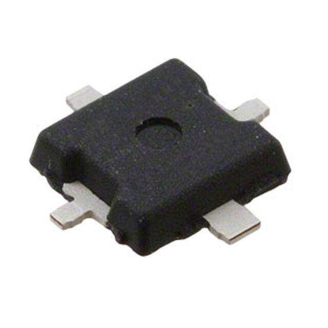

NE5550779A-T1-A 数据手册
Data Sheet NE5550779A R09DS0040EJ0300 Rev.3.00 Mar 12, 2013 Silicon Power LDMOS FET FEATURES • • • • • High Output Power : Pout = 38.5 dBm TYP. (VDS = 7.5 V, IDset = 140 mA, f = 460 MHz, Pin = 25 dBm) High power added efficiency : ηadd = 66% TYP. (VDS = 7.5 V, IDset = 140 mA, f = 460 MHz, Pin = 25 dBm) High Linear gain : GL = 22.0 dB TYP. (VDS = 7.5 V, IDset = 140 mA, f = 460 MHz, Pin = 10 dBm) High ESD tolerance Suitable for VHF to UHF-BAND Class-AB power amplifier. APPLICATIONS • 150 MHz Band Radio System • 460 MHz Band Radio System • 900 MHz Band Radio System ORDERING INFORMATION Part Number NE5550779A Order Number NE5550779A-A NE5550779A-T1 NE5550779A-T1-A Package 79A (Pb-Free) Marking W8 Supplying Form • 12 mm wide embossed taping • Gate pin faces the perforation side of the tape • • • • • • 12 mm wide embossed taping Gate pin faces the perforation side of the tape Qty 1 kpcs/reel NE5550779A-T1A NE5550779A-T1A-A 12 mm wide embossed taping Gate pin faces the perforation side of the tape Qty 5 kpcs/reel Remark To order evaluation samples, please contact your nearby sales office. Part number for sample order: NE5550779A ABSOLUTE MAXIMUM RATINGS (TA = 25°C, unless otherwise specified) Operation in excess of any one of these parameters may result in permanent damage. Parameter Drain to Source Voltage Gate to Source Voltage Drain Current Symbol VDS VGS IDS Drain Current (50% Duty Pulsed) Total Power Dissipation Note Channel Temperature Storage Temperature Note: IDS-pulse Ratings 30 6.0 2.1 4.2 Unit V V A A Ptot Tch Tstg 17.8 150 −55 to +150 W °C °C Value at TC = 25°C CAUTION Observe precautions when handling because these devices are sensitive to electrostatic discharge. The mark shows major revised points. The revised points can be easily searched by copying an "" in the PDF file and specifying it in the "Find what:" field. R09DS0040EJ0300 Rev.3.00 Mar 12, 2013 Page 1 of 15 NE5550779A RECOMMENDED OPERATING RANGE (TA = 25°C) Parameter Drain to Source Voltage Gate to Source Voltage Drain Current Input Power Symbol VDS VGS IDS Pin Test Conditions f = 460 MHz, VDS = 7.5 V MIN. – 1.65 – – TYP. 7.5 2.20 1.4 25 MAX. 9.0 2.85 – 30 Unit V V A dBm ELECTRICAL CHARACTERISTICS (TA = 25°C, unless otherwise specified) Parameter DC Characteristics Gate to Source Leakage Current Drain to Source Leakage Current (Zero Gate Voltage Drain Current) Gate Threshold Voltage Drain to Source Breakdown Voltage Transconductance Thermal Resistance RF Characteristics Output Power Drain Current Power Drain Efficiency Power Added Efficiency Linear Gain Load VSWR Tolerance Output Power Drain Current Power Drain Efficiency Power Added Efficiency Linear Gain Output Power Drain Current Power Drain Efficiency Power Added Efficiency Linear Gain Notes: 1. 2. 3. 4. Symbol IGSS IDSS Vth BVDSS Gm Rth Pout IDS ηd ηadd Test Conditions MIN. TYP. MAX. Unit − − − − 100 10 μA VDS = 7.5 V, IDS = 1.0 mA IDS = 10 μA VDS = 7.5 V, IDS = 490±70 mA Channel to Case 1.15 25 1.26 − 1.65 38 1.54 7.0 2.25 − 2.03 − V V S °C/W f = 460 MHz, VDS = 7.5 V, Pin = 25 dBm, IDset = 140 mA (RF OFF) 37.0 − − − − 38.5 1.38 68 66 22.0 − − − − − dBm A % % dB − − − − − − − − − − dBm A % % dB dBm A % % dB VGS = 6.0 V VDS = 25 V GL Note 1 Note 2 Pout IDS ηd ηadd GL Note 3 Pout IDS ηd ηadd GL Note 4 f = 460 MHz, VDS = 9.0 V, Pin = 25 dBm, IDset = 140 mA (RF OFF) Load VSWR=20:1(All Phase) f = 157 MHz, VDS = 7.5 V, Pin = 23 dBm, IDset = 140 mA (RF OFF) f = 900 MHz, VDS = 7.5 V, Pin = 27 dBm, IDset = 140 mA (RF OFF) nA No Destroy − − − − − − − − − − 38.5 1.36 69 67 24.0 37.4 1.26 58 53 17.0 Pin = 10 dBm These characteristics values are measurement using measurement tools especially by RENESAS. Pin = 5 dBm Pin = 10 dBm Remark DC performance is 100% testing. RF performance is testing several samples per wafer. A wafer rejection criterion for standard devices is 1 reject for several samples. R09DS0040EJ0300 Rev.3.00 Mar 12, 2013 Page 2 of 15 NE5550779A TEST CIRCUIT SCHEMATIC FOR 460 MHz VGS VDS R1 C1 L1 C1 IN OUT 50 Ω C10 L2 C11 C12 C13 C22 NE5550779A 50 Ω C20 L3 C21 COMPONENTS OF TEST CIRCUIT FOR MEASURING ELECTRICAL CHARACTERISTICS Symbol C1 C10 C11 Value 1 μF 27 pF 2.7 pF Type GRM188B31C105KA92 GRM1882C1H270JA01 ATC100A2R7JW C12 12 pF ATC100A120BW American Technical Ceramics C13 12 pF ATC100A120BW American Technical Ceramics C20 24 pF ATC100A240JW American Technical Ceramics C21 6.8 pF ATC100A6R8BW American Technical Ceramics C22 100 pF ATC100A101JW R1 2 kΩ American Technical Ceramics KOA L1 L2 L3 PCB SMA Connecter 114 nH 4.7 nH 3.0 nH − − R09DS0040EJ0300 Rev.3.00 Mar 12, 2013 1/10 W Chip Resistor RK73B1JTTD202J φ 0.5 mm, φ D = 3 mm, 10 Turns LQW18AN4R7NG00 LQP15MN3N0B02 R1766, t = 0.4 mm, εr = 4.5, size = 30 × 48 mm WAKA 01K0790-20 Maker Murata Murata American Technical Ceramics Ohesangyou Murata Murata Panasonic WAKA Page 3 of 15 NE5550779A COMPONENT LAYOUT OF TEST CIRCUIT FOR 460 MHz VDS VGS C1 L1 C11 RF IN C12 C12 R1 C13 C13 L2 C10 R09DS0040EJ0300 Rev.3.00 Mar 12, 2013 C1 C20 C21 L3 RF OUT C22 Page 4 of 15 NE5550779A TYPICAL CHARACTERISTICS 1 (TA = 25°C) R: f = 460MHz, VDS = 3.6/4.5/6/7.5/9 V, IDset = 140 mA, Pin = 0 to 30 dBm IM: f1 = 460MHz, f2 = 461 MHz, VDS = 3.6/4.5/6/7.5/9 V, IDset = 140mA, Pout (2 tone) = 12 to 37 dBm 45 40 POWER GAIN, POWER ADDED EFFICIENCY vs. INPUT POWER 40 3.0 Pout - 3.6 V Pout - 4.5 V Pout - 6 V Pout - 7.5 V Pout - 9 V 2.7 35 2.4 30 2.1 25 1.8 35 10 IDS - 3.6 V IDS - 4.5 V IDS - 6 V IDS - 7.5 V IDS - 9 V 1.2 0.6 0 0.3 –10 10 15 20 25 30 0.0 35 50 40 15 30 10 20 5 10 0 5 10 15 20 25 30 35 Input Power Pin (dBm) Input Power Pin (dBm) 2f0 vs. OUTPUT POWER IM3/IM5 vs. 2 TONES OUTPUT POWER 0 2f0 - 3.6 V 2f0 - 4.5 V 2f0 - 6 V 2f0 - 7.5 V 2f0 - 9 V –20 –30 –40 –50 –60 –70 15 60 20 0 –5 3rd/5th Order Intermodulation Distortion IM3/IM5 (dBc) 0 5 25 70 0.9 5 0 Power Gain GP (dB) 15 –5 –5 2nd Harmonics 2f0 (dBc) 1.5 20 Drain Current IDS (A) Output Power Pout (dBm) 30 80 Gp - 3.6 V Gp - 4.5 V Gp - 6 V Gp - 7.5 V Gp - 9 V η add - 3.6 V η add - 4.5 V η add - 6 V η add - 7.5 V η add - 9 V 20 25 30 35 40 45 Output Power Pout (dBm) –10 –20 Power Added Efficiency ηadd (%) OUTPUT POWER, DRAIN CURRENT vs. INPUT POWER 0 IM3 - 3.6 V IM3 - 4.5 V IM3 - 7.5 V IM3 - 9 V IM5 - 3.6 V IM5 - 4.5 V IM5 - 7.5 V IM5 - 9 V IM3 - 6 V IM5 - 6 V –30 –40 –50 –60 –70 10 15 20 25 30 35 40 2 Tones Output Power Pout (2 tone) (dBm) Remark The graphs indicate nominal characteristics. R09DS0040EJ0300 Rev.3.00 Mar 12, 2013 Page 5 of 15 NE5550779A TEST CIRCUIT SCHEMATIC FOR 157 MHz VGS VDS R1 C1 L1 C1 IN 50 Ω OUT C10 L10 C11 C12 C23 50 Ω L20 NE5550779A C20 C21 C22 COMPONENTS OF TEST CIRCUIT FOR MEASURING ELECTRICAL CHARACTERISTICS Symbol C1 C10 C11 C12 C20 C21 C22 C23 R1 Value 1 μF 100 pF 5.6 pF 39 pF 22 pF 68 pF 15 pF 100 pF 5.1 kΩ L1 L10 L20 PCB SMA Connecter 74.7 nH 27 nH 29.8 nH − − R09DS0040EJ0300 Rev.3.00 Mar 12, 2013 Type GRM31MB11E105KA01 GQM1882C1H101JB01 GQM1882C2A5R6DB01 GQM1882C1H390JB01 GRM1882C1H220JA01 GQM1882C1H680JB01 GQM1882C1H150JA01 GQM1882C1H101JB01 1/10 W Chip Resistor MCR03J103 φ 0.4 mm, φ D = 2 mm, 10 Turns LLQ2012-F27N φ 0.4 mm, φ D = 2 mm, 5 Turns R1766, t = 0.4 mm, εr = 4.5, size = 30 × 48 mm WAKA 01K0790-20 Maker Murata Murata Murata Murata Murata Murata Murata Murata ROAM Ohesangyou Toko Ohesangyou Panasonic WAKA Page 6 of 15 NE5550779A COMPONENT LAYOUT OF TEST CIRCUIT FOR 157 MHz C1 C1 L1 L10 IN C10 C11 C11 R1 C 20 C 21 L20 C23 OUT C22 R09DS0040EJ0300 Rev.3.00 Mar 12, 2013 Page 7 of 15 NE5550779A TYPICAL CHARACTERISTICS 2 (TA = 25°C) f = 157 MHz, VDS = 3.6/4.5/6/7.5/9 V, IDset = 40 mA, Pin = –10 to 20 dBm POWER GAIN, POWER ADDED EFFICIENCY vs. INPUT POWER OUTPUT POWER, DRAIN CURRENT vs. INPUT POWER Output Power Pout (dBm) 35 35 2.5 30 2.0 25 1.5 20 80 GP - 3.6 V GP - 4.5 V GP - 6 V GP - 7.5 V GP - 9 V η add - 3.6 V η add - 4.5 V η add - 6 V η add - 7.5 V η add - 9 V 70 60 30 50 25 40 20 30 15 20 10 10 1.0 15 10 –5 40 3.0 Power Gain GP (dB) 40 45 3.5 Pout - 3.6 V Pout - 4.5 V Pout - 6.0 V Pout - 7.5 V Pout - 9 V IDS - 3.6 V IDS - 4.5 V IDS - 6 V IDS - 7.5 V IDS - 9 V Drain Current IDS (A) 45 0.5 0 5 10 15 20 25 0.0 30 Input Power Pin (dBm) 5 –5 0 5 10 15 20 25 Power Added Efficiency η add (%) RF: 0 30 Input Power Pin (dBm) Remark The graphs indicate nominal characteristics. R09DS0040EJ0300 Rev.3.00 Mar 12, 2013 Page 8 of 15 NE5550779A TEST CIRCUIT SCHEMATIC FOR 900 MHz VGS VDS R1 C1 L1 C2 IN 50 Ω OUT C10 C24 C11 C12 C13 FET NE5550779A C20 C21 50 Ω C23 C22 COMPONENTS OF TEST CIRCUIT FOR MEASURING ELECTRICAL CHARACTERISTICS Symbol C10 C11 C12 C13 C20 C21 C22 C23 C24 C1 C2 L1 R1 PCB SMA Connecter Value 27 pF 6.8 pF 15 pF 18 pF 8.2 pF 3.9 pF 1.5 pF 8.2 pF 100 pF 1 μF 1 μF 74.7 nH 20 kΩ − − R09DS0040EJ0300 Rev.3.00 Mar 12, 2013 Type GQM1882C1H270JB01 GQM1882C2A6R8DB01 GQM1882C1H150JB01 GQM1882C1H180JB01 GQM1882C1H8R2DB01 GQM1883C2A3R9CB01 GQM1884C2A1R5CB01 GQM1882C1H8R2DB01 GQM1882C1H101JB01 GRM21BB31H105KA2L GRM21BB31H105KA2L D20-74N7 MCR03J203 R1766, t = 0.8 mm, εr = 4.8, size = 30 × 40 mm WAKA 01K0790-20 Maker Murata Murata Murata Murata Murata Murata Murata Murata Murata Murata Murata Ohesangyou Rohm Panasonic WAKA Page 9 of 15 NE5550779A COMPONENT LAYOUT OF TEST CIRCUIT FOR 900 MHz VDS VGS C1 C2 VGS RF IN VDS C1 RF IN C10 R09DS0040EJ0300 Rev.3.00 Mar 12, 2013 C1 0 R1 C2 RF OUT L1 L1 C23 C23 C24 C 11 C 20 C 21 C 12 C 22 C11 C12C13 C13 C20 C21C22 R1 C24 Page 10 of 15 NE5550779A TYPICAL CHARACTERISTICS 3 (TA = 25°C) RF: f = 900 MHz, VDS = 3.6/4.5/6/7.5/9 V, IDset = 40 mA, Pin = –5 to 30 dBm POWER GAIN, DRAIN CURRENT vs. INPUT POWER 40 50 20 40 15 30 10 20 5 10 0 –10 –5 0 5 (%) 60 10 15 20 25 30 35 0 Input Power Pin (dBm) Power Gain GP (dB) 25 25 add Output Power Pout (dBm) 30 70 Power Added Efficiency η 35 30 80 Pout - 3.6 V Pout - 4.5 V Pout - 6.0 V Pout - 7.5 V Pout - 9 V η add - 3.6 V η add - 4.5 V η add - 6.0 V η add - 7.5 V η add - 9 V 20 1.8 GP - 3.6 V GP - 4.5 V GP - 6 V GP - 7.5 V GP - 9 V IDS - 3.6 V IDS - 4.5 V IDS - 6.0 V IDS - 7.5 V IDS - 9 V 1.5 1.2 15 0.9 10 0.6 5 0.3 0 –10 –5 0 5 10 15 20 25 30 35 Drain Current IDS (A) OUTPUT POWER, POWER ADDED EFFICIENCY vs. INPUT POWER 0 Input Power Pin (dBm) Remark The graphs indicate nominal characteristics. R09DS0040EJ0300 Rev.3.00 Mar 12, 2013 Page 11 of 15 NE5550779A S-PARAMETERS S-parameters and noise parameters are provided on our web site in a form (S2P) that enables direct import of the parameters to microwave circuit simulators without the need for keyboard inputs. Click here to download S-parameters. [Products] → [RF Devices] → [Device Parameters] URL http://www.renesas.com/products/microwave/ R09DS0040EJ0300 Rev.3.00 Mar 12, 2013 Page 12 of 15 NE5550779A MOUNTING LAYOUT PAD DIMENSIONS 79A (UNIT: mm) 4.0 1.7 Source Stop up the hole with a rosin or something to avoid solder flow. Drain 1.2 0.5 1.0 5.9 Gate Through Hole: φ 0.2 × 33 0.5 0.5 6.1 Remark The mounting pad layout in this document is for reference only. When designing PCB, please consider workability of mounting, solder joint reliability, prevention of solder bridge and so on, in order to optimize the design. R09DS0040EJ0300 Rev.3.00 Mar 12, 2013 Page 13 of 15 NE5550779A PACKAGE DIMENSIONS 79A (UNIT: mm) 0.4±0.15 1.2 MAX. Drain 3.6±0.2 0.2±0.1 0.9±0.2 Gate 0.8 MAX. 5.7 MAX. R09DS0040EJ0300 Rev.3.00 Mar 12, 2013 1.0 MAX. 0.8±0.15 Drain 4.4 MAX. Source 27001 Source 8 1.5±0.2 W Gate 0.6±0.15 5.7 MAX. (Bottom View) 4.2 MAX. Page 14 of 15 NE5550779A RECOMMENDED SOLDERING CONDITIONS This product should be soldered and mounted under the following recommended conditions. For soldering methods and conditions other than those recommended below, contact your nearby sales office. Soldering Method Infrared Reflow Soldering Conditions Peak temperature (package surface temperature) Time at peak temperature Time at temperature of 220°C or higher Preheating time at 120 to 180°C Maximum number of reflow processes Maximum chlorine content of rosin flux (% mass) : 260°C or below : 10 seconds or less : 60 seconds or less : 120±30 seconds : 3 times : 0.2% (Wt.) or below Condition Symbol IR260 Wave Soldering Peak temperature (molten solder temperature) : 260°C or below Time at peak temperature : 10 seconds or less Preheating temperature (package surface temperature) : 120°C or below Maximum number of flow processes : 1 time Maximum chlorine content of rosin flux (% mass) : 0.2% (Wt.) or below WS260 Partial Heating Peak temperature (terminal temperature) : 350°C or below Soldering time (per side of device) : 3 seconds or less Maximum chlorine content of rosin flux (% mass) : 0.2% (Wt.) or below HS350 CAUTION Do not use different soldering methods together (except for partial heating). R09DS0040EJ0300 Rev.3.00 Mar 12, 2013 Page 15 of 15 Revision History Rev. 1.00 2.00 3.00 Date Apr 26, 2012 Jul 04, 2012 Mar 12, 2013 NE5550779A Data Sheet Description Summary Page − p.2 First edition issued Modification of ELECTRICAL CHARACTERISTICS p.6 Modification of COMPONENTS OF TEST CIRCUIT FOR MEASURING ELECTRICAL CHARACTERISTICS P3 Modification of COMPONENTS OF TEST CIRCUIT FOR MEASURING ELECTRICAL CHARACTERISTICS P6 Modification of COMPONENTS OF TEST CIRCUIT FOR MEASURING ELECTRICAL CHARACTERISTICS P9 Modification of COMPONENTS OF TEST CIRCUIT FOR MEASURING ELECTRICAL CHARACTERISTICS All trademarks and registered trademarks are the property of their respective owners. C-1 Notice 1. Descriptions of circuits, software and other related information in this document are provided only to illustrate the operation of semiconductor products and application examples. You are fully responsible for the incorporation of these circuits, software, and information in the design of your equipment. Renesas Electronics assumes no responsibility for any losses incurred by you or third parties arising from the use of these circuits, software, or information. 2. Renesas Electronics has used reasonable care in preparing the information included in this document, but Renesas Electronics does not warrant that such information is error free. Renesas Electronics 3. Renesas Electronics does not assume any liability for infringement of patents, copyrights, or other intellectual property rights of third parties by or arising from the use of Renesas Electronics products or assumes no liability whatsoever for any damages incurred by you resulting from errors in or omissions from the information included herein. technical information described in this document. No license, express, implied or otherwise, is granted hereby under any patents, copyrights or other intellectual property rights of Renesas Electronics or others. 4. You should not alter, modify, copy, or otherwise misappropriate any Renesas Electronics product, whether in whole or in part. Renesas Electronics assumes no responsibility for any losses incurred by you or 5. Renesas Electronics products are classified according to the following two quality grades: "Standard" and "High Quality". The recommended applications for each Renesas Electronics product depends on third parties arising from such alteration, modification, copy or otherwise misappropriation of Renesas Electronics product. the product's quality grade, as indicated below. "Standard": Computers; office equipment; communications equipment; test and measurement equipment; audio and visual equipment; home electronic appliances; machine tools; personal electronic equipment; and industrial robots etc. "High Quality": Transportation equipment (automobiles, trains, ships, etc.); traffic control systems; anti-disaster systems; anti-crime systems; and safety equipment etc. Renesas Electronics products are neither intended nor authorized for use in products or systems that may pose a direct threat to human life or bodily injury (artificial life support devices or systems, surgical implantations etc.), or may cause serious property damages (nuclear reactor control systems, military equipment etc.). You must check the quality grade of each Renesas Electronics product before using it in a particular application. You may not use any Renesas Electronics product for any application for which it is not intended. Renesas Electronics shall not be in any way liable for any damages or losses incurred by you or third parties arising from the use of any Renesas Electronics product for which the product is not intended by Renesas Electronics. 6. You should use the Renesas Electronics products described in this document within the range specified by Renesas Electronics, especially with respect to the maximum rating, operating supply voltage range, movement power voltage range, heat radiation characteristics, installation and other product characteristics. Renesas Electronics shall have no liability for malfunctions or damages arising out of the use of Renesas Electronics products beyond such specified ranges. 7. Although Renesas Electronics endeavors to improve the quality and reliability of its products, semiconductor products have specific characteristics such as the occurrence of failure at a certain rate and malfunctions under certain use conditions. Further, Renesas Electronics products are not subject to radiation resistance design. Please be sure to implement safety measures to guard them against the possibility of physical injury, and injury or damage caused by fire in the event of the failure of a Renesas Electronics product, such as safety design for hardware and software including but not limited to redundancy, fire control and malfunction prevention, appropriate treatment for aging degradation or any other appropriate measures. Because the evaluation of microcomputer software alone is very difficult, please evaluate the safety of the final products or systems manufactured by you. 8. Please contact a Renesas Electronics sales office for details as to environmental matters such as the environmental compatibility of each Renesas Electronics product. Please use Renesas Electronics products in compliance with all applicable laws and regulations that regulate the inclusion or use of controlled substances, including without limitation, the EU RoHS Directive. Renesas Electronics assumes no liability for damages or losses occurring as a result of your noncompliance with applicable laws and regulations. 9. Renesas Electronics products and technology may not be used for or incorporated into any products or systems whose manufacture, use, or sale is prohibited under any applicable domestic or foreign laws or regulations. You should not use Renesas Electronics products or technology described in this document for any purpose relating to military applications or use by the military, including but not limited to the development of weapons of mass destruction. When exporting the Renesas Electronics products or technology described in this document, you should comply with the applicable export control laws and regulations and follow the procedures required by such laws and regulations. 10. It is the responsibility of the buyer or distributor of Renesas Electronics products, who distributes, disposes of, or otherwise places the product with a third party, to notify such third party in advance of the contents and conditions set forth in this document, Renesas Electronics assumes no responsibility for any losses incurred by you or third parties as a result of unauthorized use of Renesas Electronics products. 11. This document may not be reproduced or duplicated in any form, in whole or in part, without prior written consent of Renesas Electronics. 12. Please contact a Renesas Electronics sales office if you have any questions regarding the information contained in this document or Renesas Electronics products, or if you have any other inquiries. (Note 1) "Renesas Electronics" as used in this document means Renesas Electronics Corporation and also includes its majority-owned subsidiaries. (Note 2) "Renesas Electronics product(s)" means any product developed or manufactured by or for Renesas Electronics. http://www.renesas.com SALES OFFICES Refer to "http://www.renesas.com/" for the latest and detailed information. California Eastern Laboratories, Inc. 4590 Patrick Henry Drive, Santa Clara, California 95054, U.S.A. Tel: +1-408-919-2500, Fax: +1-408-988-0279 Renesas Electronics Europe Limited Dukes Meadow, Millboard Road, Bourne End, Buckinghamshire, SL8 5FH, U.K Tel: +44-1628-651-700, Fax: +44-1628-651-804 Renesas Electronics Europe GmbH Arcadiastrasse 10, 40472 Düsseldorf, Germany Tel: +49-211-65030, Fax: +49-211-6503-1327 Renesas Electronics (China) Co., Ltd. 7th Floor, Quantum Plaza, No.27 ZhiChunLu Haidian District, Beijing 100083, P.R.China Tel: +86-10-8235-1155, Fax: +86-10-8235-7679 Renesas Electronics (Shanghai) Co., Ltd. Unit 204, 205, AZIA Center, No.1233 Lujiazui Ring Rd., Pudong District, Shanghai 200120, China Tel: +86-21-5877-1818, Fax: +86-21-6887-7858 / -7898 Renesas Electronics Hong Kong Limited Unit 1601-1613, 16/F., Tower 2, Grand Century Place, 193 Prince Edward Road West, Mongkok, Kowloon, Hong Kong Tel: +852-2886-9318, Fax: +852 2886-9022/9044 Renesas Electronics Taiwan Co., Ltd. 13F, No. 363, Fu Shing North Road, Taipei, Taiwan Tel: +886-2-8175-9600, Fax: +886 2-8175-9670 Renesas Electronics Singapore Pte. Ltd. 80 Bendemeer Road, Unit #06-02 Hyflux Innovation Centre Singapore 339949 Tel: +65-6213-0200, Fax: +65-6213-0300 Renesas Electronics Malaysia Sdn.Bhd. Unit 906, Block B, Menara Amcorp, Amcorp Trade Centre, No. 18, Jln Persiaran Barat, 46050 Petaling Jaya, Selangor Darul Ehsan, Malaysia Tel: +60-3-7955-9390, Fax: +60-3-7955-9510 Renesas Electronics Korea Co., Ltd. 11F., Samik Lavied' or Bldg., 720-2 Yeoksam-Dong, Kangnam-Ku, Seoul 135-080, Korea Tel: +82-2-558-3737, Fax: +82-2-558-5141 © 2013 Renesas Electronics Corporation. All rights reserved. [Colophon 2.2]
