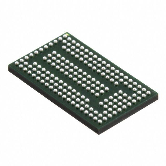

DATASHEET 1.35V/1.5V REGISTERING CLOCK DRIVER WITH PARITY TEST AND QUAD CHIP SELECT Description This 28-bit 1:2, or 26-bit 1:2 and 4-bit 1:1, registering clock driver with parity is designed for 1.35V and 1.5V VDD operation. All inputs are 1.35V and 1.5V CMOS compatible, except the reset (RESET) and MIRROR inputs which are LVCMOS. All outputs are 1.35V and 1.5V CMOS edge-controlled drivers optimized to drive single terminated 25 to 50 traces in DDR3 RDIMM applications, except the open-drain error (ERROUT) output. The clock outputs (Yn and Yn) and control net outputs QnCKEn, QnCSn and QnODTn are designed with a different strength and skew to compensate for different loading and equalize signal travel speed. The SSTE32882HLB has two basic modes of operation associated with the Quad Chip Select Enable (QCSEN) input. When the QCSEN input pin is open (or pulled high), the component has two chip select inputs, DCS0 and DCS1, and two copies of each chip select output, QACS0, QACS1, QBCS0 and QBCS1. This is the "QuadCS disabled" mode. When the QCSEN input pin is pulled low, the component has four chip select inputs DCS[3:0], and four chip select outputs, QCS[3:0]. This is the "QuadCS enabled" mode. Through the remainder of this specification, DCS[n:0] will indicate all of the chip select inputs, where n=1 for QuadCS disabled, and n=3 for QuadCS enabled. QxCS[n:0] will indicate all of the chip select outputs. SSTE32882HLB has occurred on the open-drain ERROUT pin (active low). The convention is even parity; i.e., valid parity is defined as an even number of ones across the DIMM-independent data inputs combined with the parity input bit. To calculate parity, all DIMM-independent D-inputs must be tied to a known logic state. The DIMM-dependent signals (DCKEn, DODTn, and DCSn) are not included in the parity check computation. To ensure defined outputs from the register before a stable clock has been supplied, RESET must be held in the low state during power-up. The SSTE32882HLB is available in a 176-ball BGA with 0.65mm ball pitch in a 11 x 20 grid. It is also available in a 176-ball Thin-Profile Fine-Pitch BGA with 0.65mm ball pitch in an 8x22 grid. The device pinout supports outputs on the outer two left and right columns to support easy DIMM signal routing. Corresponding inputs are placed in a-way that two devices can be placed back-to-back for four Rank modules while the data inputs share the same vias. Each input and output is located close to an associated no ball position or on the outer two rows to allow low cost via technology combined with the small 0.65mm ball pitch. The SSTE32882HLB includes a high-performance, low-jitter, low-skew buffer that distributes a differential clock input (CK and CK) to four differential pairs of clock outputs (Yn and Yn), and to one differential pair of feedback clock outputs (FBOUT and FBOUT). The clock outputs are controlled by the input clocks (CK and CK), the feedback clocks (FBIN and FBIN), and the analog power inputs (AVDD and AVSS). When AVDD is grounded, the PLL is turned off and bypassed for test purposes. The SSTE32882HLB operates from a differential clock (CK and CK). Data are registered at the crossing of CK going high, and CK going low. The data is either driven to the corresponding device outputs if exactly one of the DCS[n:0] input signals is driven low. Based on the control register settings, the device can change its output characterisitics to match different DIMM net topologies. The timing can be changed to compensate for different flight time of signals within the target application. By disabling unused outputs the power consumption is reduced. The SSTE32882HLB accepts a parity bit from the memory controller on the parity (PAR_IN) input, compares it with the data received on the DIMM-independent data inputs (DAn, DBAn, DRAS, DCAS, and DWE), and indicates whether a parity error 1.35V/1.5V REGISTERING CLOCK DRIVER WITH PARITY TEST AND QUAD CHIP SELECT 1 SSTE32882HLB 7201/14 SSTE32882HLB 1.35V/1.5V REGISTERING CLOCK DRIVER WITH PARITY TEST AND QUAD CHIP SELECT COMMERCIAL TEMPERATURE Features • • • • • • Pinout optimizes DDR3 RDIMM PCB layout • • • • Supports CKE Power Down operation modes 1-to-2 Register Outputs and 1-to-4 Clock Pair Outputs support stacked DDR3 RDIMMs Phase Lock Loop clock driver for buffering one differential clock pair (CK and CK) and distributing to four differential outputs Supports LVCMOS switching levels on the RESET and MIRROR inputs Checks priority on DIMM-independent data inputs Supports dynamic 1T/3T timing transaction and output inversion feature for improved timing performance during normal operations and MRS command pass-through Supports Quad Chip Select operation features RESET input disables differential input recievers, resets all registers, and disables all output drivers except ERROUT and QnCKEn Provides access to internal control words for configuring the device features and adapting in different RDIMM and system applications • Latch-up performance exceeds 100mA • ESD > 2000V per MIL-STD883, Method 3015; ESD > 200V using machine model (c = 200pF, R = 0) • Available in 176 Ball Grid Array package 1.35V/1.5V REGISTERING CLOCK DRIVER WITH PARITY TEST AND QUAD CHIP SELECT 2 SSTE32882HLB 7201/14 SSTE32882HLB 1.35V/1.5V REGISTERING CLOCK DRIVER WITH PARITY TEST AND QUAD CHIP SELECT COMMERCIAL TEMPERATURE Block Diagram - Register and PLL Logic Diagram (Positive Logic) DRAS DCAS DWE VREF DA3..DA9, DA11, DA13..DA15, DBA0..DBA2 Output Inversion QxA3..QxA9, QxA11, QxA13..QxA15, QxBA0..QxBA2 D 0 Q R CE 1 3 DA0..DA2, DBA2 DA0-DA2, DA10, DA12, DRAS, DCAS, DWE 4 DA3, DA4, DBA0, DBA1 B-Enable Control Word A-Enable State Machine and Y0..Y3Control Logic Enable D Q R CE CMR Access PreLaunch 4 (1) DCS[n:0] D (1) 0 Q R DCKE0, DCKE1 QxA0-QxA2, QxA10, QxA12, QxRAS, QxCAS, QxWE 1/4 CK delay QxCS[n:0] 1 CS Logic D DODT0, DODT1 QACKEn 0 Q R 1/4 CK delay 1 QBCKEn D QAODTn 0 Q R 1/4 CK delay RESET 1 QBODTn OE0 Y0 Y0 OE1 Y1 CK CK Y1 10K~100K FBIN FBIN PLL OE2 0 1/4 CK delay Y2 1 Y2 OE3 Y3 Y3 FBOUT FBOUT 1 DCS[n:0] indicates all of the chip select inputs, where n=1 for QuadCS disabled, and n=3 for QuadCS enabled. QxCS[n:0] indicates all of the chip select outputs. 1.35V/1.5V REGISTERING CLOCK DRIVER WITH PARITY TEST AND QUAD CHIP SELECT 3 SSTE32882HLB 7201/14 SSTE32882HLB 1.35V/1.5V REGISTERING CLOCK DRIVER WITH PARITY TEST AND QUAD CHIP SELECT COMMERCIAL TEMPERATURE Block Diagram - Parity Logic Diagram (Positive Logic) VREF DRAS DCAS DWE DA0..DA15, DBA0..DBA2, DRAS, DCAS, DWE Output Inversion Disabled 3T Timing Enabled D Q R PAR_IN Internal Logic CE D Q R CE Parity Generator and Error Check QA0..QA15, QBA0..QBA2, QRAS, QCAS, QWE ERROUT (1) DCS[n:0] D (1) Q Internal Logic Q Internal Logic QxCS[n:0] R CS Logic DCKE0, DCKE1 D QACKEn QBCKEn R DODT0, DODT1 QAODTn D Q Internal Logic QBODTn R RESET Y0 Y0 Y1 CK Internal Logic CK 10K - 100K Y1 Y2 Y2 Y3 PLL FBIN Y3 FBIN FBOUT FBOUT 1 DCS[n:0] indicates all of the chip select inputs, where n=1 for QuadCS disabled, and n=3 for QuadCS enabled. QxCS[n:0] indicates all of the chip select outputs. 1.35V/1.5V REGISTERING CLOCK DRIVER WITH PARITY TEST AND QUAD CHIP SELECT 4 SSTE32882HLB 7201/14 SSTE32882HLB 1.35V/1.5V REGISTERING CLOCK DRIVER WITH PARITY TEST AND QUAD CHIP SELECT COMMERCIAL TEMPERATURE Pinout Configuration Package options include a 176-ball Thin-Profile Fine-Pitch BGA (TFBGA) with 0.65mm ball pitch, 11 x 20 grid, 8.0mm x 13.5mm. It uses the mechanical outline MO-246 variation F. The device pinout supports outputs on the outer two left and right columns to support easy DIMM signal routing. Corresponding inputs are placed in a way that two devices can be placed back to back for 4 Rank modules while the data inputs share the same vias. Each input and output is located close to an associated no-ball position or on the outer two rows to allow low cost via technology combined with the small 0.65mm ball pitch. 1 2 3 4 5 6 7 8 9 10 11 A B C D E F G H J K L M N P R T U V W Y 176-ball Thin Profile Fine Pitch BGA (TFBGA) 11x20 Grid Top View 1.35V/1.5V REGISTERING CLOCK DRIVER WITH PARITY TEST AND QUAD CHIP SELECT 5 SSTE32882HLB 7201/14 SSTE32882HLB 1.35V/1.5V REGISTERING CLOCK DRIVER WITH PARITY TEST AND QUAD CHIP SELECT COMMERCIAL TEMPERATURE Pin Descriptions The device has symmetric pinout with the inputs on the south side and the outputs on the east and west sides. This allows back-to-back mounting on both sides of the PCB if more than one device is needed. Ball Assignment: MIRROR = LOW, QCSEN = HIGH or float This table specifies the pinout for SSTE32882HLB in the front configuration (QuadCS mode disabled). Balls A9 and W7 are reserved for future functions and must not be connected on the system. However, a ball on the device and connecting pad on the module are required in these locations. Also, balls Y2 and R6 are “do not use” balls reserved for DCS2 and DCS3 in the QuadCS mode, and must not be connected on the system. The device is designed to tolerate floating on these pins. Blank spaces indicate no ball is populated at that gridpoint, and vias on the module may be located in these areas. 1 A B C D E F G H J K L M N P R T U V W Y QAA13 QAA14 QAA9 QAA11 QAA2 QAA1 QAA0 QAA12 QABA2 QAA15 QAWE QAA10 QACAS QARAS DCKE1 DCKE0 DA12 DA9 DA8 DA7 2 3 QAA8 QCSEN QAA7 QAA6 VDD QAA5 VSS QAA4 VDD QAA3 VSS QABA1 VDD QABA0 VSS VDD QACS1 QACKE0 VSS QACS0 VDD QACKE1 VSS QAODT0 VDD QAODT1 DA3 DA14 DA15 DCS0 DBA2 DA11 DA6 FBIN RSVD FBIN 4 5 6 7 8 9 10 11 VSS RESET MIRROR ERROUT VSS RSVD VDD VSS VDD VSS VDD VSS VDD VSS VDD VSS VDD VSS DA5 VDD VSS VDD VSS VDD VSS VDD VSS VDD VSS VDD VSS RSVD VDD VSS VDD VSS VDD VSS VDD VSS VDD VSS VDD VSS DA2 PVSS PVSS AVSS AVDD VDD VSS CK CK PVDD PVDD RSVD VREFCA QBA8 QBA7 QBA6 QBA5 QBA4 QBA3 QBBA1 QBBA0 QBCS1 QBCKE0 QBCS0 QBCKE1 QBODT0 QBODT1 DA10 DCS1 DA13 DRAS DA0 PAR_IN QBA13 QBA14 QBA9 QBA11 QBA2 QBA1 QBA0 QBA12 QBBA2 QBA15 QBWE QBA10 QBCAS QBRAS DODT1 DODT0 DCAS DWE DBA0 DBA1 Y1 Y1 Y3 Y3 1.35V/1.5V REGISTERING CLOCK DRIVER WITH PARITY TEST AND QUAD CHIP SELECT 6 VDD VSS VDD VSS VDD VSS VDD VSS VDD VSS VDD DA4 DA1 Y0 Y0 Y2 Y2 FBOUT FBOUT SSTE32882HLB 7201/14 SSTE32882HLB 1.35V/1.5V REGISTERING CLOCK DRIVER WITH PARITY TEST AND QUAD CHIP SELECT COMMERCIAL TEMPERATURE Ball Assignment: MIRROR = HIGH, QCSEN = HIGH or float This table specifies the pinout for SSTE32882HLB in the back configuration (QuadCS mode disabled). Balls A9 and W7 are reserved for future functions and must not be connected on the system. However, a ball on the device and connecting pad on the module are required in these locations. Also, balls Y10 and R6 are “do not use” balls reserved for DCS2 and DCS3 in the QuadCS mode, and must not be connected on the system. The device is designed to tolerate floating on these pins. Blank spaces indicate no ball is populated at that gridpoint, and vias on the module may be located in these areas. A B C D E F G H J K L M N P R T U V W Y 1 2 3 4 5 6 7 8 9 10 11 QAA13 QAA14 QAA9 QAA11 QAA2 QAA1 QAA0 QAA12 QABA2 QAA15 QAWE QAA10 QACAS QARAS DODT1 DODT0 DCAS DWE DBA0 DBA1 QAA8 QAA7 QAA6 QAA5 QAA4 QAA3 QABA1 QABA0 QACS1 QACKE0 QACS0 QACKE1 QAODT0 QAODT1 DA10 DCS1 DA13 DRAS DA0 PAR_IN QCSEN VSS RESET MIRROR ERROUT VSS RSVD VDD VSS VDD VSS VDD VSS VDD VSS VDD VSS VDD VSS DA2 VDD VSS VDD VSS VDD VSS VDD VSS VDD VSS VDD VSS RSVD VDD VSS VDD VSS VDD VSS VDD VSS VDD VSS VDD VSS DA5 PVSS PVSS AVSS AVDD VDD VSS CK CK PVDD PVDD RSVD VREFCA QBA8 QBA7 QBA6 QBA5 QBA4 QBA3 QBBA1 QBBA0 QBCS1 QBCKE0 QBCS0 QBCKE1 QBODT0 QBODT1 DA14 DCS0 DBA2 DA11 DA6 RSVD QBA13 QBA14 QBA9 QBA11 QBA2 QBA1 QBA0 QBA12 QBBA2 QBA15 QBWE QBA10 QBCAS QBRAS DCKE1 DCKE0 DA12 DA9 DA8 DA7 VDD VSS VDD VSS VDD VSS VDD VSS VDD VSS VDD DA4 DA1 FBIN FBIN Y1 Y1 Y3 Y3 1.35V/1.5V REGISTERING CLOCK DRIVER WITH PARITY TEST AND QUAD CHIP SELECT 7 VDD VSS VDD VSS VDD VSS VDD VSS VDD VSS VDD DA3 DA15 Y0 Y0 Y2 Y2 FBOUT FBOUT SSTE32882HLB 7201/14 SSTE32882HLB 1.35V/1.5V REGISTERING CLOCK DRIVER WITH PARITY TEST AND QUAD CHIP SELECT COMMERCIAL TEMPERATURE Ball Assignment: MIRROR = LOW, QCSEN = LOW This table specifies the pinout for SSTE32882HLB in the front configuration (QuadCS mode enabled). Balls A9 and W7 are reserved for future functions and must not be connected on the system. However, a ball on the device and connecting pad on the module are required in these locations. Blank spaces indicate no ball is populated at that gridpoint, and vias on the module may be located in these areas. 1 A B C D E F G H J K L M N P R T U V W Y QAA13 QAA14 QAA9 QAA11 QAA2 QAA1 QAA0 QAA12 QABA2 QAA15 QAWE QAA10 QACAS QARAS DCKE1 DCKE0 DA12 DA9 DA8 DA7 2 3 QAA8 QCSEN QAA7 QAA6 VDD QAA5 VSS QAA4 VDD QAA3 VSS QABA1 VDD QABA0 VSS VDD QCS1 QACKE0 VSS QCS0 VDD QACKE1 VSS QAODT0 VDD QAODT1 DA3 DA14 DA15 DCS0 DBA2 DA11 DA6 FBIN FBIN DCS2 4 5 6 7 8 9 10 11 VSS RESET MIRROR ERROUT VSS RSVD VDD VSS VDD VSS VDD VSS VDD VSS VDD VSS VDD VSS DA5 VDD VSS VDD VSS VDD VSS VDD VSS VDD VSS VDD VSS DCS3 VDD VSS VDD VSS VDD VSS VDD VSS VDD VSS VDD VSS DA2 PVSS PVSS AVSS AVDD VDD VSS CK CK PVDD PVDD RSVD VREFCA QBA8 QBA7 QBA6 QBA5 QBA4 QBA3 QBBA1 QBBA0 QCS3 QBCKE0 QCS2 QBCKE1 QBODT0 QBODT1 DA10 DCS1 DA13 DRAS DA0 PAR_IN QBA13 QBA14 QBA9 QBA11 QBA2 QBA1 QBA0 QBA12 QBBA2 QBA15 QBWE QBA10 QBCAS QBRAS DODT1 DODT0 DCAS DWE DBA0 DBA1 Y1 Y1 Y3 Y3 1.35V/1.5V REGISTERING CLOCK DRIVER WITH PARITY TEST AND QUAD CHIP SELECT VDD VSS VDD VSS VDD VSS VDD VSS VDD VSS VDD DA4 DA1 8 Y0 Y0 Y2 Y2 FBOUT FBOUT SSTE32882HLB 7201/14 SSTE32882HLB 1.35V/1.5V REGISTERING CLOCK DRIVER WITH PARITY TEST AND QUAD CHIP SELECT COMMERCIAL TEMPERATURE Ball Assignment: MIRROR = HIGH, QCSEN = LOW This table specifies the pinout for SSTE32882HLB in the back configuration (QuadCS mode enabled). Balls A9 and W7 are reserved for future functions and must not be connected on the system. However, a ball on the device and connecting pad on the module are required in these locations. Blank spaces indicate no ball is populated at that gridpoint, and vias on the module may be located in these areas. A B C D E F G H J K L M N P R T U V W Y 1 2 3 4 5 6 7 8 9 10 11 QAA13 QAA14 QAA9 QAA11 QAA2 QAA1 QAA0 QAA12 QABA2 QAA15 QAWE QAA10 QACAS QARAS DODT1 DODT0 DCAS DWE DBA0 DBA1 QAA8 QAA7 QAA6 QAA5 QAA4 QAA3 QABA1 QABA0 QCS1 QACKE0 QCS0 QACKE1 QAODT0 QAODT1 DA10 DCS1 DA13 DRAS DA0 PAR_IN QCSEN VSS RESET MIRROR ERROUT VSS RSVD VDD VSS VDD VSS VDD VSS VDD VSS VDD VSS VDD VSS DA2 VDD VSS VDD VSS VDD VSS VDD VSS VDD VSS VDD VSS DCS3 VDD VSS VDD VSS VDD VSS VDD VSS VDD VSS VDD VSS DA5 PVSS PVSS AVSS AVDD VDD VSS CK CK PVDD PVDD RSVD VREFCA QBA8 QBA7 QBA6 QBA5 QBA4 QBA3 QBBA1 QBBA0 QCS3 QBCKE0 QCS2 QBCKE1 QBODT0 QBODT1 DA14 DCS0 DBA2 DA11 DA6 DCS2 QBA13 QBA14 QBA9 QBA11 QBA2 QBA1 QBA0 QBA12 QBBA2 QBA15 QBWE QBA10 QBCAS QBRAS DCKE1 DCKE0 DA12 DA9 DA8 DA7 VDD VSS VDD VSS VDD VSS VDD VSS VDD VSS VDD DA4 DA1 FBIN FBIN Y1 Y1 Y3 Y3 1.35V/1.5V REGISTERING CLOCK DRIVER WITH PARITY TEST AND QUAD CHIP SELECT 9 VDD VSS VDD VSS VDD VSS VDD VSS VDD VSS VDD DA3 DA15 Y0 Y0 Y2 Y2 FBOUT FBOUT SSTE32882HLB 7201/14 SSTE32882HLB 1.35V/1.5V REGISTERING CLOCK DRIVER WITH PARITY TEST AND QUAD CHIP SELECT COMMERCIAL TEMPERATURE Pinout configuration narrow package1 As an option, the device is available as a176-ball Thin-Profile Fine-Pitch BGA (TFBGA) with 0.65mm ball pitch, 8 x 22 grid, 6.0mm x 15mm. It is using the mechanical outline MO-246 variation B. Equivalent to the 11 x 20 grid configuration the device pinout supports outputs on the outer two left and right columns. Corresponding inputs are placed in a way that two devices can be placed back to back for 4 Rank modules while the data inputs share the same vias. 1 2 3 4 5 6 7 8 A B C D E F G H J K L M N P R T U V W Y AA AB 176-ball Thin Profile Fine Pitch BGA (TFBGA) 8x22 Grid Top View 1. This package may only be used in new DIMM designs. It is not intended for use in the existing DIMM’s. 1.35V/1.5V REGISTERING CLOCK DRIVER WITH PARITY TEST AND QUAD CHIP SELECT 10 SSTE32882HLB 7201/14 SSTE32882HLB 1.35V/1.5V REGISTERING CLOCK DRIVER WITH PARITY TEST AND QUAD CHIP SELECT COMMERCIAL TEMPERATURE Ball Assignment; MIRROR=LOW, QCSEN=HIGH (or Float) The table below specifies the pinout for SSTE32882 in front configuration with QuadCS mode disabled. The device has symmetric pinout with inputs at the south side and outputs to east and west sides. This allows back to back mounting on both sides of the PCB if more than one device is needed. 1 2 3 4 5 6 7 8 QAA13 QAA8 QCSEN RESET ERROUT RSVD QBA8 QBA13 A QAA14 QAA7 VSS VSS MIRROR VSS QBA7 QBA14 B QAA9 QAA6 VDD VDD VDD VDD QBA6 QBA9 C QAA11 QAA5 VSS VSS VSS VSS QBA5 QBA11 D QAA2 QAA4 VDD VDD VDD VDD QBA4 QBA2 E QAA1 QAA3 VSS VSS VSS VSS QBA3 QBA1 F QAA0 QABA1 VDD VDD VDD VDD QBBA1 QBA0 G QAA12 QABA0 VSS VSS VSS VSS QBBA0 QBA12 H QABA2 QACS1 VDD VDD VDD VDD QBCS1 QBBA2 J QAA15 QACKE0 VSS VSS VSS VSS QBCKE0 QBA15 K QAWE QACS0 VDD VDD VDD VDD QBCS0 QBWE L QAA10 QACKE1 VSS VSS VSS VSS QBCKE1 QBA10 M QACAS QAODT0 VDD VDD VDD VDD QBODT0 QBCAS N QARAS QAODT1 VSS VSS VSS VSS QBODT1 QBRAS P DA14 DCKE1 VDD VDD VDD VDD DODT1 DA10 R DCS0 DCKE0 VSS VSS VSS VSS DODT0 DCS1 T DA12 DA3 Y1 PVSS PVDD Y0 DA4 DCAS U DA5 DA9 Y1 PVSS PVDD Y0 DWE DA2 V DA8 DA15 Y3 PVSS PVDD Y2 DA1 DBA0 W DA7 DBA2 Y3 AVSS AVDD Y2 DA13 DBA1 Y DA11 RSVD FBIN CK RSVD FBOUT PAR_IN DRAS AA DA6 RSVD FBIN CK VREFCA FBOUT RSVD DA0 AB Pins A6, AA2, AA5, AB2 and AB7 are reserved for future functions must not be connected on system. The system must provide a solder pad for these pins. The device design needs to tolerate floating on these pins. A3 may be left floating since it has an internal pull-up resistor. 1.35V/1.5V REGISTERING CLOCK DRIVER WITH PARITY TEST AND QUAD CHIP SELECT 11 SSTE32882HLB 7201/14 SSTE32882HLB 1.35V/1.5V REGISTERING CLOCK DRIVER WITH PARITY TEST AND QUAD CHIP SELECT COMMERCIAL TEMPERATURE Ball Assignment; MIRROR=HIGH, QCSEN=HIGH (or Float) The table below specifies the pinout for SSTE32882 in back configuration with QuadCS mode disabled. A B C D E F G H J K L M N P R T U V W Y AA AB 1 2 3 4 5 6 7 8 QAA13 QAA8 QCSEN RESET ERROUT RSVD QBA8 QBA13 QAA14 QAA7 VSS VSS MIRROR VSS QBA7 QBA14 QAA9 QAA6 VDD VDD VDD VDD QBA6 QBA9 QBA11 QAA11 QAA5 VSS VSS VSS VSS QBA5 QAA2 QAA4 VDD VDD VDD VDD QBA4 QBA2 QAA1 QAA3 VSS VSS VSS VSS QBA3 QBA1 QAA0 QABA1 VDD VDD VDD VDD QBBA1 QBA0 QAA12 QABA0 VSS VSS VSS VSS QBBA0 QBA12 QABA2 QACS1 VDD VDD VDD VDD QBCS1 QBBA2 QAA15 QACKE0 VSS VSS VSS VSS QBCKE0 QBA15 QAWE QACS0 VDD VDD VDD VDD QBCS0 QBWE QAA10 QACKE1 VSS VSS VSS VSS QBCKE1 QBA10 QACAS QAODT0 VDD VDD VDD VDD QBODT0 QBCAS QARAS QAODT1 VSS VSS VSS VSS QBODT1 QBRAS DA10 DODT1 VDD VDD VDD VDD DCKE1 DA14 DCS1 DODT0 VSS VSS VSS VSS DCKE0 DCS0 DCAS DA4 Y1 PVSS PVDD Y0 DA3 DA12 DA2 DWE Y1 PVSS PVDD Y0 DA9 DA5 DBA0 DA1 Y3 PVSS PVDD Y2 DA15 DA8 DBA1 DA13 Y3 AVSS AVDD Y2 DBA2 DA7 DRAS PAR_IN FBIN CK RSVD FBOUT RSVD DA11 DA0 RSVD FBIN CK VREFCA FBOUT RSVD DA6 Pins A6, AA5, AA7, AB2 and AB7 are reserved for future functions must not be connected on system. The system must provide a solder pad for these pins. The device design needs to tolerate floating on these pins. A3 may be left floating since it has an internal pull-up resistor. 1.35V/1.5V REGISTERING CLOCK DRIVER WITH PARITY TEST AND QUAD CHIP SELECT 12 SSTE32882HLB 7201/14 SSTE32882HLB 1.35V/1.5V REGISTERING CLOCK DRIVER WITH PARITY TEST AND QUAD CHIP SELECT COMMERCIAL TEMPERATURE Ball Assignment; MIRROR=LOW, QCSEN=LOW The table below specifies the pinout for SSTE32882 in front configuration with QuadCS mode enabled. 1 2 3 4 5 6 7 8 QAA13 QAA8 QCSEN RESET ERROUT RSVD QBA8 QBA13 A QAA14 QAA7 VSS VSS MIRROR VSS QBA7 QBA14 B QAA9 QAA6 VDD VDD VDD VDD QBA6 QBA9 C QAA11 QAA5 VSS VSS VSS VSS QBA5 QBA11 D QAA2 QAA4 VDD VDD VDD VDD QBA4 QBA2 E QAA1 QAA3 VSS VSS VSS VSS QBA3 QBA1 F QAA0 QABA1 VDD VDD VDD VDD QBBA1 QBA0 G QAA12 QABA0 VSS VSS VSS VSS QBBA0 QBA12 H QABA2 QCS1 VDD VDD VDD VDD QCS3 QBBA2 J QAA15 QACKE0 VSS VSS VSS VSS QBCKE0 QBA15 K QAWE QCS0 VDD VDD VDD VDD QCS2 QBWE L QAA10 QACKE1 VSS VSS VSS VSS QBCKE1 QBA10 M QACAS QAODT0 VDD VDD VDD VDD QBODT0 QBCAS N QARAS QAODT1 VSS VSS VSS VSS QBODT1 QBRAS P DA14 DCKE1 VDD VDD VDD VDD DODT1 DA10 R DCS0 DCKE0 VSS VSS VSS VSS DODT0 DCS1 T DA12 DA3 Y1 PVSS PVDD Y0 DA4 DCAS U DA5 DA9 Y1 PVSS PVDD Y0 DWE DA2 V DA8 DA15 Y3 PVSS PVDD Y2 DA1 DBA0 W DA7 DBA2 Y3 AVSS AVDD Y2 DA13 DBA1 Y DA11 DCS2 FBIN CK RSVD FBOUT PAR_IN DRAS AA DA6 RSVD FBIN CK VREFCA FBOUT DCS3 DA0 AB Pins A6, AA5 and AB2 are reserved for future functions must not be connected on system. The system must provide a solder pad for these pins. The device design needs to tolerate floating on these pins. A3 must be tied LOW for this configuration. 1.35V/1.5V REGISTERING CLOCK DRIVER WITH PARITY TEST AND QUAD CHIP SELECT 13 SSTE32882HLB 7201/14 SSTE32882HLB 1.35V/1.5V REGISTERING CLOCK DRIVER WITH PARITY TEST AND QUAD CHIP SELECT COMMERCIAL TEMPERATURE Ball Assignment; MIRROR=HIGH, QCSEN=LOW) The table below specifies the pinout for SSTE32882 in back configuration with QuadCS mode enabled. . A B C D E F G H J K L M N P R T U V W Y AA AB 1 2 3 4 5 6 7 8 QAA13 QAA8 QCSEN RESET ERROUT RSVD QBA8 QBA13 QAA14 QAA7 VSS VSS MIRROR VSS QBA7 QBA14 QAA9 QAA6 VDD VDD VDD VDD QBA6 QBA9 QBA11 QAA11 QAA5 VSS VSS VSS VSS QBA5 QAA2 QAA4 VDD VDD VDD VDD QBA4 QBA2 QAA1 QAA3 VSS VSS VSS VSS QBA3 QBA1 QAA0 QABA1 VDD VDD VDD VDD QBBA1 QBA0 QAA12 QABA0 VSS VSS VSS VSS QBBA0 QBA12 QABA2 QCS1 VDD VDD VDD VDD QCS3 QBBA2 QAA15 QACKE0 VSS VSS VSS VSS QBCKE0 QBA15 QAWE QCS0 VDD VDD VDD VDD QCS2 QBWE QAA10 QACKE1 VSS VSS VSS VSS QBCKE1 QBA10 QACAS QAODT0 VDD VDD VDD VDD QBODT0 QBCAS QARAS QAODT1 VSS VSS VSS VSS QBODT1 QBRAS DA10 DODT1 VDD VDD VDD VDD DCKE1 DA14 DCS1 DODT0 VSS VSS VSS VSS DCKE0 DCS0 DCAS DA4 Y1 PVSS PVDD Y0 DA3 DA12 DA2 DWE Y1 PVSS PVDD Y0 DA9 DA5 DBA0 DA1 Y3 PVSS PVDD Y2 DA15 DA8 DBA1 DA13 Y3 AVSS AVDD Y2 DBA2 DA7 DRAS PAR_IN FBIN CK RSVD FBOUT DCS2 DA11 DA0 RSVD FBIN CK VREFCA FBOUT DCS3 DA6 Pins A6, AA5 and AB2 are reserved for future functions must not be connected on system. The system must provide a solder pad for these pins. The device design needs to tolerate floating on these pins. A3 must be tied LOW for this configuration. 1.35V/1.5V REGISTERING CLOCK DRIVER WITH PARITY TEST AND QUAD CHIP SELECT 14 SSTE32882HLB 7201/14 SSTE32882HLB 1.35V/1.5V REGISTERING CLOCK DRIVER WITH PARITY TEST AND QUAD CHIP SELECT COMMERCIAL TEMPERATURE Terminal Functions Signal Group Signal Name Type Ungated inputs DCKEn, DODTn Chip Select gated inputs DAn, DBAn, DRAS, DCAS, DWE Chip Select inputs DCS0, DCS1 1.35V/1.5V CMOS Inputs1 DCS2, DCS3 1.35V/1.5V CMOS Inputs1 Re-driven outputs Parity input 1.35V/1.5V CMOS Inputs1 1.35V/1.5V CMOS Inputs1 QxAn, QxBAn, QxCSn, 1.35V/1.5V QxCKEn, QxODTn, CMOS Outputs2 QxRAS, QxCAS, QxWE PAR_IN 1.35V/1.5V CMOS Inputs1 Parity error output ERROUT Open drain Clock inputs CK, CK Feedback FBIN, FBIN Clock FBOUT, FBOUT Clock Outputs Yn, Yn Miscellaneous inputs RESET 1.35V/1.5V CMOS Inputs1 1.35V/1.5V CMOS Inputs1 1.35V/1.5V CMOS Outputs2 1.35V/1.5V CMOS Outputs2 CMOS3 MIRROR CMOS3 QSCEN CMOS3 Description DRAM corresponding register function pins not associated with Chip Select. DRAM corresponding register inputs, re-driven only when either chip select is LOW. If both chip selects are low the register maintains the state of the previous input clock cycle at its outputs DRAM corresponding register Chip Select signals. These pins initiate DRAM address/command decodes, and as such exactly one will be low when a valid address/command is present which should be re-driven. DRAM corresponding register Chip Select signals when QuadCS mode is enabled. DCS2 and DCS3 inputs are disabled when QuadCS mode is disabled. Outputs of the register, valid after the specified clock count and immediately following a rising edge of the clock. x is A or B; outputs are grouped as A or B and may be enabled or disabled via RC0. Input parity is received on pin PAR_IN and should maintain parity across the Chip Select Gated inputs (see above), at the rising edge of the input clock, one input clock cycle after corresponding data and one or both chip selects are LOW. When LOW, this output indicates that a parity error was identified associated with the address and/or command inputs. ERROUT will be active for two clock cycles, and delayed by 3 clock cycles to the corresponding input data Differential master clock input pair to the PLL; has weak internal pull-down resistors (10K~100K. Feedback clock input Feedback clock output Re-driven Clock Active low asynchronous reset input. When LOW, it causes a reset of the internal latches and disables the outputs, thereby forcing the outputs to float. Once RESET becomes high the Q outputs get enabled and are driven LOW (ERROUT is driven high) until the first access has been performed. RESET also resets the ERROUT signal. Selects between two different ballouts for front or back operation. When the MIRROR input is high, the device Input Bus Termination (IBT) is turned off on all inputs, except the DCSn and DODTn inputs. Enables the QuadCS mode. The QSCEN input has a weak internal pullup resistor (10K - 100K). 1.35V/1.5V REGISTERING CLOCK DRIVER WITH PARITY TEST AND QUAD CHIP SELECT 15 SSTE32882HLB 7201/14 SSTE32882HLB 1.35V/1.5V REGISTERING CLOCK DRIVER WITH PARITY TEST AND QUAD CHIP SELECT Signal Group Power Signal Name Vrefca Type 1 Description Reference Voltage Input reference voltage for the differential data inputs, VDD/2 (0.75V) nominal. Register Power Power supply voltage (Register) Register Ground Ground (Register) Analog Power Analog supply voltage (PLL) Analog Ground Analog ground (PLL) PLL Power Clock logic and clock output driver power supply (PLL) PLL Ground Clock logic and clock output driver ground (PLL) I/O Reserved pins, must be left floating (PLL) Vdd Vss AVdd AVss PVdd PVss RSVD 1 2 3 COMMERCIAL TEMPERATURE 1.35V/1.5V CMOS inputs use VREFCA as the switching point reference for these recievers. These outputs are optimized for memory applications to drive DRAM inputs to 1.35V/1.5V signaling levels. Voltage levels according standard JESD8-11A, wide range, non terminated logic. Function Table (Each Flip Flop) with QuadCS Mode Disabled RESET DCS0 DCS1 Inputs CK2 CK 2 ADDR3 4 CMD CTRL5 Control Word X Control Word X H L L   H X X L or H H or L Control Word X H L H   X X X H X X L L X X X H H L   X X X H H H   X or float X L X or float X or float X or float X or float X or float X or float X or float X or float Qn 6 QxCS0 Outputs1 QxCS1 QxODTn QxCKEn Q0 H H Q0 Q0 Q0 Follows Input float Follows Input Q0 or float7 Q0 Q0 L H float float H L H H Q0 Follows Input float Follows Input Follows Input Q0 Follows Input L Follows Input Follows Input float float float L float 1 Q0 means the output does not change state. 2 It is illegal to hold both the CK and CK inputs at static logic HIGH levels or static complementary logic levels (LOW and HIGH) when RESET is driven HIGH. 3 ADDR = DA[15:0], DBA[2:0] 4 CMD = DRAS, DCAS, DWE. 5 6 CTRL = DODTn, DCKEn. Qn = QxAn, QxRAS, QxCAS, QxWE, and QxBAn. 7 Depending on Control Word RC0 Bit DA4. If RC0 DA4 is cleared, previous state (Q0) is maintained. Address floating is disabled independent of control word RC0 once 3T timing is activated. 1.35V/1.5V REGISTERING CLOCK DRIVER WITH PARITY TEST AND QUAD CHIP SELECT 16 SSTE32882HLB 7201/14 SSTE32882HLB 1.35V/1.5V REGISTERING CLOCK DRIVER WITH PARITY TEST AND QUAD CHIP SELECT COMMERCIAL TEMPERATURE Function Table (Each Flip Flop) with QuadCS Mode Enabled RESET Inputs DCS[3:0] CK1 1 2 CK A/C/E Qn   Control Word No change XXXX L or H H or L X H LHHH   Dn No change Dn H HLHH   Dn H HHLH   H HHHL  H LHLH H HLLH H H H H LLHH HHLL LLLL H Outputs QCS[3:0] QxODTn QxCKEn HHHH No change No change No change No change No change LHHH DODTn DCKEn Dn HLHH DODTn DCKEn Dn Dn HHLH DODTn DCKEn  Dn Dn HHHL DODTn DCKEn   Dn Dn LHLH DODTn DCKEn   Dn Dn HLLH DODTn DCKEn LHHL   Dn Dn LHHL DODTn DCKEn H H HLHL XXXX  L  L Dn X HLHL float DODTn float DCKEn L H HHHH   X Dn float No change or float3 HHHH DODTn DCKEn H H H H LLLH LLHL LHLL HLLL   X L X or float X or float X or float X or float Ilegal Input States float float float L 1 It is illegal to hold both the CK and CK inputs at static logic high levels or static complementary logic levels (low and high) when RESET is driven high. 2 A/C/E = DA0..DA15, DBA0..DBA2, DRAS, DCAS, DWE, DODTn, DCKEn 3 Depending on Control Word RC0 Bit DA4. If RC0 DA4 is cleared, previous state is maintained. Address floating is disabled independent of control word RC0 once 3T timing is activated 1.35V/1.5V REGISTERING CLOCK DRIVER WITH PARITY TEST AND QUAD CHIP SELECT 17 SSTE32882HLB 7201/14 SSTE32882HLB 1.35V/1.5V REGISTERING CLOCK DRIVER WITH PARITY TEST AND QUAD CHIP SELECT COMMERCIAL TEMPERATURE Parity, Low Power and Standby with QuadCS Mode Disabled RESET H H H H H H H H H H H L DCS0 DCS1 Inputs CK1 1 2  of C/A PAR_IN Even Odd Even Odd Even Odd Even Odd X X X X or floating L L H H L L H H X X X X or floating CK L X   L X   L X   L X   X L   X L   X L   X L   H H   X X L or H H or L X X L L X or floating X or floating X or floating X or floating 3 Output ERROUT4 H L L H H L L H H5 ERROUT0 H6 H 1 It is illegal to hold both the CK and CK inputs at static logic HIGH levels or static complementary logic levels (LOW and HIGH) when RESET is driven HIGH. 2 C/A= DAn, DBAn, DRAS, DCAS, DWE. Inputs DCKEn, DODTn, and DCSn are not included in this range. This column represents the sum of the number of C/A signals that are electrically HIGH. 3 PAR_IN arrives one clock cycle after the data to which it applies, ERROUT is issued three clock cycles after the failing data. 4 This transition assumes ERROUT is high at the crossing of CK going high and CK going low. If ERROUT is low, it stays latched low for exactly two clock cycles or until RESET is driven low. 5 Same three cycle delay for ERROUT is valid for the de-select phase (see diagram) 6 The system is not allowed to pull CK and CK low while ERROUT is asserted. 1.35V/1.5V REGISTERING CLOCK DRIVER WITH PARITY TEST AND QUAD CHIP SELECT 18 SSTE32882HLB 7201/14 SSTE32882HLB 1.35V/1.5V REGISTERING CLOCK DRIVER WITH PARITY TEST AND QUAD CHIP SELECT COMMERCIAL TEMPERATURE Parity, Low Power and Standby with QuadCS Mode Enabled RESET DCS[3:0] H LXXX XLXX XXLX XXXL LXXX XLXX XXLX XXXL LXXX XLXX XXLX XXXL LXXX XLXX XXLX XXXL HHHH XXXX XXXX X or floating H H H H H H L Inputs CK1 CK  of A/C PAR_IN   Even L H   Odd L L   Even H L   Odd H H 1 2 3   X X L or H H or L X X L L X X X or floating X or floating X or floating X or floating Output ERROUT4 H5 ERROUTn0 H6 H 1 It is illegal to hold both the CK and CK inputs at static logic high levels or static complementary logic levels (low and high) when RESET is driven high. 2 A/C = DA0..DA15, DBA0..DBA2, DRAS, DCAS, DWE. Inputs DCKE0, DCKE1, DODT0, DODT1, DCS0 and DCS1 are not included in this range. This column represents the sum of the number of A/C signals that are electrically high. 3 PAR_IN arrivesone clock cycle afterdata to which it applies, ERROUT is issued three clock cycles after the failing data. 4 This transition assumes ERROUT is high at the crossing of CK going high and CK going low. If ERROUT is low, it stays latched low for exactly two clock cycles or until RESET is driven low. 5 Same three-cycle delay for ERROUT is valid for the de-select phase (see diagram) 6 The system is not allowed to pull CK and CK low while ERROUT is asserted. 1.35V/1.5V REGISTERING CLOCK DRIVER WITH PARITY TEST AND QUAD CHIP SELECT 19 SSTE32882HLB 7201/14 SSTE32882HLB 1.35V/1.5V REGISTERING CLOCK DRIVER WITH PARITY TEST AND QUAD CHIP SELECT COMMERCIAL TEMPERATURE PLL Function Table Inputs Outputs PLL RESET AVDD OEn1 CK2 CK2 Yn Yn FBOUT FBOUT L X X X X Float Float Float Float Off H VDD nominal L L H L H L H On H VDD nominal L H L H L H L On H VDD nominal H L H Float Float L H On H VDD nominal H H L Float Float H L On H VDD nominal X L L Float Float Float Float Off H GND3 L L H L H L H Bypassed/Off H GND3 L H L H L H L Bypassed/Off H GND3 H L H Float Float L H Bypassed/Off H GND3 H H L Float Float H L Bypassed/Off H GND3 X L L Float Float Float Float Bypassed/Off H X X H H Reserved 1 The Output Enable (OEn) to disable the output buffer is not an input signal to the SSTE32882HLB, but an internal signal from the PLL powerdown control and test logic. It is controlled by setting or clearing the corresponding bit in the Clock Driver mode register. 2 It is illegal to hold both the CK and CK inputs at static logic HIGH levels or static complementary logic levels (LOW and HIGH) when RESET is driven HIGH. 3 This is a device test mode and all register timing parameters are not guaranteed. 1.35V/1.5V REGISTERING CLOCK DRIVER WITH PARITY TEST AND QUAD CHIP SELECT 20 SSTE32882HLB 7201/14 SSTE32882HLB 1.35V/1.5V REGISTERING CLOCK DRIVER WITH PARITY TEST AND QUAD CHIP SELECT COMMERCIAL TEMPERATURE Absolute Maximum Ratings Stresses greater than those listed under ABSOLUTE MAXIMUM RATINGS may cause permanent damage to the device. This is a stress rating only and functional operation of the device at these or any other conditions above those indicated in the operational sections of this specification is not implied. Exposure to absolute maximum rating conditions for extended periods may affect reliability Symbol Parameter Conditions AVDD, PVDD, Supply voltage VDD Receiver input voltage1 VI VREF Reference voltage voltage1 Unit –0.4 +1.975 V –0.4 VDD + 0.5 V –0.4 VDD + 0.5 V –0.4 VDD + 0.5 V Driver output IIK Input clamp current VI < 0 or VI > VDD -50 mA IOK Output clamp current VO < 0 or VO > VDD ±50 mA IO Continuous output current 0 < VO < VDD Continuous current through each VDD or GND pin TSTG Storage temperature –65 RJA Package Thermal Impedance, Junction-to-Ambient2 RJB Package Thermal Impedance, Junction-to-Board2 RJC 2 Max VO ICCC 1 Min Package Thermal Impedance, 0m/s Airflow 1m/s Airflow Junction-to-Case2 ±50 mA ±100 mA +150 43.8 35.5 C C/W 22 C/W 16.2 C/W The input and output negative-voltage ratings may be exceeded if the input and output clamp-current ratings are observed. This value is limited to 1.975 V maximum. The package thermal impedance is calculated in accordance with JESD51-2. DC and AC Specifications The SSTE32882HLB parametric values are specified for the device default control word settings, unless otherwise stated. Note that RC10 setting does not affect any of the paramteric values. 1.35V/1.5V REGISTERING CLOCK DRIVER WITH PARITY TEST AND QUAD CHIP SELECT 21 SSTE32882HLB 7201/14 SSTE32882HLB 1.35V/1.5V REGISTERING CLOCK DRIVER WITH PARITY TEST AND QUAD CHIP SELECT COMMERCIAL TEMPERATURE DC Specifications - Voltage The SSTE32882 parametric values are specified for the device default control word settings, unless otherwise stated. Note that the RC10 setting does not affect any of the parametric values. Symbol VDD Min Nom Max Unit DC Supply voltage (1.5V Operation) Parameter Signals 1.425 1.5 1.575 V DC Supply voltage (1.35V Operation) 1.282 1.35 1.451 V 0.49 x VDD 0.50 x VDD 0.51 x VDD V VREF DC Reference voltage VTT DC Termination voltage VREF – 40 mV VREF VREF + 40 mV V VIH(AC) AC HIGH-level input voltage (1.5V Operation, DDR3-800/1066/1333) Data inputs1 VREF + 175 mV – VDD + 0.4 V AC HIGH-level input voltage (1.5V Operation, DDR3-1600) Data inputs1 VREF + 150 mV – VDD + 0.4 V AC HIGH-level input voltage (1.35V Operation, DDR3L-800/1066/1333) Data inputs1 VREF + 150 mV – VDD + 0.2 V AC HIGH-level input voltage (1.35V Operation, DDR3L-1600) Data inputs1 VREF + 135 mV – VDD + 0.2 V –0.4 – VREF – 175 mV V VIL(AC) VIH(DC) VIL(DC) AC LOW-level input voltage (1.5V Operation, DDR3-800/1066/1333) Data inputs AC LOW-level input voltage (1.5V Operation, DDR3-1600) Data inputs1 –0.4 – VREF – 150 mV V inputs1 –0.2 – VREF – 150 mV V –0.2 – VREF – 135 mV V VREF + 100 mV – VDD + 0.4 V 1 AC LOW-level input voltage(1.35V Operation, DDR3L-800/1066/1333) Data AC LOW-level input voltage (1.35V Operation, DDR3L-1600) Data inputs1 DC HIGH-level input voltage(1.5V Operation) Data inputs DC HIGH-level input voltage(1.35V Operation) Data inputs1 1 DC LOW-level input voltage(1.5V Operation) Data inputs DC LOW-level input voltage(1.35V Operation) Data inputs1 VIH(CMO HIGH-level input voltage 1 CMOS inputs 2 S) VIL(CMO LOW-level input voltage CMOS inputs2 S) VIL (Static) Static LOW-level input voltage3 CK, CK, VIX(AC) Differential input crosspoint voltage range(1.5V Operation, DDR3-800/1066/1333/1600) CK, CK, FBIN, FBIN VREF + 90 mV – VDD + 0.2 V –0.4 – VREF – 100 mV V –0.2 – VREF – 90 mV V 0.65 x VDD – VDD V 0 – 0.35 x VDD V - – 0.35 x VDD V 0.5xVDD - 175 mV 0.5 x VDD 0.5xVDD + 175 mV V 0.5xVDD - 200 mV Differential input crosspoint voltage range(1.35V Operation, DDR3L-800/1066/1333/1600) CK, CK, FBIN, FBIN 4 0.5xVDD - 150 mV 0.5xVDD - 180 mV5 VID(AC) Differential input voltage6 (1.5V Operation, DDR3-800/1066/1333) CK, CK Differential input voltage6(1.5V Operation, DDR3-1600) CK, CK 6(1.35V Differential input voltage DDR3-800/1066/1333) Operation, Differential input voltage6 (1.35V Operation, DDR3-1600) IOH HIGH-level output current IOL LOW-level output current7 7 0.5 x VDD 0.5 x VDD 0.5 x VDD 0.5xVDD + 200 mV4 0.5xVDD + 150 mV 0.5xVDD + 180 mV5 V V V 350 – VDD mV 300 – VDD mV 300 – VDD mV CK, CK 270 – VDD mV All outputs except ERROUT -11 – – mA All outputs except ERROUT 11 – –- mA CK, CK 1.35V/1.5V REGISTERING CLOCK DRIVER WITH PARITY TEST AND QUAD CHIP SELECT 22 SSTE32882HLB 7201/14 SSTE32882HLB 1.35V/1.5V REGISTERING CLOCK DRIVER WITH PARITY TEST AND QUAD CHIP SELECT Symbol IOL VOD VOX Parameter Signals Min Nom Max Unit LOW-level output current ERROUT 25 – – mA Differential re-driven clock swing (1.5V Operation) Yn, Yn 500 – VDD mV Differential re-driven clock swing (1.35V Operation) Yn, Yn 450 – VDD mV Differential Output Crosspoint Voltage (1.5V Operation) Yn, Yn 0.5xVDD – 100 mV – 0.5xVDD + 100 mV V Differential Output Crosspoint Voltage (1.35V Operation) Yn, Yn 0.5xVDD – 90 mV – 0.5xVDD + 90 mV V DDR3-1066 DDR3-133 3 DDR3-1600 1089 1069 1039 DDR3-800 Tcase COMMERCIAL TEMPERATURE Case temperature8 1099 (max) o C 1 DCKE0/1, DODT0/1, DA0..DA15, DBA0..DBA2, DRAS, DCAS, DWE, PAR_IN, DCS[1:0] when QCSEN = HIGH, DCS[3:0] when QCSEN = LOW. 2 RESET, MIRROR 3 This spec applies only when both CK and CK are actively driven LOW. It does not apply when CK/CK are floating. 4 Extended range for Vix is only allowed for clock (CK and CK) and if single-ended clock input signals CK and CK are monotonic with a single-ended swing VSEL / VSEH of at least VDD/2 +/-275 mV, and when the differential slew rate of CK - CK is larger than 4 V/ns. 5 Extended range for Vix is only allowed for clock (CK and CK) and if single-ended clock input signals CK and CK are monotonic with a single-ended swing VSEL / VSEH of at least VDD/2 +/-243 mV, and when the differential slew rate of CK - CK is larger than 3.6 V/ns 6 VID is the magnitude of the difference between the input level on CK and the input level on CK See Diagram (Voltage waveforms; input clock) 7 Default settings 8 Measurement procedure JESD51-2 9 This spec is meant to guarantee a Tj of 125C by the SSTE32882 device. Since Tj cannot be measured or observed by users, Tcase is specified instead. Under all thermal condition, the Tj of a SSTE32882 device shall not be higher than 125 oC. Voltage waveforms; input clock VIX(AC) VIX(AC) VID VIX(AC) = 0.5XVDD±175 mV (1.5V operation) or 0.5xVDD±150 mV (1.35 V operation) 1.35V/1.5V REGISTERING CLOCK DRIVER WITH PARITY TEST AND QUAD CHIP SELECT 23 SSTE32882HLB 7201/14 SSTE32882HLB 1.35V/1.5V REGISTERING CLOCK DRIVER WITH PARITY TEST AND QUAD CHIP SELECT COMMERCIAL TEMPERATURE DC Current Specifications Operating Electrical Characteristics Symbol II Parameter1 Input current RESET, MIRROR, VI = VDD or GND QCSEN input current QCSEN, VI = VDD or GND IID Input current IOH HIGH-level output current IOL IDD6 Conditions LOW-level output current Min Typ2 Max ±5 -150 5 Unit A ±5 A 150 A Data inputs3, VI = VDD or GND CK, CK4; VI = VDD or GND -5 Qn5 -11 mA Yn, Yn, FBOUT, FBOUT -11 mA Qn5 11 mA Yn, Yn, FBOUT, FBOUT 11 mA ERROUT 25 mA Static standby current RESET = GND and CK = CK = VIL(AC) 5 mA Low-Power Static Operating RESET = VDD and CK = CK = VIL(AC), MIRROR = VDD, DCS[1:0] = [0,1] 15 mA Dynamic operating -- input clock only; active outputs RESET = VDD, MIRROR = VDD, VI = VIH(AC) or VIL(AC), RC0[DBA0]=0, RC0[DBA1]=0, CK and CK switching 50% duty cycle, IO = 0, DCS0 = L, DCS1 = H. VDD = VDDMAX 68 A/MHz Dynamic operating -- per each data input RESET = VDD, MIRROR = VDD, VI = VIH(AC) or VIL(AC), CK and CK switching 50% duty cycle. One data input switching at one half clock frequency, 50% duty cycle; RC0[DBA0]=0, RC0[DBA1]=0, IO = 0, DCS0 = L, DCS1 = H. VDD = VDDMAX 16 A/Clock MHz/ D Input ICCD 1 The RESET and MIRROR inputs of the device must be held at valid voltage levels (not floating) to ensure proper device operation. The differential inputs must not be floating unless RESET is LOW. 2 All typical values are at VDD = 1.5V, TA = 25°C. 3 4 5 DCKEn, DODTn, DAn, DBAn, DRAS, DCAS, DWE, DCSn, PAR_IN are measured while RESET is pulled LOW. The CK and CK inputs have pull-down resistors in the range of 10K to 100K. Qn = QxAn, QxCSn, QxCKEn, QxODTn, QxRAS, QxCAS, QxWE, and QxBAn. 6 The supply current is measured as the total current consumption on the AVDD, PVDD, and VDD supply current pins. Io = 0. 1.35V/1.5V REGISTERING CLOCK DRIVER WITH PARITY TEST AND QUAD CHIP SELECT 24 SSTE32882HLB 7201/14 SSTE32882HLB 1.35V/1.5V REGISTERING CLOCK DRIVER WITH PARITY TEST AND QUAD CHIP SELECT COMMERCIAL TEMPERATURE Capacitance Values Symbol Parameter Input capacitance, Data inputs Conditions 1 see footnote Input capacitance, CK, CK, FBIN, FBIN see footnote Input capacitance, CK, CK, FBIN, FBIN (1.35 V operation) see footnote1 CO Output capacitance, Re-driven and Clock Outputs QxA0..QxA15, QxBA0..QxBA2, QxCS0/1, QxCKE0/1, QxODT0/1, QxRAS, QxCAS, QxWE, Y0, Y0.. Y3, Y3 CI Delta capacitance over all inputs CIR Input capacitance, RESET, MIRROR, QCSEN CI 1 VI = VDD or GND; VDD = 1.5 V Min Typ Max Unit 1.5 - 2.5 pF 2 - 3 pF 1.5 - 2.5 pF 1 - 2 pF - - 0.5 pF - - 3 pF 1 This parameter is not subject to production test. It is verified by design and characterization. Input capacitance is measured according to JEP147 ("PROCEDURE FOR MEASURING INPUT CAPACITANCE USING A VECTOR NETWORK ANALYZER (VNA)") with VDD, VSS, AVDD, AVSS, PVDD, PVSS, VREF applied and all other pins (except the pin under test) floating. Input capacitance are measured with the device default settings when MIRROR=Low. 1.35V/1.5V REGISTERING CLOCK DRIVER WITH PARITY TEST AND QUAD CHIP SELECT 25 SSTE32882HLB 7201/14 SSTE32882HLB 1.35V/1.5V REGISTERING CLOCK DRIVER WITH PARITY TEST AND QUAD CHIP SELECT COMMERCIAL TEMPERATURE Timing Requirements Symbol fCLOCK fTEST tCH/tCL Parameter Input Clock Frequency Input Clock Frequency Conditions Application Frequency Test 1 Frequency2 Pulse Duration, CK, CK HIGH or LOW DDR3-800/ 1066/1333 DDR3-1600 Unit Min Max Min Max 300 670 300 810 MHz 70 300 70 300 MHz 0.4 0.4 tCK3 Inputs active time before RESET is taken HIGH4 DCKE0/1 = LOW and DCS[n:0] = HIGH 8 8 tCK3 Command word to command word programming delay Number of clock cycles between two command programming accesses 8 8 tCK3 tINDIS Input Buffers disable time after DCKE[1:0] is LOW DCKE[1:0] = LOW; RESET = HIGH; CK/CK = Toggling; RC9[DBA1] = 1 and RC9[DBA0] = 0 or 1 1 4 1 4 tCK3 tQDIS Output Buffers Hi-Z after QxCKEn is driven LOW DCKE[1:0] = LOW; RESET = HIGH; CK/CK = Toggling; RC9[DBA1] = 1 and RC9[DBA0] = 0 or 1 1.5 1.5 1.5 1.5 tCK3 tCKOFF Number of tCK required for both DCKE0 and DCKE1 to remain LOW before both CK/CK are driven low DCKE[1:0] = LOW; RESET = HIGH; CK/CK = Toggling 5 5 tCK3 tCKEV Input buffers (DCKE0 and DCKE1) disable time after CK/CK = LOW DCKE[1:0] = LOW; RESET = HIGH; CK/CK = LOW 2 2 tCK3 tACT tMRD tFixedoutputs tSU tH Static Register Output after DCKE0 or RC9[DBA1] = 1 and RC9[DBA0] DCKE1 is HIGH at the input (exit from = 0 or 1 Power Saving state) Setup Time5 Hold Time6 1 3 1 4 tCK3 Input valid before CK/CK 100 50 ps Input to remain valid after CK/CK 175 125 ps 1 All specified timing parameters apply. 2 Timing parameters specified for frequency band 2 apply. 3 Clock cycle time. 4 This parameter is not necessarily production tested (see figure below). 5 Setup (tSU) nominal slew rate for a rising signal is defined as the slew rate between the last crossing of VREF(DC) and first crossing of VIH(AC) min. Setup (tSU) nominal slew rate for a falling signal is defined as the slew rate between the last crossing of VREF(DC) and the first crossing of VIL(AC) max. If the actual signal is always earlier than the nominal slew rate line between shaded ‘VREF(DC) to ac region’, use nominal slew rate for derating value. If the actual signal is later than the nominal slew rate line anywhere between shaded ‘VREF(DC) to ac region’, the slew rate of a tangent line to the actual signal from the ac level to dc level is used for derating value . 1.35V/1.5V REGISTERING CLOCK DRIVER WITH PARITY TEST AND QUAD CHIP SELECT 26 SSTE32882HLB 7201/14 SSTE32882HLB 1.35V/1.5V REGISTERING CLOCK DRIVER WITH PARITY TEST AND QUAD CHIP SELECT COMMERCIAL TEMPERATURE 6 Hold (tH) nominal slew rate for a rising signal is defined as the slew rate between the last crossing of VIL(DC)MAX and the first crossing of VREF(DC). Hold (tH) nominal slew rate for a falling signal is defined as the slew rate between the last crossing of VIH(DC)MIN and the first crossing of VREF(DC). If the actual signal is always later than the nominal slew rate line between shaded ‘dc level to VREF(DC) region’ use nominal slew rate for derating value. If the actual signal is earlier than the nominal slew rate line anywhere between shaded ‘dc to VREF(DC) region’, the slew rate of a tangent line to the actual signal from the dc level to VREF(DC) level is used for derating value. 1.35V/1.5V REGISTERING CLOCK DRIVER WITH PARITY TEST AND QUAD CHIP SELECT 27 SSTE32882HLB 7201/14 SSTE32882HLB 1.35V/1.5V REGISTERING CLOCK DRIVER WITH PARITY TEST AND QUAD CHIP SELECT COMMERCIAL TEMPERATURE Voltage Waveforms for Setup and Hold Times–Hold Time Calculation tSU tH tSU tH CK CK VDDQ VIH(AC) MIN VIH(DC) MIN to VREF region DC nominal slew rate VREF(DC) nominal slew rate to VREF region DC VIL(DC) MAX VIL(AC) MAX VSS TF TR VREF(DC) - VIL(DC) MAX Hold Slew Rate = Rising Signal TR VIH(DC) MIN - VREF(DC) Hold Slew Rate = Falling Signal TF 1.35V/1.5V REGISTERING CLOCK DRIVER WITH PARITY TEST AND QUAD CHIP SELECT 28 SSTE32882HLB 7201/14 SSTE32882HLB 1.35V/1.5V REGISTERING CLOCK DRIVER WITH PARITY TEST AND QUAD CHIP SELECT COMMERCIAL TEMPERATURE Voltage Waveforms for Setup and Hold Times–Setup Time Calculation tSU tH tSU tH CK CK VDDQ VIH(ac) min VIH(dc) min VREF to ac region nominal slew rate VREF(dc) nominal slew rate VREF to ac region VIL(dc) max VIL(ac) max TF TR VSS Setup Slew Rate VREF(dc) - VIL(ac)max Falling Signal = TF Setup Slew Rate VIH(ac)min - VREF(dc) Rising Signal = TR 1.35V/1.5V REGISTERING CLOCK DRIVER WITH PARITY TEST AND QUAD CHIP SELECT 29 SSTE32882HLB 7201/14 SSTE32882HLB 1.35V/1.5V REGISTERING CLOCK DRIVER WITH PARITY TEST AND QUAD CHIP SELECT COMMERCIAL TEMPERATURE AC Specifications - Output Timing Requirements Parameter1 Symbol Conditions output2 tPDM tDIS tEN Propagation delay, single-bit switching CKCK to (1.5V operation) Propagation delay, single-bit switching CKCK to output2 3 (1.35V operation) Output disable time (1/2-Clock pre-launch) Yn/Yn (falling edge) to output float4 Output disable time (3/4-Clock pre-launch) Output enable time (1/2-Clock pre-launch) Yn/Yn (falling edge) output driving Output enable time (3/4-Clock pre-launch) DDR3-800/ 1066/1333 Min Max Min Max 0.65 1.0 0.65 1.0 0.65 1.2 0.65 1.2 0.5+ tQSK1(min) 0.25+ tQSK2(min) 0.5tQSK1(max) 0.75tQSK2(max) DDR3-1600 Unit ns 0.5+ tQSK1(min) 0.25+ tQSK2(min) 0.5tQSK1(max) 0.75tQSK2(max) ps ps 1 See “Qn and Yn Load Circuit” diagram. 2 See “Propagation Delay Timing” diagram below. 3 tPDM range (tPDM_max - tPDM_min) must remain as 350 ps. For example, if tPDM_min for a device is 0.65 ns, it’s tPDM_max cannot be more than 1.0 ns, If tPDM_max for a device is 1.2 ns, it’s tPDM_min cannot be less than 0.85 ns. 4 See “Voltage Waveforms Address Floating” diagram. Propagation Delay Timing n Input n+1 n+2 n+3 n+4 n+5 n+6 CK(1) DCS C/A CA0 Standard Yn(1) QxCSx QxCKEx, QxODTx Qn(C/A) C/A prelaunch RCA0(2) Yn(1) QxCSx, QxCKEx, QxODTx RCA0 Qn(C/A) tPDM 3/4 Clock Qn(C/A) pre-launch time 1 CK and Yn left out for better visibility. 2 RCA0 is re-driven command address signal based on input CA0. 1.35V/1.5V REGISTERING CLOCK DRIVER WITH PARITY TEST AND QUAD CHIP SELECT 30 SSTE32882HLB 7201/14 SSTE32882HLB 1.35V/1.5V REGISTERING CLOCK DRIVER WITH PARITY TEST AND QUAD CHIP SELECT COMMERCIAL TEMPERATURE Output Buffer Characteristics - edge rates over specified operating free-air temperature range Symbol dV/dt_r dV/dt_f dV/dt_D2 Parameter Conditions DDR3DDR3L800/1066/1333 DDR3/DDR3L1600 Min Max Min Max rising edge slew rate 1 (1.5V operation) 2 7 2.0 5.5 rising edge slew rate 1 (1.35V operation) 1.8 5.0 1.8 5.0 falling edge slew rate 1 (1.5V operation) 2 7 2.0 5.5 1.8 5.0 1.8 5.0  1  1 1 falling edge slew rate (1.35V operation) absolute difference between dV/dt_r and dV/dt_f 1 Unit V/ns V/ns V/ns 1 Measured into test load at default register setting. 2 Difference between dV/dt_r (rising edge rate) and dV/dt_f (falling edge rate). 1.35V/1.5V REGISTERING CLOCK DRIVER WITH PARITY TEST AND QUAD CHIP SELECT 31 SSTE32882HLB 7201/14 SSTE32882HLB 1.35V/1.5V REGISTERING CLOCK DRIVER WITH PARITY TEST AND QUAD CHIP SELECT COMMERCIAL TEMPERATURE Clock Driver Characteristics at Application Frequency (frequency band 1) Symbol Parameter tJIT(CC+) tJIT(CC-) tSTAB tFDYN Cycle-to-cycle period jitter Cycle-to-cycle period jitter Stabilization time Dynamic phase offset Fractional Clock Output tCKSK skew1 tJIT(PER) Yn Clock Period jitter tJIT(HPER) Half period jitter tPWH/PWL tQSK12 tQSK24 tSTAOFF tDYNOFF6 Conditions DDR3-800 DDR3-1066 DDR3-1333 DDR3-1600 Unit Min Max Min Max Min Max Min Max 0 -40 -50 - 40 0 6 50 15 0 -40 -50 - 40 0 6 50 15 0 -40 -50 - 40 0 6 50 15 0 -30 -40 - 30 0 6 40 10 ps ps µs ps ps -40 -50 40 50 -40 -50 40 50 -40 -50 40 50 -30 -40 30 40 ps ps tPW = 1/2tCK ItJIT(hper)minI to 1.200 1.300 0.888 0.988 0.700 0.800 0.585 0.665 1/2tCK ItJIT(hper)maxI Qn Output to Yn clock Output Inversion -100 200 -100 200 -100 200 -100 100 tolerance (Standard enabled 1/2-Clock Pre-Launch) Output Inversion -100 300 -100 300 -100 300 -100 200 disabled Qn Output to Yn clock Output Inversion -100 200 -100 200 -100 200 -100 100 tolerance (3/4 Clock enabled Pre-Launch) Output Inversion -100 300 -100 300 -100 300 -100 200 disabled Standard 1/2-Clock Pre-Launch 1.9 2.25 1.59 1.94 1.40 1.75 1.28 1.63 Average delay through the tSTAOFF = tPDM + 1/2 register beween the input tCK clock and output clock over 3/4 Clock “n” cycles5. Pre-Launch (1.5V operation) 2.53 2.88 2.06 2.41 1.77 2.12 1.59 1.94 tSTAOFF = tPDM + 3/4 tCK Standard 1/2-Clock Pre-Launch 1.90 2.45 1.59 2.14 1.40 1.95 1.28 1.63 Average delay through the tSTAOFF = tPDM + 1/2 tCK register beween the input clock and output clock5. 3/4 Clock (1.35V operation) Pre-Launch 2.53 3.08 2.06 2.61 1.77 2.32 1.59 1.94 tSTAOFF = tPDM + 3/4 tCK Maximum variation in 160 130 110 delay between the input & 90 output clock Yn pulse width HIG/LOW duration3 1.35V/1.5V REGISTERING CLOCK DRIVER WITH PARITY TEST AND QUAD CHIP SELECT 32 SSTE32882HLB ns ps ps ns ns ns ps 7201/14 SSTE32882HLB 1.35V/1.5V REGISTERING CLOCK DRIVER WITH PARITY TEST AND QUAD CHIP SELECT Symbol tBAND Parameter Conditions SSC modulation frequency SSC clock input frequency deviation PLL Loop bandwidth (-3 dB from unity gain) DDR3-800 0.00 30 -0.5 257 COMMERCIAL TEMPERATURE DDR3-1066 DDR3-1333 DDR3-1600 Unit 33 0.00 307 30 -0.5 33 0.00 357 30 -0.5 30 0.00 33 -0.5 kHz % 407 - MHz 1. This skew represents the absolute output clock skew and contains the pad skew and package skew (See “Clock Output (Yn) Skew”). This parameter is specified for the clock pairs on each side of the register independently. The skew is applicable to left side clock pairs between Y0/Y0 and Y2/Y2, as well as right side of the clock pairs between Y1/Y1 and Y3/Y3. This is not a tested parameter and has to be considered as a design goal only. 2. This skew represents the absolute Qn skew compared to the output clock (Yn), and contains the register pad skew, clock skew and package routing skew (See “Qn Output Skew for Standard 1/2-Clock Pre-Launch”). The output clock jitter is not included in this skew. The Qn output can either be early or late. This parameter applies to each side of the register independently. The parameter includes the skew related to simultaneous switching noise (SSO). 3. The parameter is a measure of the output clock pulse width HIGH/LOW. The output clock duty cycle can be calculated based on tPW. 4. This skew represents the absolute Qn skew compared to the output clock (Yn), and contains the register pad skew, clock skew and package routing skew (See “Qn Output Skew for Standard 3/4-Clock Pre-Launch”). The output clock jitter is not included in this skew. The Qn output can either be early or late. This parameter applies to each side of the register independently. The parameter includes the skew related to simultaneous switching noise (SSO). 5. This parameter measures the delay from the rising differential input clock which samples incoming C/A to the rising differential output clock that will be used to sample the same C/A data. tSTAOFF may vary by the amount of tDYNOFF based on voltage and temperature drift as well as tracking error and jitter. Including this variation tSTAOFF may not exceed the limits set by tSTAOFF(MIN) and tSTAOFF(MAX). 6. See “Measurement Requirement for tSTAOFF and tDYNOFF“. 7. Implies a -3 dB bandwidth and jitter peaking of 3 dB. Clock Output (Yn) Skew tCK Y0 Y0 tCKSK Y2 Y2 tCKSK Y2 Y2 1.35V/1.5V REGISTERING CLOCK DRIVER WITH PARITY TEST AND QUAD CHIP SELECT 33 SSTE32882HLB 7201/14 SSTE32882HLB 1.35V/1.5V REGISTERING CLOCK DRIVER WITH PARITY TEST AND QUAD CHIP SELECT COMMERCIAL TEMPERATURE Qn Output Skew for Standard 1/2-Clock Pre-Launch tCK Yn Yn tCK/2 tCK/2 Qn(C/A) Ideal tQSK1 max Qn(C/A) Late tQSK1 min Qn(C/A) Early Qn Output Skew for 3/4-Clock Pre-Launch tCK Yn Yn 3/4*tCK tCK/4 Qn(C/A) Ideal tQSK2 max Qn(C/A) Late tQSK2 min Qn(C/A) Early 1.35V/1.5V REGISTERING CLOCK DRIVER WITH PARITY TEST AND QUAD CHIP SELECT 34 SSTE32882HLB 7201/14 SSTE32882HLB 1.35V/1.5V REGISTERING CLOCK DRIVER WITH PARITY TEST AND QUAD CHIP SELECT COMMERCIAL TEMPERATURE Clock Driver Characteristics at Test Frequency (frequency band 2) Symbol tJIT(CC) tSTAB Parameter Conditions Min. Max. Unit Cycle-to-cycle period jitter 0 160 ps Stabilization time  15 us 1 tCKSK tJIT(PER) tJIT(HPER) tQSK13 tQSK1SSO4 tQSK25 tQSK2SSO6 tDYNOFF Total Clock Output skew 100 Fractional Clock Output skew2 Yn Clock Period jitter Half period jitter TBD Output Inversion Enabled Output Inversion Disabled Output Inversion Enabled Output clock tolerance (3/4 Clock Pre-Launch) Output Inversion Disabled Qn Output to clock tolerance (Standard 1/2-Clock Pre-Launch) Maximum re-driven dynamic clock offset7 -160 -200 160 200 -100 TBD -100 TBD -100 TBD -100 TBD -500 500 ps ps ps ps ps ps 1 This skew represents the absolute output clock skew and contains the pad skew and package skew. 2 This skew represents the absolute output clock skew and contains the pad skew and package skew (see “Clock Output (Yn) Skew”). This parameter is specified for the clock pairs on each side of the register independently. The skew is applicable to the left side of the clock pair between Y0/Y0 and Y2/Y2, as well as the right side of the clock pair between Y1/Y1 and Y3/Y3. 3 This skew represents the absolute Qn skew compared to the output clock Yn, and contains the register pad skew, clock skew, and package routing skew (see “Qn Output Skew for Standard 1/2 Clock Pre-Launch”). The output clock jitter is not included in this skew. This parameter applies to each side of the register independently. The Qn output can either be early or late. 4 This skew represents the absolute Qn skew compared to the output clock Yn, and contains the register pad skew, clock skew, and package routing skew. The output clock jitter is not included in this skew. This parameter applies to each side of the register independently. This parameter includes the skew related to Simultaneous Switching Noise (SSO). The Qn output can either be early or late. 5 This skew represents the absolute Qn skew compared to the output clock Yn, and contains the register pad skew, clock skew, and package routing skew (see “Qn Output Skew for Standard 3/4 Clock Pre-Launch”). The output clock jitter is not included in this skew. This parameter applies to each side of the register independently. The Qn output can either be early or late. 6 This skew represents the absolute Qn skew compared to the output clock Yn, and contains the register pad skew, clock skew, and package routing skew. The output clock jitter is not included in this skew. This parameter applies to each side of the register independently. This parameter includes the skew related to Simultaneous Switching Noise (SSO). The Qn output can either be early or late. 7 The re-driven clock signal is ideally centered in the address/control signal eye. This parameter describes the dynamic deviation from this ideal position including jitter and dynamic phase offset. 1.35V/1.5V REGISTERING CLOCK DRIVER WITH PARITY TEST AND QUAD CHIP SELECT 35 SSTE32882HLB 7201/14 SSTE32882HLB 1.35V/1.5V REGISTERING CLOCK DRIVER WITH PARITY TEST AND QUAD CHIP SELECT COMMERCIAL TEMPERATURE Initialization The SSTE32882HLB can be powered-on at 1.5V or 1.35V. After the voltage transition, stable power is provided for a minimum of 200 µs with RESET asserted. When the reset input (RESET) is low, all input receivers are disabled, and can be left floating. The RESET input is referenced to VDD/2, therefore the reference voltage (VREF) is not required to be stable during reset. In addition, when RESET is low, all control registers are restored to their default states. The QACKE0, QACKE1, QBCKE0 and QBCKE1 outputs must drive low during reset, and all other outputs must float. As long as the RESET input is pulled low the register is in low power state and input termination is not present. A certain period of time (tACT) before the RESET input is pulled high the reference voltage needs to be stable within specification, the clock input signal must be stable, the register inputs DCS[n:0] must be pulled high to prevent any fortuitous access to the control registers. Also, DCKE0 and DCKE1 inputs must be pulled low for the complete stabilization time (tSTAB). After reset and after the stabilization time (tSTAB), the register must meet the input setup and hold specification before accepting and transfering data from the register inputs to the register outputs. The RESET input must always be held at a valid logic level once the input clock is present. To ensure defined outputs from the register before a stable clock has been supplied, the register must enter the reset state during power-up. It may leave this state only after a low to high transition on RESET while a stable clock signal is present on CK and CK. In the DDR3 RDIMM application, RESET is specified to be completely asynchronous with respect to CK and CK. Therefore, no timing relationship can be guaranteed between the two. When entering reset, the register will be cleared and the data outputs will float quickly (except for QACKE0, QACKE1, QBCKE0 and QBCKE1, which are driven low), relative to the time to disable the differential input receivers. The figure below shows the system timing of clock and data during the initialization sequence. Timing of clock and data during initialization sequence Step 0,1 Step 2 Step 3 Step 4 Step 5 Step 6 Step 7 CK(1) VDD RESET DCKE[0:1] Controller guarantees low logic DA/C(2) Controller guarantees valid logic DODT[0:1] Controller guarantees valid logic Controller guarantees high logic DCS0 DCS[n:1](4) Controller guarantees high logic Y[0:3](1) QxCKE[0:1] Register guarantees low logic QxODT[0:1] QxCS[n:0](4) QxA/C(3) ERROUT High or Low Register guarantees high logic tACT = 8 cycles PLL lock 6 s tINIT = 200 s Register drives CKE low until ready to transfer input signals Register proper function and timing starting from here 1 CK is left out for better visibility. 2 DCKE0, DCKE1, DODT0, DODT1, DCS0 and DCS1 are not included in this range. 3 n = 1 for QuadCS disabled mode, n = 3 for QuadCS enabled mode. 4 QxCKEn, QxODTn, QxCSn are not included in this range. 1.35V/1.5V REGISTERING CLOCK DRIVER WITH PARITY TEST AND QUAD CHIP SELECT 36 SSTE32882HLB 7201/14 SSTE32882HLB 1.35V/1.5V REGISTERING CLOCK DRIVER WITH PARITY TEST AND QUAD CHIP SELECT COMMERCIAL TEMPERATURE From a device perspective, the initialization sequence must be as shown in the following Device Initialization table. SSTE32882HLB Device Initialization Sequence1. Step Power VDD, AVDD, PVDD Inputs: Signals provided by the controller RESET Vref DCS [n:0]2 DODT [0:1] DCKE DA/C [0:1] PAR_IN Outputs: Signals provided by the device CK,CK QCS [n:0] QODT [0:1] QCKE [0:1] Z Z QxA/C ERROUT Y[0:3] Y[0:3] 2 X or Z X or Z X or Z X or Z X or Z Z 0 0V X or Z X or Z X or Z 1 0-->VDD X or Z X or Z X or Z X or Z X or Z X or Z X or Z L X or Z 24 VDD 1.5V-->1.35V 1.35V-->1.5V L X or Z X or Z X or Z X or Z X or Z X or Z L Z 3 VDD L X or Z X or Z X or Z X or Z X or Z X or Z running 4 VDD L X or Z H X or Z L X or Z X or Z 5 VDD L stable voltage H X L X 6 VDD H stable voltage H X L 77 VDD H stable voltage H X X Z FB OUT3 Z Z Z X or Z X or Z X or Z X or Z X or Z X or Z Z L5 Z H5 Z Z Z Z L Z H Z Z running Z Z L Z H Z Z X running Z Z L Z H Z Z X X running H L6 L X H running running X X running device Function Tables. After Step 6 (Step 7 and beyond), the device outputs are as defined in the 1. x=Logic low or lolgic high. Z=floating. 2. n = 1 for QuadCS disabled mode, n = 3 for QuadCS enabled mode. 3. The feedback clock (FBOUT and FBOUT) pins may or may not be actively driven by the device. 4. The system may power up using either 1.5V or 1.35V. The BIOS reads the SPD and adjusts the voltage if needed from 1.35V to 1.5V or from 1.5V to 1.35V. After the voltage transition, stable power is provided for a minimum of 200 uS with RESET asserted. 5. QxCKEn and ERROUT will be driven to these logic states by the register after RESET is driven low and VDD is 1.5V or 1.35V (nominal). 6. This indicates the state of QxODTx after RESET switches from low-to-high and before the rising CK edge (falling CK edge). After the first rising CK edge, within (tSTAB - tACT) us, the state of QxODTx is a function of DODTx (high or low). 7. Step 7 is a typical usage example and is not a register requirement. Reset Initialization with Stable Power The timing diagram in the following diagram depicts the initialization sequence with stable power and clock. This will apply to the situation when we have a soft reset in the system. RESET will be asserted for minimum 100ns. This RESET timing is based on DDR3 DRAM Reset Initialization with Stable Power requirement, and is a minimum requirement. Actual RESET timing can vary base on specific system requirement, but it cannot be less than 100ns as required by JESD79-3 Specification. 1.35V/1.5V REGISTERING CLOCK DRIVER WITH PARITY TEST AND QUAD CHIP SELECT 37 SSTE32882HLB 7201/14 SSTE32882HLB 1.35V/1.5V REGISTERING CLOCK DRIVER WITH PARITY TEST AND QUAD CHIP SELECT COMMERCIAL TEMPERATURE Timing of clock and data during initialization sequence with stable power Step 0,1 Step 2 Step 3 Step 4 Step 5 Step 6 Step 7 CK(1) VDD RESET DCKE[0:1] Controller guarantees low logic H or L (2) DA/C Controller guarantees valid logic DODT[0:1] Controller guarantees valid logic DCS0 H or L Controller guarantees high logic DCS[n:1] H or L Controller guarantees high logic (1) Y[0:3] QxCKE[0:1] H or L Register guarantees low logic (3) QxA/C H or L QxODT[0:1] H or L Hi-Z QxCS[0:1] H or L Hi-Z ERROUT H or L High or Low Register guarantees high logic tACT = 8 cycles PLL lock 6 s tINIT_Power_Stable = 100 nS Register drives CKE low until ready to transfer input signals Register proper function and timing starting from here 1 CK is left out for better visibility. 2 DCKE0, DCKE1, DODT0, DODT1, DCS0 and DCS1 are not included in this range. 3 QxCKEn, QxODTn, QxCSn are not included in this range. 4 n = 1 for QuadCS disabled mode, n = 3 for QuadCS enabled mode. 1.35V/1.5V REGISTERING CLOCK DRIVER WITH PARITY TEST AND QUAD CHIP SELECT 38 SSTE32882HLB 7201/14 SSTE32882HLB 1.35V/1.5V REGISTERING CLOCK DRIVER WITH PARITY TEST AND QUAD CHIP SELECT COMMERCIAL TEMPERATURE SSTE32882HLB Device Initialization Sequence1 when Power and Clock are Stable Step Power Inputs: Signals provided by the controller Vref Outputs: Signals provided by the device QODT [0:1] QCKE [0:1] QxA/C ERROUT X X X X X running running running X X X X X running running X running Z Z L4 Z H4 Z Z X X running Z Z L Z H Z Z L X X running Z Z L Z H Z Z X L X X running Z Z L Z H Z Z H X L X X running H L5 L X H H X X X X running VDD, AVDD, PVDD RESET DCS [n:1]2 DODT DCKE [0:1] [0:1] DA/C PAR_I N CK, CK QCS [0:1] 0 VDD H stable voltage X X X X X running 1 VDD H stable voltage X X X X X 2 VDD L stable voltage X X X X 3 VDD L stable voltage X X X 4 VDD L stable voltage H X 5 VDD L stable voltage H 6 VDD H stable voltage 7 VDD H stable voltage Y[0:3] Y[0:3] FB OUT3 running running After Step 6 (Step 7 and beyond), the device outputs are as defined in the device Function Tables. 1. x=Logic low or lolgic high. Z=floating. 2. n = 1 for QuadCS disabled mode, n = 3 for QuadCS enabled mode. 3. The feedback clock (FBOUT and FBOUT) pins may or may not be actively driven by the device. 4. QxCKEn and ERROUT will be driven to these logic states by the register after RESET is driven low and VDD is 1.35V or 1.5V (nominal). 5. This indicates the state of QxODTx after RESET switches from low-to-high and before the rising CK edge (falling CK edge). After the first rising CK edge, within (tSTAB - tACT) us, the state of QxODTx is a function of DODTx (high or low) Parity The SSTE32882HLB includes a parity checking function. The SSTE32882HLB accepts a parity bit from the memory controller at its input pin PAR_IN one cycle after the corresponding data input, compares it with the data received on the D-inputs and indicates on its open-drain ERROUT pin (active low) whether a parity error has occurred. The computation only takes place for data which is qualified by at least one of the DCS[n:0] signals being LOW. If an error occurs, and ERROUT is driven low with the third input clock edge after the corresponding data on the D-inputs. It becomes high impedance with the 5th input clock cycle after the data corresponding with a parity error. In case of consecutive errors ERROUT becomes high impedance with the 5th input clock cycle after the last data corresponding with a parity error. The DIMM-dependent signals (DCKE0, DCKE1, DCS0, DCS1, DODT0 and DODT1) are not included in the parity check computations. Parity Timing Scheme Waveforms The PAR_IN signal arrives one input clock cycle after the corresponding data input signals. ERROUT is generated three input clock cycles after the corresponding data is registered. If ERROUTgoes low, it stays low for a minimum of two input clock cycles or until RESET is driven low. The following figure shows the parity diagram with single parity-error occurrence and assumes the occurrence of only one parity error when data is clocked in at the n input clock cycle (PAR_IN clocked in on the n+1 input clock cycle). 1.35V/1.5V REGISTERING CLOCK DRIVER WITH PARITY TEST AND QUAD CHIP SELECT 39 SSTE32882HLB 7201/14 SSTE32882HLB 1.35V/1.5V REGISTERING CLOCK DRIVER WITH PARITY TEST AND QUAD CHIP SELECT COMMERCIAL TEMPERATURE Timing of clock, data and parity signals n Input n+1 n+2 n+3 CA1 CA2 P0 P1 n+4 n+5 n+6 CK(1) CA0 CA PAR_IN P2 ERROUT ERROUT resulting from CA0 - P0 1 CK left out for better visibility. The next figure shows the parity diagram with two consecutive parity-error occurrences and assumes the occurrence of both parity errors when data is clocked in at the n and n+1 input clock cycles (PAR_IN clocked in on the n+1 and n+2 input clock cycles). Two Consecutive Parity-Error Occurrences n Input n+1 n+2 n+3 CA1 CA2 P0 P1 n+4 n+5 n+6 CK(1) CA0 CA PAR_IN P2 ERROUT ERROUT resulting from CA0 - P0, followed by 2nd error in CA1 - 1 CK left out for better visibility. The next figure shows the parity diagram with two parity-error occurrences separated by a clock cycle with no error occurrence. The diagram assumes the occurrence of two parity errors when data is clocked in at the n and n+2 input clock cycles (PAR_IN clocked in on the n+1 and n+3 input clock cycles). Two Parity-Error Occurrences Separated by a Clock Cycle of no Error Occurrence Input n n+1 n+2 n+3 n+4 n+5 CA0 CA1 CA2 CA3 CA4 CA5 P0 P1 P2 P3 P4 n+6 n+7 n+8 n+9 CK(1) CA PAR_IN P5 ERROUT ERROUT resulting from CA0 - P0, followed by 2nd error in CA2 - P2 1 CK left out for better visibility. The next figure shows the parity diagram with two parity-error occurrences separated by two input clock cycles with no error occurrence. The diagram assumes the occurrence of two parity errors when data is clocked in at the n and n+3 input clock cycles (PAR_IN clocked in on the n+1 and n+4 input clock cycles). 1.35V/1.5V REGISTERING CLOCK DRIVER WITH PARITY TEST AND QUAD CHIP SELECT 40 SSTE32882HLB 7201/14 SSTE32882HLB 1.35V/1.5V REGISTERING CLOCK DRIVER WITH PARITY TEST AND QUAD CHIP SELECT COMMERCIAL TEMPERATURE Two Parity-Error Occurrences Separated by two Clock Cycles of no Error Occurrence Input n n+1 n+2 n+3 n+4 n+5 n+6 CA0 CA1 CA2 CA3 CA4 CA5 P0 P1 P2 P3 P4 n+7 n+8 n+9 CK(1) CA PAR_IN P5 ERROUT ERROUT resulting from CA0 - P0, followed by 2nd error in CA3 - P3 1 CK left out for better visibility. The next figure shows the parity diagram with two parity-error occurrences; during chip-select and chip-deselect modes. The diagram assumes the occurrence of both parity errors when data is clocked in at the n and n+1 input clock cycles (PAR_IN clocked in on the n+1 and n+2 input clock cycles). Parity error in the chip-select mod is detected, but parity error in the chip-deselect mode is ignored. Parity-Error Occurrence In Chip-Deselect Mode n Input n+1 n+2 CA1 CA2 P0 P1 n+3 n+4 n+5 n+6 CK(1) CA CA0 PAR_IN P2 DCSx ERROUT ERROUT resulting from CA0 - P0, subsequent parity errors during DCSx high ignored 1 CK left out for better visibility. The next figure shows the parity diagram with two parity-error occurrences; during normal operation and during control register programming. The diagram assumes the occurrence of both parity errors when data is clocked in at the n and n+3 input clock cycles (PAR_IN clocked in on the n+1 and n+4 input clock cycles). The data on the n+3 input clock pulse is intended for the control mode register. Parity error during control mode register programming is detected and the parity functionality is the same as during normal operation. If a parity error occurs, the command is ignored. 1.35V/1.5V REGISTERING CLOCK DRIVER WITH PARITY TEST AND QUAD CHIP SELECT 41 SSTE32882HLB 7201/14 SSTE32882HLB 1.35V/1.5V REGISTERING CLOCK DRIVER WITH PARITY TEST AND QUAD CHIP SELECT COMMERCIAL TEMPERATURE Parity-Error Occurrences During Control Word Programming n Input n+1 n+2 n+3 n+4 n+5 n+6 n+7 n+8 n+9 CK(1) CA CA0 PAR_IN CA1 CA2 CA3 CA4 CA5 P0 P1 P2 P3 P4 P5 DCS0 DCS1 ERROUT ERROUTresulting from CA0 - P0, followed by 2nd error during control word access in CA3 - P3 1 CK left out for better visibility. POWER SAVING MODES The device supports different power saving mechanisms. When both inputs CK and CK are being held low the device stops operation and enters low-power static and standby operation. It stops its PLL and floats all outputs except QACKE0, QACKE1, QBCKE0 and QBCKE1 which are kept driven low. Before the device is taken out of standby operation by applying a stable input clock signal, the register inputs DCS[n:0] must be pulled high to prevent accidential access to the control registers and DCKE0 as well as DCKE1 must be pulled low for a certain period of time (tACT). The input clock must be stable for a time (tSTAB) before any access to the device takes place. Stopping the clocks (CK = CK = low) will only put the SSTE32882HLB in low-power mode and will not clear the content of the control words. The control words will reset only when RESET is diven low. A float feature can be enabled by setting the corresponding bit in the control register. This causes the device to monitor all the DCS[n:0] inputs and to float all outputs corresponding with the chip select gated inputs when all the DCS[n:0] inputs are high. If any one of the DCS[n:0] inputs are low, the Qn outputs will function normally. Once all the DCS[n;0] inputs are high, the gated address command inputs to the register can float to conserve input termination power. DCKE0, DCKE1, DODT0 and DODT1 need to be driven by the system all the time. The RESET input has priority over all other power saving mechanisms. When RESET is driven low, it will force the Qn outputs to float, the ERROUT output high, the QACKE0, QACKE1, QBCKE0 and QBCKE1 outputs low, and disables Input Bus Termination (IBT). REGISTER CKE POWER DOWN If RC9[DBA1] is set to “1”, the SSTE32882HLB monitors both DCKEn input signals and enters into power saving state when it latches Low on both DCKEn inputs and at least one of the DCKEn input has transitioned from High to Low. If any input Chip Select signal (DCS[n:0]) is asserted together with DCKEn, the SSTE32882HLB transfers the corresponding command to its outputs together with QxCKEn Low. There are two modes of CKE Power Down selected by RC9. Bit DBA0 in RC9 indicates whether the register turns off IBT or keeps IBT on. 1.35V/1.5V REGISTERING CLOCK DRIVER WITH PARITY TEST AND QUAD CHIP SELECT 42 SSTE32882HLB 7201/14 SSTE32882HLB 1.35V/1.5V REGISTERING CLOCK DRIVER WITH PARITY TEST AND QUAD CHIP SELECT COMMERCIAL TEMPERATURE REGISTER CKE POWER DOWN WITH IBT OFF Upon entry into CKE Power Down mode with IBT off, all register input buffers including IBT are disabled except for CK/CK, DCKEn, FBIN/FBIN, and RESET. The SSTE32882HLB disables input buffers within tInDIS clocks after latching both DCKEn Low. In order to eliminate and false parity check error, the PAR_IN input buffer has to be kept active for 1 tCK after Address and Command input buffers disabled. After tInDIS, the register can tolerate floating input except for CK/CK, DCKEn and RESET. The SSTE32882HLB also disables all its output buffers except for Yn/Yn, QxODTn, QxCKEn and FBOUT/FBOUT. The Yn/Yn and FBOUT/FBOUT outputs continue to drive a valid phase accurate clock signal. The QxODTn and QxCKEn outputs are driven Low. The register output buffers are Hi-Z tQDIS clock after QxCKEn is driven Low. This is shown in the next figure. Power Down Mode Entry and Exit with IBT Off n-1 n n+4 n+8 n+12 n+16 n+20 CK High RESET Hi-z DAn,DBAn DRAS, DCAS, DWE Hi-z Hi-z PAR_IN DODTn Hi-z High or Low High or Low tInDIS Either or both DCKEn inputs are driven High Low DCKEn High DCS[i,0] High or Low DCS[j,1] High or Low High n-1 n High Hi-z H or L High Hi-z n+4 H or L n+8 Low n+12 n+16 n+20 Yn QxAn, QxBAn QxRAS, QxCAS, QxWE QxODTn Hi-z tFixedoutput High or Low Hi-z High or Low Output buffers are Hi-z High or Low tQDIS QxCKEn High QxCS[i,0] High or Low QxCS[j,1] High or Low Low Low High High or Low Either or both QxCKEn outputs are driven High Low Hi-z see Note 3 Hi-z see Note 3 High High Low tEN (1) i, j only apply for QuadCS capable register. When QuadCS is enabled, i = 2, j = 3. (2) QuadCS disabled: During CKE Power Down Entry/Exit, driving DCS[1,0] LOW is illegal as it will force SSTE32882 into Register Control Word access mode. (3)Upon CKE Power Down exit, QxCSn will be held HIGH for maximum of 1 tCK regardless of what DCSn input level is. For all other operation QxCSn outputs will follow DCSn inputs. 1.35V/1.5V REGISTERING CLOCK DRIVER WITH PARITY TEST AND QUAD CHIP SELECT 43 SSTE32882HLB 7201/14 SSTE32882HLB 1.35V/1.5V REGISTERING CLOCK DRIVER WITH PARITY TEST AND QUAD CHIP SELECT COMMERCIAL TEMPERATURE To re-enable the register from this power saving state, valid logic levels are required at all register inputs when either or both DCKEn inputs are driven high. Upon either DCKE0 or DCKE1 input going High, the register immediately starts driving High on the appropriate QxCKEn signal. The QxCSn signals are driven High and QxODTn signals are driven Low. Other output signals QxRAS, QxCAS, QxWE, and QxAddr are driven either high or low to ensure stable valid logic an all register outputs when QxCKEn goes High. The register drives output signals to these levels for tFIXEDOUTPUT to allow input receivers to be stabilized. After the input recievers are stabilized, the register output follow their corresponding input levels. When exiting CKE power down mode, either one of the Chip Select register inputs DCSn can be asserted for 1 tCK. For QuadCS capable register, when working in quad rank mode, either two of the Chip Select register inputs DCSn can be asserted for 1 tCK. The register guarantees that input receivers are stabilized within tFIXEDOUTPUT clocks after DCKEn input is driven High. This is shown in the previous diagram. REGISTER CKE POWER DOWN WITH IBT ON Upon entry into CKE Power Down Mode with IBT on, all register input buffers excluding IBT are disabled except for CK/CK, DCKEn, DODTn, FBIN/FBIN, and RESET. The SSTE32882HLB disables input buffers within tInDIS clocks after latching both DCKEn Low. In order to eliminate any false parity check error, the PAR_IN input buffer has to be kept active for 1 tCK after the Address and Command input buffers are disabled. After tInDIS, the register can tolerate floating input except for CK/CK, DCKEn, DODTn and RESET. The SSTE32882HLB also disables all its output buffers except for Yn/Yn, QxODTn, QxCKEn and FBOUT/FBOUT. The Yn/Yn and FBOUT/FBOUT outputs continue to drive a valid phase accurate clock signal. The QxCKEn outputs are driven Low. The register output buffers are Hi-Z tQDIS clock after QxCKEn is driven Low. This is shown below. 1.35V/1.5V REGISTERING CLOCK DRIVER WITH PARITY TEST AND QUAD CHIP SELECT 44 SSTE32882HLB 7201/14 SSTE32882HLB 1.35V/1.5V REGISTERING CLOCK DRIVER WITH PARITY TEST AND QUAD CHIP SELECT COMMERCIAL TEMPERATURE Power Down Mode Entry and Exit with IBT On n-1 n n+4 n+8 n+12 n+16 n+20 CK tFixedoutput High RESET DAn,DBAn H, L or Hi-Z DRAS, DCAS, DWE H, L or Hi-Z PAR_IN H, L or Hi-Z Hi-z H, L or Hi-Z Hi-z H, L or Hi-Z Hi-z H, L or Hi-Z High, Low or Toggling DODTn tInDIS Low H or L DCKEn High DCS[i,0] Hi-z High or Low High Hi-z High or Low DCS[j,1] n-1 n Either or both DCKEn inputs are driven High n+4 H or L High High or Low H or L High High or Low n+8 n+12 n+16 n+20 Yn tFixedoutput QxAn, QxBAn QxRAS, QxCAS, QxWE High or Low Hi-z High or Low Output buffers are Hi-z QxODTn QxCKEn QxCS[i,0] QxCS[j,1] Hi-z Follows Input (High, Low or Toggling) H or L tQDIS High High or Low High High or Low Either or both QxCKEn outputs are driven High Low Hi-z see Note 3 Hi-z see Note 3 High tEN Follows Input (High or Low) High Follows Input (High or Low) (1) i, j only apply for QuadCS capable register. When QuadCS is enabled, i = 2, j = 3. (2) QuadCS disabled: During CKE Power Down Entry/Exit, driving DCS[1,0] LOW is illegal as it will force SSTE32882 into Register Control Word access mode. (3) UPon CKE Power Down exit, QxCSn will be held HIGH for a maximum of 1 tCK regardless of what DCSn input level is. For all other operation, QxCSn outputs will follow DCSn inputs. To re-enable the SSTE32882HLB from this Power Down Mode with IBT on, valid logic levels are required at all device inputs when either or both DCKEn inputs are driven High. Upon either DCKE0 or DCKE1 input going High, the SSTE32882HLB immediately starts driving High on the appropriate QxCKEn signals. The QxCSn signals are driven high and the QxODTn signals follow the inputs. Other output signals QxRAS, QxCAS, QxWE and QxAddr are driven either high or low to ensure stable valid logic on all device outputs when QxCKEn goes High. The device drives output signals to these levels for tFIXEDOUTPUT to allow input receivers to be stablized. After the input receivers are stablized, the register output follow their corresponding input levels. When exiting CKE power down mode, either one of the Chip Select register inputs DCSn can be asserted for 1 tCK. For QuadCS capable register, when working in quad rank mode, either two of the Chip Select register inputs DCSn can be asserted for 1 tCK. The device guarantees that input receivers are stablized within tFIXEDOUTPUT clocks after DCKEn input is driven High. This is shown in the previous diagram. 1.35V/1.5V REGISTERING CLOCK DRIVER WITH PARITY TEST AND QUAD CHIP SELECT 45 SSTE32882HLB 7201/14 SSTE32882HLB 1.35V/1.5V REGISTERING CLOCK DRIVER WITH PARITY TEST AND QUAD CHIP SELECT COMMERCIAL TEMPERATURE CLOCK STOPPED POWER DOWN MODE To support S3 Power Management mode or any other operation that allows Yn clocks to float, the SSTE32882HLB supports a Clock Stopped power down mode. When both inputs CK and CK are being held LOW, (VIL(static)) or float (will eventually settle at LOW because of the (10K-100K Ohm) pulldown resistor in the CK/CK input buffer, the device stops operation and enters low-power static and standby operation. The corresponding timing are shown in “Clock Stopped Power Down Entry and Exit with IBT On” and “Clock Stopped Power Down Entry and Exit with IBT Off“. The register device will stop its PLL and floats all outputs except QACKE0, QACKE1, QBCKE0 and QBCKE1, which must be kept driven LOW. The Clock Stopped power down mode can only be utilized once the DRAM received a self refresh command. In this state, the DRAM ignores all inputs except CKE. Hence, all register outputs besides QxCKE0 and QxCKE1 can be disabled. Clock Stopped Power Down Mode Entry To enter Clock Stopped Power Down mode, the register will first enter CKE power down mode. Once in CKE power down mode, the host will deasserts DCKEn for a minimum of one tCKoff before pulling CK and CK LOW. After holding CK and CK LOW (VIL(static)) for at least one tCKEV, both CK and CK can be floated (because of the (10K-100K Ohm) pulldown resistor in the CK/CK input buffer, CK/CK will stay at LOW even though they are not being driven).The register is now in Clock Stopped Power Down mode. After CK and CK are pulled LOW, the host has to keep DCKEn stable for at least one tCKEV before it can float DCKEn. At this point, all input receivers and input termination of the SSTE32882HLB are disabled. The only active input circuits are CK and CK, which are required to detect the wake up request from the host. Clock Stopped Power Down Mode Exit To wake up the register after Clock Stopped power down, the host must drive the register inputs DCS[n:0] must be driven to HIGH (to prevent accidental access to the control registers), and DCKEn to LOW. After that, the host can apply a frequency and phase accurate input clock signal. Within tACT after CK and CK resumed normal operation, the SSTE32882HLB outputs start becoming a function of their corresponding inputs. The state of the DCS[n:0] inputs must not be changed before the end of tSTAB. The input clock CK and CK must be stable for a time equal or greater than tSTAB before any access to the SSTE32882HLB can takes place. 1.35V/1.5V REGISTERING CLOCK DRIVER WITH PARITY TEST AND QUAD CHIP SELECT 46 SSTE32882HLB 7201/14 SSTE32882HLB 1.35V/1.5V REGISTERING CLOCK DRIVER WITH PARITY TEST AND QUAD CHIP SELECT COMMERCIAL TEMPERATURE Clock Stopped Power Down Entry and Exit with IBT On Input n-1 n+4 n m CK/CK RESET High DRAS DCAS DWE PAR_IN DCKEn Hi-Z H, L or Hi-Z DAn, DBAn DODTn m+8 m+4 L or Float* H, L or Hi-Z H, L or Hi-Z Hi-Z High, Low or Toggling tInDIS Low High DCS[i,0] High or Low H, L or Hi-Z Hi-Z H, L or Hi-Z H or L H, L or Hi-Z Hi-Z ODT8 ODT9 ODT10High, ODT11Low ODT12 ODT13 ODT14 ODT15 ODT16 ODT17 or Toggling Hi-Z Low Either or both DCKEn inputs are driven High tFixedoutput Hi-Z High or Low High High Hi-Z DCS[j,1] High or Low tCKoff tCKEV x High or Low High x tACT tSTAB Output n-1 n n+4 Yn QxAn, QxBAn Hi-Z QxRAS, QxCAS, QxWE Hi-Z QxODTn QxCKEn Follows Input (High, Low or Toggling) H or L tQDIS High QxCS[i,0] High or Low High p Hi-Z tFixedoutput High or Low Follows Input (High, Low or Toggling) driven Low Hi-Z qp+7 High or Low Hi-Z Hi-Z p+4 Either or both QxCKEn outputs are driven High see Note 3 High Follows Input (H or L) High Follows Input (H or L) see Note 3 tEN QxCS[j,1] High or Low QxCSn and QxODTn transfer from Hi-Z to high/low with in-accurate phase (1) i, j only apply for QuadCS capable register. When QuadCS is enabled, i = 2, j = 3. (2) With RC9 DBA0=’0’. (3) When CK/CK inputs are floated, CK/CK inputs are pulled LOW by the (10K-100K Ohm) pulldown resistor in the CK/CK input buffer. (4) Upon CKE Power Down exit, QxCSn will be held HIGH for maximum of 1 tCK regardless of what DCSn input level is. For all other operation QxCSn outputs will follow DCSn inputs. 1.35V/1.5V REGISTERING CLOCK DRIVER WITH PARITY TEST AND QUAD CHIP SELECT 47 SSTE32882HLB 7201/14 SSTE32882HLB 1.35V/1.5V REGISTERING CLOCK DRIVER WITH PARITY TEST AND QUAD CHIP SELECT COMMERCIAL TEMPERATURE Clock Stopped Power Down Entry and Exit with IBT Off Input n-1 n+4 n m RESET High Hi-Z DAn, DBAn DRAS DCAS DWE PAR_IN DODTn DCKEn m+8 m+4 L or Float* CK/CK Hi-Z Hi-Z Hi-Z High or Low tInDIS H or L Low High ODT8 ODT9 ODT10High ODT11or ODT12 Low ODT13 ODT14 ODT15 ODT16 ODT17 Hi-Z Low Either or both DCKEn inputs are driven High tFixedoutput Hi-Z DCS[i,0] High or Low High High x Hi-Z DCS[j,1] High or Low tCKoff High Low x tACT tCKEV tSTAB Output n-1 n n+4 Yn QxAn, QxBAn Hi-Z QxRAS, QxCAS, QxWE Hi-Z QxODTn QxCKEn p+4 tQDIS tFixedoutput High or Low Hi-Z High Hi-Z QxCS[i,0] High or Low High or Low driven Low High qp+7 High or Low Hi-Z High or Low H or L p Hi-Z Either or both QxCKEn outputs are driven High see Note 3 see Note 3 tEN High High QxCS[j,1] High or Low Low QxCSn and QxODTn transfer from Hi-Z to high/low with in-accurate phase (1) i, j only apply for QuadCS capable register. When QuadCS is enabled, i = 2, j = 3. (2) With RC9 DBA0=’1’. (3) When CK/CK inputs are floated, CK/CK inputs are pulled LOW by the (10K-100K Ohm) pulldown resistor in the CK/CK input buffer. (4) Upon CKE Power Down exit, QxCSn will be held HIGH for maximum of 1 tCK regardless of what DCSn input level is. For all other operation QxCSn outputs will follow DCSn inputs. 1.35V/1.5V REGISTERING CLOCK DRIVER WITH PARITY TEST AND QUAD CHIP SELECT 48 SSTE32882HLB 7201/14 SSTE32882HLB 1.35V/1.5V REGISTERING CLOCK DRIVER WITH PARITY TEST AND QUAD CHIP SELECT COMMERCIAL TEMPERATURE DYNAMIC 1T/3T TIMING TRANSACTION AND OUTPUT INVERSION ENABLING/DISABLING Output Inversion is always enabled by default, after RESET is de-asserted, to conserve power and reduce simultaneous output switching current. All A-outputs will follow the equivalent inputs, however the following B-outputs will be driven to the complement of the matching A-outputs: QBA3 - QBA9, QBA11, QBA13 - QBA15, QBBA0 - QBBA2. Output Inversion Functional Diagram MRS Register QAxxx output QBxxx output Decoder Dxxx input The Output Inversion feature is not used during DRAM MRS command access. When Output Inversion is disabled, all corresponding A and B output drivers of the SSTE32882HLB are driven to the same logic levels. Output Inversion must be disabled when the MRS and EMRS commands must be issued to the DRAMs, for example, to assure that the same programming is issued to all DRAMs in a rank. With Output Inversion disabled during MRS access, in order to allow correct DRAM accesses with the consequently increased simultaneous switching propagation delay the devices supports 3T timing. If this feature is invoked the device drives the received data on its outputs for thee cycles instead of one. The only exceptions are the QxCS[n:0] outputs, which are the QACS0, QACS1, QBCS0, and QBCS1 outputs in the QuadCS disabled mode and are QCS[3:0] in the QuadCS enabled mode. When the device decodes the MRS command (DRAS=0, DCAS=0, DWE=0 and only one DCSn=0), it will disable the Output Inversion function and pass the DRAM MRS command with an additional (one) clock delay on the appropriate QnCSx signal to the DRAM. Back-to-back MRS command via the SSTE32882HLB must have a minimum of three clock delays. The SSTE32882HLB will automatically enable Output Inversion if there is no DRAM MRS command three clocks after the previous MRS command. The inputs and outputs relationships for 1T timing and 3T timing are shown in the following three diagrams. 1.35V/1.5V REGISTERING CLOCK DRIVER WITH PARITY TEST AND QUAD CHIP SELECT 49 SSTE32882HLB 7201/14 SSTE32882HLB 1.35V/1.5V REGISTERING CLOCK DRIVER WITH PARITY TEST AND QUAD CHIP SELECT COMMERCIAL TEMPERATURE 1T Timing During Normal Operation n Input n+1 n+2 n+3 n+4 CK(1) n+5 n+6 n+7 n+8 n+9 n+10 n+11 n+12 n+13 DCKE[1:0] DA[15:0], DBA[2:0] DODT[1:0] DRAS DCAS, DWE DCS0 DCS[n:1](2) Outputs @ 1T n n+1 n+2 n+3 Yn(1) n+4 n+5 n+6 n+7 n+8 n+9 n+10 n+11 n+12 n+13 QCKE[1:0] QAA[15:0], QABA[2:0], QBA12, QBA10, QBA[2:0] QBA[15:13], QBA11, QBA[9:13], QBBA[2:0] QODT[1:0] QRAS QCAS, QWE QCS0 QCS[n:1](2) 1 CK and Yn left out for better visibility. 2 n = 1 for QuadCS disabled, n = 3 for QuadCS enabled. 1.35V/1.5V REGISTERING CLOCK DRIVER WITH PARITY TEST AND QUAD CHIP SELECT 50 SSTE32882HLB 7201/14 SSTE32882HLB 1.35V/1.5V REGISTERING CLOCK DRIVER WITH PARITY TEST AND QUAD CHIP SELECT COMMERCIAL TEMPERATURE 3T Timing During DRAM MRS Command n Input n+1 n+2 n+3 n+4 CK(1) n+5 n+6 n+8 n+7 n+9 n+10 n+11 n+12 n+13 DCKE[1:0] DA[15:0], DBA[2:0] DODT[1:0] Output Inversion Disabled DRAS Output Inversion enabled DCAS, DWE DCS0 DCS[n:1](2) Outputs @ 3T n n+1 n+2 n+3 Yn(1) n+4 n+5 n+6 n+7 n+8 n+9 n+10 n+11 n+12 n+13 QCKE[1:0] QAA[15:0], QABA[2:0], QBA12, QBA10, QBA[2:0] QBA[15:13], QBA11, QBA[9:3], QBBA[2:0] QODT[1:0] QRAS QCAS, QWE QCS0 QCS[n:1](2) 1 CK and Yn left out for better visibility. 2 n = 1 for QuadCS disabled, n = 3 for QuadCS enabled. 1.35V/1.5V REGISTERING CLOCK DRIVER WITH PARITY TEST AND QUAD CHIP SELECT 51 SSTE32882HLB 7201/14 SSTE32882HLB 1.35V/1.5V REGISTERING CLOCK DRIVER WITH PARITY TEST AND QUAD CHIP SELECT COMMERCIAL TEMPERATURE 3T Timing During Multiple DRAM MRS Commands n Input n+1 n+2 n+3 n+4 CK(1) n+5 n+6 n+7 n+8 n+9 n+10 n+11 n+12 n+13 DCKE[1:0] DA[15:0], DBA[2:0] DODT[1:0] Output Inversion Disabled Output Inversion enabled DRAS DCAS, DWE DCS0 DCS[n:1](2) Outputs @ 3T n n+1 n+2 n+3 Yn(1) n+4 n+5 n+6 n+7 n+8 n+9 n+10 n+11 n+12 n+13 QCKE[1:0] QAA[15:0], QABA[2:0], QBA12, QBA10, QBA[2:0] QBA[15:13], QBA11, QBA[9:3], QBBA[2:0] QODT[1:0] QRAS QCAS, QWE QCS0 QCS[n:1](2) 1 CK and Yn left out for better visibility. 2 n = 1 for QuadCS disabled, n = 3 for QuadCS enabled. 1.35V/1.5V REGISTERING CLOCK DRIVER WITH PARITY TEST AND QUAD CHIP SELECT 52 SSTE32882HLB 7201/14 SSTE32882HLB 1.35V/1.5V REGISTERING CLOCK DRIVER WITH PARITY TEST AND QUAD CHIP SELECT COMMERCIAL TEMPERATURE CONTROL WORDS The SSTE32882HLB registers have internal control bits for adapting the configuration of certain device features. The control bits are accessed by the simultaneous assertion of both DCS0 and DCS1 in the QuadCS disabled mode. In the QuadCS enabled mode, the simultaneous assertion of both DCS2 and DCS3 during normal operation, and the assertion of all four DCS[3:0] inputs also results in control word access. However, assertion of any three DCS[3:0] inputs is not legal. Register Qn outputs including QxCKE0, QxCKE1, QxODT0 and QxODT1 remain in their previous state. Select signals QxCS[n:0] are set to high during control word access. The SSTE32882HLB allocates decoding for up to 16 words of control bits, RC0 through RC15. Selection of each word of control bits is presented on inputs DA0 through DA2 and DBA2. Data to be written into the configuration registers need to be presented on DA3, DA4, DBA0 and DBA1. Bits DA[15:5] need to be low, and at least one DCKEn input must be high, for valid data access. If Power Down mode is enabled in RC9[DBA1], at least one DCKE must be high for valid control word access. The inputs on DRAS, DCAS, DWE, and DODT[1:0] can be either high or low, and are ignored by the SSTE32882HLB during control word access. In all cases Address and command parity is checked during control word write operations. ERROUT is asserted and the command is ignored if a parity error is detected. Using this mechanism, controllers may use the SSTE32882HLB to validate the address and command bus signal integrity to the module as long as one or more of the parity checked input signals DA3-DA15, DBA0, DBA1, DRAS, DCAS, DWE are kept high. Control word access must be possible at any defined frequency independent of the current setting of DBA1 control registers. 1.35V/1.5V REGISTERING CLOCK DRIVER WITH PARITY TEST AND QUAD CHIP SELECT 53 SSTE32882HLB 7201/14 SSTE32882HLB 1.35V/1.5V REGISTERING CLOCK DRIVER WITH PARITY TEST AND QUAD CHIP SELECT COMMERCIAL TEMPERATURE Control Words The device features a set of control words, which allow the optimization of the device properties for different raw card designs. The different control words and settings are described below. Any change to these control words requires some time for the device to settle. For changes to the control word setting, except for RC2 (bits DBA1 and DA3) and RC10, the controller needs to wait tMRD after the last control word access, before further access to the DRAM can take place. For any changes to the clock timing (RC2: bits DBA1 and DA3) and RC10, this settling may take up to tSTAB time. All chip select inputs (DCS[n:0]) must be kept high during that time. The Control Words can be accessed and written to when running within any one defined frequency band. CONTROL WORD DECODING The values to be programmed into each control word are presented on signals DA3, DA4, DBA0 and DBA1 simultaneously with the assertion of the control word access through DCS0 and DCS1, or DCS2 and DCS3 in the QuadCS enabled mode, and the address of the control word on DA0, DA1, DA2 and DBA2. The reset default state of Control Words 0 .. 5 and Control Words 8 .. 15 is “0”. The reset default state for Control Words 6 and 7 is vendor specific. Every time the device is reset, its default state is restored. Stopping the clocks (CK = CK = low) to put the device in low-power mode will not alter the control word settings. 1.35V/1.5V REGISTERING CLOCK DRIVER WITH PARITY TEST AND QUAD CHIP SELECT 54 SSTE32882HLB 7201/14 SSTE32882HLB 1.35V/1.5V REGISTERING CLOCK DRIVER WITH PARITY TEST AND QUAD CHIP SELECT COMMERCIAL TEMPERATURE Control Word Decoding with QuadCS Mode Disabled Signal Control Word Symbol DCS0 DCS1 DBA2 DA2 DA1 DA0 Meaning None None Control word 0 Control word 1 Control word 2 Control word 3 Control word 4 Control word 5 Control word 6 Control word 7 Control word 8 Control word 9 Control word 10 Control word 11 n/a n/a RC0 RC1 RC2 RC3 RC4 RC5 RC6 RC7 RC8 RC9 RC10 RC11 H X L L L L L L L L L L L L X H L L L L L L L L L L L L X X L L L L L L L L H H H H X X L L L L H H H H L L L L X X L L H H L L H H L L H H X X L H L H L H L H L H L H No control word access No control word access Global Features Control word Clock Driver Enable Control word Timing Control word CA Signals Driver Characteristics Control word Control Signals Driver Characteristics Control word CK Driver Characteristics Control word Reserved, free to use by vendor Reserved, free to use by vendor Additional IBT Setting Control Word Power Saving Settings Control word Encoding for RDIMM Operating Speed Encoding for RDIMM Operating VDD Control word 12 Control word 13 Control word 14 Control word 15 RC12 RC13 RC14 RC15 L L L L L L L L H H H H H H H H L L H H L H L H Reserved for future use Reserved for future use Reserved for future use Reserved for future use 1.35V/1.5V REGISTERING CLOCK DRIVER WITH PARITY TEST AND QUAD CHIP SELECT 55 SSTE32882HLB 7201/14 SSTE32882HLB 1.35V/1.5V REGISTERING CLOCK DRIVER WITH PARITY TEST AND QUAD CHIP SELECT COMMERCIAL TEMPERATURE Control Word Decoding with QuadCS Mode Enabled Signal Control Word Symbol DCS[3:0] None None None None None None None None Control word 0 Control word 1 Control word 2 Control word 3 Control word 4 n/a n/a n/a n/a n/a n/a n/a n/a RC0 RC1 RC2 RC3 RC4 HXHX HXXH XHHX XHXH HLLL LHLL LLHL LLLH Control word 5 Control word 6 Control word 7 Control word 8 Control word 9 Control word 10 Control word 11 Control word 12 Control word 13 Control word 14 Control word 15 RC5 RC6 RC7 RC8 RC9 RC10 RC11 RC12 RC13 RC14 RC15 LLHH or HHLL or LLLL DBA2 DA2 DA1 DA0 X X X X X X X X L L L L L X X X X X X X X L L L L H X X X X X X X X L L H H L X X X X X X X X L H L H L L L L H H H H H H H H H H H L L L L H H H H L H H L L H H L L H H H L H L H L H L H L H 1.35V/1.5V REGISTERING CLOCK DRIVER WITH PARITY TEST AND QUAD CHIP SELECT Meaning No control word access Ilegal Input States Global Features Control word Clock Driver Enable Control word Timing Control word CA Signals Driver Characteristics Control word Control Signals Driver Characteristics Control word CK Driver Characteristics Control word Reserved, free to use by vendor Reserved, free to use by vendor Additional IBT Setting Control Word Power Saving Settings Control word Encoding for RDIMM Operating Speed Encoding for RDIMM Operating VDD Reserved for future use Reserved for future use Reserved for future use Reserved for future use 56 SSTE32882HLB 7201/14 SSTE32882HLB 1.35V/1.5V REGISTERING CLOCK DRIVER WITH PARITY TEST AND QUAD CHIP SELECT COMMERCIAL TEMPERATURE CONTROL WORD FUNCTIONS The following sections describe the contents of each control word. RC0: Global Features Control Word Input DBA1 DBA0 DA4 DA3 x x x 0 x x x 1 x x 0 x x x 1 x x 0 x x x 1 x x 0 x x x 1 x x x Definition Encoding Output Inversion Output Inversion enabled Output Inversion disabled Float outputs Float disabled A outputs disabled A outputs enabled Float enabled A outputs disabled B outputs disabled B outputs enabled B outputs disabled Output Inversion: When Output Inversion is disabled, all A and B output drivers of the SSTE32882HLB are driven to the same levels. Output Inversion may be enabled to conserve power, reducing simultaneous switching output currents in the SSTE32882HLB. When Output Inversion is enabled, all A outputs will follow the equivalent inputs, however the following B outputs will be driven to the complement of the matching A output: QBA03-QBA9, QBA11, QBA13 - QBA15, QBBA0 - QBBA2. Output Inversion does not affect SSTE32882HLB control word programming. Output Inversion Functional Diagram RC0-DA3 Register QAxxx output Control Bit Dxxx input QBxxx output Output floating refers to allowing many A/B outputs to enter a hi-Z state when they are not being used. This is to conserve power when the outputs are resistively terminated to a voltage (e.g., VDD, VTT, or VSS). When output floating is enabled, the following outputs (on both matching A and B outputs) are hi-Z when not actively driven: QxAn, QxBAn, QxRAS, QxCAS, and QxWE. Output floating is independent of Output Inversion and does not affect SSTE32882HLB control word programming. 1.35V/1.5V REGISTERING CLOCK DRIVER WITH PARITY TEST AND QUAD CHIP SELECT 57 SSTE32882HLB 7201/14 SSTE32882HLB 1.35V/1.5V REGISTERING CLOCK DRIVER WITH PARITY TEST AND QUAD CHIP SELECT COMMERCIAL TEMPERATURE A or B output disable allows the use of the SSTE32882HLB in reduced parts count applications such as DDR3 Mini-RDIMMs. When output disable is asserted, all outputs on the corresponding side of the register, including the clock drivers, remain in Hi-Z at all times. When RC0[DBA0] = 1, all A-side Q-outputs and Y1 and Y3 outputs will be disabled. When RC0[DBA1] = 1, all B-side Q-outputs and Y0 and Y2 outputs will be disabled. When RC0[DBA0] = 1 and RC0[DBA1] = 1, all A-side and B-side Q-outputs and Yn outputs will be disabled. RC1: Clock Driver Enable Control Word Input DBA1 DBA0 DA4 DA3 x x x 0 x x x 1 x x 0 x x x 1 x x 0 x x x 1 x x 0 x x x 1 x x x Definition Encoding Disable Y0/Y0 clock Y0/Y0 clock enabled Y0/Y0 clock disabled Disable Y1/Y1 clock Y1/Y1 clock enabled Y1/Y1 clock disabled Disable Y2/Y2 clock Y2/Y2 clock enabled Y2/Y2 clock disabled Disable Y3/Y3 clock Y3/Y3 clock enabled Y3/Y3 clock disabled Output clocks may be individually turned on or off to conserve power. The system must read the module SPD to determine which clock outputs are used by the module. The PLL remains locked on CK/CK unless the system stops the clock inputs to the SSTE32882HLB to enter the lowest power mode. RC2: Timing Control Word Input Definition Encoding Address- and command-nets pre-launch (Control Signals QxCKE, QxCS, QxODT do not apply) Address and command nets pre-launch (3/4 Clock) DBA1 DBA0 DA4 DA3 x x x 0 x x x 1 x x 0 x x x 1 x x 0 x x x 1 x x 150  0 x x x Operation (Frequency Band 1) 1 x x x Standard (1/2 Clock) 1T timing 1T/3T Output timing 3T timing(1) 100  Input Bus Termination(2) Frequency Band Select Test Mode (Frequency Band 2) 1 There is no floating once 3T timing is activated. 2 If MIRROR is ‘HIGH’ then Input Bus Termination (IBT) is turned off, or on all inputs except the DCSn and DODTn inputs. 1.35V/1.5V REGISTERING CLOCK DRIVER WITH PARITY TEST AND QUAD CHIP SELECT 58 SSTE32882HLB 7201/14 SSTE32882HLB 1.35V/1.5V REGISTERING CLOCK DRIVER WITH PARITY TEST AND QUAD CHIP SELECT COMMERCIAL TEMPERATURE The IBT control is also located in this control word, with two options of 100 or 150 which can be selected to adapt to different system scenarios. At power-up, the SSTE32882HLB IBT defaults to 100. The system controller can reprogram the termination resistance to 150 by setting this bit. Only the DAn, DBAn, DRAS, DCAS, DWE, DCSn, DODTn, DCKEn, and PAR_IN inputs have the IBT. The CK, CK, FBIN, FBIN, RESET, and MIRROR inputs do not have IBT. Effective IBT Tolerance Requirement Total Effective IBT Value Tolerance1 Min Max -10% +10% 1 Example: for 100 Ohm IBT, Min = 90 Ohms, Max = 110 Ohms Mismatch Tolerance Between R-IBT-Up and R-IBT-Down Max Mismatch Tolerance Between R-IBT-Up ABS(5%) and R-IBT-Down1 1 (1 - R-IBT-Up/R-IBT-Down) *100% < ABS(5%) If MIRROR is ‘HIGH’ then it is assumed the register is located on the back side of a module where two registers are tied together on the input side. In this case, for the register on the back side, the IBT are turned off on all inputs except the DCSn and DODTn inputs. The following diagram illustrates the pre-launch feature whereby double loaded nets in a 2-rank configuration can be driven with an earlier signal compared to output clock and control in order to compensate for the slower signal travel speed. This timing applies at all supported frequencies. 1.35V/1.5V REGISTERING CLOCK DRIVER WITH PARITY TEST AND QUAD CHIP SELECT 59 SSTE32882HLB 7201/14 SSTE32882HLB 1.35V/1.5V REGISTERING CLOCK DRIVER WITH PARITY TEST AND QUAD CHIP SELECT COMMERCIAL TEMPERATURE Standard versus Address and Command-Nets pre-launch Timing n Input n+1 n+2 n+3 n+4 n+5 n+6 CK(1) DCS C/A CA0 Standard Yn(1) QxCSx, QxCKEx, QxODTx Qn(C/A) C/A prelaunch RCA0(2) Yn(1) QxCSx, QxCKEx, QxODTx Qn(C/A) RCA0 3/4 Clock Qn(C/A) pre-launch time 1 CK and Yn left out for better visibility. 2 RCA0 is re-driven command address signal based on input CA0. Output driver characteristics are separately controlled for outputs that are often loaded with twice as many DRAMs as the other outputs. Outputs are grouped as follows: • • • CA Signals =QxA0-QxAn, QxBA0-QxBAn, QxRAS, QxCAS, QxWE Control Signals = QxCSn, QxCKEn, QxODTn CK = Yn .. Yn 1.35V/1.5V REGISTERING CLOCK DRIVER WITH PARITY TEST AND QUAD CHIP SELECT 60 SSTE32882HLB 7201/14 SSTE32882HLB 1.35V/1.5V REGISTERING CLOCK DRIVER WITH PARITY TEST AND QUAD CHIP SELECT COMMERCIAL TEMPERATURE RC3: CA Signals Driver Characteristics Control Word Input Definition Encoding DBA1 DBA0 DA4 DA3 x x 0 0 x x 0 1 x x 1 0 x x 1 1 Reserved 0 0 x x Light Drive (4 or 5 DRAM Loads) 0 1 x x 1 0 x x 1 1 x x Light Drive (4 or 5 DRAM Loads) Command/Address Driver-A Outputs Command/Address Driver-B Outputs Moderate Drive (8 or 10 DRAM Loads) Strong Drive (16 or 20 DRAM Loads) Moderate Drive (8 or 10 DRAM Loads) Strong Drive (16 or 20 DRAM Loads) Reserved RC4: Control Signals Driver Characteristics Control Word Input Definition Encoding 0 Light Drive (4 or 5 DRAM Loads) 1 Control Driver-A Outputs Moderate Drive (8 or 10 DRAM Loads) DBA1 DBA0 DA4 DA3 x x 0 x x 0 x x 1 0 x x 1 1 0 0 x x Light Drive (4 or 5 DRAM Loads) 0 1 x x Moderate Drive (8 or 10 DRAM Loads) 1 0 x x 1 1 x x Reserved Reserved Control Driver-B Outputs 1.35V/1.5V REGISTERING CLOCK DRIVER WITH PARITY TEST AND QUAD CHIP SELECT Reserved Reserved 61 SSTE32882HLB 7201/14 SSTE32882HLB 1.35V/1.5V REGISTERING CLOCK DRIVER WITH PARITY TEST AND QUAD CHIP SELECT COMMERCIAL TEMPERATURE RC5: CK Driver Characteristics Control Word Input Definition Encoding DBA1 DBA0 DA4 DA3 x x 0 0 x x 0 1 x x 1 0 x x 1 1 Reserved 0 0 x x Light Drive (4 or 5 DRAM Loads) 0 1 x x 1 0 x x 1 1 x x Light Drive (4 or 5 DRAM Loads) Clock Y1, Y1, Y3, and Y3 Output Drivers Clock Y0, Y0, Y2, and Y2 Output Drivers Moderate Drive (8 or 10 DRAM Loads) Strong Drive (16 or 20 DRAM Loads) Moderate Drive (8 or 10 DRAM Loads) Strong Drive (16 or 20 DRAM Loads) Reserved RC8: Additional IBT Setting Control Word Input Definition Encoding IBT Compatibility Settings IBT as defined in RC2 DBA1 DBA0 DA4 DA3 x 0 0 0 0 x x x 1 x x x x 0 0 1 Reserved x 0 1 0 200 x 0 1 1 Reserved x 1 0 0 x 1 0 1 Reserved x 1 1 0 Reserved x 1 1 1 Off3 Mirror Mode IBT Off when MIRROR is HIGH1 IBT On when MIRROR is HIGH2 300 Input Bus Termination1 1 If MIRROR is HIGH, then Input Bus Termination (IBT) is turned off on all inputs, except DCSn and DODTn inputs. 2 When DBA0 = 1, DA4 = 1, or DA3 = 1, IBT on all inputs is turned off no matter what the DBA1 setting may be. 3 With this setting, no matter what the logic level of the MIRROR input pin may be, IBT on all inputs (including DCSn and DODTn) is turned off. 1.35V/1.5V REGISTERING CLOCK DRIVER WITH PARITY TEST AND QUAD CHIP SELECT 62 SSTE32882HLB 7201/14 SSTE32882HLB 1.35V/1.5V REGISTERING CLOCK DRIVER WITH PARITY TEST AND QUAD CHIP SELECT COMMERCIAL TEMPERATURE RC9: Power Saving Settings Control Word Input DBA1 DBA0 DA4 DA3 x x x 0 x x x 1 x x 0 x x x 1 x 1 0 x x 1 1 x x 0 x x x 1 x x x Definition Encoding Floating Weak Drive Mode Reserved CKE Power Down Mode Typical weak drive enabled1 Weak Driver Impedance: 70 (min), 100 (nom), 120 (min) Reserved Reserved CKE power down with IBT ON, QxODT is a function of DxODT CKE power down with IBT off, QxODT held LOW CKE Power Down Mode Enable Disabled Enabled 1 To get optimum power saving while keeping the VIL DC (max) limit for SDRAM, the Weak Drive Mode Impedance should be 70 (min), 100 (nom), 120 (min). The SSTE32882HLB features a weak drive mode, which is a variant of the floating mode set in RC0. If Bit DA4 of RC0 is set to ‘1’, then Bit DA3 of RC9 selects between floating mode and weak drive mode. The SSTE32882HLB register supports different power down modes. By default, the Power Down feature is disabled (RC9[DBA1]=0). The register ignores CKE Power Down mode setting when this function is disabled. If the CKE Power Down mode is enabled (RC9[DBA1]=1), then power down is invoked once both DCKE0 and DCKE1 are low. Bit DBA0 selects how IBT and ODT behaves. RC10: Encoding for RDIMM Operating Speed The encoding value is used to inform the register the operating speed that it is being run at in a system. It is not an indicator of how fast or slow a register can run Input Definition Encoding 0 f < 800 MTS DDR3-800 (default) 0 1 800 MTS < f < 1066 MTS DDR3-1066 0 1 0 1066 MTS < f < 1333 MTS DDR3-1333 x 0 1 1 1333 MTS < f < 1600 MTS DDR3-1600 x 1 0 0 Reserved Reserved x 1 0 1 Reserved Reserved x 1 1 0 Reserved Reserved x 1 1 1 Reserved Reserved DBA1 DBA0 DA4 DA3 x 0 0 x 0 x 1.35V/1.5V REGISTERING CLOCK DRIVER WITH PARITY TEST AND QUAD CHIP SELECT 63 SSTE32882HLB 7201/14 SSTE32882HLB 1.35V/1.5V REGISTERING CLOCK DRIVER WITH PARITY TEST AND QUAD CHIP SELECT COMMERCIAL TEMPERATURE RC11: Operating Voltage VDD Control Word RC11 is used to inform the SSTE32882HLB under what operating voltage VDD will be used. The register can use the information to optimize functionality and performance LV condition. Input Definition Encoding DBA1 DBA0 DA4 DA3 x x 0 0 x x 0 1 x x 1 0 x x 1 1 Reserved 0 0 x x Reserved 0 1 x x Reserved 1 0 x x Reserved 1 1 x x Reserved DDR3 Normal 1.5V mode DDR3L 1.35V mode Register VDD Operating Voltage 1.35V/1.5V REGISTERING CLOCK DRIVER WITH PARITY TEST AND QUAD CHIP SELECT Reserved 64 SSTE32882HLB 7201/14 SSTE32882HLB 1.35V/1.5V REGISTERING CLOCK DRIVER WITH PARITY TEST AND QUAD CHIP SELECT COMMERCIAL TEMPERATURE Test Circuits and Switching Waveforms Parameter Measurement Information All input pulses are supplied by generators having the following characteristics: 300MHz PRR  810 MHz; Zo = 50 ; input slew rate = 1 V/ns ± 20%, unless otherwise specified. The outputs are measured one at a time with one transition per measurement. Qn and Yn Load circuit for propagation delay and slew measurement DUT TL = 50 CK CK Inputs CK Test point OUT Test point RL=50 VTT CL
