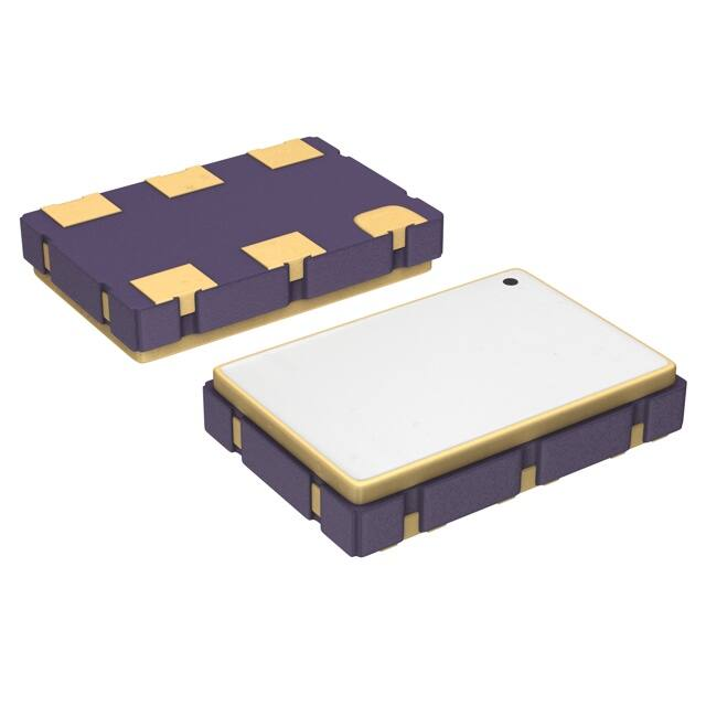

XL Family of Low Phase Noise Quartz-based PLL Oscillators Description Features The Renesas XL devices (XO and VCXO options) are ultra-precision crystal oscillators with 750 to 890fs typical phase jitter over 12kHz to 20MHz bandwidth. Available in a wide frequency range from 0.750MHz to 1350MHz, the XL series crystal oscillators utilize a family of proprietary ASICs, with a key focus on noise reduction technologies. ▪ ▪ ▪ ▪ XL Datasheet Output types: LVDS, LVPECL, LVCMOS Phase jitter (12kHz to 20MHz): 750fs to 890fs typical Supply voltage: 2.5V or 3.3V Package options: • 3.2 × 2.5 × 1.0 mm (not available for VCXO) • 5.0 × 3.2 × 1.2 mm • 7.0 × 5.0 × 1.3 mm ▪ Operating temperature: -20°C to +70°C • Frequency stability options: ±20, ±25, ±50, or ±100 ppm (XO only) The 3rd order Delta Sigma Modulator reduces noise to the levels that are comparable to traditional Bulk Quartz and SAW oscillators. With short lead-time, low cost, low noise, wide frequency range, excellent ambient performance, the XL devices are an excellent choice over the conventional technologies. The XL (XO option) devices have stabilities as tight as ±20ppm and the XL (VCXO option) devices have ±50ppm APR. Either option provides extremely quick delivery for both standard and custom frequencies. • ±50ppm APR (VCXO only) ▪ Operating temperature: -40°C to +85°C • Frequency stability options: ±25, ±50, or ±100 ppm (XO only) • ±50ppm APR (VCXO only) Pin Assignments ▪ Operating temperature: -40°C to +105°C (XO only) (XO Option) • Frequency stability options: ±50 or ±100 ppm ▪ kV of 85ppm/volt typical from 0.5VDC to VDD (VCXO only) OUT2 OUT 5 4 1 2 3 NC / E/D • Better than ±10% linearity for Vc range GND VDD 6 E/D / NC NOTE: To minimize power supply line noise, a 0.01μF bypass capacitor should be placed between VDD (Pin 6) and GND (Pin 3). (VCXO Option) VDD OUT2 OUT 6 5 4 1 2 3 Vc E/D GND NOTE: To minimize power supply line noise, a 0.01μF bypass capacitor should be placed between VDD (Pin 6) and GND (Pin 3). ©2021 Renesas Electronics Corporation 1 August 18, 2021 XL Datasheet Pin Descriptions Table 1. XO Pin Description Table 2. VCXO Pin Description Number Name Description Number Name Description 1 E/D NC Enable/Disable [a][b] No connect 1 Vc Voltage control 2 E/D Enable/Disable [a][b] 2 NC E/D No connect Enable/Disable [a][b] 3 GND Connect to ground 3 GND Connect to ground 4 OUT Output 4 OUT Output 5 OUT2 Complementary output (NC LVCMOS) 5 OUT2 Complementary output [c] 6 VDD Supply voltage 6 VDD Supply voltage [a] Pulled high internally. [b] Low = output disabled. See Ordering Information (VCXO) for more details. [a] Pulled high internally. [b] Low = output disabled. [c] Do not connect for LVCMOS. For XLVCMOS, both OUT and OUT2 are ON and in opposite phase. See Ordering Information (XO) for more details. ©2021 Renesas Electronics Corporation 2 August 18, 2021 XL Datasheet Ordering Information (XO) XL L 5 3 5 125.000000 I Family and ASIC Output Type Package Voltage Precision Frequency Temperature Range  2:  2.5 VDC ±5%  3: 3.3 VDC ±5%   I: Industrial range: ‐ 40 to +85 °C  K: Extended industrial range : ‐40 to +105 °C  X: Extended commercial range : ‐20 to +70 °C  3: 3.2 x 2.5 mm  5: 5.0 x 3.2 mm  7: 7.0 x 5.0 mm 125.000000  listed in MHz as example 3 digits before decimal and   6 digits after decimal  H: LVCMOS Enable/Disable Pin 1     J: LVCMOS Enable/Disable Pin 2  L: LVDS Enable/Disable Pin 1  M:  LVDS Enable/Disable Pin 2  P:  LVPECL Enable/Disable Pin 1  Q: LVPECL Enable/Disable Pin 2  X: XLVCMOS Comp HCMOS Enable/Disable Pin 1*  Y: XLVCMOS Comp HCMOS Enable/Disable Pin 2* 000.750000  to 000.999999  75kHz to 999.999kHz 001.000000  to 009.999999  1MHz to 9.999999MHz 010.000000  to 099.999999  10MHz to 99.999999MHz 100.000000  to 999.999999  100MHz to 999.999999MHz A00.000000  to A99.999999  1000MHz to 1099.999MHz B00.000000  to B99.999999  1100MHz to 1199.999MHz C00.000000  to C99.999999  1200MHz to 1299.999MHz D00.000000  to D50.000000  1300MHz to 1350MHz * XLVCMOS: Complimentary HCMOS where both  outputs are ON and in opposite phase.   0: ±100ppm**   5: ±50ppm**   6: ±25ppm   8: ±20ppm*  XL:  1,000 fs jitter * ±20ppm for X (‐20° to +70°C) only. ** ±100ppm and ±50ppm for K (‐40°C to +105°C) only. Ordering Information (VCXO) XL L 5 3 Family a nd AS IC Output Type Packag e Volta ge V 125.000000 I Frequency Temperature Ra nge  2: 2.5 VDC ±5%  3: 3.3 VDC ±5%   5: 5.0 x 3.2 mm  7: 7.0 x 5.0 mm  H: LVCMOS Enable/Disable  L: LVDS  Enable/Disa ble  P: LVPECL Enable/Disa ble  I: Industrial range: ‐ 40 to +85 °C  X: Extended commercial range : ‐20 to +70 °C 125.000000  listed in MHz as example 3 digits before decimal and   6 digits af ter decima l 000.750000  to 000.999999  75kHz to 999.999kHz 001.000000  to 009.999999  1MHz to 9.999999MHz 010.000000  to 099.999999  10MHz to 99.999999MHz 100.000000  to 999.999999  100MHz to 999.999999MHz    A00.000000  to A99.999999  1000MHz to 1099.999MHz B00.000000  to B99.999999  1100MHz to 1199.999MHz C00.000000  to C99.999999  1200MHz to 1299.999MHz D00.000000  to D50.000000  1300MHz to 1350MHz  XL:  1,000 fs ji tter   V: VCXO option ©2021 Renesas Electronics Corporation 3 August 18, 2021 XL Datasheet Contents Description . . . . . . . . . . . . . . . . . . . . . . . . . . . . . . . . . . . . . . . . . . . . . . . . . . . . . . . . . . . . . . . . . . . . . . . . . . . . . . . . . . . . . . . . . . . . . . . . . . . . . . 1 Pin Assignments. . . . . . . . . . . . . . . . . . . . . . . . . . . . . . . . . . . . . . . . . . . . . . . . . . . . . . . . . . . . . . . . . . . . . . . . . . . . . . . . . . . . . . . . . . . . . . . . . . 1 (XO Option) . . . . . . . . . . . . . . . . . . . . . . . . . . . . . . . . . . . . . . . . . . . . . . . . . . . . . . . . . . . . . . . . . . . . . . . . . . . . . . . . . . . . . . . . . . . . . . . . . 1 (VCXO Option) . . . . . . . . . . . . . . . . . . . . . . . . . . . . . . . . . . . . . . . . . . . . . . . . . . . . . . . . . . . . . . . . . . . . . . . . . . . . . . . . . . . . . . . . . . . . . . 1 Features . . . . . . . . . . . . . . . . . . . . . . . . . . . . . . . . . . . . . . . . . . . . . . . . . . . . . . . . . . . . . . . . . . . . . . . . . . . . . . . . . . . . . . . . . . . . . . . . . . . . . . . . 1 Pin Descriptions . . . . . . . . . . . . . . . . . . . . . . . . . . . . . . . . . . . . . . . . . . . . . . . . . . . . . . . . . . . . . . . . . . . . . . . . . . . . . . . . . . . . . . . . . . . . . . . . . . 2 Ordering Information (XO) . . . . . . . . . . . . . . . . . . . . . . . . . . . . . . . . . . . . . . . . . . . . . . . . . . . . . . . . . . . . . . . . . . . . . . . . . . . . . . . . . . . . . . . . . . 3 Ordering Information (VCXO) . . . . . . . . . . . . . . . . . . . . . . . . . . . . . . . . . . . . . . . . . . . . . . . . . . . . . . . . . . . . . . . . . . . . . . . . . . . . . . . . . . . . . . . . 3 Absolute Maximum Ratings . . . . . . . . . . . . . . . . . . . . . . . . . . . . . . . . . . . . . . . . . . . . . . . . . . . . . . . . . . . . . . . . . . . . . . . . . . . . . . . . . . . . . . . . . 5 ESD Compliance . . . . . . . . . . . . . . . . . . . . . . . . . . . . . . . . . . . . . . . . . . . . . . . . . . . . . . . . . . . . . . . . . . . . . . . . . . . . . . . . . . . . . . . . . . . . . . . . . 5 Mechanical Testing . . . . . . . . . . . . . . . . . . . . . . . . . . . . . . . . . . . . . . . . . . . . . . . . . . . . . . . . . . . . . . . . . . . . . . . . . . . . . . . . . . . . . . . . . . . . . . . 5 Solder Reflow Profile . . . . . . . . . . . . . . . . . . . . . . . . . . . . . . . . . . . . . . . . . . . . . . . . . . . . . . . . . . . . . . . . . . . . . . . . . . . . . . . . . . . . . . . . . . . . . . 5 DC Electrical Characteristics . . . . . . . . . . . . . . . . . . . . . . . . . . . . . . . . . . . . . . . . . . . . . . . . . . . . . . . . . . . . . . . . . . . . . . . . . . . . . . . . . . . . . . . . 6 AC Electrical Characteristics . . . . . . . . . . . . . . . . . . . . . . . . . . . . . . . . . . . . . . . . . . . . . . . . . . . . . . . . . . . . . . . . . . . . . . . . . . . . . . . . . . . . . . . . 9 Output Waveforms – LVDS . . . . . . . . . . . . . . . . . . . . . . . . . . . . . . . . . . . . . . . . . . . . . . . . . . . . . . . . . . . . . . . . . . . . . . . . . . . . . . . . . . . . . . . . 12 Output Waveforms – LVPECL . . . . . . . . . . . . . . . . . . . . . . . . . . . . . . . . . . . . . . . . . . . . . . . . . . . . . . . . . . . . . . . . . . . . . . . . . . . . . . . . . . . . . . 12 Output Waveforms – LVCMOS . . . . . . . . . . . . . . . . . . . . . . . . . . . . . . . . . . . . . . . . . . . . . . . . . . . . . . . . . . . . . . . . . . . . . . . . . . . . . . . . . . . . . 13 Package Outline Drawings . . . . . . . . . . . . . . . . . . . . . . . . . . . . . . . . . . . . . . . . . . . . . . . . . . . . . . . . . . . . . . . . . . . . . . . . . . . . . . . . . . . . . . . . . 14 Marking Diagrams . . . . . . . . . . . . . . . . . . . . . . . . . . . . . . . . . . . . . . . . . . . . . . . . . . . . . . . . . . . . . . . . . . . . . . . . . . . . . . . . . . . . . . . . . . . . . . . 14 Revision History . . . . . . . . . . . . . . . . . . . . . . . . . . . . . . . . . . . . . . . . . . . . . . . . . . . . . . . . . . . . . . . . . . . . . . . . . . . . . . . . . . . . . . . . . . . . . . . . . 15 ©2021 Renesas Electronics Corporation 4 August 18, 2021 XL Datasheet Absolute Maximum Ratings Stresses above the ratings listed below can cause permanent damage to the device. These ratings, which are standard values for Renesas commercially rated parts, are stress ratings only. Functional operation of the device at these or any other conditions above those indicated in the operational sections of the specifications is not implied. Exposure to absolute maximum rating conditions for extended periods can affect product reliability. Electrical parameters are guaranteed only over the recommended operating temperature range. Table 3. Absolute Maximum Ratings Item VDD E/D OUT Storage Temperature Maximum Junction Temperature Core Current Theta JA Theta JB Rating -0.5 to +5.0V -0.5V to VDD + 0.5V -0.5V to VDD + 0.5V -55°C to 125°C 125°C 65mA maximum JU6 7.0 × 5.0 × 1.3 mm 75.9 °C/W 48.6°C/W JS6 5.0 × 3.2 × 1.2 mm 89.6 °C/W 54.3 °C/W JX6 3.2 × 2.5 × 1.0 mm 94.7 °C/W 66.8 °C/W ESD Compliance Table 4. ESD Compliance Human Body Model (HBM 1000V Machine Model (MM) 150V Mechanical Testing Table 5. Mechanical Testing Parameter Test Method Mechanical Shock Drop from 75cm to hardwood surface–3 times. Mechanical Vibration 10–55Hz, 1.5mm amplitude, 1 minute sweep; 2 hours each in 3 directions (X, Y, Z). High Temperature Burn-in Under power at 125°C for 2000 hours. He pressure: 4 ±1kgf/cm2 2 hour soak. Hermetic Seal Solder Reflow Profile tP 10 seconds Max within 5°C of 260°C peak 260°C Ramp up 3°C/s Max 225°C 180°C 120 ±20 seconds in pre-heating area 160°C 50 ±10 seconds above 225°C reflow area Ramp down not to exceed 6°C/s 25°C 400 seconds MAX from +25°C to 260°C peak ©2021 Renesas Electronics Corporation 5 August 18, 2021 XL Datasheet DC Electrical Characteristics Table 6. 3.3V IDD DC Electrical Characteristics VDD = 3.3V ±5%, TA = -20°C to +70°C; -40°C to +85°C, -40°C to +105°C. Symbol Parameter Output Type LVDS IDD Power Supply Current LVPECL[a] LVCMOS Conditions Minimum Typical Maximum 0.75MHz to 40MHz. — 32 37 40+MHz to 220MHz. — 40 47 220+MHz to 630MHz. — 49 57 630+MHz to 1350MHz. — 72 100 0.75MHz to 40MHz. — 26 31 40+MHz to 220MHz. — 38 45 220+MHz to 630MHz. — 56 64 630+MHz to 1350MHz. — 96 120 0.75MHz to 20MHz. — 27 32 20+MHz to 50MHz. — 32 35 50+MHz to 130MHz. — 43 47 130+MHz to 200MHz. — 48 55 200+MHz to 250MHz. — 48 60 Minimum Typical Maximum 0.75MHz to 20MHz. — 24 26 20+MHz to 220MHz. — 29 34 220+MHz to 630MHz. — 36 44 630+MHz to 1000MHz. — 46 65 0.75MHz to 20MHz. — 20 33 20+MHz to 220MHz. — 28 41 220+MHz to 630MHz. — 41 63 630+MHz to 1000MHz. — 56 72 0.75MHz to 20MHz. — 17 22 20+MHz to 50MHz. — 23 25 50+MHz to 100MHz. — 28 29 100+MHz to 130MHz. — 30 32 130+MHz to 160MHz. — 32 35 160+MHz to 180MHz. — 33 37 Units mA [a] Without termination resistors. Table 7. 2.5V IDD DC Electrical Characteristics VDD = 2.5V ±5%, TA = -20°C to +70°C; -40°C to +85°C, -40°C to +105°C. Symbol Parameter Output Type LVDS LVPECL[a] IDD Power Supply Current LVCMOS Conditions Units mA [a] Without termination resistors. ©2021 Renesas Electronics Corporation 6 August 18, 2021 XL Datasheet Table 8. LVDS DC Electrical Characteristics VDD = 3.3V, 2.5V ±5%, T A = -20°C to +70°C; -40°C to +85°C, -40°C to +105°C. Below are guaranteed for listed standard frequencies. Symbol Parameter Conditions Minimum Typical Maximum VDD = 3.3V ±5%. — — 0.6 VDD = 2.5V ±5%. — — 0.4 VDD = 3.3V ±5%. — — 1.3 VDD = 2.5V ±5%. — — 1.25 VOD Differential Output Voltage VOS Output Offset Voltage VIH Enable/Disable Input High Voltage (Output enabled) — 70% VDD — — VIL Enable/Disable Input Low Voltage (Output disabled) — — — 30% VDD Units V Table 9. LVPECL DC Electrical Characteristics VDD = 3.3V, 2.5V ±5%, T A = -20°C to +70°C; -40°C to +85°C, -40°C to +105°C. Below are guaranteed for listed standard frequencies. Symbol Parameter Conditions Minimum Typical Maximum VDD = 3.3V ±5%. 2.055 VDD = 2.5V ±5%. — VDD = 3.3V ±5%. 1.305 VDD = 2.5V ±5%. — 0.68 — 2.405 VOD Differential Output Voltage VOS Output Offset Voltage VIH Enable/Disable Input High Voltage (Output enabled) — 70% VDD — — VIL Enable/Disable Input Low Voltage (Output disabled) — — — 30% VDD ©2021 Renesas Electronics Corporation 7 Units 1.4 — 1.65 V August 18, 2021 XL Datasheet Table 10. LVCMOS DC Electrical Characteristics VDD = 3.3V, 2.5V ±5%, T A = -20°C to +70°C; -40°C to +85°C, -40°C to +105°C. Below are guaranteed for listed standard frequencies. Symbol Parameter Conditions VDD = 3.3V ±5%. VOH Output High Voltage VDD = 2.5V ±5%. VDD = 3.3V ±5%. VOL Output Low Voltage VDD = 2.5V ±5%. Minimum Typical Maximum 0.75MHz to 150MHz. 90% VDD — — 150+MHz to 250MHz. 80% VDD — — 0.75MHz to 160MHz. 90% VDD — — 160+MHz to 180MHz. 80% VDD — — 0.75MHz to 150MHz. — — 10% VDD 150+MHz to 250MHz. — — 20% VDD 0.75MHz to 160MHz. — — 10% VDD 160+MHz to 180MHz. — — 20% VDD VIH Enable/Disable Input High Voltage (Output enabled) — — 70% VDD — — VIL Enable/Disable Input Low Voltage (Output disabled) — — — — 30% VDD ©2021 Renesas Electronics Corporation 8 Units V August 18, 2021 XL Datasheet AC Electrical Characteristics Table 11. 3.3V AC Electrical Characteristics VDD = 3.3V ±5%, TA = -20°C to +70°C; -40°C to +85°C, -40°C to +105°C. Symbol F Parameter Output Frequency Range Frequency Stability tR Minimum Typical Maximum LVDS. 0.75 — 1350 LVPECL. 0.75 — 1350 LVCMOS. 0.75 — 250 Temperature = -20°C to +70°C. ±20 — ±100 ppm Temperature = -40°C to +85°C. ±25 — ±100 ppm Temperature = -40°C to +105°C. ±50 — ±100 ppm — — ±3 ppm Aging (10 years) TA = 25°C. — — ±10 ppm Start-up Time Output Rise Time LVDS. Differential. — 100 — LVPECL. VDD - 2.0V. — 50 — LVCMOS. To GND. — 15 — pF Output valid time after VDD meets minimum specified level. — — 10 ms LVDS. — — 400 — — 400 — — 3 — — 400 — — 400 — — 3 LVDS. 45 — 55 LVPECL. 45 — 55 FOUT < 62.5MHz. 45 — 55 FOUT > 62.5MHz. 40 — 60 — — 100 LVDS. — 3 — LVPECL. — 5.8 — — 5 — LVDS. — 1.3 — LVPECL. — 1.29 — — 0.6 — LVDS. — 5.8 — LVPECL. — 9.3 — — 10 — 20% to 80% Vpp. LVPECL. 10% to 90% VDD. LVDS. Output Fall Time 80% to 20% Vpp. LVPECL. LVCMOS. ODC Output Clock Duty Cycle 90% to 10% VDD. LVCMOS. TOE JPER Output Enable/ Disable Time Period Jitter, RMS — LVCMOS. RJ Random Jitter LVCMOS. DJ MHz TA = 25°C. LVCMOS. tF Units Aging (1st year) Output Load TST Test Condition Deterministic Jitter LVCMOS. ©2021 Renesas Electronics Corporation FOUT = 125MHz. FOUT = 125MHz. FOUT = 125MHz. 9 Ω ps ns ps ns % ns ps ps ps August 18, 2021 XL Datasheet Table 11. 3.3V AC Electrical Characteristics (Cont.) VDD = 3.3V ±5%, TA = -20°C to +70°C; -40°C to +85°C, -40°C to +105°C. Symbol TJ Parameter Total Jitter Test Condition Minimum Typical Maximum LVDS. — 23.6 — LVPECL. — 27.7 — — 19 — LVDS. — 890 — LVPECL. — 860 — — 750 — Minimum Typical Maximum LVDS. 0.75 — 1000 LVPECL. 0.75 — 1000 LVCMOS. 0.75 — 180 Temperature = -20°C to +70°C. ±20 — ±100 ppm Temperature = -40°C to +85°C. ±25 — ±100 ppm Temperature = -40°C to +105°C. ±50 — ±100 ppm LVCMOS. fJITTER Phase Jitter (12kHz–20MHz) FOUT = 125MHz. FOUT = 125MHz. LVCMOS. Units ps fs Table 12. 2.5V AC Electrical Characteristics VDD = 2.5V ±5%, TA = -20°C to +70°C; -40°C to +85°C, -40°C to +105°C. Symbol F Parameter Output Frequency Range Frequency Stability tR — — ±3 ppm Aging (10 years) TA = 25°C. — — ±10 ppm Start-up Time Output Rise Time LVDS. Differential. — 100 — LVPECL. VDD - 2.0V. — 50 — LVCMOS. To GND. — 15 — pF Output valid time after VDD meets minimum specified level. — — 10 ms LVDS. — — 400 — — 400 — — 3.5 — — 400 — — 400 — — 3 LVDS. 45 — 55 LVPECL. 45 — 55 LVCMOS. 45 — 55 — — 100 20% to 80% Vpp. LVPECL. 10% to 90% VDD. LVDS. Output Fall Time 80% to 20% Vpp. LVPECL. LVCMOS. ODC TOE MHz TA = 25°C. LVCMOS. tF Units Aging (1st year) Output Load TST Test Condition Output Clock Duty Cycle Output Enable/ Disable Time ©2021 Renesas Electronics Corporation 90% to 10% VDD. — 10 Ω ps ns ps ns % ns August 18, 2021 XL Datasheet Table 12. 2.5V AC Electrical Characteristics (Cont.) VDD = 2.5V ±5%, TA = -20°C to +70°C; -40°C to +85°C, -40°C to +105°C. Symbol JPER Parameter Period Jitter, RMS Test Condition Minimum Typical Maximum LVDS. — 4 — LVPECL. — 5.12 — — 3.3 — LVDS. — 1.4 — LVPECL. — 1.36 — — 1.3 — LVDS. — 9.2 — LVPECL. — 10 — — 6.7 — LVDS. — 29.2 — LVPECL. — 29.3 — — 25.6 — LVDS. — 1040 — LVPECL. — 1200 — — 850 — LVCMOS. RJ Random Jitter LVCMOS. DJ Deterministic Jitter LVCMOS. TJ Total Jitter LVCMOS. fJITTER Phase Jitter (12kHz–20MHz) LVCMOS. FOUT = 125MHz. FOUT = 125MHz. FOUT = 125MHz. FOUT = 125MHz. FOUT = 125MHz. Units ps ps ps ps fs Notes for all AC Electrical Characteristics tables: 1 All jitter values provided at 156.25MHz, unless noted otherwise. ©2021 Renesas Electronics Corporation 11 August 18, 2021 XL Datasheet Output Waveforms – LVDS Output Levels/Rise Time/Fall Time Measurements TF TR OUTPUT 2 50% VPP 20% to 80% VPP VOS VOD OUTPUT 1 Oscillator Symmetry Ideally, Symmetry should be 50/50 for ½ period –Other expressions are 45/55 or 55/45 VOH OUTPUT 2 50% VPP OUTPUT 1 VOL ½ Period Period Output Waveforms – LVPECL Rise Time/Fall Time Measurements TF TR VOH OUTPUT 2 20% to 80% VPP OUTPUT 1 VOL Oscillator Symmetry VOH OUTPUT 2 50% VPP OUTPUT 1 VOL ½ Period Period ©2021 Renesas Electronics Corporation 12 August 18, 2021 XL Datasheet Output Waveforms – LVCMOS ©2021 Renesas Electronics Corporation 13 August 18, 2021 XL Datasheet Package Outline Drawings The package outline drawings (JS6, JX6, JU6) are appended at the end of this document. The package information is the most current data available. Marking Diagrams JX6 3.2 × 2.5 mm Package Option (example based on XLH320010.000000I) ▪ Line 1: • “010” denotes last three digits to the left of the decimal point as shown in the above example. This number will vary depending upon the frequency value selected in the orderable part number. • “YW” denotes the last digit of the year and work week the part was assembled. JS6 5.0 × 3.2 mm Package Option (example based on XLH536210.380000I) ▪ Line 1: • “XL” = family; “H” = output type; “5” = package size; “3” = voltage; “6” = precision level. This number will vary depending upon the output type, voltage, and precision values selected in the orderable part number. ▪ Line 2: • “210” denotes last three digits to the left of the decimal point as shown in the above example. This number will vary depending upon the frequency value selected in the orderable part number. • “YW” denotes the last digit of the year and work week the part was assembled. JU6 7.0 × 5.0 mm Package Option (example based on XLH735004.915200X) ▪ Line 1: • “XL” = family; “H” = output type; “7” = package size; “3” = voltage; “5” = precision level. This number will vary depending upon the output type, voltage, and precision values selected in the orderable part number. ▪ Line 2: • “004” denotes last three digits to the left of the decimal point as shown in the above example. This number will vary depending upon the frequency value selected in the orderable part number. • “YW” denotes the last digit of the year and work week the part was assembled. ©2021 Renesas Electronics Corporation 14 August 18, 2021 XL Datasheet Revision History Revision Date Description of Change August 18, 2021 Moved XO and VCXO ordering information tables to be just after Pin Descriptions. January 19, 2021 ▪ Removed 4-pin package description table, figure, and package drawing references. ▪ Added footnote for pin 5 in Table 1. ▪ Added footnote under “Output Type” in XO Ordering Information. January 12, 2021 Added Marking Diagrams section and updated Package Outline Drawings links. October 27, 2020 Added pin counts to Output Type in XO ordering table. September 21, 2020 Added typical IDD to tables. Added more frequency ranges to IDD tables. Updated H to be LVCMOS in order code. April 27, 2020 Updated ODC parameter. 2nd LVCMOS row to be changed from 62.5 MHz. September 7, 2018 Updated frequency stability options value from ±20ppm to ±25ppm for -40°C to +85°C XO only. June 25, 2018 ▪ Updated Package Outline Drawings section. May 4, 2018 ▪ ▪ ▪ ▪ January 12, 2018 Initial release. Added XO and VCXO options. Updated description and Features sections. Updated Package Outline Drawings section. Added VCXO Ordering Information decoder diagram. ©2021 Renesas Electronics Corporation 15 August 18, 2021 IMPORTANT NOTICE AND DISCLAIMER RENESAS ELECTRONICS CORPORATION AND ITS SUBSIDIARIES (“RENESAS”) PROVIDES TECHNICAL SPECIFICATIONS AND RELIABILITY DATA (INCLUDING DATASHEETS), DESIGN RESOURCES (INCLUDING REFERENCE DESIGNS), APPLICATION OR OTHER DESIGN ADVICE, WEB TOOLS, SAFETY INFORMATION, AND OTHER RESOURCES “AS IS” AND WITH ALL FAULTS, AND DISCLAIMS ALL WARRANTIES, EXPRESS OR IMPLIED, INCLUDING, WITHOUT LIMITATION, ANY IMPLIED WARRANTIES OF MERCHANTABILITY, FITNESS FOR A PARTICULAR PURPOSE, OR NON-INFRINGEMENT OF THIRD PARTY INTELLECTUAL PROPERTY RIGHTS. These resources are intended for developers skilled in the art designing with Renesas products. You are solely responsible for (1) selecting the appropriate products for your application, (2) designing, validating, and testing your application, and (3) ensuring your application meets applicable standards, and any other safety, security, or other requirements. These resources are subject to change without notice. Renesas grants you permission to use these resources only for development of an application that uses Renesas products. Other reproduction or use of these resources is strictly prohibited. No license is granted to any other Renesas intellectual property or to any third party intellectual property. Renesas disclaims responsibility for, and you will fully indemnify Renesas and its representatives against, any claims, damages, costs, losses, or liabilities arising out of your use of these resources. Renesas' products are provided only subject to Renesas' Terms and Conditions of Sale or other applicable terms agreed to in writing. No use of any Renesas resources expands or otherwise alters any applicable warranties or warranty disclaimers for these products. (Rev.1.0 Mar 2020) Corporate Headquarters Contact Information TOYOSU FORESIA, 3-2-24 Toyosu, Koto-ku, Tokyo 135-0061, Japan www.renesas.com For further information on a product, technology, the most up-to-date version of a document, or your nearest sales office, please visit: www.renesas.com/contact/ Trademarks Renesas and the Renesas logo are trademarks of Renesas Electronics Corporation. All trademarks and registered trademarks are the property of their respective owners. © 2020 Renesas Electronics Corporation. All rights reserved.

物料型号:文档中没有明确列出单一的物料型号,但提到了XL系列的多个型号,例如XLH320010.000000I、XLH536210.380000I和XLH735004.915200X等。
器件简介:Renesas XL系列是超精密晶体振荡器,具有750至890fs的典型相位抖动,频率范围从0.750MHz到1350MHz。这些振荡器使用专有的ASICs,专注于降低噪声技术。
引脚分配:文档提供了XO和VCXO两种选项的引脚分配表,包括E/D(使能/禁用)、GND(地)、OUT(输出)、OUT2(互补输出)、VDD(供电电压)等。
参数特性:包括输出类型(LVDS, LVPECL, LVCMOS)、相位抖动(12kHz至20MHz时为750fs至890fs典型值)、供电电压(2.5V或3.3V)、封装选项、工作温度范围、频率稳定性选项等。
功能详解:文档提到了3rd order Delta Sigma Modulator,它可以将噪声降低到与传统的Bulk Quartz和SAW振荡器相当的水平。
应用信息:XL设备以其短的交货时间、低成本、低噪声、宽频率范围和出色的环境性能,是传统技术的一个很好的替代选择。
封装信息:文档提供了不同封装选项的尺寸信息,例如3.2 × 2.5 × 1.0 mm、5.0 × 3.2 × 1.2 mm和7.0 × 5.0 × 1.3 mm。
