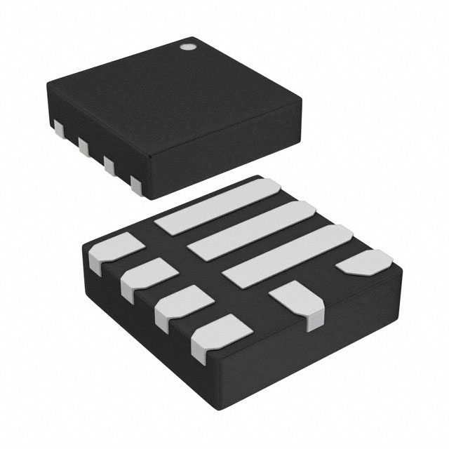

Default Marking & Package Type
RT4813GQUF, UQFN-9L 2x2 (FC)
