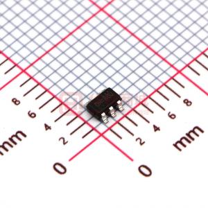

RT9193 300mA, Ultra-Low Noise, Ultra-Fast CMOS LDO Regulator General Description The RT9193 is designed for portable RF and wireless applications with demanding performance and space requirements. The RT9193 performance is optimized for battery-powered systems to deliver ultra low noise and low quiescent current. A noise bypass pin is available for further reduction of output noise. Regulator ground current increases only slightly in dropout, further prolonging the battery life. The RT9193 also works with low-ESR ceramic capacitors, reducing the amount of board space necessary for power applications, critical in hand-held wireless devices. The RT9193 consumes less than 0.01uA in shutdown mode and has fast turn-on time less than 50us. The other features include ultra low dropout voltage, high output accuracy, current limiting protection, and high ripple rejection ratio. Available in the SC-70-5, SOT-23-5, TSOT-23-5, WDFN-6L 2x2 and MSOP-8 packages. Features Ultra-Low-Noise for RF Application Ultra-Fast Response in Line/Load Transient Quick Start-Up (Typically 50us) < 0.01uA Standby Current When Shutdown Low Dropout : 220mV @ 300mA Wide Operating Voltage Ranges : 2.5V to 5.5V TTL-Logic-Controlled Shutdown Input Low Temperature Coefficient Current Limiting Protection Thermal Shutdown Protection Only 1uF Output Capacitor Required for Stability High Power Supply Rejection Ratio Custom Voltage Available RoHS Compliant and 100% Lead (Pb)-Free Applications CDMA/GSM Cellular Handsets Battery-Powered Equipment Laptop, Palmtops, Notebook Computers Hand-Held Instruments PCMCIA Cards Portable Information Appliances Ordering Information RT9193Package Type U5 : SC-70-5 B : SOT-23-5 J5 : TSOT-23-5 QW : WDFN-6L 2x2 (W-Type) F : MSOP-8 Marking Information Operating Temperature Range P : Pb Free with Commercial Standard For marking information, contact our sales representative G : Green (Halogen Free with Commer- directly or through a Richtek distributor located in your cial Standard) area, otherwise visit our website for detail. Output Voltage 15 : 1.5V 16 : 1.6V : 49 : 4.9V 50 : 5.0V 1H : 1.85V 2H : 2.85V 4G : 4.75V Note : Richtek Pb-free and Green products are : RoHS compliant and compatible with the current requirements of IPC/JEDEC J-STD-020. Suitable for use in SnPb or Pb-free soldering processes. 100% matte tin (Sn) plating. DS9193-11 May 2008 www.richtek.com 1 Typical Application Circuit RT9193 VIN CIN VIN GND EN BP CBP 22nF VOUT COUT VOUT 1uF/X7R Chip Enable 1uF/X7R RT9193 Pin Configurations (TOP VIEW) VIN GND EN 1 2 3 4 BP 5 VOUT EN GND VIN 1 2 3 7 6 5 4 BP NC VOUT NC VIN NC VOUT 8 2 3 4 7 6 5 NC EN BP GND WDFN-6L 2x2 SC-70-5/SOT-23-5/TSOT-23-5 MSOP-8 Functional Pin Description Pin Name EN BP GND VOUT VIN Pin Function Chip Enable (Active High). Note that this pin is high impedance. There should be a pull low 100kΩ resistor connected to GND when the control signal is floating. Reference Noise Bypass. Ground . Output Voltage. Power Input Voltage. Function Block Diagram EN Quick Start BP VREF + Error Amplifier Shutdown and Logic Control VIN MOS Driver VOUT Current-Limit and Thermal Protection GND www.richtek.com 2 DS9193-11 May 2008 RT9193 Absolute Maximum Ratings (Note 1) 6V 300mW 400mW 606mW 625mW 333°C/W 250°C/W 165°C/W 160°C/W 150°C 260°C −65°C to 150°C 2kV 200V Supply Input Voltage -----------------------------------------------------------------------------------------------------Power Dissipation, PD @ TA = 25°C SC-70-5 ---------------------------------------------------------------------------------------------------------------------TSOT-23-5/SOT-23-5 -----------------------------------------------------------------------------------------------------WDFN-6L 2x2 -------------------------------------------------------------------------------------------------------------MSOP-8 --------------------------------------------------------------------------------------------------------------------Package Thermal Resistance (Note 4) SOT-70-5, θJA --------------------------------------------------------------------------------------------------------------TSOT-23-5/SOT-23-5, θJA -----------------------------------------------------------------------------------------------WDFN-6L 2x2, θJA --------------------------------------------------------------------------------------------------------MSOP-8 θJA ---------------------------------------------------------------------------------------------------------------Junction Temperature ----------------------------------------------------------------------------------------------------Lead Temperature (Soldering, 10 sec.) ------------------------------------------------------------------------------Storage Temperature Range -------------------------------------------------------------------------------------------ESD Susceptibility (Note 2) HBM (Human Body Mode) ---------------------------------------------------------------------------------------------MM (Machine Mode) ------------------------------------------------------------------------------------------------------ Recommended Operating Conditions (Note 3) 2.5V to 5.5V 0V to 5.5V −40°C to 125°C −40°C to 85°C Supply Input Voltage -----------------------------------------------------------------------------------------------------EN Input Voltage ----------------------------------------------------------------------------------------------------------Junction Temperature Range -------------------------------------------------------------------------------------------Ambient Temperature Range -------------------------------------------------------------------------------------------- Electrical Characteristics Parameter O utput Voltage Accuracy Current Limit Q uiescent Current Dropout Voltage Line Regulation Load Regulation Standby Current EN Input Bias Current EN Threshold (Note 5) (VIN = VOUT + 1V, CIN = COUT = 1μF, CBP = 22nF, TA = 25°C, unless otherwise specified) Symbol ΔVOUT ILIM IQ VDROP ΔVLINE Test Conditions IO UT = 1 mA RL OAD = 1Ω V EN Min −2 360 -- Typ -400 90 170 Max +2 -130 200 300 0.3 0.6 1 100 0.4 --- Units % mA μA mV % % μA nA V μ VR MS ≥ 1.2V, I OUT = 0mA IO UT = 2 00mA, VOUT > 2.8V IO UT = 3 00mA, VOUT > 2.8V V IN = (VOUT + 1V) to 5.5V, IO UT = 1 mA V EN = G ND, Shutdown V EN = G ND or VIN V IN = 3V to 5.5V, Shutdown V IN = 3V to 5.5V, Start-Up 1 0Hz to 100kHz, IOUT = 2 00mA CO UT = 1 μF ------1.2 -- 220 --0.01 0 --100 ΔVLOAD 1 mA < IOUT < 300mA ISTBY IIBSD VIL Logic-Low Voltage L ogic-High Voltage VIH eNO O utput Noise Voltage To be continued DS9193-11 May 2008 www.richtek.com 3 RT9193 Parameter Power Supply Rejection Rate f = 100Hz f = 10kHz Symbol PSRR TSD Δ TSD Test Conditions C OUT = 1μF, IOUT = 1 0mA Min ----Typ −70 −50 165 30 Max ----Units dB °C °C Thermal Shutdown Temperature Thermal Shutdown Temperature Note 1. Stresses listed as the above "Absolute Maximum Ratings" may cause permanent damage to the device. These are for stress ratings. Functional operation of the device at these or any other conditions beyond those indicated in the operational sections of the specifications is not implied. Exposure to absolute maximum rating conditions for extended periods may remain possibility to affect device reliability. Note 2. Devices are ESD sensitive. Handling precaution is recommended. Note 3. The device is not guaranteed to function outside its operating conditions. Note 4. θ JA i s measured in the natural convection at T A = 2 5 ° C on a low effective thermal conductivity test board (Single Layer, 1S) of JEDEC 51-3 thermal measurement standard. Note 5. The dropout voltage is defined as VIN - VOUT, which is measured when VOUT is VOUT(NORMAL) − 100mV. www.richtek.com 4 DS9193-11 May 2008 RT9193 Typical Operating Characteristics Output Voltage vs. Temperature 1.8 1.7 Quiescent Current vs. Temperature 95 90 Quiescent Current (uA) 50 75 100 125 RT9193-15xU5 VIN = 3.3V CIN = COUT = 1uF X7R RT9193-15xU5 VIN = 3.3V CIN = COUT = 1uF X7R Output Voltage (V) 1.6 1.5 1.4 1.3 1.2 -50 -25 0 25 85 80 75 70 65 60 -50 -25 0 25 50 75 100 125 Temperature (°C) Temperature (°C) Dropout Voltage vs. Load Current 300 250 200 RT9193-33xB CIN = COUT = 1uF TJ = 125°C 20 PSRR VIN = 4V to 5V CIN = COUT = 1uF, X7R Dropout Voltage (mV) 0 PSRR (dB) TJ = 25°C 150 100 50 0 0 0.05 0.1 0.15 0.2 0.25 0.3 -20 TJ = -40°C -40 -60 ILoad = 100mA ILoad = 10mA -80 10 0.01 100 0.1 1K 1 10K 10 100K 100 1M 1000 Load Current (A) Frequency (kHz) (Hz) EN Pin Shoutdown Threshold vs. Temperature 1.75 EN Pin Shutdown Response EN Pin Voltage (V) 10 5 0 VIN = 5V CIN = COUT = 1uF RT9193-28xU5 No Load EN Pin Shoutdown Threshold (V) 1.5 RT9193-15xU5 VIN = 3.3V CIN = COUT = 1uF X7R 1.25 1 Output Voltage (V) -50 -25 0 25 50 75 100 125 2 1 0 0.75 0.5 Temperature (°C) Time (500μs/Div) DS9193-11 May 2008 www.richtek.com 5 RT9193 Load Transient Response Load Current (mA) Load Current (mA) VIN = 5V, VOUT = 2.8V 100 CIN = COUT = 1uF 50 0 ILoad = 1mA to 60mA Load Transient Response VIN = 5V, VOUT = 2.8V 400 CIN = COUT = 1uF 200 0 ILoad = 1mA to 250mA Output Voltage Deviation (mV) 20 0 -20 Output Voltage Deviation (mV) 50 0 -50 Time (500μs/Div) Time (500μs/Div) Line Transient Response Input Voltage Deviation (V) 6 5 4 Line Transient Response Input Voltage Deviation (V) 6 5 4 VIN = 4V to 5V COUT = 1uF RT9193-25xB ILoad = 100mA VIN = 4V to 5V COUT = 1uF RT9193-25xB ILoad = 1mA Output Voltage Deviation (mV) 10 0 -10 Output Voltage Deviation (mV) 10 0 -10 Time (50μs/Div) Time (100μs/Div) Noise VIN = 4.5V CIN = COUT = 1uF, X7R 200 RT9193-30xB ILoad = 50mA 200 Noise VIN = 4.5V CIN = COUT = 1uF, X7R RT9193-15xU5 ILoad = 50mA Noise (μV) 0 -100 -200 Noise (μV) f = 10Hz to 100kHz 100 100 0 -100 -200 f = 10Hz to 100kHz Time (10ms/Div) Time (10ms/Div) www.richtek.com 6 DS9193-11 May 2008 RT9193 Start Up EN Pin Voltage (V) 10 5 0 VIN = 5V CIN = COUT = 1uF RT9193-28xU5 No Load Output Voltage (V) 2 1 0 Time (10μs/Div) DS9193-11 May 2008 www.richtek.com 7 RT9193 Applications Information Like any low-dropout regulator, the external capacitors used with the RT9193 must be carefully selected for regulator stability and performance. Using a capacitor whose value is > 1μF on the RT9193 input and the amount of capacitance can be increased without limit. The input capacitor must be located a distance of not more than 0.5 inch from the input pin of the IC and returned to a clean analog ground. Any good quality ceramic or tantalum can be used for this capacitor. The capacitor with larger value and lower ESR (equivalent series resistance) provides better PSRR and line-transient response. The output capacitor must meet both requirements for minimum amount of capacitance and ESR in all LDOs application. The RT9193 is designed specifically to work with low ESR ceramic output capacitor in space-saving and performance consideration. Using a ceramic capacitor whose value is at least 1μF with ESR is > 25mΩ on the RT9193 output ensures stability. The RT9193 still works well with output capacitor of other types due to the wide stable ESR range. Figure 1 shows the curves of allowable ESR range as a function of load current for various output capacitor values. Output capacitor of larger capacitance can reduce noise and improve load transient response, stability, and PSRR. The output capacitor should be located not more than 0.5 inch from the VOUT pin of the RT9193 and returned to a clean analog ground. Bypass Capacitor and Low Noise Connecting a 22nF between the BP pin and GND pin significantly reduces noise on the regulator output, it is critical that the capacitor connection between the BP pin and GND pin be direct and PCB traces should be as short as possible. There is a relationship between the bypass capacitor value and the LDO regulator turn on time. DC leakage on this pin can affect the LDO regulator output noise and voltage regulation performance. Enable Function The RT9193 features an LDO regulator enable/disable function. To assure the LDO regulator will switch on, the EN turn on control level must be greater than 1.2 volts. The LDO regulator will go into the shutdown mode when the voltage on the EN pin falls below 0.4 volts. For to protecting the system, the RT9193 have a quick-discharge function. If the enable function is not needed in a specific application, it may be tied to VIN to keep the LDO regulator in a continuously on state. Thermal Considerations Thermal protection limits power dissipation in RT9193. When the operation junction temperature exceeds 165°C, the OTP circuit starts the thermal shutdown function turn the pass element off. The pass element turn on again after the junction temperature cools by 30°C. For continue operation, do not exceed absolute maximum operation junction temperature 125 ° C. The power dissipation definition in device is : PD = (VIN−VOUT) x IOUT + VIN x IQ The maximum power dissipation depends on the thermal resistance of IC package, PCB layout, the rate of surroundings airflow and temperature difference between junction to ambient. The maximum power dissipation can be calculated by following formula : RT9193-15xU5 CIN = COUT = 1uF, X7R 150 200 250 300 Region of Stable COUT ESR vs. Load Current 100.00 100 Instable 10.00 10 C OUT ESR (Ω) 1 1.00 Stable 0.10 0.01 PD(MAX) = ( TJ(MAX) − TA ) /θJA Where T J(MAX) i s the maximum operation junction temperature 125°C, TA is the ambient temperature and the θJA is the junction to ambient thermal resistance. Simulation Verify 0.00 0 50 100 Load Current (mA) Figure 1 www.richtek.com 8 DS9193-11 May 2008 RT9193 For recommended operating conditions specification of RT9193, where T J(MAX) i s the maximum junction temperature of the die (125°C) and TA is the maximum ambient temperature. The junction to ambient thermal resistance (θJA is layout dependent) for TSOT-23-5/ SOT-23-5 package is 250°C/W, SC-70-5 package is 333°C/ W, WDFN-6L 2x2 package is 165°C/W and MSOP-8 package is 160°C/W on standard JEDEC 51-3 thermal test board. The maximum power dissipation at TA = 25°C can be calculated by following formula : PD(MAX) = (125°C−25°C) / 333 = 300mW for SC-70-5 PD(MAX) = (125°C−25°C) / 250 = 400mW for TSOT-23-5/ SOT-23-5 PD(MAX) = (125°C−25°C) / 165 = 606mW for WDFN-6L 2x2 PD(MAX) = (125°C−25°C) / 160 = 625mW for MSOP-8 The maximum power dissipation depends on operating ambient temperature for fixed T J(MAX) and thermal resistance θJA. For RT9193 packages, the Figure 2 of derating curves allows the designer to see the effect of rising ambient temperature on the maximum power allowed. 700 600 MSOP-8 WDFN-6L 2x2 Power Dissipation (mW) 500 400 300 200 100 0 0 TSOT-23-5/ SOT-23-5 SC 70-5 25 50 75 100 125 Ambient Temperature (°C) Figure 2. Derating Curve for Packages DS9193-11 May 2008 www.richtek.com 9 RT9193 Outline Dimension H D L C B b A A1 e Symbol A A1 B b C D e H L Dimensions In Millimeters Min 0.800 0.000 1.150 0.150 1.800 1.800 0.650 0.080 0.210 0.260 0.460 Max 1.100 0.100 1.350 0.400 2.450 2.250 Dimensions In Inches Min 0.031 0.000 0.045 0.006 0.071 0.071 0.026 0.003 0.008 0.010 0.018 Max 0.044 0.004 0.054 0.016 0.096 0.089 SC-70-5 Surface Mount Package www.richtek.com 10 DS9193-11 May 2008 RT9193 H D L C B b A A1 e Symbol A A1 B b C D e H L Dimensions In Millimeters Min 0.700 0.000 1.397 0.300 2.591 2.692 0.838 0.080 0.300 Max 1.000 0.100 1.803 0.559 3.000 3.099 1.041 0.254 0.610 Dimensions In Inches Min 0.028 0.000 0.055 0.012 0.102 0.106 0.033 0.003 0.012 Max 0.039 0.004 0.071 0.022 0.118 0.122 0.041 0.010 0.024 TSOT-23-5 Surface Mount Package DS9193-11 May 2008 www.richtek.com 11 RT9193 H D L C B b A A1 e Symbol A A1 B b C D e H L Dimensions In Millimeters Min 0.889 0.000 1.397 0.356 2.591 2.692 0.838 0.080 0.300 Max 1.295 0.152 1.803 0.559 2.997 3.099 1.041 0.254 0.610 Dimensions In Inches Min 0.035 0.000 0.055 0.014 0.102 0.106 0.033 0.003 0.012 Max 0.051 0.006 0.071 0.022 0.118 0.122 0.041 0.010 0.024 SOT-23-5 Surface Mount Package www.richtek.com 12 DS9193-11 May 2008 RT9193 D D2 L E E2 SEE DETAIL A 1 e A A1 A3 b 2 1 2 1 DETAIL A Pin #1 ID and Tie Bar Mark Options Note : The configuration of the Pin #1 identifier is optional, but must be located within the zone indicated. Symbol A A1 A3 b D D2 E E2 e L Dimensions In Millimeters Min 0.700 0.000 0.175 0.200 1.950 1.000 1.950 0.500 0.650 0.300 0.400 Max 0.800 0.050 0.250 0.350 2.050 1.450 2.050 0.850 Dimensions In Inches Min 0.028 0.000 0.007 0.008 0.077 0.039 0.077 0.020 0.026 0.012 0.016 Max 0.031 0.002 0.010 0.014 0.081 0.057 0.081 0.033 W-Type 6L DFN 2x2 Package DS9193-11 May 2008 www.richtek.com 13 RT9193 D L E E1 e A A1 b A2 Symbol A A1 A2 b D e E E1 L Dimensions In Millimeters Min 0.810 0.000 0.750 0.220 2.900 0.650 4.800 2.900 0.400 5.000 3.100 0.800 Max 1.100 0.150 0.950 0.380 3.100 Dimensions In Inches Min 0.032 0.000 0.030 0.009 0.114 0.026 0.189 0.114 0.016 0.197 0.122 0.031 Max 0.043 0.006 0.037 0.015 0.122 8-Lead MSOP Plastic Package Richtek Technology Corporation Headquarter 5F, No. 20, Taiyuen Street, Chupei City Hsinchu, Taiwan, R.O.C. Tel: (8863)5526789 Fax: (8863)5526611 Richtek Technology Corporation Taipei Office (Marketing) 8F, No. 137, Lane 235, Paochiao Road, Hsintien City Taipei County, Taiwan, R.O.C. Tel: (8862)89191466 Fax: (8862)89191465 Email: marketing@richtek.com www.richtek.com 14 DS9193-11 May 2008

1. 物料型号: - 型号为RT9193,由Richtek公司生产。
2. 器件简介: - RT9193是一款300mA超低噪声、超快速CMOS LDO调节器,适用于对性能和空间有严格要求的便携式RF和无线应用。它针对电池供电系统进行了优化,能够提供超低噪声和低静态电流。该芯片还具备噪声旁路引脚以进一步降低输出噪声,并且在 dropout 时调节器地电流仅略有增加,有助于延长电池寿命。RT9193能够与低ESR陶瓷电容器一起工作,减少了电源应用所需的板空间,这在手持无线设备中至关重要。此外,RT9193在关闭模式下消耗小于0.01uA的电流,并且开启时间少于50us。其他特性包括超低dropout电压、高输出精度、电流限制保护和高纹波抑制比。
3. 引脚分配: - EN:芯片使能(Active High)。当控制信号浮动时,该引脚应连接一个下拉100k电阻至地。 - BP:参考噪声旁路。 - GND:地。 - VOUT:输出电压。 - VIN:电源输入电压。
4. 参数特性: - 输出电压精度:-2% 至 +2%。 - 电流限制:360mA至400mA。 - 关闭模式下的静态电流:90至130nA。 - Dropout电压:在200mA负载下为170至200mV,在300mA负载下为220至300mV。 - 线路调整率:0.3%。 - 负载调整率:0.6%。 - 待机电流:0.01至1uA。 - EN输入偏置电流:0至100nA。 - 输出噪声电压:100μVRMS(在10Hz至100kHz下)。
5. 功能详解: - RT9193具有超低噪声、快速响应、快速启动(典型值为50us)、低静态电流、低dropout电压、宽工作电压范围、TTL逻辑控制关闭输入、低温度系数电流限制保护、热保护、仅需1uF输出电容器即可稳定工作、高电源抑制比等特点。
6. 应用信息: - 适用于CDMA/GSM手机、电池供电设备、笔记本电脑、掌上电脑、手持仪器、PCMCIA卡、便携式信息设备等。
