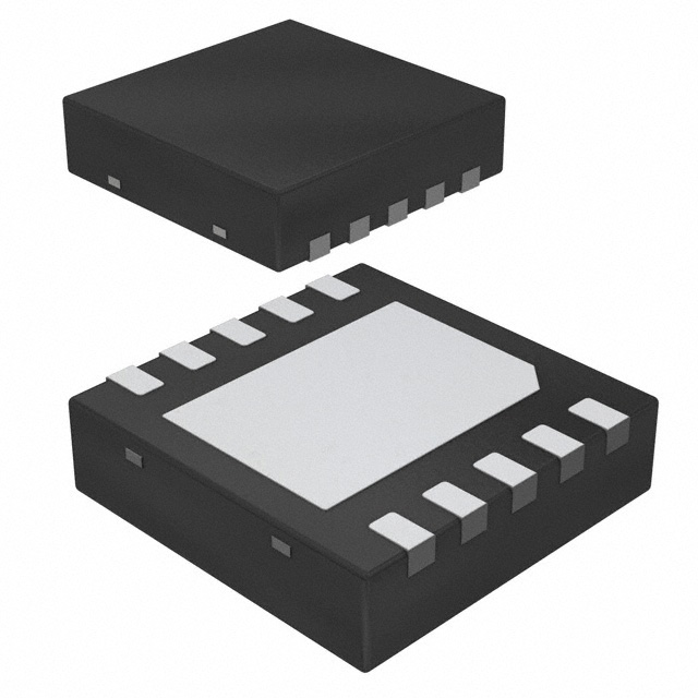

    RT9278 是一款紧凑、高效的同步升压转换器,适用于由两节、三节碱性/NiMH 或一节锂离子/聚合物电池供电的产品。它提供高达95%的效率,并集成了线性控制器。最大峰值电流限制为2A,输入电压范围为...
RT9278GQV 数据手册
Preliminary RT9278 High Efficiency Boost LDO Converter & High Power White LED Driver General Description The RT9278 is a compact, high efficiency, synchronous step-up converter, it provides a power supply solution for products powered by either two-cell, three-cell Alkaline/ NiMH or one-cell Li-Ion/Li-polymer battery. The RT9278 is boost converter with PWM control loop, provide up to 95% efficiency by using a synchronous rectifier. The maximum peak current in the internal switch is limited to up to 2A. It keeps the output voltage regulated when the input voltage exceeds the setting output voltage. The output voltage can be set by an external resister divider, or be fixed to reduce external components. It integrates a linear controller for linear regulator. RT9278 is available in VDFN-10L 3x3 package. Features l l l l l l l l l l l l l 95% Efficiency Synchronous Boost Converter High Supply Capability 2A Current Limit Input Voltage Range : 1.5V to 5.5V 600kHz Fixed Switching Rate Adjustable Output Voltage Options Up to 5.5V Output Voltage Keep Regulated when Input Voltage Exceed Setting Output Voltage 1µA Supply Current in Shutdown Mode External Compensation Network Build in Linear Controller for Linear Regulator Over Temperature Protection Small 10-Lead VDFN Package RoHS Compliant and 100% Lead (Pb)-Free Applications Ordering Information RT9278 Package Type QV : VDFN-10L 3x3 (V-Type) Operating Temperature Range P : Pb Free with Commercial Standard G : Green (Halogen Free with Commercial Standard) Note : Richtek Pb-free and Green products are : }RoHS compliant and compatible with the current requirements of IPC/JEDEC J-STD-020. }Suitable for use in SnPb or Pb-free soldering processes. }100% matte tin (Sn) plating. FB COMP GND EN LX 1 2 3 4 5 11 10 9 l l l l Digital Still Camera Camera White LED Flash Light PDAs Portable Device Pin Configurations (TOP VIEW) LFB LDRI PGND VDD VOUT GND 8 7 9 VDFN-10L 3x3 Marking Information For marking information, contact our sales representative directly or through a Richtek distributor located in your area, otherwise visit our website for detail. DS9278-04 August 2007 www.richtek.com 1 RT9278 Typical Application Circuit Chip Enable L1 1 to 10uH VIN C1 4.7uF R1 2.2k C2 12nF Chip Shutdown 100ms 4 EN 5 LX 8 Preliminary VDD 7 RT9278 VOUT 6 C3 1uF Q1 AO7401 C4 2.2uF 700mA 100ms D1 Power LED PGND FB 1 LDRI 9 LFB 10 2 COMP 3 GND R2 300k R3 0.28 Figure 1. Novel Up-Down Driver for Power LED with Strobe Mode Note : Patent Pending. Chip Enable 4 L1 1 to 10uH Chip Shutdown VIN C1 4.7uF R1 2.2k C2 12nF EN 5 LX 8 VDD 7 RT9278 VOUT 6 C3 1uF Istrobe Q1 AO3403 C4 2.2uF IMovie GPIO R2 300k 700mA 200mA 2.8V 100ms PGND 1 FB LDRI 9 LFB 10 2 COMP 3 GND 0V D1 Power LED R4 1k R5 18.2k GPIO R3 0.28 R4 = 1kΩ 0.2 R3 = IStrobe (GPIO_HI − 0.2) x R4 R5 = 0.2 − (IMovie x R3) Figure 2. Novel Up-Down Driver for Power LED with Strobe Mode and Movie Mode Note : l l Patent Pending. The GPIO Signal has to pull high before enable IC. Chip Enable L1 4.7uH VIN C1 10uF R1 2.5k Chip Shutdown VDD 7 EN RT9278 5 LX 6 2 COMP VOUT 8 PGND 9 10 LDRI LFB 1 3 FB GND 4 C3 1uF C4 10uF Q1 AO3403 R2 510k C5 100pF R3 470k VOUT 3.3V C2 2.2nF R4 150k Figure 3. Synchronous Boost Converter with Load Disconnect in Shutdown www.richtek.com 2 DS9278-04 August 2007 Preliminary RT9278 VIN 1.6V to 5V L1 4.7uH C1 10uF GPIO 4 EN 5 LX 8 VDD 7 RT9278 VOUT 6 C3 1uF C4 10pF Q1 AO3403 R2 732k R3 226k C5 20uF R5 620k C6 22pF C7 1uF PGND FB 1 VOUT 3.3V R1 51k C2 3.3nF 2 COMP 3 GND R4 510k LDRI 9 10 LFB R6 40.2k Figure 4. Boost-LDO Application for Constant Output Voltage VIN 1.6V to 3.0V L1 4.7uH C1 20uF GPIO 4 EN 5 LX 8 VDD 7 RT9278 VOUT 6 C3 1uF C4 10pF VOUT1 3.3V/300mA Q1 AO3403 R2 470k R3 150k C5 40uF R5 887k C6 22pF C7 30uF VOUT2 1.8V/150mA PGND FB 1 R1 3.9k C2 1.5nF 2 COMP 3 GND R4 510k LDRI 9 10 LFB R6 110k Figure 5. Synchronous Boost Converter Driver for Dual Output Voltage Chip Enable Chip Shutdown 4 EN VDD 7 RT9278 PVD CFF R2 C OUT 40uF C3 1uF VOUT L VIN C1 10uF 5 LX 9 LDRI 10 LFB RCOMP CCOMP 2 COMP 1 FB 3 GND PGND 8 R1 Figure 6. Synchronous Boost Converter DS9278-04 August 2007 www.richtek.com 3 RT9278 Input Voltage Output Voltage (V) (V) 1.5~3.0 1.5~3.3 3.0~4.5 3.3 5.0 5.0 L (µH) 2.2 2.2 2.2 Preliminary Table 1. Component Selection for Figure 6 (L=2.2µH) COUT (µF) 40 40 40 R1 (kΩ ) 150 130 130 R2 (kΩ) 470 680 680 RCOMP ( kΩ ) 43 24 24 CCOMP (nF) 5.6 8.2 3.9 C FF (pF) 18 12 12 Table 2. Component Selection for Figure 6 (L=4.7µH) Input Voltage Output Voltage (V) (V) 1.5~3.0 1.5~3.3 3.0~4.5 3.3 5.0 5.0 L (µH) 4.7 4.7 4.7 COUT (µF) 40 40 40 R1 (kΩ ) 150 130 130 R2 (kΩ) 470 680 680 RCOMP ( kΩ ) 24 24 24 CCOMP (nF) 10 15 8.2 C FF (pF) 18 12 12 Table 3. Component Selection for Figure 6 (L=6.8µH) Input Voltage Output Voltage (V) (V) 1.5~3.0 1.5~3.3 3.0~4.5 3.3 5.0 5.0 L (µH) 6.8 6.8 6.8 COUT (µF) 40 40 40 R1 (kΩ) 150 130 130 R2 (kΩ ) 470 680 680 RCOMP ( kΩ ) 24 24 24 CCOMP (nF) 15 22 12 CFF (pF) 18 12 12 Table 4. Component Selection for Figure 6 (L=10µH) Input Voltage Output Voltage (V) (V) 1.5~3.0 1.5~3.3 3.0~4.5 3.3 5.0 5.0 L (µH) 10 10 10 COUT (µF) 40 40 40 R1 (kΩ ) 150 130 130 R2 (kΩ) 470 680 680 RCOMP ( kΩ ) 24 24 24 CCOMP (nF) 22 33 18 C FF (pF) 18 12 12 www.richtek.com 4 DS9278-04 August 2007 Preliminary Functional Pin Description Pin No. 1 2 3 4 5 6 7 8 9 10 Pin Name FB COMP GND EN LX VOUT VDD PGND LDRI LFB Feedback Input Pin. Feedback Compensation Pin. Ground. Enable Input Pin Switch Node. Output Pin Device Input Power Pin. Power Ground. Linear Controller Driver Output. Linear Controller Feedback Input. Pin Function RT9278 Exposed Pad (11) GND The exposed pad must be soldered to a large PCB and connected to GND for maximum power dissipation. Function Block Diagram COMP Error AMPLIFIER VREF = 0.8V VDD GND Oscillator and Shutdown Control Slope Compensation Current Sense + Error Comparator + VOUT FB Control and Driver Logic LX EN PGND LDRI LFB VREF = 0.2V + DS9278-04 August 2007 www.richtek.com 5 RT9278 Operation Preliminary RT9278 integrates a high-efficiency step-up DC-DC converter and a linear regulator controller. The boost converter is based on a fixed frequency, pulse-width-modulation (PWM) controller using a synchronous rectifier to obtain maximum efficiency. Current mode control with external compensation network makes it easy to stabilize the system and keep maximum flexibility. The linear regulator controller can use to drive the external P-Channel MOSFET switch for load disconnection. It keeps the output voltage regulated even when the input voltage exceeds the nominal output voltage, and keeps the output voltage completely disconnected from input voltage (battery) when the chip is in shutdown mode Soft-start When the chip is enabled. Soft-start is achieved by ramping up the PWM duty from very small to normal operation. The ramping up PWM duty is achieved by sourcing 1uA from error amplifier to the compensation capacitor. When the output voltage is regulated, the PWM duty enters the normal operation, and the error amplifier can sink and source up to 22uA. The soft-start time is set by the following formula : TSS = (1V - 1µA x RCOMP ) x CCOMP 1µA RCOMP and CCOMP are compensation components. Current limit The current of NMOS is sensed cycle by cycle to prevent over current. When over current limit, then the NMOS is off. This state is latched and then reset automatically at next clock cycle. Over voltage When the chip voltage is higher than 6.5V, Switch is off. When the Over Voltage Protection is relieved, the chip operates well again. Thermal protection Thermal protection function is integrated in the chip. When the chip temperature is higher than 180°C, the controllers are shutdown. 20°C is the hysteresis range of temperature to prevent unstable operation when the thermal protection happens. When the thermal protection is relieved, the chip operates well again. www.richtek.com 6 DS9278-04 August 2007 Preliminary Absolute Maximum Ratings l l l l RT9278 (Note 1) l l l l l Supply Voltage, VDD ------------------------------------------------------------------------------------------------- 7V LX Pin Voltage -------------------------------------------------------------------------------------------------------- − 0.3V to 7V The Other pins -------------------------------------------------------------------------------------------------------- − 0.3V to 7V Power Dissipation, PD @ TA = 25°C VDFN-10L 3x3 -------------------------------------------------------------------------------------------------------- 1.43W Package Thermal Resistance (Note 4) VDFN-10L 3x3, θJA --------------------------------------------------------------------------------------------------- 70°C/W Lead Temperature (Soldering, 10 sec.)-------------------------------------------------------------------------- 260°C Operation Temperature Range ------------------------------------------------------------------------------------ −40°C to 85°C Storage Temperature Range --------------------------------------------------------------------------------------- − 65°C to 150°C ESD Susceptibility (Note 2) HBM (Human Body Mode) ----------------------------------------------------------------------------------------- 2kV Recommended Operating Conditions l l (Note 3) Ambient Temperature Range -------------------------------------------------------------------------------------- 0°C to 70°C Junction Temperature Range -------------------------------------------------------------------------------------- 0°C to 125°C Electrical Characteristics (VBAT = 1.8V, VOUT = 3.3V, TA = 25°C, unless otherwise specified) Parameter Start-Up Voltage Operating Voltage Range, After start-up VOUT Output Voltage Range VOUT Over Voltage Protection Switch-off Current I (VBAT) Shutdown Current Feedback Reference Voltage Switching Frequency Maximum Duty SWN Switch ON Resistance SWP Switch ON Resistance Current Limit Setting Error Amplifier GM Compensation Source Current Compensation Sink Current Symbol VST VBAT VOUT_ADJ ISW OFF IOFF VFB FS D(MAX) Test Conditions IL = 1mA Min -1.1 2.4 ---0.784 ------ Typ 1.5 --6.5 200 0.01 0.8 650 85 210 240 2 Max -5.5 5.5 -350 1 0.816 ------ Units V V V V µA µA V kHz % mΩ mΩ A VOUT = 3.3V, VFB = 0.9V EN Pin = 0V, Open Loop Close Loop, V OUT = 3.3V VOUT = 3.3V VOUT = 3.3V ISW VOUT = 3.3V ---- 0.2 22 22 ---- ms uA uA To be continued DS9278-04 August 2007 www.richtek.com 7 RT9278 Parameter Linear Controller Feedback Voltage for Linear Controller EN Input High Level Threshold EN Input Low Level Threshold Thermal Shutdown Thermal Shutdown Hysterises TSD ∆TSD Preliminary Symbol Test Conditions Min Typ Max Units VLFB --0.4 --- 0.2 --180 20 -1.3 ---- V V V °C °C Note 1.Stresses listed as the above "Absolute Maximum Ratings" may cause permanent damage to the device. These are for stress ratings. Functional operation of the device at these or any other conditions beyond those indicated in the operational sections of the specifications is not implied. Exposure to absolute maximum rating conditions for extended periods may remain possibility to affect device reliability. Note 2. D evices are ESD sensitive. Handling precaution recommended. Note 3. T he device is not guaranteed to function outside its operating conditions. Note 4. θJA is measured in the natural convection at T A = 2 5 ° C on a high effective thermal conductivity test board of JEDEC 51-7 (2S2P, 4-Layers) thermal measurement standard. www.richtek.com 8 DS9278-04 August 2007 Preliminary Typical Operating Characteristics Frequency vs. Temperature 700 680 0.804 0.803 RT9278 Reference Voltage vs. Temperature Re feren ce V olta ge (V ) VDD = 3.3V F req uenc y (k Hz) 0.802 0.801 0.8 0.799 0.798 0.797 660 640 620 600 580 -40 -20 0 20 40 60 80 100 120 140 160 180 VDD = 3.3V 0.796 -40 -20 0 20 40 60 80 100 120 140 160 180 Temperature (°C) Temperature (°C) Efficiency vs. Output Current Refer to Application Circuit Figure 3 100 90 80 Efficiency vs. Output Current VOUT = 5.0V 90 80 VOUT = 3.3V Effic ienc y (%) 60 50 40 30 20 10 0 1 10 100 Effic ienc y (%) 70 VIN VIN VIN VIN = = = = 3.0V 2.5V 2.0V 1.5V 70 60 50 40 30 20 10 0 1 10 100 VIN VIN VIN VIN VIN VIN VIN = = = = = = = 4.5V 4.0V 3.5V 3.0V 2.5V 2.0V 1.5V 1000 1000 Output Current (mA) Output Current (mA) Input Voltage vs. Output Voltage 3.350 3.325 5.150 5.100 Input Voltage vs. Output Voltage Ou tput Voltage (V) 3.300 3.275 3.250 3.225 Ou tput Voltage (V) 5.050 5.000 4.950 4.900 VOUT = 3.3V 3.200 1.6 1.8 2.0 2.2 2.4 2.6 2.8 3.0 4.850 VOUT = 5.0V 1.6 1.925 2.25 2.575 1.93 2.58 2.9 3.225 3.55 3.875 3.23 3.88 4.2 Input Voltage (V) Input Voltage (V) DS9278-04 August 2007 www.richtek.com 9 Refer to Application Circuit Figure 3 100 RT9278 Preliminary Output Voltage vs. Output Current 3.310 3.305 3.300 3.295 3.290 3.285 3.280 3.275 3.270 3.265 3.260 3.255 3.250 1 10 100 1000 4.98 4.97 4.96 Output Voltage vs. Output Current Outp ut Volta ge (V) O utpu t Vo ltage (V) 4.95 4.94 4.93 4.92 4.91 4.90 4.89 4.88 4.87 4.86 4.85 1 VIN VIN VIN VIN VOUT = 3.3V = = = = 3.0V 2.5V 2.0V 1.5V VOUT = 5.0V 10 VIN VIN VIN VIN VIN VIN VIN = = = = = = = 4.2V 4.0V 3.5V 3.0V 2.5V 2.0V 1.5V 100 1000 Output Current (mA) Output Current (mA) Power LED Efficiency vs. Input Voltage 90 Normal Operation Refer to Application Circuit Figure 1 VOUT (10mV/Div) (5V/Div) 100 Power L ED Effic ienc y (%) 80 70 60 50 40 30 20 10 0 VLX (1V/Div) VIN II N (500mA/Div) VIN = 1.5V, VOUT = 5V, ILOAD = 100mA Vf = 3.5V, ILED = 200mA, L = 4.7µ H 3 3.1 3.2 3.3 3.4 3.5 3.6 3.7 3.8 3.9 4 4.1 4.2 4.3 Time (1 µs/Div) Input Voltage (V) Normal Operation VOUT (10mV/Div) (5V/Div) Normal Operation VOUT (10mV/Div) VIN (1V/Div) VLX (1V/Div) VLX II N VIN = 1.5V, VOUT = 5V, ILOAD = 300mA (5V/Div) (500mA/Div) VIN = 4.2V, VOUT = 5V, ILOAD = 100mA VIN II N (1A/Div) Time (1 µs/Div) Time (1 µs/Div) www.richtek.com 10 DS9278-04 August 2007 Preliminary RT9278 Load Transient Regulation VIN = 1.5V, VOUT = 5V, ILOAD = 100mA to 300mA Normal Operation VOUT VIN (1V/Div) Lo ad Cu rrent (mA) Output Voltage Deviation (m V) VIN = 4.2V, VOUT = 5V, ILOAD = 300mA (10mV/Div) 400 200 0 VLX (5V/Div) 50 0 -50 II N (500mA/Div) Time (1 µs/Div) Time (1ms/Div) Load Transient Regulation VIN = 4.2V, VOUT = 5V, ILOAD = 100mA to 400mA Flash LED VIN = 3.0V, Power LED = 200mA to 700mA Lo ad Cu rrent (mA) 400 200 0 VIN (100mV/Div) (2V/Div) GPIO Output Voltage Deviation (m V) 100 0 -100 (500mA /Div) ILED II N Time (1ms/Div) (500mA/Div) Time (10ms/Div) Flash LED VIN = 3.77V, Power LED = 200mA to 700mA Flash LED VIN = 4.3V, Power LED = 200mA to 700mA VIN (100mV/Div) (2V/Div) VIN (100mV/Div) (2V/Div) GPIO (500mA /Div) GPIO (500mA/Div) ILED II N (500mA/Div) Mode Transition ILED II N (500mA/Div) Time (10ms/Div) Time (10ms/Div) DS9278-04 August 2007 www.richtek.com 11 RT9278 Application Information Preliminary RT9278 integrates a high-efficiency synchronous rectifier step-up DC-DC converter and a linear regulator controller. To fully utilize its advantages, peripheral components should be appropriately selected. The following information provides basic considerations for component selection. Inductor Selection For a better efficiency in high switching frequency converter, the inductor selection has to use a proper core material such as ferrite core to reduce the core loss and choose low ESR wire to reduce copper loss. The most important point is to prevent the core saturated when handling the maximum peak current. Using a shielded inductor can minimize radiated noise in sensitive applications. The maximum peak inductor current is the maximum input current plus the half of inductor ripple current. The calculated peak current has to be smaller than the current limitation in the electrical characteristics. A typical setting of the inductor ripple current is 20% to 40% of the maximum input current. If the selection is 40% 1 IPK = IIN(MAX) + IRIPPLE = 1.2 × IIN(MAX) 2  (IOUT(MAX) × VOUT  = 1.2 ×    η × VIN(MIN)    The minimum inductance value is derived from the following equation: L= η × IIN(MIN)2 × [VOUT - VIN(MIN)] 0.4 × IOUT(MAX) × VOUT 2 × fOSC Output Capacitor Selection For lower output voltage ripple, low-ESR ceramic capacitors are recommended. The tantalum capacitors can be used as well, but the ESR is bigger than ceramic capacitor. The output voltage ripple consists of two components: one is the pulsating output ripple current flows through the ESR, and the other is the capacitive ripple caused by charging and discharging. VRIPPLE = VRIPPLE(ESR ) + VRIPPLE(C) ≅ IPEAK × ESRCOUT + Output Voltage Setting Referring to application circuits (Figure 6), the output voltage of the switching regulator (VOUT ) can be set with below equation : R2 VOUT = (1 + ) × VFB, R1 VFB = 0.8V (typ.) IPP 2× C× f Linear Regulator Linear Regular MOSFETs Selection The linear controller of RT9278 was designed to drive an external P-Channel MOSFET. The main consideration of pass MOSFETs of linear regulator is package selection for efficient removal of heat. The power dissipation of a linear regulator is Plinear = (VIN-VOUT ) x IOUT (W) Depending on the application, the recommended inductor value is between 2.2µH and 10µH. Input Capacitor Selection For better input bypassing, low-ESR ceramic capacitors are recommended for performance. A 10µF input capacitor is sufficient for most applications. For a lower output power requirement application, this value can be decreased. The criterion for selection of package is the junction temperature below the maximum desired temperature with the maximum expected ambient temperature. Layout Guide l l A f ull GND plane without gap break. VDD to GND noise bypass − Short and wide connection for the 1µF MLCC capacitor between Pin7 and Pin3. VIN to GND noise bypass − Add a capacitor close to L1 inductor, when VIN is not an ideal voltage source. Minimized FB node copper area and keep far away from noise sources. The MOSFETs of linear regulator should have wide pad to dissipate the heat. DS9278-04 August 2007 l l l www.richtek.com 12 Preliminary Outline Dimension D2 RT9278 D L E E2 SEE DETAIL A 1 e A A1 A3 b 2 1 2 1 DETAIL A Pin #1 ID and Tie Bar Mark Options Note : The configuration of the Pin #1 identifier is optional, but must be located within the zone indicated. Symbol A A1 A3 b D D2 E E2 e L Dimensions In Millimeters Min 0.800 0.000 0.175 0.180 2.950 2.300 2.950 1.500 0.500 0.350 0.450 Max 1.000 0.050 0.250 0.300 3.050 2.650 3.050 1.750 D imensions In Inches Min 0.031 0.000 0.007 0.007 0.116 0.091 0.116 0.059 0.020 0.014 0.018 Max 0.039 0.002 0.010 0.012 0.120 0.104 0.120 0.069 V-Type 10L DFN 3x3 Package Richtek Technology Corporation Headquarter 5F, No. 20, Taiyuen Street, Chupei City Hsinchu, Taiwan, R.O.C. Tel: (8863)5526789 Fax: (8863)5526611 Richtek Technology Corporation Taipei Office (Marketing) 8F, No. 137, Lane 235, Paochiao Road, Hsintien City Taipei County, Taiwan, R.O.C. Tel: (8862)89191466 Fax: (8862)89191465 Email: marketing@richtek.com DS9278-04 August 2007 www.richtek.com 13
RT9278GQV
物料型号: - 型号:RT9278 - 制造商:Richtek - 封装类型:VDFN-10L 3x3 (V-Type)
器件简介: - RT9278是一款高效率的升压LDO转换器和大功率白光LED驱动器。它适用于由两节、三节碱性/镍氢电池或一节锂离子/锂聚合物电池供电的产品,提供高达95%的效率,并集成了线性控制器用于线性调节器。
引脚分配: - 1号引脚:FB(反馈输入引脚) - 2号引脚:COMP(反馈补偿引脚) - 3号引脚:GND(地) - 4号引脚:EN(使能输入引脚) - 5号引脚:LX(开关节点) - 6号引脚:VOUT(输出引脚) - 7号引脚:VDD(器件输入电源引脚) - 8号引脚:PGND(电源地) - 9号引脚:LDR1(线性控制器驱动输出) - 10号引脚:LFB(线性控制器反馈输入) - 暴露的垫(11号):GND(暴露的垫必须焊接到大的PCB上,并连接到GND以获得最大的功率耗散)
参数特性: - 效率:高达95%的同步升压转换器 - 供电能力:2A电流限制 - 输入电压范围:1.5V至5.5V - 600kHz固定开关频率 - 可调输出电压选项高达5.5V - 当输入电压超过设定输出电压时,输出电压保持调节
功能详解: - RT9278集成了一个高效率的升压DC-DC转换器和一个线性调节器控制器。升压转换器基于固定频率、脉宽调制(PWM)控制器,使用同步整流器以获得最大效率。电流模式控制与外部补偿网络相结合,使得系统稳定并保持最大的灵活性。线性调节器控制器可用于驱动外部P沟道MOSFET开关以断开负载。即使输入电压超过标称输出电压,它也能保持输出电压调节,并在芯片处于关闭模式时,使输出电压完全与输入电压(电池)断开连接。
应用信息: - 数码相机、相机白光LED闪光灯、个人数字助理设备(PDA)等。
封装信息: - VDFN-10L 3x3封装,符合RoHS标准和100%无铅(Pb-Free)。 - 适合在SnPb或无铅焊接过程中使用。 - 100%亚光锡(Sn)镀层。
