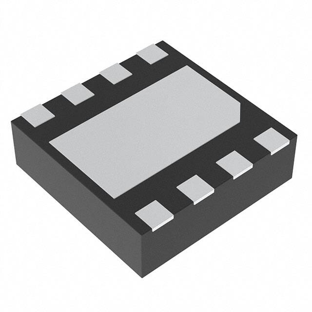

R1245K003H-TR
R1245K003H-TR
    RICOH
    UFDFN8
    降压型 1.2A 4.5V~30V
R1245K003H-TR 数据手册
R1245x Series 1.2 A, 30 V Step-Down DC/DC Converter No. EA-269-201022 OUTLINE The R1245x is a CMOS-based Step-down DC/DC converter with internal N-channel high side Tr. The ON resistance of the built-in high-side transistor is 0.35  and the R1245x can provide the maximum 1.2 A output current. Each of the ICs consists of an oscillator, a PWM control circuit, a voltage reference unit, an error amplifier, a phase compensation circuit, a slope compensation circuit, a soft-start circuit, protection circuits, an internal voltage regulator, and a switch for bootstrap circuit. The ICs can make up a step-down DC/DC converter with an inductor, resistors, a diode, and capacitors. The R1245x is a current mode operating type DC/DC converter without an external current sense resistor, and realizes fast response and high efficiency. As an output capacitor, a ceramic type capacitor can be used with the R1245x. The options of the internal oscillator frequency are preset at 330 kHz for version A and B, 500 kHz for version C and D, 1000 kHz for version E and F, 2400 kHz for version G and H. As for protection, an Lx peak current limit circuit cycle by cycle, a thermal shutdown function and an under voltage lockout (UVLO) function are built in. Furthermore, there are two types for short protection, for A/C/E/G version, a latch protection function which makes the output latch off if the output voltage keeps lower than the set output voltage for a certain time after detecting current limit is built in, for B/D/F/H version, a fold-back protection function which changes the oscillator frequency slower after detecting short circuit or equivalent. As for the packages of the R1245x, HSOP-8E, DFN(PLP)2020-8, SOT23-6W are available. FEATURES        Operating Voltage ꞏꞏꞏꞏꞏꞏꞏꞏꞏꞏꞏꞏꞏꞏꞏꞏꞏꞏꞏꞏꞏꞏꞏꞏꞏꞏꞏꞏꞏꞏꞏꞏꞏꞏꞏꞏꞏꞏꞏꞏꞏꞏ 4.5 V to 30 V Internal N-channel MOSFET Driver ꞏꞏꞏꞏꞏꞏꞏꞏꞏꞏꞏꞏꞏꞏꞏꞏꞏꞏꞏꞏꞏꞏ Typ. RON = 0.35  Adjustable Output Voltage with External Resistor ꞏꞏꞏꞏ 0.8 V or more Feedback Voltage and Tolerance ꞏꞏꞏꞏꞏꞏꞏꞏꞏꞏꞏꞏꞏꞏꞏꞏꞏꞏꞏꞏꞏꞏꞏꞏꞏ 0.8 V1.0% Peak Current Limit ꞏꞏꞏꞏꞏꞏꞏꞏꞏꞏꞏꞏꞏꞏꞏꞏꞏꞏꞏꞏꞏꞏꞏꞏꞏꞏꞏꞏꞏꞏꞏꞏꞏꞏꞏꞏꞏꞏꞏꞏꞏꞏꞏꞏ Typ. 2.0 A UVLO Function Released Voltage ꞏꞏꞏꞏꞏꞏꞏꞏꞏꞏꞏꞏꞏꞏꞏꞏꞏꞏꞏꞏꞏꞏꞏꞏ Typ. 4.0 V Operating Frequency ꞏꞏꞏꞏꞏꞏꞏꞏꞏꞏꞏꞏꞏꞏꞏꞏꞏꞏꞏꞏꞏꞏꞏꞏꞏꞏꞏꞏꞏꞏꞏꞏꞏꞏꞏꞏꞏꞏꞏꞏ 330 kHz (Ver. A/B), 500 kHz (Ver. C/D), 1000 kHz (Ver. E/F), 2400 kHz (Ver. G/H)      Fold-back Protected Frequency ꞏꞏꞏꞏꞏꞏꞏꞏꞏꞏꞏꞏꞏꞏꞏꞏꞏꞏꞏꞏꞏꞏꞏꞏꞏꞏꞏ 170 kHz (Ver. B/D), 250 kHz (Ver. F), 400 kHz (Ver. H) Latch Protection Delay Time ꞏꞏꞏꞏꞏꞏꞏꞏꞏꞏꞏꞏꞏꞏꞏꞏꞏꞏꞏꞏꞏꞏꞏꞏꞏꞏꞏꞏꞏꞏꞏ Typ. 4 ms (Ver. A/C/E/G) Ceramic Capacitors Recommended for Input and Output. Stand-by Current ꞏꞏꞏꞏꞏꞏꞏꞏꞏꞏꞏꞏꞏꞏꞏꞏꞏꞏꞏꞏꞏꞏꞏꞏꞏꞏꞏꞏꞏꞏꞏꞏꞏꞏꞏꞏꞏꞏꞏꞏꞏꞏꞏꞏꞏꞏ Typ. 0 A Packages ꞏꞏꞏꞏꞏꞏꞏꞏꞏꞏꞏꞏꞏꞏꞏꞏꞏꞏꞏꞏꞏꞏꞏꞏꞏꞏꞏꞏꞏꞏꞏꞏꞏꞏꞏꞏꞏꞏꞏꞏꞏꞏꞏꞏꞏꞏꞏꞏꞏꞏꞏꞏꞏꞏꞏ SOT-23-6W, DFN(PLP)2020-8, HSOP-8E 1 R1245x No. EA-269-201022 APPLICATIONS     Digital Home Appliances: Digital TVs, DVD Players Office Equipment: Printers, Faxes 5V PSU or 2-cell or more Li-ion Battery Powered Communication Equipment, Cameras, VCRs, Camcorders High Voltage Battery-powered Equipment SELECTION GUIDE In the R1245x, the package, type of short protection (Latch or Fold-back), and the oscillator frequency can be selected with the user’s request. Selection Guide Product code Package Quantity per Reel Pb Free Halogen Free R1245S003-E2-FE HSOP-8E 1,000 pcs Yes Yes DFN(PLP)2020-8 5,000 pcs Yes Yes SOT-23-6W 3,000 pcs Yes Yes R1245K003-TR R1245N001-TR-FE : Designation of the oscillator frequency and the protection function option. Latch Fold-back Oscillator Symbol Protection Protection Frequency  A 330 kHz  B 330 kHz  C 500 kHz  D 500 kHz  E 1000 kHz  F 1000 kHz  G 2400 kHz  H 2400 kHz 2 R1245x No. EA-269-201022 BLOCK DIAGRAM R1245x Block Diagram *1 Version A B C D E F G H Oscillator Frequency 330 kHz 330 kHz 500 kHz 500 kHz 1000 kHz 1000 kHz 2400 kHz 2400 kHz Short Protection Type 330 kHz 330 kHz 500 kHz 500 kHz 1000 kHz 1000 kHz 2400 kHz 2400 kHz 3 R1245x No. EA-269-201022 PIN DESCRIPTIONS Top View Bottom View 8 7 6 5 5 6 7 8 1 2 3 4 4 3 2 1 DFN(PLP)2020-8 Pin Configuration Top View 8 1 7 2 6 3 Top View Bottom View 5 4 5 4 6 3 7 2 HSOP-8E Pin Configuration 8 6 5 4 1 2 3 1 SOT-23-6W Pin Configuration * Connect the backside heat radiation tub to GND or same as GND level (recommendation). The tub is connected to the GND pin. 4 R1245x No. EA-269-201022 R1245S Pin Description Pin No. Symbol Description 1 Lx Lx Switching Pin 2 VIN Power Supply Pin 3 CE Chip Enable Pin, Active with ”H” 4 TEST TEST pin (must be open for user side.) 5 GND Ground Pin 6 FB Feedback Pin 7 NC No connection 8 BST Bootstrap Pin * Connect the backside heat radiation tub to GND or same as GND level (recommendation). The tub is connected to the GND pin. R1245K Pin Description Pin No. Symbol Description 1 Lx Lx Switching Pin 2 VIN Power Supply Pin 3 VIN Power Supply Pin 4 CE Chip Enable Pin, Active with ”H” 5 GND 6 FB 7 TEST 8 BST Ground Pin Feedback Pin Test Pin (must be open for user side.) Bootstrap Pin * Connect the backside heat radiation tub to GND or same as GND level (recommendation). The tub is connected to the GND pin. R1245N Pin Description Pin No. Symbol Description 1 BST Bootstrap Pin 2 GND Ground Pin 3 FB Feedback Pin 4 CE Chip Enable Pin, Active with ”H” 5 VIN Power Supply Pin 6 Lx Lx Switching Pin 5 R1245x No. EA-269-201022 INTERNAL EQUIVALENT CIRCUIT FOR EACH PIN Regulator VIN BST LX LX Regulator Regulator 6 VIN CE FB TEST R1245x No. EA-269-201022 ABSOLUTE MAXIMUM RATINGS Absolute Maximum Ratings (GND = 0 V) Symbol VIN Item Rating Unit −0.3 V to 32 V V VLX −0.3 V to VLX + 6 V V Input Voltage VBST BST Pin Voltage VLX Lx Pin Voltage −0.3 V to VIN + 0.3 V VCE CE Pin Input Voltage −0.3 V to VIN + 0.3 V VFB Feedback Pin Voltage −0.3 V to 6 V V PD Power Dissipation* HSOP-8E Ultra High Wattage Land Pattern 2900 DFN(PLP)2020-8 Standard Land Pattern 880 SOT-23-6W Standard Land Pattern 430 mW Tj Junction Temperature Range −40 to 125 ºC Tstg Storage Temperature Range −55 to 125 ºC * Refer to POWER DISSIPATION for detailed information. ABSOLUTE MAXIMUM RATINGS Electronic and mechanical stress momentarily exceeded absolute maximum ratings may cause the permanent damages and may degrade the lifetime and safety for both device and system using the device in the field. The functional operation at or over these absolute maximum ratings is not assured. RECOMMENDED OPERATING CONDITIONS Recommended Operating Conditions Symbol Item Rating VIN Operating Input Voltage Ta Operating Temperature Range Unit 4.5 to 30 V −40 to 105 °C RECOMMENDED OPERATING CONDITIONS All of electronic equipment should be designed that the mounted semiconductor devices operate within the recommended operating conditions. The semiconductor devices cannot operate normally over the recommended operating conditions, even if when they are used over such conditions by momentary electronic noise or surge. And the semiconductor devices may receive serious damage when they continue to operate over the recommended operating conditions. 7 R1245x No. EA-269-201022 ELECTRICAL CHARACTERISTICS Electrical Characteristics Symbol Item Min. Typ. Max. Unit 0.5 VUVLO2 −0.2 1.0 VUVLO2 −0.1 mA IIN Consumption Current VIN = 30 V, VFB = 1.0 V VUVLO1 UVLO Detect Voltage Specified VIN falling edge 3.6 VUVLO2 UVLO Released Voltage Specified rising edge 3.8 4.0 4.2 V 0.792 0.800 0.808 V ppm/ ºC VFB ΔVFB/ΔTa fosc fFLB Maxduty tstart VFB Voltage Tolerance VFB Voltage Temperature Coefficient Oscillator Frequency Fold back Frequency Oscillator Maximum Duty Cycle −40ºC ≤ Ta ≤ 105ºC ±100 Ver. A/B 300 330 360 Ver. C/D 450 500 550 Ver. E/F 900 1000 1100 Ver. G/H 2200 2400 2600 VF B < 0.56 V Ver. B/D 170 Ver. F 250 Ver. H 400 Ver. A/B/C/D 92 Ver. E/F 88 Ver. G/H 76 V kHz kHz % VFB = 0.72 V 1 ms Ver. A/C/E/G 4 ms 0.35  VCEL Soft-start Time Delay Time for Latch Protection Lx High Side Switch ON Resistance Lx High Side Switch Leakage Current Lx High Side Switch Limited Current CE “L” Input Voltage VIN = 30 V VCEH CE “H” Input Voltage VIN = 30 V 1.6 IFB VFB Input Current VIN = 30.0 V, VFB = 1.0 V −1.0 1.0 μA ICEL CE “L” Input Current VIN = 30 V, VCE = 0 V −1.0 1.0 μA ICEH CE “H” Input Current VIN = 30 V, VCE = 30 V −1.0 1.0 μA tDLY RLXH ILXHOFF ILIMLXH TTSD Istandby 8 (Unless otherwise noted, VIN = 12 V, Ta = 25ºC) Conditions Thermal Shutdown Detect Temperature Standby Current VBST − VLX = 4.5 V VIN = 30 V, VCE = 0 V VBST − VLX = 4.5 V Hysteresis 30ºC VIN = 30 V 1.5 0 5 μA 2.0 2.7 A 0.3 V V 160 0 ºC 5 μA R1245x No. EA-269-201022 OPERATING DESCRIPTIONS OPERATION OF THE BUCK CONVERTER AND THE OUTPUT CURRENT The DC/DC converter charges energy in the inductor when the switch turns on, and discharges the energy from the inductor when the switch turns off and controls with less energy loss, so that a lower output voltage than the input voltage is obtained. Refer to the following figures. ILmax IL ILmin i1 VIN Switch L Diode i2 topen VOUT COUT GND ton toff t=1/fosc Basic Circuit Current flowing through the Inductor Step 1: The switch turns on and current IL (= i1) flows, and energy is charged into COUT. At this moment, IL increases from ILmin (= 0) to reach ILmax in proportion to the on-time period (ton) of the switch. Step 2: When the switch turns off, the diode turns on in order to maintain IL at ILmax, and current IL (= i2) flows. Step 3: IL (= i2) decreases gradually and reaches IL = ILmin = 0 after a time period of topen, and the diode turns off. This case is called as discontinuous mode. If the output current becomes large, next switching cycle starts before IL becomes 0 and the diode turns off. In this case, IL value increases from ILmin (> 0), and this case is called continuous mode. In the case of PWM control system, the output voltage is maintained by controlling the on-time period (ton), with the oscillator frequency (fosc) being maintained constant. 9 R1245x No. EA-269-201022 TYPICAL APPLICATION CIRCUIT R1245x00xA/B Typical Application Circuit, 330 kHz, VOUT = 1.2 V, VIN = 24 V R1245x00xC/D Typical Application Circuit, 500 kHz, VOUT = 3.3 V, VIN = 24 V * TEST pin must be open. 10 R1245x No. EA-269-201022 R1245x00xE/F Typical Application Circuit, 1000 kHz, VOUT = 3.3 V VIN = 12 V R1245x00xG/H Typical Application Circuit, 2400 kHz, VOUT = 5. 0 V, VIN = 12 V * TEST pin must be open. 11 R1245x No. EA-269-201022 OUTPUT CURRENT AND SELECTION OF EXTERNAL COMPONENTS The relation between the output current and external components is as follows: When the switch of Lx turns on: (Wherein, the peak to peak value of the ripple current is described as IRP, the ON resistance of the switch is described as RONH, and the diode forward voltage as VF, and the DC resistance of the inductor is described as RL, and on time of the switch is described as ton) VIN = VOUT + (RONH + RL)  IOUT + L  IRP / ton ꞏꞏꞏꞏꞏꞏꞏꞏꞏꞏꞏꞏꞏꞏꞏꞏꞏꞏꞏꞏꞏꞏꞏꞏꞏꞏꞏꞏꞏꞏꞏꞏꞏꞏꞏꞏꞏꞏꞏꞏꞏꞏꞏꞏꞏꞏꞏꞏꞏꞏꞏꞏꞏꞏꞏꞏꞏꞏꞏꞏꞏꞏꞏꞏꞏ Equation 1 When the switch turns off (the diode turns on) as toff: L  IRP / toff = VF + VOUT + RL  IOUT ꞏꞏꞏꞏꞏꞏꞏꞏꞏꞏꞏꞏꞏꞏꞏꞏꞏꞏꞏꞏꞏꞏꞏꞏꞏꞏꞏꞏꞏꞏꞏꞏꞏꞏꞏꞏꞏꞏꞏꞏꞏꞏꞏꞏꞏꞏꞏꞏꞏꞏꞏꞏꞏꞏꞏꞏꞏꞏꞏꞏꞏꞏꞏꞏꞏꞏꞏꞏꞏꞏꞏꞏꞏꞏꞏꞏꞏꞏ Equation 2 Put Equation 2 to Equation 1 and solve for ON duty of the switch, ton / (toff + ton) = DON, DON = (VOUT + VF + RL  IOUT) / (VIN + VF - RONH  IOUT)ꞏꞏꞏꞏꞏꞏꞏꞏꞏꞏꞏꞏꞏꞏꞏꞏꞏꞏꞏꞏꞏꞏꞏꞏꞏꞏꞏꞏꞏꞏꞏꞏꞏꞏꞏꞏꞏꞏꞏꞏꞏꞏꞏꞏꞏꞏꞏꞏꞏꞏꞏꞏꞏꞏ Equation 3 Ripple Current is as follows: IRP = (VIN −VOUT −RONH  IOUT −RL  IOUT)  DON / fosc / L ꞏꞏꞏꞏꞏꞏꞏꞏꞏꞏꞏꞏꞏꞏꞏꞏꞏꞏꞏꞏꞏꞏꞏꞏꞏꞏꞏꞏꞏꞏꞏꞏꞏꞏꞏꞏꞏꞏꞏꞏꞏꞏꞏꞏꞏꞏꞏꞏ Equation 4 wherein, peak current that flows through L, and the peak current ILmax is as follows: ILmax = IOUT + IRP / 2 ꞏꞏꞏꞏꞏꞏꞏꞏꞏꞏꞏꞏꞏꞏꞏꞏꞏꞏꞏꞏꞏꞏꞏꞏꞏꞏꞏꞏꞏꞏꞏꞏꞏꞏꞏꞏꞏꞏꞏꞏꞏꞏꞏꞏꞏꞏꞏꞏꞏꞏꞏꞏꞏꞏꞏꞏꞏꞏꞏꞏꞏꞏꞏꞏꞏꞏꞏꞏꞏꞏꞏꞏꞏꞏꞏꞏꞏꞏꞏꞏꞏꞏꞏꞏꞏꞏꞏꞏꞏꞏꞏꞏꞏꞏꞏꞏ Equation 5 As for the valley current ILmin, ILmin = IOUT - IRP / 2 ꞏꞏꞏꞏꞏꞏꞏꞏꞏꞏꞏꞏꞏꞏꞏꞏꞏꞏꞏꞏꞏꞏꞏꞏꞏꞏꞏꞏꞏꞏꞏꞏꞏꞏꞏꞏꞏꞏꞏꞏꞏꞏꞏꞏꞏꞏꞏꞏꞏꞏꞏꞏꞏꞏꞏꞏꞏꞏꞏꞏꞏꞏꞏꞏꞏꞏꞏꞏꞏꞏꞏꞏꞏꞏꞏꞏꞏꞏꞏꞏꞏꞏꞏꞏꞏꞏꞏꞏꞏꞏꞏꞏꞏꞏꞏꞏꞏꞏ Equation 6 If ILmin < 0, the step-down DC/DC converter operation becomes current discontinuous mode. Therefore the current condition of the current discontinuous mode, the next formula is true. IOUT < IRP / 2 ꞏꞏꞏꞏꞏꞏꞏꞏꞏꞏꞏꞏꞏꞏꞏꞏꞏꞏꞏꞏꞏꞏꞏꞏꞏꞏꞏꞏꞏꞏꞏꞏꞏꞏꞏꞏꞏꞏꞏꞏꞏꞏꞏꞏꞏꞏꞏꞏꞏꞏꞏꞏꞏꞏꞏꞏꞏꞏꞏꞏꞏꞏꞏꞏꞏꞏꞏꞏꞏꞏꞏꞏꞏꞏꞏꞏꞏꞏꞏꞏꞏꞏꞏꞏꞏꞏꞏꞏꞏꞏꞏꞏꞏꞏꞏꞏꞏꞏꞏꞏꞏꞏꞏꞏꞏꞏꞏꞏ Equation 7 Consider ILmax and ILmin, conditions of input and output and select external components. *The above explanation is based on the calculation in an ideal case in continuous mode. 12 R1245x No. EA-269-201022 Ripple Current and Lx Current Limit The ripple current of the inductor may change according to the various reasons. In the R1245x, as an Lx current limit, Lx peak current limit is used. Therefore the upper limit of the inductor current is fixed. The peak current limit is not the average current of the inductor (output current). If the ripple current is large, peak current becomes also large. The characteristic is used for the fold-back current limit of version B/D/F/H. In other words, the peak current limit is maintained and the switching frequency is reduced, as a result, the average current of the inductor is reduced. To release this condition, at 170 kHz for version B/D, at 250 kHz for version F, at 400 kHz for version H must not be beyond the peak current limit. In the figure1, the sequence of the Lx current limit function is described. Figure 1. LX Limit function sequence 13 R1245x No. EA-269-201022 Latch Protection Function for Version A/C/E/G The latch function works after detecting current limit and if the output voltage becomes low for a certain time, the output is latched off. Refer to the TECHNICAL NOTES. Fold-back Protection Function for Version B/D/F/H If FB voltage becomes lower than approximately 0.56 V, the fold-back protection function limits the oscillator frequency to typically 170 kHz for version B/D, typically 250 kHz fir version F, typically 400 kHz for version H. By reducing frequency, the ripple current increases. The R1245x has the peak current limit function, therefore as in the equation 8, the Lx average current decreases by the increase of the ripple current. IOUT = ILmax + IRP / 2………………………………………………………………………………………..Equation 8 If FB voltage becomes less than 0.56 V, the oscillator frequency is reduced. At heavy load, if the R1245x becomes into the fold-back protection mode, the situation may not be released by increase the ripple current. In terms of other notes on this protection function, refer to the TECHNICAL NOTES. 14 R1245x No. EA-269-201022 MAXIMUM OUTPUT CURRENT The output current of the R1245x is limit by the power dissipation PD of the package and the maximum specification 1.2 A. The loss of the IC includes the switching loss, and it is difficult to estimate. To estimate the maximum output, using the efficiency data is one method. By using the efficiency data, the loss including the external components can be calculated with the equation, (100 / efficiency (%) - 1) x (VOUT (V) x IOUT (A)). From this equation, by reducing the loss of external components, the loss of the IC can be estimated. The main loss of the external components is composed by the rectifier diode and DCR of the inductor. Supposed that the forward voltage of the diode is described as VF, the loss of the diode can be described as follows: (VIN (V) - RON () x IOUT (A) - VOUT (V) - VF (V))) / VIN (V) x VF (V) x IOUT (A) The loss by the DCR of the inductor can be calculated by the formula DCR () x IOUT2 (A). Thus, The loss of the IC = (100 / efficiency (%) - 1) x (VOUT (V) x IOUT (A) - (VIN (V) - RON () x IOUT (A) - VOUT (V) -VF (V)) / VIN (V) x VF (V) x IOUT (A) – DCR () x IOUT2 (A) The efficiency of the R1245x at Ta = 25C, VIN = 12 V, VOUT = 3.3 V, IOUT = 600 mA is approximately 89.5% for version A/B (Oscillator frequency: 330 kHz). Supposed that the On resistance of the internal driver is 0.35 , the DCR of the inductor is 65 m, the VF of the rectifier diode is 0.3 V and applied to the formula above, The loss of the IC = (100% / 89.5% - 1) x (3.3 V x 0.6 A) - (12 V - 0.35  x 0.6 A - 3.3 V - 0.3 V) / 12 V x 0.3 V x 0.6 A - 0.065  x 0.62 A = 86 mW The power dissipation PD of the package is specified at Ta = 25C based on the Tjmax = 125C. Thus the thermal resistance of the package ja = (Tjmax (C) - Ta(C)) / PD (W), therefore the thermal resistance of the each available package is as follows: HSOP-8E: (125C - 25C) /2.9 W = 34.5C/W DFN(PLP)2020-8: (125C - 25C) / 0.88 W = 114C/W SOT-23-6W: (125C - 25C) / 0.43 W = 233C/W Due to the loss of the IC is 86mW for this example, therefore Tj increase of the each package is as follows: HSOP-8E: 34.5C/W x 86 mW = 2.96C DFN(PLP)2020-8: 114C/W x 86 mW = 9.80C SOT-23-6W: 233C/W x 86 mW = 20.0C For all the packages, even if the ambient temperature is at 105C, Tj can be suppressed less than 125C. By the increase of the temperature, on resistance and switching loss increases, therefore, temperature margin is not enough, measure the efficiency at the actual maximum temperature and recalculation is necessary. At the same condition, if the preset frequency is 2400 kHz, the efficiency will be down to approximately 81%. The result of the loss calculation is 310 mW, therefore the Tj increase of each package is, HSOP-8E: 34.5C/W x 310 mW = 11C DFN(PLP)2020-8: 114C/W x 310 mW = 35C SOT-23-6W: 233C/W x 310 mW = 72C 15 R1245x No. EA-269-201022 HSOP-8E can be used at the ambient temperature 105C, DFN(PLP)2020-8 can be used at the ambient temperature up to 90C, SOT-23-6W can be used at the ambient temperature up to 53C. Note that the result is different by the frequency. The next graphs are the output current and estimated ambient temperature limit. Maximum Output Current VIN = 12 V, VOUT = 3.3 V, fosc = 330 kHz -40°C 105°C 1400 1200 IOUT[mA] 1000 800 SOT-23-6W DFN2020-8 HSOP-8E 600 400 200 0 -50 0 50 100 150 Ta[°C] Maximum Output Current VIN = 12 V, VOUT = 3.3 V, fosc = 2400 kHz -40°C 105°C 1400 1200 IOUT[mA] 1000 SOT-23-6W DFN2020-8 HSOP-8E 800 600 400 200 0 -50 0 50 Ta[°C] 16 100 150 R1245x No. EA-269-201022 TECHNICAL NOTES  External components must be connected as close as possible to the ICs and make wiring as short as possible. Especially, the capacitor connected in between VIN pin and GND pin must be wiring the shortest. If their impedance is high, internal voltage of the IC may shift by the switching current, and the operating may be unstable. Make the power supply and GND lines sufficient. In the wiring of the power supply, GND, LX, VOUT and the inductor, large current by switching may flow. To avoid the bad influence, the wiring between the resistance, “RUP” for setting the output voltage and loading, and the wiring between the inductor and loading must be separated.  The ceramic capacitors have low ESR (Equivalent Series Resistance) and recommended for the ICs. The recommendation of CIN capacitor between VIN and GND is 10 F or more for A/B/C/D version, 4.7 F or more for E/F version, and 2.2 F or more for G/H version. Verify the bias dependence and the temperature characteristics of the ceramic capacitors. Recommendation conditions are written based on the case which the recommendation parts are used with the R1245x.  The R1245x is designed with the recommendation inductance value and ceramic capacitor value and phase compensation has been made. If the inductance value is large, due to the lack of current sensing amount of the current mode, unstable operation may result. On the contrary, if the inductance value is small, the current sensing amount may increase too much, low frequency oscillation may occur when the on duty ratio is beyond 50%. Not only that, if the inductance value is small, according to the increase of the load current, the peak current of the switching may increase, as a result, the current may reach the current limit value and the current limit may work.  As for the diode, use the Schottky diode with small capacitance between terminals. The reference characteristic of the capacitance between terminals is around 100 pF or less at 10 V. If the capacitance between terminals is large, excess switching current may flow and the operation of the IC may be unstable. If the capacitance between terminals of the Scottky diode is beyond 100 pF at 10 V or unknown, verify the load regulation, line regulation, and the load transient response.  Output voltage can be set by adjustment of the values of R1 and R2. The equation of setting the output voltage is VOUT = VFB  (R1 + R2) / R2. If the values of R1 and R2 are large, the impedance of FB pin increases, and pickup the noise may result. The recommendation value range of R2 is approximately between 1.0 kΩ to 16 kΩ. If the operation may be unstable, reduce the impedance of FB pin.  For the CE pin, as an ESD protection element, a diode to VIN pin is formed internal of the IC. If CE pin voltage may become higher than VIN pin voltage, to prevent flowing large current from CE pin to VIN pin, connect 10 k or more resistor between CE and VIN pin.  Connect the backside heat radiation tub of the DFN(PLP)2020-9/HSOP-8E to the GND. As for multi-layered boards, to make better power dissipation, putting some thermal via on the thermal pad in the land pattern and radiation of the heat to another layer is effective.  After the soft-start operation, the latch function is enabled for version A/C/E/G. The latch protection starts the internal counter when the internal current limit protection circuit detects the current limit. When the internal counter counts up to the latch timer limit, typically 4 ms, the output is latched off. To reset the latch function, make the CE pin “L”, or make VIN pin voltage lower than UVLO detector threshold. Then in the case that the output voltage or FB voltage becomes setting voltage within the latch timer preset time, counter is initialized. If the slew rate of the power supply is too slow and after the soft-start time, the output voltage does not reach the set output voltage even if the latch timer preset time is over, the latch function may work unexpectedly. 17 R1245x No. EA-269-201022  After the soft-start operation, fold-back protection function is enabled for version B/D/F/H. The fold-back function will limit the oscillator frequency if the FB pin voltage becomes lower than typically 0.56 V. For B/D version, the oscillator frequency will be reduced typically into 170 kHz, for F version, into 250 kHz, for H version, into 400 kHz.  If the slew rate of the power supply is too slow, and even after the soft-start time, the output voltage is still less than 70% of the set output voltage, or FB pin voltage is less than typically 0.56 V, then this function may work unexpectedly.  The performance of power circuit using this IC largely depends on external components. Selection of external components is very important, especially, do not exceed each rating value (voltage/current/power). Table 1. Recommended Values for Each Output Voltage R1245x00xA/B: 330 kHz VOUT (V) 0.8 to 1.2 R1245x00xC/D: 500 kHz VOUT (V) 0.8 to 1.2 R1 (RUP) (kΩ) R2 (RBOT) (kΩ) 16 CSPD (pF) open 100 COUT (F) 4.7 L (H) R1245x00xE/F: 1000 kHz VOUT (V) 0.8 to 1.0 R1 (RUP) (kΩ) R2 (RBOT) (kΩ) 16 CSPD (pF) open 100 COUT (F) 2.2 L (H) R1245x00xG/H: 2400 kHz VOUT (V) R1 (RUP) (kΩ) R2 (RBOT) (kΩ) CSPD (pF) COUT (F) L (H) 18 2.5 to 5.0 5.0 ≤ = (VOUT / 0.8 − 1) × R2 R1 (RUP) (kΩ) R2 (RBOT) (kΩ) CSPD (pF) COUT (F) L (H) 1.2 to 2.5 16 open 47 4.7 1.2 to 1.5 16 100 100 4.7 1.0 to 1.2 16 100 100 2.2 1.2 to 1.8 16 100 10 1.0 12 470 47 10 1.5 to 2.0 1.20 2200 22 15 2.0 to 5.0 1.20 1000 22 33 5.0 to 12.0 12.0 ≤ 1.2 1000 22 15 1.2 470 22 15 2.5 to 5.0 5.0 ≤ 1.2 470 10 4.7 1.2 470 10 10 = (VOUT / 0.8 − 1) × R2 16 1.2 100 1000 22 22 10 10 1.2 to 1.5 1.5 to 2.5 = (VOUT / 0.8 − 1) × R2 16 16 100 100 47 22 2.2 2.2 1.8 to 2.5 2.5 to 5.0 = (VOUT / 0.8 − 1) × R2 12 1.2 100 470 10 4.7 1.5 2.2 5.0 ≤ 1.2 470 4.7 4.7 R1245x No. EA-269-201022 *1 Divider Resisters Values and Possible Setting Range of Input/ Output VOUT [V] 0.8 1 1.2 1.5 1.8 2 2.5 3.3 5 R1 (RUP) [kΩ] R2 (RBOT) [kΩ] 0 open 0 16 4 16 8 16 6 12 10.5 12 14 16 Input Voltage Range [V] Ver. A/B Ver. C/D Ver. E/F Ver. G/H 4.5 to 20 4.5 to 13.5 4.5 to 7 - 4.5 to 25.5 4.5 to 17 4.5 to 8.5 - 4.5 to 30 4.5 to 20 4.5 to 10 - 4.5 to 30 4.5 to 25 4.5 to 12.5 4.5 to 5.5 4.5 to 30 4.5 to 30 4.5 to 15 4.5 to 6.5 4.5 to 30 4.5 to 30 4.5 to 17 4.5 to 7 4.5 to 30 4.5 to 30 4.5 to 21 4.5 to 9 4.5 to 30 4.5 to 30 4.5 to 27.5 4.5 to 12 20 16 15 12 24 16 1.8 1.2 34 16 25.5 12 2.55 1.2 3.75 1.2 6.3 1.2 5.5 to 30 5.5 to 30 6 to 30 7 to 18.5 6.5 to 30 7 to 30 8 to 20 6 7.8 1.2 6.5 to 30 9 12.3 1.2 10 to 30 10 to 30 11 to 30 12 to 30 12 16.8 1.2 13 to 30 13 to 30 14 to 30 16 to 30 15 21.3 34.8 1.2 16.5 to 30 16.5 to 30 17 to 30 20 to 30 1.2 26.5 to 30 26.5 to 30 27.5 to 30 30 24 19 R1245x No. EA-269-201022 Table 2. Recommended External Components Examples (Considering All the Range) Symbol Condition Value Parts Name CIN 50 V/ X5R 50 V/ X5R 50 V/ X7R 50 V/ X7R 10 F 10 F 4.7 F 2.2 F UMK325BJ106MM-P CGA6P3X7S1H106K GRM31CR71H475KA12L GRM31CR71H225KA88L COUT 50 V/ X5R 50 V/ X5R 50 V/ X7R 25 V/ X7R 10 V/ X7R 16 V/ B 10 V/ X7R 10 F 10 F 10 F 10 F 22 F 47 F 47 F CBST 16 V/ X7R 0.47 F UMK325BJ106MM-P TAIYO YUDEN CGA6P3X7S1H106K TDK KTS500B106M55N0T00 Nippon Chemi-Con GRM31CR71E106K Murata GRM31CR71A226M Murata GRM32EB31C476KE15 Murata GRM32ER71A476KE15 Murata NOTE: The value of COUT depends on the setting output voltage. EMK212B7474KD-T TAIYO YUDEN L D RCE 20 MFR TAIYO YUDEN TDK Murata Murata SLF6045T-100M1R6-3PF TDK 10 H SLF7045T-4R7M2R0-PF TDK 4.7 H NR4018T-4R7M2R0-PF TDK 4.7 H NR6020T4R7N TAIYO YUDEN 4.7 H NR6028T100M TAIYO YUDEN 10 H NR6045T150M TAIYO YUDEN 15 H NR6045T220M TAIYO YUDEN 22 H NR8040T330M TAIYO YUDEN 33 H VLCF4020T-2R2N1R7 TDK 2.2 H NR4012T2R2M TAIYO YUDEN 2.2 H NR3015T1R5N TAIYO YUDEN 1.5 H NR4010T1R0N TAIYO YUDEN 1.0 H 30 V/ 2.0 A 0.37 V CMS06 TOSHIBA 40 V/ 2.0 A 0.55 V CMS11 TOSHIBA An up diode is formed between the CE pin and the VIN pin as an ESD protection element. If the CE pin may become higher than the voltage of the VIN pin, connect the 10 kΩ resistance between the CE pin and VIN pin, to prevent a large current from flowing into the VIN pin from the CE pin. 1.8 A 1.65 A 1.7 A 2.4 A 1.9 A 2.3 A 1.9 A 1.9 A 1.7 A 1.65 A 1.8 A 1.8 A R1245x No. EA-269-201022 APPLICATION INFORMATION TO IMPROVE THE PERFORMANCE The R1245 can make its performance better, by adding components as shown below. Cspd: Speed up capacitor Cspd has two roles, one is to improve the stability, and the other is to improve the transient speed. The transfer function from VOUT (-which is made of Cspd and feedback resisters, R1(Rup) and R2(Rbot)) to FB will make a forward bump by low frequency zero and high frequency pole, and improve the stability of feedback loop. Cspd can improve the gain and make the transient speed fast at high frequency. Figure 2. Transfer function BODE plot from VOUT to FB (R1=3.75kΩ, R2=1.2kΩ, Cspd=470pF) 21 R1245x No. EA-269-201022 To improve the stability If the resistance values of the R1 and R2 have to be changed, make the value of R1*Cspd be constant. (For example, with the R1245x00xA/B and making VOUT=1.2V, if R1=0.6kΩ, R2=1.2kΩ are used, Cspd=4700pF. By making the values of R1 and R2 increase, the impedance of FB pin also increases, as a result, the influence by noise must be cared. To avoid this, recommendation value range of R2 is from 1.0kΩ to 16kΩ. If the operation becomes unstable by increasing the impedance, choose low resistance value. If COUT and L are necessary to be changed, or unusual voltage setting is necessary, the Cspd value must be adjusted. The instruction of the adjustment is as follows: 1. Without Cspd, measure the output under-shoot amount by load transient response. 2. Further, with using a small value Cspd, measure the output under-shoot amount by load transient response. The appropriate initial value is about 1/10 of the recommendation Cspd value. If Cspd is too small, the under-shoot amount is almost same as the one without Cspd. If the value of Cspd is changed bigger gradually, the under-shoot amount will be less. Supposed that this new good Cspd as Cspd1, and continue to make it bigger, and finally, the under-shoot amount becomes unchanged, at this point, supposed that the maximum Cspd as Cspd2. 3. Select an appropriate value according to the formula, Cspd=√(Cspd1*Cspd2). To improve the transient response speed If the stability is enough, (for example, in the case that COUT is big enough), make Cspd value bigger. The stability will be same, but the gain at high frequency will be large, and improve the transient response speed. However, if Cspd value is set Cspd2 value or more, the result will not be improved, not only that, due to the high gain at high frequency, compared with the result without Cspd, the stability will be worse. 22 R1245x No. EA-269-201022 ①R1=3.75kΩ, R2=1.2kΩ, Cspd: none, VOUT=3.3V VOUT ILX IOUT Due to no Cspd, the stability is not good enough, and under-shoot amount is big during the load transient. ②R1=3.75kΩ, R2=1.2kΩ, Cspd=2200pF, VOUT=3.3V VOUT ILX IOUT Cspd value is appropriate, and stability and response speed is adjusted properly. ③R1=3.75kΩ, R2=1.2kΩ, Cspd=33000pF, VOUT=3.3V VOUT ILX IOUT Cspd value is too big, the response speed is fast, but the stability decreases slightly. 23 R1245x No. EA-269-201022 Rspd: Noise reduction filter for speed up capacitor Cspd can improve the high frequency characteristics due to its differential function. In other words, the high frequency component is passed through without change, therefore the spike noise of VOUT is transferred to FB pin as it is. If the spike noise is too big, by its noise of FB pin, the output voltage may be changed especially at heavy load. To avoid this situation, by setting an Rspd which inserts in series in Cspd and making a pole at high frequency, filtering is possible and effective. The appropriate value range of Rspd is from 10Ω to 30Ω. If the resistance value is too big, the effect of Cspd is cancelled by the lowering pole at high frequency by Rspd. By removing FB pin noise, using low R1 and R2 resistance value. 24 R1245x No. EA-269-201022 VOLTAGE BETWEEN Lx PIN AND BST PIN In the boot-strap style switching regulator, when the Lx pin voltage becomes lower than the regulator which supplies BST voltage, CBST is charged. By this charge, while the Lx pin voltage is "H", high side switch can be turned on continuously. Therefore, if Lx pin voltage does not become lower than the BST voltage supply regulator, switching may be abnormal. In the R1245, the output voltage of the BST voltage supply regulator is set at 5V. The abnormal switching may be caused by the following conditions: ・VOUT>5V, the difference between VIN and VOUT is small, inductor current is discontinuous by light load When the inductor current is continuous, or load current is big enough even if the discontinuous mode, the forward current of the diode will make Lx pin voltage down and CBST is charged, but at light load, Lx pin voltage does not become low enough against the BST voltage supply regulator output(5V). The voltage of CBST is not high enough and drive capability will be down. (Figure 3-①) Due to the lack of the drive capability, VOUT cannot be maintained, and under-shoot happens to VOUT, Lx pin voltage may become lower than the BST voltage supply regulator output (5V), but the error amplifier operation may be abnormal. When the charge of CBST is recovered and normal switching starts, VOUT becomes back to set output voltage. However, after recovering the VOUT, to recover the error amplifier's operation, some response time is necessary, during this response time, VOUT may be over-shoot. (Figure 3-②) As a result, LX pin voltage cannot be low enough against the BST voltage supply regulator output voltage (5V), undershoot and over-shoot may be repeated. (Figure 4) 25 R1245x No. EA-269-201022 Abnormal waveforms are shown in the next figures. Figure 3: VIN voltage start-up is slower than the softstart time Figure 4: The voltage difference between input and output is small and load current is small In both cases, the voltage between Lx pin and BST pin is not enough. ① ② VIN VOUT VBST VLX Figure 3. VIN slow start-up (R1245S003A: VIN=30V, VOUT=24V, IOUT=0mA) VIN VOUT VBST VLX Figure 4. The voltage difference between input and output is small (R1245S003A VIN=5.5V, VOUT=5V, IOUT=500uA) 26 R1245x No. EA-269-201022 To avoid these situations, please refer to the countermeasures shown below: If start-up with VOUT>5V is necessary, avoid the extremely low load, and start up should be done by CE pin control after VIN becomes high enough. ・ If VOUT>5V at low load operation is necessary, make the inductance value bigger and assure the "L" time of Lx. ・ If start-up with VIN=CE is necessary, avoid very slow VIN setting and low load current condition. ・ During the output overshoot while the normal transient response, even the no-switching condition happens, the operation keeps normal. Other than that, low load condition with VOUT
