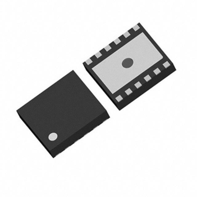

R1283K002B-TR 数据手册
*1283Z (WLCSP-11-P2) is the discontinued product as of June, 2016. R1283x SERIES 2ch DC/DC for CCD & OLED NO.EA-157-160224 OUTLINE The R1283x 2ch DC/DC converter is designed for CCD & OLED Display power source. It contains a step up DC/DC converter and an inverting DC/DC converter to generate two required voltages by CCD & OLED Display. Step up DC/DC converter generates boosted output voltage up to 20V. Inverting DC/DC converter generates negative voltage up to VIN voltage minus 20V independently. Start up sequence is internally made. Each of the R1283x series consists of an oscillator, a PWM control circuit, a voltage reference, error amplifiers, over current protection circuits, short protection circuits, an under voltage lockout circuit (UVLO), an Nch driver for boost operation, a Pch driver for inverting. A high efficiency boost and inverting DC/DC converter can be composed with external inductors, diodes, capacitors, and resistors. FEATURES  Operating Voltage ......................................... 2.5V to 5.5V  Step Up DC/DC (CH1) Internal Nch MOSFET Driver (RON=400mTyp.) Adjustable VOUT Up to 20V with external resistor Internal Soft start function (Typ. 4.5ms) Over Current Protection Maximum Duty Cycle: 91%(Typ.)  Inverting DC/DC (CH2) Internal Pch MOSFET Driver (RON=400m Typ.) Adjustable VOUT Up to Vdd-20V with external resistor Auto Discharge function for negative output Internal Soft start function (Typ. 4.5ms) Over Current Protection Maximum Duty Cycle: 91%(Typ.)  Short Protection with timer latch function (Typ. 50ms); Short condition for either or both two outputs makes all output drivers off and latches./ If the maximum duty cycle continues for a certain time, these output drivers will be turned off. CE with start up sequence function CH1CH2 (R1283K001x) / CH2CH1(R1283K002x) Selectable UVLO function Operating Frequency Selection .......... 300kHz / 700kHz / 1400kHz  Packages ...................................................... DFN(PLP)2730-12, WLCSP-11-P2 APPLICATION  Fixed voltage power supply for portable equipment  Fixed voltage power supply for CCD, OLED, LCD 1 *1283Z (WLCSP-11-P2) is the discontinued product as of June, 2016. R1283x BLOCK DIAGRAM Timer Current Limit VCC PVCC UVLO PWM Control LX2 VREF Maxduty Vref Discharge Control VFB2 Vref VOUTN VFB1 Vref LX1 GND PWM Control CE 2 Sequence Control PGND *1283Z (WLCSP-11-P2) is the discontinued product as of June, 2016. R1283x SELECTION GUIDE The start-up sequence, oscillator frequency, and the package for the ICs can be selected at the user’s request. Product Name R1283Z00x-E2-F R1283K00x-TR Package Quantity per Reel Pb Free Halogen Free WLCSP-11-P2 4,000 pcs Yes Yes DFN(PLP)2730-12 5,000 pcs Yes Yes x : The start-up sequence can be designated. (1) Step-up → Inverting (2) Inverting → Step-up  : The oscillator frequency is the option as follows. (A) 300kHz (A Version for 1283Z packaged in WLCSP-11-P2 is not available) (B) 700kHz (C) 1400kHz 3 *1283Z (WLCSP-11-P2) is the discontinued product as of June, 2016. R1283x PIN CONFIGURATIONS  WLCSP-11-P2  DFN(PLP)2730-12 Top View Top View Bottom View 3 3 2 2 1 1 A B C D 12 11 10 9 8 Bottom View 7 7 8  D C B A 1 2 3 4 5 6 6 5 PIN DESCRIPTIONS    4 9 10 11 12 WLCSP-11-P2 Pin No Symbol Pin Description A1 PGND A2 VFB1 Feedback pin for Step up DC/DC A3 LX1 Switching pin for Step up DC/DC B1 PVCC B2 CE Chip Enable pin for the R1283 B3 LX2 Switching pin for Inverting DC/DC C1 GND Analog GND pin C3 VOUTN Discharge pin for Negative output D1 VCC Analog power source Input pin D2 VREF Reference Voltage Output pin D3 VFB2 Feedback pin for Inverting DC/DC Power GND pin Power Input pin DFN(PLP)2730-12 Pin No Symbol Pin Description 1 NC No Connect 2 LX1 Switching pin for Step up DC/DC 3 LX2 Switching pin for Inverting DC/DC 4 VOUTN Discharge pin for Negative Output 5 CE Chip Enable pin for the R1283 6 VFB2 Feedback pin for Inverting DC/DC 7 VREF Reference Voltage Output pin 8 VCC Analog power source Input pin 9 VFB1 Feedback pin for Step up DC/DC 10 GND Analog GND pin 11 PVCC Power Input pin 12 PGND Power GND pin ) Tab is GND level. (They are connected to the reverse side of this IC.) The tab is better to be connected to the GND, but leaving it open is also acceptable. 4 3 2 1 *1283Z (WLCSP-11-P2) is the discontinued product as of June, 2016. R1283x ABSOLUTE MAXIMUM RATINGS Symbol Item (GND/PGND0V) Rating Unit 6.5 V VCC VCC / PVCC pin Voltage VDTC VFB1 pin Voltage 0.3 to VCC0.3 V VFB VFB2 pin Voltage 0.7(1) to VCC0.3 V VCE CE pin Voltage 0.3 to VCC0.3 V VREF VREF pin Voltage 0.7(1) to VCC0.3 V VLX1 LX1 pin Voltage 0.3 to 24 V ILX1 LX1 pin Current Internally Limited A VLX2 LX2 pin Voltage VCC24 to VCC0.3 V ILX2 LX2 pin Current Internally Limited A VNFB VOUTN pin Voltage VCC24 to VCC0.3 V PD Power Dissipation (WLCSP-11-P2) (2) 1000 Power Dissipation (DFN(PLP)2730-12) (2) 1000 mW Topt Operating Temperature Range 40 to 85 C Tstg Storage Temperature Range 55 to 125 C 1) In case the voltage range is from 0.7V to 0.3V, permissible current is 10mA or less. 2) For Power Dissipation, please refer to PACKAGE INFORMATION. ABSOLUTE MAXIMUM RATINGS Electronic and mechanical stress momentarily exceeded absolute maximum ratings may cause the permanent damages and may degrade the life time and safety for both device and system using the device in the field. The functional operation at or over these absolute maximum ratings is not assured. RECOMMENDED OPERATING CONDITIONS (ELECTRICAL CHARACTERISTICS) All of electronic equipment should be designed that the mounted semiconductor devices operate within the recommended operating conditions. The semiconductor devices cannot operate normally over the recommended operating conditions, even if when they are used over such conditions by momentary electronic noise or surge. And the semiconductor devices may receive serious damage when they continue to operate over the recommended operating conditions. 5 *1283Z (WLCSP-11-P2) is the discontinued product as of June, 2016. R1283x ELECTRICAL CHARACTERISTICS  R1283x Symbol VCC Item Operating Input Voltage Conditions Min. 2.5 Typ. 3 2.25 Unit. V mA mA mA A A A A V 2.48 V 1.228 VFB2 V Istandby VUVLO1 Standby Current UVLO Detect Voltage VUVLO2 UVLO Released Voltage Rising VREF Voltage Tolerance VCC=3.3V VREF Voltage Temperature Coefficient VREF Line Regulation VREF Load Regulation VREF Short Current Limit VFB1 Voltage Tolerance VFB1 Voltage Temperature Coefficient VFB1 Input Current VFB2 Voltage Tolerance VFB2 Input Current VCC=3.3V, 40ºC≤Topt≤85ºC 150 ppm/ºC 2.5V≤VCC≤5.5V VCC=3.3V, 0.1mA≤IOUT≤2mA VCC=3.3V, VREF=0V VCC=3.3V 5 5 15 1.0 mV mV mA V ICC1 ICC2 VCC Consumption Current (At no switching) ∆VREF/∆Topt ∆VREF/∆VCC ∆VREF/∆IOUT ILIMREF VFB1 ∆VFB1/∆Topt IFB1 VFB2 IFB2 fosc Maxduty1 Maxduty2 tSS1 tSS2 tDLY RLX1 IOFFLX1 ILIMLX1 RLX2 IOFFLX2 ILIMLX2 RVOUTN VCEL VCEH ICEL ICEH 2.05 1.172 VFB2 0.985 VCC=3.3V, 40ºC≤Topt≤85ºC VCC=5.5V, VFB1=0V or 5.5V VCC=3.3V VCC=5.5V, VFB2=0V or 5.5V VCC=3.3V Oscillator Frequency VCC=3.3V VCC=3.3V CH1 Max. Duty Cycle VCC=3.3V CH2 Max. Duty Cycle VCC=3.3V CH1 Soft-start Time VCC=3.3V, VFB1=0.9V CH2 Soft-start Time VCC=3.3V, VFB2=0.12V Delay Time for Protection VCC=3.3V LX1 ON Resistance VCC=3.3V LX1 Leakage Current VCC=5.5V, VLX1=20V LX1 Current limit VCC=3.3V LX2 ON Resistance VCC=3.3V LX2 Leakage Current VCC=5.5V, VLX=14.5V LX2 Current limit VCC=3.3V VOUTN Discharge Resistance VCC=3.3V, VOUTN=0.3V CE "L" Input Voltage VCC=2.5V CE "H" Input Voltage VCC=5.5V CE "L" Input Current VCC=5.5V CE "H" Input Current VCC=5.5V 2.0 4.0 8.0 250 300 350 0.1 2.15 VUVLO1 0.16 1.2 VFB2 Max. 5.5 VCC=5.5V, FREQ=300kHz VCC=5.5V, FREQ=700kHz VCC=5.5V, FREQ=1400kHz VCC=5.5V, FREQ=300kHz VCC=5.5V, FREQ=700kHz VCC=5.5V, FREQ=1400kHz VCC=5.5V Falling VCC Consumption Current (Switching) VREF 6 Topt25C 1.015 150 0.1 25 0.1 240 600 1200 86 86 20 0 300 700 1400 91 91 4.5 4.5 50 400 ppm/ºC 0.1 25 0.1 360 800 1600 5 1.0 1.5 400 1.0 1.5 10 5 1.5 1.0 1.0 25 0.3 1.0 1.0 A mV A kHz kHz kHz % % ms ms ms m A A m A A  V V A A *1283Z (WLCSP-11-P2) is the discontinued product as of June, 2016. R1283x TYPICAL APPLICATION C1 L1 D1 VOUT1 LX1 VCC R3 R2 PGND C2 C5 VFB1 R1 PVCC VOUTN D2 C1B VOUT2 LX2 R6 L2 EN CE R5 C3 C6 VFB2 GND  VREF R4 C4 Pin Connection Externally short VCC pin to PVCC pin. Externally short GND pin to PGND pin.  Step-up DC/DC converter output voltage setting The output voltage VOUT1 of the step-up DC/DC converter is controlled with maintaining the VFB1 as 1.0V. VOUT1 can be set with adjusting the values of R1 and R2 as in the next formula. VOUT1 can be set equal or less than 20V. VOUT1 = VFB1  (R1+R2) / R1  Inverting DC/DC converter output voltage setting The output voltage VOUT2 of the inverting DC/DC converter is controlled with maintaining the VFB2 as 0V. VOUT2 can be set with adjusting the values of R4 and R5 as in the next formula. VOUT2 = VFB2  (VREFVFB2)  R5 / R4  Auto Discharge Function When CE level turns from "H" to "L" level, the R1283x goes into standby mode and switching of the outputs of LX1 and LX2 will stop. Then dischage Tr. between VOUT2 and VCC turns on and discharges the negative output voltage. When the negative output voltage is discharged to 0V, the Tr. turns off and the negative output will be Hi-Z. When the Auto discharge function is unnecessary, VOUTN connect to VCC or make be Hi-Z. CE 0V Negative output Discharge Hi-Z 7 *1283Z (WLCSP-11-P2) is the discontinued product as of June, 2016. R1283x  Start up Sequence (R1283x001x) When CE level turns from "L" to "H" level, the softstart of CH1 starts the operation. After detecting output voltage of CH1(VOUT1) as the nominal level, the soft start of CH2 starts the operation. CE CH1 (VOUT1) 0V Soft start CH1 Soft Start CH2 CH2 (VOUT2)  Start up Sequence (R1283x002x) When CE level turns from "L" to "H" level, the softstart of CH2 starts the operation. After detecting output voltage of CH2(VOUT2) as the nominal level, the soft start of CH1 starts the operation. CE CH1(VOUT1) 0V Soft Start CH2 Soft start CH1 CH2(VOUT2)  Short protection circuit timer In case that the voltage of VFB1 drops, the error amplifier of CH1 outputs "H". In case that the voltage of VFB2 rises, the error amplifier of CH2 outputs "L". The built-in short protection circuit makes the ineternal timer operate with detecting the output of the error amplifier of CH1 as "H", or the output of the error amplifier of CH2 as "L". After the setting time will pass, the switching of LX1 and LX2 will stop. To release the latch operatoion, make the VCC set equal or less than UVLO level and restart or set the CE pin as "L" and make it "H" again. During the softstart operation of CH1 and CH2, the timer operates independently from the outputs of the error amplifiers. Therefore, even if the softstart cannot finish correctly because of the short circuit, the protection timer function will be able to work correctly.  Phase Compensation DC/DC converter's phase may lose 180 degree by external components of L and C and load current. Because of this, the phase margin of the system will be less and the stability will be worse. Therefore, the phase must be gained. A pole will be formed by external components, L and C. Fpole ~ 1 / {2√(L1C2)} (CH1) Fpole ~ 1 / {2√(L2C3)} (CH2) Zero will be formed with R2, C5, R5, and C6. 8 *1283Z (WLCSP-11-P2) is the discontinued product as of June, 2016. R1283x Fzero ~ 1/(2R2C5) (CH1) Fzero ~ 1/(2R5C6) (CH2) Set the cut-off frequency of the Zero close to the cut off frequency of the pole by L and C.  To reduce the noise of Feedback voltage If the noise of the system is large, the output noise affects the feedback and the operation may be unstable. In that case, resistor values, R1, R2, R4, and R5 should be set lower and make the noise into the feedback pin reduce. Another method is set R3 and R6 . The appropriate value range is from 1k to 5k.  Set a ceramic 1F or more capacitor as C1B between VCC pin and GND. Set another 4.7F or more capacitor between PVCC and GND as C1.  Set a ceramic 1F or more capacitor between VOUT1 and GND, and between VOUT2 and GND for each as C2 and C3. Recommendation value range is from 4.7F to 22F.  Set a ceramic capacitor between VREF and GND as C4. Recommendation value range is from 0.1F to 2.2F. Operation of Step-up DC/DC Converter and Output Current <Basic Circuit> IL2 Inductor VIN Diode IOUT VOUT IL1 CL Lx Tr <Current through L> Continuous Mode Discontinuous Mode IL ILxmax IL ILxmax ILxmin ILxmin tf t t ton T=1/fosc toff ton toff T=1/fosc 9 *1283Z (WLCSP-11-P2) is the discontinued product as of June, 2016. R1283x There are two operation modes for the PWM control step-up switching regulator, that is the continuous mode and the discontinuous mode. When the LX Tr. is on, the voltage for the inductor L will be VIN. The inductor current (IL1) will be; IL1 = VIN  ton / L ............................................................................................................ Formula1 When the Lx transistor turns off, power will supply continuously. The inductor current at off (IL2) will be; IL2 = (VOUT - VIN)  tf / L .................................................................................................. Formula2 In terms of the PWM control, when the tf=toff, the inductor current will be continuous, the operation of the switching regulator will be continuous mode. In the continuous mode, the current variation of IL1 and IL2 are same, therefore VIN  ton / L = (VOUT  VIN)  toff / L .................................................................................. Formula3 In the continuous mode, the duty cycle will be DUTY = ton / (ton + toff) = (VOUT - VIN) / VOUT .................................................................... Formula4 If the input power equals to output power, IOUT = VIN2  ton / (2  L  VOUT) ....................................................................................... Formula5 When IOUT becomes more then Formula5, it will be continuous mode. In this moment, the peak current, ILxmax flowing through the inductor is described as follows: ILxmax = IOUT  VOUT / VIN + VIN  ton / (2  L) ................................................................. Formula6 ILxmax = IOUT  VOUT / VIN + VIN  T  (VOUT  VIN) / (2  L  VOUT) .................................. Formula7 Therefore, peak current is more than IOUT. Considering the value of ILxmax, the condition of input and output, and external components should be selected. The explanation above is based on the ideal calculation, and the loss caused by Lx switch and external components is not included. The actual maximum output current is between 50% and 80% of the calculation. Especially, when the IL is large, or VIN is low, the loss of VIN is generated with on resistance of the switch. As for VOUT, VF(as much as 0.3V) of the diode should be considered. 10 *1283Z (WLCSP-11-P2) is the discontinued product as of June, 2016. R1283x Operation of Inverting DC/DC Converter and Output Current <Basic Circuit> Lx Tr Diode IOUT VOUT VIN IL1 IL2 CL Inductor <Current through L> Continuous Mode Discontinuous Mode IL ILxmax IL ILxmax ILxmin ILxmin Tf t ton T=1/fosc toff t ton toff T=1/fosc There are also two operation modes for the PWM control inverting switching regulator, that is the continuous mode and the discontinuous mode. When the LX Tr. is on, the voltage for the inductor L will be VIN. The inductor current (IL1) will be; IL1 = VIN  ton / L ............................................................................................................ Formula8 Inverting circuit saves energy during on time of Lx Tr, and supplies the energy to output during off time, output voltage opposed to input voltage is obtained. The inductor current at off (IL2) will be; IL2 = |VOUT|  tf / L .......................................................................................................... Formula9 In terms of the PWM control, when the tf=toff, the inductor current will be continuous, the operation of the switching regulator will be continuous mode. In the continuous mode, the current variation of IL1 and IL2 are same, therefore 11 *1283Z (WLCSP-11-P2) is the discontinued product as of June, 2016. R1283x VIN  ton / L = |VOUT|  toff / L ......................................................................................... Formula10 In the continuous mode, the duty cycle will be: DUTY = ton / (ton + toff) = |VOUT| / (|VOUT| + VIN) ............................................................. Formula11 If the input power equals to output power, IOUT = VIN2  ton / (2 L  |VOUT|) ................................................................................... Formula12 When IOUT becomes more then Formula12, it will be continuous mode. In this moment, the peak current, ILxmax flowing through the inductor is described as follows: ILxmax = IOUT  |VOUT| / VIN + VIN  ton / (2  L) ............................................................... Formula13 ILxmax = IOUT  |VOUT| / VIN + VIN  |VOUT| T / { 2 L (|VOUT| + VIN) } ........................... Formula14 Therefore, peak current is more than IOUT. Considering the value of ILxmax, the condition of input and output, and external components should be selected. The explanation above is based on the ideal calculation, and the loss caused by Lx switch and external components is not included. The actual maximum output current is between 50% and 80% of the calculation. Especially, when the IL is large, or VIN is low, the loss of VIN is generated with on resistance of the switch. As for VOUT, VF (as much as 0.3V) of the diode should be considered. 12 *1283Z (WLCSP-11-P2) is the discontinued product as of June, 2016. R1283x TYPICAL TYPCALCHARACTERISTICS CHARACTERISTICS 1) Output Voltage VS. Output Current R1283x001A R1283x001A Topt=25°C Topt=25°C 4.8 -4.2 4.7 -4.3 V OUT 2 [V] V OUT 1 [V] VIN=2.8V 4.6 VIN=2.8V 4.5 VIN=3.6V VIN=4.2V -4.4 -4.5 VIN=3.6V VIN=4.2V -4.6 4.4 0 50 100 150 0 200 50 100 IOUT1 [mA] IOUT 2 [mA] R1283x001A R1283x001A Topt=25°C 12.6 150 200 Topt=25°C -7.2 -7.3 12.2 -7.4 V OUT 2 [V] V OUT 1 [V] VIN=2.8V 12.4 VIN=2.8V 12.0 VIN=3.6V 11.8 VIN=4.2V VIN=5.0V 11.6 VIN=3.6V VIN=4.2V VIN=5.0V -7.5 -7.6 -7.7 11.4 -7.8 0 25 50 75 100 125 150 0 50 100 IOUT1 [mA] IOUT2 [mA] R1283x001B R1283x001B Topt=25°C 150 200 Topt=25°C 4.8 -5.2 VIN=2.8V -5.3 VIN=3.6V VIN=4.2V V OUT 2 [V] V OUT 1 [V] 4.7 4.6 4.5 -5.4 VIN=2.8V -5.5 VIN=3.6V VIN=4.2V 4.4 -5.6 0 50 100 150 IOUT1 [mA] 200 250 0 50 100 150 200 IOUT2 [mA] 13 *1283Z (WLCSP-11-P2) is the discontinued product as of June, 2016. R1283x R1283x001B R1283x001B Topt=25°C Topt=25°C 12.6 -7.2 VIN=2.8V 12.4 -7.3 VIN=3.6V -7.4 VIN=4.2V V OUT 2 [V] V OUT 1 [V] 12.2 VIN=5.0V 12.0 11.8 -7.5 VIN=2.8V -7.6 11.6 VIN=3.6V VIN=4.2V -7.7 VIN=5.0V 11.4 -7.8 0 50 100 150 200 250 0 100 200 IOUT1 [mA] IOUT2 [mA] R1283x001C R1283x001C Topt=25°C 4.8 -4.2 4.7 -4.3 V OUT 2 [V] V OUT 1 [V] Topt=25°C 300 4.6 VIN=2.8V VIN=3.6V VIN=4.2V -4.4 VIN=2.8V 4.5 -4.5 VIN=3.6V VIN=4.2V 4.4 -4.6 0 50 100 150 200 250 300 350 0 50 100 150 IOUT2 [mA] R1283x001C R1283x001C 300 -7.2 VIN=2.8V 12.4 VIN=3.6V VIN=4.2V -7.4 V OUT 2 [V] 12.2 VIN=5.0V 12.0 VIN=2.8V -7.3 VIN=3.6V V OUT 1 [V] 250 Topt=25°C Topt=25°C 12.6 11.8 11.6 VIN=4.2V VIN=5.0V -7.5 -7.6 -7.7 11.4 -7.8 0 50 100 150 IOUT1 [mA] 14 200 IOUT1 [mA] 200 250 0 50 100 150 200 IOUT2 [mA] 250 300 350 *1283Z (WLCSP-11-P2) is the discontinued product as of June, 2016. R1283x 2) Efficiency VS. Output Current R1283x001A R1283x001A Topt=25℃ , V OUT2=-4.4V V OUT1=4.6V , IOUT1=0mA Topt=25 , VVOUT 1=4.6V Topt=25°C, OUT1=4.6V 100 100 90 90 80 80 Efficiency [%] Efficiency [%] V OUT2=-4.4V , IOUT2=0mA 70 60 60 50 50 VIN=2.8 [V] 40 VIN=3.6 [V] 40 VIN=3.6 [V] VIN=4.2 [V] 30 VIN=4.2 [V] 30 VIN=2.8 [V] 20 20 0 20 40 60 80 0 100 120 140 160 180 20 40 60 100 120 IOUT1 [mA] R1283x001A R1283x001A 90 80 80 Efficiency [%] 90 70 60 VIN=2.8 [V] 50 VIN=3.6 [V] 140 160 Topt=25°C , V OUT2=-7.5V V OUT1=12V , IOUT1=0mA 100 70 60 VIN=2.8 [V] 50 VIN=3.6 [V] 40 VIN=4.2 [V] 40 30 VIN=5 [V] 30 20 VIN=4.2 [V] VIN=5 [V] 20 0 20 40 60 80 100 IOUT1 [mA] 120 140 160 0 20 40 60 100 90 90 80 80 Efficiency [%] 100 70 60 VIN=2.8 [V] 40 VIN=3.6 [V] VIN=4.2 [V] 30 100 120 140 160 R1283x001B Topt=25°C , V OUT1=4.6V V OUT2=-5.4V , IOUT2=0mA 50 80 IOUT2 [mA] R1283x001B Efficiency [%] 80 IOUT2 [mA] Topt=25°C , V OUT1=12V V OUT2=-7.5V , IOUT2=0mA 100 Efficiency [%] 70 Topt=25°C , V OUT2=-5.4V V OUT1=4.6V , IOUT1=0mA 70 60 50 VIN=2.8 [V] 40 VIN=3.6 [V] 30 VIN=4.2 [V] 20 20 0 50 100 150 IOUT1 [mA] 200 250 0 30 60 90 120 150 180 IOUT2 [mA] 15 *1283Z (WLCSP-11-P2) is the discontinued product as of June, 2016. R1283x R1283x001B Topt=25°C , V OUT1=12V V OUT2=-7.5V , IOUT2=0mA 100 90 80 80 70 70 60 50 VIN=2.8 [V] 40 VIN=3.6 [V] 30 VIN=4.2 [V] VIN=5 [V] 20 0 30 60 90 120 150 180 VIN=2.8 [V] 40 VIN=3.6 [V] 30 VIN=4.2 [V] 20 VIN=5 [V] 0 210 40 80 120 160 200 IOUT2 [mA] R1283x001C R1283x001C 90 80 80 70 70 50 60 50 40 VIN=2.8 [V] VIN=3.6 [V] 30 VIN=3.6 [V] VIN=4.2 [V] 20 VIN=4.2 [V] 40 VIN=2.8 [V] 30 20 280 100 90 60 240 Topt=25°C , V OUT2=-4.4V V OUT1=4.6V , IOUT1=0mA Topt=25°C , V OUT1=4.6V V OUT2=-4.4V , IOUT2=0mA Efficiency [%] Efficiency [%] 50 IOUT1 [mA] 100 10 10 0 40 80 120 160 200 240 280 320 0 50 100 150 200 IOUT1 [mA] IOUT2 [mA] R1283x001C R1283x001C Topt=25°C , V OUT1=12V V OUT2=-7.5V , IOUT2=0mA 100 90 90 80 80 70 70 60 50 VIN=2.8 [V] 40 VIN=3.6 [V] 250 300 Topt=25°C , V OUT2=-7.5V V OUT1=12V , IOUT1=0mA 100 Efficiency [%] Efficiency [%] 60 10 10 60 50 VIN=2.8 [V] 40 VIN=3.6 [V] VIN=4.2 [V] VIN=5 [V] 30 VIN=4.2 [V] 30 20 VIN=5 [V] 20 10 10 0 30 60 90 120 150 IOUT1 [mA] 16 Topt=25°C, V OUT2=-7.5V V OUT1=12V , IOUT1=0mA 100 90 Efficiency [%] Efficiency [%] R1283x001B 180 210 240 0 40 80 120 160 200 IOUT2 [mA] 240 280 320 *1283Z (WLCSP-11-P2) is the discontinued product as of June, 2016. R1283x Temperature 3) CE "L" Input Voltage VS. Temparature 4) CE "H" Input Voltage VS. Temperature Temparature R1283x00xx R1283x00xx VIN=5.5V 1.1 1 1 VCEH [V] VCEL [V] VIN=2.5V 1.1 0.9 0.9 0.8 0.8 0.7 -40 0.7 -40 -20 0 20 40 60 80 -20 0 Temparature 5) VFB1 Voltage VS. Temperature 60 80 60 80 0.01 1.01 0.005 1 VFB2 [V] VFB1 [V] 80 R1283x00xx 1.02 0.99 0 -0.005 0.98 -20 0 20 40 60 -0.01 -40 80 -20 0 Topt [°C] 20 40 Topt [°C] Temparature 7) VREF Voltage VS. Temperature 8) UVLO Voltage VS. Temparature Temperature R1283x00xx R1283x00xx 1.22 2.4 1.21 2.35 2.3 VUVLO [V] 1.2 VREF [V] 60 6) VFB2 Voltage VS. Temperature Temparature R1283x00xx 1.19 1.18 UVLO Release 2.25 2.2 2.15 1.17 1.16 -40 40 Topt [°C] Topt [°C] 0.97 -40 20 2.1 -20 0 20 Topt [°C] 40 60 80 2.05 -40 UVLO Detect -20 0 20 40 Topt [°C] 17 *1283Z (WLCSP-11-P2) is the discontinued product as of June, 2016. R1283x 9) LX1 ON Resistance VS. Temparature Temperature 10) LX2 ON Resistance VS. Temparature Temperature R1283x00xx 0.8 0.8 0.6 0.6 RLX2 [Ω] RLX1 [Ω] R1283x00xx 0.4 0.2 0.2 0 -40 0.4 -20 0 20 40 60 0 -40 80 -20 0 20 11) LX1 Limit Current VS. Temparature Temperature 80 60 80 60 80 12) LX2 Limit Current VS. Temperature Temparature R1283x00xx R1283x00xx 2 2 1.8 1.8 ILIMLX2 [mA] ILIMLX1 [A] 60 Topt [°C] Topt [°C] 1.6 1.4 1.6 1.4 1.2 1.2 1 -40 40 -20 0 20 40 Topt [°C] 60 1 -40 80 -20 0 20 40 Topt [°C] Temperature 13) Osillator Frequency VS. Temparature R1283x00xA R1283x00xB 800 350 750 FOSC [kHz] FOSC [kHz] 330 310 290 650 270 250 -40 -20 0 20 Topt [°C] 18 700 40 60 80 600 -40 -20 0 20 Topt [°C] 40 *1283Z (WLCSP-11-P2) is the discontinued product as of June, 2016. R1283x R1283x00xC 1600 FOSC [kHz] 1500 1400 1300 1200 -40 -20 0 20 40 60 80 Topt [°C] 14) Maxduty1 VS. Temperature Temparature R1283x00xB 94 94 93 93 92 92 Maxduty1 [%] Maxduty1 [%] R1283x00xA 91 90 90 89 89 88 -40 91 -20 0 20 40 60 88 -40 80 -20 0 20 40 60 80 60 80 Topt [°C] Topt [°C] Temparature 15) Maxduty2 VS. Temperature R1283x00xA 94 92 93 91 92 90 Maxduty2 [%] Maxduty1 [%] R1283x00xC 91 90 89 88 -40 89 88 87 -20 0 20 Topt [°C] 40 60 80 86 -40 -20 0 20 40 Topt [°C] 19 *1283Z (WLCSP-11-P2) is the discontinued product as of June, 2016. R1283x R1283x00xC 92 92 91 91 90 90 Maxduty2 [%] Maxduty2 [%] R1283x00xB 89 88 89 88 87 86 -40 87 -20 0 20 40 60 86 -40 80 -20 0 Topt [°C] 7 7 6 6 TSS2 [ms] TSS1 [ms] 8 5 4 5 4 3 3 2 2 20 40 60 1 -40 80 -20 0 20 Topt [°C] 80 R1283x00xx 100 0 80 -20 IVOUTN [mA] TDLY [ms] 60 19) VOUTN Discharge Current VS. Temparature Temperature R1283x00xx 60 40 -40 -60 -20 0 20 Topt [°C] 20 40 Topt [°C] Temparature 18) Timer Latch Delay Time VS. Temperature 20 -40 80 R1283x00xx 8 0 60 17) CH2 Soft-start Time VS. Temparature Temperature R1283x00xx -20 40 Topt [°C] 16) CH1 Soft-start Time VS. Temperature Temparature 1 -40 20 40 60 80 -80 -40 -20 0 20 Topt [°C] 40 60 80 *1283Z (WLCSP-11-P2) is the discontinued product as of June, 2016. R1283x R1283x002x Topt=25°C , V IN=3.6V V OUT 1=12V , V OUT 2=-7.5V Topt=25°C , V IN=3.6V V OUT1=12V , V OUT2=-7.5V 6 4 9 6 V OUT1 3 0 -3 V OUT2 -6 -9 15 12 9 2 0 CE 6 3 0 -3 V OUT1 V OUT2 CE Input Voltage [V] 2 0 CE 6 4 Output Voltage [V] 15 12 R1283x001x CE Input Voltage [V] Output Voltage [V] 20) Startup Response -6 -9 0 5 10 15 20 0 5 10 Time [ms] Time [ms] R1283x001x R1283x001x 15 20 21)Shut down Response Topt=25°C , V IN=3.6V V OUT 1=12V , V OUT 2=-7.5V IOUT 1=10mA 6 4 V OUT1 6 3 0 -3 Output Voltage [V] 2 0 CE Input Voltage [V] V OUT 2 :discharge -6 -9 2 0 15 12 9 V OUT1 6 3 0 -3 V OUT 2:not discharge -6 -9 0 5 10 15 20 0 5 Time [ms] R1283x002x R1283x002x Topt=25°C , V IN=3.6V V OUT 1=12V , V OUT 2=-7.5V IOUT 1=10mA V OUT 2:discharge 10 Time [ms] 15 20 Output Voltage [V] 3 0 -3 5 (V OUTN=Open) 6 4 2 0 CE CE Input Voltage [V] Output Voltage [V] 2 0 V OUT1 0 20 6 4 15 12 -6 -9 15 Topt=25°C , V IN=3.6V V OUT 1=12V , V OUT 2=-7.5V IOUT 1=10mA CE 9 6 10 Time [ms] 15 12 9 6 3 0 -3 -6 -9 V OUT1 V OUT 2:not discharge 0 5 10 15 CE Input Voltage [V] Output Voltage [V] CE 6 4 CE CE Input Voltage [V] Topt=25°C , V IN=3.6V V OUT 1=12V , V OUT 2=-7.5V IOUT 1=10mA 15 12 9 (V OUTN=Open) 20 Time [ms] 21 *1283Z (WLCSP-11-P2) is the discontinued product as of June, 2016. R1283x 22) Load Transient Response R1283x00xA Topt=25°C , V IN=3.6V Topt=25°C , V IN=3.6V - 200 50 - 0 - -50 0 12.4 12.2 Output Voltage [V] 12.6 Output Current [mA] -100 -7.4 -150 -7.5 -7.6 -7.7 0 1 2 3 4 0 5 1 2 Time [ms] Time [ms] R1283x00xB R1283x00xB Topt=25°C , V IN=3.6V 12.3 100 12.1 0 11.9 5 50 - 0 - -50 -7.3 -100 -7.4 -150 -7.5 -7.6 11.5 -7.7 0 1 2 3 4 5 0 1 2 3 Time [ms] Time [ms] R1283x00xC R1283x00xC 4 5 Topt=25°C , V IN=3.6V 200 12.3 100 0 12.1 11.9 11.7 Output Voltage [V] 12.5 Output Current [mA] Topt=25°C , V IN =3.6V Output Voltage [V] 4 Topt=25°C , V IN=3.6V - Output Voltage [V] 200 Output Current [mA] 12.5 11.7 - 50 - 0 - -50 -7.3 -100 -7.4 -150 -7.5 -7.6 -7.7 11.5 0 1 2 3 Time [ms] 22 3 Output Current [mA] 12.0 Output Voltage [V] -7.3 4 5 0 1 2 3 Time [ms] 4 5 Output Current [mA] Output Voltage [V] 100 Output Current [mA] R1283x00xA *1283Z (WLCSP-11-P2) is the discontinued product as of June, 2016. R1283x APPLIED CIRCUIT 1) Application with outputting power supply (+12V/-7.5V) for CCD from Li battery 3.6V 4.7uF L1 SBD VOUT1= 12V LX 1 10uF x 2 1kΩ VCC 110kΩ PGND C5 VFB1 10kΩ PVCC VOUTN SBD VOUT2= -7.5V LX 2 EN L2 CE 10uF 1kΩ 75kΩ C6 VFB2 GND 12kΩ VREF 0.1uF R1283x00xA R1283x00xB R1283x00xC L1 15H 6.8H 4.7H L2 10H 6.8H 4.7H C5 220pF 150pF 120pF C6 220pF 150pF 120pF Inductor SBD VLF3010 (TDK) CRS10I30A (TOSHIBA) 2) Application with outputting power supply (+4.6V/-4.4V) for AMOLED from Li battery 3.6V 4.7uF L1 SBD VOUT1= 4.6 V LX1 VCC 36kΩ PGND 1kΩ 10uF C5 VFB1 10kΩ VOUTN PVCC SBD V VOUT2= 4.4 - LX2 EN 1kΩ L2 CE 56kΩ 10uF C6 VFB2 GND 15kΩ VREF 0.1uF R1283x00xA R1283x00xB R1283x00xC L1 15H 4.7H 4.7H L2 10H 4.7H 4.7H C5 100pF 47pF 68pF C6 100pF 33pF 47pF Inductor SBD VLF3010 (TDK) CRS10I30A (TOSHIBA) 23 *1283Z (WLCSP-11-P2) is the discontinued product as of June, 2016. R1283x 3) Application with output disconnect and discharge. EN SBD VOUT1 LX 1 VCC PGND EN VFB1 PVCC VOUTN LX 2 EN CE VFB2 GND 24 VREF SBD VOUT2 1. The products and the product specifications described in this document are subject to change or discontinuation of production without notice for reasons such as improvement. Therefore, before deciding to use the products, please refer to Ricoh sales representatives for the latest information thereon. 2. The materials in this document may not be copied or otherwise reproduced in whole or in part without prior written consent of Ricoh. 3. Please be sure to take any necessary formalities under relevant laws or regulations before exporting or otherwise taking out of your country the products or the technical information described herein. 4. The technical information described in this document shows typical characteristics of and example application circuits for the products. The release of such information is not to be construed as a warranty of or a grant of license under Ricoh's or any third party's intellectual property rights or any other rights. 5. The products listed in this document are intended and designed for use as general electronic components in standard applications (office equipment, telecommunication equipment, measuring instruments, consumer electronic products, amusement equipment etc.). Those customers intending to use a product in an application requiring extreme quality and reliability, for example, in a highly specific application where the failure or misoperation of the product could result in human injury or death (aircraft, spacevehicle, nuclear reactor control system, traffic control system, automotive and transportation equipment, combustion equipment, safety devices, life support system etc.) should first contact us. 6. We are making our continuous effort to improve the quality and reliability of our products, but semiconductor products are likely to fail with certain probability. In order to prevent any injury to persons or damages to property resulting from such failure, customers should be careful enough to incorporate safety measures in their design, such as redundancy feature, fire containment feature and fail-safe feature. We do not assume any liability or responsibility for any loss or damage arising from misuse or inappropriate use of the products. 7. Anti-radiation design is not implemented in the products described in this document. 8. The X-ray exposure can influence functions and characteristics of the products. Confirm the product functions and characteristics in the evaluation stage. 9. WLCSP products should be used in light shielded environments. The light exposure can influence functions and characteristics of the products under operation or storage. 10. There can be variation in the marking when different AOI (Automated Optical Inspection) equipment is used. In the case of recognizing the marking characteristic with AOI, please contact Ricoh sales or our distributor before attempting to use AOI. 11. Please contact Ricoh sales representatives should you have any questions or comments concerning the products or the technical information. Halogen Free Ricoh is committed to reducing the environmental loading materials in electrical devices with a view to contributing to the protection of human health and the environment. Ricoh has been providing RoHS compliant products since April 1, 2006 and Halogen-free products since April 1, 2012. https://www.e-devices.ricoh.co.jp/en/ Sales & Support Offices Ricoh Electronic Devices Co., Ltd. Shin-Yokohama Office (International Sales) 2-3, Shin-Yokohama 3-chome, Kohoku-ku, Yokohama-shi, Kanagawa, 222-8530, Japan Phone: +81-50-3814-7687 Fax: +81-45-474-0074 Ricoh Americas Holdings, Inc. 675 Campbell Technology Parkway, Suite 200 Campbell, CA 95008, U.S.A. Phone: +1-408-610-3105 Ricoh Europe (Netherlands) B.V. Semiconductor Support Centre Prof. W.H. Keesomlaan 1, 1183 DJ Amstelveen, The Netherlands Phone: +31-20-5474-309 Ricoh International B.V. - German Branch Semiconductor Sales and Support Centre Oberrather Strasse 6, 40472 Düsseldorf, Germany Phone: +49-211-6546-0 Ricoh Electronic Devices Korea Co., Ltd. 3F, Haesung Bldg, 504, Teheran-ro, Gangnam-gu, Seoul, 135-725, Korea Phone: +82-2-2135-5700 Fax: +82-2-2051-5713 Ricoh Electronic Devices Shanghai Co., Ltd. Room 403, No.2 Building, No.690 Bibo Road, Pu Dong New District, Shanghai 201203, People's Republic of China Phone: +86-21-5027-3200 Fax: +86-21-5027-3299 Ricoh Electronic Devices Shanghai Co., Ltd. Shenzhen Branch 1205, Block D(Jinlong Building), Kingkey 100, Hongbao Road, Luohu District, Shenzhen, China Phone: +86-755-8348-7600 Ext 225 Ricoh Electronic Devices Co., Ltd. Taipei office Room 109, 10F-1, No.51, Hengyang Rd., Taipei City, Taiwan (R.O.C.) Phone: +886-2-2313-1621/1622 Fax: +886-2-2313-1623
