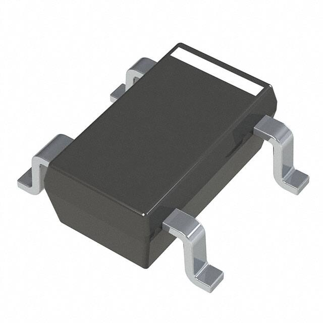

 R3111E (TO-92) is the discontinued product as of April, 2017. R3111x SERIES LOW VOLTAGE DETECTOR NO.EA-056-170428 OUTLINE The R3111x series are CMOS-based voltage detector ICs with high detector threshold accuracy and ultra-low supply current, which can be operated at an extremely low voltage and is used for system reset as an example. Each of these ICs consists of a voltage reference unit, a comparator, resistors for detector threshold setting, an output driver and a hysteresis circuit. The detector threshold is fixed with high accuracy internally and does not require any adjustment. Three output types, Nch open drain “L” type, Nch open drain “H” type and CMOS type are available. The R3111x Series are operable at a lower voltage than that for the Rx5VL series, and can be driven by a single battery. Seven types of packages, TO-92, SOT-89, SOT-23-3, SOT-23-5, SC-82AB, SC-88A and SON1612-6 are available. FEATURES  Supply Current ...................................................................... Typ. 0.8A (-VDET1.5V, VDD-VDET0.1V)  Operating Voltage Range...................................................... 0.7V to 10.0V (Ta25C)  Detector Threshold Range .................................................... 0.9V to 6.0V (0.1V steps) (For other voltages, please refer to MARK INFORMATIONS.)  Detector Threshold Accuracy ................................................ 2.0%  Temperature-Drift Coefficient of Detector Threshold ............ Typ. 100ppm/C  Output Types ......................................................................... Nch Open Drain “L”, Nch Open Drain “H”, and CMOS  Packages .............................................................................. SON1612-6, SC-82AB, SC-88A, SOT-23-3, SOT-23-5, SOT-89, TO-92 APPLICATIONS       CPU and Logic Circuit Reset Battery Checker Window Comparator Wave Shaping Circuit Battery Back-up Circuit Power Failure Detector 1  R3111E (TO-92) is the discontinued product as of April, 2017. R3111x BLOCK DIAGRAMS R3111xxxxA VDD R3111xxxxB OUT Vref OUT Vref GND R3111xxxxC VDD OUT Vref GND 2 VDD GND  R3111E (TO-92) is the discontinued product as of April, 2017. R3111x SELECTION GUIDE The package type, the detector threshold, the output type and the taping type for the ICs can be selected at the users’ request. The selection can be made with designating the part number as shown below; Product Name Package Quantity per Reel Pb Free Halogen Free R3111Dxx1-TR-FE SON1612-6 4,000 pcs Yes Yes R3111Qxx1-TR-FE SC-82AB 3,000 pcs Yes Yes R3111Qxx2-TR-FE SC-88A 3,000 pcs Yes Yes R3111Nxx1-TR-FE SOT-23-5 3,000 pcs Yes Yes R3111Nxx2$-TR-FE SOT-23-3 3,000 pcs Yes Yes R3111Hxx1$-T1-FE SOT-89 1,000 pcs Yes Yes TO-92 2,500 pcs Yes No R3111Exx1$-TZ-F xx : The detector threshold can be designated in the range from 0.9V(09) to 6.0V(60) in 0.1V steps. (For other voltages, please refer to MARK INFORMATIONS.)  : Designation of Output Type (A) Nch Open Drain (Output "L" at Detection) (B) Nch Open Drain (Output "H" at Detection) (C) CMOS (Output "L" at Detection) $ : Designation of Output Type (A) Nch Open Drain (Output "L" at Detection) (C) CMOS (Output "L" at Detection) 3  R3111E (TO-92) is the discontinued product as of April, 2017. R3111x PIN CONFIGURATIONS  TO-92  SOT-89  SOT-23-3  SOT-23-5 3 (mark side) (mark side) 1 1 2  SC-88A 5 3 (mark side) (mark side) 1 1 2 2 3 4  SON1612-6 6 (mark side) (mark side) 1 3 4 3  SC-82AB 4 2 5 1 2 2 3 5 4 (mark side) 1 2 3 PIN DESCRIPTIONS  TO-92  SOT-89  SOT-23-3  SOT-23-5 Pin No. Symbol Pin No. Symbol Pin No. Symbol Pin No. Symbol 1 VDD 1 OUT 1 OUT 1 OUT 2 GND 2 VDD 2 GND 2 VDD 3 OUT 3 GND 3 VDD 3 GND 4 NC 5 NC  SC-82AB  SC-88A  SON1612-6 Pin No. Symbol Pin No. Symbol Pin No. Symbol 1 OUT 1 OUT 1 OUT 2 VDD 2* NC 2 VDD 3 NC 3 VDD 3 GND 4 GND 4 NC 4 NC 5 GND 5 VDD 6 NC * Pin No. 2 is connected to the bottom of the IC. It is recommended that the pin be connected to the VDD pin on the board, or otherwise be left floating so that there is no contact with other potentials. 4  R3111E (TO-92) is the discontinued product as of April, 2017. R3111x ABSOLUTE MAXIMUM RATINGS Symbol VDD VOUT IOUT PD Ta Tstg Item Supply Voltage Output Voltage (CMOS) Output Voltage (Nch) Rating Unit 12 V VSS0.3 to VDD0.3 VSS0.3 to 12 Output Current 70 Power Dissipation (TO-92)* 300 Power Dissipation (SOT-89)* 900 Power Dissipation (SOT-23-3)* 420 Power Dissipation (SOT-23-5)* 420 Power Dissipation (SC-82AB)* 380 Power Dissipation (SC-88A)* 380 Power Dissipation (SON1612-6)* 500 V mA mW Operating Temperature Range 40 to 85 C Storage Temperature Range 55 to 125 C * ) For Power Dissipation, please refer to PACKAGE INFORMATION. ABSOLUTE MAXIMUM RATINGS Electronic and mechanical stress momentarily exceeded absolute maximum ratings may cause the permanent damages and may degrade the life time and safety for both device and system using the device in the field. The functional operation at or over these absolute maximum ratings is not assured. RECOMMENDED OPERATING CONDITIONS (ELECTRICAL CHARACTERISTICS) All of electronic equipment should be designed that the mounted semiconductor devices operate within the recommended operating conditions. The semiconductor devices cannot operate normally over the recommended operating conditions, even if when they are used over such conditions by momentary electronic noise or surge. And the semiconductor devices may receive serious damage when they continue to operate over the recommended operating conditions. 5  R3111E (TO-92) is the discontinued product as of April, 2017. R3111x ELECTRICAL CHARACTERISTICS  Ta25C R3111xxxxA Symbol Item -VDET Detector Threshold VHYS Detector Threshold Hysteresis Conditions 2.0V ≤ -VDET < 3.0V Supply Current 3.0V ≤ -VDET < 4.0V 4.0V ≤ -VDET < 5.0V 5.0V ≤ -VDET ≤ 6.0V VDDH Maximum Operating Voltage VDDL Minimum Operating Voltage1 Typ. Max. -VDET  0.05 -VDET  1.02 -VDET  0.07 VDD-VDET 0.10V 0.8 2.4 VDD-VDET +2.0V 1.0 3.0 VDD-VDET 0.10V 0.9 2.7 VDD-VDET +2.0V 1.1 3.3 VDD-VDET 0.13V 1.0 3.0 VDD-VDET +2.0V 1.2 3.6 VDD-VDET 0.16V 1.1 3.3 VDD-VDET +2.0V 1.3 3.9 VDD-VDET 0.20V 1.2 3.6 VDD-VDET +2.0V 1.4 4.2 -VDET  0.98 -VDET  0.03 0.9V ≤ -VDET < 2.0V ISS Min. 10 Ta25C 0.55 0.70 40C ≤ Ta ≤ 85C 0.65 0.80 VDS0.05V, VDD0.70V IOUT tPLH -VDET/ Ta Output Current (Driver Output Pin) Output Delay Time2 Detector Threshold Temperature Coefficient Nch 0.01 0.05 0.9V ≤ -VDET < 1.1V VDS0.50V VDD0.85V 0.05 0.5 1.1V ≤ -VDET < 1.6V VDS0.50V VDD1.00V 0.2 1.0 1.6V ≤ -VDET ≤ 6.0V VDS0.50V VDD1.50V 1.0 2.0 100 V V A V V mA mA 100 40C ≤ Ta ≤ 85C Unit s ppm/ C 1: Minimum operating voltage means the value of input voltage when output voltage maintains 0.1V or less. (In the case of the output pin is pulled up with a resistance of 470k to 5.0V.) 2: The output pin is pulled up with a resistance of 470k to 5.0V, the time interval between the rising edge of VDD input pulse from 0.7V to (VDET) 2.0V and output voltage level becoming to 2.5V. 6  R3111E (TO-92) is the discontinued product as of April, 2017. R3111x  Ta25C R3111xxxxB Symbol Item -VDET Detector Threshold VHYS Detector Threshold Hysteresis Conditions 2.0V ≤ -VDET < 3.0V Supply Current 3.0V ≤ -VDET < 4.0V 4.0V ≤ -VDET < 5.0V 5.0V ≤ -VDET ≤ 6.0V VDDH Maximum Operating Voltage VDDL Minimum Operating Voltage1 IOUT Output Current (Driver Output Pin) tPLH -VDET/ Ta Output Delay Time2 Detector Threshold Temperature Coefficient Typ. Max. -VDET  0.05 -VDET  1.02 -VDET  0.07 VDD-VDET 0.10V 0.8 2.4 VDD-VDET +2.0V 1.0 3.0 VDD-VDET 0.10V 0.9 2.7 -VDET  0.98 -VDET  0.03 0.9V ≤ -VDET < 2.0V ISS Min. VDD-VDET +2.0V 1.1 3.3 VDD-VDET 0.13V 1.0 3.0 VDD-VDET +2.0V 1.2 3.6 VDD-VDET 0.16V 1.1 3.3 VDD-VDET +2.0V 1.3 3.9 VDD-VDET 0.20V 1.2 3.6 VDD-VDET +2.0V 1.4 4.2 10 Ta25C 0.55 0.70 40C ≤ Ta ≤ 85C 0.65 0.80 Nch VDS0.10V, VDD6.5V 2.5 V V A V V mA 100 40C ≤ Ta ≤ 85C Unit 100 s ppm/ C 1: Minimum operating voltage means the value of input voltage when output voltage maintains 0.1V or less. (In the case of the output pin is pulled up with a resistance of 470k to 5.0V.) 2: The output pin is pulled up with a resistance of 470k to 5.0V, the time interval between the rising edge of VDD input pulse from 0.7V to (VDET) 2.0V and output voltage level becoming to 2.5V. 7  R3111E (TO-92) is the discontinued product as of April, 2017. R3111x  Ta25C R3111xxxxC Symbol Item -VDET Detector Threshold VHYS Detector Threshold Hysteresis Conditions 2.0V ≤ -VDET < 3.0V Supply Current 3.0V ≤ -VDET < 4.0V 4.0V ≤ -VDET < 5.0V 5.0V ≤ -VDET ≤ 6.0V VDDH Maximum Operating Voltage VDDL Minimum Operating Voltage1 Typ. Max. -VDET  0.05 -VDET  1.02 -VDET  0.07 VDD-VDET 0.10V 0.8 2.4 VDD-VDET +2.0V 1.0 3.0 VDD-VDET 0.10V 0.9 2.7 -VDET  0.98 -VDET  0.03 0.9V ≤ -VDET < 2.0V ISS Min. VDD-VDET +2.0V 1.1 3.3 VDD-VDET 0.13V 1.0 3.0 VDD-VDET +2.0V 1.2 3.6 VDD-VDET 0.16V 1.1 3.3 VDD-VDET +2.0V 1.3 3.9 VDD-VDET 0.20V 1.2 3.6 VDD-VDET +2.0V 1.4 4.2 10 Ta25C 0.55 0.70 40C ≤ Ta ≤ 85C 0.65 0.80 VDS0.05V, VDD0.70V Nch IOUT Output Current (Driver Output Pin) -VDET/ Ta Output Delay Time2 Detector Threshold Temperature Coefficient 0.05 0.9V ≤ -VDET < 1.1V VDS0.50V VDD0.85V 0.05 0.5 1.1V ≤ -VDET < 1.6V VDS0.50V VDD1.00V 0.2 1.0 1.6V ≤ -VDET ≤ 6.0V VDS0.50V VDD1.50V 1.0 2.0 0.9V ≤ -VDET < 4.0V VDS2.1V VDD4.5V 1.0 2.0 4.0V ≤ -VDET ≤ 6.0V VDS2.1V VDD8.0V 1.5 3.0 Pch tPLH 0.01 100 V V A V V mA mA 100 40C ≤ Ta ≤ 85C Unit s ppm/ C 1: Minimum operating voltage means the value of input voltage when output voltage maintains 0.1V or less. 2: The time interval between the rising edge of VDD input pulse from 0.7V to (VDET) 2.0V and output voltage level becoming to ((VDET)2.0V)/2. 8  R3111E (TO-92) is the discontinued product as of April, 2017. R3111x TIMING CHART Supply Voltage Released Voltage +VDET Detector Threshold -VDET (VDD) Detector Threshold Hysteresis Detector Threshold Hysteresis Detector Threshold Hysteresis Minimum Operating Voltage VDDL GND Pull-up Voltage Output Voltage (VOUT) GND R3111xxxxA tPLH R3111xxxxB tPLH R3111xxxxC tPLH DEFINITION OF OUTPUT DELAY TIME Output Delay Time (tPLH) is defined as follows: 1. In the case of Nch Open Drain Output:(R3111xxxxA/B) Under the condition of the output pin (OUT) is pulled up through a resistor of 470k to 5V, the time interval between the rising edge of VDD pulse from 0.7V to (VDET)2.0V and becoming of the output voltage to 2.5V. 2. In the case of CMOS Output:(R3111xxxxC) The time interval between the rising edge of VDD pulse from 0.7V to (VDET)2.0V and becoming of the output voltage to ((VDET)2.0V)/2. VDET2.0V Supply Voltage (VDD) VDET2.0V Supply Voltage (VDD) 0.7V GND Supply Voltage (VDD) 0.7V GND Output Voltage (VOUT) 2.5V GND tPHL tPLH Nch Open Drain Output (R3111xxxxA) 0.7V GND VDET2.0V 5.0V 5.0V Output Voltage (VOUT) VDET2.0V VDET2.0V Output 2 Voltage GND (VOUT) 2.5V GND tPHL tPLH tPHL tPLH Nch Open Drain Output CMOS Output (R3111xxxxB) (R3111xxxxC) 9  R3111E (TO-92) is the discontinued product as of April, 2017. R3111x ELECTRICAL CHARACTERISTICS BY DETECTOR THRESHOLD  R3111x09x to R3111x60x Part Number R3111x09xx R3111x10xx R3111x11xx R3111x12xx R3111x13xx R3111x14xx R3111x15xx R3111x16xx R3111x17xx R3111x18xx R3111x19xx R3111x20xx R3111x21xx R3111x22xx R3111x23xx R3111x24xx R3111x25xx R3111x26xx R3111x27xx R3111x28xx R3111x29xx R3111x30xx R3111x31xx R3111x32xx R3111x33xx R3111x34xx R3111x35xx R3111x36xx R3111x37xx R3111x38xx R3111x39xx R3111x40xx R3111x41xx R3111x42xx R3111x43xx R3111x44xx R3111x45xx R3111x46xx R3111x47xx R3111x48xx R3111x49xx R3111x50xx R3111x51xx R3111x52xx R3111x53xx R3111x54xx R3111x55xx R3111x56xx R3111x57xx R3111x58xx R3111x59xx R3111x60xx Detector Threshold Min. 0.882 0.980 1.078 1.176 1.274 1.372 1.470 1.568 1.666 1.764 1.862 1.960 2.058 2.156 2.254 2.352 2.450 2.548 2.646 2.744 2.842 2.940 3.038 3.136 3.234 3.332 3.430 3.528 3.626 3.724 3.822 3.920 4.018 4.116 4.214 4.312 4.410 4.508 4.606 4.704 4.802 4.900 4.998 5.096 5.194 5.292 5.390 5.488 5.586 5.684 5.782 5.880 -VDET[V] Typ. 0.900 1.000 1.100 1.200 1.300 1.400 1.500 1.600 1.700 1.800 1.900 2.000 2.100 2.200 2.300 2.400 2.500 2.600 2.700 2.800 2.900 3.000 3.100 3.200 3.300 3.400 3.500 3.600 3.700 3.800 3.900 4.000 4.100 4.200 4.300 4.400 4.500 4.600 4.700 4.800 4.900 5.000 5.100 5.200 5.300 5.400 5.500 5.600 5.700 5.800 5.900 6.000 Max. 0.918 1.020 1.122 1.224 1.326 1.428 1.530 1.632 1.734 1.836 1.938 2.040 2.142 2.244 2.346 2.448 2.550 2.652 2.754 2.856 2.958 3.060 3.162 3.264 3.366 3.468 3.570 3.672 3.774 3.876 3.978 4.080 4.182 4.284 4.386 4.488 4.590 4.692 4.794 4.896 4.998 5.100 5.202 5.304 5.406 5.508 5.610 5.712 5.814 5.916 6.018 6.120 Detector Threshold Hysteresis VHYS[V] Min. Typ. Max. 0.027 0.045 0.063 0.030 0.050 0.070 0.033 0.055 0.077 0.036 0.060 0.084 0.039 0.065 0.091 0.042 0.070 0.098 0.045 0.075 0.105 0.048 0.080 0.112 0.051 0.085 0.119 0.054 0.090 0.126 0.057 0.095 0.133 0.060 0.100 0.140 0.063 0.105 0.147 0.066 0.110 0.154 0.069 0.115 0.161 0.072 0.120 0.168 0.075 0.125 0.175 0.078 0.130 0.182 0.081 0.135 0.189 0.084 0.140 0.196 0.087 0.145 0.203 0.090 0.150 0.210 0.093 0.155 0.217 0.096 0.160 0.224 0.099 0.165 0.231 0.102 0.170 0.238 0.105 0.175 0.245 0.108 0.180 0.252 0.111 0.185 0.259 0.114 0.190 0.266 0.117 0.195 0.273 0.120 0.200 0.280 0.123 0.205 0.287 0.126 0.210 0.294 0.129 0.215 0.301 0.132 0.220 0.308 0.135 0.225 0.315 0.138 0.230 0.322 0.141 0.235 0.329 0.144 0.240 0.336 0.147 0.245 0.343 0.150 0.250 0.350 0.153 0.255 0.357 0.156 0.260 0.364 0.159 0.265 0.371 0.162 0.270 0.378 0.165 0.275 0.385 0.168 0.280 0.392 0.171 0.285 0.399 0.174 0.290 0.406 0.177 0.295 0.413 0.180 0.300 0.420 Supply Current 1 Condition ISS1[A] Typ. Supply Current 2 Max. 0.8 2.4 0.9 2.7 VDD (-VDET) 0.13V 1.0 3.0 VDD (-VDET) 0.16V 1.1 VDD (-VDET) 0.20V 1.2 Condition ISS2[A] Typ. 0.9 Max. 2.7 1.0 3.0 1.1 3.3 1.2 3.6 3.3 1.3 3.9 3.6 1.4 4.2 VDD (-VDET) 0.10V VDD (-VDET) 2.0V *1) In the case of CMOS output type; when the voltage is forced to VDD from 0.7V to (VDET)2.0V, time interval between the rising edge of VDD and the reaching point at ((VDET)2.0V)/2. In the case of Nch open drain output type : The output pin is pulled up to 5V through 470k, and when the voltage is forced to VDD from 0.7V to (VDET)2.0V, time interval between the rising edge of VDD and the reaching point at ((VDET)2.0V)/2. *2) VDD value when Output Voltage is equal or less than 0.1V. In the case of Nch open drain output type, the output pin is pulled up to 5V through 470k resistor. Condition 1: Ta25C Condition 2: 40C   Ta   85C 10  R3111E (TO-92) is the discontinued product as of April, 2017. R3111x Output Current 2 *3 Output Current 1 IOUT1[mA] Condition Min. Typ. IOUT2[mA] Condition Min. VDD 0.05 0.85V VDD 1.0V Nch VDS0.05V VDD0.7V 0.01 0.2 Typ. Output Delay Time tPLH[s] Max. Minimum Operating Voltage VDDL[V] Typ. Max. 100 *1 Condition 1 Condition 1 0.55 0.70 0.5 1.0 0.05 *2 Nch VDS 0.5V Nch VDS0.10V VDD6.5V 2.5 Detector Threshold Temperature Coefficient -VDET/Ta[ppm/C] Condition Typ. VDD 1.5V 1.0 2.0 *2 Condition 2 Condition 2 0.65 0.80 40C    Ta   85C 100 - *3) Only A/C versions. 11  R3111E (TO-92) is the discontinued product as of April, 2017. R3111x OPERATION  Operation of R3111xxxxA VDD Ra Comparator OUT OUT pin should be pulled-up to VDD or an external voltage level. Rb Vref Nch Tr.1 Rc GND Block Diagram (R3111xxxxA) 1 3 4 5 Step Released Voltage +VDET Detector Threshold -VDET 2 A Detector Threshold Hysteresis B Comparator () Pin Input Voltage Supply Voltage (VDD) Comparator Output Minimum Operating Voltage VDDL GND Tr.1 Output Tr. I Pull-up Voltage Output Delay Time Output Voltage (VOUT) tPLH II 1 2 3 4 5 I II II II I H L Indefinite L H OFF ON Indefinite ON OFF Nch OFF ON Indefinite ON OFF RbRc VDD RaRbRc Rb RaRb VDD GND Operation Diagram  Explanation of operation Step 1. The output voltage is equal to the pull-up voltage. Step 2. At Point “A”, Vref   VDD(RbRc)/(RaRbRc) is true, as a result, the output of comparator is reversed from "H" to "L", therefore the output voltage becomes the GND level. The voltage level of Point A means a detector threshold voltage (VDET). Step 3. When the supply voltage is lower than the minimum operating voltage, the operation of the output transistor becomes indefinite. The output voltage is equal to the pull-up voltage. Step 4. The output Voltage is equal to the GND level.  VDDRb/(RaRb) is true, as a result, the output of comparator is reversed from "L" to Step 5. At Point “B”, Vref  "H", then the output voltage is equal to the pull-up voltage. The voltage level of Point B means a released voltage (VDET). ) The difference between a released voltage and a detector threshold voltage is a detector threshold hysteresis. 12  R3111E (TO-92) is the discontinued product as of April, 2017. R3111x  Operation of R3111xxxxB VDD Ra Comparator OUT OUT pin should be pulled-up to VDD or an external voltage level. Rb Vref Nch Tr.1 Rc GND Block Diagram (R3111xxxxB) 1 3 Step Released Voltage +VDET Detector Threshold -VDET 2 A Detector Threshold Hysteresis B Supply Voltage (VDD) Minimum Operating Voltage VDDL GND 1 2 3 Comparator () Pin Input Voltage I II I Comparator Output L H L Tr.1 OFF ON OFF ON OFF ON Output Tr. I Pull-up Voltage Output Voltage (VOUT) Output Delay Time tPLH II Nch RbRc VDD RaRbRc Rb RaRb VDD GND Operation Diagram  Explanation of operation Step 1. The output voltage is equal to the GND level. Step 2. At Point “A”, Vref   VDD(RbRc)/(RaRbRc) is true, as a result, the output of comparator is reversed from "L" to "H", therefore the output voltage becomes the pull-up voltage. The voltage level of Point A means a detector threshold voltage (VDET). Step 3. At Point “B”, Vref   VDDRb/(RaRb) is true, as a result, the output of comparator is reversed from "H" to "L", then the output voltage is equal to the GND level. The voltage level of Point B means a released voltage (VDET). ) The difference between a released voltage and a detector threshold voltage is a detector threshold hysteresis. 13  R3111E (TO-92) is the discontinued product as of April, 2017. R3111x  Operation of R3111xxxxC VDD Comparator Ra Pch OUT Rb Vref Nch Tr.1 Rc GND Block Diagram (R3111xxxxC) 1 2 3 4 5 Step Released Voltage +VDET Detector Threshold -VDET A Detector Threshold Hysteresis B 2 3 4 5 I II II II I H L Indefinite L H Comparator (+) Pin Input Voltage Supply Voltage (VDD) Comparator Output Minimum Operating Voltage VDDL GND Tr.1 Output Tr. Output Delay Time Output Voltage (VOUT) 1 tPLH GND I II OFF ON Indefinite ON OFF Pch ON OFF Indefinite OFF ON Nch OFF ON Indefinite ON OFF RbRc VDD RaRbRc Rb RaRb VDD Operation Diagram  Explanation of operation Step 1. The output voltage is equal to the supply voltage (VDD). Step 2. At Point “A”, Vref   VDD(RbRc)/(RaRbRc) is true, as a result, the output of comparator is reversed from "H" to "L", therefore the output voltage becomes the GND level. The voltage level of Point A means a detector threshold voltage (VDET). Step 3. When the supply voltage is lower than the minimum operating voltage, the operation of the output transistor becomes indefinite. Step 4. The output Voltage is equal to the GND level. Step 5. At Point “B”, Vref   VDDRb/(RaRb) is true, as a result, the output of comparator is reversed from "L" to "H", then the output voltage is equal to the supply voltage (VDD). The voltage level of Point B means a released voltage (VDET). ) The difference between a released voltage and a detector threshold voltage is a detector threshold hysteresis. 14  R3111E (TO-92) is the discontinued product as of April, 2017. R3111x TEST CIRCUITS ISS VDD VIN 5V VDD R3111x Series VIN R3111x Series OUT 470k VOUT OUT GND GND Supply Current Test Circuit Detector Threshold Test Circuit (Pull-up circuit is not necessary for CMOS Output type.) VDD VDD VIN R3111x Series IOUT VIN OUT VDS GND R3111x Series VDS IOUT OUT VDDVDS GND Nch Driver Output Current Test Circuit Pch Driver Output Current Test Circuit Apply to CMOS Output type only +VDET+2.0V 0.7V GND 5V VDD R3111x Series P.G. ROUT 470k OUT GND +VDET+2.0V 0.7V GND VOUT COUT 5V RIN 470k VDD P.G. CIN R3111x Series ROUT 470k OUT GND VDS Output Delay Time Test Circuit (1) (Pull-up circuit is not necessary for VOUT VDS Output Delay Time Test Circuit (2) CMOS Output type.) 15  R3111E (TO-92) is the discontinued product as of April, 2017. R3111x  Power Dissipation (SON1612-6) Power Dissipation (PD) depends on conditions of mounting on board. This specification is based on the measurement at the condition below: Measurement Conditions Standard Land Pattern Environment Mounting on Board (Wind velocity 0m/s) Board Material Glass cloth epoxy plastic (Double layers) Board Dimensions 40mm  40mm  1.6mm Copper Ratio Top side: Approx. 50%, Back side: Approx. 50% Through - hole  0.5mm  24pcs Measurement Results (Ta=25C, Tjmax=125C) Standard Land Pattern Power Dissipation 500mW Thermal Resistance ja = (125-25C)/ 0.5W = 200C/W 39 500 On Board 39 300 27 400 40 Power Dissipation PD (mW) 600 200 100 0 0 25 50 75 85 100 125 Ambient Temperature (C) SON1612-6 Power Dissipation 150 27 40 Measurement Board Pattern IC Mount Area Unit : mm 16  R3111E (TO-92) is the discontinued product as of April, 2017. R3111x Package Dimensions (SON1612-6) 1 3 0.6MAX 1.6±0.05 4 1.2±0.05 6 (0.2) 1.6±0.1 0.125±0.055 0.08 0.22±0.05  0.5 (0.3) 0.3TYP. (0.3)  Unit: mm 0.08 M Mark Specification (SON1612-6)  : Product Code … Refer to Mark Specification Table (SON1612-6).  : Lot No. ………... Alphanumeric Serial Number 6 5 4   1 2 3 17  R3111E (TO-92) is the discontinued product as of April, 2017. R3111x  Marking Specification Table (SON1612-6) R3111Dxx1A 18 R3111Dxx1C R3111Dxx1B Part Number  Part Number  Part Number  R3111D091A A09A R3111D091C A09C R3111D091B A09B R3111D101A R3111D111A R3111D121A R3111D131A R3111D141A R3111D151A R3111D161A R3111D171A R3111D181A R3111D191A A10A A11A A12A A13A A14A A15A A16A A17A A18A A19A R3111D101C R3111D111C R3111D121C R3111D131C R3111D141C R3111D151C R3111D161C R3111D171C R3111D181C R3111D191C A10C A11C A12C A13C A14C A15C A16C A17C A18C A19C R3111D101B R3111D111B R3111D121B R3111D131B R3111D141B R3111D151B R3111D161B R3111D171B R3111D181B R3111D191B A10B A11B A12B A13B A14B A15B A16B A17B A18B A19B R3111D201A R3111D211A R3111D221A R3111D231A R3111D241A R3111D251A R3111D261A R3111D271A R3111D281A R3111D291A A20A A21A A22A A23A A24A A25A A26A A27A A28A A29A R3111D201C R3111D211C R3111D221C R3111D231C R3111D241C R3111D251C R3111D261C R3111D271C R3111D281C R3111D291C A20C A21C A22C A23C A24C A25C A26C A27C A28C A29C R3111D201B R3111D211B R3111D221B R3111D231B R3111D241B R3111D251B R3111D261B R3111D271B R3111D281B R3111D291B A20B A21B A22B A23B A24B A25B A26B A27B A28B A29B R3111D301A R3111D311A R3111D321A R3111D331A R3111D341A R3111D351A R3111D361A R3111D371A R3111D381A R3111D391A A30A A31A A32A A33A A34A A35A A36A A37A A38A A39A R3111D301C R3111D311C R3111D321C R3111D331C R3111D341C R3111D351C R3111D361C R3111D371C R3111D381C R3111D391C A30C A31C A32C A33C A34C A35C A36C A37C A38C A39C R3111D301B R3111D311B R3111D321B R3111D331B R3111D341B R3111D351B R3111D361B R3111D371B R3111D381B R3111D391B A30B A31B A32B A33B A34B A35B A36B A37B A38B A39B R3111D401A R3111D411A R3111D421A R3111D431A R3111D441A R3111D451A R3111D461A R3111D471A R3111D481A R3111D491A A40A A41A A42A A43A A44A A45A A46A A47A A48A A49A R3111D401C R3111D411C R3111D421C R3111D431C R3111D441C R3111D451C R3111D461C R3111D471C R3111D481C R3111D491C A40C A41C A42C A43C A44C A45C A46C A47C A48C A49C R3111D401B R3111D411B R3111D421B R3111D431B R3111D441B R3111D451B R3111D461B R3111D471B R3111D481B R3111D491B A40B A41B A42B A43B A44B A45B A46B A47B A48B A49B R3111D501A R3111D511A R3111D521A R3111D531A R3111D541A R3111D551A R3111D561A R3111D571A R3111D581A R3111D591A A50A A51A A52A A53A A54A A55A A56A A57A A58A A59A R3111D501C R3111D511C R3111D521C R3111D531C R3111D541C R3111D551C R3111D561C R3111D571C R3111D581C R3111D591C A50C A51C A52C A53C A54C A55C A56C A57C A58C A59C R3111D501B R3111D511B R3111D521B R3111D531B R3111D541B R3111D551B R3111D561B R3111D571B R3111D581B R3111D591B A50B A51B A52B A53B A54B A55B A56B A57B A58B A59B R3111D601A A60A R3111D601C A60C R3111D601B A60B  R3111E (TO-92) is the discontinued product as of April, 2017. R3111x  Power Dissipation (SC-82AB) Power Dissipation (PD) depends on conditions of mounting on board. This specification is based on the measurement at the condition below; Measurement Conditions Standard Land Pattern Environment Mounting on Board (Wind velocity=0m/s) Board Material Glass cloth epoxy plastic (Double Layers) Board Dimensions 40mm  40mm  1.6mm Copper Ratio Top side: Approx. 50%, Back side: Approx. 50% Through-hole 0.5mm  44pcs Measurement Result (Ta=25C, Tjmax=125C) Standard Land Pattern Free Air Power Dissipation 380mW 150mW Thermal Resistance ja=(125-25C)/0.38W=263C/W 667C/W 40 500 On Board 380 400 Free Air 300 200 40 Power Dissipation PD (mW) 600 150 100 0 0 25 50 75 85 100 125 Ambient Temperature (C) 150 Measurement Board Pattern IC Mount Area (Unit : mm) Power Dissipation 19  R3111E (TO-92) is the discontinued product as of April, 2017. R3111x Package Dimensions (SC-82AB) +0.05 1.0-0.2 2±0.2 1.3±0.2 0.9±0.1 0.3±0.1 0.3±0.1 3 +0.2 1.25-0.1 4 2.1±0.3 (0.7) 0.3±0.2  0 to 0.1 2 1 +0.1 0.16-0.06 0.4±0.1 0.3±0.1 0.05 Unit : mm  Mark Specification (SC-82AB)   : Product Code …Refer to Mark Specification Table (SC-82AB). : Lot No. ………... Alphanumeric Serial Number 3   4 1 20 2  R3111E (TO-92) is the discontinued product as of April, 2017. R3111x  Marking Specification Table (SC-82AB) R3111Qxx1A R3111Qxx1C R3111Qxx1B Part Number  Part Number  Part Number  R3111Q091A K9 R3111Q091C T9 R3111Q091B 09 R3111Q101A R3111Q111A R3111Q121A R3111Q131A R3111Q141A R3111Q151A R3111Q161A R3111Q171A R3111Q181A R3111Q191A L0 L1 L2 L3 L4 L5 L6 L7 L8 L9 R3111Q101C R3111Q111C R3111Q121C R3111Q131C R3111Q141C R3111Q151C R3111Q161C R3111Q171C R3111Q181C R3111Q191C U0 U1 U2 U3 U4 U5 U6 U7 U8 U9 R3111Q101B R3111Q111B R3111Q121B R3111Q131B R3111Q141B R3111Q151B R3111Q161B R3111Q171B R3111Q181B R3111Q191B 10 11 12 13 14 15 16 17 18 19 R3111Q201A R3111Q211A R3111Q221A R3111Q231A R3111Q241A R3111Q251A R3111Q261A R3111Q271A R3111Q281A R3111Q291A M0 M1 M2 M3 M4 M5 M6 M7 M8 M9 R3111Q201C R3111Q211C R3111Q221C R3111Q231C R3111Q241C R3111Q251C R3111Q261C R3111Q271C R3111Q281C R3111Q291C V0 V1 V2 V3 V4 V5 V6 V7 V8 V9 R3111Q201B R3111Q211B R3111Q221B R3111Q231B R3111Q241B R3111Q251B R3111Q261B R3111Q271B R3111Q281B R3111Q291B 20 21 22 23 24 25 26 27 28 29 R3111Q301A R3111Q311A R3111Q321A R3111Q331A R3111Q341A R3111Q351A R3111Q361A R3111Q371A R3111Q381A R3111Q391A N0 N1 N2 N3 N4 N5 N6 N7 N8 N9 R3111Q301C R3111Q311C R3111Q321C R3111Q331C R3111Q341C R3111Q351C R3111Q361C R3111Q371C R3111Q381C R3111Q391C W0 W1 W2 W3 W4 W5 W6 W7 W8 W9 R3111Q301B R3111Q311B R3111Q321B R3111Q331B R3111Q341B R3111Q351B R3111Q361B R3111Q371B R3111Q381B R3111Q391B 30 31 32 33 34 35 36 37 38 39 R3111Q401A R3111Q411A R3111Q421A R3111Q431A R3111Q441A R3111Q451A R3111Q461A R3111Q471A R3111Q481A R3111Q491A P0 P1 P2 P3 P4 P5 P6 P7 P8 P9 R3111Q401C R3111Q411C R3111Q421C R3111Q431C R3111Q441C R3111Q451C R3111Q461C R3111Q471C R3111Q481C R3111Q491C X0 X1 X2 X3 X4 X5 X6 X7 X8 X9 R3111Q401B R3111Q411B R3111Q421B R3111Q431B R3111Q441B R3111Q451B R3111Q461B R3111Q471B R3111Q481B R3111Q491B 40 41 42 43 44 45 46 47 48 49 R3111Q501A R3111Q511A R3111Q521A R3111Q531A R3111Q541A R3111Q551A R3111Q561A R3111Q571A R3111Q581A R3111Q591A R0 R1 R2 R3 R4 R5 R6 R7 R8 R9 R3111Q501C R3111Q511C R3111Q521C R3111Q531C R3111Q541C R3111Q551C R3111Q561C R3111Q571C R3111Q581C R3111Q591C Y0 Y1 Y2 Y3 Y4 Y5 Y6 Y7 Y8 Y9 R3111Q501B R3111Q511B R3111Q521B R3111Q531B R3111Q541B R3111Q551B R3111Q561B R3111Q571B R3111Q581B R3111Q591B 50 51 52 53 54 55 56 57 58 59 R3111Q601A S0 R3111Q601C Z0 R3111Q601B 60 21  R3111E (TO-92) is the discontinued product as of April, 2017. R3111x  Power Dissipation (SC-88A) Power Dissipation (PD) depends on conditions of mounting on board. This specification is based on the measurement at the condition below; Measurement Conditions Standard Land Pattern Environment Mounting on Board (Wind velocity=0m/s) Board Material Glass cloth epoxy plastic (Double Layers) Board Dimensions 40mm  40mm  1.6mm Copper Ratio Top side: Approx. 50%, Back side: Approx. 50% Through-hole 0.5mm  44pcs Measurement Result (Ta=25C, Tjmax=125C) Standard Land Pattern Free Air 380mW 150mW ja=(125-25C)/0.38W=263C/W ja=(125-25C)/0.15W=667C/W jc=75C/W - Power Dissipation Thermal Resistance 40 500 On Board 380 400 Free Air 300 200 40 Power Dissipation PD (mW) 600 150 100 0 0 25 50 75 85 100 125 Ambient Temperature (C) Power Dissipation 22 150 Measurement Board Pattern IC Mount Area (Unit : mm)  R3111E (TO-92) is the discontinued product as of April, 2017. R3111x Package Dimensions (SC-88A) 2.0±0.2 A 0.15±0.07 B 1.3±0.2 0.36±0.1  4 0.15 2.1±0.3 +0.2 1.25 -0.1 5 0~14 2 3 +0.1 0.65 +0.1 S  0.10 S AB 0~0.1 0.9 -0.2 0.2 -0.05 1.1Max. 1 0.10 S Unit : mm Mark Specification (SC-88A)  : Product Code …Refer to Mark Specification Table (SC-88A).  : Lot No. ………... Alphanumeric Serial Number 5 4 ①②③ ④⑤⑥ 1 2 3 23  R3111E (TO-92) is the discontinued product as of April, 2017. R3111x  Marking Specification Table (SC-88A) R3111Qxx2A R3111Qxx2C  Part Number  Part Number  R3111Q092A R3111Q102A R3111Q112A R3111Q122A R3111Q132A R3111Q142A R3111Q152A R3111Q162A R3111Q172A R3111Q182A R3111Q192A R3111Q202A R3111Q212A R3111Q222A R3111Q232A R3111Q242A R3111Q252A R3111Q262A R3111Q272A R3111Q282A R3111Q292A R3111Q302A R3111Q312A R3111Q322A R3111Q332A R3111Q342A R3111Q352A R3111Q362A R3111Q372A R3111Q382A R3111Q392A U0 09 U0 10 U 0 11 U0 12 U0 13 U0 14 U0 15 U0 16 U0 17 U0 18 U0 19 U0 20 U0 21 U0 22 U0 23 U0 24 U0 25 U0 26 U0 27 U0 28 U0 29 U0 30 U0 31 U0 32 U0 33 U0 34 U0 35 U0 36 U0 37 U0 38 U0 39 U0 40 U0 41 U0 42 U0 43 U0 44 U0 45 U0 46 U0 47 U0 48 U0 49 R3111Q092C R3111Q102C R3111Q112C R3111Q122C R3111Q132C R3111Q142C R3111Q152C R3111Q162C R3111Q172C R3111Q182C R3111Q192C R3111Q202C R3111Q212C R3111Q222C R3111Q232C R3111Q242C R3111Q252C R3111Q262C R3111Q272C R3111Q282C R3111Q292C R3111Q302C R3111Q312C R3111Q322C R3111Q332C R3111Q342C R3111Q352C R3111Q362C R3111Q372C R3111Q382C R3111Q392C R3111Q402C R3111Q412C R3111Q422C R3111Q432C R3111Q442C R3111Q452C R3111Q462C R3111Q472C R3111Q482C R3111Q492C R3111Q502C R3111Q512C R3111Q522C R3111Q532C R3111Q542C R3111Q552C R3111Q562C R3111Q572C R3111Q582C R3111Q592C R3111Q602C V0 09 V0 10 V011 V0 12 V0 13 V0 14 V0 15 V0 16 V0 17 V0 18 V0 19 V0 20 V0 21 V0 22 V0 23 V0 24 V0 25 V0 26 V0 27 V0 28 V0 29 V0 30 V0 31 V0 32 V0 33 V0 34 V0 35 V0 36 V0 37 V0 38 V0 39 V0 40 V0 41 V0 42 V0 43 V0 44 V0 45 V0 46 V0 47 V0 48 V0 49 V0 50 V0 51 V0 52 V0 53 V0 54 V0 55 V0 56 V0 57 V0 58 V0 59 V0 60 R3111Q092B R3111Q102B R3111Q112B R3111Q122B R3111Q132B R3111Q142B R3111Q152B R3111Q162B R3111Q172B R3111Q182B R3111Q192B R3111Q202B R3111Q212B R3111Q222B R3111Q232B R3111Q242B R3111Q252B R3111Q262B R3111Q272B R3111Q282B R3111Q292B R3111Q302B R3111Q312B R3111Q322B R3111Q332B R3111Q342B R3111Q352B R3111Q362B R3111Q372B R3111Q382B R3111Q392B R3111Q402B R3111Q412B R3111Q422B R3111Q432B R3111Q442B R3111Q452B R3111Q462B R3111Q472B R3111Q482B R3111Q492B R3111Q502B R3111Q512B R3111Q522B R3111Q532B R3111Q542B R3111Q552B R3111Q562B R3111Q572B R3111Q582B R3111Q592B R3111Q602B W0 09 W0 10 W011 W0 12 W0 13 W0 14 W0 15 W0 16 W0 17 W0 18 W0 19 W0 20 W0 21 W0 22 W0 23 W0 24 W0 25 W0 26 W0 27 W0 28 W0 29 W0 30 W0 31 W0 32 W0 33 W0 34 W0 35 W0 36 W0 37 W0 38 W0 39 W0 40 W0 41 W0 42 W0 43 W0 44 W0 45 W0 46 W0 47 W0 48 W0 49 W0 50 W0 51 W0 52 W0 53 W0 54 W0 55 W0 56 W0 57 W0 58 W0 59 W0 60 R3111Q402A R3111Q412A R3111Q422A R3111Q432A R3111Q442A R3111Q452A R3111Q462A R3111Q472A R3111Q482A R3111Q492A R3111Q502A R3111Q512A R3111Q522A R3111Q532A R3111Q542A R3111Q552A R3111Q562A R3111Q572A R3111Q582A R3111Q592A R3111Q602A R3111Q222A5 24 R3111Qxx2B Part Number U0 50 U0 51 U0 52 U0 53 U0 54 U0 55 U0 56 U0 57 U0 58 U0 59 U0 60 U0 01  R3111E (TO-92) is the discontinued product as of April, 2017. R3111x  Power Dissipation (SOT-23-5) Power Dissipation (PD) depends on conditions of mounting on board. This specification is based on the measurement at the condition below: (Power Dissipation (SOT-23-5) is substitution of SOT-23-6.) Measurement Conditions Standard Test Land Pattern Environment Mounting on Board (Wind velocity=0m/s) Board Material Glass cloth epoxy plastic (Double sided) Board Dimensions 40mm  40mm  1.6mm Copper Ratio Top side: Approx. 50%, Back side: Approx. 50% Through-holes  0.5mm  44pcs Measurement Result (Ta=25C, Tjmax=125C) Standard Land Pattern Free Air Power Dissipation 420mW 250mW Thermal Resistance ja = (125-25C)/0.42W = 238C/W 400C/W 40 500 On Board 420 400 300 Free Air 250 40 Power Dissipation PD (mW) 600 200 100 0 0 25 50 75 85 100 125 150 Measurement Board Pattern Ambient Temperature (C) Power Dissipation IC Mount Area (Unit: mm) 25  R3111E (TO-92) is the discontinued product as of April, 2017. R3111x  Package Dimensions (SOT-23-5) 2.9±0.2 1.1±0.1 1.9±0.2 0.8±0.1 (0.95) 4 1 2 0~0.1 0.2min. +0.2 1.6-0.1 5 2.8±0.3 (0.95) 3 +0.1 0.15-0.05 0.4±0.1 Unit : mm  Mark Specification (SOT-23-5)   : Product Code …Refer to Mark Specification Table (SOT-23-5). : Lot No. ………... Alphanumeric Serial Number 5 4  1 26 2 3  R3111E (TO-92) is the discontinued product as of April, 2017. R3111x  Marking Specification Table (SOT-23-5) R3111Nxx1A R3111Nxx1C R3111Nxx1B Part Number  Part Number  Part Number  R3111N091A 9A R3111N091C 9H R3111N091B D1 R3111N101A R3111N111A R3111N121A R3111N131A R3111N141A R3111N151A R3111N161A R3111N171A R3111N181A R3111N191A 0B 1B 2B 3B 4B 5B 6B 7B 8B 9B R3111N101C R3111N111C R3111N121C R3111N131C R3111N141C R3111N151C R3111N161C R3111N171C R3111N181C R3111N191C 0J 1J 2J 3J 4J 5J 6J 7J 8J 9J R3111N101B R3111N111B R3111N121B R3111N131B R3111N141B R3111N151B R3111N161B R3111N171B R3111N181B R3111N191B D2 D3 D4 D5 D6 D7 D8 D9 J1 J2 R3111N201A R3111N211A R3111N221A R3111N231A R3111N241A R3111N251A R3111N261A R3111N271A R3111N281A R3111N291A 0C 1C 2C 3C 4C 5C 6C 7C 8C 9C R3111N201C R3111N211C R3111N221C R3111N231C R3111N241C R3111N251C R3111N261C R3111N271C R3111N281C R3111N291C 0K 1K 2K 3K 4K 5K 6K 7K 8K 9K R3111N201B R3111N211B R3111N221B R3111N231B R3111N241B R3111N251B R3111N261B R3111N271B R3111N281B R3111N291B J3 J4 J5 J6 J7 EB EC ED EE EF R3111N301A R3111N311A R3111N321A R3111N331A R3111N341A R3111N351A R3111N361A R3111N371A R3111N381A R3111N391A 0D 1D 2D 3D 4D 5D 6D 7D 8D 9D R3111N301C R3111N311C R3111N321C R3111N331C R3111N341C R3111N351C R3111N361C R3111N371C R3111N381C R3111N391C 0L 1L 2L 3L 4L 5L 6L 7L 8L 9L R3111N301B R3111N311B R3111N321B R3111N331B R3111N341B R3111N351B R3111N361B R3111N371B R3111N381B R3111N391B EG EH EJ EK KB KC KD KE KF KG R3111N401A R3111N411A R3111N421A R3111N431A R3111N441A R3111N451A R3111N461A R3111N471A R3111N481A R3111N491A 0E 1E 2E 3E 4E 5E 6E 7E 8E 9E R3111N401C R3111N411C R3111N421C R3111N431C R3111N441C R3111N451C R3111N461C R3111N471C R3111N481C R3111N491C 0M 1M 2M 3M 4M 5M 6M 7M 8M 9M R3111N401B R3111N411B R3111N421B R3111N431B R3111N441B R3111N451B R3111N461B R3111N471B R3111N481B R3111N491B KH KJ KK QB QC QD QE QF QG QH R3111N501A R3111N511A R3111N521A R3111N531A R3111N541A R3111N551A R3111N561A R3111N571A R3111N581A R3111N591A 0F 1F 2F 3F 4F 5F 6F 7F 8F 9F R3111N501C R3111N511C R3111N521C R3111N531C R3111N541C R3111N551C R3111N561C R3111N571C R3111N581C R3111N591C 0N 1N 2N 3N 4N 5N 6N 7N 8N 9N R3111N501B R3111N511B R3111N521B R3111N531B R3111N541B R3111N551B R3111N561B R3111N571B R3111N581B R3111N591B QJ QK VB VC VD VE VF VG VH VJ R3111N601A 0G R3111N601C 0P R3111N601B VK 27  R3111E (TO-92) is the discontinued product as of April, 2017. R3111x  Power Dissipation (SOT-23-3) Power Dissipation (PD) depends on conditions of mounting on board. This specification is based on the measurement at the condition below: (Power Dissipation (SOT-23-3) is substitution of SOT-23-6.) Measurement Conditions Standard Test Land Pattern Environment Mounting on Board (Wind velocity=0m/s) Board Material Glass cloth epoxy plastic (Double sided) Board Dimensions 40mm  40mm  1.6mm Copper Ratio Top side: Approx. 50%, Back side: Approx. 50% Through-holes  0.5mm  44pcs Measurement Result (Ta=25C, Tjmax=125C) Standard Land Pattern Free Air Power Dissipation 420mW 250mW Thermal Resistance ja = (125-25C)/0.42W = 238C/W 400C/W 40 500 On Board 420 400 300 Free Air 250 40 Power Dissipation PD (mW) 600 200 100 0 0 25 50 75 85 100 125 150 Measurement Board Pattern Ambient Temperature (C) Power Dissipation 28 IC Mount Area (Unit: mm)  R3111E (TO-92) is the discontinued product as of April, 2017. R3111x  Package Dimensions (SOT-23-3) 1.4MAX. +0.2 1.1-0.1 2.9±0.2 0.4±0.1 0.8 3 1 0.2MIN. 2.8±0.3 1.6±0.2 0~0.1 2 (0.95) +0.1 0.16-0.06 (0.95) 1.9±0.2 Unit: mm  Mark Specification (SOT-23-3)   : Product Code …Refer to Mark Specification Table (SOT-23-3). : Lot No. ………... Alphanumeric Serial Number 3  1 2 29  R3111E (TO-92) is the discontinued product as of April, 2017. R3111x  Marking Specification Table (SOT-23-3) R3111Nxx2A 30 R3111Nxx2C Part Number  Part Number  R3111N092A A9 R3111N092C H9 R3111N102A R3111N112A R3111N122A R3111N132A R3111N142A R3111N152A R3111N162A R3111N172A R3111N182A R3111N192A B0 B1 B2 B3 B4 B5 B6 B7 B8 B9 R3111N102C R3111N112C R3111N122C R3111N132C R3111N142C R3111N152C R3111N162C R3111N172C R3111N182C R3111N192C J0 J1 J2 J3 J4 J5 J6 J7 J8 J9 R3111N202A R3111N212A R3111N222A R3111N232A R3111N242A R3111N252A R3111N262A R3111N272A R3111N282A R3111N292A C0 C1 C2 C3 C4 C5 C6 C7 C8 C9 R3111N202C R3111N212C R3111N222C R3111N232C R3111N242C R3111N252C R3111N262C R3111N272C R3111N282C R3111N292C K0 K1 K2 K3 K4 K5 K6 K7 K8 K9 R3111N302A R3111N312A R3111N322A R3111N332A R3111N342A R3111N352A R3111N362A R3111N372A R3111N382A R3111N392A D0 D1 D2 D3 D4 D5 D6 D7 D8 D9 R3111N302C R3111N312C R3111N322C R3111N332C R3111N342C R3111N352C R3111N362C R3111N372C R3111N382C R3111N392C L0 L1 L2 L3 L4 L5 L6 L7 L8 L9 R3111N402A R3111N412A R3111N422A R3111N432A R3111N442A R3111N452A R3111N462A R3111N472A R3111N482A R3111N492A E0 E1 E2 E3 E4 E5 E6 E7 E8 E9 R3111N402C R3111N412C R3111N422C R3111N432C R3111N442C R3111N452C R3111N462C R3111N472C R3111N482C R3111N492C M0 M1 M2 M3 M4 M5 M6 M7 M8 M9 R3111N502A R3111N512A R3111N522A R3111N532A R3111N542A R3111N552A R3111N562A R3111N572A R3111N582A R3111N592A F0 F1 F2 F3 F4 F5 F6 F7 F8 F9 R3111N502C R3111N512C R3111N522C R3111N532C R3111N542C R3111N552C R3111N562C R3111N572C R3111N582C R3111N592C N0 N1 N2 N3 N4 N5 N6 N7 N8 N9 R3111N602A G0 R3111N602C P0  R3111E (TO-92) is the discontinued product as of April, 2017. R3111x  Power Dissipation (SOT-89-3) Power Dissipation (PD) depends on conditions of mounting on board. This specification is based on the measurement at the condition below: Measurement Conditions Standard Land Pattern Environment Mounting on Board (Wind velocity=0m/s) Board Material Glass cloth epoxy plastic (Double sided) Board Dimensions 50mm  50mm  1.6mm Copper Ratio Top side : Approx. 10% , Back side : Approx. 100% Through-hole - Measurement Result (Ta=25C,Tjmax=125C) Standard Land Pattern Free Air Power Dissipation 900mW 500mW Thermal Resistance ja = (125-25C)/0.9W = 111C/W 200C/W 50 900 On Board 750 Free Air 50 Power Dissipation PD (mW) 1000 500 250 0 Measurement Board Pattern 0 25 50 75 85 100 Ambient Temperature (C) 125 150 IC Mount Area Unit : mm Power Dissipation 31  R3111E (TO-92) is the discontinued product as of April, 2017. R3111x Package Dimensions (SOT-89-3) 1.5±0.1 4.5±0.1 1.6±0.2 φ1.0 +0.25 4.0 -0.35 2.5±0.1 0.4±0.1 0.1 S 2 3 0.42±0.1 3 1.0±0.2 1 2 1 0.4±0.1 0.3±0.2  Bottom View S 0.42±0.1 0.47±0.1 Unit: mm 1.5±0.1 1.5±0.1  Mark Specification (SOT-89-3) 32 ④⑤⑥ ①②③  : Product Code …Refer to Mark Specification Table (SOT-89-3).  : Lot No. ………... Alphanumeric Serial Number  R3111E (TO-92) is the discontinued product as of April, 2017. R3111x  Marking Specification Table (SOT-89-3) R3111Hxx1A R3111Hxx1C Part Number  Part Number  R3111H091A A09A R3111H091C A09C R3111H101A R3111H111A R3111H121A R3111H131A R3111H141A R3111H151A R3111H161A R3111H171A R3111H181A R3111H191A A10A A11A A12A A13A A14A A15A A16A A17A A18A A19A R3111H101C R3111H111C R3111H121C R3111H131C R3111H141C R3111H151C R3111H161C R3111H171C R3111H181C R3111H191C A10C A11C A12C A13C A14C A15C A16C A17C A18C A19C R3111H201A R3111H211A R3111H221A R3111H231A R3111H241A R3111H251A R3111H261A R3111H271A R3111H281A R3111H291A A20A A21A A22A A23A A24A A25A A26A A27A A28A A29A R3111H201C R3111H211C R3111H221C R3111H231C R3111H241C R3111H251C R3111H261C R3111H271C R3111H281C R3111H291C A20C A21C A22C A23C A24C A25C A26C A27C A28C A29C R3111H301A R3111H311A R3111H321A R3111H331A R3111H341A R3111H351A R3111H361A R3111H371A R3111H381A R3111H391A A30A A31A A32A A33A A34A A35A A36A A37A A38A A39A R3111H301C R3111H311C R3111H321C R3111H331C R3111H341C R3111H351C R3111H361C R3111H371C R3111H381C R3111H391C A30C A31C A32C A33C A34C A35C A36C A37C A38C A39C R3111H401A R3111H411A R3111H421A R3111H431A R3111H441A R3111H451A R3111H461A R3111H471A R3111H481A R3111H491A A40A A41A A42A A43A A44A A45A A46A A47A A48A A49A R3111H401C R3111H411C R3111H421C R3111H431C R3111H441C R3111H451C R3111H461C R3111H471C R3111H481C R3111H491C A40C A41C A42C A43C A44C A45C A46C A47C A48C A49C R3111H501A R3111H511A R3111H521A R3111H531A R3111H541A R3111H551A R3111H561A R3111H571A R3111H581A R3111H591A A50A A51A A52A A53A A54A A55A A56A A57A A58A A59A R3111H501C R3111H511C R3111H521C R3111H531C R3111H541C R3111H551C R3111H561C R3111H571C R3111H581C R3111H591C A50C A51C A52C A53C A54C A55C A56C A57C A58C A59C R3111H601A A60A R3111H601C A60C 33  R3111E (TO-92) is the discontinued product as of April, 2017. R3111x TYPICAL CHARACTERISTICS 1) Supply Current vs. Input Voltage R3111x09xx R3111x27xx 2.0 Topt=85°C Supply Current ISS(μA) Supply Current ISS(μA) 2.5 2.0 1.5 25°C 1.0 -40°C 0.5 Topt=85°C 1.5 25°C 1.0 -40°C 0.5 0.0 0.0 0 2 4 6 Input Voltage VIN(V) 8 0 10 2 4 6 Input Voltage VIN(V) 8 10 R3111x45xx Supply Current ISS(μA) 2.0 Topt=85°C 1.5 25°C 1.0 -40°C 0.5 0.0 0 2 4 6 Input Voltage VIN(V) 8 10 2) Detector Threshold Hysteresis vs. Temperature R3111x09xx R3111x27xx 0.98 0.96 0.94 +VDET 0.92 0.90 -VDET 0.88 0.86 0.84 -60 34 2.9 Detector Threshold -VDET(V) Detector Threshold -VDET(V) 1.00 -40 -20 0 20 40 60 Temperature Topt(°C) 80 100 2.8 +VDET 2.7 -VDET 2.6 2.5 -60 -40 -20 0 20 40 60 Temperature Topt(°C) 80 100  R3111E (TO-92) is the discontinued product as of April, 2017. R3111x R3111x45xx Detector Threshold -VDET(V) 4.8 4.7 +VDET 4.6 4.5 -VDET 4.4 -60 -40 -20 0 20 40 60 Temperature Topt(°C) 80 100 3) Output Voltage vs. Input Voltage R3111x09xC R3111x09xA 5V Pull-up 470kΩ 6 1.4 Output Voltage VOUT(V) Output Voltage VOUT(V) 1.6 1.2 1.0 0.8 85°C 0.6 25°C Topt=-40°C 0.4 0.2 0.0 Topt=-40°C 5 4 25°C 3 2 85°C 1 0 0 0.2 0.4 0.6 0.8 1 1.2 Input Voltage VIN(V) 1.4 1.6 0 0.2 R3111x27xC Output Voltage VOUT(V) 3.5 3.0 2.5 2.0 85°C 1.0 25°C 0.5 1.6 5V Pull-up 470kΩ 6 1.5 1.4 R3111x27xA 4.0 Output Voltage VOUT(V) 0.4 0.6 0.8 1 1.2 Input Voltage VIN(V) 5 Topt=-40°C 4 25°C 3 85°C 2 1 Topt=-40°C 0.0 0 0 0.5 1 1.5 2 2.5 3 Input Voltage VIN(V) 3.5 4 0 0.5 1 1.5 2 2.5 3 Input Voltage VIN(V) 3.5 4 35  R3111E (TO-92) is the discontinued product as of April, 2017. R3111x R3111x45xC R3111x45xA 5V Pull-up 470kΩ 6 5 Output Voltage VOUT(V) Output Voltage VOUT(V) 6 4 3 2 85°C 25°C 1 Topt=-40°C 0 0 1 2 3 4 Input Voltage VIN(V) Topt=-40°C 5 25°C 4 85°C 3 2 1 0 5 6 0 1 2 3 4 Input Voltage VIN(V) 5 6 4) Nch Driver Output Current vs. VDS R3111x09xx R3111x09xx Topt=25°C 600 VDD=0.85V 500 400 300 200 0.7V 100 Topt=25°C 300 Output Current IOUT(μA) Output Current IOUT(μA) 700 250 VDD=0.8V 200 150 100 0.7V 50 0 0 0 0.2 0.4 VDS(V) 0.6 0.8 0 0.02 Topt=25°C 20 18 16 14 VDD=2.5V 12 10 8 6 4 2.0V 1.5V 2 0 0.1 Topt=25°C 300 250 VDD=0.8V 200 150 0.7V 100 50 0 0 36 0.08 R3111x27xx Output Current IOUT(μA) Output Current IOUT(mA) R3111x27xx 0.04 0.06 VDS(V) 0.5 1 1.5 VDS(V) 2 2.5 0 0.02 0.04 0.06 VDS(V) 0.08 0.1  R3111E (TO-92) is the discontinued product as of April, 2017. R3111x R3111x45xx R3111x45xx Topt=25°C VDD=4.5V 50 4.0V 40 3.5V 30 3.0V 20 2.5V 2.0V 10 Topt=25°C 300 Output Current IOUT(μA) Output Current IOUT(mA) 60 250 VDD=0.8V 200 150 0.7V 100 50 1.5V 0 0 0 0.5 1 1.5 2 2.5 VDS(V) 3 3.5 4 4.5 0 0.02 0.04 0.06 VDS(V) 0.08 0.1 5) Nch Driver Output Current vs. Input Voltage R3111x27xx 14 800 12 Output Current IOUT(mA) Output Current IOUT(μA) R3111x09xx 900 700 600 500 Topt=-85°C 400 300 25°C 200 100 0 -40°C 0 0.2 0.4 0.6 Input Voltage VIN(V) 10 Topt=-40°C 25°C 8 6 85°C 4 2 0 0.8 1 0 0.5 1 1.5 1 Input Voltage VIN(V) 2.5 3 R3111x45xx Output Current IOUT(mA) 25 20 Topt=-40°C 15 25°C 10 85°C 5 0 0 1 2 3 4 Input Voltage VIN(V) 5 6 37  R3111E (TO-92) is the discontinued product as of April, 2017. R3111x 6) Pch Driver Output Current vs. Input Voltage R3111x09xC 1.2 VDS=0.7V 1.0 0.8 0.6 0.5V 0.4 0.2 Topt=25°C 3.5 Output Current IOUT(mA) 1.4 Output Current IOUT(mA) R3111x27xC Topt=25°C 3.0 VDS=2.1V 2.5 2.0 1.5V 1.5 1.0V 1.0 0.5V 0.5 0.0 0.0 0 2 4 6 Input Voltage VIN(V) 8 0 1 2 3 4 5 Input Voltage VIN(V) 6 7 R3111x45xC Topt=25°C Output Current IOUT(mA) 4.5 4.0 3.5 VDS=2.1V 3.0 1.5V 2.5 2.0 1.0V 1.5 1.0 0.5V 0.5 0.0 0 2 4 6 8 Input Voltage VIN(V) 10 7) Output Delay Time vs. Load Capacitance (Ta25C) R3111x09xA R3111x27xA 10 1 tPLH 0.1 0.01 0.001 0.0001 38 100 Output Delay Time tP(ms) Output Delay Time tP(ms) 100 tPHL 0.001 0.01 Load Capacitance COUT(μF) 0.1 10 1 tPLH 0.1 0.01 0.001 0.0001 tPHL 0.001 0.01 Load Capacitance COUT(μF) 0.1  R3111E (TO-92) is the discontinued product as of April, 2017. R3111x R3111x45xA Output Delay Time tP(ms) 100 10 1 tPLH 0.1 0.01 0.001 0.0001 tPHL 0.001 0.01 Load Capacitance COUT(μF) 0.1 8) Output Delay Time vs. Input Pin Capacitance R3111x09xA R3111x27xA 100 Output Delay Time tP(ms) Output Delay Time tP(ms) 100 10 1 tPHL 0.1 0.01 0.001 0.0001 tPLH 0.001 0.01 Input Pin Capacitance CIN(μF) 0.1 10 1 tPLH 0.1 tPHL 0.01 0.001 0.0001 0.001 0.01 Input Pin Capacitance CIN(μF) 0.1 R3111x45xA Output Delay Time tP(ms) 100 10 1 tPLH 0.1 tPHL 0.01 0.001 0.001 0.01 0.1 Input Pin Capacitance CIN(μF) 1 39  R3111E (TO-92) is the discontinued product as of April, 2017. R3111x TYPICAL APPLICATION  R3111xxxxA CPU Reset Circuit (Nch Open Drain Output) Case 1. Input Voltage to R3111xxxxA is equal to Input Voltage to CPU Case 2. Input Voltage to R3111xxxxA is unequal to Input Voltage to CPU VDD VDD VDD 470k R3111xxxxA Series R GND GND  470k R3111xxxxA Series RESET OUT VDD2 VDD VDD CPU R OUT VDD CPU RESET GND GND R3111xxxxC CPU Reset Circuit (CMOS Output) VDD VDD VDD CPU R3111xxxxC Series RESET OUT GND GND  R3111xxxxA Output Delay Time Circuit 1 (Nch Open Drain Output)  R3111xxxxA Output Delay Time Circuit 2 (Nch Open Drain Output) VDD VDD 470k R3111xxxxA Series R VDD CPU VDD 100k RESET OUT VDD GND GND  470k R3111xxxxA Series R2 RESET OUT GND GND Memory Back-up Circuit VDD D1 VDD R3111xxxxC Series GND 40 R1 VDD CPU VCC D2 A B C GND OUT Y1 Y2 Y3 Y4 VCC VCC VCC VCC RAM1 RAM2 RAM3 RAM4 GND CS GND CS GND CS GND CS  R3111E (TO-92) is the discontinued product as of April, 2017. R3111x  Voltage level Indicator Circuit (lighted when the power runs out) (Nch Open Drain Output) VDD VDD R3111xxxxA Series OUT GND  Detector Threshold Adjustable Circuit (Nch Open Drain Output) Adjusted Detector Threshold (VDET)(RaRb)/Rb VDD OUT R3111xxxxA Series Ra VDD C + Hysteresis Voltage (VHYS)(RaRb)/Rb Rb ) If the value of Ra is set excessively large, voltage drop may occur caused by the supply current of IC itself, and detector threshold may vary. GND  Window Comparator Circuit (Nch Open Drain Output) VDD VDD R3111xxxxA OUT Series VDET1 R3111xxxxA VDET2 Series OUT VDET1 VDET2 VDD VDD WC_OUT GND GND WC_OUT GND GND Over-charge Preventing Circuit R1 R2 R3 D1 VDD OUT R3111xxxxC Series R4 Load Light Solar Battery  GND 41  R3111E (TO-92) is the discontinued product as of April, 2017. R3111x TECHNICAL NOTES When connecting resistors to the device’s input pin When connecting a resistor (R1) to an input of this device, the input voltage decreases by [Device’s Consumption Current] x [Resistance Value] only. And, the cross conduction current*1, which occurs when changing from the detecting state to the release state, is decreased the input voltage by [Cross Conduction Current] x [Resistance Value] only. And then, this device will enter the re-detecting state if the input voltage reduction is larger than the difference between the detector voltage and the released voltage. When the input resistance value is large and the VDD is gone up at mildly in the vicinity of the released voltage, repeating the above operation may result in the occurrence of output. As shown in Figure A/B, set R1 to become 100 kΩ or less as a guide, and connect CIN of 0.1 μF and more to between the input pin and GND. Besides, make evaluations including temperature properties under the actual usage condition, with using the evaluation board like this way. As a result, make sure that the cross conduction current has no problem. R1 R1 VDD CIN *2 Voltage Detector VDD R2 CIN *2 OUT pin GND Figure A *1 In the CMOS output type, a charging current for OUT pin is included. *2 Note the bias dependence of capacitors. 42 Voltage Detector GND Figure B OUT pin 1. The products and the product specifications described in this document are subject to change or discontinuation of production without notice for reasons such as improvement. Therefore, before deciding to use the products, please refer to Ricoh sales representatives for the latest information thereon. 2. The materials in this document may not be copied or otherwise reproduced in whole or in part without prior written consent of Ricoh. 3. Please be sure to take any necessary formalities under relevant laws or regulations before exporting or otherwise taking out of your country the products or the technical information described herein. 4. The technical information described in this document shows typical characteristics of and example application circuits for the products. The release of such information is not to be construed as a warranty of or a grant of license under Ricoh's or any third party's intellectual property rights or any other rights. 5. The products listed in this document are intended and designed for use as general electronic components in standard applications (office equipment, telecommunication equipment, measuring instruments, consumer electronic products, amusement equipment etc.). Those customers intending to use a product in an application requiring extreme quality and reliability, for example, in a highly specific application where the failure or misoperation of the product could result in human injury or death (aircraft, spacevehicle, nuclear reactor control system, traffic control system, automotive and transportation equipment, combustion equipment, safety devices, life support system etc.) should first contact us. 6. We are making our continuous effort to improve the quality and reliability of our products, but semiconductor products are likely to fail with certain probability. In order to prevent any injury to persons or damages to property resulting from such failure, customers should be careful enough to incorporate safety measures in their design, such as redundancy feature, fire containment feature and fail-safe feature. We do not assume any liability or responsibility for any loss or damage arising from misuse or inappropriate use of the products. 7. Anti-radiation design is not implemented in the products described in this document. 8. The X-ray exposure can influence functions and characteristics of the products. Confirm the product functions and characteristics in the evaluation stage. 9. WLCSP products should be used in light shielded environments. The light exposure can influence functions and characteristics of the products under operation or storage. 10. There can be variation in the marking when different AOI (Automated Optical Inspection) equipment is used. In the case of recognizing the marking characteristic with AOI, please contact Ricoh sales or our distributor before attempting to use AOI. 11. Please contact Ricoh sales representatives should you have any questions or comments concerning the products or the technical information. Halogen Free Ricoh is committed to reducing the environmental loading materials in electrical devices with a view to contributing to the protection of human health and the environment. Ricoh has been providing RoHS compliant products since April 1, 2006 and Halogen-free products since April 1, 2012. https://www.e-devices.ricoh.co.jp/en/ Sales & Support Offices Ricoh Electronic Devices Co., Ltd. Shin-Yokohama Office (International Sales) 2-3, Shin-Yokohama 3-chome, Kohoku-ku, Yokohama-shi, Kanagawa, 222-8530, Japan Phone: +81-50-3814-7687 Fax: +81-45-474-0074 Ricoh Americas Holdings, Inc. 675 Campbell Technology Parkway, Suite 200 Campbell, CA 95008, U.S.A. Phone: +1-408-610-3105 Ricoh Europe (Netherlands) B.V. Semiconductor Support Centre Prof. W.H. Keesomlaan 1, 1183 DJ Amstelveen, The Netherlands Phone: +31-20-5474-309 Ricoh International B.V. - German Branch Semiconductor Sales and Support Centre Oberrather Strasse 6, 40472 Düsseldorf, Germany Phone: +49-211-6546-0 Ricoh Electronic Devices Korea Co., Ltd. 3F, Haesung Bldg, 504, Teheran-ro, Gangnam-gu, Seoul, 135-725, Korea Phone: +82-2-2135-5700 Fax: +82-2-2051-5713 Ricoh Electronic Devices Shanghai Co., Ltd. Room 403, No.2 Building, No.690 Bibo Road, Pu Dong New District, Shanghai 201203, People's Republic of China Phone: +86-21-5027-3200 Fax: +86-21-5027-3299 Ricoh Electronic Devices Shanghai Co., Ltd. Shenzhen Branch 1205, Block D(Jinlong Building), Kingkey 100, Hongbao Road, Luohu District, Shenzhen, China Phone: +86-755-8348-7600 Ext 225 Ricoh Electronic Devices Co., Ltd. Taipei office Room 109, 10F-1, No.51, Hengyang Rd., Taipei City, Taiwan (R.O.C.) Phone: +886-2-2313-1621/1622 Fax: +886-2-2313-1623
R3111Q201B-TR-FE
物料型号:R3111x系列
器件简介:R3111x系列是CMOS基础的电压检测集成电路,具有高精度的检测阈值和超低的供电电流。这些IC能够在极低的电压下工作,例如用于系统重置。
引脚分配:文档提供了TO-92、SOT-89、SOT-23-3、SOT-23-5、SC-82AB、SC-88A和SON1612-6等封装的引脚分配图。
参数特性: - 供电电流:典型值0.8μA - 工作电压范围:0.7V至10.0V - 检测阈值范围:0.9V至6.0V(以0.1V步进) - 检测阈值精度:±2.0% - 检测阈值温度漂移系数:典型值±100ppm/°C
功能详解:R3111x系列由电压参考单元、比较器、用于设置检测阈值的电阻器、输出驱动器和滞后电路组成。检测阈值在内部高精度固定,无需调整。
应用信息:适用于CPU和逻辑电路重置、电池检查、窗口比较器、波形整形电路、电池备份电路和电源故障检测等。
封装信息:提供七种封装类型,包括TO-92、SOT-89、SOT-23-3、SOT-23-5、SC-82AB、SC-88A和SON1612-6。
