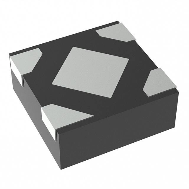

R3116x Series 0.8% Low Voltage Detector with Output Delay NO.EA-161-140819 OUTLINE The R3116x series are CMOS-based voltage detector ICs with high detector threshold accuracy and ultra-low supply current, which can be operated at an extremely low voltage and is used for system reset as an example. Each of these ICs consists of a voltage reference unit, a comparator, resistors for detector threshold setting, an output driver, a hysteresis circuit and an output delay circuit. The detector threshold is internally fixed with high accuracy and does not require any adjustment. Two output types, Nch open drain type and CMOS type are available. The R3116x series are operable at a lower voltage than that of the R3112x series, and can be driven by a single battery. Three types of packages, SOT-23-5, SC-82AB, and DFN(PLP)1010-4 are available. FEATURES • • • • • • • • • Supply Current ...................................................................... Typ. 0.35μA (-VDET=1.5V, VDD=-VDET+1V) Operating Voltage Range...................................................... 0.5V to 6.0V (Topt=25°C) Detector Threshold Range .................................................... 0.7V to 5.0V (0.1V step) Detector Threshold Accuracy ................................................ ±0.8% (-VDET ≥ 1.5V) Temperature-Drift Coefficient of Detector Threshold ............ Typ. ±30ppm/°C Built-in Output Delay Circuit .................................................. Typ. 100ms with an external capacitor: 0.022μF Output Delay Time Accuracy................................................. ±15% (-VDET ≥ 1.5V) Output Types ......................................................................... Nch Open Drain "L" and CMOS Packages .............................................................................. DFN(PLP)1010-4, SC-82AB, SOT-23-5 APPLICATIONS • • • • • • CPU and Logic Circuit Reset Battery Checker Window Comparator Wave Shaping Circuit Battery Back-up Circuit Power Failure Detector 1 R3116x NO.EA-161-140819 BLOCK DIAGRAMS Nch Open Drain Output (R3116xxx1A) VDD CMOS Output (R3116xxx1C) OUT VDD Delay Circuit Delay Circuit Vref OUT Vref GND GND CD CD SELECTION GUIDE The package type, the detector threshold, the output type and the taping type for the ICs can be selected at the users’ request. Product Name Package Quantity per Reel Pb Free Halogen Free DFN(PLP)1010-4 10,000 pcs Yes Yes R3116Qxx1∗-TR-FE SC-82AB 3,000 pcs Yes Yes R3116Nxx1∗-TR-FE SOT-23-5 3,000 pcs Yes Yes R3116Kxx1∗-TR xx : The detector threshold can be designated in the range from 0.7V(07) to 5.0V(50) in 0.1V step. ∗ : Designation of Output Type (A) Nch Open Drain (C) CMOS 2 R3116x NO.EA-161-140819 PIN DESCRIPTIONS • DFN(PLP)1010-4 Bottom View Top View 4 3 3 4 ∗ 1 2 2 • SOT-23-5 5 1 • SC-82AB 4 4 (mark side) (mark side) 1 • 2 1 OUT 2 CD 3 GND 4 VDD 1 3 • DFN(PLP)1010-4 Pin No. Symbol 3 Description SOT-23-5 Pin No. Symbol Output Pin 2 Description Output Pin 1 OUT Pin for External Capacitor (for setting output delay) 2 VDD Ground Pin 3 GND Input Pin 4 NC No Connection 5 CD Pin for External Capacitor (for setting output delay) ("L" at detection) ∗) Tab is GND level. (They are connected to the reverse side of this IC.) The tab is better to be connected to the GND, but leaving it open is also acceptable. • ("L" at detection) Input Pin Ground Pin SC-82AB Pin No. Symbol 1 VDD 2 GND 3 CD 4 OUT Description Input Pin Ground Pin Pin for External Capacitor (for setting output delay) Output Pin ("L" at detection) 3 R3116x NO.EA-161-140819 ABSOLUTE MAXIMUM RATINGS Symbol VDD Item Supply Voltage VOUT IOUT Output Voltage (Nch Open Drain Output) Unit 7.0 V VSS−0.3 to 7.0 VSS−0.3 to VDD+0.3 Output Voltage (CMOS Output) Output Current 20 Power Dissipation (SOT-23-5) ∗ V mA 420 Power Dissipation (SC-82AB)∗ PD Rating 380 ∗ Power Dissipation (DFN(PLP)1010-4) mW 400 Topt Operating Temperature Range −40 to 85 °C Tstg Storage Temperature Range −55 to 125 °C ∗ Please refer to PACKAGE INFORMATION for detailed information. ABSOLUTE MAXIMUM RATINGS Electronic and mechanical stress momentarily exceeded absolute maximum ratings may cause the permanent damages and may degrade the life time and safety for both device and system using the device in the field. The functional operation at or over these absolute maximum ratings is not assured. RECOMMENDED OPERATING CONDITIONS (ELECTRICAL CHARACTERISTICS) All of electronic equipment should be designed that the mounted semiconductor devices operate within the recommended operating conditions. The semiconductor devices cannot operate normally over the recommended operating conditions, even if when they are used over such conditions by momentary electronic noise or surge. And the semiconductor devices may receive serious damage when they continue to operate over the recommended operating conditions. 4 R3116x NO.EA-161-140819 ELECTRICAL CHARACTERISTICS • R3116xxx1A/C Symbol values indicate −40°C ≤ Topt ≤ 85°C, unless otherwise noted. Item Conditions 1.5V < -VDET ≤ 5.0V Topt=25°C -VDET Detector Threshold −40°C ≤ Topt ≤ 85°C VHYS Supply Current VDD=-VDET +1.0V VDDH Maximum Operating Voltage VDDL Minimum Operating Voltage∗1 tD V -12 +12 mV 1.5V < -VDET ≤ 5.0V -VDET × 1.015 V 0.7V ≤ -VDET ≤ 1.5V -22.5 +22.5 mV -VDET × 0.04 -VDET × 0.07 V 0.7V ≤ -VDET < 1.6V 1.400 1.6V ≤ -VDET < 3.1V 1.500 3.1V ≤ -VDET < 4.1V 1.600 4.1V ≤ -VDET ≤ 5.0V 1.700 0.7V ≤ -VDET < 1.6V 1.200 1.6V ≤ -VDET < 3.1V 1.200 3.1V ≤ -VDET < 4.1V 1.300 4.1V ≤ -VDET ≤ 5.0V 1.400 0.50 −40°C ≤ Topt ≤ 85°C 0.55 Output Current (Driver Output Pin) 0.7V ≤ -VDET < 1.1V VDD=0.6V, VDS=0.5V 0.020 1.1V ≤ -VDET < 1.6V VDD=1.0V, VDS=0.5V 0.400 1.6V ≤ -VDET < 3.1V VDD=1.5V, VDS=0.5V 1.000 3.1V ≤ -VDET ≤ 5.0V VDD=3.0V, VDS=0.5V 2.400 0.7V ≤ -VDET < 4.0V VDD=4.5V, VDS=−2.1V 0.650 4.0V ≤ -VDET ≤ 5.0V VDD=6.0V, VDS=−2.1V 0.900 Topt=25°C −40°C ≤ Topt ≤ 85°C 0.7V ≤ -VDET < 1.5V 80 1.5V ≤ -VDET ≤ 5.0V 85 0.7V ≤ -VDET < 1.5V 70 1.5V ≤ -VDET ≤ 5.0V 75 V mA 100 100 nA ppm /°C ±30 CD=0.022μF VDD=-VDET−0.1V to -VDET×1.1V V mA 80 Detector Threshold Temperature Coefficient μA μA 7 Nch Driver Leakage Current∗3 VDD=6.0V, VDS=7.0V Output Delay Time -VDET ×1.008 Topt=25°C Pch∗2 Δ-VDET/ ΔTopt Unit 6 Nch ILEAK -VDET × 0.992 Max. -VDET × 0.985 VDD=0.55V, VDS=0.05V IOUT Typ. 0.7V ≤ -VDET ≤ 1.5V Detector Threshold Hysteresis VDD=-VDET −0.1V ISS Min. (Topt=25°C) 130 115 150 ms 135 All of unit are tested and specified under load conditions such that Topt=25°C except for Detector Threshold Temperature Coefficient. *1: Minimum operating voltage means the value of input voltage when output voltage maintains 0.1V or less. (In case of Nch Open Drain Output type, the output pin is pulled up with a resistance of 470kΩ to 5.0V) *2: In case of CMOS type *3: In case of Nch Open Drain type 5 R3116x NO.EA-161-140819 TIMING CHART Supply Voltage (VDD) Released Voltage (+VDET) CD Pin Voltage CD Pin Threshold Voltage (VTCD) Detector Threshold (-VDET) GND Output Voltage (VOUT) GND Output Delay Time (tD) Detect Delay Time (tPHL) • When the supply voltage, which is higher than released voltage, is forced to VDD pin, charge to an external capacitor starts, then CD pin voltage increases. Until the CD pin voltage reaches to CD pin threshold voltage, output voltage maintains "L". When the CD pin voltage becomes higher than CD pin threshold voltage, output voltage is reversed from "L" to "H". Where the time interval between the rising edge of supply voltage and output voltage reverse point means output delay time. When the output voltage reverses from "L" to "H", the external capacitor starts to discharge. Therefore, when lower voltage than the detector threshold voltage is forced to VDD pin, the output voltage reverses from "H" to "L" thus the detect delay time is constant not being affected by the external capacitor. Output Delay Time Output Delay Time (tD) can be calculated with the next formula using the external capacitor: tD(s) = 4.5 × 106 × CD(F) DEFINITION OF OUTPUT DELAY TIME Output Delay Time (tD) is defined as follows: 1. In the case of Nch Open Drain Output: Under the condition of the output pin (OUT) is pulled up through a resistor of 470kΩ to 5V, the time interval between the rising edge of VDD pulse from (-VDET)−0.1V to (-VDET)×1.1V pulse voltage is supplied, the becoming of the output voltage to 2.5V. 2. In the case of CMOS Output: The time interval between the rising edge of VDD pulse from (-VDET)−0.1V to (-VDET)×1.1V pulse voltage is supplied, the becoming of the output voltage to ((-VDET)×1.1V)/2. −VDET×1.1V Supply Voltage (VDD) −VDET−0.1V Output Voltage (VOUT) −VDET×1.1V GND Supply Voltage (VDD) −VDET−0.1V GND 5.0V −VDET×1.1V 2.5V (−VDET×1.1V)/2 Output Voltage GND (VOUT) GND tPHL 6 tD tPHL Nch Open Drain Output CMOS Output (R3116xxx1A) (R3116xxx1C) tD R3116x NO.EA-161-140819 ELECTRICAL CHARACTERISTICS BY DETECTOR THRESHOLD • R3116x071A/C to R3116x501A/C Bold values are checked and guaranteed by design engineering at −40°C ≤ Topt ≤ 85°C, unless otherwise noted. (Topt=25°C) Part Number R3116x071A/C R3116x081A/C R3116x091A/C R3116x101A/C R3116x111A/C R3116x121A/C R3116x131A/C R3116x141A/C R3116x151A/C R3116x161A/C R3116x171A/C R3116x181A/C R3116x191A/C R3116x201A/C R3116x211A/C R3116x221A/C R3116x231A/C R3116x241A/C R3116x251A/C R3116x261A/C R3116x271A/C R3116x281A/C R3116x291A/C R3116x301A/C R3116x311A/C R3116x321A/C R3116x331A/C R3116x341A/C R3116x351A/C R3116x361A/C R3116x371A/C R3116x381A/C R3116x391A/C R3116x401A/C R3116x411A/C R3116x421A/C R3116x431A/C R3116x441A/C R3116x451A/C R3116x461A/C R3116x471A/C R3116x481A/C R3116x491A/C R3116x501A/C Detector Threshold1 -VDET1 [V] Min. 0.688 0.788 0.888 0.988 1.088 1.188 1.288 1.388 1.488 1.587 1.686 1.786 1.885 1.984 2.083 2.182 2.282 2.381 2.480 2.579 2.678 2.778 2.877 2.976 3.075 3.174 3.274 3.373 3.472 3.571 3.670 3.770 3.869 3.968 4.067 4.166 4.266 4.365 4.464 4.563 4.662 4.762 4.861 4.960 Max. 0.712 0.812 0.912 1.012 1.112 1.212 1.312 1.412 1.512 1.613 1.714 1.814 1.915 2.016 2.117 2.218 2.318 2.419 2.520 2.621 2.722 2.822 2.923 3.024 3.125 3.226 3.326 3.427 3.528 3.629 3.730 3.830 3.931 4.032 4.133 4.234 4.334 4.435 4.536 4.637 4.738 4.838 4.939 5.040 Detector Threshold2 -VDET2 [V] Min. 0.678 0.778 0.878 0.978 1.078 1.178 1.278 1.378 1.478 1.576 1.675 1.773 1.872 1.970 2.069 2.167 2.266 2.364 2.463 2.561 2.660 2.758 2.857 2.955 3.054 3.152 3.251 3.349 3.448 3.546 3.645 3.743 3.842 3.940 4.039 4.137 4.236 4.334 4.433 4.531 4.630 4.728 4.827 4.925 Max. 0.723 0.823 0.923 1.023 1.123 1.223 1.323 1.423 1.523 1.624 1.726 1.827 1.929 2.030 2.132 2.233 2.335 2.436 2.538 2.639 2.741 2.842 2.944 3.045 3.147 3.248 3.350 3.451 3.553 3.654 3.756 3.857 3.959 4.060 4.162 4.263 4.365 4.466 4.568 4.669 4.771 4.872 4.974 5.075 Detector Threshold Supply Current1 Hysteresis VHYS [V] Min. 0.028 0.032 0.036 0.040 0.044 0.048 0.052 0.056 0.060 0.064 0.068 0.072 0.076 0.080 0.084 0.088 0.092 0.096 0.100 0.104 0.108 0.112 0.116 0.120 0.124 0.128 0.132 0.136 0.140 0.144 0.148 0.152 0.156 0.160 0.164 0.168 0.172 0.176 0.180 0.184 0.188 0.192 0.196 0.200 Max. 0.049 0.056 0.063 0.070 0.077 0.084 0.091 0.098 0.105 0.112 0.119 0.126 0.133 0.140 0.147 0.154 0.161 0.168 0.175 0.182 0.189 0.196 0.203 0.210 0.217 0.224 0.231 0.238 0.245 0.252 0.259 0.266 0.273 0.280 0.287 0.294 0.301 0.308 0.315 0.322 0.329 0.336 0.343 0.350 ISS1 [µA] Cond. Max. Supply Current2 Max. Op. Min. Op. Voltage Voltage ISS2 [µA] VDDH [V] VDDL [V] Cond. Max. Max. Max. 1.400 1.200 1.500 0.50 VDD= -VDET +1.0V VDD= -VDET -0.1V 6 0.55 ∗Note1 1.600 1.300 1.700 1.400 ∗Note1) VDD value when output voltage is equal or less than 0.1V. In the case of Nch Open Drain output type, the output pin is pulled up to 5.0V through 470kΩ resistor. 7 R3116x NO.EA-161-140819 Nch Driver Output Current1 IOUT1 [µA] Cond. Nch Driver Output Current2 IOUT2 [mA] Min. Cond. VDD= 0.6V VDS= 0.5V VDD= 1.0V Min. Pch Driver Output Current IOUT3 [mA] Cond. Min. Nch Driver Leakage Current ILEAK [nA] Cond. Max. Detector Threshold Temperature Coefficient ∆-VDET/∆Topt [ppm/°C] Typ. Output Delay Time tD [ms] Cond. Min. Max. 0.020 80 130 70 150 VDD= -VDET -0.1V ↓ -VDET ×1.1V 85 115 ∗Note2 75 135 0.400 VDS= 0.5V VDD= 4.5V VDD= 1.5V 1.000 VDS= 0.5V 0.650 CD= 0.022μF VDS= -2.1V VDD= 0.55V VDD= 6.0V 7 80 VDS= 0.05V VDS= 7.0V ±30 VDD= 3.0V 2.400 VDS= 0.5V VDD= 6.0V 0.900 VDS= -2.1V ∗Note2) 1. In the case of CMOS output type: When the voltage is forced from (-VDET)−0.1V to (-VDET)×1.1V pulse voltage is added to VDD, time interval that the output voltage reaches ((-VDET)×1.1V)/2. 2. In the case of Nch Open Drain output type: The output pin is pulled up to 5.0V through 470kΩ, and when the voltage is forced from (-VDET)−0.1V to (-VDET)×1.1V pulse voltage is added to VDD, time interval that the output voltage reaches 2.5V. 8 R3116x NO.EA-161-140819 TYPICAL APPLICATION • R3116xxx1A CPU Reset Circuit 1 (Nch Open Drain Output) Case1. Input Voltage to R3116xxx1A is equal to Input Voltage to CPU Case2. Input Voltage to R3116xxx1A is unequal to Input Voltage to CPU VDD VDD CD 470kΩ R R3116xxx1A Series OUT VDD1 RESET CD GND GND • VDD2 VDD VDD CPU 470kΩ R3116xxx1A Series OUT R VDD CPU RESET GND GND R3116xxx1C CPU Reset Circuit 2 (CMOS Output) VDD VDD CD R3116xxx1C Series OUT VDD CPU RESET GND GND • Memory Back-up Circuit VDD VCC D1 D2 A B C Y1 Y2 Y3 Y4 VCC VCC VCC VCC RAM1 RAM2 RAM3 RAM4 GND CS GND CS GND CS GND CS VDD CD R3116xxx1C Series GND OUT GND 9 R3116x NO.EA-161-140819 • Voltage level Indicator Circuit (lighted when the power runs out) (Nch Open Drain Output) VDD VDD CD R3116xxx1A Series OUT GND • Detector Threshold Adjustable Circuit 1 (Nch Open Drain Output) Vup VDD Ra VDD OUT Rup R3116xxx1A Series GND • Hysteresis Voltage=(VHYS)×(Ra+Rb)/Rb ∗1) To prevent oscillation, set Ra < = 1kΩ, Rb < = 100Ω. ∗2) If the value of Ra is set excessively large, voltage drop may occur caused by the supply current of IC itself, and detector threshold and hysteresis voltage may vary. ∗3) If Vup and VDD are connected, the voltage dropdown caused by Rup, may cause difference in the hysteresis voltage. CD Rb Adjustable Detector Threshold=(-VDET)×(Ra+Rb)/Rb Detector Threshold Adjustable Circuit 2 (Nch Open Drain Output) Adjustable Detector Threshold=(-VDET)×(Ra+Rb)/Rb Vup VDD Ra VDD Rb C OUT R3116xxx1A Series CD GND 10 Rup Hysteresis Voltage=(VHYS)×(Ra+Rb)/Rb ∗1) To prevent oscillation, set Ra < = 10kΩ, Rb < = 1kΩ, > C = 1μF. ∗2) If the value of Ra is set excessively large, voltage drop may occur caused by the supply current of IC itself, and detector threshold and hysteresis voltage may vary. ∗3) If Vup and VDD are connected, the voltage dropdown caused by Rup, may cause difference in the hysteresis voltage. ∗4) If the value of Ra, Rb and C are set excessively large, the delay of the start-up may become too long. R3116x NO.EA-161-140819 • Window Comparator Circuit (Nch Open Drain Output) VDD VDD Rup1 CD R3116xxx1A Series OUT −VDET2 −VDET2 WC_OUT GND GND OUT −VDET1 Rup2 CD R3116xxx1A Series VDD VDD −VDET1 WC_OUT GND GND Over-charge Preventing Circuit R1 R2 R3 D1 VDD OUT R3116xxx1C Series R4 Load Light Solar Battery • GND 11 R3116x NO.EA-161-140819 TECHNICAL NOTES When connecting resistors to the device’s input pin When connecting a resistor (R1) to an input of this device, the input voltage decreases by [Device’s Consumption Current] x [Resistance Value] only. And, the cross conduction current*1, which occurs when changing from the detecting state to the release state, is decreased the input voltage by [Cross Conduction Current] x [Resistance Value] only. And then, this device will enter the re-detecting state if the input voltage reduction is larger than the difference between the detector voltage and the released voltage. When the input resistance value is large and the VDD is gone up at mildly in the vicinity of the released voltage, repeating the above operation may result in the occurrence of output. As shown in Figure A/B, set R1 to become 100kΩ or less as a guide, and connect CIN of 0.1μF and more to between the input pin and GND. Besides, make evaluations including temperature properties under the actual usage condition, with using the evaluation board like this way. As result, make sure that the cross conduction current has no problem. R1 R1 VDD CIN *2 Voltage VDD R2 CIN *2 OUT pin Detector GND Figure A *1 In the CMOS output type, a charging current for OUT pin is included. *2 Note the bias dependence of capacitors. 12 Voltage Detector GND Figure B OUT pin R3116x NO.EA-161-140819 OPERATION • Operation of R3116xxx1A VDD Ra Comparator Delay Circuit OUT pin should be pulled-up to VDD or an external voltage level. OUT Rb Vref Nch Tr.1 Rc GND CD Block Diagram (R3116xxx1A) 1 2 3 4 5 Step 1 2 3 4 5 Comparator (−) Pin Input Voltage I II II II I Comparator Output L H Indefinite H L Released Voltage +VDET Detector Threshold -VDET A Detector Threshold Hysteresis B Supply Voltage (VDD) Minimum Operating Voltage VDDL GND Tr.1 Output Tr. I Pull-up Voltage Output Voltage (VOUT) Detect Delay Time tPHL Output Delay Time tD II OFF ON Indefinite ON OFF Nch OFF ON Indefinite ON OFF Rb+Rc ×VDD Ra+Rb+Rc Rb Ra+Rb ×VDD GND Operation Diagram • Explanation of operation Step 1. The output voltage is equal to the pull-up voltage. Step 2. At Point "A", Vref > = VDD×(Rb+Rc)/(Ra+Rb+Rc) is true, as a result, the output of comparator is reversed from "L" to "H", therefore the output voltage becomes the GND level. The voltage level of Point A means a detector threshold voltage (-VDET). Step 3. When the supply voltage is lower than the minimum operating voltage, the operation of the output transistor becomes indefinite. The output voltage is equal to the pull-up voltage. Step 4. The output voltage is equal to the GND level. Step 5. At Point "B", Vref < = VDD×Rb/(Ra+Rb) is true, as a result, the output of comparator is reversed from "H" to "L", then the output voltage is equal to the pull-up voltage. The voltage level of Point B means a released voltage (+VDET). ∗) The difference between a released voltage and a detector threshold voltage is a detector threshold hysteresis. 13 R3116x NO.EA-161-140819 • Operation of R3116xxx1C VDD Comparator Ra Pch Delay Circuit OUT Rb Vref Nch Tr.1 Rc GND CD Block Diagram (R3116xxx1C) 1 2 3 4 5 Step Released Voltage +VDET Detector Threshold -VDET A Detector Threshold Hysteresis B Supply Voltage (VDD) 1 2 3 4 5 Comparator (−) Pin Input Voltage I II II II I Comparator Output L H Indefinite H L Minimum Operating Voltage VDDL GND Tr.1 Output Tr. Output Voltage (VOUT) Detect Delay Time tPHL Output Delay Time tD GND I II OFF ON Indefinite ON OFF Pch ON OFF Indefinite OFF ON Nch OFF ON Indefinite ON OFF Rb+Rc ×VDD Ra+Rb+Rc Rb Ra+Rb ×VDD Operation Diagram • Explanation of operation Step 1. The output voltage is equal to the supply voltage (VDD). Step 2. At Point "A", Vref > = VDD×(Rb+Rc)/(Ra+Rb+Rc) is true, as a result, the output of comparator is reversed from "L" to "H", therefore the output voltage becomes the GND level. The voltage level of Point A means a detector threshold voltage (-VDET). Step 3. When the supply voltage is lower than the minimum operating voltage, the operation of the output transistor becomes indefinite. Step 4. The output voltage is equal to the GND level. Step 5. At Point "B", Vref < = VDD×Rb/(Ra+Rb) is true, as a result, the output of comparator is reversed from "H" to "L", then the output voltage is equal to the supply voltage (VDD). The voltage level of Point B means a released voltage (+VDET). ∗) The difference between a released voltage and a detector threshold voltage is a detector threshold hysteresis. 14 R3116x NO.EA-161-140819 Detector Operation vs. glitch input voltage to the VDD pin When the R3116x is at released, if the pulse voltage which the detector threshold or lower voltage, the graph below means that the relation between pulse width and the amplitude of the swing to keep the released state for the R3116x. 100 90 80 70 60 50 40 30 20 10 0 R3116x501A/C R3116x071A/C 10 100 Over Drive Voltage (mV) CD=0.022μF, VDD=-VDET×1.1→ -VDET−VOD (R3116x071A/C, R3116x501A/C) Pulse Width (μs) Pulse Width (μs) CD=0.022μF, VDD=-VDET+2V→ -VDET−VOD (R3116x071A/C) VDD=-VDET+1V→ -VDET−VOD (R3116x501A/C) 100 90 80 70 60 50 40 30 20 10 0 1000 R3116x501A/C R3116x071A/C 10 100 Over Drive Voltage (mV) 1000 ∗VOD: Over Drive Voltage Pulse Width Supply Voltage (VDD) Detector Threshold (-VDET) Over Drive VDD Input Waveform This graph shows the maximum pulse conditions to keep the released voltage. If the pulse with larger amplitude or wider width than the graph above, is input to VDD pin, the reset signal may be output. 15 R3116x NO.EA-161-140819 PACKAGE INFORMATION POWER DISSIPATION (DFN(PLP)1010-4) Power Dissipation (PD) depends on conditions of mounting on board. This specification is based on the measurement at the condition below: Measurement Conditions Standard Test Land Pattern Environment Mounting on Board (Wind velocity=0m/s) Board Material Glass cloth epoxy plastic (Double sided) Board Dimensions 40mm*40mm*1.6mm Copper Ratio Top side: Approx. 50%, Back side: Approx. 50% Through-holes φ 0.54mm * 24pcs Measurement Result: (Ta=25°C, Tjmax=125°C) Standard Test Land Pattern Power Dissipation 400mW θja = (125-25°C)/0.4W = 250°C/W Thermal Resistance θjc = 67 °C/W 40 500 On Board 400 300 40 Power Dissipation PD (mW) 600 200 100 0 0 25 50 75 85 100 125 150 Measurement Board Pattern Ambient Temperature (°C) Power Dissipation 16 IC Mount Area (Unit : mm) R3116x NO.EA-161-140819 B A 0.48 ±0.05 0.65 3 X4 4 0.25±0.05 1.00 0.07±0.05 PACKAGE DIMENSIONS (DFN(PLP)1010-4) ※ 0.05 0.6MAX. 3-C0.18 2 1 0.48 ±0.05 0.25±0.05 Bottom View S 0.05 S 0.32±0.05 0.25±0.05 1.00 INDEX 0.05MIN. 45° 0.05 M S AB (Unit: mm) *)The tab on the bottom of the package enhances thermal performance and is electrically connected to GND (substrate level). It is recommended that the tab be connected to the ground plane on the board, or otherwise be left floating. MARK SPECIFICATION (DFN(PLP)1010-4) cd: Product Code … Refer to MARK SPECIFICATION TABLE ef: Lot Number … Alphanumeric Serial Number ①② ③④ 17 R3116x NO.EA-161-140819 MARK SPECIFICATION TABLE (DFN(PLP)1010-4) R3116Kxx1A 18 R3116Kxx1C Product Name cd VSET Product Name cd VSET R3116K071A R3116K081A R3116K091A R3116K101A R3116K111A R3116K121A R3116K131A R3116K141A R3116K151A R3116K161A R3116K171A R3116K181A R3116K191A R3116K201A R3116K211A R3116K221A R3116K231A R3116K241A R3116K251A R3116K261A R3116K271A R3116K281A R3116K291A R3116K301A R3116K311A R3116K321A R3116K331A R3116K341A R3116K351A R3116K361A R3116K371A R3116K381A R3116K391A R3116K401A R3116K411A R3116K421A R3116K431A R3116K441A R3116K451A R3116K461A R3116K471A R3116K481A R3116K491A R3116K501A HA HB HC HD HE HF HG HH HJ HK HL HM HN HP HQ HR HS HT HU HV HW HX HY HZ JA JB JC JD JE JF JG JH JJ JK JL JM JN JP JQ JR JS JT JU JV 0.7V 0.8V 0.9V 1.0V 1.1V 1.2V 1.3V 1.4V 1.5V 1.6V 1.7V 1.8V 1.9V 2.0V 2.1V 2.2V 2.3V 2.4V 2.5V 2.6V 2.7V 2.8V 2.9V 3.0V 3.1V 3.2V 3.3V 3.4V 3.5V 3.6V 3.7V 3.8V 3.9V 4.0V 4.1V 4.2V 4.3V 4.4V 4.5V 4.6V 4.7V 4.8V 4.9V 5.0V R3116K071C R3116K081C R3116K091C R3116K101C R3116K111C R3116K121C R3116K131C R3116K141C R3116K151C R3116K161C R3116K171C R3116K181C R3116K191C R3116K201C R3116K211C R3116K221C R3116K231C R3116K241C R3116K251C R3116K261C R3116K271C R3116K281C R3116K291C R3116K301C R3116K311C R3116K321C R3116K331C R3116K341C R3116K351C R3116K361C R3116K371C R3116K381C R3116K391C R3116K401C R3116K411C R3116K421C R3116K431C R3116K441C R3116K451C R3116K461C R3116K471C R3116K481C R3116K491C R3116K501C KA KB KC KD KE KF KG KH KJ KK KL KM KN KP KQ KR KS KT KU KV KW KX KY KZ LA LB LC LD LE LF LG LH LJ LK LL LM LN LP LQ LR LS LT LU LV 0.7V 0.8V 0.9V 1.0V 1.1V 1.2V 1.3V 1.4V 1.5V 1.6V 1.7V 1.8V 1.9V 2.0V 2.1V 2.2V 2.3V 2.4V 2.5V 2.6V 2.7V 2.8V 2.9V 3.0V 3.1V 3.2V 3.3V 3.4V 3.5V 3.6V 3.7V 3.8V 3.9V 4.0V 4.1V 4.2V 4.3V 4.4V 4.5V 4.6V 4.7V 4.8V 4.9V 5.0V R3116x NO.EA-161-140819 POWER DISSIPATION (SC-82AB) Power Dissipation (PD) depends on conditions of mounting on board. This specification is based on the measurement at the condition below; * Measurement Conditions Standard Land Pattern Environment Mounting on Board (Wind velocity=0m/s) Board Material Glass cloth epoxy plastic (Double Layers) Board Dimensions 40mm × 40mm × 1.6mm Copper Ratio Top side: Approx. 50%, Back side: Approx. 50% Through-hole φ0.5mm × 44pcs * Measurement Result (Ta=25°C, Tjmax=125°C) Standard Land Pattern Free Air Power Dissipation 380mW 150mW Thermal Resistance θja = (125-25°C)/0.38W = 263°C/W 667°C/W 40 500 On Board 380 400 Free Air 300 40 Power Dissipation PD (mW) 600 200 150 100 0 0 25 50 75 85 100 125 150 Measurement Board Pattern Ambient Temperature (°C) IC Mount Area (Unit : mm) Power Dissipation 19 R3116x NO.EA-161-140819 PACKAGE DIMENSIONS (SC-82AB) 1.3±0.2 0.9±0.1 0.3±0.1 0.3±0.1 3 +0.2 1.25-0.1 4 2.1±0.3 (0.7) 0.3±0.2 +0.05 1.0-0.2 2±0.2 0 to 0.1 2 1 0.4±0.1 0.3±0.1 +0.1 0.16-0.06 0.05 Unit : mm MARK SPECIFICATION (SC-82AB) cd: Product Code … Refer to MARK SPECIFICATION TABLE ef: Lot Number … Alphanumeric Serial Number 3 cd ef 4 1 20 2 R3116x NO.EA-161-140819 MARK SPECIFICATION TABLE (SC-82AB) R3116Qxx1A Product Name R3116Q071A R3116Q081A R3116Q091A R3116Q101A R3116Q111A R3116Q121A R3116Q131A R3116Q141A R3116Q151A R3116Q161A R3116Q171A R3116Q181A R3116Q191A R3116Q201A R3116Q211A R3116Q221A R3116Q231A R3116Q241A R3116Q251A R3116Q261A R3116Q271A R3116Q281A R3116Q291A R3116Q301A R3116Q311A R3116Q321A R3116Q331A R3116Q341A R3116Q351A R3116Q361A R3116Q371A R3116Q381A R3116Q391A R3116Q401A R3116Q411A R3116Q421A R3116Q431A R3116Q441A R3116Q451A R3116Q461A R3116Q471A R3116Q481A R3116Q491A R3116Q501A R3116Qxx1C cd L0 L1 L2 L3 L4 L5 L6 L7 L8 L9 M0 M1 M2 M3 M4 M5 M6 M7 M8 M9 N0 N1 N2 N3 N4 N5 N6 N7 N8 N9 P0 P1 P2 P3 P4 P5 P6 P7 P8 P9 Q0 Q1 Q2 Q3 VSET 0.7V 0.8V 0.9V 1.0V 1.1V 1.2V 1.3V 1.4V 1.5V 1.6V 1.7V 1.8V 1.9V 2.0V 2.1V 2.2V 2.3V 2.4V 2.5V 2.6V 2.7V 2.8V 2.9V 3.0V 3.1V 3.2V 3.3V 3.4V 3.5V 3.6V 3.7V 3.8V 3.9V 4.0V 4.1V 4.2V 4.3V 4.4V 4.5V 4.6V 4.7V 4.8V 4.9V 5.0V Product Name R3116Q071C R3116Q081C R3116Q091C R3116Q101C R3116Q111C R3116Q121C R3116Q131C R3116Q141C R3116Q151C R3116Q161C R3116Q171C R3116Q181C R3116Q191C R3116Q201C R3116Q211C R3116Q221C R3116Q231C R3116Q241C R3116Q251C R3116Q261C R3116Q271C R3116Q281C R3116Q291C R3116Q301C R3116Q311C R3116Q321C R3116Q331C R3116Q341C R3116Q351C R3116Q361C R3116Q371C R3116Q381C R3116Q391C R3116Q401C R3116Q411C R3116Q421C R3116Q431C R3116Q441C R3116Q451C R3116Q461C R3116Q471C R3116Q481C R3116Q491C R3116Q501C cd R0 R1 R2 R3 R4 R5 R6 R7 R8 R9 S0 S1 S2 S3 S4 S5 S6 S7 S8 S9 T0 T1 T2 T3 T4 T5 T6 T7 T8 T9 U0 U1 U2 U3 U4 U5 U6 U7 U8 U9 V0 V1 V2 V3 VSET 0.7V 0.8V 0.9V 1.0V 1.1V 1.2V 1.3V 1.4V 1.5V 1.6V 1.7V 1.8V 1.9V 2.0V 2.1V 2.2V 2.3V 2.4V 2.5V 2.6V 2.7V 2.8V 2.9V 3.0V 3.1V 3.2V 3.3V 3.4V 3.5V 3.6V 3.7V 3.8V 3.9V 4.0V 4.1V 4.2V 4.3V 4.4V 4.5V 4.6V 4.7V 4.8V 4.9V 5.0V 21 R3116x NO.EA-161-140819 POWER DISSIPATION (SOT-23-5) Power Dissipation (PD) depends on conditions of mounting on board. This specification is based on the measurement at the condition below: (Power Dissipation (SOT-23-5) is substitution of SOT-23-6.) * Measurement Conditions Standard Test Land Pattern Environment Mounting on Board (Wind velocity=0m/s) Board Material Glass cloth epoxy plastic (Double sided) Board Dimensions 40mm*40mm*1.6mm Copper Ratio Top side: Approx. 50%, Back side: Approx. 50% Through-holes φ 0.5mm * 44pcs * Measurement Result: .................................. (Ta=25°C, Tjmax=125°C) Standard Land Pattern Free Air Power Dissipation 420mW 250mW Thermal Resistance θja = (125-25°C)/0.42W= 238°C/W 400°C/W 40 500 On Board 420 400 300 Free Air 250 40 Power Dissipation PD (mW) 600 200 100 0 0 25 50 75 85 100 125 150 Measurement Board Pattern Ambient Temperature (°C) Power Dissipation 22 IC Mount Area (Unit: mm) R3116x NO.EA-161-140819 PACKAGE DIMENSIONS (SOT-23-5) 2.9±0.2 1.1±0.1 1.9±0.2 0.8±0.1 (0.95) 4 1 2 0~0.1 0.2min. +0.2 1.6-0.1 5 2.8±0.3 (0.95) 3 +0.1 0.15-0.05 0.4±0.1 Unit : mm MARK SPECIFICATION (SOT-23-5) cde: Product Code … Refer to MARK SPECIFICATION TABLE fg: Lot Number … Alphanumeric Serial Number 5 4 cdefg 1 2 3 23 R3116x NO.EA-161-140819 MARK SPECIFICATION TABLE (SOT-23-5) R3116Nxx1A Product Name R3116N071A R3116N081A R3116N091A R3116N101A R3116N111A R3116N121A R3116N131A R3116N141A R3116N151A R3116N161A R3116N171A R3116N181A R3116N191A R3116N201A R3116N211A R3116N221A R3116N231A R3116N241A R3116N251A R3116N261A R3116N271A R3116N281A R3116N291A R3116N301A R3116N311A R3116N321A R3116N331A R3116N341A R3116N351A R3116N361A R3116N371A R3116N381A R3116N391A R3116N401A R3116N411A R3116N421A R3116N431A R3116N441A R3116N451A R3116N461A R3116N471A R3116N481A R3116N491A R3116N501A 24 cde D0A D0B D0C D0D D0E D0F D0G D0H D0J D0K D0L D0M D0N D0P D0Q D0R D0S D0T D0U D0V D0W D0X D0Y D0Z E0A E0B E0C E0D E0E E0F E0G E0H E0J E0K E0L E0M E0N E0P E0Q E0R E0S E0T E0U E0V VSET 0.7V 0.8V 0.9V 1.0V 1.1V 1.2V 1.3V 1.4V 1.5V 1.6V 1.7V 1.8V 1.9V 2.0V 2.1V 2.2V 2.3V 2.4V 2.5V 2.6V 2.7V 2.8V 2.9V 3.0V 3.1V 3.2V 3.3V 3.4V 3.5V 3.6V 3.7V 3.8V 3.9V 4.0V 4.1V 4.2V 4.3V 4.4V 4.5V 4.6V 4.7V 4.8V 4.9V 5.0V R3116Nxx1C Product Name R3116N071C R3116N081C R3116N091C R3116N101C R3116N111C R3116N121C R3116N131C R3116N141C R3116N151C R3116N161C R3116N171C R3116N181C R3116N191C R3116N201C R3116N211C R3116N221C R3116N231C R3116N241C R3116N251C R3116N261C R3116N271C R3116N281C R3116N291C R3116N301C R3116N311C R3116N321C R3116N331C R3116N341C R3116N351C R3116N361C R3116N371C R3116N381C R3116N391C R3116N401C R3116N411C R3116N421C R3116N431C R3116N441C R3116N451C R3116N461C R3116N471C R3116N481C R3116N491C R3116N501C cde D1A D1B D1C D1D D1E D1F D1G D1H D1J D1K D1L D1M D1N D1P D1Q D1R D1S D1T D1U D1V D1W D1X D1Y D1Z E1A E1B E1C E1D E1E E1F E1G E1H E1J E1K E1L E1M E1N E1P E1Q E1R E1S E1T E1U E1V VSET 0.7V 0.8V 0.9V 1.0V 1.1V 1.2V 1.3V 1.4V 1.5V 1.6V 1.7V 1.8V 1.9V 2.0V 2.1V 2.2V 2.3V 2.4V 2.5V 2.6V 2.7V 2.8V 2.9V 3.0V 3.1V 3.2V 3.3V 3.4V 3.5V 3.6V 3.7V 3.8V 3.9V 4.0V 4.1V 4.2V 4.3V 4.4V 4.5V 4.6V 4.7V 4.8V 4.9V 5.0V R3116x NO.EA-161-140819 TYPICAL CHARACTERISTICS Note: Typical Characteristics are intended to be used as reference data; they are not guaranteed. 1) Supply Current vs. Input Voltage R3116x071A/C 1.0 Topt=85°C Topt=25°C Topt=- 40°C 0.8 Supply Current ISS (μA) Supply Current ISS (μA) 1.0 R3116x151A/C 0.6 0.4 0.2 0 Topt=85°C Topt=25°C Topt=- 40°C 0.8 0.6 0.4 0.2 0 0 1 2 3 4 5 Input Voltage VDD (V) 6 7 0 1 R3116x271A/C 1.0 Topt=85°C Topt=25°C Topt=- 40°C Supply Current ISS (μA) Supply Current ISS (μA) 6 7 6 7 R3116x451A/C 1.0 0.8 2 3 4 5 Input Voltage VDD (V) 0.6 0.4 0.2 0 Topt=85°C Topt=25°C Topt=- 40°C 0.8 0.6 0.4 0.2 0 0 1 2 3 4 5 Input Voltage VDD (V) 6 7 0 1 2 3 4 5 Input Voltage VDD (V) 2) Detector Threshold vs. Temperature R3116x151A/C 0.75 0.74 +VDET 0.73 0.72 0.71 -VDET 0.70 0.69 -40 -25 0 25 50 Temperature Topt (°C) 75 85 Detector Threshold/Released Voltage VDET (V) Detector Threshold/Released Voltage VDET (V) R3116x071A/C 1.60 1.58 +VDET 1.56 1.54 1.52 1.50 1.48 -40 -25 -VDET 0 25 50 Temperature Topt (°C) 75 85 25 R3116x NO.EA-161-140819 R3116x451A/C 2.90 +VDET 2.85 2.80 2.75 -VDET 2.70 2.65 -40 -25 0 25 50 Temperature Topt (°C) 75 85 Detector Threshold/Released Voltage VDET (V) Detector Threshold/Released Voltage VDET (V) R3116x271A/C 4.9 4.8 +VDET 4.7 4.6 -VDET 4.5 4.4 -40 -25 0 25 50 Temperature Topt (°C) 75 85 3) Output Voltage vs. Input Voltage R3116x071C R3116x151C 2.5 Output Voltage VOUT (V) Output Voltage VOUT (V) 1.2 1.0 Topt=- 40°C Topt=25°C Topt=85°C 0.8 0.6 0.4 0.2 0 2.0 1.5 1.0 0.5 0 0 0.2 0.4 0.6 0.8 Input Voltage VDD (V) 1.0 0 R3116x271C 2.0 6 3.0 Output Voltage VOUT (V) Output Voltage VOUT (V) 0.4 0.8 1.2 1.6 Input Voltage VDD (V) R3116x451C 3.5 Topt=- 40°C Topt=25°C Topt=85°C 2.5 2.0 1.5 1.0 0.5 0 5 4 Topt=- 40°C Topt=25°C Topt=85°C 3 2 1 0 0 26 Topt=- 40°C Topt=25°C Topt=85°C 0.5 1.0 1.5 2.0 2.5 Input Voltage VDD (V) 3.0 0 0.5 1.0 1.5 2.0 2.5 3.0 3.5 4.0 4.5 5.0 Input Voltage VDD (V) R3116x NO.EA-161-140819 R3116x071A R3116x151A 470kΩ 5V Pull-Up 470kΩ 5V Pull-Up 6 5 4 Topt=- 40°C Topt=25°C Topt=85°C 3 2 1 Output Voltage VOUT (V) Output Voltage VOUT (V) 6 0 5 4 Topt=- 40°C Topt=25°C Topt=85°C 3 2 1 0 0 0.2 0.4 0.6 0.8 Input Voltage VDD (V) 1.0 0 R3116x271A 0.4 0.8 1.2 1.6 Input Voltage VDD (V) R3116x451A 470kΩ 5V Pull-Up 470kΩ 5V Pull-Up 6 Output Voltage VOUT (V) 6 Output Voltage VOUT (V) 2.0 5 4 Topt=- 40°C Topt=25°C Topt=85°C 3 2 1 0 5 4 Topt=- 40°C Topt=25°C Topt=85°C 3 2 1 0 0 0.5 1.0 1.5 2.0 2.5 Input Voltage VDD (V) 3.0 0 0.5 1.0 1.5 2.0 2.5 3.0 3.5 4.0 4.5 5.0 Input Voltage VDD (V) 4) Nch Driver Output Current vs. Input Voltage (VDS=0.5V) R3116x151A/C 0.25 Topt=- 40°C Topt=25°C Topt=85°C 0.20 0.15 0.10 0.05 0 0 0.2 0.4 0.6 0.8 Input Voltage VDD (V) 1.0 Nch Driver Output Current IOUT (mA) Nch Driver Output Current IOUT (mA) R3116x071A/C 3.0 Topt=- 40°C Topt=25°C Topt=85°C 2.5 2.0 1.5 1.0 0.5 0 0 0.5 1.0 1.5 Input Voltage VDD (V) 2.0 27 R3116x NO.EA-161-140819 R3116x451A/C 7.5 Topt=- 40°C Topt=25°C Topt=85°C 6.0 4.5 3.0 1.5 0 0 0.5 1.0 1.5 2.0 2.5 Input Voltage VDD (V) 3.0 Nch Driver Output Current IOUT (mA) Nch Driver Output Current IOUT (mA) R3116x271A/C 12 Topt=- 40°C Topt=25°C Topt=85°C 10 8 6 4 2 0 0 1 2 3 4 Input Voltage VDD (V) 5 5) Nch Driver Output Current vs. VDS 0.20 0.15 0.10 VDD=0.6V 0.05 0 0 0.2 0.4 0.6 Nch Driver Output Current IOUT (mA) R3116x151A/C 0.8 Nch Driver Output Current IOUT (mA) Nch Driver Output Current IOUT (mA) R3116x071A/C 20 0.6 0.4 VDD=1.0V VDD=0.6V 0.2 0 0 0.2 0.4 0.6 VDS (V) VDS (V) Nch Driver Output Current IOUT (mA) R3116x271A/C 28 6 4 VDD=2.0V VDD=1.0V VDD=0.6V 0 0 0.5 1.0 VDS (V) 1.0 R3116x451A/C 8 2 0.8 1.5 2.0 15 10 VDD=4.0V VDD=3.0V VDD=2.0V VDD=1.0V VDD=0.6V 5 0 0 1.0 2.0 VDS (V) 3.0 4.0 R3116x NO.EA-161-140819 6) Pch Driver Output Current vs. Input Voltage (VDS=−2.1V) R3116x151C Topt=- 40°C Topt=25°C Topt=85°C 1.5 1.0 0.5 0 0 1 2 3 4 5 Input Voltage VDD (V) 6 7 Pch Driver Output Current IOUT (mA) Pch Driver Output Current IOUT (mA) R3116x071C 2.0 2.0 Topt=- 40°C Topt=25°C Topt=85°C 1.5 1.0 0.5 0 0 1 2 3 4 5 Input Voltage VDD (V) 2.0 Topt=- 40°C Topt=25°C Topt=85°C 1.5 1.0 0.5 0 0 1 2 3 4 5 Input Voltage VDD (V) 7 6 7 R3116x451C 6 7 Pch Driver Output Current IOUT (mA) Pch Driver Output Current IOUT (mA) R3116x271C 6 2.0 Topt=- 40°C Topt=25°C Topt=85°C 1.5 1.0 0.5 0 0 1 2 3 4 5 Input Voltage VDD (V) 7) Pch Driver Output Current vs. VDS 2.5 R3116x151C VDD=6.0V VDD=5.0V VDD=4.0V VDD=3.0V VDD=2.0V VDD=1.0V 2.0 1.5 1.0 0.5 0 0 1 2 3 VDS (V) 4 5 6 Pch Driver Output Current IOUT (mA) Pch Driver Output Current IOUT (mA) R3116x071C 2.5 VDD=6.0V VDD=5.0V VDD=4.0V VDD=3.0V VDD=2.0V 2.0 1.5 1.0 0.5 0 0 1 2 3 VDS (V) 4 5 6 29 R3116x NO.EA-161-140819 2.5 R3116x451C VDD=6.0V VDD=5.0V VDD=4.0V VDD=3.0V 2.0 1.5 1.0 0.5 0 0 1 2 3 VDS (V) 4 5 6 Pch Driver Output Current IOUT (mA) Pch Driver Output Current IOUT (mA) R3116x271C 2.5 VDD=6.0V VDD=5.0V 2.0 1.5 1.0 0.5 0 0 1 2 3 VDS (V) 4 5 6 8) Output Delay Time vs. External Capacitance R3116x071A/C R3116x151A/C 1000 Delay Time tD/tPHL (ms) Delay Time tD/tPHL (ms) 1000 100 tD 10 1 0.1 0.01 0.0001 tPHL 0.001 0.01 External Capacitance CD (μF) 100 tD 10 1 0.1 0.01 0.0001 0.1 R3116x271A/C Delay Time tD/tPHL (ms) Delay Time tD/tPHL (ms) 30 0.1 1000 100 tD 10 1 0.01 0.0001 0.001 0.01 External Capacitance CD (μF) R3116x451A/C 1000 0.1 tPHL tPHL 0.001 0.01 External Capacitance CD (μF) 0.1 100 tD 10 1 0.1 0.01 0.0001 tPHL 0.001 0.01 External Capacitance CD (μF) 0.1 R3116x NO.EA-161-140819 9) Output Delay Time vs. Temperature (CD=22nF) R3116x071A/C R3116x151A/C 130 Output Delay Time tD (ms) Output Delay Time tD (ms) 130 120 110 100 90 80 70 -40 -25 0 25 50 Temperature Topt (°C) 120 110 100 90 80 70 -40 -25 75 85 R3116x271A/C 130 Output Delay Time tD (ms) Output Delay Time tD (ms) 75 85 R3116x451A/C 130 120 110 100 90 80 70 -40 -25 0 25 50 Temperature Topt (°C) 0 25 50 Temperature Topt (°C) 75 85 120 110 100 90 80 70 -40 -25 0 25 50 Temperature Topt (°C) 75 85 31 1. The products and the product specifications described in this document are subject to change or discontinuation of production without notice for reasons such as improvement. Therefore, before deciding to use the products, please refer to Ricoh sales representatives for the latest information thereon. 2. The materials in this document may not be copied or otherwise reproduced in whole or in part without prior written consent of Ricoh. 3. Please be sure to take any necessary formalities under relevant laws or regulations before exporting or otherwise taking out of your country the products or the technical information described herein. 4. The technical information described in this document shows typical characteristics of and example application circuits for the products. The release of such information is not to be construed as a warranty of or a grant of license under Ricoh's or any third party's intellectual property rights or any other rights. 5. The products listed in this document are intended and designed for use as general electronic components in standard applications (office equipment, telecommunication equipment, measuring instruments, consumer electronic products, amusement equipment etc.). Those customers intending to use a product in an application requiring extreme quality and reliability, for example, in a highly specific application where the failure or misoperation of the product could result in human injury or death (aircraft, spacevehicle, nuclear reactor control system, traffic control system, automotive and transportation equipment, combustion equipment, safety devices, life support system etc.) should first contact us. 6. We are making our continuous effort to improve the quality and reliability of our products, but semiconductor products are likely to fail with certain probability. In order to prevent any injury to persons or damages to property resulting from such failure, customers should be careful enough to incorporate safety measures in their design, such as redundancy feature, fire containment feature and fail-safe feature. We do not assume any liability or responsibility for any loss or damage arising from misuse or inappropriate use of the products. 7. Anti-radiation design is not implemented in the products described in this document. 8. The X-ray exposure can influence functions and characteristics of the products. Confirm the product functions and characteristics in the evaluation stage. 9. WLCSP products should be used in light shielded environments. The light exposure can influence functions and characteristics of the products under operation or storage. 10. There can be variation in the marking when different AOI (Automated Optical Inspection) equipment is used. In the case of recognizing the marking characteristic with AOI, please contact Ricoh sales or our distributor before attempting to use AOI. 11. Please contact Ricoh sales representatives should you have any questions or comments concerning the products or the technical information. Halogen Free Ricoh is committed to reducing the environmental loading materials in electrical devices with a view to contributing to the protection of human health and the environment. Ricoh has been providing RoHS compliant products since April 1, 2006 and Halogen-free products since April 1, 2012. https://www.e-devices.ricoh.co.jp/en/ Sales & Support Offices Ricoh Electronic Devices Co., Ltd. Shin-Yokohama Office (International Sales) 2-3, Shin-Yokohama 3-chome, Kohoku-ku, Yokohama-shi, Kanagawa, 222-8530, Japan Phone: +81-50-3814-7687 Fax: +81-45-474-0074 Ricoh Americas Holdings, Inc. 675 Campbell Technology Parkway, Suite 200 Campbell, CA 95008, U.S.A. Phone: +1-408-610-3105 Ricoh Europe (Netherlands) B.V. Semiconductor Support Centre Prof. W.H. Keesomlaan 1, 1183 DJ Amstelveen, The Netherlands Phone: +31-20-5474-309 Ricoh International B.V. - German Branch Semiconductor Sales and Support Centre Oberrather Strasse 6, 40472 Düsseldorf, Germany Phone: +49-211-6546-0 Ricoh Electronic Devices Korea Co., Ltd. 3F, Haesung Bldg, 504, Teheran-ro, Gangnam-gu, Seoul, 135-725, Korea Phone: +82-2-2135-5700 Fax: +82-2-2051-5713 Ricoh Electronic Devices Shanghai Co., Ltd. Room 403, No.2 Building, No.690 Bibo Road, Pu Dong New District, Shanghai 201203, People's Republic of China Phone: +86-21-5027-3200 Fax: +86-21-5027-3299 Ricoh Electronic Devices Shanghai Co., Ltd. Shenzhen Branch 1205, Block D(Jinlong Building), Kingkey 100, Hongbao Road, Luohu District, Shenzhen, China Phone: +86-755-8348-7600 Ext 225 Ricoh Electronic Devices Co., Ltd. Taipei office Room 109, 10F-1, No.51, Hengyang Rd., Taipei City, Taiwan (R.O.C.) Phone: +886-2-2313-1621/1622 Fax: +886-2-2313-1623
R3116K221A-TR
物料型号:RICOH R3116x系列 器件简介:R3116x系列是CMOS基础的电压检测集成电路,具有高精度的检测阈值和超低的供电电流,可以在极低的电压下工作,例如用于系统重置。 引脚分配:文档中提供了三种封装类型的引脚分配,包括DFN(PLP)1010-4、SC-82AB和SOT-23-5。 参数特性:包括供电电流、工作电压范围、检测阈值范围、检测阈值精度、温度漂移系数、内置输出延迟电路等。 功能详解:每个IC由电压参考单元、比较器、用于设置检测阈值的电阻器、输出驱动器、滞后电路和输出延迟电路组成。 应用信息:适用于CPU和逻辑电路重置、电池检查、窗口比较器波形整形电路、电池备份电路和电源故障检测等。 封装信息:提供三种封装类型,包括SOT-23-5、SC-82AB和DFN(PLP)1010-4。
