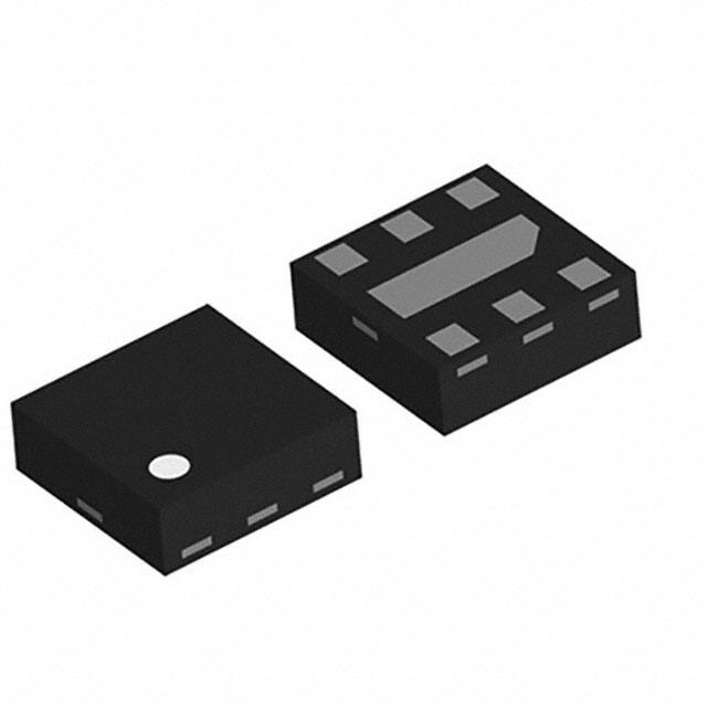

R3118x Series Low Voltage Detector with Individual SENSE Pin and Delay Function No. EA-242-211026 OUTLINE The R3118x is a voltage detector IC with individual sense pin, high detector threshold accuracy and delay time, and ultra-low supply current, which can be operated at an extremely low voltage and is used for system reset as an example. Each of the IC consists of a voltage reference unit, a hysteresis comparator, resistors net for detector threshold setting, an output driver transistor, and a delay circuit. VDD supply pin for the IC and voltage supervisory sense pin are individual, therefore the output pin can keep "L" level even if the sense pin voltage is going down to 0 V, or there is no indefinite range for the sense pin. Since a delay circuit is built-in, by connecting an external capacitor, any output delay time can be set. In the R3118x, detector released delay time can be set, and detector delay time is not influenced by the external capacitor for the delay time. The detector threshold is fixed with high accuracy internally and does not require any adjustment. The tolerance of the detector threshold is ±22.5 mV (−VDET_S < 1.6 V) or ±1.5% (−VDET_S ≥ 1.6 V). Minimum detector threshold voltage is 0.6 V, ultra-low voltage detector threshold can be set. Output delay time for the detector release can be set with high accuracy. The tolerance of the IC side is ±30%. Two output types, Nch. open drain type and CMOS type are available. If the sense pin voltage becomes to equal or lower than the detector threshold voltage, the output voltage becomes "L", and if the sense pin voltage becomes to released voltage, the output voltage becomes "H" after the set delay time. Three types of packages, SOT-23-5, SC-88A, and DFN(PLP)1212-6 are available. FEATURES (1) • • • • • • • • • • Operating Voltage Range (Maximum Rating) .............. 1.0 V to 6.0 V (7.0 V) Supply Current(2) .......................................................... Typ. 0.4 µA (VSENSE ≥ +VDET, VDD = 6 V) Operating Temperature Range .................................... −40°C to 85°C Detector Threshold Range ........................................... 0.6 V to 5.0 V (0.1 V step) Accuracy Detector Threshold ...................................... ±1.5% (-VDET_S ≥ 1.6 V), ±22.5 mV (-VDET_S < 1.6 V) Temperature-Drift Coefficient of Detector Threshold ·· Typ. ±30 ppm/°C Accuracy Detector Released ...................................... ±30% Temperature-Drift Coefficient of Detector Released··· Typ. ±0.16 ppm/°C Output Types ................................................................ Nch Open Drain and CMOS Packages ..................................................................... DFN(PLP)1212-6, SC-88A , SOT-23-5 APPLICATIONS • • • • • (1) (2) CPU and Logic Circuit Reset Battery Checker Window Comparator/Level Discrimination Battery Back-up Circuit Power Failure Detector Ta = 25°C, unless otherwise specified. Consumption current through SENSE pin is not included. 1 R3118x No. EA-242-211026 SELECTION GUIDE The detector threshold, the output type and the package type for the IC can be selected at the users’ request. Selection Guide Product Name Package Quantity per Reel Pb Free Halogen Free R3118Kxx1∗-TR DFN(PLP)1212-6 5,000 pcs Yes Yes R3118Qxx2∗-TR-FE SC-88A 3,000 pcs Yes Yes R3118Nxx1∗-TR-FE SOT-23-5 3,000 pcs Yes Yes xx : The detector threshold can be designated in the range from 0.6 V (06) to 5.0 V (50) in 0.1 V step. ∗ : Designation of Output Type (A) Nch Open Drain (C) CMOS BLOCK DIAGRAMS SENSE SENSE VDD DOUT VDD Delay Circuit Delay Circuit DOUT VREF Vref GND GND CD CD R3118xxxxA (Nch. Open Drain Output) Block Diagram R3118xxxxC (CMOS Output) Block Diagram 2 R3118x No. EA-242-211026 PIN DESCRIPTIONS Top View 6 5 Bottom View 4 4 5 5 5 4 6 (mark side) 1 2 3 3 2 1 DFN(PLP)1212-6 Pin Configuration 1 SENSE 2 GND 3 CD 4 VDD 5 NC 6 DOUT 2 (mark side) 3 SC-88A Pin Configuration DFN(PLP)1212-6 Pin Description Pin No. Symbol 1 4 1 2 3 SOT-23-5 Pin Configuration Description Voltage Detector Voltage Sense Pin Ground Pin Pin for External Capacitor (for setting output delay) Input Pin No Connection Output Pin ("L" at detection) SC-88A Pin Description Pin No. Symbol Description 1 DOUT Output Pin ("L" at detection) 2 GND Ground Pin 3 VDD Input Pin 4 CD 5 SENSE Pin for External Capacitor (for setting output delay) Voltage Detector Voltage Sense Pin SOT-23-5 Pin Description Pin No. Symbol Description 1 DOUT Output Pin ("L" at detection) 2 VDD Input Pin 3 GND Ground Pin 4 CD 5 SENSE Pin for External Capacitor (for setting output delay) Voltage Detector Voltage Sense Pin 3 R3118x No. EA-242-211026 ABSOLUTE MAXIMUM RATINGS Absolute Maximum Ratings Symbol VDD VSENSE VDOUT IDOUT PD Item Rating Unit Supply Voltage -0.3 to 7.0 V SENSE Pin Voltage -0.3 to 7.0 V Output Voltage (R3118xxxxA) -0.3 to 7.0 Output Voltage (R3118xxxxC) -0.3 to VDD + 0.3 Output Current Nch Driver (Sink Current) 20 Output Current Pch Driver (Source Current) -5 Power Dissipation(1) DFN(PLP)1212-6 JEDEC STD.51-7 Test Land Pattern 450 SC-88A Standard Test Land Pattern 380 SOT-23-5 JEDEC STD.51-7 Test Land Pattern 660 V mA mW Tj Junction Temperature Range -40 to 125 °C Tstg Storage Temperature Range -55 to 125 °C ABSOLUTE MAXIMUM RATINGS Electronic and mechanical stress momentarily exceeded absolute maximum ratings may cause permanent damage and may degrade the lifetime and safety for both device and system using the device in the field. The functional operation at or over these absolute maximum ratings is not assured. RECOMMENDED OPERATING CONDITIONS Recommended Operating Conditions Symbol Item Rating Unit VDD Supply Voltage 1.0 to 6.0 V Ta Operating Temperature Range −40 to 85 °C RECOMMENDED OPERATING CONDITIONS All of electronic equipment should be designed that the mounted semiconductor devices operate within the recommended operating conditions. The semiconductor devices cannot operate normally over the recommended operating conditions, even if they are used over such conditions by momentary electronic noise or surge. And the semiconductor devices may receive serious damage when they continue to operate over the recommended operating conditions. (1) Refer to POWER DISSIPATION for detailed information. 4 R3118x No. EA-242-211026 ELECTRICAL CHARACTERISTICS VDD = 1 V to 6 V, unless otherwise specified. The specifications surrounded by are guaranteed by design engineering at −40°C ≤ Ta ≤ 85°C. R3118xxxxA/C Electrical Characteristics Symbol Item Conditions Detector Threshold −VDET_S −VDET_S −VDET_S −0.0225 +0.0225 −40°C ≤ Ta ≤ 85°C −VDET_S −VDET_S −0.0375 −VDET_S +0.0375 Ta = 25°C −VDET_S −VDET_S × 0.985 −VDET_S × 1.015 −VDET_S −VDET_S × 0.975 −VDET_S −VDET_S × × 0.040 0.055 −VDET_S −VDET_S × × 0.035 0.055 0.480 −VDET_S × 1.025 -VDET_S ≥ 1.6 V −40°C ≤ Ta ≤ 85°C VHYS ISS RSENSE IDOUT Detector threshold Hysteresis Ta = 25°C −40°C ≤ Ta ≤ 85°C Supply Current(2) VSENSE = 0 V, VDD = 6 V Sense Resistor VSENSE = 6 V, VDD = 6 V VSENSE = 6 V, VDD = 6 V 0.150 VDD = 3 V, VDOUT = 0.1 V 0.550 VDD = 5 V, VDOUT = 0.1 V 0.850 VDD = 1 V, VDOUT = 0.4 V 0.400 VDD = 3 V, VDOUT = 0.4 V 2.100 VDD = 5 V, VDOUT = 0.4 V 3.300 VDD = 1 V, VDOUT = 0.9 V 6 VDD = 3 V, VDOUT = 2.9 V 30 VDD = 5 V, VDOUT = 4.9 V Nch Driver Leakage Current VSENSE = 6 V, VDD = 6 V, VDOUT = 6 V (R3118xxxxA) VSENSE = 6 V, VDD = 1 V, VCD = 0.4 V CD pin 45 Output Current (Driver Output Pin) Pch VSENSE = 6 V (R3118xxxxC) ILEAK RDIS (1) (2) 9 VDD = 1 V, VDOUT = 0.1 V Nch. VSENSE = 0 V Discharge Tr. On Resistance Typ. Ta = 25°C -VDET_S(1) < 1.6 V -VDET Min. (Ta = 25°C) Max. Unit −VDET_S × 0.070 −VDET_S × 0.075 1.450 0.400 1.200 34 58 V V µA MΩ mA µA 80 2.200 6.200 VSENSE = 6 V, VDD = 3 V, VCD = 0.4 V 0.400 1.250 VSENSE = 6 V, VDD = 5 V, VCD = 0.4 V 0.250 0.800 nA kΩ -VDET_S : Set Detector Threshold Consumption current through SENSE pin is not included. 5 R3118x No. EA-242-211026 ELECTRICAL CHARACTERISTICS (continued) VDD = 1 V to 6 V, unless otherwise specified. The specifications surrounded by are guaranteed by design engineering at −40°C ≤ Ta ≤ 85°C. R3118xxxxA/C Electrical Characteristics Symbol Item Conditions Detect Output tRESET Ta = 25°C Delay Time( 1) Ta = 25°C Release Output tDELAY Delay Time( 2) −40°C ≤ Ta ≤ 85°C Min. Typ. (Ta = 25°C) Max. Unit 80 µs 70 100 130 65 100 145 ms All of unit are tested and specified under load conditions such that Tj ≈ Ta = 25°C except for Detector Output Delay Time and Release Output Delay Time. (1) (2) R3118xxxxC: In the case that a 0.022 µF capacitor is connected to the CD pin, the time interval from forcing pulsive voltage between -VDET_S ×1.155 V and -VDET_S ×0.9 V to SENSE pin, to when the output voltage of the DOUT pin will reach from "H" to VDD/2. R3118xxxxA: In the case that a 0.022 µF capacitor is connected to the CD pin and the DOUT pin is pulled up to 5 V with 470 kΩ, the time interval from forcing pulsive voltage between –VDET_S×1.155 V and -VDET_S×0.9 V to SENSE pin, to when the output voltage reaches from "H" to 2.5V. R3118xxxxC: In the case that a 0.022 µF capacitor is connected to the CD pin, the time interval from forcing pulsive voltage between -VDET_S×0.9 V and -VDET_S×1.155 V to SENSE pin, to when the output voltage of the DOUT pin will reach from "L" to VDD/2. R3118xxxxA: In the case that a 0.022 μF capacitor is connected to the CD pin and the DOUT pin is pulled up to 5 V with 470 kΩ, the time interval from forcing pulsive voltage between -VDET_S ×0.9 V and -VDET_S x1.155 V to SENSE pin, to when the output voltage reaches from "L" to 2.5 V. 6 R3118x No. EA-242-211026 ELECTRICAL CHARACTERISTICS (continued) The specifications surrounded by are guaranteed by design engineering at −40°C ≤ Ta ≤ 85°C. R3118xxxxA/C Product Name R3118x06xx R3118x07xx R3118x08xx R3118x09xx R3118x10xx R3118x11xx R3118x12xx R3118x13xx R3118x14xx R3118x15xx R3118x16xx R3118x17xx R3118x18xx R3118x19xx R3118x20xx R3118x21xx R3118x22xx R3118x23xx R3118x24xx R3118x25xx R3118x26xx R3118x271x R3118x28xx R3118x29xx R3118x30xx R3118x31xx R3118x32xx R3118x33xx R3118x34xx R3118x35xx R3118x36xx R3118x37xx R3118x38xx R3118x39xx R3118x40xx R3118x41xx R3118x42xx R3118x43xx R3118x44xx R3118x45xx R3118x46xx R3118x47xx R3118x48xx R3118x49xx R3118x50xx -VDET [V] Ta = 25°C -40°C ≤ Ta ≤ 85°C Min. Typ. Max. Min. Typ. Max. 0.5775 0.6775 0.7775 0.8775 0.9775 1.0775 1.1775 1.2775 1.3775 1.4775 1.5760 1.6745 1.7730 1.8715 1.9700 2.0685 2.1670 2.2655 2.3640 2.4625 2.5610 2.6595 2.7580 2.8565 2.9550 3.0535 3.1520 3.2505 3.3490 3.4475 3.5460 3.6445 3.7430 3.8415 3.9400 4.0385 4.1370 4.2355 4.3340 4.4325 4.5310 4.6295 4.7280 4.8265 4.9250 0.6000 0.7000 0.8000 0.9000 1.0000 1.1000 1.2000 1.3000 1.4000 1.5000 1.6000 1.7000 1.8000 1.9000 2.0000 2.1000 2.2000 2.3000 2.4000 2.5000 2.6000 2.7000 2.8000 2.9000 3.0000 3.1000 3.2000 3.3000 3.4000 3.5000 3.6000 3.7000 3.8000 3.9000 4.0000 4.1000 4.2000 4.3000 4.4000 4.5000 4.6000 4.7000 4.8000 4.9000 5.0000 0.6225 0.7225 0.8225 0.9225 1.0225 1.1225 1.2225 1.3225 1.4225 1.5225 1.6240 1.7255 1.8270 1.9285 2.0300 2.1315 2.2330 2.3345 2.4360 2.5375 2.6390 2.7405 2.8420 2.9435 3.0450 3.1465 3.2480 3.3495 3.4510 3.5525 3.6540 3.7555 3.8570 3.9585 4.0600 4.1615 4.2630 4.3645 4.4660 4.5675 4.6690 4.7705 4.8720 4.9735 5.0750 0.5625 0.6625 0.7625 0.8625 0.9625 1.0625 1.1625 1.2625 1.3625 1.4625 1.5600 1.6575 1.7550 1.8525 1.9500 2.0475 2.1450 2.2425 2.3400 2.4375 2.5350 2.6325 2.7300 2.8275 2.9250 3.0225 3.1200 3.2175 3.3150 3.4125 3.5100 3.6075 3.7050 3.8025 3.9000 3.9975 4.0950 4.1925 4.2900 4.3875 4.4850 4.5825 4.6800 4.7775 4.8750 0.6000 0.7000 0.8000 0.9000 1.0000 1.1000 1.2000 1.3000 1.4000 1.5000 1.6000 1.7000 1.8000 1.9000 2.0000 2.1000 2.2000 2.3000 2.4000 2.5000 2.6000 2.7000 2.8000 2.9000 3.0000 3.1000 3.2000 3.3000 3.4000 3.5000 3.6000 3.7000 3.8000 3.9000 4.0000 4.1000 4.2000 4.3000 4.4000 4.5000 4.6000 4.7000 4.8000 4.9000 5.0000 0.6375 0.7375 0.8375 0.9375 1.0375 1.1375 1.2375 1.3375 1.4375 1.5375 1.6400 1.7425 1.8450 1.9475 2.0500 2.1525 2.2550 2.3575 2.4600 2.5625 2.6650 2.7675 2.8700 2.9725 3.0750 3.1775 3.2800 3.3825 3.4850 3.5875 3.6900 3.7925 3.8950 3.9975 4.1000 4.2025 4.3050 4.4075 4.5100 4.6125 4.7150 4.8175 4.9200 5.0225 5.1250 -VHYS [V] Ta = 25°C -40°C ≤ Ta ≤ 85°C Min. Typ. Max. Min. Typ. Max. 0.0240 0.0280 0.0320 0.0360 0.0400 0.0440 0.0480 0.0520 0.0560 0.0600 0.0640 0.0680 0.0720 0.0760 0.0800 0.0840 0.0880 0.0920 0.0960 0.1000 0.1040 0.1080 0.1120 0.1160 0.1200 0.1240 0.1280 0.1320 0.1360 0.1400 0.1440 0.1480 0.1520 0.1560 0.1600 0.1640 0.1680 0.1720 0.1760 0.1800 0.1840 0.1880 0.1920 0.1960 0.2000 0.0330 0.0385 0.0440 0.0495 0.0550 0.0605 0.0660 0.0715 0.0770 0.0825 0.0880 0.0935 0.0990 0.1045 0.1100 0.1155 0.1210 0.1265 0.1320 0.1375 0.1430 0.1485 0.1540 0.1595 0.1650 0.1705 0.1760 0.1815 0.1870 0.1925 0.1980 0.2035 0.2090 0.2145 0.2200 0.2255 0.2310 0.2365 0.2420 0.2475 0.2530 0.2585 0.2640 0.2695 0.2750 0.0420 0.0490 0.0560 0.0630 0.0700 0.0770 0.0840 0.0910 0.0980 0.1050 0.1120 0.1190 0.1260 0.1330 0.1400 0.1470 0.1540 0.1610 0.1680 0.1750 0.1820 0.1890 0.1960 0.2030 0.2100 0.2170 0.2240 0.2310 0.2380 0.2450 0.2520 0.2590 0.2660 0.2730 0.2800 0.2870 0.2940 0.3010 0.3080 0.3150 0.3220 0.3290 0.3360 0.3430 0.3500 0.0210 0.0245 0.0280 0.0315 0.0350 0.0385 0.0420 0.0455 0.0490 0.0525 0.0560 0.0595 0.0630 0.0665 0.0700 0.0735 0.0770 0.0805 0.0840 0.0875 0.0910 0.0945 0.0980 0.1015 0.1050 0.1085 0.1120 0.1155 0.1190 0.1225 0.1260 0.1295 0.1330 0.1365 0.1400 0.1435 0.1470 0.1505 0.1540 0.1575 0.1610 0.1645 0.1680 0.1715 0.1750 0.0330 0.0385 0.0440 0.0495 0.0550 0.0605 0.0660 0.0715 0.0770 0.0825 0.0880 0.0935 0.0990 0.1045 0.1100 0.1155 0.1210 0.1265 0.1320 0.1375 0.1430 0.1485 0.1540 0.1595 0.1650 0.1705 0.1760 0.1815 0.1870 0.1925 0.1980 0.2035 0.2090 0.2145 0.2200 0.2255 0.2310 0.2365 0.2420 0.2475 0.2530 0.2585 0.2640 0.2695 0.2750 0.0450 0.0525 0.0600 0.0675 0.0750 0.0825 0.0900 0.0975 0.1050 0.1125 0.1200 0.1275 0.1350 0.1425 0.1500 0.1575 0.1650 0.1725 0.1800 0.1875 0.1950 0.2025 0.2100 0.2175 0.2250 0.2325 0.2400 0.2475 0.2550 0.2625 0.2700 0.2775 0.2850 0.2925 0.3000 0.3075 0.3150 0.3225 0.3300 0.3375 0.3450 0.3525 0.3600 0.3675 0.3750 7 R3118x No. EA-242-211026 THEORY OF OPERATION R3118xxxxA (Nch. OPEN-DRAIN OUTPUT) SENSE VDD Comparator Ra Delay Circuit DOUT ∗) DOUT pin should be pulled-up to VDD or an external voltage level. Rb Vref Nch Tr.1 Rc GND CD R3118xxxxA Block Diagram with External Capacitor 1 2 3 Supply Voltage (VDD) Minimum Operating VDDL Voltage Step 1 2 3 Released Voltage +VDET Comparator (−) Pin Input Voltage I II I Comparator Output L H L Tr.1 OFF ON OFF OFF ON OFF Detector Threshold −VDET A Detector Threshold Hysteresis (1) B SENSE Pin Voltage (VSENSE) Output Tr. GND I Pull-up Voltage Detect Output Delay Time Output Voltage (VOUT) treset Release Output Delay Time tdelay II Nch Rb+Rc ×VSENSE Ra+Rb+Rc Rb Ra+Rb ×VSENSE GND Operation Diagram 1 Step 1. The output voltage is equal to the pull-up voltage. Step 2. At Point "A", VREF ≤ VSENSE x (Rb+Rc)/(Ra+Rb+Rc) is true, as a result, the output of comparator is reversed from "L" to "H", therefore the output voltage becomes the GND level. The voltage level of Point A means a detector threshold voltage (-VDET). (When the supply voltage is lower than the minimum operating voltage, the operation of the output transistor becomes indefinite. The output voltage is equal to the GND level.) Step 3. At Point "B", VREF ≤ VSENSE x Rb/(Ra+Rb) is true, as a result, the output of comparator is reversed from "H" to "L", then the output voltage is equal to the pull-up voltage. The voltage level of Point B means a released voltage (+VDET). (1) The difference between a released voltage and a detector threshold voltage is a detector threshold hysteresis. 8 R3118x No. EA-242-211026 R3118xxxxC (CMOS OUTPUT) SENSE VDD Comparator Ra Pch Delay Circuit DOUT Rb Vref Nch Tr.1 Rc GND CD R3118xxxC Block Diagram with External Capacitor 1 2 3 Step 1 2 3 Comparator (−) Pin Input Voltage I II I Comparator Output L H L Tr.1 OFF ON OFF Pch ON OFF ON Nch OFF ON OFF Supply Voltage (VDD) Minimum Operating VDDL Voltage Released Voltage +VDET Detector Threshold −VDET A Detector Threshold Hysteresis (1) B Output Tr. SENSE Pin Voltage (VSENSE) GND I Supply Voltage (VDD) Detect Output Delay Time Output Voltage (VOUT) tRESET Release Output Delay Time tDELAY II Rb+Rc ×VSENSE Ra+Rb+Rc Rb Ra+Rb ×VSENSE GND Operation Diagram 1 Step 1. The output voltage is equal to the supply voltage (VDD). Step 2. At Point "A", VREF ≥ VSENSE × (Rb+Rc)/(Ra+Rb+Rc) is true, as a result, the output of comparator is reversed from "L" to "H", therefore the output voltage becomes the GND level. The voltage level of Point A means a detector threshold voltage (-VDET). (When the supply voltage is lower than the minimum operating voltage, the operation of the output transistor becomes indefinite. The output voltage is equal to the GND level.) Step 3. At Point "B", VREF ≤ VSENSE × Rb/(Ra+Rb) is true, as a result, the output of comparator is reversed from "H" to "L", then the output voltage is equal to the supply voltage (VDD). The voltage level of Point B means a released voltage (+VDET). (1) The difference between a released voltage and a detector threshold voltage is a detector threshold hysteresis. 9 R3118x No. EA-242-211026 WHEN POWER TO SENSE PIN TURNING-ON AFTER VDD PIN’S POWER-ON VDD pin voltage VDD 6V 1V Time t SENSE pin voltage VSENSE Released Voltage +VDET Detector Threshold -VDET Time t DOUT pin voltage VDOUT Indefinite Release Output Delay Time (tDELAY) Detect Output Delay Time (tRESET) Time t If a voltage is applied to SENSE pin after a power (in the range from 1 V to 6 V) is applied to VDD pin, DOUT pin becomes "L" when the SENSE pin voltage is less than released voltage +VDET, ,and DOUT pin becomes "H" when the SENSE pin voltage is equal or more than the released voltage +VDET. 10 R3118x No. EA-242-211026 WHEN POWER TO VDD PIN TURNING-ON AFTER SENSE PIN’S POWER-ON VDD pin voltage VDD 6V 1V Time t SENSE pin voltage VSENSE Released Voltage +VDET Detector Threshold -VDET Time t DOUT pin voltage VDOUT Release Output Delay Time (tDELAY) Indefinite Release Output Delay Time (tDELAY) Detect Output Delay Time (tRESET) Time t In the case of the SENSE pin voltage is less than released voltage +VDET, when the VDD pin voltage becomes to 1 V or more, "L" output of DOUT is determined. In case of the SENSE pin voltage is equal or more than the released voltage +VDET, when the VDD pin voltage becomes to 1 V or more, "H" output of DOUT is determined. If the turn on speed of the supply voltage of the VDD pin up to 1 V is slower than the1 V/s, connect 0.001 µF or more capacitor to CD pin, otherwise, powering-up of the VDD pin with the SENSE pin output voltage of −VDET < VSENSE < +VDET may result in an unstable DOUT pin output, “H” or “L”, at the point where the VDD pin voltage exceeds 1 V. TIMING CHART Supply Voltage (VDD) Minimum Operating VDDL Voltage Released Voltage +VDET Detector Threshold -VDET Detector Threshold Hysteresis Detector Threshold Hysteresis SENSE Pin Voltage (VSENSE) GND Pull-up Voltage Supply Voltage (VDD) Output Voltage (VOUT) GND tRESET tDELAY R3118xxxxA tRESET tDELAY R3118xxxxC 11 R3118x No. EA-242-211026 OUTPUT DELAY OPERATION Released Voltage (+VDET) SENSE pin voltage Detector Threshold (-VDET) Time t GND CD pin Threshold voltage (VTCD) CD pin voltage Time t GND DOUT pin voltage Time t Release Output Delay Time (tDELAY) GND Detect Output Delay Time (tRESET) Output Delay Operation Diagram A higher voltage than the released voltage is forced to the SENSE pin, charge to the capacitor connected to CD pin is started, then the CD pin voltage increases. Until CD pin voltage reaches to CD pin threshold voltage, the output of DOUT pin voltage keeps "L", then when CD pin voltage is higher than CD pin threshold voltage, the DOUT pin voltage changes from "L" to "H". The released output delay time means the time interval from when the released voltage threshold or more voltage level is forced to SENSE pin to when DOUT voltage changes from "L" to "H". When the voltage of DOUT pin reverses from "L" to "H", the discharge of the external capacitor connected to CD pin starts. Therefore, the time interval from when the voltage lower than the detector threshold is forced to SENSE pin, to when the output voltage reverses from "H" to "L", or detector output delay time is constant and independent from the external capacitance value. However, after the DOUT pin voltage reverses from "L" to "H", if a voltage lower than the detector threshold is forced to SENSE pin before the capacitor connected to CD pin is discharged, delay time will increase. The time interval (tDIS) from when the capacitor connected to CD pin is discharged completely to when the capacitor is charged to a certain CD pin voltage (described as VCD herein) can be calculated by power supply voltage (VDD), external capacitance (CD), on resistance of the CD pin discharge transistor (RDIS) as in the next formula: tDIS = -RDIS × CD × ln(VCD / (VDD × 0.45)) RELEASED OUTPUT DELAY TIME The release output delay time (tDELAY) can be calculated as in the next formula with an external capacitance value (CD): tDELAY(s) = 4.545 × 106 × CD(F) During the released delay operation, only a small current will charge the external capacitor connected to CD pin. If the leakage current between CD pin and GND is large, the released delay time may increase or the detector may not be released. And, if the VDD pin voltage varies, the released output delay time will be also shift. 12 R3118x No. EA-242-211026 APPLICATION INFORMATION TYPICAL APPLICATION R3118xxxxA (Nch. Open-drain Output) CPU Reset Circuit VDD 470kΩ R VS VDD VDD SENSE R3118xxxxA CPU RESET DOUT GND CD GND When using a shared input voltage between R3118x and CPU VDD1 VDD2 470kΩ R VS VDD SENSE R3118xxxxA DOUT GND CD VDD CPU RESET GND When using different input voltages between R3118x and CPU R3118xxxxC (CMOS Output) CPU Reset Circuit VDD VS VDD SENSE R3118xxxxC DOUT GND CD VDD CPU RESET GND 13 R3118x No. EA-242-211026 TYPICAL CHARACTERISTICS Note: Typical Characteristics are intended to be used as reference data; they are not guaranteed. 1.0 0.9 0.8 0.7 0.6 0.5 0.4 0.3 0.2 0.1 0.0 R3118xxxxA/C (VSENSE = 6 V) Topt=-40°C Topt=25°C Topt=85°C 0 1 2 Supply Current ISS (μA) Supply Current ISS (μA) 1) Supply Current vs. Supply Voltage R3118xxxxA/C (VSENSE = 0 V) 3 4 5 Supply Voltage VDD (V) 6 1.0 0.9 0.8 0.7 0.6 0.5 0.4 0.3 0.2 0.1 0.0 Topt=-40°C Topt=25°C Topt=85°C 0 2 4 6 Supply Voltage VDD (V) 2) Detector Threshold vs. Temperature R3118x06xA/C (VDD = 5.3 V) R3118x27xA/C (VDD = 5.3 V) -VDET 0.636 Detector Threshold VDET (V) Detector Threshold VDET (V) 0.645 +VDET 0.627 0.618 0.609 0.600 0.591 -50 -25 0 25 50 75 100 2.903 -VDET +VDET 2.862 2.822 2.781 2.741 2.700 2.660 -50 -25 0 25 50 75 100 Temperature Topt (°C) Temperature Topt (°C) Detector Threshold VDET (V) R3118x50xA/C (VDD = 5.3 V) 5.375 5.300 5.225 -VDET 5.150 +VDET 5.075 5.000 4.925 -50 -25 0 25 50 75 100 Temperature Topt (°C) 14 R3118x No. EA-242-211026 3) Detector Threshold vs. Supply Voltage R3118x06xA/C R3118x27xA/C Detector Threshold VDET (V) Detector Threshold VDET (V) 0.609 Topt=-40°C 0.606 Topt=25°C Topt=85°C 0.603 0.600 0.597 0.594 0.591 1 2 3 4 5 6 5 6 2.741 Topt=-40°C 2.727 Topt=25°C 2.714 Topt=85°C 2.700 2.687 2.673 2.660 1 3 5 Supply Voltage VDD (V) Supply Voltage VDD (V) R3118x50xA/C Detector Threshold VDET (V) 5.075 Topt=-40°C 5.050 Topt=25°C Topt=85°C 5.025 5.000 4.975 4.950 4.925 1 2 3 4 Supply Voltage VDD (V) 4) Hysteresis vs. Temperature R3118x27xA/C (VDD = 5.3 V) 0.042 0.039 0.036 0.033 0.030 0.027 0.024 0.021 -50 -25 0 25 50 75 Temperature Topt (°C) 100 Detector Threshold Hysteresis VHYS (V) Detector Threshold Hysteresis VHYS (V) R3118x06xA/C (VDD = 5.3 V) 0.045 0.203 0.190 0.176 0.163 0.149 0.136 0.122 0.109 0.095 -50 -25 0 25 50 75 100 Temperature Topt (°C) 15 R3118x No. EA-242-211026 Detector Threshold Hysteresis VHYS (V) R3118x50xA/C (VDD = 5.3 V) 0.375 0.350 0.325 0.300 0.275 0.250 0.225 0.200 0.175 -50 -25 0 25 50 75 100 Temperature Topt (°C) 5) Hysteresis vs. Supply Voltage R3118x27xA/C Detector Threshold Hysteresis VHYS (V) Detector Threshold Hysteresis VHYS (V) R3118x06xA/C 0.045 Topt=-40°C 0.042 Topt=25°C 0.039 Topt=85°C 0.036 0.033 0.030 0.027 0.024 0.021 0.203 Topt=-40°C 0.189 Topt=25°C 0.176 Topt=85°C 0.162 0.149 0.135 0.122 0.108 1 2 3 4 5 6 0.095 1 2 3 4 5 6 Supply Voltage VDD (V) Supply Voltage VDD (V) R3118x50xA/C Detector Threshold Hysteresis VHYS (V) 0.375 Topt=-40°C 0.35 Topt=25°C 0.325 Topt=85°C 0.3 0.275 0.25 0.225 0.2 0.175 1 2 3 4 5 6 Supply Voltage VDD (V) 16 R3118x No. EA-242-211026 6) Output Voltage vs. SENSE Voltage (DOUT pin is pulled up to VDD pin via 470 kΩ) R3118x06xA/C R3118x27xA/C VDD=1V 6 VDD=3V 6 Output Voltage VDOUT (V) Output Voltage VDOUT (V) VDD=5V 5 4 3 2 1 0 0 1 2 3 4 5 6 VDD=1V VDD=3V 5 VDD=5V 4 3 2 1 0 0 1 SENSE Voltage VSENSE (V) 2 3 4 5 6 SENSE Voltage VSENSE (V) R3118x50xA/C Output Voltage VDOUT (V) 6 VDD=1V VDD=3V VDD=5V 5 4 3 2 1 0 0 1 2 3 4 5 6 SENSE Voltage VSENSE (V) 7) Nch. Driver Output Current vs. Supply Voltage 8)Nch. Driver Output Current vs. Output Voltage R3118xxxxA/C (VDOUT = 0.4 V) Topt=-40°C 8 Topt=25°C 7 Topt=85°C 6 5 4 3 2 1 0 1 2 3 4 Supply Voltage [V] 5 6 Nch Driver Output Current IDOUT (mA) 9 Nch Driver Output Current [mA] R3118xxxxA/C 20 18 VDD=1V 16 VDD=3V 14 VDD=5V 12 10 8 6 4 2 0 0 1 2 Output Voltage VDOUT (V) 3 17 R3118x No. EA-242-211026 9) Pch. Driver Output Current vs. Supply Voltage 10) Pch Driver Output current vs. Output voltage 0 R3118xxxxA/C Pch Driver Output Current IDOUT (mA) Pch Driver Output Current IDOUT (μA) R3118xxxxA/C (VDOUT = VDD - 0.1 V) Topt=-40°C Topt=25°C -20 Topt=85°C -40 -60 -80 -100 1 2 3 4 5 6 0.0 -0.2 -0.4 -0.6 -0.8 -1.0 -1.2 -1.4 -1.6 VDD=1V -1.8 -2.0 VDD=3V 0 1 2 3 VDD=5V 4 5 Output Voltage VDOUT (V) Supply Voltage VDD (V) 11) CD pin Discharge Tr. On Resistance vs. Supply Voltage R3118xxxxA/C (VCD = 0.4 V) CD Pin Discharge Tr. On Resistor RDIS (k ohm) 6 Topt=-40°C 5 Topt=25°C 4 Topt=85°C 3 2 1 0 1 2 3 4 5 6 Supply Voltage VDD (V) 12) CD pin Discharge Transistor On Resistance vs. CD pin Voltage R3118xxxxA/C CD Pin Discharge Tr On Resistor RDIS (k ohm) 6 VDD=1V 5 VDD=3V VDD=5V 4 3 2 1 0 0.0 1.0 2.0 CD Pin Voltage VCD (V) 18 R3118x No. EA-242-211026 13) Release Output Delay Time vs. Temperature 14) Release Output Delay Time vs. Supply Voltage R3118xxxxA/C (VDD = 4 V, CD = 0.022 µF) 135 125 115 105 95 85 75 65 R3118xxxxA/C (CD = 0.022 µF) Release Delay Time tdelay (ms) Release Delay Time tdelay (ms) 145 -50 -25 0 25 50 75 100 Temperature Topt (°C) 145 Topt=-40°C Topt=25°C Topt=85°C 135 125 115 105 95 85 75 65 1 3 5 Supply Voltage VDD (V) 15) Detect Output Delay Time/Release Output Delay Time vs. CD pin External Capacitance R3118xxxxA/C (VDD = 4 V) Release / Detect Delay Time tdelay / treset (ms) 1000 100 10 1 tdelay treset 0.1 0.01 0.0001 0.0010 0.0100 0.1000 External Capacitance CD (μF) 19 R3118x No. EA-242-211026 16) Detect Output Delay time vs. Over-drive Voltage 100 90 80 70 60 50 40 30 20 10 0 R3118x50xA/C (CD = none) VDD=1V VDD=6V 10 100 1000 Detect Delay Time treset (μs) Detect Delay Time treset (μs) R3118x06xA/C (CD = none) 140 VDD=1V 120 VDD=6V 100 80 60 40 20 0 10 100 1000 Over Drive Voltage VOD (mV) Over Drive Voltage VOD (mV) SENSE pin Voltage VSENSE Over-drive Voltage (VOD) Detector Threshold (-VDET) Time t DOUT pin Voltage VDOUT Detect Output DelayTime (tRESET) Time t Note: The pulse shorter than the detect output delay time cannot be detected, and "L" does not output from DOUT pin. 20 R3118x No. EA-242-211026 17) Release Output Delay time vs. Over-drive Voltage 500 450 400 350 300 250 200 150 100 50 0 R3118x50xA/C (CD = none) VDD=1V VDD=6V 10 100 1000 Release Delay Time tdelay (μs) Release Delay Time tdelay (μs) R3118x06xA/C (CD = none) 3500 VDD=1V 3000 VDD=6V 2500 2000 1500 1000 500 0 10 100 1000 Over Drive Voltage VOD (mV) Over Drive Voltage VOD (mV) SENSE pin Voltage VSENSE Over-drive Voltage (VOD) Released Voltage (+VDET) Time t DOUT pin Voltage VDOUT Release Output Delay Time (tDELAY) Time t Notes: • If the pulse is shorter than the output release delay time, the R3118x cannot be released and "H" does not output from DOUT pin. • If the attachment capacitor for CD pin for setting a delay time is too small and the difference between the released voltage threshold and the actual released voltage is too small or the slope for rising voltage of the SENSE pin is too slow, the output delay time tolerance will be worse. Ex. Attachment capacitor = 0.0001 µF, Released voltage threshold = 4.725 V, Actual released voltage = 4.75 V. In this case, the calculated delay time = 0.4545 ms, however, over-drive voltage is only 25 mV. Therefore, the actual delay time will be approximately 2.4545 ms. If the attachment capacitor = 0.001 µF and other conditions are same as above, the calculated delay time = 4.545 ms, and the actual delay time will be approximately 6.545 ms. If the attachment capacitor = 0.01 µF and other conditions are same as above, the calculated delay time = 45.45 ms, and the actual delay time will be approximately 47.45 ms. 21 POWER DISSIPATION DFN(PLP)1212-6 Ver. A The power dissipation of the package is dependent on PCB material, layout, and environmental conditions. The following measurement conditions are based on JEDEC STD. 51-7. Measurement Conditions Item Measurement Conditions Environment Mounting on Board (Wind Velocity = 0 m/s) Board Material Glass Cloth Epoxy Plastic (Four-Layer Board) Board Dimensions 76.2 mm × 114.3 mm × 0.8 mm Copper Ratio Outer Layer (First Layer): Less than 95% of 50 mm Square Inner Layers (Second and Third Layers): Approx. 100% of 50 mm Square Outer Layer (Fourth Layer): Approx. 100% of 50 mm Square Through-holes  0.2 mm × 14 pcs Measurement Result (Ta = 25°C, Tjmax = 125°C) Item Measurement Result Power Dissipation 450 mW Thermal Resistance (ja) ja = 218°C/W Thermal Characterization Parameter (ψjt) ψjt = 105°C/W ja: Junction-to-Ambient Thermal Resistance ψjt: Junction-to-Top Thermal Characterization Parameter 600 Power Dissipation (mW) 500 450 400 300 200 100 0 0 25 50 75 85 Ambient Temperature (°C) 100 Power Dissipation vs. Ambient Temperature 125 Measurement Board Pattern i PACKAGE DIMENSIONS DFN(PLP)1212-6 Ver. B DFN(PLP)1212-6 Package Dimensions i POWER DISSIPATION SC-88A Ver. B The power dissipation of the package is dependent on PCB material, layout, and environmental conditions. The following conditions are used in this measurement. Measurement Conditions Item Standard Test Land Pattern Environment Mounting on Board (Wind Velocity = 0 m/s) Board Material Glass Cloth Epoxy Plastic (Double-Sided Board) Board Dimensions 40 mm × 40 mm × 1.6 mm Top Side: Approx. 50% Copper Ratio Bottom Side: Approx. 50% Through-holes φ 0.5 mm × 44 pcs Measurement Result (Ta = 25°C, Tjmax = 125°C) Item Standard Test Land Pattern Power Dissipation 380 mW Thermal Resistance (θja) θja = 263°C/W Thermal Characterization Parameter (ψjt) ψjt = 75°C/W θja: Junction-to-Ambient Thermal Resistance ψjt: Junction-to-Top Thermal Characterization Parameter 500 40 380 300 200 40 Power Dissipation (mW) 400 100 0 0 25 50 75 85 100 125 Ambient Temperature (°C) Power Dissipation vs. Ambient Temperature Measurement Board Pattern i PACKAGE DIMENSIONS SC-88A Ver. A SC-88A Package Dimensions i POWER DISSIPATION SOT-23-5 Ver. A The power dissipation of the package is dependent on PCB material, layout, and environmental conditions. The following measurement conditions are based on JEDEC STD. 51-7. Measurement Conditions Item Measurement Conditions Environment Mounting on Board (Wind Velocity = 0 m/s) Board Material Glass Cloth Epoxy Plastic (Four-Layer Board) Board Dimensions 76.2 mm × 114.3 mm × 0.8 mm Copper Ratio Outer Layer (First Layer): Less than 95% of 50 mm Square Inner Layers (Second and Third Layers): Approx. 100% of 50 mm Square Outer Layer (Fourth Layer): Approx. 100% of 50 mm Square Through-holes  0.3 mm × 7 pcs Measurement Result Item (Ta = 25°C, Tjmax = 125°C) Measurement Result Power Dissipation 660 mW Thermal Resistance (ja) ja = 150°C/W Thermal Characterization Parameter (ψjt) ψjt = 51°C/W ja: Junction-to-Ambient Thermal Resistance ψjt: Junction-to-Top Thermal Characterization Parameter Power Dissipation vs. Ambient Temperature Measurement Board Pattern i SOT-23-5 PACKAGE DIMENSIONS Ver. A 2.9±0.2 1.1±0.1 1.9±0.2 0.8±0.1 (0.95) 4 1 2 0~0.1 0.2min. +0.2 1.6-0.1 5 2.8±0.3 (0.95) 3 0.4±0.1 +0.1 0.15-0.05 SOT-23-5 Package Dimensions i 1. The products and the product specifications described in this document are subject to change or discontinuation of production without notice for reasons such as improvement. Therefore, before deciding to use the products, please refer to Ricoh sales representatives for the latest information thereon. 2. The materials in this document may not be copied or otherwise reproduced in whole or in part without prior written consent of Ricoh. 3. Please be sure to take any necessary formalities under relevant laws or regulations before exporting or otherwise taking out of your country the products or the technical information described herein. 4. The technical information described in this document shows typical characteristics of and example application circuits for the products. The release of such information is not to be construed as a warranty of or a grant of license under Ricoh's or any third party's intellectual property rights or any other rights. 5. The products listed in this document are intended and designed for use as general electronic components in standard applications (office equipment, telecommunication equipment, measuring instruments, consumer electronic products, amusement equipment etc.). Those customers intending to use a product in an application requiring extreme quality and reliability, for example, in a highly specific application where the failure or misoperation of the product could result in human injury or death (aircraft, spacevehicle, nuclear reactor control system, traffic control system, automotive and transportation equipment, combustion equipment, safety devices, life support system etc.) should first contact us. 6. We are making our continuous effort to improve the quality and reliability of our products, but semiconductor products are likely to fail with certain probability. In order to prevent any injury to persons or damages to property resulting from such failure, customers should be careful enough to incorporate safety measures in their design, such as redundancy feature, fire containment feature and fail-safe feature. We do not assume any liability or responsibility for any loss or damage arising from misuse or inappropriate use of the products. 7. Anti-radiation design is not implemented in the products described in this document. 8. The X-ray exposure can influence functions and characteristics of the products. Confirm the product functions and characteristics in the evaluation stage. 9. WLCSP products should be used in light shielded environments. The light exposure can influence functions and characteristics of the products under operation or storage. 10. There can be variation in the marking when different AOI (Automated Optical Inspection) equipment is used. In the case of recognizing the marking characteristic with AOI, please contact Ricoh sales or our distributor before attempting to use AOI. 11. Please contact Ricoh sales representatives should you have any questions or comments concerning the products or the technical information. Halogen Free Ricoh is committed to reducing the environmental loading materials in electrical devices with a view to contributing to the protection of human health and the environment. Ricoh has been providing RoHS compliant products since April 1, 2006 and Halogen-free products since April 1, 2012. Official website https://www.n-redc.co.jp/en/ Contact us https://www.n-redc.co.jp/en/buy/

物料型号:RICOH R3118x系列
器件简介: - R3118x系列是一款具有独立检测引脚、高检测阈值精度和延时功能的低电压检测集成电路。 - 该器件能够在极低的电压下运行,例如用于系统重置。
引脚分配: - DFN(PLP)1212-6、SC-88A和SOT-23-5是可用的封装类型,每种封装的引脚功能略有不同,但主要包括: - SENSE:电压检测引脚 - VDD:供电引脚 - GND:地引脚 - DOUT:输出引脚 - CD:用于设置输出延时的外部电容引脚
参数特性: - 工作电压范围:1.0 V至6.0 V(最大额定值为7.0 V) - 供电电流:典型值为0.4 µA(当VSENSE ≥ +VDET, VDD = 6 V时) - 工作温度范围:-40°C至85°C - 检测阈值范围:0.6 V至5.0 V(以0.1 V为步进) - 检测阈值精度:±1.5%(-VDET_S ≥ 1.6 V)或±22.5 mV(-VDET_S < 1.6 V)
功能详解: - 当检测到的电压达到设定的检测阈值时,输出引脚DOUT会变为“低”电平。 - 内部集成了延时电路,可以通过外部电容设置任意的输出延时时间。
应用信息: - 可用于CPU和逻辑电路重置、电池检查器、窗口比较器/电平判别、电池后备电路和电源故障检测等。
封装信息: - 提供三种封装类型:DFN(PLP)1212-6、SC-88A和SOT-23-5,每种封装的引脚分配和描述在文档中有详细说明。
