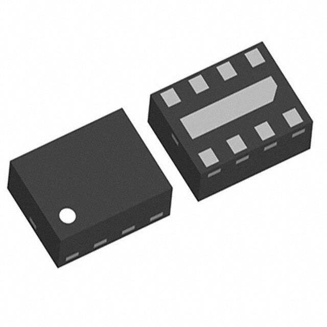

R3200x SERIES Reset Timer IC for Mobile Equipments NO.EA-280-190531 OUTLINE The R3200x is a reset timer IC with two input signals for mobile equipment which require long interval for reset sequence. The long interval prevents unexpected resets caused by accidental key operations. Internally, the R3200x consists of a delay generator circuit and output driver transistors. The R3200x has two active-low input pins (SR0 and SR1) which generate reset signals after output delay time when both active-low input pins are activated at the same time. The R3200x has two versions that are different in output delay time settings and output release method. R3200x001x: Output delay time is selectable from 7.5 s or 11.25 s typ. by connecting the DSR pin to either GND or VDD. A reset signal can be released by making one of the active-low input pins high. R3200xxx2x, R3200L053B or R3200L064A: Output delay time is fixed. A reset signal will be released automatically after output release time. Or, by making one of the active-low input pins high, a reset signal can be released before output release time. The R3200x provides ultra-low supply current while a reset signal is remaining active or after being sent out. The R3200x is offered in a 8-pin DFN(PLP)2020-8B package or a 8-pin DFN1216-8 package. 1 R3200x NO.EA-280-190531 FEATURES  Operating Voltage Range (Maximum Rating).................... 1.65 V to 5.5 V (6 V)  Supply Current 1 (at standby) ........................................... Typ. 0.28 µA (VDD = 5.5 V)  Supply Current 2 (at active before reset signal output) ..... Typ. 3 µA(VDD = 5.5 V)*1  Supply Current 3 (at active after reset signal output) ........ Typ. 0.45 µA (VDD = 5.5 V)  Operating Temperature Range.......................................... −40 to +85°C  Output Delay Time (R3200x001x) ..................................... Typ. 7.5 s or 11.25 s (R3200x002x) .................................... Typ. 7.5 s (R3200L052B) .................................... Typ. 10 s (R3200L053B) ....................................... Typ. 10 s (R3200L064A) ........................................ Typ. 3.0 s  Output Delay Time Accuracy .................................................. ±10%  Output Release Time (R3200x002x) ...................................... Typ. 0.234 s (R3200L052B) ...................................... Typ. 0.313 s (R3200L053B) ...................................... Typ. 0.078 s (R3200L064A) ................................... Typ. 0.1875 s  Output Release Time Accuracy ......................................... ±10%  Output Type (R3200xxxxA) ............................................... Nch Open Drain (R3200xxxxB) ............................................... Nch Open Drain and CMOS  Packages .......................................................................... DFN(PLP)2020-8B, DFN1216-8 *1 Guaranteed by design engineering APPLICATIONS  Mobile phone, Smartphone  Tablet devices such as E-book etc.  Portable Games  Personal Navigation Devices 2 R3200x NO.EA-280-190531 BLOCK DIAGRAMS SR0 VDD Reset Logic *1 Delay Time Selector Delay Logic RST OSC GND SR1 *1 DSR Delay Time Selector R3200xxxxA *1 VDD Reset Logic RST2 SR1 DSR SR0 Delay Logic RST OSC GND R3200xxxxB The parts surrounded by red dotted lines are for the R3200x001x only. SELECTION GUIDE The package type, the combination of output delay time and output release time, the output type for the device are user-selectable options. Selection Guide Product Name Package Quantity per Reel Pb Free Halogen Free R3200Kxxx-TR DFN(PLP)2020-8B 5,000 pcs Yes Yes R3200Lxxx-E2 DFN1216-8 5,000 pcs Yes Yes xxx: Specify the combination of output delay time and output release method. (001) Select the output delay time from 7.5 s or 11.25 s typ. A reset signal can be released by making one of the active-low input pins high. (xx2) / (053) / (064) A reset signal will be released automatically after output release time. A reset signal can be released before output release time by making one of the active-low input pins high. Refer to the table below for the output delay time and the output release time for each device. 002 052 (R3200L052B only) 053 (R3200L053B only) 064 (R3200L064A only) Output Delay Time 7.5 s 10 s 10 s 3.0 s Output Release Time 0.234 s 0.313 s 0.078 s 0.1875 s : Specify the output type. (A) Nch Open Drain (B) Nch Open Drain and CMOS 3 R3200x NO.EA-280-190531 PIN DESCRIPTIONS Top View 8 7 6 Top View Bottom View 5 5 6 7 8 8 7 6 Bottom View 5 5  1 2 3 4 4 6 7 8 3 2 1  3 2 1 1 2 3 4 4 DFN1216-8 DFN(PLP)2020-8B The tab on the bottom of the package enhances thermal performance and is electrically connected to GND (substrate level). It is recommended that the tab be connected to the ground plane on the board, or otherwise be left floating. DFN(PLP)2020-8B Pin Description/ DFN1216-8 Pin Description Pin No. 1 NC Description No Connection (R3200xxxxA) RST2 CMOS Output Pin, Active-high (R3200xxxxB) 2 GND Ground Pin 3 SR1 Input Pin2, Active-low*1 4 RST Nch Open Drain Output Pin, Active-low*2 DSR Output Delay Time Selection Pin (R3200x001x) (GND: 7.5 s, VDD: 11.25 s)*3 5 *1 Symbol TEST2 Test Pin 2*4 (R3200xxx2x/ R3200L053B/ R3200L064A) 6 TEST Test Pin*4 7 SR0 Input Pin1, Active-low*1 8 VDD Power Supply Input Pin When only one active-low input pin is used, connect the unused one to GND. The RST pin must be connected to GND or left floating if it is not used (Ex.R3200xxxxB). *3 The DSR pin must be connected to GND or VDD. *4 The TEST pin and the TEST2 pin must be connected to GND when they are used. *2 4 R3200x NO.EA-280-190531 ABSOLUTE MAXIMUM RATINGS Absolute Maximum Ratings Symbol Item Rating Unit VDD Supply Voltage GND −0.3 to 6 V VSR0 Input Voltage (Input Pin1) GND −0.3 to 6 V VSR1 Input Voltage (Input Pin2) GND −0.3 to 6 V VRST Output Voltage (Reset Signal Output Pin1) GND −0.3 to 6 V VRST2 Output Voltage (Reset Signal Output Pin2) GND −0.3 to VDD +0.3 V VDSR Input Voltage (Output Delay Time Selection Pin) (R3200x001x) GND −0.3 to 6 V IOUT Output Current 20 mA PD Power Dissipation (JEDEC STD. 51)*1 Ta Operating Temperature Range −40 to +85 °C Storage Temperature Range −55 to +125 °C Tstg *1 DFN(PLP)2020-8B 1050 DFN1216-8 1700 mW Refer to PACKAGE INFORMATION for detailed information. ABSOLUTE MAXIMUM RATINGS Electronic and mechanical stress momentarily exceeded absolute maximum ratings may cause permanent damage and may degrade the life time and safety for both device and system using the device in the field. The functional operation at or over these absolute maximum ratings is not assured. RECOMMENDED OPERATING CONDITIONS (ELECTRICAL CHARACTERISTICS) All of electronic equipment should be designed that the mounted semiconductor devices operate within the recommended operating conditions. The semiconductor devices cannot operate normally over the recommended operating conditions, even if they are used over such conditions by momentary electronic noise or surge. And the semiconductor devices may receive serious damage when they continue to operate over the recommended operating conditions. 5 R3200x NO.EA-280-190531 ELECTRICAL CHARACTERISTICS The specifications surrounded by R3200x001x Electrical Characteristics Symbol Item VDD (Ta = 25°C) Conditions Supply Voltage Min. Typ. 1.65 *1 ISS1 Supply Current 1 ISS2 Supply Current 2*2 ISS3 Supply Current 3*3 VOL "L" Output Voltage VOH are guaranteed by design engineering at 40C  Ta  85C. VDD = 5.5 V (at standby) VDD = 5.5 V (at active before reset signal output) VDD = 5.5 V (at active after reset signal output) VDD ≥ 4.5 V IOL = 8 mA *4 "H" Output Voltage VDD ≥ 3.3 V IOL = 5 mA VDD ≥ 1.65 V IOL = 3 mA VDD ≥ 4.5 V IOH = 5 mA VDD ≥ 3.3 V IOH = 2.5 mA VDD ≥ 1.65 V IOH = 0.8 mA Max. Unit 5.5 0.28 1.35 V µA 3.0 6.5 µA 0.45 1.7 µA 0.3 V VDD x 0.85 V ILEAKI S R 0 , S R 1 Input Leakage Current VDD = 5.5 V 0.1 µA ILEAKO Output Leakage Current VDD = 5.5 V 0.1 µA tdelay Output Delay Time 8.25 s VIL S R 0 , S R 1 "L" Input Voltaget VIH S R 0 , S R 1 "H" Input Voltaget DSR = GND DSR = VDD 6.75 7.5 10.125 11.25 12.375 0.3 0.85 s V V All test items listed under ELECTRICAL CHARACTERISTICS are done under the pulse load condition (Tj ≈ Ta = 25°C) except Supply Current 2. *1 Supply current when the device is active and waiting for the reset input. *2 Supply current when both active-low input pins are low and the timer operation is running. *3 Supply current after the completion of timer operation and the output of reset signal. *4 For the R3200xxxxB only (CMOS output). 6 R3200x NO.EA-280-190531 ELECTRICAL CHARACTERISTICS (continued) are guaranteed by design engineering at 40°C Ta  85°C. The specifications surrounded by R3200xxx2x, R3200L053B, R3200L064A Electrical Characteristics Symbol Item Conditions VDD Operating Voltage ISS1 *1 Supply Current 2*2 ISS3 Supply Current 3*3 VOL VOH VDD = 5.5 V (at standby) VDD = 5.5 V (at active before reset signal output) VDD = 5.5 V (at active after reset signal output) "L" Output Voltage *4 "H" Output Voltage VDD ≥ 4.5 V IOL = 8 mA VDD ≥ 3.3 V IOL = 5 mA VDD ≥ 1.65 V IOL = 3 mA VDD ≥ 4.5 V IOH = 5 mA VDD ≥ 3.3 V IOH = 2.5 mA VDD ≥ 1.65 V IOH = 0.8 mA ILEAKI S R 0 , S R 1 Input Leakage Current VDD = 5.5 V ILEAKO Output Leakage Current VDD = 5.5 V tdelay Typ. Max. Unit 5.5 V 0.28 1.35 µA 3.0 6.5 µA 0.45 1.7 µA 0.3 V 1.65 Supply Current 1 ISS2 (Ta = 25°C) Min. VDD x 0.85 V 0.1 µA 0.1 µA tdelay_s tdelay_s tdelay_s x 0.9 x 1.1 Output Delay Time*5 trec_s x 0.9 trec Output Release Time*5 VIL S R 0 , S R 1 "L" Input Voltage VIH S R 0 , S R 1 "H" Input Voltage 0.85 trec_s sec trec_s x 1.1 sec 0.3 V V All test items listed under ELECTRICAL CHARACTERISTICS are done under the pulse load condition (Tj ≈ Ta = 25°C) except Supply Current 2. *1 Supply current when the device is active and waiting for the reset input. *2 Supply current when both active-low input pins are low and the timer operation is running. *3 Supply current after the automatic cancellation of reset signal following the completion of timer operation and the output of rest signal. *4 For the R3200xxxxB only (CMOS output). *5 Refer to Output Delay Time and Output Release Time of R3200x. Output Delay Time and Output Release Time of R3200x Product Name tdelay_s trec_s R3200x002x 7.5 s 0.234 s R3200L052B 10 s 0.313 s R3200L053B 10 s 0.078 s R3200L064A 3.0 s 0.1875 s 7 R3200x NO.EA-280-190531 TYPICAL APPLICATIONS Power Supply C VDD VDD CPU 470k DSR/TEST2 R3200xxxxA TEST RESET RST SR0 SR1 Power On GND GND Power Switch R3200xxxxA Typical Application Power Supply C VDD Regulator CE DSR/TEST2 R3200xxxxB TEST RST SR0 RST2 SR1 GND Power Switch System Power Output VDD CPU RESET Power On0 Power On1 GND Power Switch R3200xxxxB Typical Application A bypass capacitor between the power supply line and the GND line is not necessarily required. If the device operation is affected by power supply noise, connect an appropriately selected bypass capacitor. 8 R3200x NO.EA-280-190531 TECHNICAL NOTES The performance of power source circuits using this device largely depends on the peripheral circuits. When selecting the peripheral components, consider the conditions of use. Do not allow each component, PCB pattern and the device to exceed their respected rated values (voltage, current and power) when designing the peripheral circuits.  When only one active-low input pins is used (refer to R3200xxxxA Typical Application) connect the unused one to GND.  In the case of applying the following circuit configuration to the R3200x, the supply current of the device itself may cause significant voltage drop on the VDD pin if the R1 value is high. As a result, the VDD voltage may fall below the minimum operating voltage. Power Supply R1 RST2 VDD GND RST Circuit Configuration Example 9 R3200x NO.EA-280-190531 THEORY OF OPERATION VDD 1.65V Timer Timer Start Stop Timer Start Timer End VSR0 tDELAY VSR1 VRST VRST2*1 *1 Reset Reset off Reset Reset off For R3200xxxxB only. R3200x001x Timing Chart  When both active-low input pins become the low voltage level, the timer operation starts. After the output delay time (tdelay), a reset signal will be sent out. When one of the active-low input pins becomes the high voltage level, the timer operation stops.  During tdealy, if one of the active-low input pins becomes the high voltage level, the timer operation stops. If both active-low input pins become the low voltage level again, a reset signal will be sent out after tdelay.  A reset signal will be released if one of the active-low input pins becomes the high voltage level. Until one of the active-low input pins becomes the high voltage level, a reset signal will be continually sent out.  tdelay can be selected from 7.5 s or 11.25 s typ. by connecting the DSR pin to either GND or VDD. However, if the DSR pin is switched during the operations, the output would become unstable and may cause false operations. Switching of the DSR pin must be done during power-off. Also, the DSR pin must be connected to either GND or VDD, otherwise the output would become unstable and may cause false operations. 10 R3200x NO.EA-280-190531 VDD 1.65V Timer Start Timer Start Timer Stop Timer Start Timer End Timer End VSR0 tDELAY VSR1 tDELAY Reset *1 VRST Reset VRST2*1 Reset tREC Reset off Reset off Reset Reset off tREC Reset off For R3200xxxxB only. R3200xxx2x, R3200L053B, R3200L064A Timing Chart  When both active-low input pins become the low voltage level, the timer operation starts. After the output delay time (tdelay), a reset signal will be sent out. If one of the active-low input pins becomes the high voltage level, the timer operation stops.  During tdelay, if one of the active-low input pins becomes the high voltage level, the timer operation stops. If both active-low input pins become the low voltage level again, a reset signal will be sent out after tdelay.  A reset signal will be released automatically after the reset delay time (trec), or it will be released if one of the active-low input pins becomes the high voltage level. 11 R3200x NO.EA-280-190531 OUTPUT DELAY TIME GAP The threshold voltages of the active-low input pins are between VIL and VIH. Therefore, if the rising or falling slew rate is very slow, the timer will start at the point of crossing the threshold voltage and may cause errors in the output delay time (tdelay) and the output release time (trec). VIH=0.85V VDET_H VSR0, VSR1 VDET_L VIL=0.3V Output Delay Time Gap VRST Released Reset Time Gap Output Delay Time Relation between the Rising and Falling Slew Rate and the Time Gap VDD START-UP DURING LOW INPUT When starting up VDD at slow slew rate of 0.001 V/µs or less while the active-low input pins are the low voltage level, the device may start the operation at lower than the minimum operating voltage, thus tdelay may exceed the guaranteed time. 12 R3200x NO.EA-280-190531 PACKAGE INFORMATION Power Dissipation (DFN(PLP)2020-8B) The power dissipation of the package is dependent on PCB material, layout, and environmental conditions. The following measurement conditions are based on JEDEC STD. 51-7. Measurement Conditions Item Measurement Conditions Environment Mounting on Board (Wind Velocity = 0 m/s) Board Material Glass Cloth Epoxy Plastic (Four-Layer Board) Board Dimensions 76.2 mm × 114.3 mm × 0.8 mm Outer Layer (First Layer): Less than 95% of 50 mm Square Inner Layers (Second and Third Layers): Approx. 100% of 50 mm Square Outer Layer (Fourth Layer): Approx. 100% of 50 mm Square Copper Ratio  0.3 mm × 23 pcs Through-holes Measurement Result Item (Ta = 25°C, Tjmax = 125°C) Measurement Result Power Dissipation 1050 mW Thermal Resistance (ja) ja = 92°C/W Thermal Characterization Parameter (ψjt) ψjt = 60°C/W ja: Junction-to-Ambient Thermal Resistance ψjt: Junction-to-Top Thermal Characterization Parameter Power Dissipation vs. Ambient Temperature Measurement Board Pattern 13 R3200x NO.EA-280-190531 1.30.05 B 2.00 5 8 0.350.05 A 0.550.05 PACKAGE DIMENSIONS (DFN(PLP)2020-8B) X4  2.00 0.05 C0.05 INDEX 4 1 0.5 0.6max 0.200.05 Bottom View 0.05min S 0.05 S 0.05 M AB (Unit: mm) The tab on the bottom of the package enhances thermal performance and is electrically connected to GND (substrate level). It is recommended that the tab be connected to the ground plane on the board, or otherwise be left floating. DFN(PLP)2020-8B Package Dimensions MARK SPECIFICATION (DFN(PLP)2020-8B) : Product Code … Refer to MARK SPECIFICATION TABLE (DFN(PLP)2020-8B). : Lot Number … Alphanumeric Serial Number 8 7 6 5   1 2 3 4 DFN(PLP)2020-8B Mark Specification 14 R3200x NO.EA-280-190531 MARK SPECIFICATION TABLE (DFN(PLP)2020-8B) R3200K Mark Specification Table Product Name R3200K001A R3200K001B R3200K002A R3200K002B  D001 DD02 DD03 DD04 15 R3200x NO.EA-280-190531 Power Dissipation (DFN1216-8) The power dissipation of the package is dependent on PCB material, layout, and environmental conditions. The following conditions are based on JEDEC STD. 51-7. Measurement Conditions Item Measurement Conditions Environment Mounting on Board (Wind Velocity = 0 m/s) Board Material Glass Cloth Epoxy Plastic (Four-Layer Board) Board Dimensions Copper Ratio 76.2 mm × 114.3 mm × 0.8 mm Outer Layer (First Layer): Less than 95% of 50 mm Square Inner Layers (Second and Third Layers): Approx. 100% of 50 mm Square Outer Layer (Fourth Layer): Approx. 100% of 50 mm Square  0.2 mm × 15 pcs Through-holes Measurement Result Item Power Dissipation (Ta = 25°C, Tjmax = 125°C) Measurement Result 1700 mW Thermal Resistance (ja) ja = 56°C/W Thermal Characterization Parameter (ψjt) ψjt = 18°C/W ja: Junction-to-Ambient Thermal Resistance ψjt: Junction-to-Top Thermal Characterization Parameter Power Dissipation vs. Ambient Temperature 16 Measurement Board Pattern R3200x NO.EA-280-190531 B X4 1.300.05 5 8  1.20 0.05 0.300.05 C0.15 4 1 0.40 0.4max INDEX 0.200.05 1.60 0.180.05 Bottom View 0.05 A 0.200.05 PACKAGE DIMENSIONS (DFN1216-8) 0.05 M AB (Unit: mm) 0.05 S S The tab on the bottom of the package enhances thermal performance and is electrically connected to GND (substrate level). It is recommended that the tab be connected to the ground plane on the board, or otherwise be left floating. DFN1216-8 Package Dimensions MARK SPECIFICATION (DFN1216-8) : Product Code … Refer to MARK SPECIFICATION TABLE (DFN1216-8). : Lot Number … Alphanumeric Serial Number   DFN1216-8 Mark Specification 17 R3200x NO.EA-280-190531 MARK SPECIFICATION TABLE (DFN1216-8) R3200L Mark Specification Table Product Name R3200L001A R3200L001B R3200L002A R3200L002B R3200L052B R3200L053B R3200L064A 18  DE01 DF02 DE03 DE04 DE05 DE06 DE07 R3200x NO.EA-280-190531 TEST CIRCUITS ISS1 RST2 VDD GND SR0 SR1 TEST RST2 VDD GND SR0 SR1 TEST RST DSR/TEST2 RST DSR/TEST2 470kΩ Supply Current Test Circuit RST2 VDD GND SR0 SR1 TEST RST DSR/TEST2 VOL Output Delay Time Test Circuit VOH IOUT RST2 VDD GND SR0 SR1 TEST RST DSR/TEST2 IOUT Nch Driver Output Voltage Test Circuit CMOS Driver Output Voltage Test Circuit (For the R3200xxxxB only.) 19 R3200x NO.EA-280-190531 TYPICAL CHARACTERISTICS Note: Typical Characteristics are intended to be used as reference data; they are not guaranteed. 1) Supply Current 1 vs. Temperature R3200x (at standby) 2) Supply Current 2 vs. Temperature R3200x (before the reset signal output) 4 VDD=5.5V VDD=5.5V VDD=3.3V VDD=3.3V Supply Current ISS2 (uA) Supply Current ISS1 (uA) 0.6 VDD=1.65V 0.4 0.2 VDD=1.65V 3 2 1 0 -50 -25 0 25 50 75 Temperature Topt (゜C) 100 3) Supply Current 3 vs. Temperature R3200x (after the reset signal output) -50 Supply Current ISS1 (uA) Supply Current ISS3 (uA) 100 0.6 Topt = 85℃ Topr = 25℃ Topt = -40℃ VDD=5.5V VDD=3.3V 0.6 VDD=1.65V 0.4 0.2 0.4 0.2 0 0 -50 -25 0 25 50 75 Temperature Topt (゜C) 1 100 5) Supply Current 2 vs. Supply Voltage R3200x (before the reset signal output) Supply Current ISS3 (uA) 0.9 3 2 Topt = 85℃ Topr = 25℃ 2 3 4 5 Supply Voltage VDD (V) 6 6) Supply Current 2 vs. Supply Voltage R3200x (after the reset signal output) 4 Supply Current ISS2 (uA) 0 25 50 75 Temperature Topt (゜C) 4) Supply Current 1 vs. Supply Voltage R3200x (at standby) 0.8 Topt = 85℃ Topr = 25℃ Topt = -40℃ 0.6 0.3 Topt = -40 ℃ 1 0 1 20 -25 2 3 4 5 Supply Voltage VDD (V) 6 1 2 3 4 Supply Voltage VDD (V) 5 6 R3200x NO.EA-280-190531 7) Output Delay Time vs. Temperature 7.7 R3200x001x R3200x001x DSR = GND (tdelay: Typ. 7.5 s) DSR = VDD (tdelay: Typ. 11.25 s) 11.50 VDD=5.5V Reset Delay Time t DELAY (s) Reset Delay Time t DELAY (s) VDD=5.5V VDD=3.3V 7.6 VDD=1.65V 7.5 7.4 7.3 VDD=3.3V 11.35 VDD=1.65V 11.20 11.05 10.90 -50 -25 0 25 50 Temperature Ta (゜C) 75 100 -50 -25 0 25 50 Temperature Ta (゜C) 75 100 8) Output Release Time vs. Temperature R3200x002x R3200x002x 0.245 7.7 Reset Release Time t REC (s) Reset Delay Time t DELAY (s) VDD=5.5V VDD=3.3V VDD=1.65V 7.6 7.5 7.4 VDD=5.5V VDD=3.3V 0.240 VDD=1.65V 0.235 0.230 0.225 7.3 -50 -25 0 25 50 75 Temperature Topt (゜C) -50 100 -25 0 25 50 75 Temperature Topt (゜C) 100 9) Output Delay Time vs. Supply Voltage R3200x001x R3200x001x DSR = GND (tdelay: Typ. 7.0 7.7 DSR = VDD (tdelay: Typ. 11.25 s) 11.50 Reset Delay time t DELAY (s) Reset Delay Time t DELAY (s) Topt = -40℃ Topt = 25℃ 7.6 Topt = 85℃ 7.5 7.4 11.35 11.20 Topt = -40℃ 11.05 Topt = 25℃ Topt = 85℃ 10.90 7.3 1 2 3 4 5 Supply Voltage VDD (V) 6 1 2 3 4 5 Supply Voltage VDD (V) 6 21 R3200x NO.EA-280-190531 10) Output Release Time vs. Supply Voltage R3200x002x R3200x002x 0.240 Reset Release Time t REC (s) Reset Delay Time t DELAY (s) 7.7 7.6 7.5 Topt = 85℃ 7.4 Topt = 25℃ Topt = -40℃ 7.3 1 2 3 4 5 Supply Voltage VDD (V) 0.235 0.230 Topt = 25℃ Topt = -40℃ 0.220 6 1 11) Nch Driver Output Current vs. Supply Voltage VDS = 0.3 V Output Current IOUT (mA) 72 16 12 8 Topt = -40℃ Topt = 25℃ 4 Topt = 85℃ 0 1 2 3 4 5 2 3 4 5 Supply Voltage VDD (V) VDD=5.5V VDD=4.5V VDD=3.5V VDD=2.5V VDD=1.65V 60 48 36 24 12 0 6 0.0 0 0.5 Supply Voltage VDD (V) 16 12 Topt = -40℃ Topt = 25℃ Topt = 85℃ 1 2 3 4 5 Supply Voltage VDD (V) 22 Output Current IOUT (mA) Output Current IOUT (mA) 30 0 1.5 2.0 14) Pch Driver Output Current vs. VDS 20 4 1.0 VDS (V) 13) Pch Driver Output Current vs. Supply Voltage VDS = 0.9 V 8 6 12) Nch Driver Output Current vs. VDS 20 Output Current IOUT (mA) Topt = 85℃ 0.225 6 VDD=5.5V VDD=4.5V VDD=3.5V VDD=2.5V VDD=1.65V 25 20 15 10 5 0 0.0 0.5 1.0 VDS (V) 1.5 2.0 1. The products and the product specifications described in this document are subject to change or discontinuation of production without notice for reasons such as improvement. Therefore, before deciding to use the products, please refer to Ricoh sales representatives for the latest information thereon. 2. The materials in this document may not be copied or otherwise reproduced in whole or in part without prior written consent of Ricoh. 3. Please be sure to take any necessary formalities under relevant laws or regulations before exporting or otherwise taking out of your country the products or the technical information described herein. 4. The technical information described in this document shows typical characteristics of and example application circuits for the products. The release of such information is not to be construed as a warranty of or a grant of license under Ricoh's or any third party's intellectual property rights or any other rights. 5. The products listed in this document are intended and designed for use as general electronic components in standard applications (office equipment, telecommunication equipment, measuring instruments, consumer electronic products, amusement equipment etc.). Those customers intending to use a product in an application requiring extreme quality and reliability, for example, in a highly specific application where the failure or misoperation of the product could result in human injury or death (aircraft, spacevehicle, nuclear reactor control system, traffic control system, automotive and transportation equipment, combustion equipment, safety devices, life support system etc.) should first contact us. 6. We are making our continuous effort to improve the quality and reliability of our products, but semiconductor products are likely to fail with certain probability. In order to prevent any injury to persons or damages to property resulting from such failure, customers should be careful enough to incorporate safety measures in their design, such as redundancy feature, fire containment feature and fail-safe feature. We do not assume any liability or responsibility for any loss or damage arising from misuse or inappropriate use of the products. 7. Anti-radiation design is not implemented in the products described in this document. 8. The X-ray exposure can influence functions and characteristics of the products. Confirm the product functions and characteristics in the evaluation stage. 9. WLCSP products should be used in light shielded environments. The light exposure can influence functions and characteristics of the products under operation or storage. 10. There can be variation in the marking when different AOI (Automated Optical Inspection) equipment is used. In the case of recognizing the marking characteristic with AOI, please contact Ricoh sales or our distributor before attempting to use AOI. 11. Please contact Ricoh sales representatives should you have any questions or comments concerning the products or the technical information. Halogen Free Ricoh is committed to reducing the environmental loading materials in electrical devices with a view to contributing to the protection of human health and the environment. Ricoh has been providing RoHS compliant products since April 1, 2006 and Halogen-free products since April 1, 2012. https://www.e-devices.ricoh.co.jp/en/ Sales & Support Offices Ricoh Electronic Devices Co., Ltd. Shin-Yokohama Office (International Sales) 2-3, Shin-Yokohama 3-chome, Kohoku-ku, Yokohama-shi, Kanagawa, 222-8530, Japan Phone: +81-50-3814-7687 Fax: +81-45-474-0074 Ricoh Americas Holdings, Inc. 675 Campbell Technology Parkway, Suite 200 Campbell, CA 95008, U.S.A. Phone: +1-408-610-3105 Ricoh Europe (Netherlands) B.V. Semiconductor Support Centre Prof. W.H. Keesomlaan 1, 1183 DJ Amstelveen, The Netherlands Phone: +31-20-5474-309 Ricoh International B.V. - German Branch Semiconductor Sales and Support Centre Oberrather Strasse 6, 40472 Düsseldorf, Germany Phone: +49-211-6546-0 Ricoh Electronic Devices Korea Co., Ltd. 3F, Haesung Bldg, 504, Teheran-ro, Gangnam-gu, Seoul, 135-725, Korea Phone: +82-2-2135-5700 Fax: +82-2-2051-5713 Ricoh Electronic Devices Shanghai Co., Ltd. Room 403, No.2 Building, No.690 Bibo Road, Pu Dong New District, Shanghai 201203, People's Republic of China Phone: +86-21-5027-3200 Fax: +86-21-5027-3299 Ricoh Electronic Devices Shanghai Co., Ltd. Shenzhen Branch 1205, Block D(Jinlong Building), Kingkey 100, Hongbao Road, Luohu District, Shenzhen, China Phone: +86-755-8348-7600 Ext 225 Ricoh Electronic Devices Co., Ltd. Taipei office Room 109, 10F-1, No.51, Hengyang Rd., Taipei City, Taiwan Phone: +886-2-2313-1621/1622 Fax: +886-2-2313-1623
