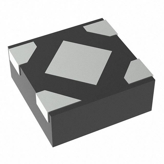

RP300x Series High Accuracy Voltage Detector with Delay Function (Internal Counter Type) No.EA-306-210329 OUTLINE The RP300x is a voltage detector (VD) IC with a built-in output delay circuit. The RP300x is available in internally fixed detector threshold type. When the VDD voltage becomes lower than the preset voltage, the RP300xxxxA/C generates a “L” reset signal and the RP300xxxxB(1) generates a “H” reset signal. The detector threshold accuracy is as high as ±1.0% when −VSET(2) < 1.7 V and ±0.8% when 1.7 V ≤ −VSET. The reset output signal remains asserted for 50 ms, 100 ms(3) or 200 ms after the VDD voltage rises above the threshold voltage or when manual reset is canceled. The RP300x is designed to ignore fast transients on the VDD pin. The output delay time accuracy is as high as ±5.0%. The RP300x is available in an Nch open drain output type or in a CMOS output type. The RP300x is offered in a small DFN(PLP)1010-4B package or in a SOT-23-5 package. FEATURES • • • Operating Voltage Range (Maximum Rating) ········· 0.72 V to 5.50 V (6.0V) • • • • • • • Detector Threshold Accuracy ····························· ±1.0% (−VSET < 1.7 V), ±0.8% (1.7 V ≤ −VSET) Supply Current ··············································· Typ. 0.95 µA (−VSET = 3.08 V, VDD = 3.18 V) Detector Threshold Range ································ 1.1 V, 2.32 V, 2.63 V, 2.7 V, 2.8 V, 2.93 V, 3.08 V, 4.2 V, 4.38 V, 4.6 V Detector Threshold Temperature Coefficient ·········· Typ. ±50 ppm/°C Released Output Delay Time ····························· Typ. 50 ms, 100 ms (Custom IC), 200 ms Released Output Delay Time Accuracy ················ ±5% (Ta=25°C), ±15% (−40°C ≤ Ta ≤ 85°C) Output Type ··················································· Nch Open Drain output, CMOS Output Reset Signal ·················································· Active-low, Active-high (Custom IC) Package ························································ DFN(PLP)1010-4B ( 1.0 mm x 1.0 mm x 0.6 mm ) SOT-23-5 ( 2.9 mm x 2.8 mm x 1.1 mm ) APPLICATIONS • • (1) (2) (3) Voltage monitoring for handheld communication equipment, camera and VCRs. Voltage monitoring for battery-powered equipment RP300xxxxB is a custom IC. For more information about a custom IC, please contact our sales representatives. −VSET is defined as a preset detector threshold. Delay time of 100ms is offered as a custom IC. 1 RP300x No.EA-306-210329 SELECTION GUIDE With the RP300x, the detector threshold, the package type, the released output delay time and the output type are user-selectable options. Package Quantity per Reel Pb Free Halogen Free DFN(PLP)1010-4B 10,000 pcs Yes Yes SOT-23-5 3,000 pcs Yes Yes Product Name RP300Kxxy∗(z)-TR RP300Nxxy∗(z)-TR-FE xx: Specify −VSET from 1.1 V (11), 2.32 V (23), 2.63 V (26), 2.7 V (27), 2.8 V (28), 2.93 V (29), 3.08 V (30), 4.2 V (42), 4.38 V (43), 4.6 V (46). z: If −VSET includes the 3rd digit, indicate the digit of 0.01 V. Ex. If −VSET is 2.63 V, indicate as RP300x26xx3-TR-x. y: Specify the released output delay time. (A) 50 ms (B) 100 ms (custom IC) (D) 200 ms ∗: Specify the output type. (A) Nch Open Drain Output (B) Nch Open Drain Inverting Output (custom IC) (C) CMOS Output BLOCK DIAGRAMS RP300xxxxA/B (Nch Open Drain Output) RP300xxxxC (CMOS Output) 2 RP300x No.EA-306-210329 PIN DESCRIPTION Top View 4 Bottom View 3 3 Top View 5 4 4 (mark side) 1 2 2 1 1 RP300K [DFN(PLP)1010-4B] 2 3 RP300N (SOT- 23-5) RP300K Pin Description Pin No. Symbol Pin Description 1 OUT Output Pin RP300xxxxA/C: asserts an active-low reset signal when a voltage drops below the detector threshold. RP300xxxxB: asserts an active-high reset signal when a voltage drops below the detector threshold. (custom IC) 2 MR Manual Reset Input Pin: active-low 3 GND Ground Pin 4 VDD Power Supply Pin The tab on the bottom of the package enhances thermal performance and is electrically connected to GND (substarate level). It is recommended that the tab be connected to the ground plane on the board. If not, the tab can be left open. RP300N Pin Description Pin No. Symbol 1 MR 2 GND 3 NC Description Manual Reset Input Pin: active-low Ground Pin No Connection 4 OUT Output Pin RP300xxxxA/C: asserts an active-low reset signal when a voltage drops below the detector threshold. RP300xxxxB: asserts an active-high reset signal when a voltage drops below the detector threshold. (custom IC) 5 VDD Power Supply Pin 3 RP300x No.EA-306-210329 ABSOLUTE MAXIMUM RATINGS Symbol VIN OUT Parameter Input Voltage Output Voltage (Nch Open Drain Output) Rating Unit 6.0 V −0.3 to 6.0 V Output Voltage (CMOS Output) −0.3 to VDD +0.3 MR Manual Reset Pin −0.3 to VDD +0.3 V IOUT Output Current 20 mA PD Power Dissipation(1) DFN(PLP)1010-4B 800 (JEDEC STD. 51-7) SOT-23-5 660 mW Tj Junction Temperature Range −40 to 125 °C Tstg Storage Temperature Range −55 to 125 °C ABSOLUTE MAXIMUM RATINGS Electronic and mechanical stress momentarily exceeded absolute maximum ratings may cause the permanent damages and may degrade the life time and safety for both device and system using the device in the field. The functional operation at or over these absolute maximum ratings are not assured. RECOMMENDED OPERATING CONDITIONS Symbol Parameter Rating Unit VDD Operating Voltage 0.72 to 5.5 V Ta Operating Temperature Range −40 to 85 °C RECOMMENDED OPERATING CONDITIONS All of electronic equipment should be designed that the mounted semiconductor devices operate within the recommended operating conditions. The semiconductor devices cannot operate normally over the recommended operating conditions, even if when they are used over such conditions by momentary electronic noise or surge. And the semiconductor devices may receive serious damage when they continue to operate over the recommended operating conditions. (1) Refer to POWER DISSIPATION for detailed information. 4 RP300x No.EA-306-210329 ELECTRICAL CHARACTERISTICS The specifications surrounded by are guaranteed by design engineering at −40°C ≤ Ta ≤ 85°C. RP300x Electrical Characteristics Symbol Parameter −VDET Threshold(1) (Ta = 25°C) Ta = 25°C Detector Condition 1.1 V ≤ −VSET < 1.7 V 1.7 V ≤ −VSET −40°C ≤ Ta 1.1 V ≤ −VSET < 1.7 V ≤ 85°C 1.7 V ≤ −VSET Min. ×0.99 ×0.992 Typ. Max. Unit ×1.010 V ×1.008 V ×0.982 ×1.018 V ×0.984 ×1.016 V ISS1 Supply Current 1 VDD = −VSET −0.1 V, IOUT = 0 A 3.2 µA ISS2 Supply Current 2 VDD = −VSET +0.1 V, IOUT = 0 A 3.1 VDD Operating Voltage Ta = 25°C 0.72 5.5 µA V −40°C ≤ Ta ≤ 85°C 0.80 5.5 V −VSET ≥ 1.1 V −VSET ≥ 1.6 V −VSET ≥ 2.7 V −VSET ≥ 1.1 V Nch Inverting(2) VDD = −VSET +0.1 V −VSET ≥ 1.4 V VDS = 0.3 V −VSET ≥ 2.5 V −VSET ≥ 1.1 V Pch CMOS VDD = −VSET +0.1 V −VSET ≥ 1.6 V VDS = −0.3 V −VSET ≥ 2.7 V VDD = 5.5 V RP300xxxxA/C VDS = 5.5 V Nch VDD = −VSET −0.1 V VDS = 0.3 V IOUT Output Current (Driver Output Pin) ILEAK Nch Driver Leakage Current RMR MR Pin Pull-up Resistance VIH MR Pin Input Voltage “H” VDD ≥ −VSET +0.1 V VIL MR Pin Input Voltage “L” VDD ≥ −VSET +0.1 V tDELAY Released Output Delay Time(4) RP300xxxxB(3) VDD = 0.8 V → −VSET +1.0 V Detector Threshold Temperature Coefficient −40°C ≤ Ta ≤ 85°C mA mA mA mA mA mA mA mA mA VDD=−VSET − 0.1 V VDS = 5.5 V 0.21 −40°C ≤ Ta ≤ 85°C ∆−VDET /∆Ta 0.45 2.5 4.8 0.45 2.5 4.8 −0.15 −0.45 −0.8 0.45 0.15 µA 0.90 MΩ 0.75 ×VDD RP300xxxAx RP300xxxBx(5) RP300xxxDx 47.5 95 190 V 50 100 200 tSET ×0.85 ±50 0.4 V 52.5 105 210 ms tSET ×1.15 % ppm /°C All test items listed under Electrical Characteristics are done under the pulse load condition (Tj ≈ Ta = 25°C) except Detector Threshold Temperature Coefficient. (1) (2) −VDET is defined as an actual detector threshold and −VSET is defined as a preset detector threshold. Nch open drain inverting output type is only applicable to the RP300xxxxB which is a custom IC. The RP300xxxxB is a custom IC. (4) t DELAY is defined as an actual released output delay time and tset is defined as a preset released output delay time. (5) The RP300xxxBx is a custom IC. (3) 5 RP300x No.EA-306-210329 Product-specific Electrical Characteristics The specifications surrounded by are guaranteed by design engineering at −40°C ≤ Ta ≤ 85°C. -VDET [V] Ta = 25°C Product Name −40°C ≤ Ta ≤ 85°C Min. Typ. Max. Min. Typ. Max. RP300x11xx 1.089 1.100 1.111 1.081 1.100 1.119 RP300x23xx2 2.302 2.320 2.338 2.283 2.320 2.357 RP300x26xx3 2.609 2.630 2.651 2.588 2.630 2.672 RP300x27xx 2.679 2.700 2.721 2.657 2.700 2.743 RP300x28xx 2.778 2.800 2.822 2.756 2.800 2.844 RP300x29xx3 2.907 2.930 2.953 2.884 2.930 2.976 RP300x30xx8 3.056 3.080 3.104 3.031 3.080 3.129 RP300x42xx 4.167 4.200 4.233 4.133 4.200 4.267 RP300x43xx8 4.345 4.380 4.415 4.310 4.380 4.450 RP300x46xx 4.564 4.600 4.636 4.527 4.600 4.673 6 RP300x No.EA-306-210329 THEORY OF OPERATION Timing Chart Detector Threshold = Release Voltage (VDET) Detector Threshold = Release Voltage (VDET) Power Supply Voltage (VDD) Min. Operating Voltage Power Supply Voltage (VDD) Min. Operating Voltage GND GND Manual Reset Manual Reset GND GND VPULLUP VPULLUP Output Voltage (VOUT) Output Voltage (VOUT) GND GND tdelay tdelay RP300xxxxA Timing Chart tdelay tdelay RP300xxxxB Timing Chart Detector Threshold = Release Voltage (VDET) Power Supply Voltage (VDD) Min. Operating Voltage GND Manual Reset GND VOUT Unstable Area Output Voltage (VOUT) GND tdelay tdelay RP300xxxxC Timing Chart 7 RP300x No.EA-306-210329 Release Output Delay Time (tDELAY) tDELAY is defined as follows. 1. Nch Open Drain Output Release output delay time starts after the OUT pin is pulled up to 5.5 V with a 470 kΩ resistor, and the VDD voltage is shifted from 0.8 V to −VSET + 1.0 V. It ends when the output voltage reaches 1.0 V. 2. Nch Open Drain Inverting Output (custom IC) Release output delay time starts after the OUT pin is pulled up to 5.5 V with a 470 kΩ resistor, and the VDD voltage is shifted from 0.8 V to −VSET + 1.0 V. It ends when the output voltage reaches VDD / 2 V. 3. CMOS Output Release output delay time starts when the VDD voltage is shifted from 0.8 V to −VSET + 1.0 V and ends when the output voltage reaches VDD / 2 V. -V S E T +1.0V -V S E T +1.0V Power Supply Voltage (V D D ) Power Supply Voltage (V D D ) 0.8V 0.8V GND GND 5.5V Output Voltage (V O U T ) 2 . 7 5 V 1.0V 5.5V Output Voltage (V O U T ) GND 2.75V GND trst tdelay Nch Open Drain Output trst tdelay Nch Open Drain Inverting Output -V S E T +1.0V Power Supply Voltage (V D D ) 0.8V GND -V S E T +1.0V Output Voltage (-V S E T +1.0V)/2 (V O U T ) GND trst tdelay CMOS Output 8 RP300x No.EA-306-210329 RP300xxxxA/C Operating VDD Ra Pch + Delay Circuit - OUT Comparator Vref Rb Nch GND Block Diagram ・ For CMOS Output, the Nch Tr. drain and the Pch Tr. drain are connected to the OUT pin inside the IC. ・ For Nch Open Drain Output, the Nch Tr. drain is connected to the OUT pin inside the IC. Pull up the OUT pin or VDD pin to the external voltage level. 1 2 3 4 1 5 2 3 A 5 B B Power Supply Voltage (VDD) 4 Detector Threshold (VDET) Detector Threshold (VDET) Power Supply A Voltage (VDD) = Release Voltage = Release Voltage Min. Operating Voltage Min. Operating Voltage GND GND Pull-up Voltage Output Voltage (VOUT) tdelay Output Voltage (VOUT) Unstable Area GND GND Timing Chart (A Ver.) tdelay Timing Chart (C Ver.) 1. The output voltage is equalized to the VDD voltage (CMOS Output), or to the pull-up voltage (Nch Open Drain Output). 2. The VDD voltage drops to the detector threshold (A point) which means Vref ≥ VDD x Rb / (Ra + Rb). The comparator output shifts from “L” to “H” voltage and the output voltage will be equalized to the GND voltage. 3. If the VDD voltage is lower than the minimum operating voltage, the output voltage becomes unstable (CMOS Output). The output voltage is equalized to the pull-up voltage (Nch Open Drain Output). 4. The output voltage is equalized to the GND voltage. 5. The VDD voltage becomes higher than the release voltage (B point) which means Vref < VDD x Rb / (Ra + Rb), and the comparator output shifts from “H” to “L” voltage, and the output voltage is equalized to the VDD voltage (CMOS Output) or to the pull-up voltage (Nch Open Drain Output). Note: There’s no hysteresis between the VDD voltage and the released voltage. 9 RP300x No.EA-306-210329 RP300xxxxB Operating VDD Ra + Delay Circuit Vref Rb OUT Comparator Nch GND Block Diagram ・ The Nch Tr. drain is connected to the OUT pin inside the IC. Pull up the OUT pin or VDD pin to the external voltage level. 1 2 3 4 5 B Power Supply Voltage (VDD) Detector Threshold (VDET) A = Release Voltage Min. Operating Voltage GND Pull-up Voltage Output Voltage (VOUT) tdelay GND Timing Chart 1. The output voltage is equalized to the GND voltage. 2. The VDD voltage drops to the detector threshold (A point) which means Vref ≥ VDD x Rb / (Ra + Rb). The comparator output shifts from “H” to “L” voltage and the output voltage shifts from the pull-up voltage to “L” voltage. 3. If the VDD voltage is lower than the minimum operating voltage, the output voltage is equalized to the pull-up voltage. 4. The output voltage is equalized to the pull-up voltage. 5. The VDD voltage becomes higher than the release voltage (B point) which means Vref < VDD x Rb / (Ra + Rb). The comparator output shifts from “L” to “H” voltage, and the output voltage is equalized to the GND voltage. Note: There’s no hysteresis between the VDD voltage and the released voltage. 10 RP300x No.EA-306-210329 Detector Operation vs. Glitch Input Voltage The RP300x has built-in rejection of fast transients on the VDD pins. The rejection of transients depends on both the duration and the amplitude of the transient. The amplitude of the transient is measured from the bottom of the transient to the negative threshold voltage of the RP300x. グリッジ耐性評価 Glitch Resistance Test 480 440 400 360 320 280 240 200 160 120 80 40 0 Minimum Pulse Duration at VDD (µs) 検出電圧を横切るパルス幅(μs) RP300x46xx RP300x27xx RP300x11xx 1 10 100 1000 Threshold Overdrive Voltage at VDD (mV) 検出電圧に対するオーバードライブ量(mV) Minimum Pulse Duration at VDD vs. Overdrive Voltage at VDD Pulse Duration Transient Amplitude (VDET-VDDmin) VDD Input Waveform Voltage Transient Measurement The RP300x does not respond to transients that are fast duration/ low amplitude or long duration/ small amplitude. The above graph shows the relationship between the transient amplitude and duration needed to trigger a reset. Any combination of duration and amplitude above the curve generates a reset signal. 11 RP300x No.EA-306-210329 APPLICATION INFORMATION Typical Applications VDD Pull up Voltage OUT RP300x VOUT VIN MR Control GND MR Note: The CMOS output type does not require a pull-up resistor. RP300x Typical Application Circuit TECHNICAL NOTES When connecting resistors to the device’s input pin When connecting a resistor (R1) to an input of this device, the input voltage decreases by [Device’s Consumption Current] x [Resistance Value] only. And, the cross conduction current(1), which occurs when changing from the detecting state to the release state, is decreased the input voltage by [Cross Conduction Current] x [Resistance Value] only. And then, this device will enter the re-detecting state if the input voltage reduction is larger than the difference between the detector voltage and the released voltage. When the input resistance value is large and the VDD is gone up at mildly in the vicinity of the released voltage, repeating the above operation may result in the occurrence of output. As shown in Figure A/B, set R1 to become 100kΩ or less as a guide, and connect CIN(2) of 0.1μF and more to between the input pin and GND. Besides, make evaluations including temperature properties under the actual usage condition, with using the evaluation board like this way. As result, make sure that the cross conduction current has no problem. R1 R1 VDD CIN(2) Voltage Detector VDD OUT pin R2 CIN (2 ) GND Figure A (1) In Voltage Detector OUT pin GND Figure B the CMOS output type, a charging current for OUT pin is included. the bias dependence of capacitors. (2) Note 12 RP300x No.EA-306-210329 TYPICAL CHARACTERISTICS Note: Typical Characteristics are intended to be used as reference data; they are not guaranteed. 1) Supply Current vs. Input Voltage RP300x11xx Ta=-40℃ 2.5 Ta=85℃ Ta=25℃ 2 Ta=85℃ 1.5 1.5 1 1 0.5 0.5 0 0 0 1 2 3 4 5 Input Voltage VDD (V) 0 6 RP300x30xx8 3 Ta=-40℃ 2.5 6 RP300x46xx Ta=-40℃ Ta=25℃ Ta=85℃ 2.5 Ta=25℃ Ta=85℃ 2 1 2 3 4 5 Input Voltage VDD (V) 3 Supply Current ISS (μA) Supply Current ISS (μA) Ta=-40℃ 2.5 Ta=25℃ 2 RP300x23xx2 3 Supply Current ISS (μA) Supply Current ISS (μA) 3 2 1.5 1.5 1 1 0.5 0.5 0 0 0 1 2 3 4 5 Input Voltage VDD (V) 0 6 1 2 3 4 5 Input Voltage VDD (V) 6 2) Detector Threshold vs. Temperature RP300x23xx2 1.13 2.35 1.12 2.34 Detector Threshold -VDET(V) Detector Threshold -VDET(V) RP300x11xx 1.11 1.10 1.09 1.08 2.33 2.32 2.31 2.30 2.29 1.07 -50 -25 0 25 50 75 Temperature Ta(゚C) 100 -50 -25 0 25 50 75 100 Temperature Ta(゚C) 13 RP300x No.EA-306-210329 RP300x30xx8 RP300x46xx 4.80 4.75 3.10 Detector Threshold -VDET(V) Detector Threshold -VDET(V) 3.11 3.09 3.08 3.07 3.06 3.05 -50 -25 0 25 50 75 4.70 4.65 4.60 4.55 4.50 4.45 4.40 100 -50 -25 Temperature Ta(゚C) 0 25 50 75 100 Temperature Ta(゚C) 3) Nch Driver Output Current vs. Input Voltage RP300x23xA2/xC2 16 2 Nch Driver Output Current IOUT (mA) Nch Driver Output Current IOUT (mA) RP300x11xA/xC -40゚C 1.6 25゚C 85゚C 1.2 -40゚C 12 0.8 0.4 25゚C 85゚C 8 4 0 0 0 0.2 0.4 0.6 0.8 1 Input Voltage VDD (V) 0 1.2 Nch Driver Output Current IOUT (mA) Nch Driver Output Current IOUT (mA) -40゚C 16 25゚C 85゚C 12 8 4 0 0 0.5 1 1.5 2 2.5 3 Input Voltage VDD (V) 2.5 RP300x46xA/xC RP300x30xA8/xC8 20 0.5 1 1.5 2 Input Voltage VDD (V) 3.5 20 -40゚C 16 25゚C 85゚C 12 8 4 0 0 1 2 3 4 5 Input Voltage VDD (V) 14 RP300x No.EA-306-210329 Nch Driver Inverting Output (custom IC) RP300x23xB2 RP300x11xB -40゚C 25゚C 12 16 Nch Driver Output Current IOUT (mA) Nch Driver Output Current IOUT (mA) 16 85゚C 8 4 0 -40゚C 12 25゚C 85゚C 8 4 0 0 1 2 3 4 5 0 Input Voltage VDD (V) 4 5 Input Voltage VDD (V) RP300x30xB8 RP300x46xB 16 16 Nch Driver Output Current IOUT (mA) Nch Driver Output Current IOUT (mA) 3 2 1 -40゚C 12 25゚C 8 4 0 1 25゚C 12 85゚C 0 -40゚C 2 3 4 85゚C 8 4 0 5 0 1 Input Voltage VDD (V) 2 3 4 5 Input Voltage VDD (V) 4) Pch Driver Output Current vs. Input Voltage RP300x23xC2 RP300x11xC 20 VDS=-2.1V 16 Pch Driver Output Current IOUT (mA) Pch Driver Output Current IOUT (mA) 20 VDS=-1.0V 8 4 0 1 2 3 4 5 Input Voltage VDD (V) VDS=-1.0V 12 VDS=-0.5V 0 VDS=-1.5V 16 VDS=-1.5V 12 VDS=-2.1V 6 VDS=-0.5V 8 4 0 0 1 2 3 4 5 6 Input Voltage VDD (V) 15 RP300x No.EA-306-210329 RP300x46xC 20 VDS=-2.1V 16 Pch Driver Output Current IOUT (mA) Pch Driver Output Current IOUT (mA) RP300x30xC8 VDS=-1.5V VDS=-1.0V 12 VDS=-0.5V 8 4 20 VDS=-2.1V 16 VDS=-1.5V VDS=-1.0V 12 VDS=-0.5V 8 4 0 0 0 1 2 3 4 5 6 1 0 Input Voltage VDD (V) 4 3 2 5 6 Input Voltage VDD (V) 5) Nch Driver Output Current vs. VDS RP300x23xA2/xC2 RP300x11xA/xC 14 Nch Driver Output Current IOUT (mA) Nch Driver Output Current IOUT (mA) 2 12 1.6 10 1.2 0.8 VDD=0.8V VDD=1.0V 0.4 8 VDD=1.0V 4 VDD=2.0V 2 0 0 0 0.2 0.4 0.6 0.8 VDS (V) 1 0 1.2 0.4 0.8 1.2 1.6 2 VDS (V) RP300x46xA/xC RP300x30xA8/xC8 25 25 Nch Driver Output Current IOUT (mA) Nch Driver Output Current IOUT (mA) VDD=0.8V 6 20 20 15 15 10 10 VDD=1.0V VDD=2.0V 5 VDD=3.0V 0 0 0.5 1 1.5 VDS (V) 2 2.5 VDD=1.0V VDD=2.0V 5 VDD=4.0V 0 3 0 0.5 1 1.5 2 2.5 3 3.5 4 VDS (V) 16 RP300x No.EA-306-210329 Nch Driver Inverting Output (custom IC) RP300x23xB2 25 Nch Driver Output Current IOUT (mA) Nch Driver Output Current IOUT (mA) RP300x11xB 20 15 VDD=2.0V VDD=3.0V 10 VDD=4.0V 5 VDD=5.5V 25 20 15 10 VDD=3.0V VDD=4.0V 5 VDD=5.5V 0 0 0 1 2 3 4 0 5 2 1 RP300x46xB RP300x30xB8 25 Nch Driver Output Current IOUT (mA) Nch Driver Output Current IOUT (mA) 5 VDS (V) VDS (V) 20 15 VDD=4.0V 10 4 3 VDD=5.5V 5 25 20 15 VDD=5.0V 10 VDD=5.5V 5 0 0 0 1 2 3 4 0 5 1 2 3 4 5 VDS (V) VDS (V) 6) Released Output Delay Time vs. Temperature RP300x11Ax RP300x23Ax2 60 Released Output Delay Time tDELAY (ms) Released Output Delay Time tDELAY (ms) 60 56 52 48 44 56 52 48 44 40 40 -50 -25 0 25 50 75 Temperature Ta (℃) 100 -50 -25 0 25 50 75 Temperature Ta (℃) 100 17 RP300x No.EA-306-210329 RP300x30Ax8 56 52 48 44 55 50 45 40 40 -50 -25 0 25 50 75 Temperature Ta (℃) -50 100 RP300x11Dx 230 210 190 170 -25 0 25 50 75 Temperature Ta (℃) 100 RP300x23Dx2 250 Released Output Delay Time tDELAY (ms) 250 Released Output Delay Time tDELAY (ms) RP300x46Ax 60 Released Output Delay Time tDELAY (ms) Released Output Delay Time tDELAY (ms) 60 230 210 190 170 150 150 -50 -25 0 25 50 75 Temperature Ta (℃) -50 100 RP300x30Dx8 Released Output Delay Time tDELAY (ms) 230 210 190 170 100 RP300x46Dx 250 Released Output Delay Time tDELAY (ms) 250 -25 0 25 50 75 Temperature Ta (℃) 230 210 190 170 150 150 -50 -25 0 25 50 75 Temperature Ta (℃) 100 -50 -25 0 25 50 75 Temperature Ta (℃) 100 18 POWER DISSIPATION DFN(PLP)1010-4B Ver. A The power dissipation of the package is dependent on PCB material, layout, and environmental conditions. The following measurement conditions are based on JEDEC STD. 51-7. Measurement Conditions Item Measurement Conditions Environment Mounting on Board (Wind Velocity = 0 m/s) Board Material Glass Cloth Epoxy Plastic (Four-Layer Board) Board Dimensions 76.2 mm × 114.3 mm × 0.8 mm Outer Layer (First Layer): Less than 95% of 50 mm Square Inner Layers (Second and Third Layers): Approx. 100% of 50 mm Square Outer Layer (Fourth Layer): Approx. 100% of 50 mm Square Copper Ratio φ 0.2 mm × 11 pcs Through-holes Measurement Result (Ta = 25°C, Tjmax = 125°C) Item Measurement Result Power Dissipation 800 mW Thermal Resistance (θja) θja = 125°C/W Thermal Characterization Parameter (ψjt) ψjt = 58°C/W θja: Junction-to-Ambient Thermal Resistance ψjt: Junction-to-Top Thermal Characterization Parameter 1000 900 Power Dissipation PD (mW) 800 700 600 500 400 300 200 100 0 0 25 50 75 85 100 125 Ambient Temperature (°C) Power Dissipation vs. Ambient Temperature Measurement Board Pattern i PACKAGE DIMENSIONS DFN(PLP)1010-4B Ver. A 0.65 B 3 0.25±0.05 1.00 0.05 0.07±0.05 X4 C0.18 0.05±0.05 ∗ 0.48±0.05 DETAIL : “A” 45° 0.04 “A” 2 1 0.25±0.05 0.48±0.05 0.045 0.05 M S AB 0.03min 0.6max INDEX 4 C0.10 A 1.00 S 0.05 S DFN (PLP) 1010-4B Package Dimensions (Unit: mm) * ∗ The tab on the bottom of the package is a substrate potential (GND). It is recommended that this tab be connected to the ground plane on the board but it is possible to leave the tab floating. i POWER DISSIPATION SOT-23-5 Ver. A The power dissipation of the package is dependent on PCB material, layout, and environmental conditions. The following measurement conditions are based on JEDEC STD. 51-7. Measurement Conditions Item Measurement Conditions Environment Mounting on Board (Wind Velocity = 0 m/s) Board Material Glass Cloth Epoxy Plastic (Four-Layer Board) Board Dimensions 76.2 mm × 114.3 mm × 0.8 mm Copper Ratio Outer Layer (First Layer): Less than 95% of 50 mm Square Inner Layers (Second and Third Layers): Approx. 100% of 50 mm Square Outer Layer (Fourth Layer): Approx. 100% of 50 mm Square Through-holes  0.3 mm × 7 pcs Measurement Result Item (Ta = 25°C, Tjmax = 125°C) Measurement Result Power Dissipation 660 mW Thermal Resistance (ja) ja = 150°C/W Thermal Characterization Parameter (ψjt) ψjt = 51°C/W ja: Junction-to-Ambient Thermal Resistance ψjt: Junction-to-Top Thermal Characterization Parameter Power Dissipation vs. Ambient Temperature Measurement Board Pattern i SOT-23-5 PACKAGE DIMENSIONS Ver. A 2.9±0.2 1.1±0.1 1.9±0.2 0.8±0.1 (0.95) 4 1 2 0~0.1 0.2min. +0.2 1.6-0.1 5 2.8±0.3 (0.95) 3 0.4±0.1 +0.1 0.15-0.05 SOT-23-5 Package Dimensions i 1. The products and the product specifications described in this document are subject to change or discontinuation of production without notice for reasons such as improvement. Therefore, before deciding to use the products, please refer to Ricoh sales representatives for the latest information thereon. 2. The materials in this document may not be copied or otherwise reproduced in whole or in part without prior written consent of Ricoh. 3. Please be sure to take any necessary formalities under relevant laws or regulations before exporting or otherwise taking out of your country the products or the technical information described herein. 4. The technical information described in this document shows typical characteristics of and example application circuits for the products. The release of such information is not to be construed as a warranty of or a grant of license under Ricoh's or any third party's intellectual property rights or any other rights. 5. The products listed in this document are intended and designed for use as general electronic components in standard applications (office equipment, telecommunication equipment, measuring instruments, consumer electronic products, amusement equipment etc.). Those customers intending to use a product in an application requiring extreme quality and reliability, for example, in a highly specific application where the failure or misoperation of the product could result in human injury or death (aircraft, spacevehicle, nuclear reactor control system, traffic control system, automotive and transportation equipment, combustion equipment, safety devices, life support system etc.) should first contact us. 6. We are making our continuous effort to improve the quality and reliability of our products, but semiconductor products are likely to fail with certain probability. In order to prevent any injury to persons or damages to property resulting from such failure, customers should be careful enough to incorporate safety measures in their design, such as redundancy feature, fire containment feature and fail-safe feature. We do not assume any liability or responsibility for any loss or damage arising from misuse or inappropriate use of the products. 7. Anti-radiation design is not implemented in the products described in this document. 8. The X-ray exposure can influence functions and characteristics of the products. Confirm the product functions and characteristics in the evaluation stage. 9. WLCSP products should be used in light shielded environments. The light exposure can influence functions and characteristics of the products under operation or storage. 10. There can be variation in the marking when different AOI (Automated Optical Inspection) equipment is used. In the case of recognizing the marking characteristic with AOI, please contact Ricoh sales or our distributor before attempting to use AOI. 11. Please contact Ricoh sales representatives should you have any questions or comments concerning the products or the technical information. Halogen Free Ricoh is committed to reducing the environmental loading materials in electrical devices with a view to contributing to the protection of human health and the environment. Ricoh has been providing RoHS compliant products since April 1, 2006 and Halogen-free products since April 1, 2012. Official website https://www.n-redc.co.jp/en/ Contact us https://www.n-redc.co.jp/en/buy/

物料型号:RP300x系列
器件简介: - RP300x系列是高精度电压检测器集成电路(IC),内置输出延迟电路。 - 该系列提供内部固定的检测阈值类型,当VDD电压低于预设电压时,会生成“低”或“高”的复位信号。
引脚分配: - RP300K [DFN(PLP)1010-4B]:1-OUT, 2-MR, 3-GND, 4-VDD - RP300N (SOT-23-5):1-MR, 2-GND, 3-NC, 4-OUT, 5-VDD
参数特性: - 工作电压范围:0.72V至5.50V(最大6.0V) - 供电电流:典型值0.95µA - 检测阈值范围:1.1V至4.6V - 检测阈值精度:±1.0%(-VSET < 1.7V),±0.8%(1.7V ≤ -VSET) - 输出延迟时间:50ms、100ms(定制IC)、200ms - 输出类型:Nch开漏输出或CMOS输出
功能详解: - 设计用于忽略VDD引脚上的快速瞬变。 - 输出延迟时间精度高达±5.0%。 - 提供小尺寸DFN(PLP)1010-4B或SOT-23-5封装。
应用信息: - 用于手持通信设备、相机、录像机的电压监控。 - 也适用于电池供电设备的电压监控。
封装信息: - DFN(PLP)1010-4B:1.0 mm x 1.0 mm x 0.6 mm - SOT-23-5:2.9 mm x 2.8 mm x 1.1 mm
