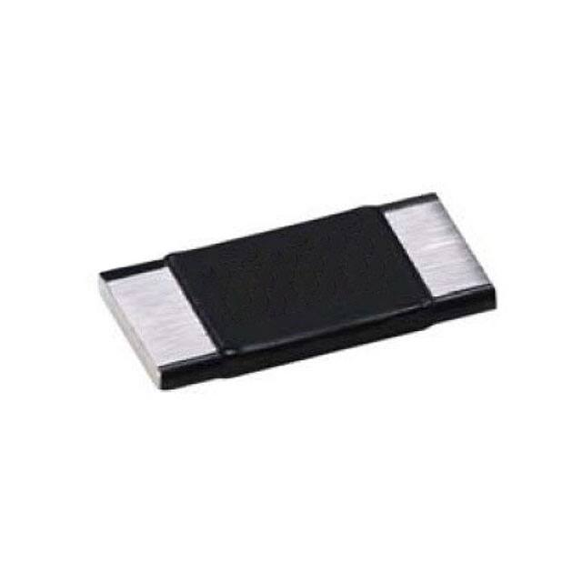

CSRL Series Power Metal Element Current Sense Chip Resistor • • • • • • Resistances from 0.5 mOhm to 200 mOhm Power Rating up to 3 Watts Resistance Tolerances to ± 0.5% TCR’s to ±25 ppm/°C Sizes: 1206 & 2512 Non-Inductive Metal Element (< 5nH) Electrical Specifications Type Power Rating ( W ) at 70°C CSRL1 (1206) 1 Resistances ( mW ) * TCR (ppm/°C) 8, 10, 12, 15, 20, 25, 30, 33, 40 ±50 3, 4, 5, 7, 8, 10, 12, 15, 20 , 25, 30, 33, 40 ±75, ±100 0.5, 0.75, 1, 1.5, 2 ±50 3, 4, 5, 6, 7, 18, 20, 22, 25, 30, 33, 35, 39, 40, 47, 50, CSRL3 (2512) 3 0.5%, 1%, 5% 1%, 5% ±25 60, 68, 70, 75, 80, 82, 90, 91, 100, 120, 150, 180, 200 3, 4, 5, 6, 7, 8, 9, 10, 12, 15, 18, 20, 22, 25, 30, 33, 35, 39, 40, 47, 50, 60, 68, 70, 75, 80, 82, 90, 91, 100, 120 Available Tolerances 0.5%, 1%, 5% ±50, ±75 150, 180, 200 * Other resistance values may be available, please consult factory | Maximum Operating Voltage =SQRT(P*R) Environmental Specifications Operating Temperature Range -55°C to +170°C Terminal Finish Nickel / Tin Test ΔR Test Method TCR As Specified +25°C ~125°C, 25°C is the reference temperature Short Time Overload +1.0% 5 times rated power for 5 seconds Load Life +1.0% 70+2°C, rated power for 1000 hrs with 1.5 hrs “ON” and 0.5 hr “OFF” Dry Heat +1.0% +170°C for 1000 hrs Solderability 95% min 245+5°C for 3 seconds Resistance to Soldering Heat +0.5% 260+5°C for 10 seconds Thermal Shock +1.0% -55°C to +155°C, 5 cycles Insulation Resistance ≥10G 100V DC for 1 minute Biased Humidity +1.0% 1000 hrs 85°C / 85%RH 10% of operating power Dry Heat +1.0% +170°C for 1000 hrs Bending Strength +1.0% Bending width 2mm once for 60 seconds Low temperature Storage ± 1.0% -55°C for 2 hrs Riedon Inc. © Riedon, Inc. 300 Cypress Avenue Alhambra CA 91801 (626) 284-9901 www.riedon.com sales@riedon.com (626) 284-1704 Revised: 202106_003 CSRL Series Power Metal Element Current Sense Chip Resistor Dimensions Resistance Type CSRL1 CSRL3 Resistor Body ( mW ) L (mm) B (mm) 3 - 40 3.10±0.10 1.60±0.10 0.5 6.35±0.254 0.75 Suggested Land Pattern C (mm) D (mm) Mass * S (mm) T (mm) W (mm) (g/1000) 0.45±0.15 0.60±0.10 1.50 1.40 1.70 9.06 3.18±0.254 1.30±0.38 1.25±0.20 2.95 2.70 3.60 184.11 6.35±0.254 3.18±0.254 1.30±0.38 0.75±0.20 2.95 2.70 3.60 131.11 1 6.35±0.254 3.18±0.254 1.30±0.38 0.65±0.20 2.95 2.70 3.60 110.85 1.5 6.35±0.254 3.18±0.254 1.30±0.38 0.45±0.20 2.95 2.70 3.60 67.16 2 6.35±0.254 3.18±0.254 1.30±0.38 0.35±0.20 2.95 2.70 3.60 49.30 3 - 200 6.40±0.25 3.20±0.25 0.90±0.30 0.70±0.20 4.00 2.00 3.50 40.20 *CSRL1, 5000 per reel | CSRL3 ≤ 0.003W, 2000 per reel, all other values, 4000 per reel Suggested Landing Patter Power Derating Curve FR4 copper board, 100μm of copper pad thickness 120 Power ( % ) 100 80 60 40 20 0 0 20 40 60 80 100 120 140 160 180 Ambient Temperature (°C) Ordering Information Example: TYPE - CSRL CSRL3 0.01 OHM 1% 50PPM Resistance TCR if omitted, highest value will be supplied fixed values between 0.0005 and 0.2 ohm see table 1, 3 size/power rating Riedon Inc. © Riedon, Inc. 0.5% 1% 5% tolerance resistance value dependent 300 Cypress Avenue Alhambra CA 91801 (626) 284-9901 www.riedon.com sales@riedon.com (626) 284-1704 Revised: 202106_003
