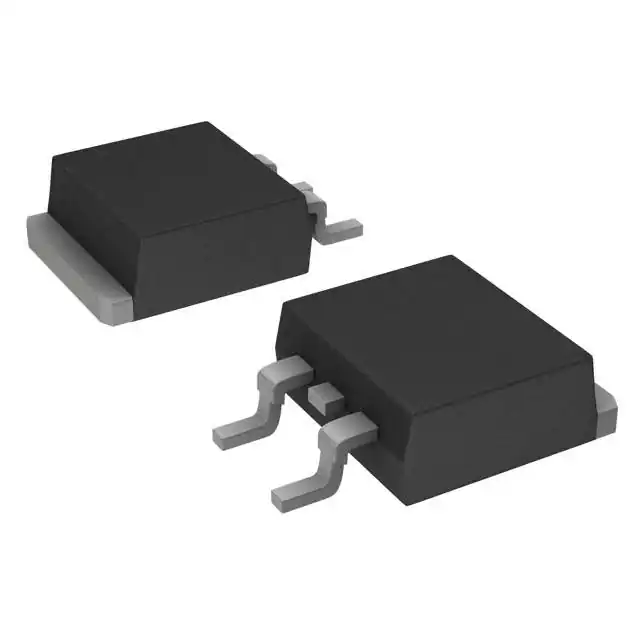

NPR NPS 2-T220 NHR NHS 2-T220 T221 Power Resistors • • • • • • • Resistances from 0.02Ohm to 100kOhms Power Rating to 50Watt Resistance Tolerances to ±1% TCR to ±50ppm/°C Load Stability to 0.5% TO-220 Housing Convenient SMD D2Pak Available SPECIFICATIONS Type Resistance Range NPR / NPS NHR / NHS 0.02 Ohms to 100kOhms 0.02 Ohms to 15kOhms 1.5 W 30 W 1.5 W 50 W 3.5 K/W 2.1 K/W Power rating free air 70°C with heatsink Thermal Resistance Rthj-c Tolerances from 0.02 Ohms from 1.0 Ohms 2% / 5% 1% / 2% / 5% Stability 0.5% Temperature Coefficient 0.02 to 0.049 Ohms 0.05 to 0.099 Ohms 0.1 Ohms to 100 kOhms ±600 ppm/°C ±300 ppm/°C ±100 ppm/°C upon request ±50 ppm/°C Voltage Proof 2.0 kVDC Max. Voltage depending on resistance value max. working voltage (VDC) 10000 1000 100 10 1 2 Ohm 10 Ohm Operating Temperature Range 1 kOhm 5 kOhm 10 kOhm 100 kOhm Thick Film Substrate Al2O3 Housing Epoxy or PPS Connector Material Cu tinned Terminals 2 Max. Torque 07/13 100 Ohm -40 to 155°C Resistor Material Riedon Inc. 1.5 kVDC T220: 1 Nm T221: 0.8 Nm 300 Cypress Avenue Alhambra CA 91801 www.riedon.com (626) 284-9901 (626) 284-1704 Page 80 NPR NPS 2-T220 T221 NHR NHS 2-T220 T221 Power Resistors SPECIFICATIONS (continued) Temperature Coefficient 100ppm/°C ∆R/R (ppm) 7000 50ppm/°C 2000 -3000 -8000 -50 -25 0 25 50 75 100 125 Temperature (°C) Derating Power ( % from nominal power) 120 Power Rating Notes The NPR / NHR Series Resistors must be attached to a suitable heatsink. The maximum internal resistor temperature is 155°C. To specify an appropriate heatsink use the following formula : 100 80 60 RθH = TMAX - ( P x RθR ) - TA P 40 20 Where: 0 25 50 85 100 115 130 145 155 Temperature of the backplate (°C) RθH = Thermal Resistance of Heatsink ( K/W ) RθR = Thermal Resistance of Resistor ( K/W ) TMAX = Maximum Temperature of Resistor TA = Ambient Temperature of Heatsink ( °C ) P = Power Through Resistor ( W ) Dimensions NPS / NHS 2-T220 Dimension mm tol. (±mm) inches tol. (±inches) A 12.70 0.2 0.50 0.008 Dimension mm inches 0.008 A 12.10 0.476 0.004 B 11.16 0.439 18.33 0.722 B C 07/13 0.76 0.2 0.1 0.40 0.03 D 5.08 0.1 0.20 0.004 C E 4.00 0.1 0.16 0.004 D 5.08 0.200 0.004 E 1.76 0.069 F 3.20 0.126 F Riedon Inc. 10.16 1.20 0.1 0.05 G 14.60 0.2 0.57 0.008 H 15.00 0.2 0.59 0.008 I 17.33 0.2 0.68 0.008 J 0.40 0.1 0.02 0.004 K 1.85 0.1 0.07 0.004 300 Cypress Avenue Alhambra CA 91801 www.riedon.com (626) 284-9901 (626) 284-1704 Page 81 NPR NPS 2-T220 T221 NHR NHS 2-T220 T221 Power Resistors SPECIFICATIONS (continued) NPR / NHR 2-T220 Dimension mm tol. (±mm) inches tol. (±inches) 0.008 A 17.30 0.2 0.68 B 10.16 0.2 0.40 0.008 C 6.00 0.1 0.24 0.004 D Ø3.7 0.1 Ø0.146 0.004 E 16.40 0.2 0.65 0.008 F 5.08 0.1 0.20 0.004 G 0.76 0.1 0.03 0.004 H 1.30 0.1 0.05 0.004 I 13.80 0.2 0.54 0.008 J 2.00 0.1 0.08 0.004 K 1.20 0.1 0.05 0.004 L 4.00 0.1 0.16 0.004 M 2.90 0.1 0.11 0.004 N 0.40 0.1 0.02 0.004 O 1.85 0.1 0.07 0.004 mm tol. (±mm) inches tol. (±inches) NPR / NHR 2-T221 Dimension A 18.30 0.2 0.72 0.008 B 10.16 0.2 0.40 0.008 C 3.70 0.1 0.15 0.004 D Ø3.2 0.1 Ø0.126 0.004 E 16.40 0.2 0.65 0.008 0.004 F 5.08 0.1 0.20 G 0.76 0.1 0.03 0.004 H 1.30 0.1 0.05 0.004 I 13.80 0.2 0.54 0.008 J 2.00 0.1 0.08 0.004 K 1.20 0.1 0.05 0.004 0.004 L 4.00 0.1 0.16 M 3.90 0.1 0.15 0.004 N 0.40 0.1 0.02 0.004 O 1.85 0.1 0.07 0.004 Ordering Information Part Description: Part Type - Resistance - Contact - Tolerance NHR 2-T221 C 1.1 kOhms 1% Riedon Inc. 07/13 300 Cypress Avenue Alhambra CA 91801 www.riedon.com (626) 284-9901 (626) 284-1704 Page 82

1. 物料型号:NPR NPS 2-T220和NHR NHS 2-T220 T221。 2. 器件简介:这些电阻器提供从0.02欧姆到100千欧姆的电阻值,功率等级高达50瓦特,符合RoHS标准,具有±1%的电阻公差和±50ppm/°C的温度系数。 3. 引脚分配:文档中提到了2个引脚的配置。 4. 参数特性: - 电阻范围:0.02欧姆至100千欧姆。 - 功率等级:在70°C自由空气中为1.5瓦特,带散热器时可达30瓦特。 - 热阻:分别为3.5K/W和2.1K/W。 - 电阻公差:从0.02欧姆为2%/5%,从1.0欧姆为1%/2%/5%。 - 稳定性:0.5%。 - 温度系数:0.02至0.049欧姆为+600ppm/°C,0.05至0.099欧姆和0.1至100千欧姆为±300ppm/°C和±100ppm/°C。 - 耐压:根据电阻值,最大电压不同。 - 工作温度范围:-40至155°C。 5. 功能详解:文档提供了电阻器的温度系数图和功率降额曲线。 6. 应用信息:文档未明确提供应用信息,但根据参数特性,这些电阻器适用于需要高功率和精确电阻值的应用。 7. 封装信息:提供TO-220外壳和方便的SMD D2Pak封装。
