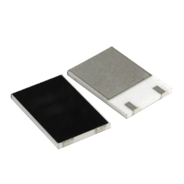

    厚膜电阻 3KΩ ±1% 25W
PFC10-3KF1 数据手册
PFC Series Thick Film Power SMD Resistors • • • • • • • • D-PAK Foot Pattern Very Low Profile Resistances from 0.1 to 51k ohms Suitable for Current Sensing Power Rating to 25 Watts Resistance Tolerances to ±1% TCR to ±100ppm/°C Isolated Back Plate SPECIFICATIONS Type PFC10 Power Rating with heatsink Short Time Overload 25 Watts 1 35 Watts 2 Thermal Resistance Rthj-c Resistance Range 3.6° K/W 0.1 - 51K Ohms E24+ (includes 2.5, 4.0, 5.0, 8.0, and 16) Tolerances (others upon request) 1% / 5% Temperature Coefficient 100 ppm/°K Operating Temperature -55°C to 155°C Max Operating Voltage P*R Capacitance 2.65 pF Inductance 15 nH Withstanding Voltage 1500 VAC Insulation Resistance Over 1,000 MΩ Resistor Material Thick Film Moisture Sensitivity Level MSL-1 Mass Standard Packaging 0.324 grams 500 pieces per 254 mm diameter reel within paper box. Test Conditions Load Life ±1% 90 min ON, 30 min OFF, 1000 hrs @ 25°C Humidity ±1% 90-95% RH, 0.1W, 1000 hrs @ 40°C Temperature Cycle ±0.25% -55°C for 30 min, +155°C for 30 min, 5 cycles Solder Heat ±0.1% 350°C ±5°C for 3 seconds Lead Solderability Vibration 1 2 Results Over 95% of surface ±0.25% 230° ±5°C for 3 seconds IEC60068-2-6 Power rating is 2.5 watt using a simple footprint and without heatsink Overload rating is permissible for continuous duty with back solder pad temerature not exceeding 25°C Ordering Information Part Description: Part Type - Resistance - Tolerance PFC10 10 Ohms 1% Riedon Inc. © Riedon, Inc. 300 Cypress Avenue Alhambra CA 91801 (626) 284-9901 www.riedon.com sales@riedon.com (626) 284-1704 Revised: 202007_004 PFC Series Thick Film Power SMD Resistors DIMENSIONS Solder Pad Layout H C A G B I F L E K D J Note: Back solder pad is isolated from both pins. Dimension mm tol. (±mm) inches tol. (±inches) A 8.20 0.20 0.323 0.008 B 12.0 0.20 0.472 0.008 C 0.90 0.10 0.039 0.002 D 5.08 0.10 0.200 0.004 E 0.75 0.1 0.030 0.002 F 1.85 0.05 0.070 0.002 G 8.50 - 0.335 - H 8.80 - 0.346 - I 14.1 - 0.555 - J 5.08 - 0.200 - K 2.00 - 0.079 - L 3.80 - 0.150 - CHIP CONSTRUCTION Riedon Inc. © Riedon, Inc. 300 Cypress Avenue Alhambra CA 91801 (626) 284-9901 www.riedon.com sales@riedon.com (626) 284-1704 Revised: 202007_004 PFC Series Thick Film Power SMD Resistors MOUNTING / DERATING Power Derating Curve Power Rating Notes - The PFC Series Resistors must be attached to a suitable heatsink. The maximum internal resistor temperature is 155°C. +25 °C 100 To specify an appropriate heatsink use the following formula : Power (%) 80 60 PFC10 +155 °C 40 20 0 -50 0 50 100 150 Heatsink Temperature (°C) 200 RHH = TMAX - (P * RHR) - TA P Where: RqH = Thermal Resistance of Heatsink ( K/W ) RqR = Thermal Resistance of Resistor ( K/W ) TMAX = Maximum Temperature of Resistor TA = Ambient Temperature of Heatsink ( °C ) P = Power Through Resistor ( W ) Via-Holes Copper Insert Copper insert improves thermal conductivity to heatsink. Power ratings of 35 watts can be achieved through active cooling of the heatsink. For more general information on heatsinking please see our training module on heatsinking by clicking here: https://riedon.com/media/pdf-tech/PowerandHeatsink.pdf Riedon Inc. © Riedon, Inc. 300 Cypress Avenue Alhambra CA 91801 (626) 284-9901 www.riedon.com sales@riedon.com (626) 284-1704 Revised: 202007_004
