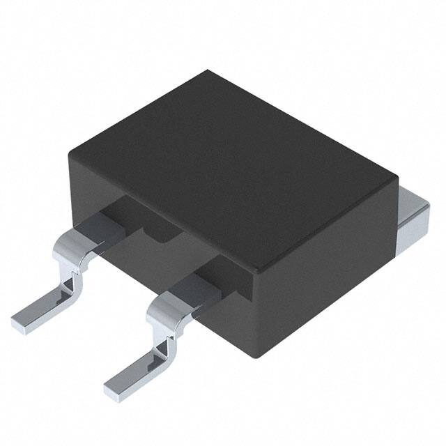

PFS35 Power SMD Film Resistors • • • • • • • • • • TO-263 Housing (D-Pak) Resistances from 0.01Ohm to 51kOhms Power Rating to 35Watt Resistance Tolerances to ±1% TCR to ±50ppm/°C Load Stability to 1% Low Ohm Values for Current Sense Applications Exceptional Pulse Performance Solder Reflow Secure at 260°C / 20s Isolated Back Plate SPECIFICATIONS Type PFS35 Terminals 2 Terminal Finish Tin Plated Copper Power Rating (with heatsink) 35 W ( 2W on Simple Solder Pad ) Thermal Resistance Rthj-c Resistance Range Tolerances (others upon request) Temperature Coefficient 3.3 K/W 0.01 to 0.099Ohms 0.1 to 9.9Ohms 10 to 51KOhms 5% 1% / 5% 1% ±250 ppm/°C ±100 ppm/°C ±50 ppm/°C Operating Temperature -55°C to 175°C Max Operating Voltage 500V Inductance 8.4 nH Voltage Proof 2.0kV DC Insulation Resistance Over 1,000 Megohm Resistor Material Thin Film Load Life ±1% 90 min ON, 30 min OFF, 1000 hrs @ 25C Humidity ±1% 90-95% RH, 0.1W, 1000 hrs @ 40C Temperature Cycle ±0.25% -55C for 30 min, +155C for 30 min, 5 cycles Solder Heat ±0.1% 350C ±5C for 3 seconds Vibration ±0.25% IEC60068-2-6 Flammability UL94V-0 Reflow soldering lead-free soldering 260°C / 20s (2 reflow cycles maximum) Moisture Sensitivity Level MSL-1 Mass 1.5g Ordering Information Part Description: Part Type - Resistance - Tolerance PFS35 10 Ohms 1% Riedon Inc. © Riedon, Inc. 300 Cypress Avenue Alhambra CA 91801 (626) 284-9901 www.riedon.com sales@riedon.com (626) 284-1704 Revised: 201908_004 PFS35 Power SMD Film Resistors Power Derating Power Rating Notes - % Power The PFS35 Series Resistors must be attached to a suitable heatsink. The maximum internal resistor temperature is 175°C. To specify an appropriate heatsink use the following formula : +25 °C 100 80 RHH = 60 40 20 +175 °C 0 -50 0 50 100 150 Flange Temperature (C) 200 TMAX - (P * RHR) - TA P Where: RqH = Thermal Resistance of Heatsink ( K/W ) RqR = Thermal Resistance of Resistor ( K/W ) TMAX = Maximum Temperature of Resistor TA = Ambient Temperature of Heatsink ( °C ) P = Power Through Resistor ( W ) DIMENSIONS Back plate is isolated from both pins. Dimension mm tol. (±mm) inches tol. (±inches) A 10.3 0.2 0.405 0.008 B 10.1 0.2 0.400 0.008 C 15.3 1.2 0.602 0.047 D 5.08 0.1 0.200 0.004 E 1.5 0.05 0.060 0.002 F 0.75 0.05 0.030 0.002 G 2.2 0.2 0.087 0.008 H 4.5 0.2 0.177 0.008 J 0.5 0.05 0.020 0.002 K 2.5 0.5 0.10 0.02 L 5.0 1.0 0.20 0.04 Riedon Inc. © Riedon, Inc. Pulse peak power (W) 100k 10k 1k 400W 100 35W 10 10n 100n 1u 10u 100u 1m 10m 100m Pulse width (seconds) 1 10 100 Tenative continuous-pulse allowance at duty 0.01. Load life test will be necessary in actual equipment, because curve may be changed by resistance, repetition, duty and perating temperature. 300 Cypress Avenue Alhambra CA 91801 (626) 284-9901 www.riedon.com sales@riedon.com (626) 284-1704 Revised: 201908_004

物料型号:PFS35 5RF 0826
器件简介: - 封装类型:TO-263 Housing (D-Pak) - 电阻范围:0.01欧姆至51千欧姆 - 功率等级:最高35瓦特 - 电阻公差:±1% - 温度系数:±50ppm/°C - 负载稳定性:1% - 低欧姆值适用于电流感应应用 - 出色的脉冲性能 - 260°C/20s的焊接再流安全性 - 隔离的背板
引脚分配:2个引脚,端子表面为锡镀铜
参数特性: - 功率等级(带散热器):35W(在简单焊盘上为2W) - 热阻:3.3 K/W - 电阻范围:0.01至0.099欧姆,0.1至9.9欧姆,10至51千欧姆 - 公差:5%,1%/5%,1% - 温度系数:+250 ppm/°C,±100 ppm/°C,±50 ppm/°C - 工作温度:-55°C至175°C - 最大工作电压:500V - 电感:8.4nH - 电压证明:2.0kV DC - 绝缘电阻:超过1,000兆欧姆 - 电阻材料:薄膜 - 负载寿命:±1%,90分钟开,30分钟关,1000小时@25°C - 湿度:±1%,90-95% RH,0.1W,1000小时@40°C - 温度循环:±0.25%,-55°C 30分钟,+155°C 30分钟,5个周期 - 焊接热:±0.1%,350°C 5秒 - 振动:±0.25% IEC60068-2-6 - 可燃性:UL94V-0 - 再流焊接:无铅焊接260°C/20秒(最多2次再流) - 湿度敏感等级:MSL-1 - 质量:1.5克
功能详解: - 电阻器必须附着在合适的散热器上,最大内部电阻器温度为175°C。 - 散热器的热阻计算公式:$ R_{\Theta H}=\frac{T_{MAX}-(P R_{\Theta R})-T_{A}}{P} $
应用信息: - 适用于电流感应应用和具有出色脉冲性能的场合。
封装信息: - 背板与两个引脚隔离,提供了详细的尺寸数据,包括A、B、C、D、E、F、G、H、J、K、L等尺寸的毫米和英寸值及其公差。
