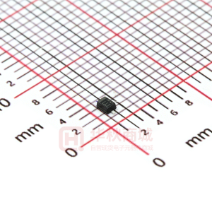

1SS380 数据手册
Switching Diode 1SS380 Applications High speed switching Dimensions (Unit : mm) 1.25±0.1 0.1±0.1     0.05 Land size figure (Unit : mm) 1.7±0.1 2.5±0.2 Features 1)Ultra small mold type. (UMD2) 2)High reliability 0.8MIN. 0.9MIN. UMD2 Construction Silicon epitaxial planar 0.3±0.05 0.7±0.2     0.1 Structure ROHM : UMD2 JEDEC : SOD-323 JEITA : SC-90/A dot (year week factory) Taping dimensions (Unit : mm) 4.0±0.1 2.0±0.05 φ1.55±0.05 1.75±0.1 0.3±0.1 3.5±0.05 8.0±0.2 1.40±0.1 4.0±0.1 φ1.05 1.0±0.1 Absolute maximum ratings (Ta=25C) Parameter Symbol Reverse voltage (repetitive peak) Reverse voltage (DC) Forward current Average rectified forward current Surge current (t=1s) Junction temperature Storage temperature VRM VR IFM Io Isurge Tj Tstg Limits 40 35 225 100 400 150 55 to 150 Unit V V mA mA mA C C Electrical characteristics (Ta=25C) Parameter Symbol Forward voltage Reverse current Capacitance between terminals VF IR Ct Min. - Typ. - Max. 1.2 0.01 5.0 Unit V μA pF IF=100mA VR=20V VR=0.5V , f=1MHz www.rohm.com ©2011 ROHM Co., Ltd. All rights reserved. 1/2 2.75 Conditions 2011.08 - Rev.C 2.8±0.1 2.1 1SS380   Data Sheet 100 100 REVERSE CURRENT : IR(nA) 10 1 0.1 0.01 Ta=150℃ Ta=125℃ 10 f=1MHz FORWARD CURRENT : I F(mA) 10 Ta=75℃ Ta=25℃ Ta=25℃ Ta=75℃ CAPACITANCE BETWEEN TERMINALS:Ct(pF) 20 Ta=125℃ Ta=25℃ 1 1 Ta=150℃ Ta=25℃ 0.001 0.1 0 0.1 0.2 0.3 0.4 0.5 0.6 0.7 0.8 0.9 1 1.1 1.2 FORWARD VOLTAGE : VF(V) VF-IF CHARACTERISTICS 0.0001 0 5 10 15 REVERSE VOLTAGE : VR(V) VR-IR CHARACTERISTICS 0.1 0 10 20 REVERSE VOLTAGE : VR(V) VR-Ct CHARACTERISTICS 30 970 Ta=25℃ IF=100mA n=30pcs 200 Ta=25℃ VR=20V n=30pcs 10 9 CAPACITANCE BETWEEN TERMINALS:Ct(pF) 8 7 6 5 4 3 2 1 0 AVE:3.24pF Ta=25℃ f=1MHz VR=0V n=10pcs FORWARD VOLTAGE : V F(mV) REVERSE CURRENT: IR(pA) 960 150 950 100 940 930 50 AVE:940.0mV 920 AVE:40.51pA 0 VF DISPERSION MAP IR DISPERSION MAP Ct DISPERSION MAP 15 1cyc 8.3ms REVERSE RECOVERY TIME:trr(ns) Ifsm PEAK SURGE FORWARD CURRENT : I FSM(A) 5 Ta=25℃ VR=6V IF=10mA RL=100Ω Irr=0.1*IR n=10pcs 20 PEAK SURGE FORWARD CURRENT : I FSM(A) Ifsm 15 8.3ms 8.3ms 4 10 3 1cyc 10 2 5 AVE:9.60A 1 AVE:1.20ns 0 5 0 IFSM DISPERSION MAP 0 1 trr DISPERSION MAP 10 NUMBER OF CYCLES IFSM-CYCLE CHARACTERISTICS 100 30 PEAK SURGE FORWARD CURRENT : I FSM(A) 25 20 15 10 5 0 0.1 1 10 100 TIME:t(ms) IFSM-t CHARACTERISTICS Ifsm t 1000 TRANSIENT THAERMAL IMPEDANCE : Rth (℃/W) Rth(j-a) ELECTROSTATIC DDISCHARGE TEST ESD(KV) 30 25 20 15 10 5 0 0.01 0.1 1 10 100 1000 TIME:t(s) Rth-t CHARACTERISTICS C=200pF R=0Ω C=100pF R=1.5kΩ AVE:3.70kV 100 Rth(j-c) Mounted on epoxy board AVE:5.1kV 10 IM=1mA 1ms time IF=50mA 300us 1 0.001 ESD DISPERSION MAP www.rohm.com © 2011 ROHM Co., Ltd. All rights reserved. 2/2 2011.08 - Rev.C Notice Notes No copying or reproduction of this document, in part or in whole, is permitted without the consent of ROHM Co.,Ltd. The content specified herein is subject to change for improvement without notice. The content specified herein is for the purpose of introducing ROHM's products (hereinafter "Products"). If you wish to use any such Product, please be sure to refer to the specifications, which can be obtained from ROHM upon request. Examples of application circuits, circuit constants and any other information contained herein illustrate the standard usage and operations of the Products. The peripheral conditions must be taken into account when designing circuits for mass production. Great care was taken in ensuring the accuracy of the information specified in this document. However, should you incur any damage arising from any inaccuracy or misprint of such information, ROHM shall bear no responsibility for such damage. The technical information specified herein is intended only to show the typical functions of and examples of application circuits for the Products. ROHM does not grant you, explicitly or implicitly, any license to use or exercise intellectual property or other rights held by ROHM and other parties. ROHM shall bear no responsibility whatsoever for any dispute arising from the use of such technical information. The Products specified in this document are intended to be used with general-use electronic equipment or devices (such as audio visual equipment, office-automation equipment, communication devices, electronic appliances and amusement devices). The Products specified in this document are not designed to be radiation tolerant. While ROHM always makes efforts to enhance the quality and reliability of its Products, a Product may fail or malfunction for a variety of reasons. Please be sure to implement in your equipment using the Products safety measures to guard against the possibility of physical injury, fire or any other damage caused in the event of the failure of any Product, such as derating, redundancy, fire control and fail-safe designs. ROHM shall bear no responsibility whatsoever for your use of any Product outside of the prescribed scope or not in accordance with the instruction manual. The Products are not designed or manufactured to be used with any equipment, device or system which requires an extremely high level of reliability the failure or malfunction of which may result in a direct threat to human life or create a risk of human injury (such as a medical instrument, transportation equipment, aerospace machinery, nuclear-reactor controller, fuelcontroller or other safety device). ROHM shall bear no responsibility in any way for use of any of the Products for the above special purposes. If a Product is intended to be used for any such special purpose, please contact a ROHM sales representative before purchasing. If you intend to export or ship overseas any Product or technology specified herein that may be controlled under the Foreign Exchange and the Foreign Trade Law, you will be required to obtain a license or permit under the Law. Thank you for your accessing to ROHM product informations. More detail product informations and catalogs are available, please contact us. ROHM Customer Support System http://www.rohm.com/contact/ www.rohm.com © 2011 ROHM Co., Ltd. All rights reserved. R1120A
