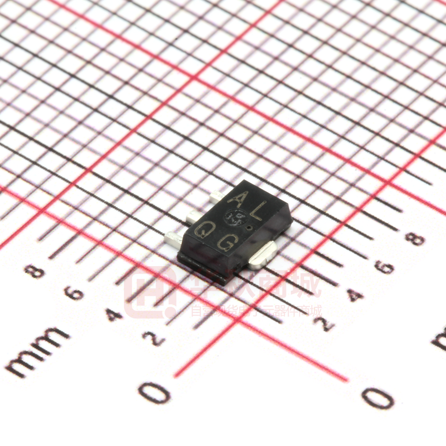

    通用三极管 PNP Ic=1A Vceo=50V hfe=120~270 P=2W MPT3
2SA1900T100Q 数据手册
2SA1900 Transistors Medium power transistor (−50V, −1A) 2SA1900 zDimensions (Unit : mm) zFeatures 1) Low saturation voltage, typically VCE(sat) = −0.15V at IC / IB = −500mA/ −50mA 2) PC=2W (on 40×40×0.7mm ceramic board) 3) Complements the 2SC5053 MPT3 (1)Base (2)Collector (3)Emitter z Absolute maximum ratings (Ta=25°C) Symbol Limits Unit Collector-base voltage Collector-emitter voltage VCBO −60 V VCEO −50 V Emitter- base voltage VEBO −5 V Parameter IC Collector current −1 A −2 0.5 A (Pulse) Collector power dissipation PC 2 W Collector power dissipation tj 150 °C tstg −55 to +150 °C Storage temperature ∗1 W ∗2 + + ∗1 Pw=20ms, Duty=1/2 ∗2 When mounted on a 40 40 0.7mm seramic board. zElectrical characteristics (Ta=25°C) Symbol Min. Typ. Max. Unit Collector-base breakdown voltage Collector-emitter breakdown voltage Parameter BVCBO BVCEO −60 −50 − − − − V V IC = −50µA IC = −1mA Emitter-base breakdown voltage BVEBO ICBO −5 − − V IE = −50µA − − −0.1 µA VCB = −40V − − −0.1 µA − − −0.4 V VEB = −4V IC/IB = −500mA/−50mA 120 − 270 − VCE/IC = −3V/−0.5A Transition frequency IEBO VCE(sat) hFE fT − 150 − MHz Output capacitance Cob − 20 − pF Collector cutoff current Emitter cutoff current Collector-emitter saturation voltage DC current transfer ratio Conditions VCE = −5V , IE = 50mA , f=100MHz VCB = −10V , IE = 0A , f=1MHz zPackaging specifications and hFE Type 2SA1900 Package hFE MPT3 Q AL ∗ Marking Code T100 Basic ordering unit (pleces) 1000 ∗ Denotes hFE Rev.C 1/2 2SA1900 Transistors 1000 −6mA 500 −5mA DC CURRENT GAIN : hFE COLLECTOR CURRENT : IC (A) −0.8 −7m Ta=25°C Ta=25°C A −8mA −9mA −10mA −4mA −0.6 −3mA −0.4 −2mA IB=−1mA −0.2 VCE=−3V 200 100 50 20 10 5 2 0 0 −1 −2 −3 −4 1 −0.001 −5 COLLECTOR TO EMITTER VOLTAGE : VCE (V) 10 5 2 1 1m 2m 5m 10m 20m 50m 0.1 0.2 0.5 1 −10 −5 −2 −1 −1m 1000 Ta=25°C f=1MHz IE=0A 500 200 100 50 20 10 5 2 1 −0.1 −10m −100m −1 −2 Fig.3 Collector-emitter saturation voltage vs.collector current −10 Ta=25°C ∗Single nonrepeatitive pulse −5 −2 IC Max. (Pulse∗) 10 −1 0m s∗ −0.5 s∗ 20 −20 0m 50 −50 =1 100 −100 COLLECTOR CURRENT : IC (A) Fig.2 DC current gain vs. collector current COLLECTOR OUTPUT CAPACITANCE : Cob( (pF) 200 −1 −2 −200 Pw TRANSITION FREQUENCY : fT (MHz) Ta=25°C VCE= −5V 500 −0.1 Ta=25°C −500 IC/IB=10 COLLECTOR CURRENT : IC (A) Fig.1 Grounded emitter output characteristics 1000 −0.01 −1000 COLLECTOR CURRENT : IC (A) −1.0 COLLECTOR SATURATION VOLTAGE : VCE(sat) (mV) zElectric characteristics curves D C −0.2 −0.1 −0.05 −0.02 −1 −10 −100 −0.01 −0.1 −1 −10 −100 EMITTER CURRENT : IE (A) COLLECTOR TO BASE VOLTAGE : VCB (V) COLLECTOR TO EMITTER VOLTAGE : VCE (V) Fig.4 Gain bandwith product vs. emitter current Fig.5 Collector output capacitance vs. collector-base voltage Fig.6 Safe operating area Rev.C 2/2 Appendix Notes No technical content pages of this document may be reproduced in any form or transmitted by any means without prior permission of ROHM CO.,LTD. The contents described herein are subject to change without notice. The specifications for the product described in this document are for reference only. Upon actual use, therefore, please request that specifications to be separately delivered. Application circuit diagrams and circuit constants contained herein are shown as examples of standard use and operation. Please pay careful attention to the peripheral conditions when designing circuits and deciding upon circuit constants in the set. Any data, including, but not limited to application circuit diagrams information, described herein are intended only as illustrations of such devices and not as the specifications for such devices. ROHM CO.,LTD. disclaims any warranty that any use of such devices shall be free from infringement of any third party's intellectual property rights or other proprietary rights, and further, assumes no liability of whatsoever nature in the event of any such infringement, or arising from or connected with or related to the use of such devices. Upon the sale of any such devices, other than for buyer's right to use such devices itself, resell or otherwise dispose of the same, no express or implied right or license to practice or commercially exploit any intellectual property rights or other proprietary rights owned or controlled by ROHM CO., LTD. is granted to any such buyer. Products listed in this document are no antiradiation design. The products listed in this document are designed to be used with ordinary electronic equipment or devices (such as audio visual equipment, office-automation equipment, communications devices, electrical appliances and electronic toys). Should you intend to use these products with equipment or devices which require an extremely high level of reliability and the malfunction of which would directly endanger human life (such as medical instruments, transportation equipment, aerospace machinery, nuclear-reactor controllers, fuel controllers and other safety devices), please be sure to consult with our sales representative in advance. It is our top priority to supply products with the utmost quality and reliability. However, there is always a chance of failure due to unexpected factors. Therefore, please take into account the derating characteristics and allow for sufficient safety features, such as extra margin, anti-flammability, and fail-safe measures when designing in order to prevent possible accidents that may result in bodily harm or fire caused by component failure. ROHM cannot be held responsible for any damages arising from the use of the products under conditions out of the range of the specifications or due to non-compliance with the NOTES specified in this catalog. Thank you for your accessing to ROHM product informations. More detail product informations and catalogs are available, please contact your nearest sales office. ROHM Customer Support System www.rohm.com Copyright © 2008 ROHM CO.,LTD. THE AMERICAS / EUROPE / ASIA / JAPAN Contact us : webmaster@ rohm.co. jp 21 Saiin Mizosaki-cho, Ukyo-ku, Kyoto 615-8585, Japan TEL : +81-75-311-2121 FAX : +81-75-315-0172 Appendix1-Rev2.0
