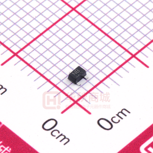

General purpose transistor(50V,0.1A) 2SCR523M / 2SCR523EB / 2SCR523UB Structure NPN silicon epitaxial planar transistor Features 1) Complements the 2SAR523M / 2SAR523EB / 2SAR523UB. Applications Switch, LED driver Packaging specifications Package Packaging Type Type Code Basic ordering unit (pieces) 2SCR523M 2SCR523EB 2SCR523UB VMT3 Taping T2L 8000 EMT3F Taping TL 3000 UMT3F Taping Abbreviated symbol : NB (1) Dimensions (Unit : mm) VMT3 Abbreviated symbol : NB EMT3F (3) (2) TL UMT3F 2.0 0.425 (3) 1.25 2.1 (1) 0.65 0.65 1.3 (2) 0.13 Abbreviated symbol : NB  Absolute maximum ratings (Ta=25C) Parameter Collector-base voltage Collector-emitter voltage Emitter-base voltage Collector current 2SCR523M,2SCR523EB Inner circuit Limits 50 50 5 100 200 150 200 Unit V V V mA mA mW mW °C °C (2) (1) (3) Symbol VCBO VCEO VEBO IC ICP PD Tj Tstg ∗1 ∗2 (1) Base (2) Emitter (3) Collector Power dissipation 2SCR523UB Junction temperature Range of storage temperature 150 −55 to +150 ∗1 Pw=1mS Single pulse ∗2 Each terminal mounted on a recommended land Electrical characteristics (Ta=25C) Parameter Collector-emitter breakdown voltage Collector-base breakdown voltage Emitter-base breakdown voltage Collector cut-off current Emitter cut-off current Collector-emitter saturation voltage DC current gain Transition frequency Output capacitance Symbol BVCEO BVCBO BVEBO ICBO IEBO VCE(sat) hFE fT Cob Min. 50 50 5 − − − 120 − − Typ. − − − − − 0.10 − 350 1.6 Max. − − − 0.1 0.1 0.30 560 − − Unit V V V μA μA V − MHz pF IC=1mA IC=50μA IE=50μA VCB=50V VEB=5V IC=50mA, IB=5mA VCE=6V, IC=1mA VCE=10V, IE=−10mA, f=100MHz VCB=10V, IE=0A, f=1MHz Conditions www.rohm.com c ○ 2009 ROHM Co., Ltd. All rights reserved. 1/2 2010.09 - Rev.A 0.53 0.425 0.53 3000 0.32 0.9 2SCR523M / 2SCR523EB / 2SCR523UB Electrical characteristics curves COLLECTOR CURRENT : IC (mA) 100 Data Sheet COLLECTOR CURRENT : IC (mA) IB=450uA IB=500uA IB=400uA 50 40 30 20 10 0 0 1 2 3 IB=350uA DC CURENT GAIN : hFE 1000 VCE=5V 10 Ta=125°C 25°C -55°C IB=300uA IB=250uA IB=200uA IB=150uA IB=100uA 1 100 0.1 VCE =2V 0.01 Ta=25°C 4 5 IB=50uA IB=0A 10 0.1 Ta=125°C 25°C -55°C 1 10 100 0 0.2 0.4 0.6 0.8 1 BASE TO EMITTER VOLTAGE : VBE (V) COLLECTOR TO EMITTER VOLTAGE : VCE (V) 1 COLLECTOR SATURATION VOLTAGE : VCE(sat) (V) COLLECTOR CURRENT : IC (mA) 1 COLLECTOR SATURATION VOLTAGE : VCE(sat) (V) TRANSITION FREQUENCY :fT (MHz) Ta=25°C IC/IB= 10/1 Ta=125°C 25°C -55°C 1000 VCE = 10V Ta=25°C IC/IB = 20/1 IC/IB =10/1 0.1 0.1 100 0.01 1 10 100 COLLECTOR CURRENT : IC (mA) 0.01 1 10 100 10 0.1 1 10 100 1000 EMITTER CURRENT : IE (mA) COLLECTOR CURRENT : IC (mA) 100 Cib 10 Cob (pF) Cib (pF) Cob 1 0 Ta=25°C f=1MHz IE=0 IC=0 0.01 0.1 1 10 100 COLLECTOR TO BASE VOLTAGE : VCB (V) EMITTER TO BASE VOLTAGE : VEB(V) www.rohm.com c ○ 2009 ROHM Co., Ltd. All rights reserved. 2/2 2010.09 - Rev.A Notice Notes No copying or reproduction of this document, in part or in whole, is permitted without the consent of ROHM Co.,Ltd. The content specified herein is subject to change for improvement without notice. The content specified herein is for the purpose of introducing ROHM's products (hereinafter "Products"). If you wish to use any such Product, please be sure to refer to the specifications, which can be obtained from ROHM upon request. Examples of application circuits, circuit constants and any other information contained herein illustrate the standard usage and operations of the Products. The peripheral conditions must be taken into account when designing circuits for mass production. Great care was taken in ensuring the accuracy of the information specified in this document. However, should you incur any damage arising from any inaccuracy or misprint of such information, ROHM shall bear no responsibility for such damage. The technical information specified herein is intended only to show the typical functions of and examples of application circuits for the Products. ROHM does not grant you, explicitly or implicitly, any license to use or exercise intellectual property or other rights held by ROHM and other parties. ROHM shall bear no responsibility whatsoever for any dispute arising from the use of such technical information. The Products specified in this document are intended to be used with general-use electronic equipment or devices (such as audio visual equipment, office-automation equipment, communication devices, electronic appliances and amusement devices). The Products specified in this document are not designed to be radiation tolerant. While ROHM always makes efforts to enhance the quality and reliability of its Products, a Product may fail or malfunction for a variety of reasons. Please be sure to implement in your equipment using the Products safety measures to guard against the possibility of physical injury, fire or any other damage caused in the event of the failure of any Product, such as derating, redundancy, fire control and fail-safe designs. ROHM shall bear no responsibility whatsoever for your use of any Product outside of the prescribed scope or not in accordance with the instruction manual. The Products are not designed or manufactured to be used with any equipment, device or system which requires an extremely high level of reliability the failure or malfunction of which may result in a direct threat to human life or create a risk of human injury (such as a medical instrument, transportation equipment, aerospace machinery, nuclear-reactor controller, fuelcontroller or other safety device). ROHM shall bear no responsibility in any way for use of any of the Products for the above special purposes. If a Product is intended to be used for any such special purpose, please contact a ROHM sales representative before purchasing. If you intend to export or ship overseas any Product or technology specified herein that may be controlled under the Foreign Exchange and the Foreign Trade Law, you will be required to obtain a license or permit under the Law. Thank you for your accessing to ROHM product informations. More detail product informations and catalogs are available, please contact us. ROHM Customer Support System http://www.rohm.com/contact/ www.rohm.com © 2010 ROHM Co., Ltd. All rights reserved. R1010A
