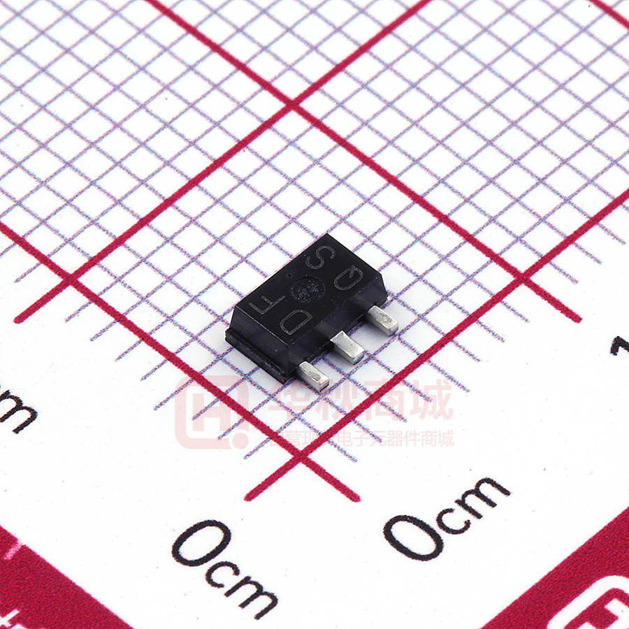

    NPN 1.0A 80V中功率晶体管
2SD1898T100Q 数据手册
2SD1898 / 2SD1733 Datasheet NPN 1.0A 80V Middle Power Transistor lOutline Value VCEO IC 80V 1.0A MPT3 Collector CPT3 Base Collector Emitter 2SD1898 (SC-62) Emitter 2SD1733 (SC-63) e N co ew m m D es en ig de ns d f lFeatures 1) Suitable for Middle Power Driver 2) Complementary PNP Types : 2SB1260 / 2SB1181 3) Low VCE(sat) VCE(sat)= 0.4V Max. (IC/IB=500mA/20mA) Base or Parameter 4) Lead Free/RoHS Compliant. lInner circuit Collector lApplications Motor driver , LED driver Power supply Base Emitter lPackaging specifications Taping code 2SD1898 MPT3 4540 T100 180 12 1,000 DF 2SD1733 CPT3 6595 TL 330 16 2,500 D1733 R Package Package size (mm) N ot Part No. www.rohm.com © 2013 ROHM Co., Ltd. All rights reserved. 1/7 Basic Reel size Tape width ordering (mm) (mm) unit (pcs) Marking 2013.05 - Rev.F Data Sheet 2SD1898 / 2SD1733 lAbsolute maximum ratings (Ta = 25°C) Symbol Values Unit Collector-base voltage VCBO 120 V Collector-emitter voltage VCEO 80 V Emitter-base voltage VEBO 5 V IC 1.0 A DC Collector current Pulsed ICP or Parameter *1 0.5 *2 W 2.0 *3 W 1 *4 W 10 *5 W Tj 150 °C Tstg -55 to +150 °C PD Power dissipation 2SD1733 Junction temperature Range of storage temperature *1 *2 *3 *4 *5 A e N co ew m m D es en ig de ns d f 2SD1898 2.0 Pw=20ms , duty=1/2 Each terminal mounted on a reference land Mounted on a ceramic board (40×40×0.7 mm) Mounted on a substrate TC=25°C lElectrical characteristics (Ta = 25°C) Parameter R Collector-emitter breakdown voltage Collector-base breakdown voltage Emitter-base breakdown voltage N ot Collector cut-off current Emitter cut-off current Collector-emitter saturation voltage Symbol Min. Typ. Max. Unit BVCEO IC = 1mA 80 - - V BVCBO IC = 50mA 120 - - V BVEBO IE = 50mA 5 - - V ICBO VCB = 100V - - 1 mA IEBO VEB = 4V - - 1 mA IC = 500mA, IB = 20mA - 0.15 0.40 V 120 - 390 - VCE = 10V, IE = -50mA f=100MHZ - 100 - MHz VCB = 10V, IE = 0A f = 1MHz - 20 - pF VCE(sat) hFE *6 DC current gain Conditions Transition frequency fT Output capacitance Cob VCE = 3V, IC = 0.5A lhFE rank categories Rank hFE Q 120 to 270 www.rohm.com © 2013 ROHM Co., Ltd. All rights reserved. R 180 to 390 2/7 2013.05 - Rev.F Data Sheet 2SD1898 / 2SD1733 lElectrical characteristic curves(Ta = 25°C) Fig.2 Typical Output Characteristics Fig.1 Ground Emitter Propagation Characteristics 100 10 Ta=100ºC 25ºC -40ºC 1 0.1 0 0.5 1 1.5 BASE TO EMITTER VOLTAGE : VBE [V] COLECTOR TO EMITTE VOLTAGE : VCE [V] Fig.3 DC Current Gain vs. Collector Current(I) 1000 or COLLECTOR CURRENT : IC [A] VCE= 5V Pulsed e N co ew m m D es en ig de ns d f COLLECTOR CURRENT : IC [mA] 1000 Fig.4 DC Current Gain vs. Collector Current(II) 1000 DC CURRENT GAIN : hFE Ta=25ºC Pulsed R 100 N ot DC CURRENT GAIN : hFE VCE= 3V Pulsed 10 1 Ta=100ºC 25ºC -40ºC 10 100 1000 10 10000 COLLECTOR CURRENT : IC [mA] www.rohm.com © 2013 ROHM Co., Ltd. All rights reserved. 100 VCE= 3V 1V 1 10 100 1000 10000 COLLECTOR CURRENT : IC [mA] 3/7 2013.05 - Rev.F Data Sheet 2SD1898 / 2SD1733 lElectrical characteristic curves(Ta = 25°C) Fig.6 Collector-Emitter Saturation Voltage vs. Collector Current (II) Fig.5 Collector-Emitter Saturation Voltage vs. Collector Current (I) Ta=100ºC 25ºC -40ºC 0.1 0.01 1 1 10 100 1000 10000 COLLECTOR CURRENT : IC [mA] 1 IC / IB = 20 10 100 1000 10 100 1000 10000 10000 EMITTER CURRENT : IE [mA] COLLECTOR CURRENT : IC [mA] www.rohm.com © 2013 ROHM Co., Ltd. All rights reserved. 1 TRANSITION FREQUENCY : fT [MHz] R BASE-EMITTER SATURATION VOLTAGE : VBE(sat) [V] N ot 0.1 0.01 Fig.8 Gain Bandwidth Product vs. Emitter Current Ta= -40ºC 25ºC 100ºC 1 IC / IB =20/1 10/1 0.1 COLLECTOR CURRENT : IC [mA] Fig.7 Base-Emitter Saturation Voltage vs. Collector Current 10 Ta=25ºC or COLLECTOR-EMITTER SATURATION VOLTAGE : VCE(sat) [V] IC / IB = 20 e N co ew m m D es en ig de ns d f COLLECTOR-EMITTER SATURATION VOLTAGE : VCE(sat) [V] 1 4/7 2013.05 - Rev.F Data Sheet 2SD1898 / 2SD1733 Fig.9 Emitter input capacitance vs. Emitter-Base Voltage Collector output capacitance vs. Collector-Base Voltage Fig.10 Safe Operating Area 1ms 2SD1898 10ms or COLLECTOR CURRENT : IC [A] 10 1 e N co ew m m D es en ig de ns d f COLLECTOR OUTPUT CAPACITANCE : Cob [pF] EMITTER INPUT CAPACITANCE : Cib [pF] lElectrical characteristic curves(Ta = 25°C) 0.1 DC (Mounted on a reference land) 0.01 0.001 COLLECTOR - BASE VOLTAGE : VCB [V] EMITTER - BASE VOLTAGE : VEB [V] 100ms Ta=25ºC Single non repetitive pulse 0.1 1 10 100 COLLECTOR TO EMITTER VOLTAGE : VCE [V] Fig.11 Safe Operating Area 10 1ms 10ms R 1 0.1 100ms N ot COLLECTOR CURRENT : IC [A] 2SD1733 0.01 DC Ta=25ºC Single non repetitive pulse 0.001 0.1 1 10 100 COLLECTOR TO EMITTER VOLTAGE : VCE [V] www.rohm.com © 2013 ROHM Co., Ltd. All rights reserved. 5/7 2013.05 - Rev.F Data Sheet 2SD1898 / 2SD1733 lDimensions (Unit : mm) D b1 A Lp or E LE HE MPT3 b2 b c b4 e N co ew m m D es en ig de ns d f x S A e1 A l1 β l3 e b5 y S l2 b3 e1 S e Pattern of terminal position areas [Not a recommended pattern of soldering pads] DIM N ot R A b b1 b2 c D E e e1 HE LE Lp x y DIM b3 b4 b5 l1 l2 l3 β MILIMETERS MIN MAX 1.40 1.50 0.30 0.50 1.50 1.70 0.40 0.60 0.35 0.50 4.40 4.70 2.40 2.70 3.00 1.50 3.70 4.30 0.80 1.20 1.01 1.41 0.15 0.10 INCHES MIN 0.055 0.012 0.059 0.016 0.014 0.173 0.094 0.118 0.059 0.146 0.031 0.040 - MILIMETERS MIN MAX 0.65 1.70 0.75 1.71 0.58 3.72 45° MAX 0.059 0.020 0.067 0.024 0.020 0.185 0.106 0.169 0.047 0.056 0.006 0.004 INCHES MIN 45° MAX 0.026 0.067 0.030 0.067 0.023 0.146 Dimension in mm / inches www.rohm.com © 2013 ROHM Co., Ltd. All rights reserved. 6/7 2013.05 - Rev.F Data Sheet 2SD1898 / 2SD1733 lDimensions (Unit : mm) A2 D B A b1 c1 H E L3 L2 CPT3 L4 or A1 b2 Lp L1 e N co ew m m D es en ig de ns d f L b3 c e b x B A A3 l3 l1 e b6 b5 l2 Pattern of terminal position areas [Not a recommended pattern of soldering pads] MILIMETERS MIN MAX 0.00 0.15 2.20 2.50 0.25 0.55 0.75 5.00 5.30 5.00 0.75 0.40 0.60 0.40 0.60 6.30 6.70 5.40 5.80 2.30 9.00 10.00 2.20 2.80 0.80 1.40 1.20 1.80 5.30 0.90 1.00 1.60 0.25 DIM b5 b6 l1 l2 l3 MILIMETERS MIN MAX 1.00 5.20 2.50 5.50 10.00 N ot R DIM A1 A2 A3 b b1 b2 b3 c c1 D E e HE L L1 L2 L3 L4 Lp x INCHES MIN 0.000 0.087 0.010 0.022 0.197 MAX 0.006 0.098 0.030 0.209 0.197 0.030 0.016 0.016 0.248 0.213 0.354 0.087 0.031 0.047 0.039 MIN - 0.024 0.024 0.264 0.228 0.091 0.209 0.035 INCHES 0.394 0.110 0.055 0.071 0.063 0.010 MAX 0.04 0.205 0.098 0.217 0.394 Dimension in mm / inches www.rohm.com © 2013 ROHM Co., Ltd. All rights reserved. 7/7 2013.05 - Rev.F Notice Notes 1) The information contained herein is subject to change without notice. or 2) Before you use our Products, please contact our sales representative and verify the latest specifications : e N co ew m m D es en ig de ns d f 3) Although ROHM is continuously working to improve product reliability and quality, semiconductors can break down and malfunction due to various factors. Therefore, in order to prevent personal injury or fire arising from failure, please take safety measures such as complying with the derating characteristics, implementing redundant and fire prevention designs, and utilizing backups and fail-safe procedures. ROHM shall have no responsibility for any damages arising out of the use of our Poducts beyond the rating specified by ROHM. 4) Examples of application circuits, circuit constants and any other information contained herein are provided only to illustrate the standard usage and operations of the Products. The peripheral conditions must be taken into account when designing circuits for mass production. 5) The technical information specified herein is intended only to show the typical functions of and examples of application circuits for the Products. ROHM does not grant you, explicitly or implicitly, any license to use or exercise intellectual property or other rights held by ROHM or any other parties. ROHM shall have no responsibility whatsoever for any dispute arising out of the use of such technical information. 6) The Products are intended for use in general electronic equipment (i.e. AV/OA devices, communication, consumer systems, gaming/entertainment sets) as well as the applications indicated in this document. 7) The Products specified in this document are not designed to be radiation tolerant. 8) For use of our Products in applications requiring a high degree of reliability (as exemplified below), please contact and consult with a ROHM representative : transportation equipment (i.e. cars, ships, trains), primary communication equipment, traffic lights, fire/crime prevention, safety equipment, medical systems, servers, solar cells, and power transmission systems. 9) Do not use our Products in applications requiring extremely high reliability, such as aerospace equipment, nuclear power control systems, and submarine repeaters. 10) ROHM shall have no responsibility for any damages or injury arising from non-compliance with the recommended usage conditions and specifications contained herein. 11) ROHM has used reasonable care to ensur the accuracy of the information contained in this document. However, ROHM does not warrants that such information is error-free, and ROHM shall have no responsibility for any damages arising from any inaccuracy or misprint of such information. R 12) Please use the Products in accordance with any applicable environmental laws and regulations, such as the RoHS Directive. For more details, including RoHS compatibility, please contact a ROHM sales office. ROHM shall have no responsibility for any damages or losses resulting non-compliance with any applicable laws or regulations. N ot 13) When providing our Products and technologies contained in this document to other countries, you must abide by the procedures and provisions stipulated in all applicable export laws and regulations, including without limitation the US Export Administration Regulations and the Foreign Exchange and Foreign Trade Act. 14) This document, in part or in whole, may not be reprinted or reproduced without prior consent of ROHM. Thank you for your accessing to ROHM product informations. More detail product informations and catalogs are available, please contact us. ROHM Customer Support System http://www.rohm.com/contact/ www.rohm.com © 2013 ROHM Co., Ltd. All rights reserved. R1102A
2SD1898T100Q
物料型号:2SD1898 / 2SD1733 器件简介:NPN型1.0A 80V中等功率晶体管 引脚分配: - 2SD1898 (SC-62):Collector, Emitter, Base - 2SD1733 (SC-63):Collector, Emitter, Base 参数特性: - 集电极-发射极电压 (VCEO):80V - 集电极电流 (Ic):1.0A - 集电极-基极电压 (VCBO):120V - 发射极-基极电压 (VEBO):5V - 集电极电流脉冲 (IcP):2.0A - 功耗 (Pd):2SD1898 (0.5W), 2SD1733 (10W) - 结温 (Tj):150°C - 存储温度范围 (Tstg):-55至+150°C 功能详解:适用于中等功率驱动器,具有低VCE(sat),无铅/RoHS兼容 应用信息:电机驱动器,LED驱动器,电源 封装信息: - 2SD1898:MPT3封装,4540尺寸,T100胶带代码,180mm卷径,12mm胶带宽度,1000pcs基本订购单位,标记为DF - 2SD1733:CPT3封装,6595尺寸,TL胶带代码,330mm卷径,16mm胶带宽度,2500pcs基本订购单位,标记为D1733
