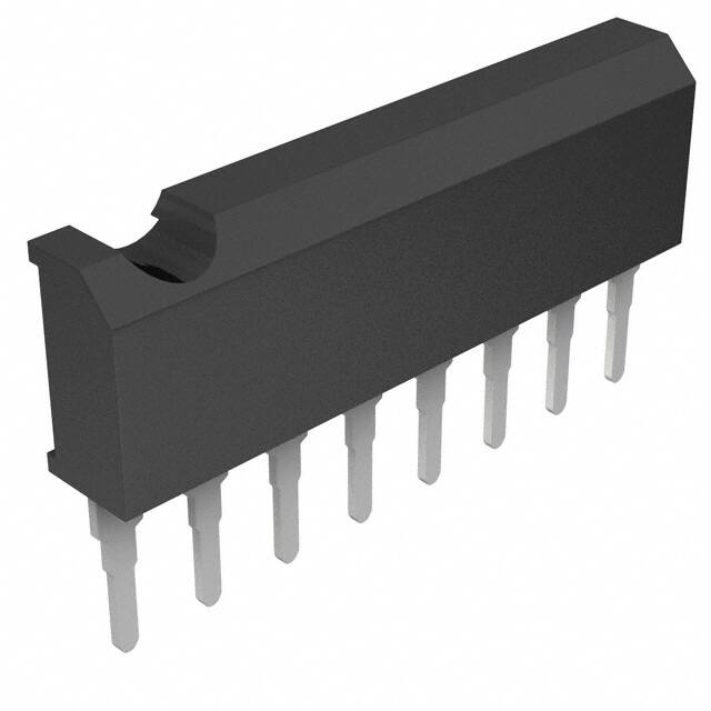

    IC COMPARATOR DUAL 18V SIP8
BA10393N 数据手册
Standard ICs Dual comparators BA10393 / BA10393F / BA10393N The BA10393, BA10393F, and BA10393N are dual comparators with open-collector output which allows wired OR connections. The operating power supply voltage ranges from 2 to 36V for a single power supply and ± 1 to ± 18V for a dual power supply. The packages are as follows: DIP 8-pin (BA10393), SOP 8-pin (BA10393F), and SIP 8-pin (BA10393N). •1)Features Wide operating voltage range. (Single power supply: 2 to 36V, dual power supply: ± 1 to ± 18V) 2) Low current dissipation. (0.4mA typ. at VCC = 5V) 3) Low input offset voltage. (25nA typ. at VCC = 5V) and low input offset voltage. (typically ±1.0mV at VCC = 5V) 4) Wide common-mode input voltage. (0 to VCC – 1.5V) 5) Open collector output. 6) Compatible with 393 comparators from other manufacturers. •Block diagram BA10393 / BA10393F BA10393N OUT1 1 8 VCC – IN1 2 7 OUT2 6 – IN2 5 + IN2 + 4 5 6 7 8 VEE + IN2 – IN2 OUT2 VCC – 3 2ch + IN1 4 + 2 VEE + – IN1 3 2ch – 1 + IN1 + OUT1 – 1ch 1ch – 1 Standard ICs BA10393 / BA10393F / BA10393N •Internal circuit configuration VCC OUT + IN – IN GND •Absolute maximum ratings (Ta = 25°C) Parameter Symbol Limits Unit BA10393 BA10393F BA10393N VCC 36 ( ± 18) 36 ( ± 18) 36 ( ± 18) V Power dissipation Pd 800∗ 550∗ 900∗ mW Differential input voltage VID ± VCC ± VCC ± VCC Power supply voltage V VI – 0.3 ~ VCC – 0.3 ~ VCC – 0.3 ~ VCC V Operating temperature Topr – 40 ~ + 85 – 40 ~ + 85 – 40 ~ + 85 °C Storage temperature Tstg – 55 ~ + 125 – 55 ~ + 125 – 55 ~ + 125 °C Common-mode input voltage ∗ Refer to the Pd characteristics diagram. The values for the BA10393F are those when it is mounted on a glass epoxy PCB (50mm × 50mm × 1.6mm). •Electrical characteristics (unless otherwise noted, Ta = 25°C, V CC Parameter Symbol Min. Input offset voltage VIO — Input offset current IIO — Typ. = + 5V) Max. Unit Conditions ±1 ±5 mV VO = 1.4V ±5 ± 50 nA | IIN+ – IIN– |, VO = 1.4V VO = 1.4V IB — 25 250 nA VICM 0 — VCC –1.5 V Voltage gain AV 93 106 — dB RL = 15kΩ, VCC = 15V Quiescent current IQ — 0.4 1 mA RL = ∞, on All Comparators Output sink current Isink 6 16 — mA VIN – = + 1V, VIN + = 0V, VO = 1.5V Output saturation voltage VOL — 250 400 mV VIN – = + 1V, VIN + = 0V, Isink = 4mA Output leakage current Ileak — 0.1 — nA VIN + = + 1V, VIN – = 0V,VO = 5V tr — 1.3 µs RL = 5.1kΩ, VRL = 5V Input bias current Common-mode input voltage Response time 2 — Standard ICs BA10393 / BA10393F / BA10393N •Electrical characteristic curves 800 BA10393 600 BA10393F 400 200 50 75 85 100 125 0.6 0.4 0.2 0 150 10 20 30 40 0.1 0.01 5mV = INPUT OVERDRIVE 5 4 3 20mV 2 1 100mV 1 10 Fig. 4 Output saturation voltage vs. output current 100 0 – 50 0 30 40 5 INPUT OVERDRIVE = 100mV 4 3 20mV 5mV 2 1 0 – 100 0.1 20 Fig. 3 Input bias current vs. power supply voltage INPUT VOLTAGE VIN (mV) OUTPUT VOLTAGE VO (V) 1 INPUT VOLTAGE VIN (mV) SATURATION VOLTAGE: VOL (V) Ta = 25°C 10 POWER SUPPLY VOLTAGE: V (V) Fig. 2 Quiescent current vs. power supply voltage 10 0 + POWER SUPPLY VOLTAGE: V (V) Fig. 1 Power dissipation vs. ambient temperature OUTPUT SINK CURRENT: IO (mA) 20 + AMBIENT TEMPERATURE: Ta (°C) 0.001 0.01 Ta = 25°C 0 0 OUTPUT VOLTAGE VO (V) 25 0.8 INPUT BIAS CURRENT: IB (nA) BA10393N 0 Ta = 25°C RL = ∞ QUIESCENT CURRENT: IQ (mA) POWER DISSIPATION: Pd (mW) 1000 0 40 1.0 1200 0.5 1.0 1.5 2.0 TIME (µs) Fig. 5 Propagation characteristics (!) 0 100 50 0 0 0.5 1.0 1.5 2.0 TIME (µs) Fig. 6 Propagation characteristics (@) 3 Standard ICs BA10393 / BA10393F / BA10393N notes •(1)Operation Handling unused circuits If a circuit is not in use, we recommend connecting it as shown in Figure 7, so that its input is connected to the potential within the in-phase input voltage range (VICM) and the output is left open. VCC + To potential in VICM Open (no connected) – VEE Fig. 7 Example of unused circuit connection •External dimensions (Units: mm) BA10393 BA10393F 5.0 ± 0.2 5 1 4 0.15 ± 0.1 4 8 4.4 ± 0.2 1 6.2 ± 0.3 5 6.5 ± 0.3 8 0.51Min. 1.5 ± 0.1 7.62 0.3 ± 0.1 0.11 3.2 ± 0.2 3.4 ± 0.3 9.3 ± 0.3 1.27 0.4 ± 0.1 0.3Min. 0.5 ± 0.1 0° ~ 15° 2.54 0.15 DIP8 SOP8 BA10393N 1.2 5.8 ± 0.2 2.8 ± 0.2 8 1 3.5 ± 0.5 10.5 ± 0.5 19.3 ± 0.2 2.54 0.6 0.8 1.3 SIP8 4 0.3 ± 0.1 Appendix Notes No technical content pages of this document may be reproduced in any form or transmitted by any means without prior permission of ROHM CO.,LTD. The contents described herein are subject to change without notice. The specifications for the product described in this document are for reference only. Upon actual use, therefore, please request that specifications to be separately delivered. Application circuit diagrams and circuit constants contained herein are shown as examples of standard use and operation. Please pay careful attention to the peripheral conditions when designing circuits and deciding upon circuit constants in the set. Any data, including, but not limited to application circuit diagrams information, described herein are intended only as illustrations of such devices and not as the specifications for such devices. ROHM CO.,LTD. disclaims any warranty that any use of such devices shall be free from infringement of any third party's intellectual property rights or other proprietary rights, and further, assumes no liability of whatsoever nature in the event of any such infringement, or arising from or connected with or related to the use of such devices. Upon the sale of any such devices, other than for buyer's right to use such devices itself, resell or otherwise dispose of the same, no express or implied right or license to practice or commercially exploit any intellectual property rights or other proprietary rights owned or controlled by ROHM CO., LTD. is granted to any such buyer. Products listed in this document use silicon as a basic material. Products listed in this document are no antiradiation design. The products listed in this document are designed to be used with ordinary electronic equipment or devices (such as audio visual equipment, office-automation equipment, communications devices, electrical appliances and electronic toys). Should you intend to use these products with equipment or devices which require an extremely high level of reliability and the malfunction of with would directly endanger human life (such as medical instruments, transportation equipment, aerospace machinery, nuclear-reactor controllers, fuel controllers and other safety devices), please be sure to consult with our sales representative in advance. About Export Control Order in Japan Products described herein are the objects of controlled goods in Annex 1 (Item 16) of Export Trade Control Order in Japan. In case of export from Japan, please confirm if it applies to "objective" criteria or an "informed" (by MITI clause) on the basis of "catch all controls for Non-Proliferation of Weapons of Mass Destruction. Appendix1-Rev1.0
