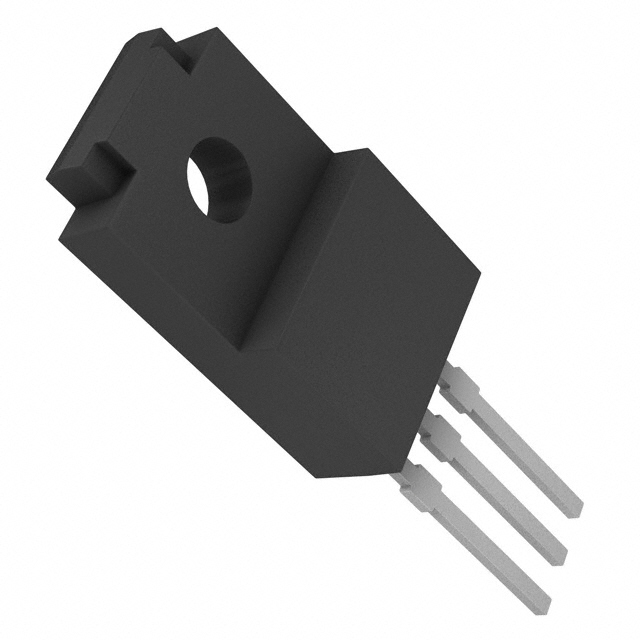

Secondary LDO Regulator Series for Local Power Supplies 1A Secondary LDO Regulators for Local Power Supplies BA□□BC0 Series,BA□□BC0W Series,BA00BC0W Series No.10024EBT02 Description The BA□□BC0 are low-saturation regulators with an output current of 1.0 A and an output voltage accuracy of 2%. A broad output voltage range is offered, from 1.5V to 10V, and built-in overcurrent protection and thermal shutdown (TSD) circuits prevent damage due to short-circuiting and overloading, respectively. Features 1) Output current: 1 A (min.) 2) Output voltage accuracy: 2% Broad output range available: 1.5 V -10 V (BA□□BC0 series) 3) Low saturation-voltage type with PNP output 4) Built-in overcurrent protection circuit 5) Built-in thermal shutdown circuit 6) Integrated shutdown switch (BA□□BC0WT, BA□□BC0WT-5, or BA□□BC0WFP Series, BA00BC0WCP-V5) 7) Operating temperature range: −40°C to +105°C Applications All electronic devices that use microcontrollers and logic circuits Product Lineup Part Number BA□□BC0WT BA□□BC0WT-V5 BA□□BC0WFP BA□□BC0T BA□□BC0FP BA00BC0WCP-V5 1.5      - 1.8      - 2.5      - 3.0     - 3.3      - 5.0      - 6.0     - 7.0     - 8.0     - 9.0      - 10.0 Variable         Package TO220FP-5 TO220FP-5 (V5) TO252-5 TO220FP-3 TO252-3 TO220CP-V5 Part Number: BA□□BC0□ □ a bc Symbol □□ 15 18 25 30 33 50 Description Output voltage specification Output voltage (V) □□ 1.5 V typ. 60 1.8 V typ. 70 2.5 V typ. 80 3.0 V typ. 90 3.3 V typ. J0 5.0 V typ. 00 Output voltage (V) 6.0 V typ. 7.0 V typ. 8.0 V typ. 9.0 V typ. 10.0 V typ. Variable a b c Existence of switch With W : A shutdown switch is provided. Without W : No shutdown switch is provided. Package T : TO20FP-5, TO220FP-5(V5), TO220FP-3 FP : TO252-5, TO252-3 CP : TO220CP-V5 www.rohm.com © 2010 ROHM Co., Ltd. All rights reserved. 1/8 2010.02 - Rev.B BA□□BC0 Series,BA□□BC0W Series,BA00BC0W Series Absolute Maximum Ratings (Ta = 25°C) Parameter Symbol Power supply voltage VCC TO252-3 TO252-5 TO220FP-3 Power Pd dissipation TO220FP-5 TO220FP-5 (V5) TO220CP-V5 Operating temperature range Topr Ambient storage temperature Tstg Maximum junction temperature Tjmax Technical Note Limits 18*1 1200*2 1300*3 2000*4 2000*4 2000*4 2000*4 −40 to +105 −55 to +150 150 Unit V mW °C °C °C *1 Must not exceed Pd. *2 Derated at 9.6mW/°C at Ta>25°C when mounted on a glass epoxy board (70 mm  70 mm  1.6 mm). *3 Derated at 10.4mW/°C at Ta>25°C when mounted on a glass epoxy board (70 mm  70 mm  1.6 mm). *4 Derated at 16mW/°C at Ta> 25°C Recommended Operating Conditions Parameter Input power supply voltage Input power supply voltage Output current Variable output voltage setting value *5 When output voltage is 1.5 V, 1.8 V, or 2.5 V. *6 When output voltage is 3.0 V or higher. Symbol VCC*5 VcC*6 Io Vo Min. 3.0 Vo+1.0 1.5 Max. 16.0 16.0 1 12 Unit V V A V Electrical Characteristics BA□□BC0FP/T/WFP/WT (−V5) (Unless otherwise specified, Ta = 25°C; VCTL = 3 V; VCCDC*7) Parameter Symbol Min. Typ. Output voltage Shutdown circuit current Minimum I/O voltage difference*8 Output current capacity Input stability*9 Load stability Temperature coefficient of output voltage*10 Vo Isd ∆Vd Io Reg.I Reg.L Tcvo Vo (T) 0.98 1 Vo (T) 0 0.3 15 35 0.02 Max. Vo (T)  1.02 10 0.5 35 75 - Unit V A V A mV mV %/°C Conditions Io = 200mA VCTL = 0 V while in off mode Io = 200 mA,Vcc = 0.95  Vo Vcc = Vo+1.0V→16V, Io = 200mA Io = 0 mA →1 A Io = 5 mA、Tj = 0°C to 125℃ Vo (T): Set output voltage *7 Vo = 1.5 V, 1.8 V, 2.5 V : Vcc = 3.3 V, Vo = 3.0 V, 3.3 V : Vcc = 5 V, Vo = 5.0 V : Vcc : 8 V, Vo = 6.0 V : Vcc = 9 V, Vo = 8.0 V : Vcc = 11 V, Vo = 9.0 V : Vcc = 12 V, Vo = 10.0 V : Vcc = 13 V *8 Vo ≥ 3.3 V *9 Change Vcc from 3.0 V to 6 V if 1.5 V ≤ Vo ≤ 2.5 V. *10 Operation guaranteed BA00BC0WFP/WT (−V5)/CP-V5 (Unless otherwise specified, Ta = 25°C, Vcc = 3.3 V, VCTL = 3 V, R1 = 30 k, R2 = 30 k*11) Parameter Symbol Min. Typ. Max. Unit Conditions Shutdown circuit current Isd 0 10 A VCTL = 0 V while in OFF mode Reference voltage Vc 1.225 1.250 1.275 V Io = 50 mA Minimum I/O voltage difference ∆Vd 0.3 0.5 V Io = 500 mA, Vcc = 2.5V Output current capacity Io 1 A Input stability Reg.I 15 30 mV Vcc = Vo + 1.0 V→16V, Io = 200 mA Load stability Reg.L 35 75 mV Io = 0 mA →1A Temperature coefficient of output *12 voltage *11 VOUT = Vc  (R1 + R2) / R1 (V) *12 Operation guaranteed Tcvo - 0.02 - %/°C Io = 5mA, Tj=0°C to 125°C www.rohm.com © 2010 ROHM Co., Ltd. All rights reserved. 2/8 2010.02 - Rev.B BA□□BC0 Series,BA□□BC0W Series,BA00BC0W Series Technical Note Electrical Characteristics Curves (Unless otherwise specified, Ta = 25°C, Vcc = 8 V, VCTL = 2 V, IO = 0 mA) 2.5 6 6 OUTPUT VOLTAGE :VOUT [mA] [BA50BC0WFP] CIRCUIT CURRENT : Icc [mA] 2 OUTPUT VOLTAGE: VOUT [V] 5 4 3 2 1 0 0 2 4 6 8 10 12 14 16 SUPPLY VOLTAGE : Vcc [V] 18 0 2 [BA50BC0WFP] 5 4 3 2 1 0 4 6 8 10 12 14 16 SUPPLY VOLTAGE : Vcc [V] 18 [BA50BC0WFP] 1.5 1 0.5 0 0 2 4 6 8 10 12 14 SUPPLY VOLTAGE : Vcc [V] 16 18 Fig.1 Circuit Current 6 Fig.2 Input Stability(Io=0mA) 0.7 DROPOUT VOLTAGE : ΔVd [mV] RIPPLE REJECTION : R.R. [dB] 0.6 0.5 0.4 0.3 0.2 0.1 0 Fig.3 Input Stability(Io = 1 A) 70 [BA50BC0WFP] OUTPUT VOLTAGE : V OUT [V] 5 4 3 2 1 0 0 0.1 0.2 0 .3 0 .4 0.5 0 .6 0 .7 0.8 0.9 1 1 .1 1.2 1 .3 1 .4 1.5 1.6 1 .7 [BA50BC0WFP] 60 50 40 30 20 10 0 [BA50BC0WFP] 0 0.1 0.2 0.3 0.4 0.5 0.6 0.7 0.8 0.9 1 1.1 1.2 1.3 0 200 400 600 800 1000 OUTPUT CURRENT : IOUT [ A] OUTPUT CURRENT : I OUT [ mA] FREQUENCY : f [Hz] Fig.4 Load Stability Fig.5 I/O Voltage Difference Fig.6 Ripple Rejection 4 OUTPUT VOLTAGE : VOUT [ V] 3.5 3 2.5 2 1.5 1 -4 0 - 30 - 20 -1 0 0 10 20 30 40 50 60 70 80 90 10 0 1 CIRCUIT CURRENT : Icc [mA] 70 [BA50BC0WFP] 0.9 0.8 0.7 0.6 0.5 0.4 0.3 0.2 0.1 0 - 40 -30 - 20 -10 0 1 0 20 [BA50BC0WFP] CIRCUIT CURRENT : Icc [mA] 60 50 40 30 20 10 0 0 100 200 300 400 [BA50BC0WFP] 3 0 40 50 60 70 8 0 9 0 10 0 500 600 700 800 900 1000 TEMPERATURE : Ta [℃] TEMPERATURE: Ta [℃] OUTPUT CURRENT : IOUT [ A] Fig.7 Output Voltage vs Temperature Fig.8 Circuit Current Temperature Fig.9 Circuit Current Classified by Load 6 OUTPUT VOLTAGE : VOUT [V] 5 CONTROL CURRENT : I CTL [μA] 0.6 8 [BA50BC0WFP] OUTPUT VOLTAGE : VOUT [V] 0.5 0.4 0.3 0.2 0.1 0 7 6 5 4 3 2 1 0 [BA50BC0WFP] [BA50BC0WFP] 4 3 2 1 0 0 2 4 6 8 CONTROL VOLTAGE : VCTL [ V] 10 0 2 4 6 8 10 12 14 16 CONTROL VOLTAGE : VCTL [ V] 18 100 120 140 160 180 TEMPERATURE : Ta [℃] 200 Fig.10 CTL Voltage vs Output Voltage Fig.11 CTL Voltage vs CTL Current Fig.12 Thermal Shutdown Circuit www.rohm.com © 2010 ROHM Co., Ltd. All rights reserved. 3/8 2010.02 - Rev.B BA□□BC0 Series,BA□□BC0W Series,BA00BC0W Series Block Diagrams / Standard Example Application Circuits [BA□□BC0T] / [BA□□BC0FP] Fin Vref GND (TO252-3) Technical Note Pin No. 1 TOP VIEW R2 Pin name Vcc N.C./GND OUT GND Function Supply voltage input NC pin/GND *1 Voltage output GMD*2 Driver 2 3 FIN R1 *1 NC pin for TO252-3 and GND pin for TO220FP-3 and TO220FP-5 (V5). *2 TO252-3 only. TSD 1 2 OCP 3 Vcc 0.33μF N.C. (TO252-3) GND (TO220FP-3) OUT 123 22μF PIN 123 External capacitor setting range Approximately 0.33 F. 22 F to 1000 F TO252-3 Vcc (1 Pin) OUT (3 Pin) Fig.13 TO220FP-3 [BA□□BC0WT] / [BA□□BC0WT-V5] / [BA□□BC0WFP] Fin GND(TO252-5) Vcc Vref Driver TOP VIEW R2 12 34 5 TO252-5 R1 TSD OCP Pin No. 1 2 3 4 5 FIN Pin name CTL Vcc N.C./GND OUT N.C. GND Function Output voltage on/off control Supply voltage input NC pin/GND*1 Power supply output NC pin GND*2 1 CTL 2 Vcc 3 4 N.C. (TO252-5) GND (TO220FP-5, -5(V5) OUT 5 N.C. *1 NC pin for TO252-5 and GND pin for TO220FP-5 and TO220FP-5 (V5). *2 TO252-5 only. 22μF 0.33μF PIN Vcc (2 Pin) 12345 12345 External capacitor setting range Approximately 0.33 F. 22 F to 1000 F Fig.14 OUT (4 Pin) TO220FP-5 TO220FP-5 (V5) [BA00BC0WT] / [BA00BC0WCP-V5] / [BA00BC0WFP] / [BA00BC0WT-V5] Fin GND(TO252-5) Vcc Vref Driver TOP VIEW Pin No. 1 2 3 4 5 FIN Pin name CTL Vcc N.C./GND OUT C GND Function Output voltage on/off control Supply voltage input NC pin/GND*1 Power supply output ADJ pin GND*2 123 TSD OCP 12 34 5 TO220CP-V5 TO252-5 5 1 CTL 2 Vcc 3 4 N.C. (TO252-5) GND (TO220FP-5, -5(V5) OUT R2 22μF R1 C *1 NC pin for TO252-5 and GND pin for TO220FP-5 and TO220FP-5 (V5). *2 TO252-5 only. 0.33μF PIN Fig.15 12345 12345 External capacitor setting range Approximately 0.33 F. 22 F to 1000 F Vcc (2 Pin) OUT (4 Pin) TO220FP-5 TO220FP-5 (V5) www.rohm.com © 2010 ROHM Co., Ltd. All rights reserved. 4/8 2010.02 - Rev.B BA□□BC0 Series,BA□□BC0W Series,BA00BC0W Series Input / Output Equivalent Circuit Diagrams Vcc Technical Note Vcc * For the BA00BC0WT, connect R1 and R2 externally between the C and GND pins and between the OUT and C pins. OUT CTL 27kΩ 2kΩ R2 31kΩ R1 Fig.16 Fig.17 Equation: VOUT = Vc  (R1 + R2) / R1 (Vc = 1.25 V (Typ.)) The recommended R1 value is approximately 30 k to 150 k. Thermal Derating Curves  TO220FP-3/TO220FP-5/TO220FP-5V5) 25 POWER DISSIPATION:Pd [W] (1)20.0 20 15 10 5 0 POWER DIDDIPATION:Pd [W] (1) When using an infinite heat sink. j-c = 6.25 (°C/W) (2) During IC without heat sink operation. j-a = 62.5 (°C/W)  TO252-3/TO252-5 2.0 1.6 1.30 1.2 TO252-5 IC mounted on a ROHM standard board Board size: 70  70  1.6 mm Copper foil area: 7  7 mm TO252-5 ja=96.2 (°C/W) TO252-3 ja=104.2 (°C/W) 0.8 0.4 0 TO252-3 (2)2.0 0 25 50 75 100 125 150 0 25 50 75 100 125 150 AMBIENT TEMPERATURE:Ta [°C] AMBIENT TEMPERATURE:Ta [°C] Fig.18 Fig.19 The characteristics of the IC are greatly influenced by the operating temperature. If the temperature exceeds the maximum junction temperature Tjmax, deterioration or damage may occur. Implement proper thermal designs to ensure that power dissipation is within the permissible range in order to prevent instantaneous damage resulting from heat and maintain the reliability of the IC for long-term operation. The following method is used to calculate the power consumption Pc (W). Pc = (Vcc – Vo)  Io + Vcc  Icca Power dissipation Pd ≥ Pc The load current Io is calculated: Io ≤ Pd − Vcc  Icca Vcc − Vo Vcc Vo IO Icca : Input voltage : Output current : Load current : Circuit current Calculation Example: Vcc = 6.0 V and Vo = 5.0 V at Ta = 85°C 0.676 − 6.0  Icca 6.0 − 5.0 Io ≤ 550 mA (Icca  20 mA) Refer to the above and implement proper thermal designs so that the IC will not be used under excessive power dissipation conditions under the entire operating temperature range. The power consumption Pc of the IC in the event of shorting (i.e. the Vo and GND pins are shorted) can be obtained from the following equation: Pc = Vcc  (Icca + Ishort) (Ishort: short current). ja = 96.2°C/W → −10.4 mW/°C 25°C = 1300 mW → 85°C = 676 mW www.rohm.com © 2010 ROHM Co., Ltd. All rights reserved. 5/8 2010.02 - Rev.B BA□□BC0 Series,BA□□BC0W Series,BA00BC0W Series Technical Note Notes for use  Vcc pin Insert a capacitor (0.33 F approx.) between VCC and GND. The capacitance will vary depending on the application. Use a suitable capacitance and implement designs with sufficient margins.  GND pin Verify that there is no potential difference between the ground of the application board and the IC. If there is a potential difference, the set voltage will not be output accurately, resulting in unstable IC operation. Therefore, lower the impedance by designing the ground pattern as wide and as short as possible.  CTL pin CTL 27kΩ 2kΩ 31kΩ The CTL pin turns on at an operating power supply voltage of 2.0 V or higher and turns off at 0.8 V or lower. There is no particular order when turning the power supply and CTL pins on or off. Fig.20 Input Equivalent Circuit Vo pin Iinsert a capacitor between the Vo and GND pins in order to prevent output oscillation. 10.0 Oscillation region 2.0 ESR [] OUT IC 22 F 1.0 0.5 0.2 Stable region 0.1 0.075 0.05 Fig.21 Output Equivalent Circuit 0 200 Oscillation region 400 600 800 1000 Io [mA] Fig.22 ESR vs IO(22μF) The capacitance may vary greatly with temperature changes, thus making it impossible to completely prevent oscillation. Therefore, use a tantalum aluminum electrolytic capacitor with a low ESR (Equivalent Serial Resistance). The output will oscillate if the ESR is too high or too low, so refer to the ESR characteristics in Fig. 20 and operate the IC within the stable region. Use a capacitor within a capacitance between 22F and 1,000F. Below figure,it is ESR-to-Io stability Area characteristics,measured by 22μF-ceramic-capacitor and resistor connected in series. This characteristics is not equal value perfectly to 22µF-aluminum electrolytic capacitor in order to measurement method. Note, however, that the stable range suggested in the figure depends on the IC and the resistance load involved, and can vary with the board’s wiring impedance, input impedance, and/or load impedance. Therefore, be certain to ascertain the final status of these items for actual use. Keep capacitor capacitance within a range of 22µF~1000μF. It is also recommended that a 0.33μF bypass capacitor be connected as close to the input pin-GND as location possible. However, in situations such as rapid fluctuation of the input voltage or the load, please check the operation in real application to determine proper capacitance. www.rohm.com © 2010 ROHM Co., Ltd. All rights reserved. 6/8 2010.02 - Rev.B BA□□BC0 Series,BA□□BC0W Series,BA00BC0W Series Technical Note Notes for use 1. Absolute maximum ratings An excess in the absolute maximum ratings, such as supply voltage, temperature range of operating conditions, etc., can break down the devices, thus making impossible to identify breaking mode, such as a short circuit or an open circuit. If any over rated values will expect to exceed the absolute maximum ratings, consider adding circuit protection devices, such as fuses. 2. GND voltage The potential of GND pin must be minimum potential in all operating conditions. 3. Thermal design Use a thermal design that allows for a sufficient margin in light of the power dissipation (Pd) in actual operating conditions. 4. Inter-pin shorts and mounting errors Use caution when positioning the IC for mounting on printed circuit boards. The IC may be damaged if there is any connection error or if pins are shorted together. 5. Actions in strong electromagnetic field Use caution when using the IC in the presence of a strong electromagnetic field as doing so may cause the IC to malfunction. 6. Testing on application boards When testing the IC on an application board, connecting a capacitor to a pin with low impedance subjects the IC to stress. Always discharge capacitors after each process or step. Always turn the IC's power supply off before connecting it to or removing it from a jig or fixture during the inspection process. Ground the IC during assembly steps as an antistatic measure. Use similar precaution when transporting or storing the IC. 7. Regarding input pin of the IC This monolithic IC contains P+ isolation and P substrate layers between adjacent elements in order to keep them isolated. P-N junctions are formed at the intersection of these P layers with the N layers of other elements, creating a parasitic diode or transistor. For example, the relation between each potential is as follows: When GND > Pin A and GND > Pin B, the P-N junction operates as a parasitic diode. When GND > Pin B, the P-N junction operates as a parasitic transistor. Parasitic diodes can occur inevitable in the structure of the IC. The operation of parasitic diodes can result in mutual interference among circuits, operational faults, or physical damage. Accordingly, methods by which parasitic diodes operate, such as applying a voltage that is lower than the GND (P substrate) voltage to an input pin, should not be used. 8. Ground Wiring Pattern When using both small signal and large current GND patterns, it is recommended to isolate the two ground patterns, placing a single ground point at the ground potential of application so that the pattern wiring resistance and voltage variations caused by large currents do not cause variations in the small signal ground voltage. Be careful not to change the GND wiring pattern of any external components, either. 9. Thermal shutdown circuit The IC incorporates a built-in thermal shutdown circuit (TSD circuit). The thermal shutdown circuit (TSD circuit) is designed only to shut the IC off to prevent thermal runaway. It is not designed to protect the IC or guarantee its operation. Do not continue to use the IC after operating this circuit or use the IC in an environment where the operation of this circuit is assumed. 10. Overcurrent Protection Circuit An overcurrent protection circuit is incorporated in order to prevention destruction due to short-time overload currents. Continued use of the protection circuits should be avoided. Please note that the current increases negatively impact the temperature. 11. Damage to the internal circuit or element may occur when the polarity of the Vcc pin is opposite to that of the other pins in applications. (I.e. Vcc is shorted with the GND pin while an external capacitor is charged.) Use a maximum capacitance of 1000μF for the output pins. Inserting a diode to prevent back-current flow in series with Vcc or bypass diodes between Vcc and each pin is recommended. Resistor 抵抗 Bypass Diode Transistor (NPN) ) トランジスタ(NPN (端子 B) C (PIN B) (端子 A) (PIN A) ~ ~ B (PINB) C ~ ~ E GND Diode for preventing back current flow ~ ~ N P+ N N P+ N N B E GND VCC P+ N Output pin P P P N P+ N Parasitic elements or transistors (PINA) P substrate P 基板 Parasitic elements 寄生素子 P 基板 P substrate Parasitic elements Parasitic elements GND GND GND Fig.23 Bypass Diode www.rohm.com © 2010 ROHM Co., Ltd. All rights reserved. Fig.24 Example of Simple Bipolar IC Architecture 7/8 2010.02 - Rev.B ~ ~ N BA□□BC0 Series,BA□□BC0W Series,BA00BC0W Series ●Ordering part number Technical Note B D 1 8 B C 0 W W : Include F P - E 2 Part number Output voltage 00:Variable Other:Fixed Current capacity BC0 : 1A Shutdown switch パッケージ Packaging and forming specification FP : TO252-3 E2: Embossed tape and reel TO252-5 None: Container tube T : TO220FP-3 TO220FP-5 TO220FP-5(V5) CP : TO220CP-V5 TO252-3 6.5±0.2 1.5±0.2 Tape C0.5 2.3±0.2 0.5±0.1 Embossed carrier tape 2000pcs E2 The direction is the 1pin of product is at the lower left when you hold +0.2 5.1 -0.1 Quantity Direction of feed FIN 5.5±0.2 9.5±0.5 ( reel on the left hand and you pull out the tape on the right hand ) 0.65 0.75 2.3±0.2 0.8 0.65 0.5±0.1 2.3±0.2 1.0±0.2 2.5 1 2 3 1.5 1pin Direction of feed (Unit : mm) Reel ∗ Order quantity needs to be multiple of the minimum quantity. TO252-5 6.5±0.2 +0.2 5.1 -0.1 2.3±0.2 C0.5 0.5±0.1 Tape Quantity Direction of feed Embossed carrier tape 2000pcs E2 The direction is the 1pin of product is at the lower left when you hold 1.5±0.2 FIN 5.5±0.2 9.5±0.5 ( reel on the left hand and you pull out the tape on the right hand ) 0.8 0.5±0.1 0.5 1.27 1.0±0.2 2.5 123 45 1.5 1pin Direction of feed (Unit : mm) Reel ∗ Order quantity needs to be multiple of the minimum quantity. TO220CP-V5 +0.3 φ 3.2 ± 0.1 10.0 -0.1 4.5± 0.1 +0.2 2.8 -0.1 Tape Quantity Embossed carrier tape 500pcs E2 +0.4 15.2 -0.2 12.0 ± 0.2 8.0 ± 0.2 13.60 Direction of feed 16.92 ( reel on the left hand and you pull out the tape on the right hand The direction is the 1pin of product is at the lower left when you hold ) 4.92 ± 0.2 1.0 ± 0.2 1.444 0.82 ± 0.1 0.92 1.778 0.42 ± 0.1 1.58 (2.85) 4.12 (1.0) (Unit : mm) Reel 1pin Direction of feed ∗ Order quantity needs to be multiple of the minimum quantity. www.rohm.com © 2010 ROHM Co., Ltd. All rights reserved. 8/8 2010.02 - Rev.B BA□□BC0 Series,BA□□BC0W Series,BA00BC0W Series TO220FP-3 +0.3 10.0 −0.1 +0.3 4.5 −0.1 φ3.2±0.1 +0.2 2.8 −0.1 Technical Note Container Quantity Direction of feed Tube 500pcs Direction of products is fixed in a container tube +0.4 17.0 −0.2 12.0±0.2 13.5Min. 5.0±0.2 8.0±0.2 1.8±0.2 7.0 +0.3 −0.1 1.3 0.8 2.54±0.5 0.55 +0.1 −0.05 2.6±0.5 2.54±0.5 12 3 (Unit : mm) ∗ Order quantity needs to be multiple of the minimum quantity. TO220FP-5 1.8±0.2 +0.3 10.0−0.1 +0.3 7.0 −0.1 +0.3 4.5 −0.1 φ3.2±0.1 +0.2 2.8 −0.1 Container Quantity Direction of feed Tube 500pcs Direction of products is fixed in a container tube +0.4 17.0 −0.2 12.0±0.2 13.5Min. 8.0±0.2 0.7 1.2 0.8 1.778 0.5±0.1 2.85 12345 (Unit : mm) ∗ Order quantity needs to be multiple of the minimum quantity. TO220FP-5(V5) 1.8±0.2 + 0.3 10.0 − 0.1 7.0 + 0.3 − 0.1 φ3.2±0.1 +0.3 4.5 −0.1 +0.2 2.8 −0.1 Container Quantity Direction of feed Tube 500pcs Direction of products is fixed in a container tube +0.4 17.0 −0.2 12.0±0.2 31.5Max. 8.0±0.2 0.7 (2.0) 17.5 1.2 0.8 0.5±0.1 1.778 4.25 8.15 12345 23.4 (2.85) 25.8 (Unit : mm) ∗ Order quantity needs to be multiple of the minimum quantity. www.rohm.com © 2010 ROHM Co., Ltd. All rights reserved. 9/8 2010.02 - Rev.B Notice Notes No copying or reproduction of this document, in part or in whole, is permitted without the consent of ROHM Co.,Ltd. The content specified herein is subject to change for improvement without notice. The content specified herein is for the purpose of introducing ROHM's products (hereinafter "Products"). If you wish to use any such Product, please be sure to refer to the specifications, which can be obtained from ROHM upon request. Examples of application circuits, circuit constants and any other information contained herein illustrate the standard usage and operations of the Products. The peripheral conditions must be taken into account when designing circuits for mass production. Great care was taken in ensuring the accuracy of the information specified in this document. However, should you incur any damage arising from any inaccuracy or misprint of such information, ROHM shall bear no responsibility for such damage. The technical information specified herein is intended only to show the typical functions of and examples of application circuits for the Products. ROHM does not grant you, explicitly or implicitly, any license to use or exercise intellectual property or other rights held by ROHM and other parties. ROHM shall bear no responsibility whatsoever for any dispute arising from the use of such technical information. The Products specified in this document are intended to be used with general-use electronic equipment or devices (such as audio visual equipment, office-automation equipment, communication devices, electronic appliances and amusement devices). The Products specified in this document are not designed to be radiation tolerant. While ROHM always makes efforts to enhance the quality and reliability of its Products, a Product may fail or malfunction for a variety of reasons. Please be sure to implement in your equipment using the Products safety measures to guard against the possibility of physical injury, fire or any other damage caused in the event of the failure of any Product, such as derating, redundancy, fire control and fail-safe designs. ROHM shall bear no responsibility whatsoever for your use of any Product outside of the prescribed scope or not in accordance with the instruction manual. The Products are not designed or manufactured to be used with any equipment, device or system which requires an extremely high level of reliability the failure or malfunction of which may result in a direct threat to human life or create a risk of human injury (such as a medical instrument, transportation equipment, aerospace machinery, nuclear-reactor controller, fuelcontroller or other safety device). ROHM shall bear no responsibility in any way for use of any of the Products for the above special purposes. If a Product is intended to be used for any such special purpose, please contact a ROHM sales representative before purchasing. If you intend to export or ship overseas any Product or technology specified herein that may be controlled under the Foreign Exchange and the Foreign Trade Law, you will be required to obtain a license or permit under the Law. Thank you for your accessing to ROHM product informations. More detail product informations and catalogs are available, please contact us. ROHM Customer Support System http://www.rohm.com/contact/ www.rohm.com © 2010 ROHM Co., Ltd. All rights reserved. R1010A

1. 物料型号 - BA□□BC0系列、BA□□BC0W系列、BA00BC0W系列
2. 器件简介 - BA□□BC0系列是低饱和电压型LDO调节器,输出电流为1.0A,输出电压精度为±2%。提供从1.5V至10V的广泛输出电压范围,内置过流保护和热关断(TSD)电路,可防止因短路和过载造成的损坏。
3. 引脚分配 - BA□□BC0T/FP系列: - 引脚1:Vcc(供电电压输入) - 引脚2:N.C./GND(NC引脚/地) - 引脚3:OUT(电压输出) - 引脚GND(地) - BA□□BC0WT/WT-V5/WFP系列: - 引脚1:CTL(输出电压开关控制) - 引脚2:Vcc(供电电压输入) - 引脚3:N.C./GND(NC引脚/地) - 引脚4:OUT(电源输出) - 引脚5:NC(NC引脚) - 引脚GND(地)
4. 参数特性 - 输出电流:1A(最小值) - 输出电压精度:±2% - 低饱和电压型,带有PNP输出 - 内置过流保护电路 - 内置热关断电路 - 集成关断开关(特定系列) - 工作温度范围:-40°C至+105°C
5. 功能详解 - 提供了不同输出电压的设定值,通过调整外部电阻器R1和R2来实现输出电压的调整。例如,BA00BC0WT系列需要在C引脚和GND引脚之间以及OUT引脚和C引脚之间外部连接R1和R2。
6. 应用信息 - 适用于所有使用微控制器和逻辑电路的电子设备。
7. 封装信息 - 提供了多种封装选项,包括TO220FP-5、TO220FP-3、TO252-5、TO252-3和TO220CP-V5等。
