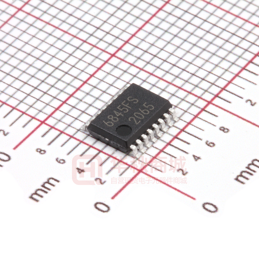

Motor driver ICs
Stepping motor driver
BA6845FS
The BA6845FS is a stepping motor driver with a maximum output current of 1.0A. The logic input allows three output
modes : forward, reverse, and power save. The IC has a low output saturation voltage and is capable of driving motors
at low supply voltage.
Applications
Stepping motors for floppy disk drives
Features
1) Low output saturation voltage.
2) Power save circuit.
3) Thermal shutdown circuit.
